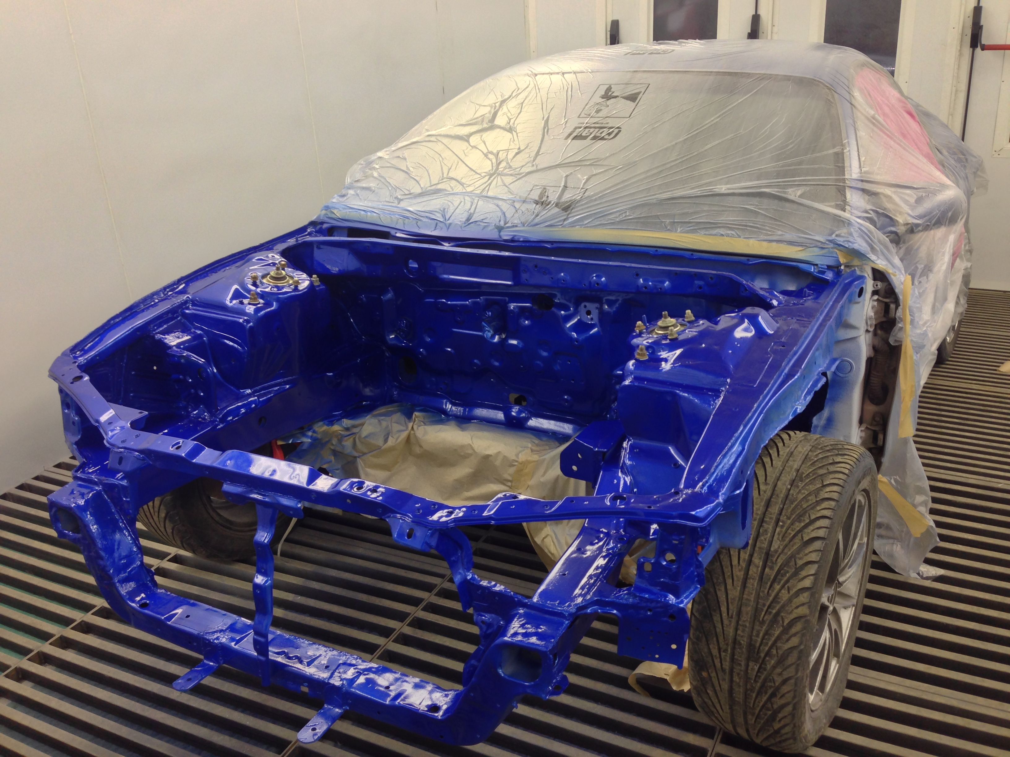

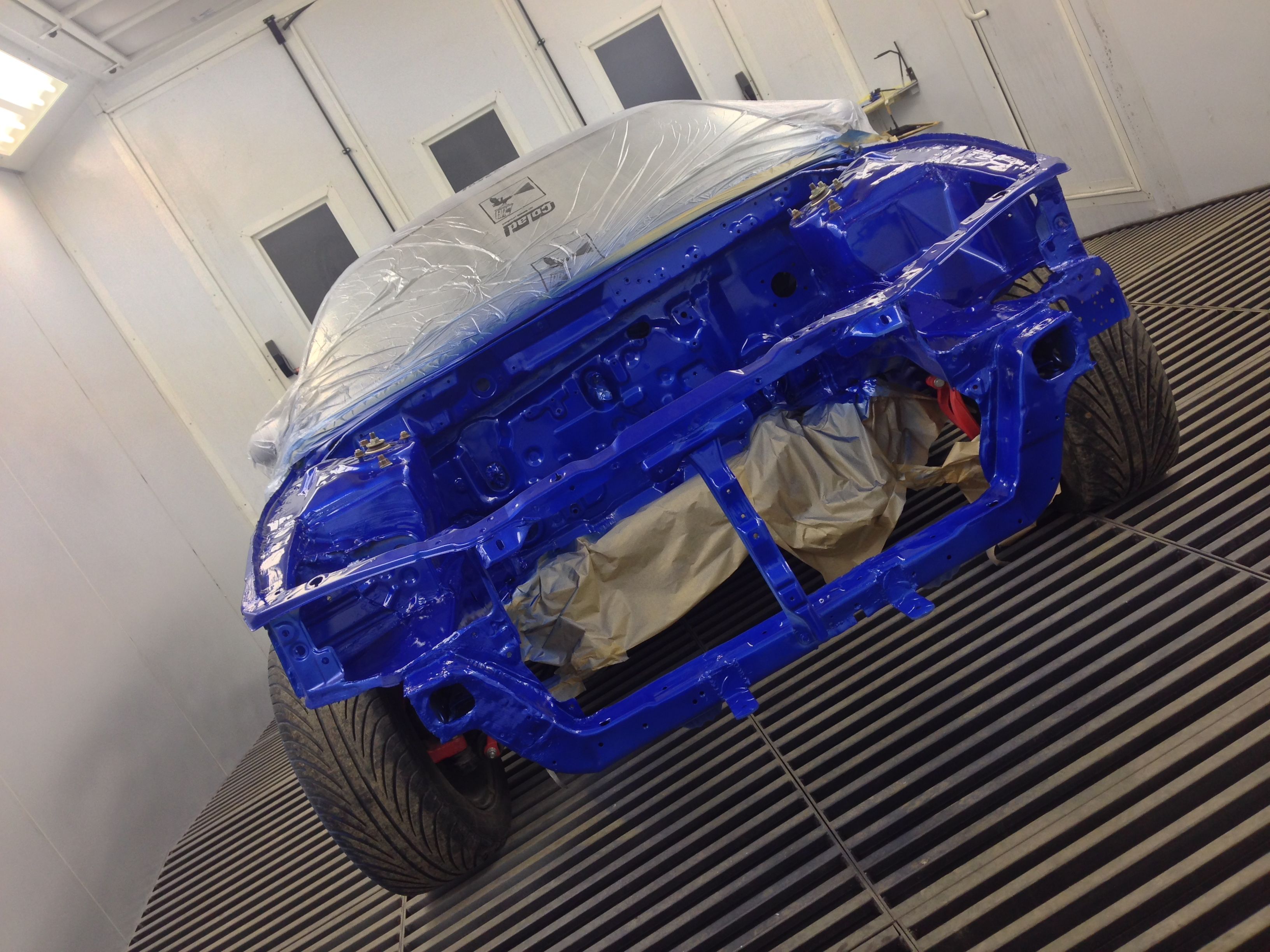

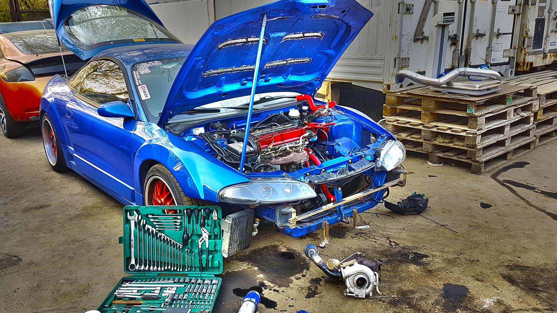

In this part of the review we will talk about what is "under the car".
This is not just a swap evo9 4g63 motor in Eclipse! We redid the whole car! Different units and aggregates from different models were used for this swap.
What rear suspension and transmission from?
AWD hubs, levers , drive shafts and gearbox?
What gear ratio was used?
How to install the propeller shaft and exhaust system?
How was the front of the car modified?
What radiators have been used and where are they installed?
Intake, Exhaust, awd swap and more - in this review.

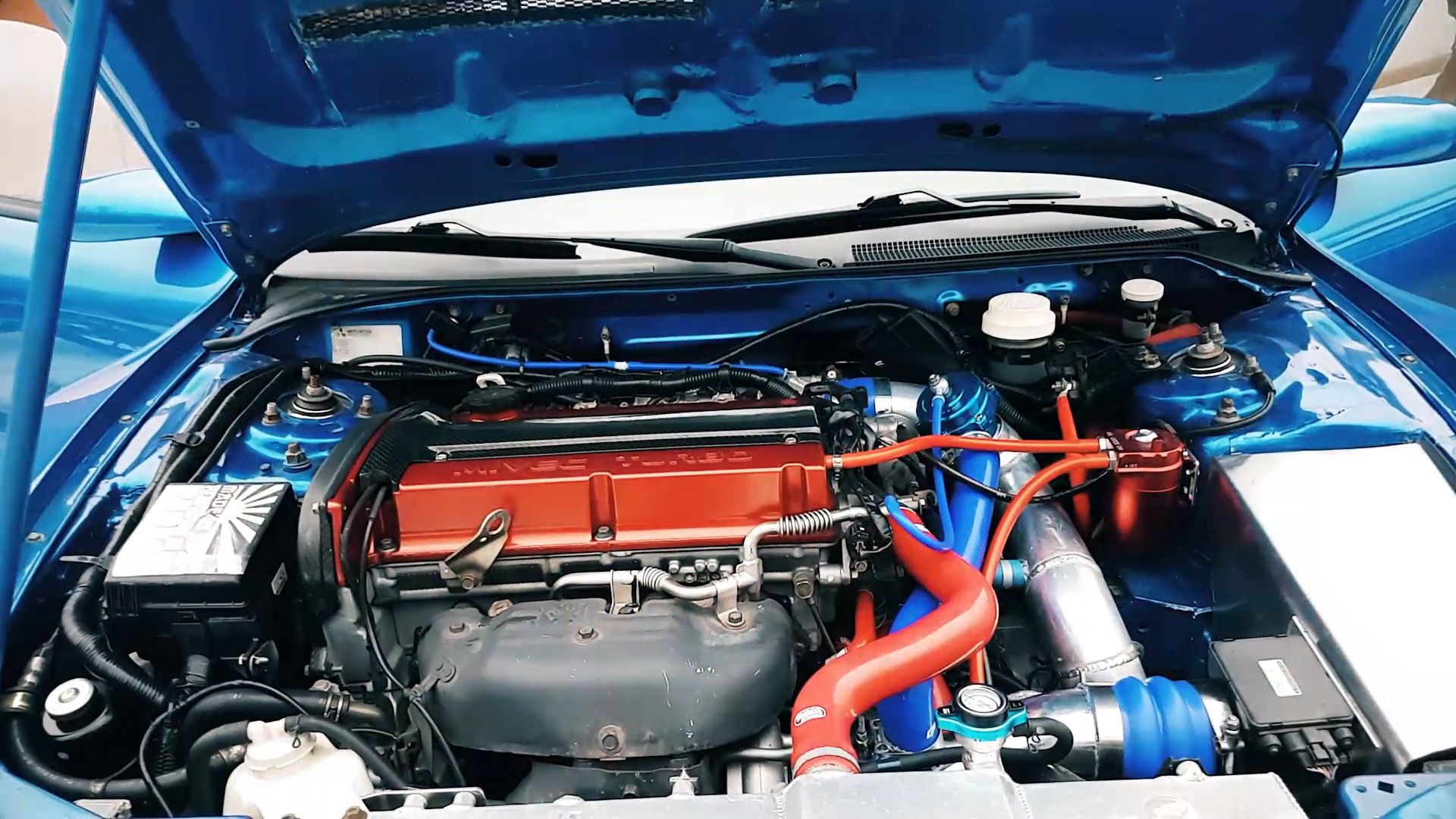

Continue story about Mitsubishi Evolution 9 inside Eclipse 2G. Now the most interesting! Under the hood there is 4G63 Mivec, 2 Litre, turbo, 400 hp (280 were from the factory). 4wheel drive 5 gear mechanical gearbox also from EVO9. Remade intake and exhaust systems, fuel and cooling systems, brake and 4wd systems. Electrical blocks are from evo9, it controls all systems of Eclipse 2G.
Remade interior. Installed musical system. Carbon fiber elements are made for the decoration.
About the making this project and how it looks like I will tell you in this serie.
