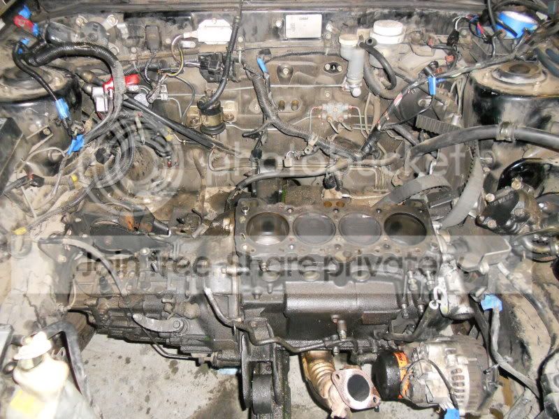

For those interested, I'll be building this car for street/strip duty. Hoping to eventually make it capable of chasing the 14b/16g records (no nitrous). I know it's got a long way to go, but that's my ultimate goal. So I got a little time this past weekend to work on my Laser. For those just seeing this, just want to point out that I got this car for $500. 220k miles, ran like crap, but is very straight. I didn't get any interior/exterior pics, but got some engine bay and head pics.
First is a quick pic of the head. The 14b has been off before, as well as the head I believe. I'll explain why I believe so on both. The oil supply line for the turbo only had 1 crush washer on the head and only 1 on the turbo...therefore both leaked like crazy. This got the head and turbo both very dirty. The reason I know the head has been off is because there was a missing injector clip when I pulled them off. I happened to find it sandwiched between the head and block, meshed into the head gasket.

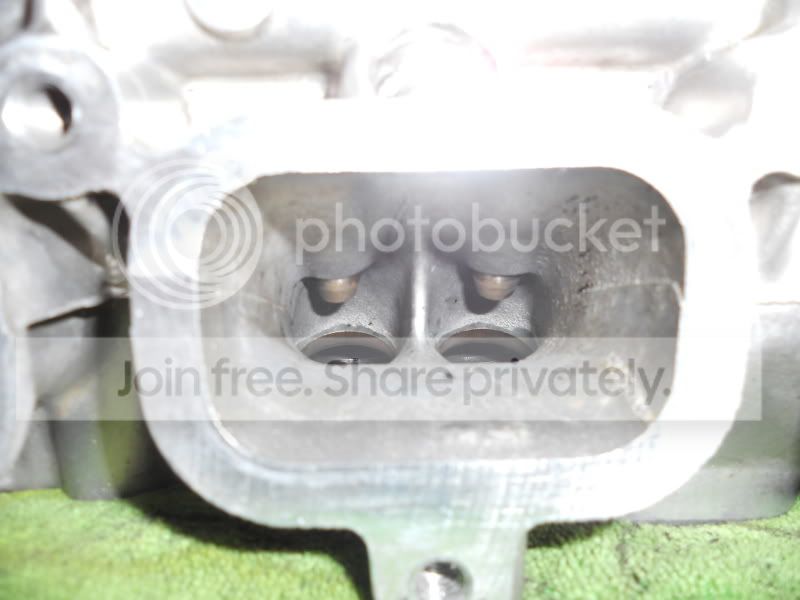

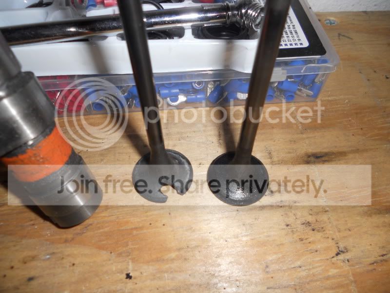

Here is a quick pic of why the car ran like crap:
When I did the compression test, 2, 3 and 4 were all at or above 135psi. Number 1 had 0, for obvious reasons. That's an exhaust valve with a pretty decent hole in it. I worried about the head and cylinder wall be damaged. The head has a very small knick, but nothing that won't come out when bowl blending occurs. The cylinder wall has a small knick that's only visible...you can't actually catch anything on it. Not worried on that either...going .020" overbore should do the trick!

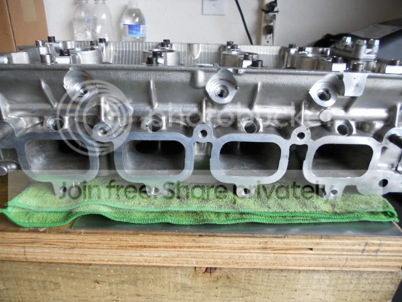

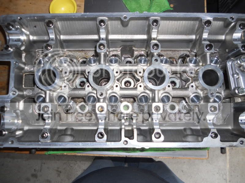

At any rate, here are a few pics of the head cleaned up a little and disassembled along with pics of the engine bay. All A/C stuff in the engine bay is gone. I drained the p/s last night and hope to remove it today or tomorrow.
