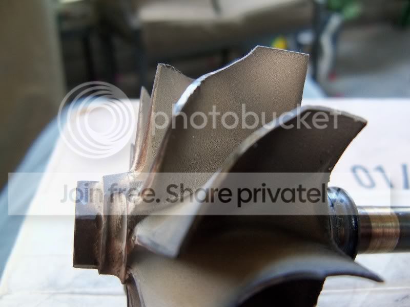

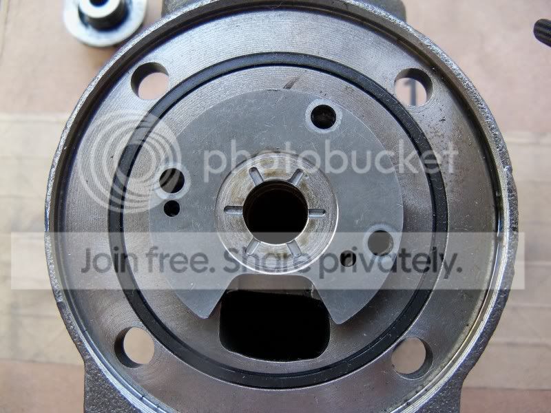

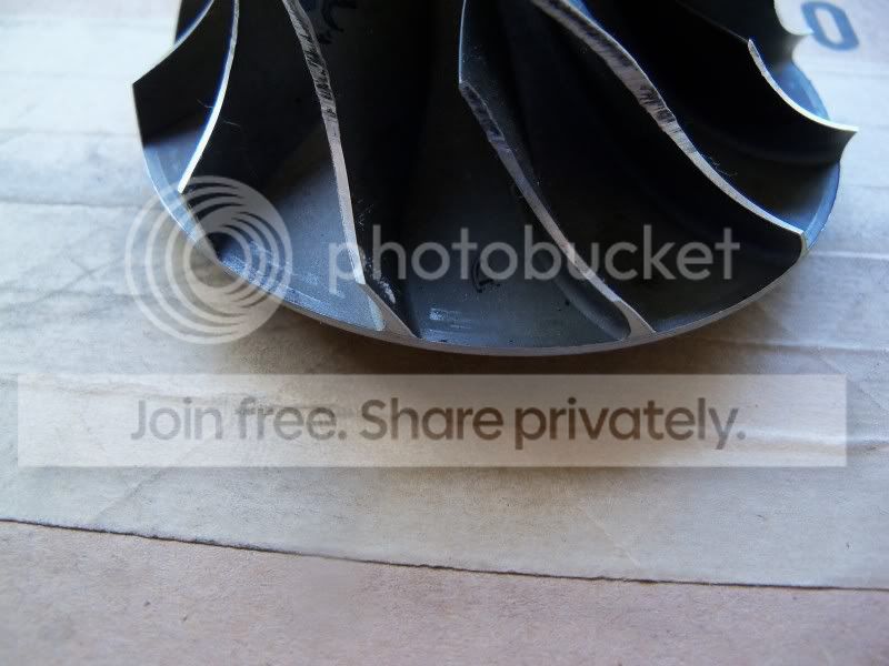

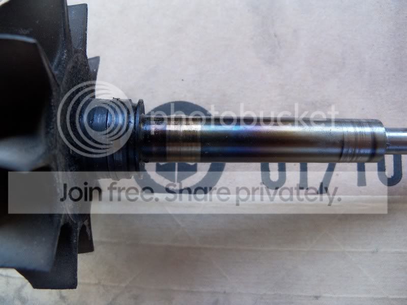

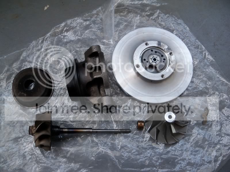

Here are pictures of the components from dead turbo number 1. Of interest in these pictures is the mix of real Garrett and imitation parts. The compressor wheel has the A cast in it marking it as genuine but the turbine wheel does not and nor does the center section. Also I have been told that if the shaft was a real Garrett shaft it would have a thinner diameter in the area between the journal bearings.
