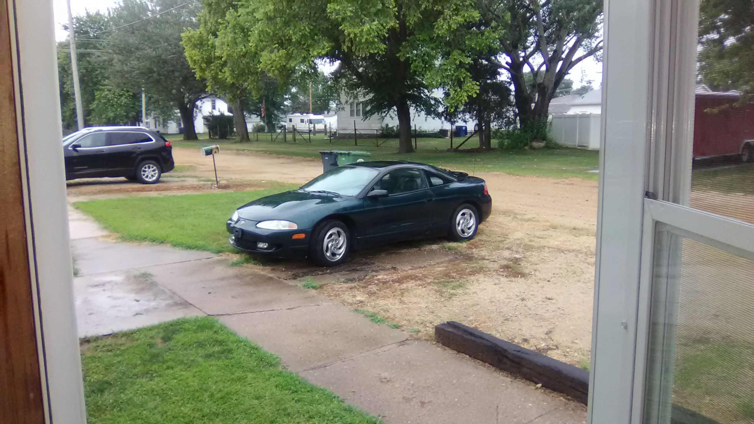

Pine green, FWD, TSi. Not much to say really.
