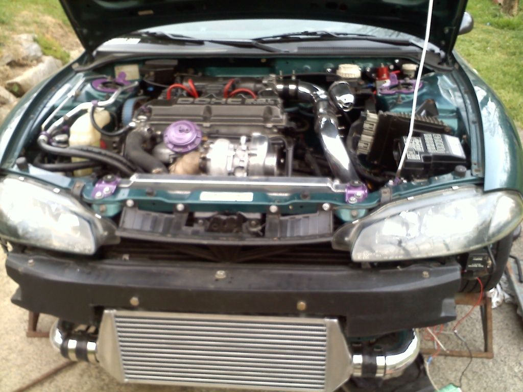

well 3 weeks ago decided to turn my boost up in the car and 15psi stretched out the head studs :ohdamn: 2nd time i had to pull the head off the car. this time ordered arp head studs. send the head out to be milled. poly motor mounts. new water pump
Now up here in North jersey there isn't any close Dsm by me. There is more stances out vw, audis up by me so its an influence on how my car is built. moved the battery to the trunk, also tucking some wires. Im still waiting on my Ic pipes to arrive so i can put everything back together. While working on the car i got my 6 month old husky and my 2 yr old lab that are with me, they help me a lot ROFL
I've built this bottom end. and a year later fixing my top end. I use this forum for everything and once i get my ic pipes in and my car is all together i will update with the specs and pics :thumb:
Plan- 20psi and see what it makes on the dyno
so little more update. i have the cams in. I did the timing on it today.Put the motor mounts all back in but it got to dark to take a pic. This is the only one i have of when my turbo went on.

less pics of the car, more pics of the husky =P. Looking good, Need a purple VC now though to match everything up. Did you poly the mounts all around as well?
I'm thinking i might do something with the valve cover. its a "hammered" paint thats on it now. i just used the purple cause i had and extra can around the house and needed to throw off just the silver and black. and i have so many pictures of my husky haha. but all poly mounts except the trans mount. that ones brand new
