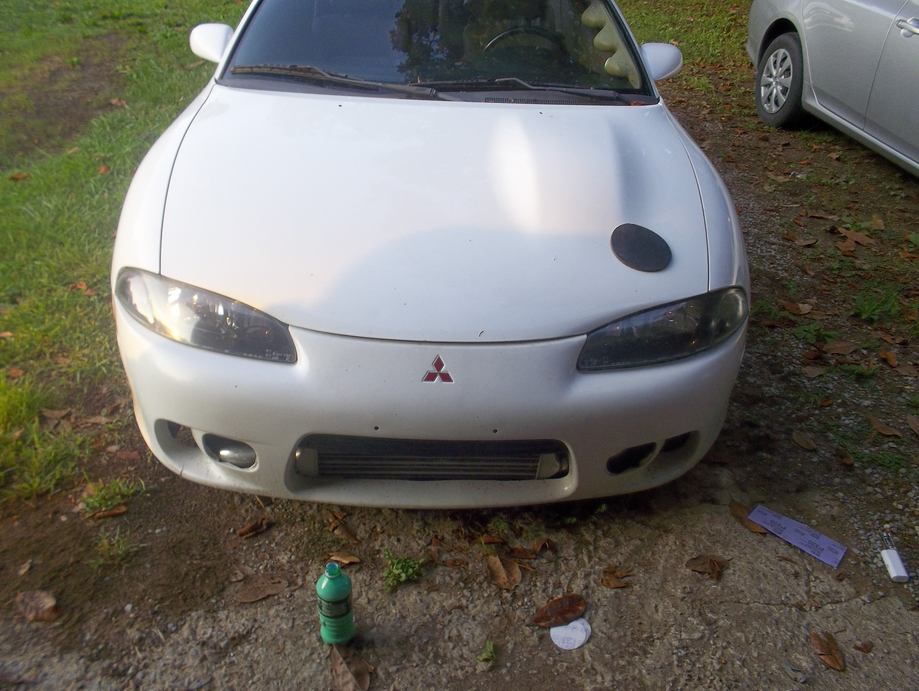

99 Eclipse 16g Restomod Daily Driver

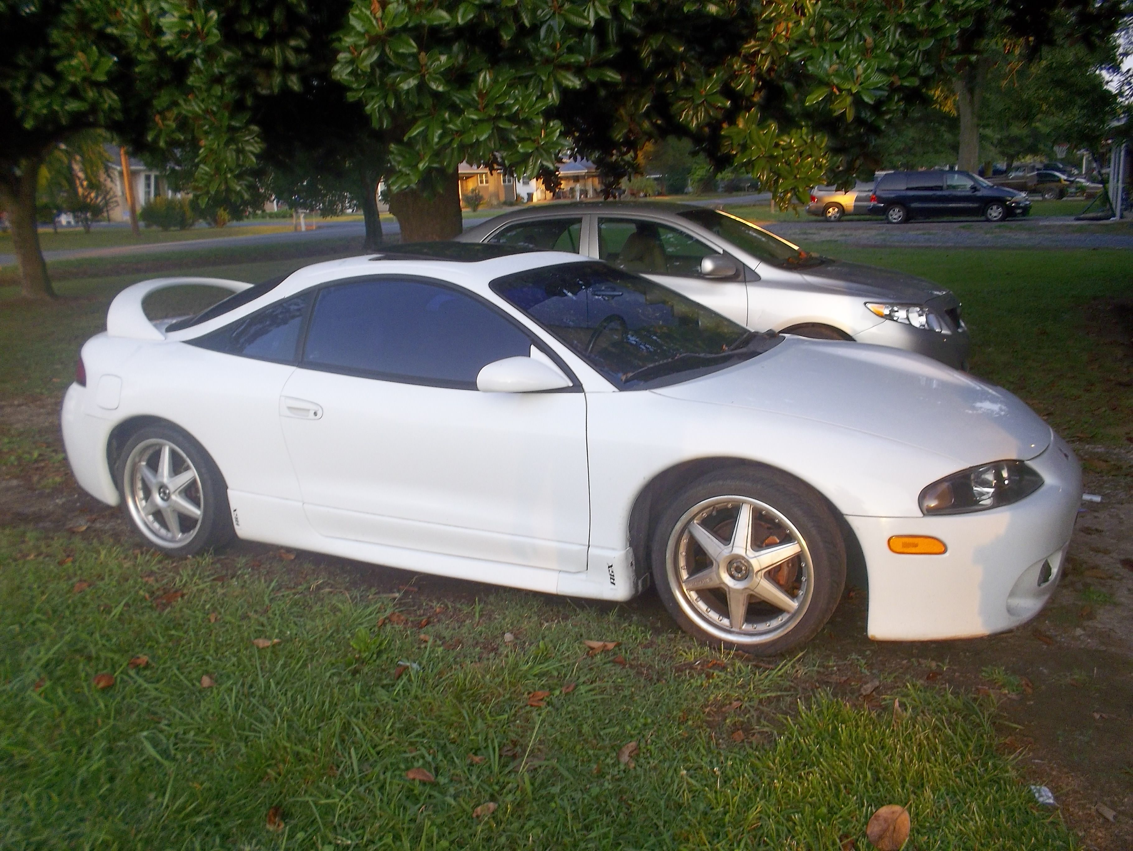

1999 Eclipse GS-T. Plan to change the color, do a projector retro. 16g with supporting mods, tuned on H8 ecu, then eventually move to evo 8 ecu. Just want a really nice daily driven DSM.Will eventually be changing the 16g for a Holset setup.

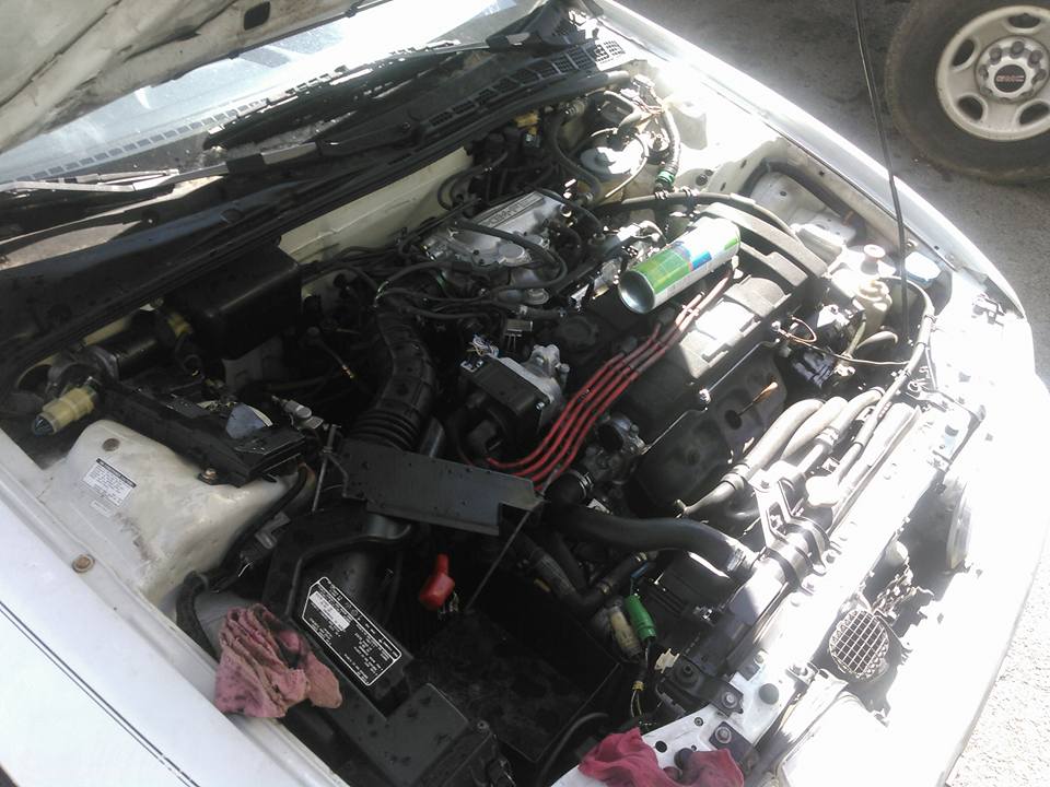

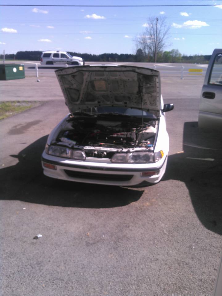

So I bought a 91 DA Integra 4 door as my first flip in a number of years. PO Claimed it needed a transmission. Well it runs and drives, so I knew that wasn't the case. Simply crimped the pins for the shift solenoids closed a bit to get better continuity through the connector. Shift problem is fixed. Now I need to find out why it wont shift into 4th. I also cleaned the inside of the car, it wasn't bad but needed a good vacuum and wipe down. Planning on putting some hubcaps on the steelies, fixing a few small dents, and putting a used side mirror on it, removing the pin stripe, and just a few odds and ends like that then sell it. Cost 400$, looks to be worth about $2,250 when all is said and done. So far my total cost has been 417$
Yes its All stock, and in very good condition.

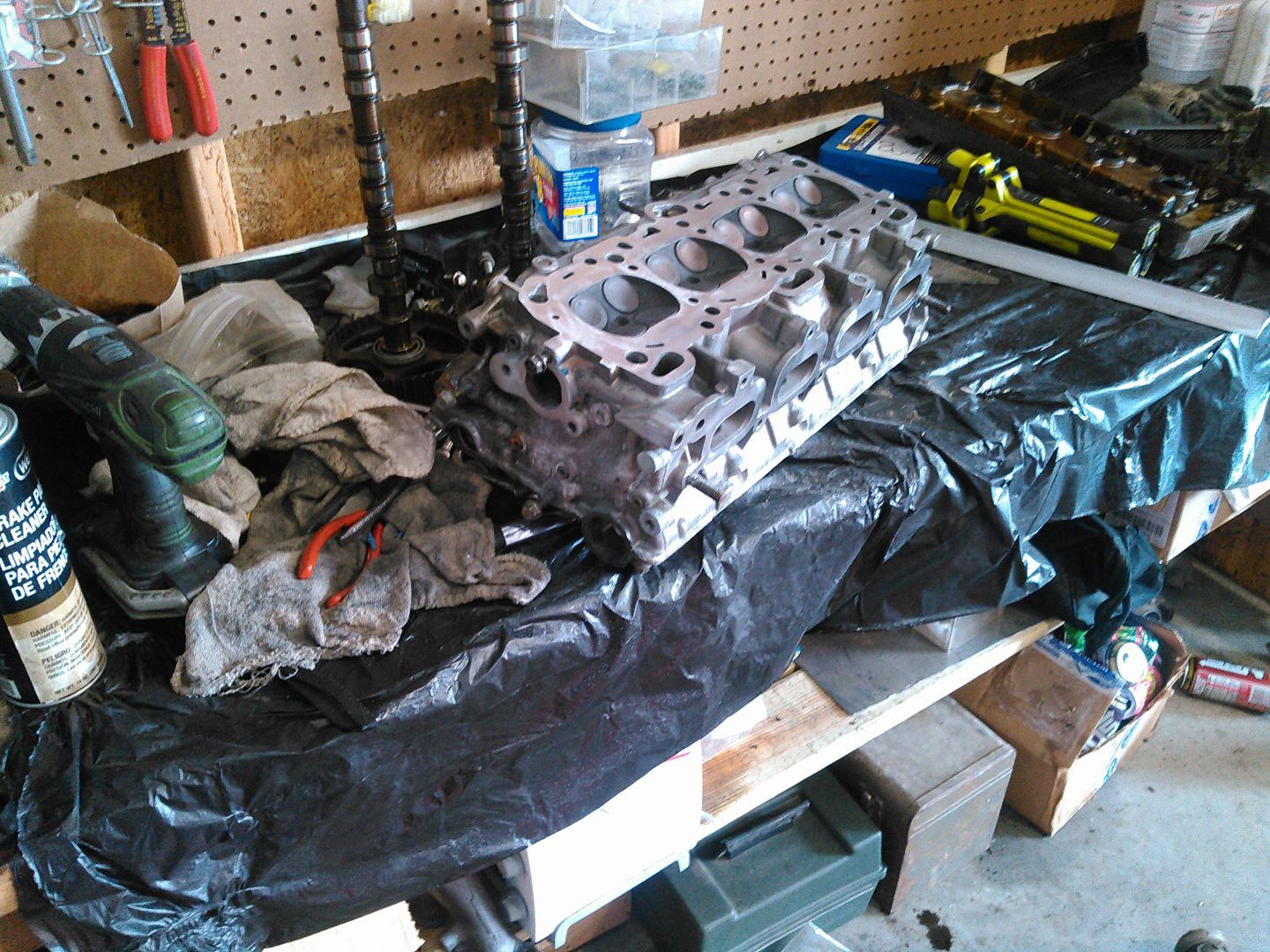

I've also been doing a headgasket Job for a fellow DSMer. Currently waiting to get a head back from the machine shop for it.

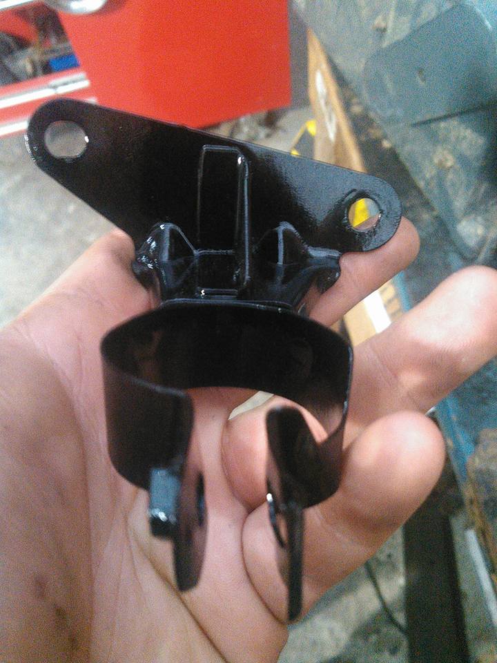

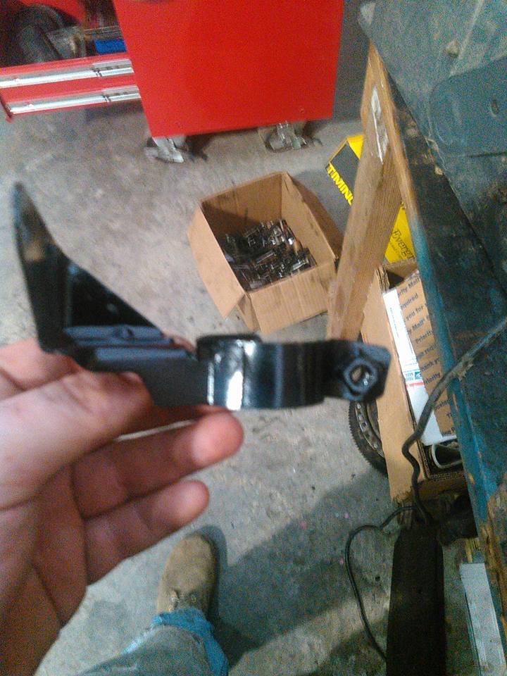

Painted my clutch resevoir bracket.

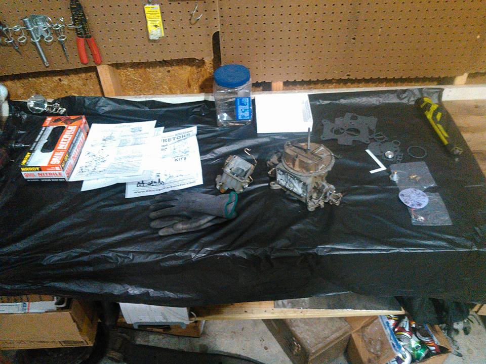

Surprising amount of money to be made fixing carburetors these days. Rebuilding this Holley from a 78 ford 302. We also did a CJ7 I6 carb. And several small engine carbs recently.

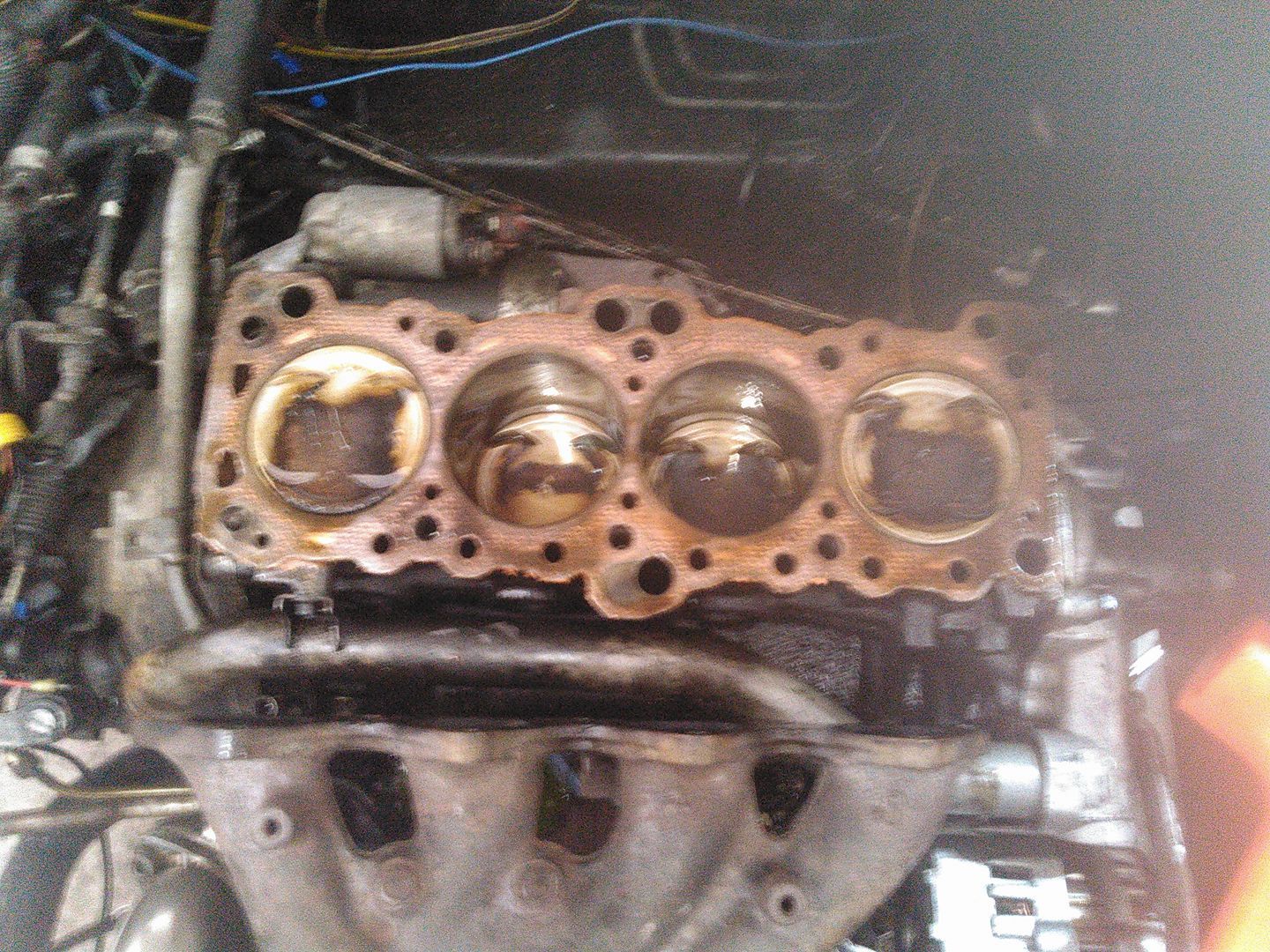

The 18 year old radiator is about to give out, so radiator will be next. I also found out cylinder 4 is quite a bit lower on compression than 3,2, and 1. So it looks like I will at least be replacing the almost 130k stock headgasket soon as well. Wet compression does not change, and cyl 4 is leaking down to cyl 1. So the mystery of my misfire may have been finally solved. Still these engines are beastly. We've put 13k on that engine this year since I got it from miller imports. Pretty sure the head gasket has been blown the whole time, and just now getting noticeable.

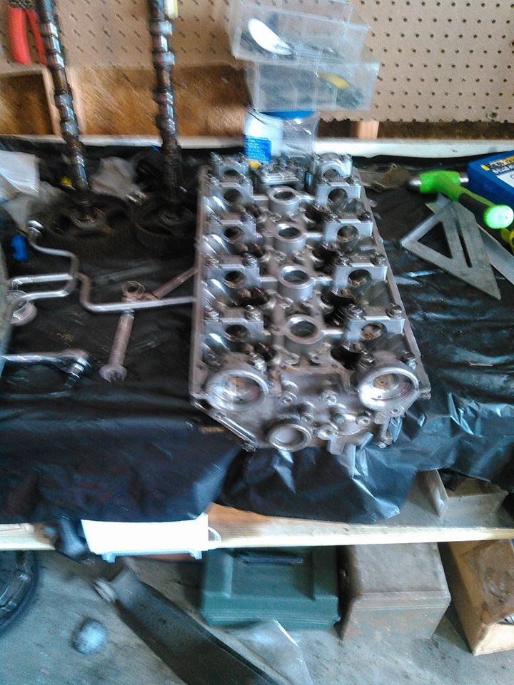

Well unfortunately the car is gonna need a new head. The one I have cracked, which pressurized the cooling system, and busted the 20 year old plastic tanks on the radiator.
So the car will be getting a new head, this time with cams and upgraded springs/retainers.

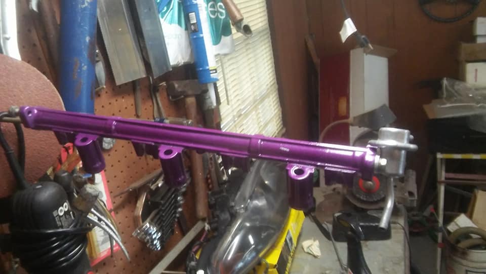

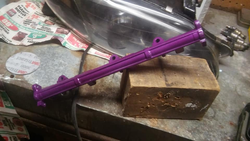

Paint Fuel rail.

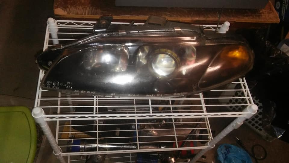

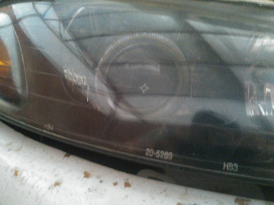

Polish and Clear Headlights

Paint Brake Res Bracket

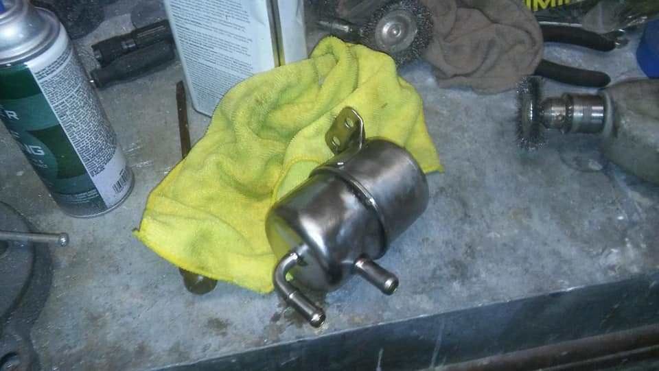

Delete the clutch fluid accumulator, replace with braided SS line.

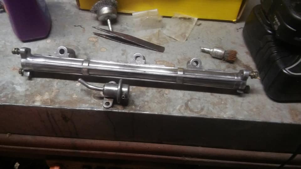

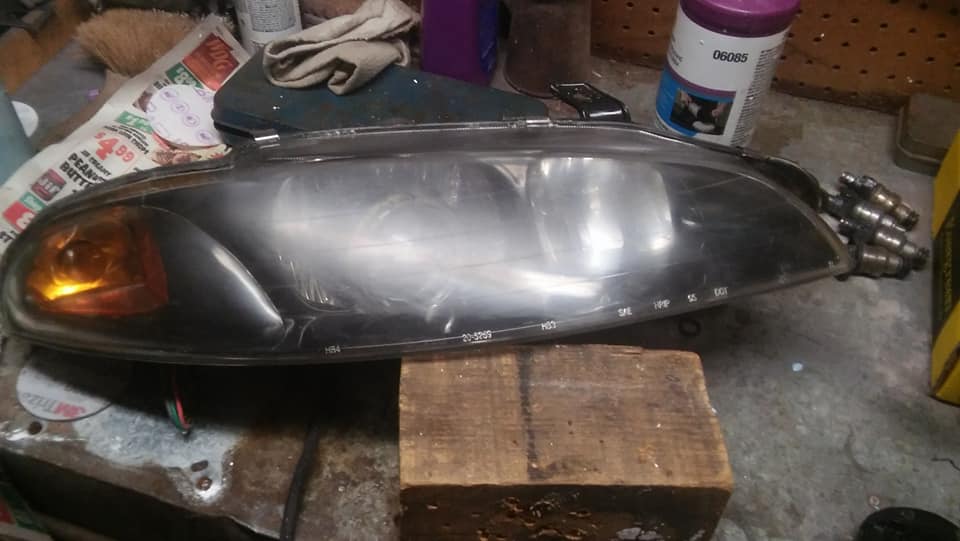

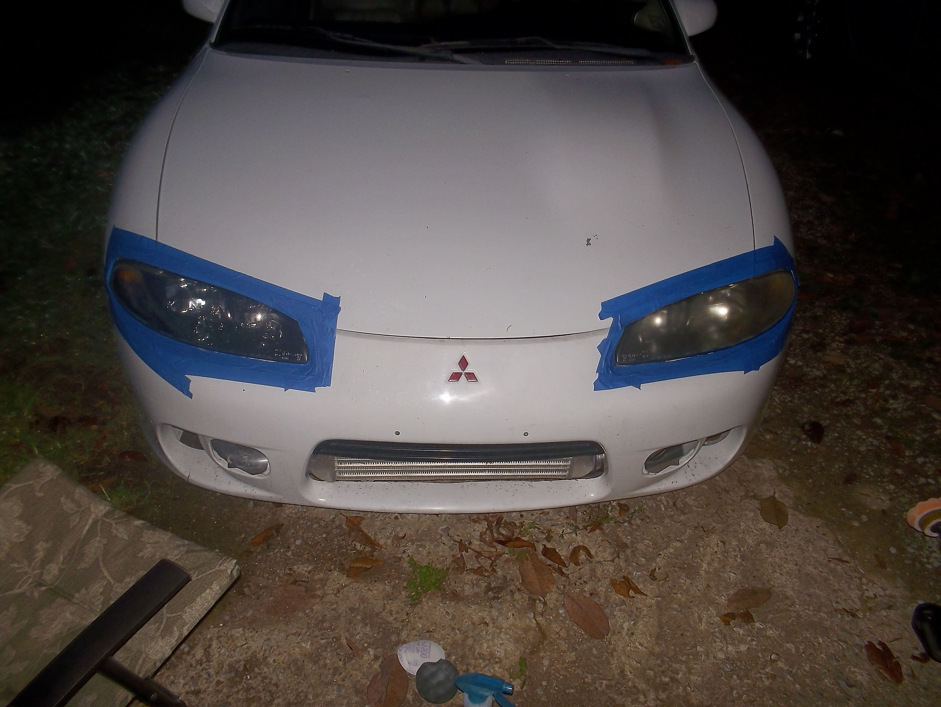

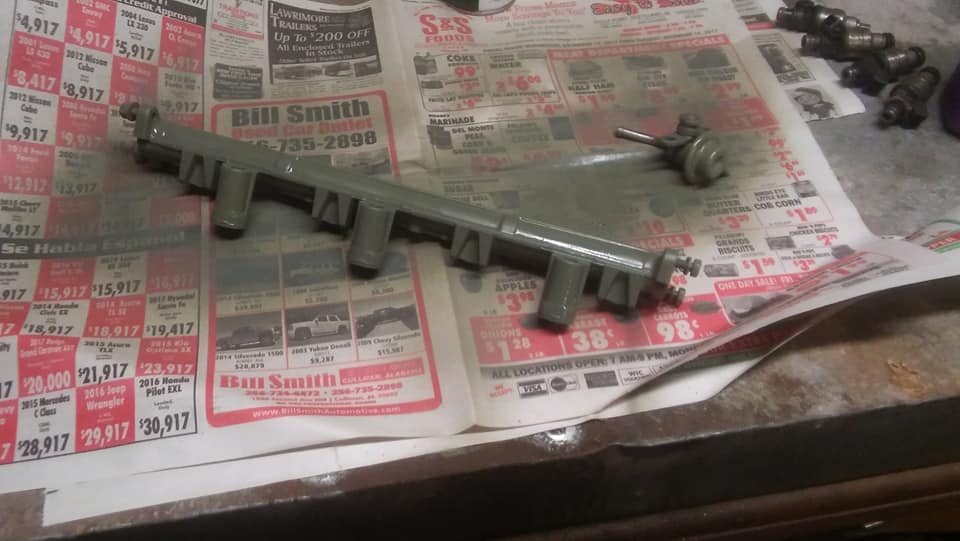

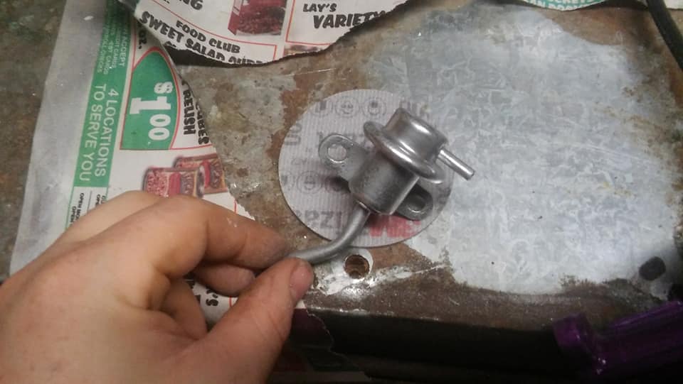

Little bit of progress. Got the fuel rail and regulator painted. Started working on polishing up the headlights again, and clearing them. Hopefully the clear lasts a bit longer. Tired of polishing them every couple months.
Metal cast paint didn't turn out like it supposed to. To cold I guess. But it doesn't look terrible. Just doesn't give that anodized look its supposed to.
Waiting for clear to dry on this one so it can be sanded and buffed.
This one has been polished once, had a bunch of scratches still so I sanding it again to 3000. Gonna polish it again then hit it with clear.

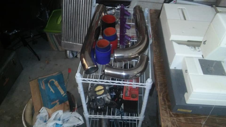

Intercooler pipes polished back up, couplers cleaned.

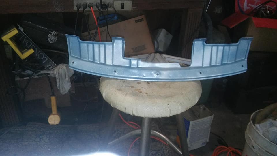

Hit the bumper support with some nickel paint, and then dusted on the blue. Pic sucks, it just looks blue. But this thing had a lot of surface rust on it, some mild pitting. But it looks way better now.
Stripping and removing rust spots from PS resevoir. Hit it with the nickel colored paint, and the cap got antique bronze paint. Will get a pic of that soon.

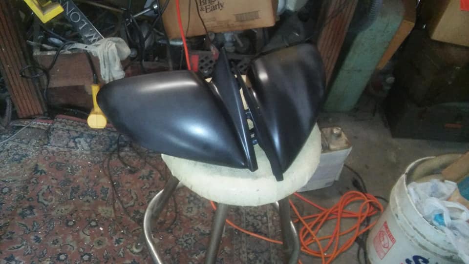

Side mirrors turned out pretty terrible. I think it was too humid when I layed the clear on. Gonna try the sand and polish before I just sand them back to base coat and hit them with clear again.
Was able to get the tiger stripes out of them. Still working on getting the spots out of the clear. But they are looking pretty good now. Will get some pics of them once I am finished polishing them.

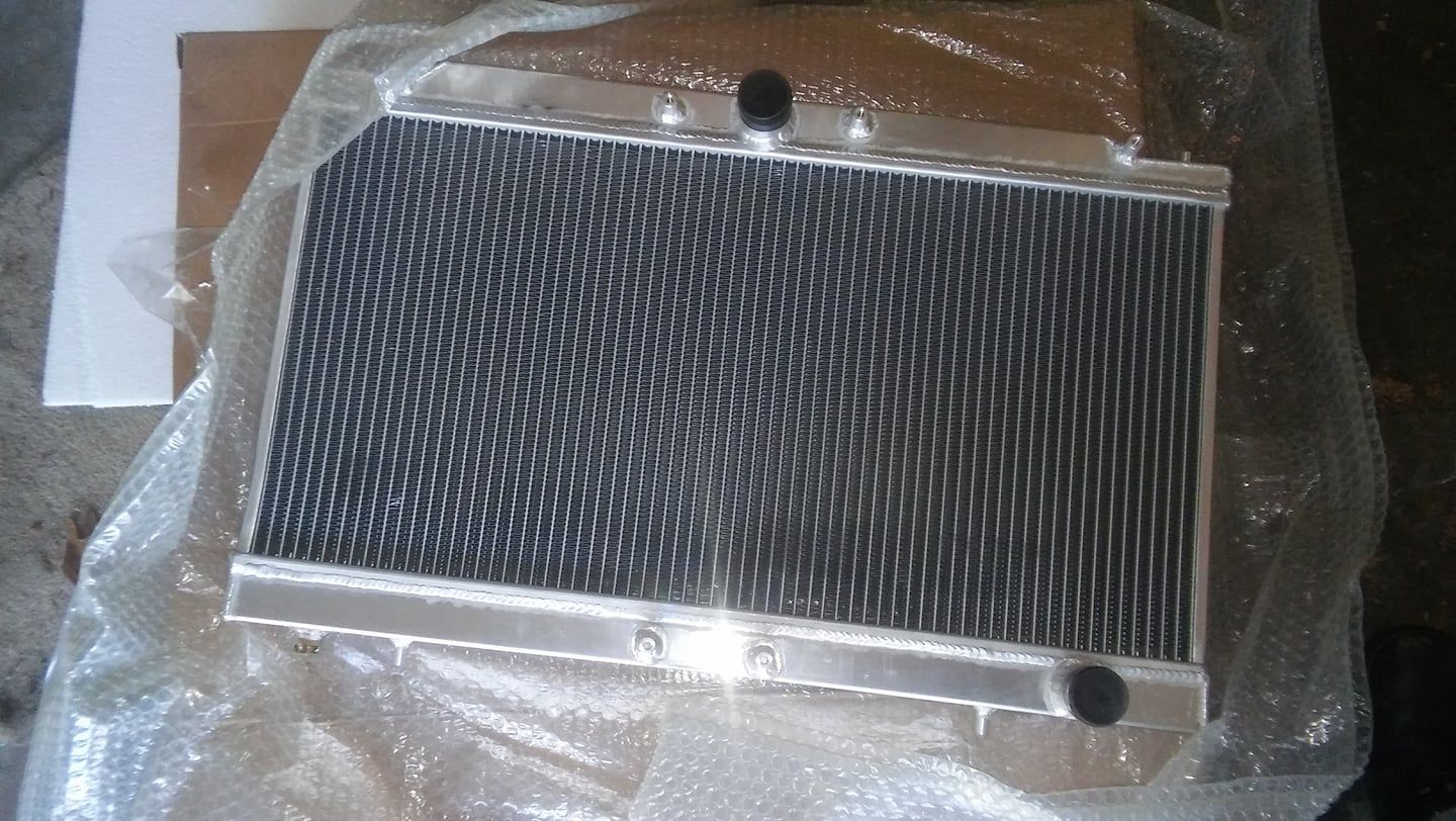

Got my 97$ radiator in today. No gripes on fitment, quality is comparable to mishimoto for much less. (Fitment, Finish quality on polished surfaces, and fin density)

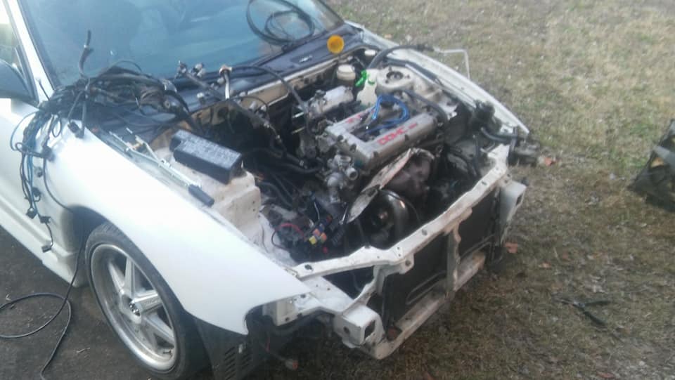

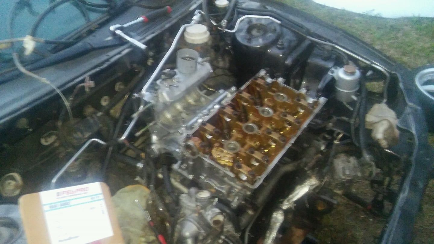

Also got my head back on. car should be going back together in the next week since I am gonna have to put a trans in my truck. At least I did manage to strip the rust in my engine bay, and get it touched up. As well as painting some stuff that needed painted.

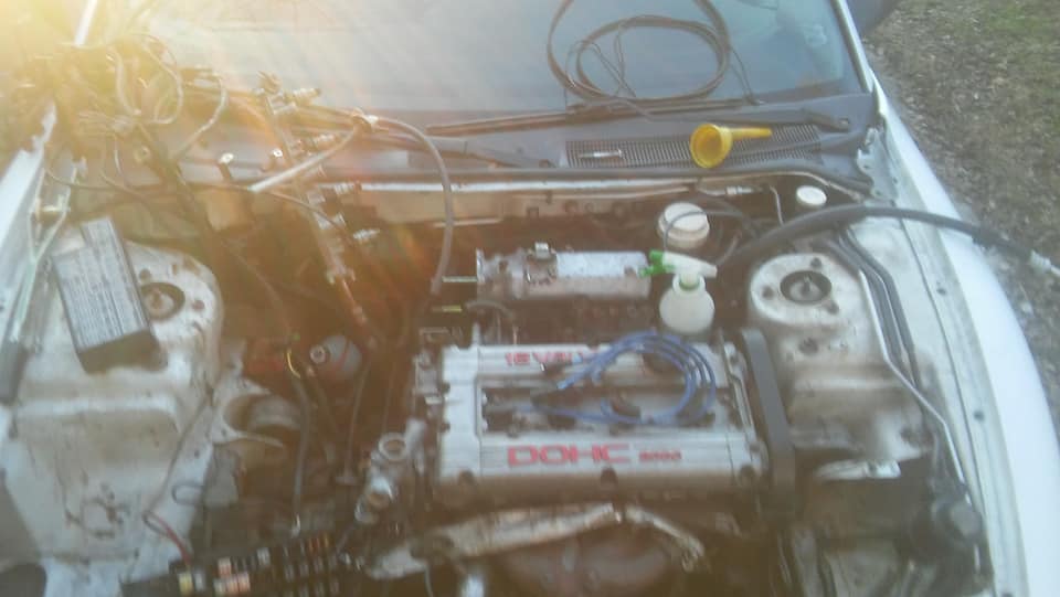

Yep engine bay is a bit of a charcoal metallic color now. Looks so much better than the dirty and faded white with rust and battery acid accents.

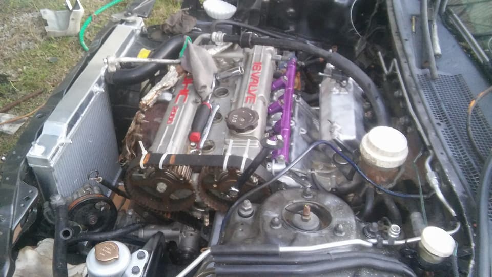

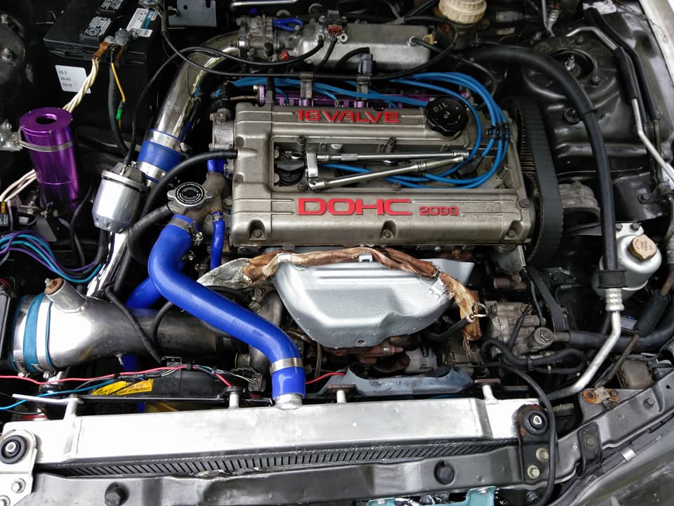

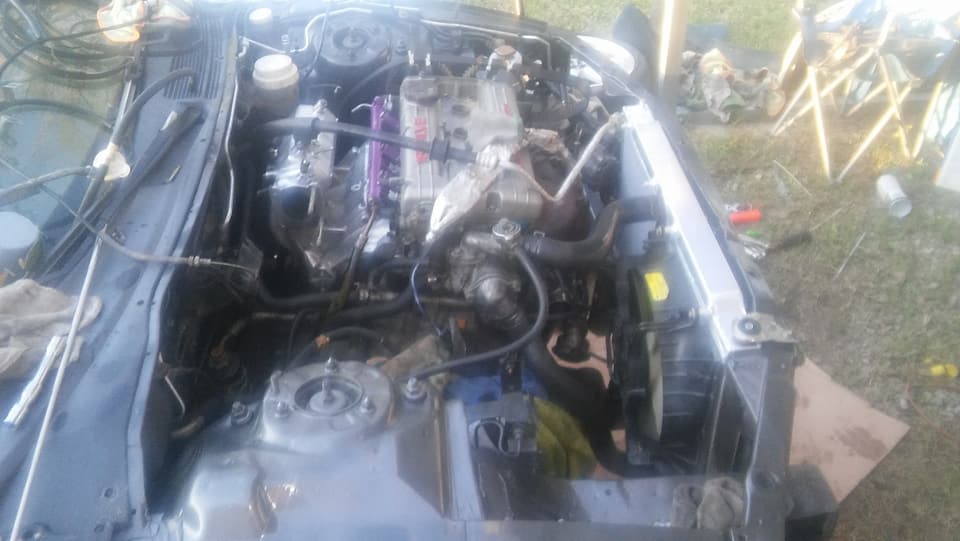

Cams, Lifters, Rollers in, valve cover installed, t-stat housing installed, radiator installed. Turbo installed, downpipe/o2 housing hooked back up. Engine put into time.
Also got the p/s pump hooked back up and ac lines hooked back up. Coilpack installed, and plug wires put back on. Fuel lines hooked back up. Its getting closer. I still need to remount the FMIC, installed the charge pipes and throttlebody. As well as replace the timing covers, water pump pullies, a/c tensioner, power steering pump bracket, p/s pump. and the 3 belts. (it got to late to take another picture)

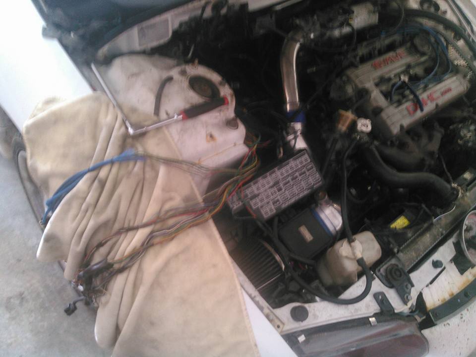

Finally figured out my misfire issue. Cut out the wiring for both the coils, and ptu and redid it all.

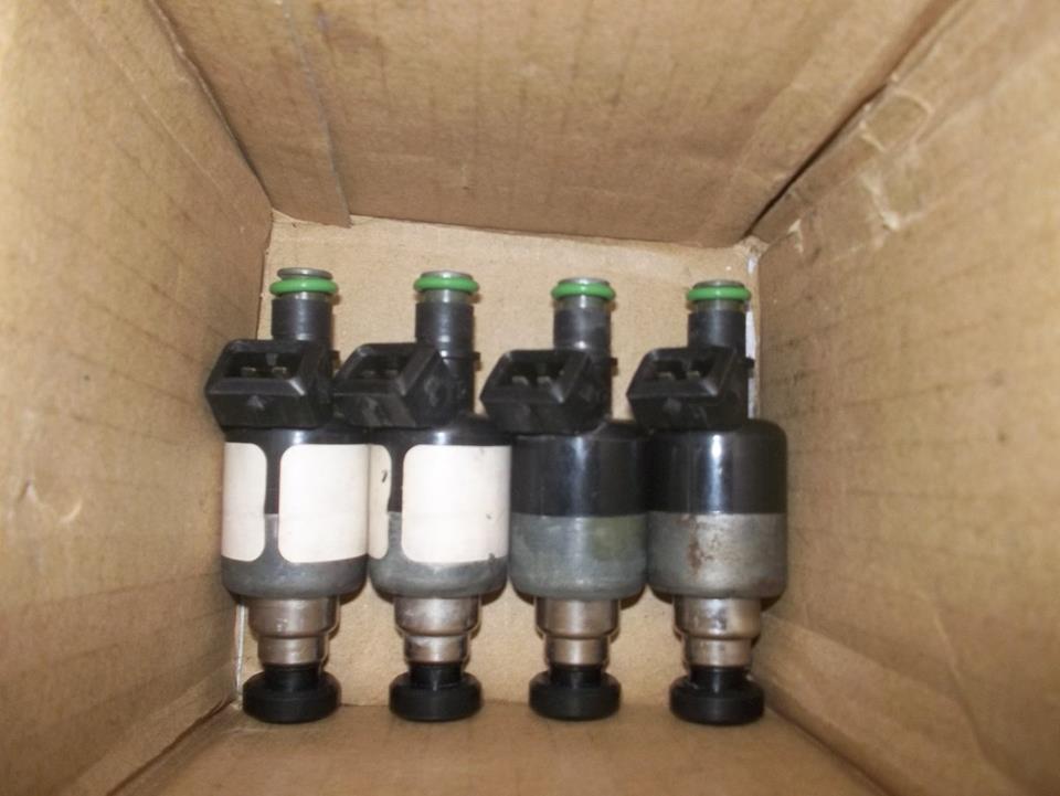

Thing actually runs as it should now. So on to body work while I wait on my wideband. Have a set of PTE 680cc ready to go in once I have that and make sure I don't have any exhaust leaks. Not sure if I wanna get a heat sink and run in it off the o2 housing, or run it further downstream.

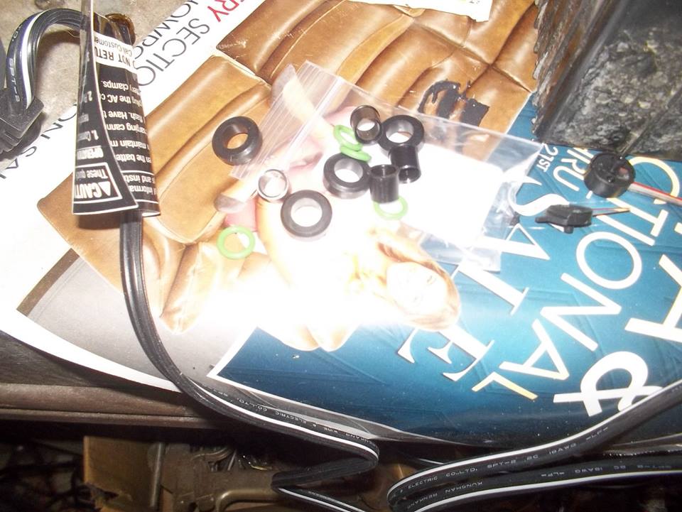

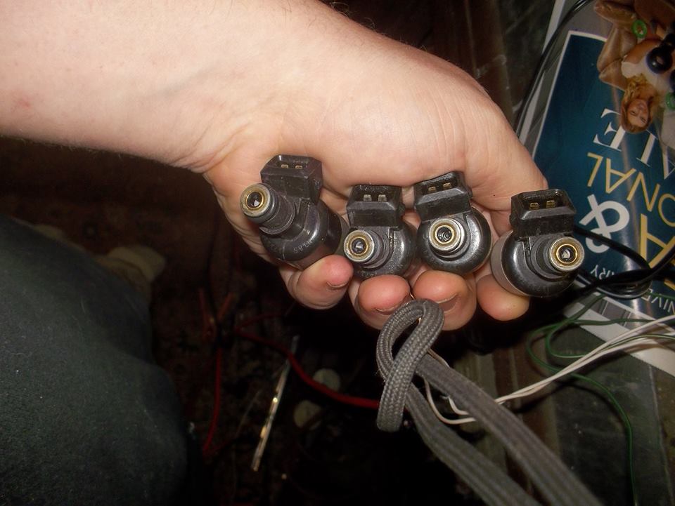

New Basket Filters, Have so many extra of these I just do them if I have the injectors out.

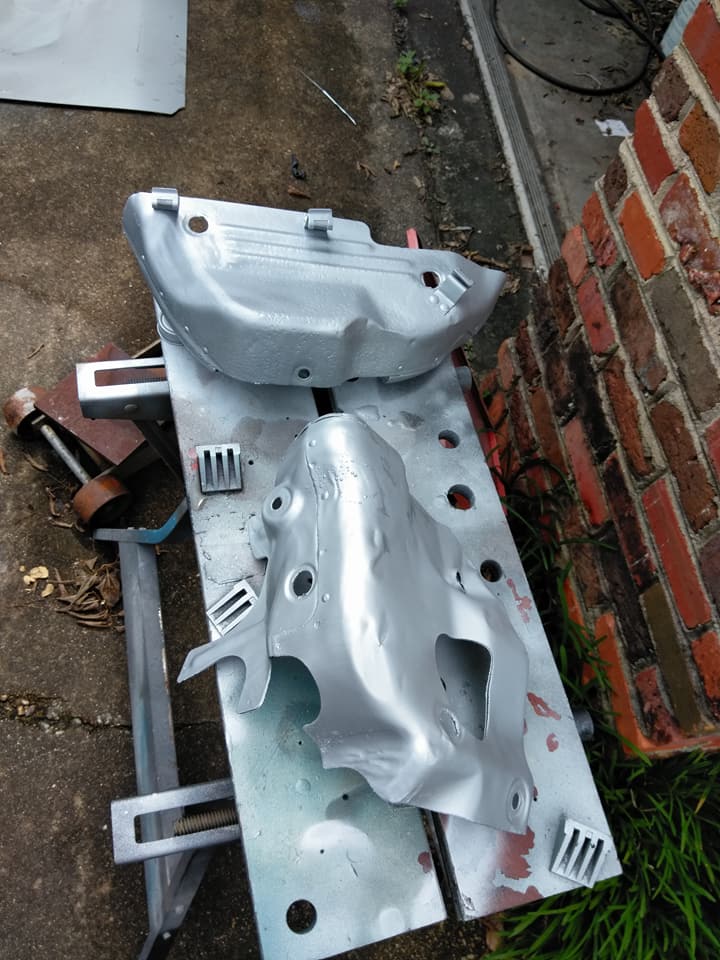

Finally sourced some stock Heatshields. Painted them with VHT header paint (aluminum color)

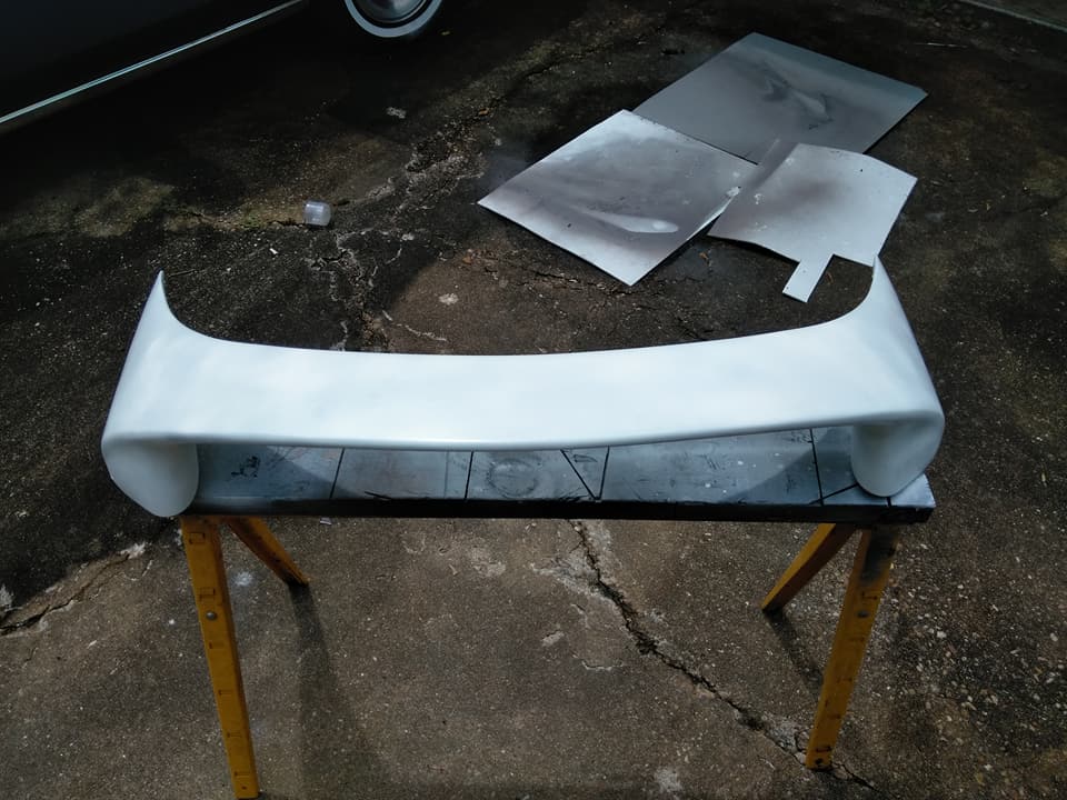

Painting my wing.

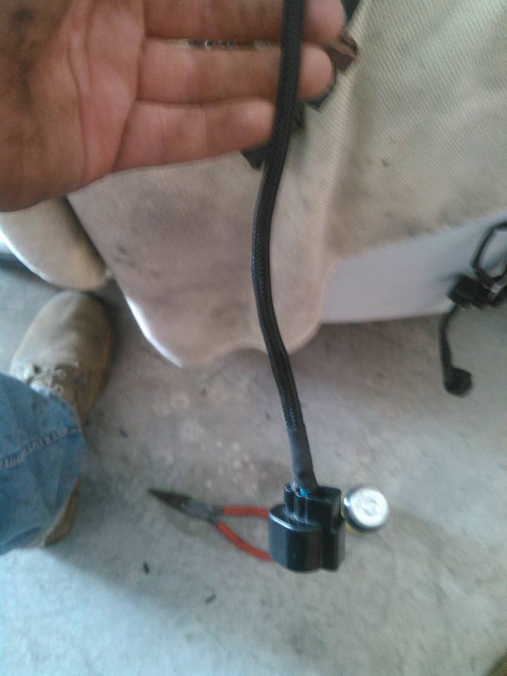

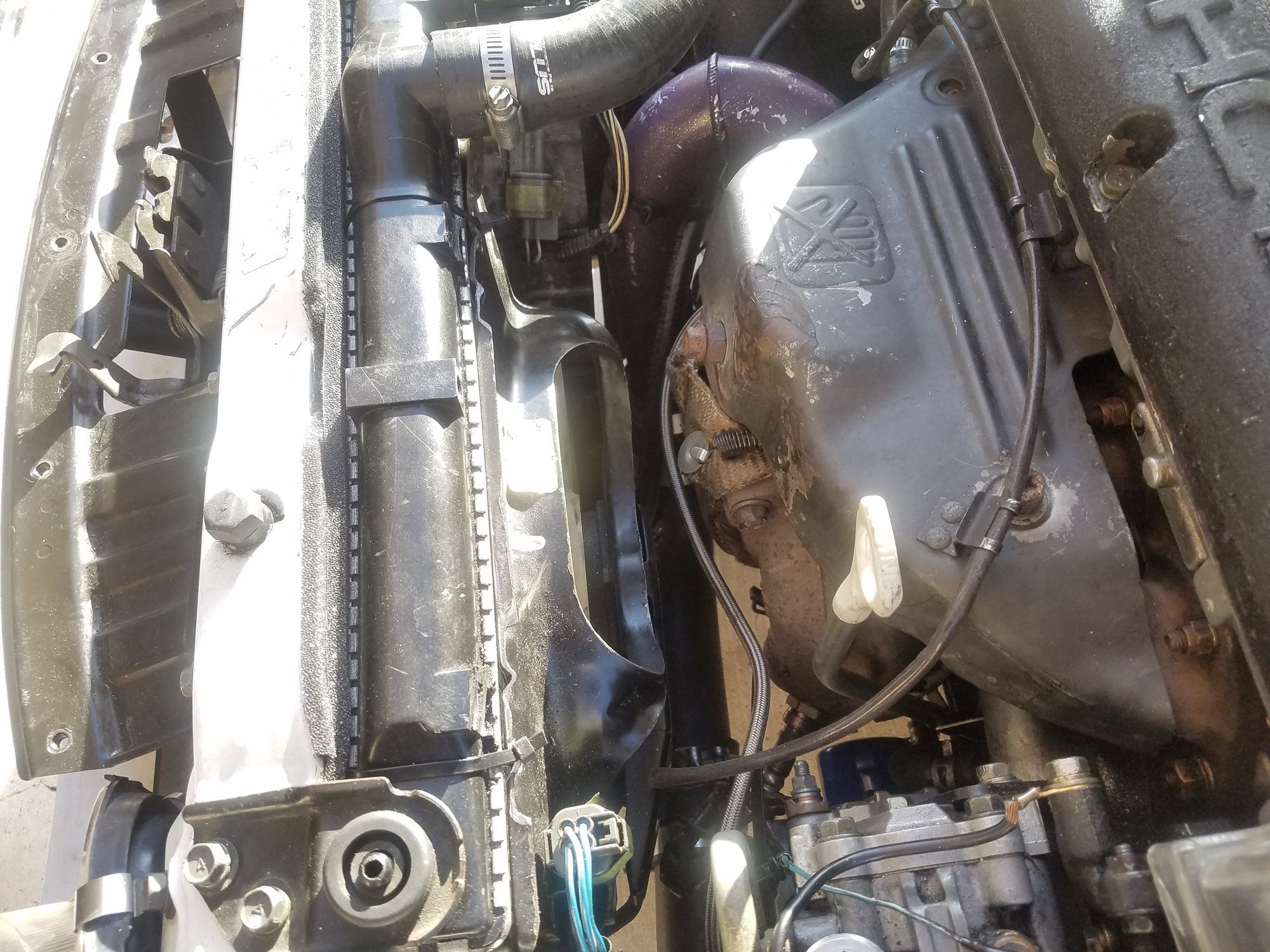

Still need to clean up the wiring for my fans, and find a new heat shield sleeve for the o2 sensor wires. I had this giant one I borrowed off GM power steering line. But I think a spark plug wire sleeve would fit better and not look as stupid.
There is no factory heat shield sleeve, it's just the oxygen sensor covering stuff that comes on them. The little arms that hold the wire cover don't get hot enough to melt it.
Your radiator fans don't fit that radiator, there is too much air gap now. The fan is not able to suck the air through the radiator to cool the coolant. Easiest solution is to cut the tabs off the fan shrowd and use the radiator pull through ties to mount through the radiator core to the fan
1) The o2 sensor wires have a heat shield on them unless you bought a cheapo or one of the cut/splice ones. That rubber stuff is just rubber on the cheap ones. The one that was on there before it started detriorating was 3 layer stuff fabric/metal/fabric.
2) the fans work fine. Ideal? No. Gonna work until I find a shrouded fan that fits the radiator or give and buy a shrouded fal? Sure does. Car holds 200-205 even sitting in stop/go traffic now. Works way better than slim fans.
Lol. No they didnt
Glad you're happy with it. The fans and wiring under your hood seem to show off your attention to detail
Lol. No they didnt
Alright, tuesday Ima go to work and start pulling o2 sensors out of boxes. I betcha the most, if not all of the exact fits on the shelf have a heat braided heat shield sleeve on them. I only sell a half dozen of them a week, on average. But whatever.
If it looks stupid and it works, its not stupid. Aside from that, you took an angle grinder to your fan then ziptied it on. At least I know I'm calling the kettle black.
Get back to me when you learn why you might want to spend more 18 cents on a timing belt kit.
Meanwhile Ima keep selling and installing my Bosch and NTK sensors with mysterious, just for cosmetic reasons sleeving on the wires.
By the way, those free fans, are still working just fine. Must be some mysterious force helping them deal with this Alabama Summer. But I guess just everything's hotter in texas. Probably wouldn't work to well in texas.

Swapped in my Injectors, got the scaling and latency dialed in. Added some tip-in, and then purchased Ceddy Mods SD/Big Maps. So I will be getting my ve dialed then going to SD.
