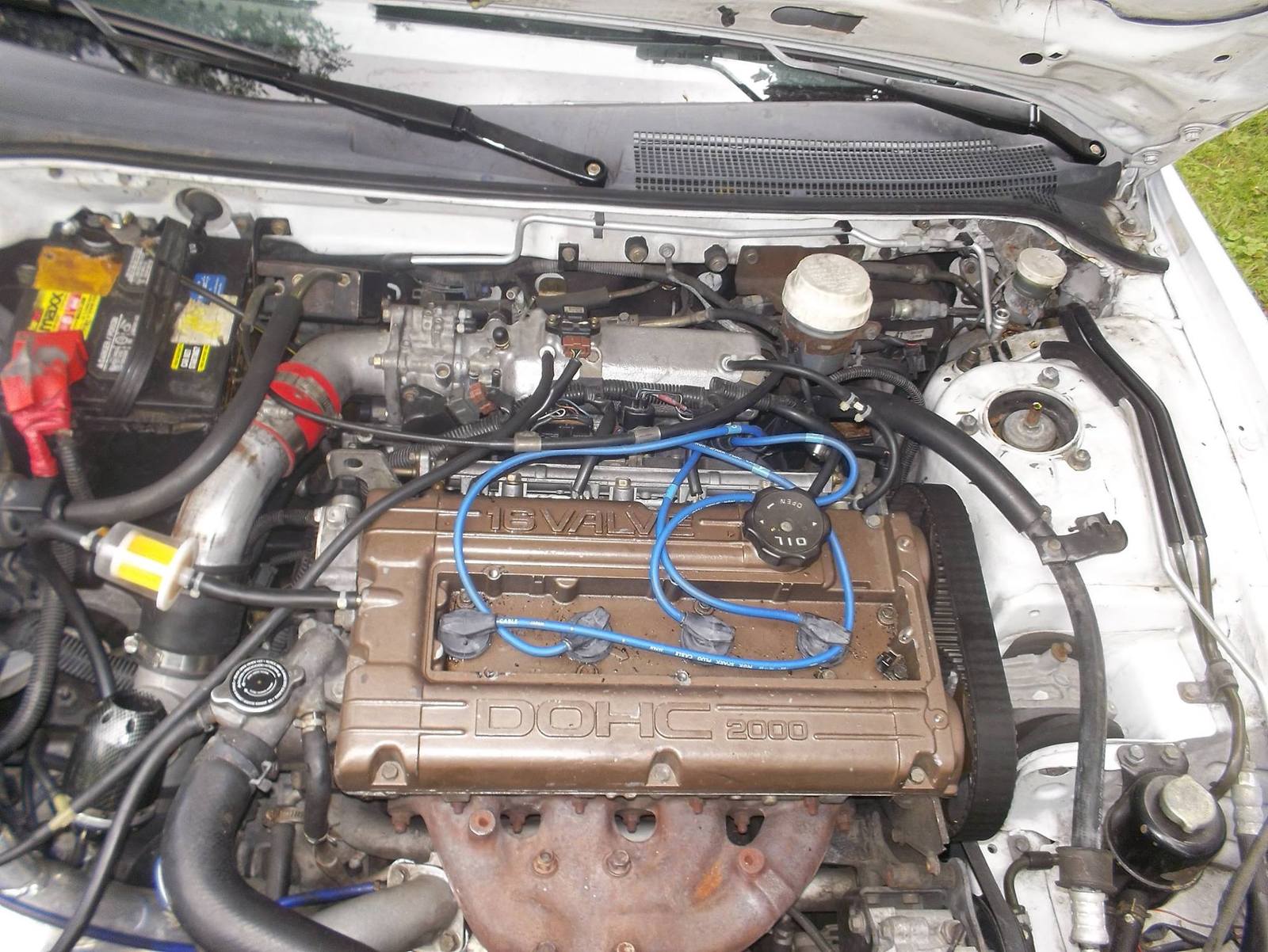

So the first week I owned the car, I had some work ahead of me. Car has a hacked together upper intercooler pipe, consisting of a 2g elbow, and 3 sections of pipe held together with a mix of cheap ass silicon couplers, and even shittier rubber home and garden couplers from lowe's. It also has a fake HKS SSQV.
I plan on ditching this stuff asap, but for now it remains. I did get some NGK bpr6es plugs @ .026" in there, and a set of NGK plug wires, as well as a pocket obd II logger dongle.
Also got the emissions stuff out of the engine bay, and the vacuum lines cleaned up, eliminating some boost leaks.

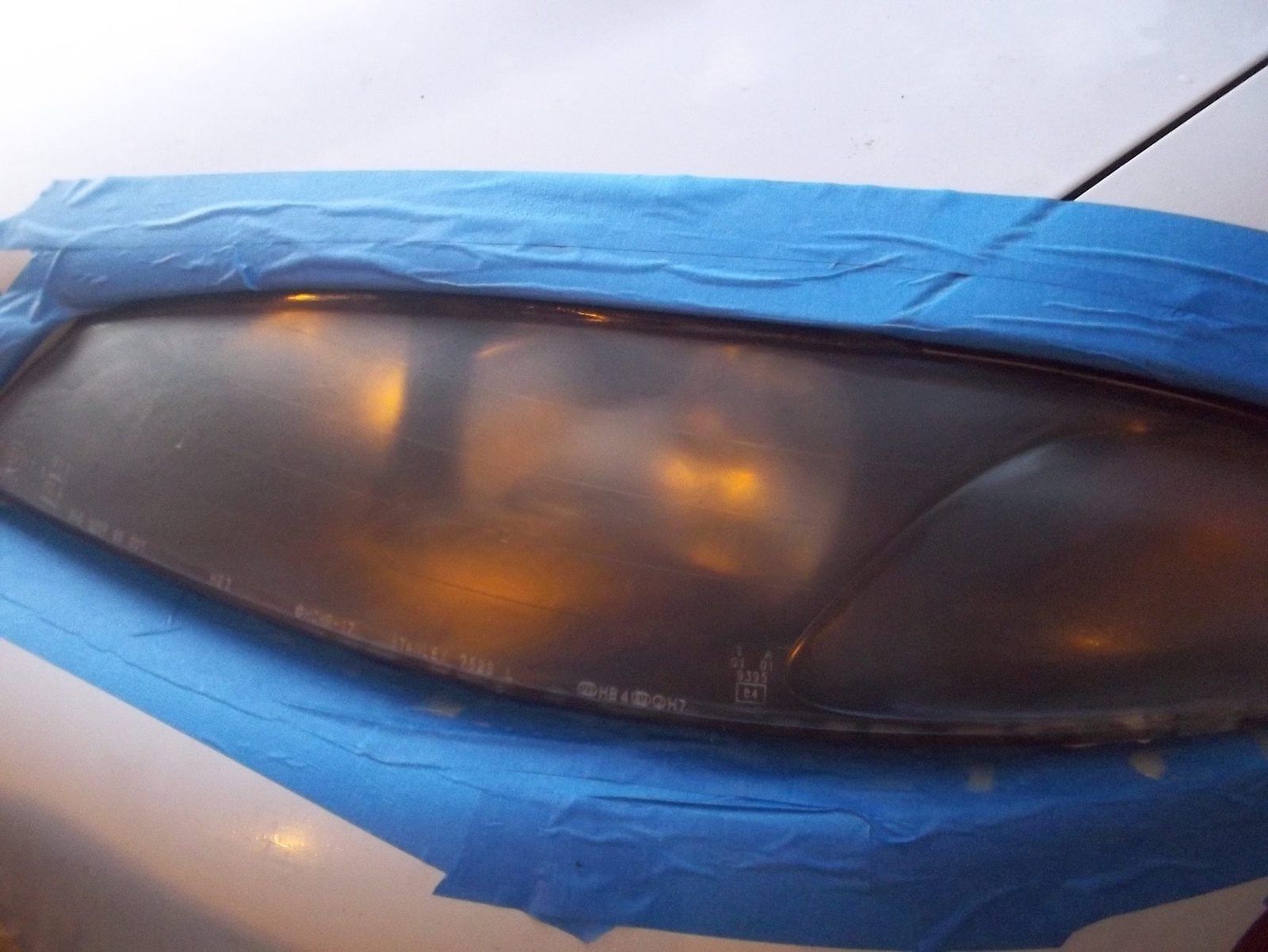

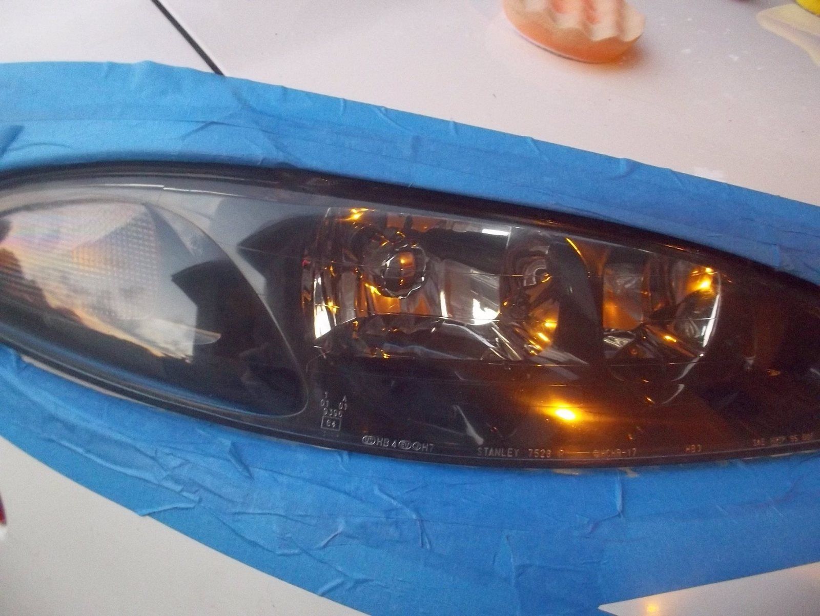

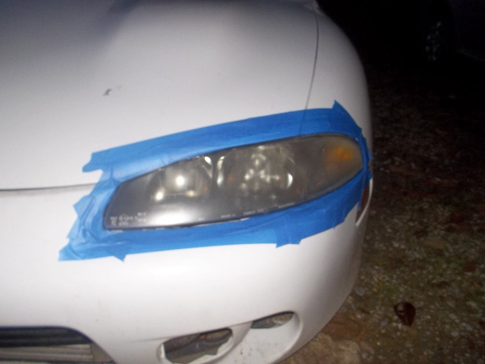

When Bought Both My headlights looked like shit.
Fixing that crap
And After
I just used some 1000,1500, and 3000 grit, and a 3" polishing roloc for my drill. Then Switched to rubbing compound on a 3m orange pad, then machine polish on a 3m black pad. Finished off with a hand rub with PlastX. The still look great some 4 months later.

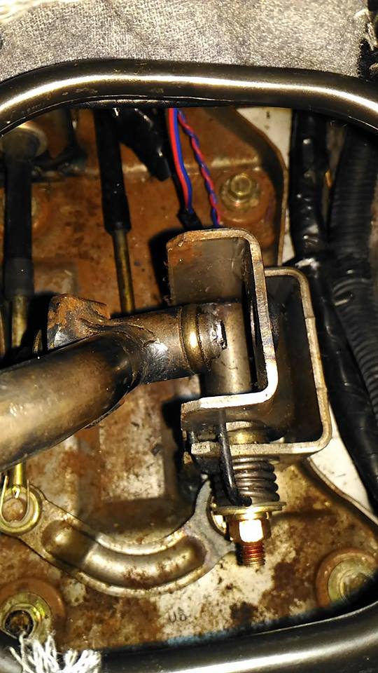

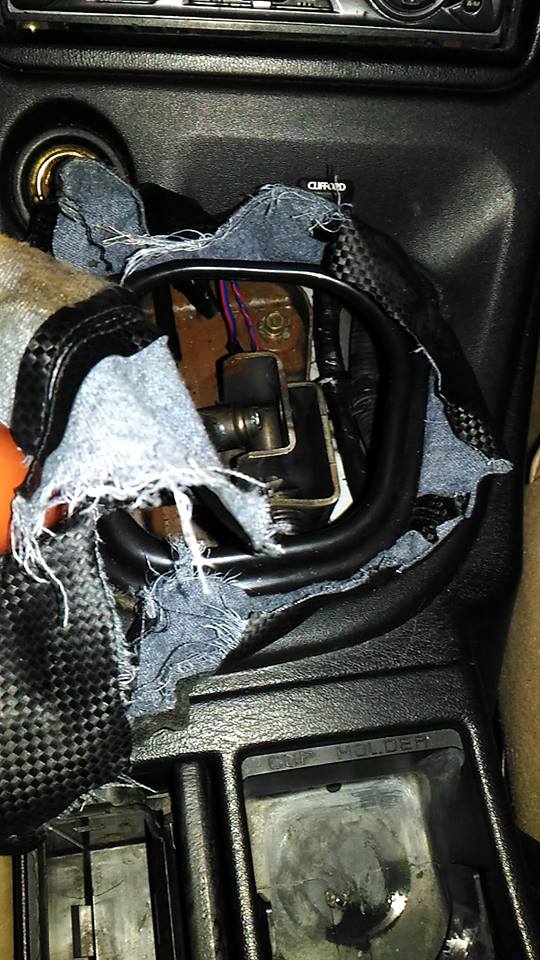

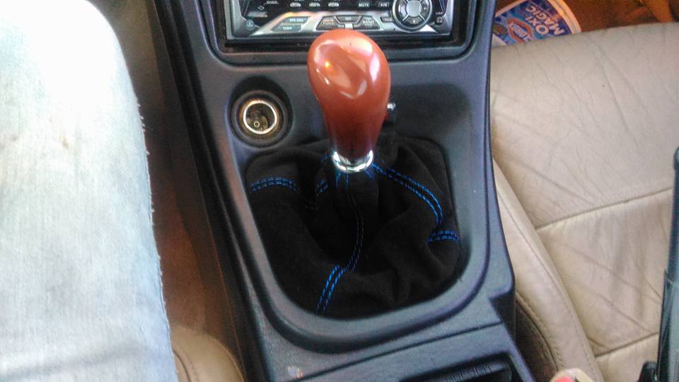

Then the Shifter Handle BROKE off. WTF. I ended up having to cut open the boot so I could pull the cables by hand to get my car to work, then home. Grabbed a cheapo boot off ebay. 3$ shift boot for a honda don't look too shabby.

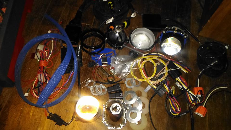

Box full of Parts I had in the closet for a projector retro in my MX-5 that never got started.

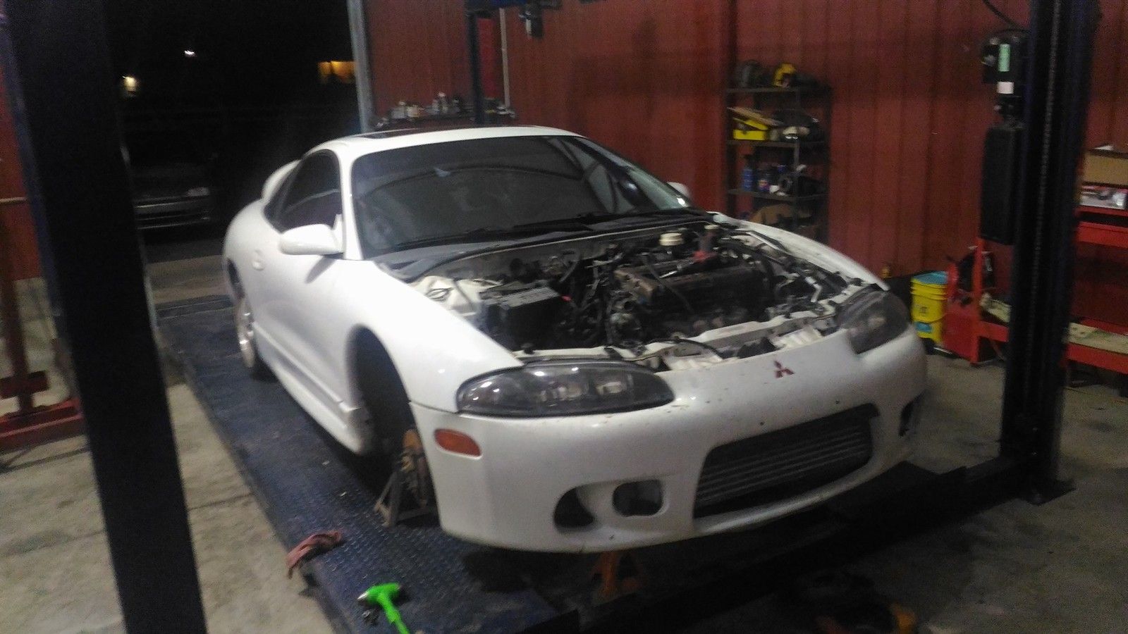

And the Miss-Bitchy on the ramp in my new shop.

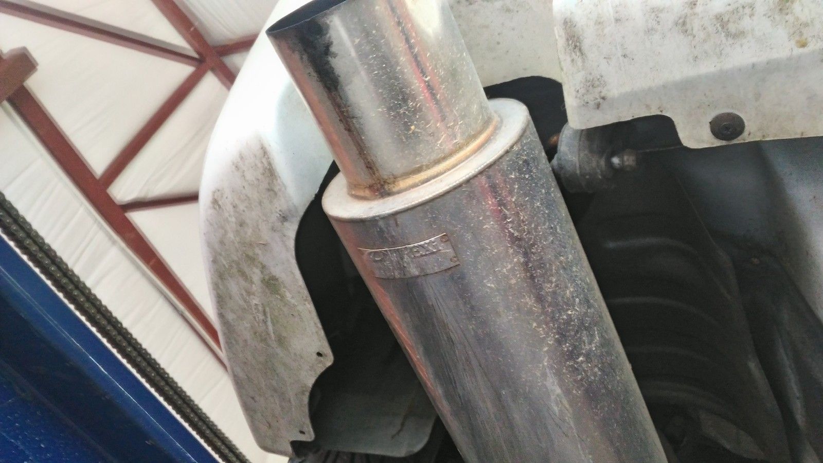

Found out it has a full Apex'I exhaust, downpipe and Catback.

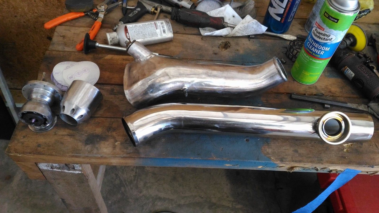

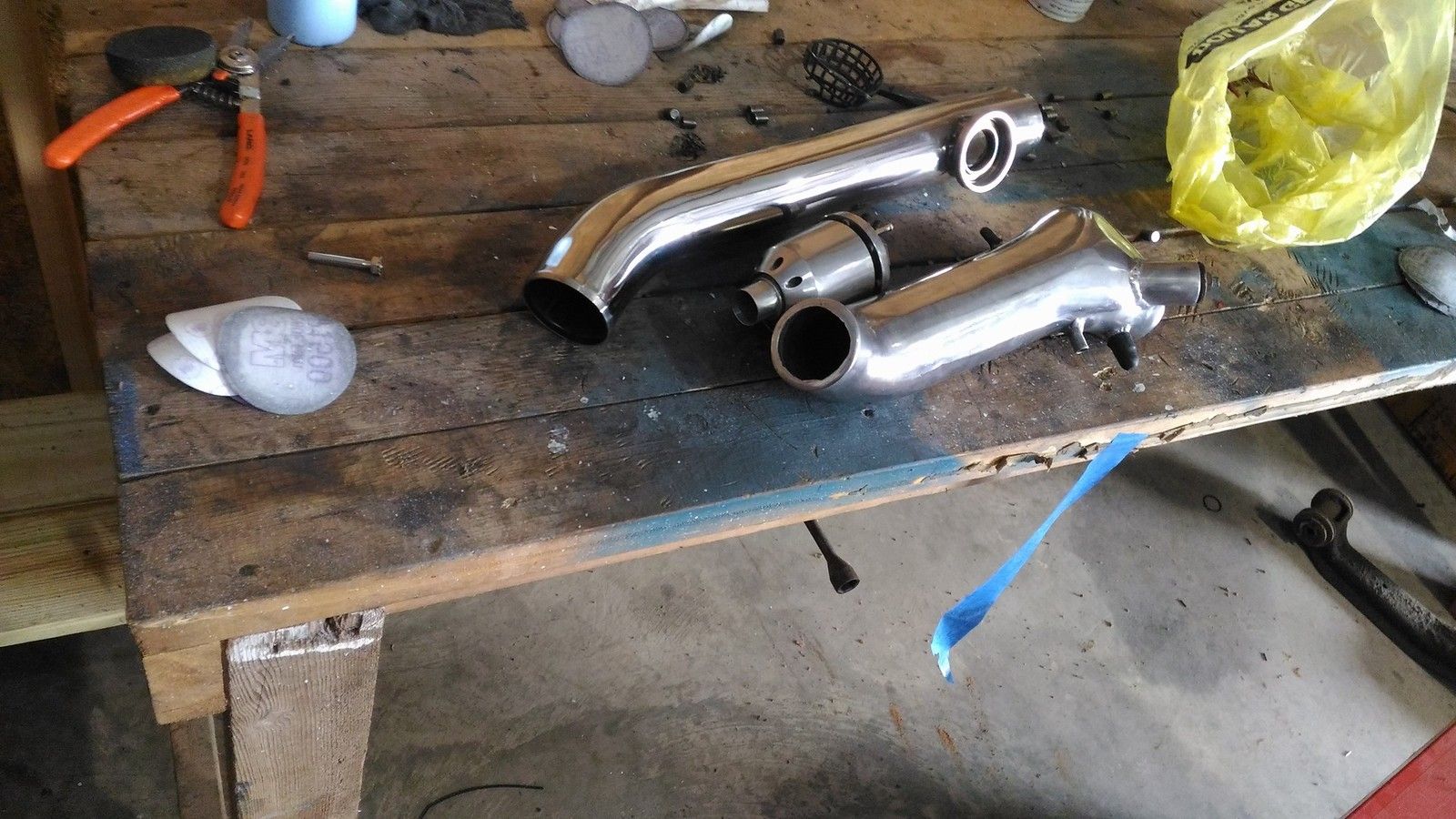

Took some 400 and 1000 grit to my intake pipe, UICP, and BOV. They were really nasty. So they are getting cleaned and polished.
Finished up. Just used machine polish on these. Wish I had something a bit stronger but for now they are clean and look much better if not quite diamond in the goat's ass status.

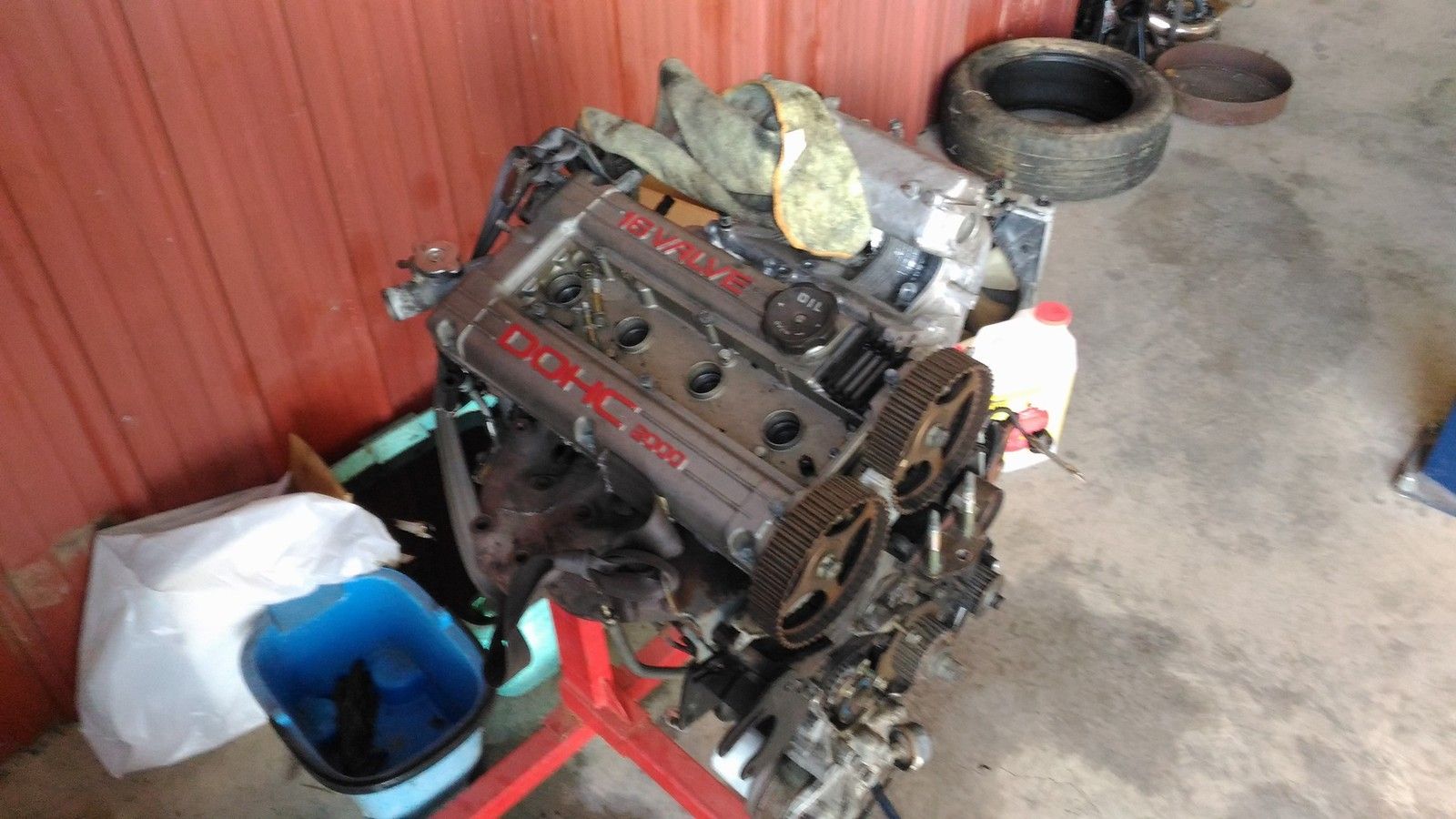

While I was polishing, and taking breaks to help my business partner reassemble a transmission, R&L Freight showed up with my engine from Millers. 1 day shipping from North Carolina with regular freight, I can't complain.

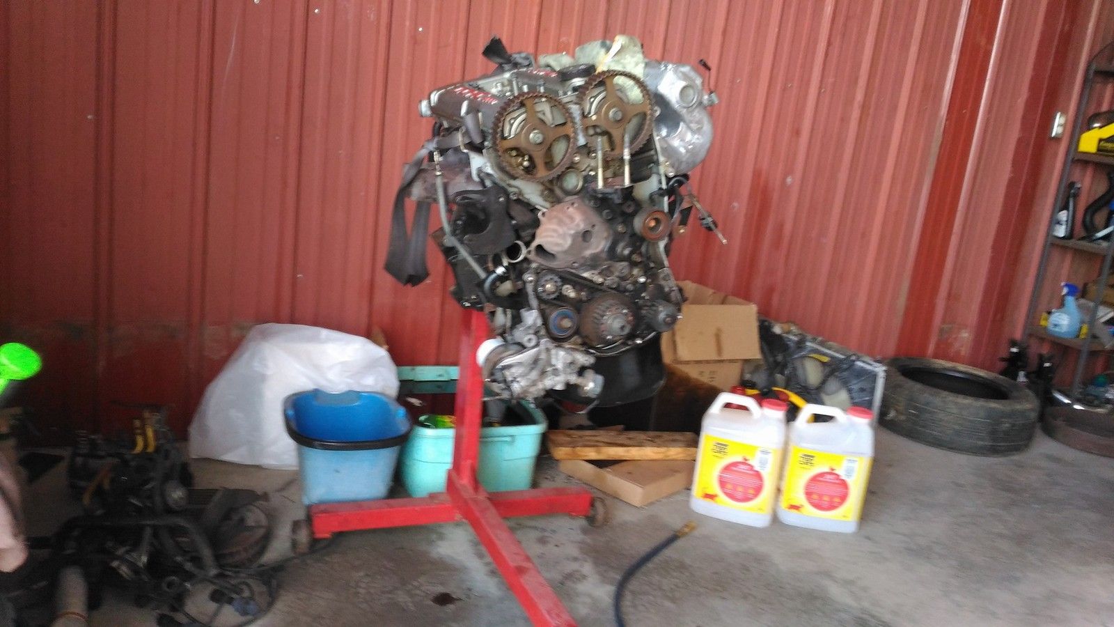

Got it unpack and on my stand, started getting it ready for new parts.

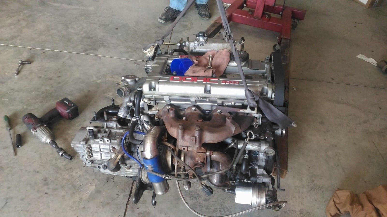

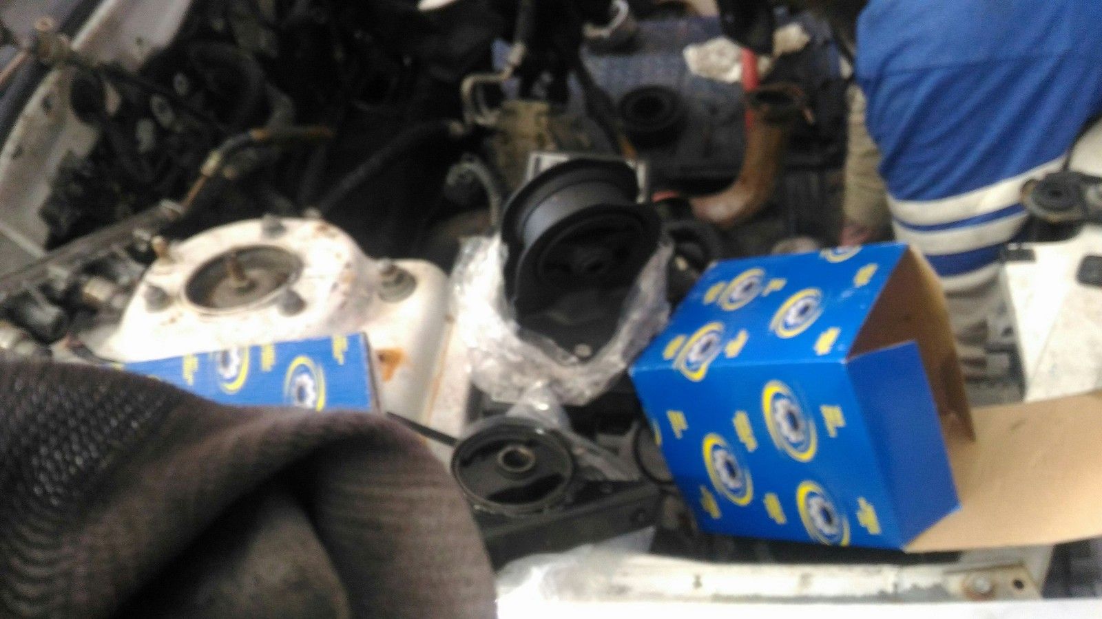

I will be transferring my ARP headstuds, ~1000 mile timing belt and timing pulleys, tensioner, and water pump from the old engine. As well as my 16g turbo, rebuilt throttle body, and o2 housing. So I am going to get all that stuff pulled off. As well as the extraneous vacuum lines and such.

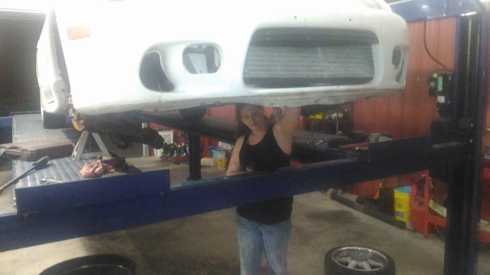

Well with the help of my lovely girlfriend we got the engine ready to come out. Made a huge mess when my oil drain overflowed. Gonna go snatch the engine out tomorrow

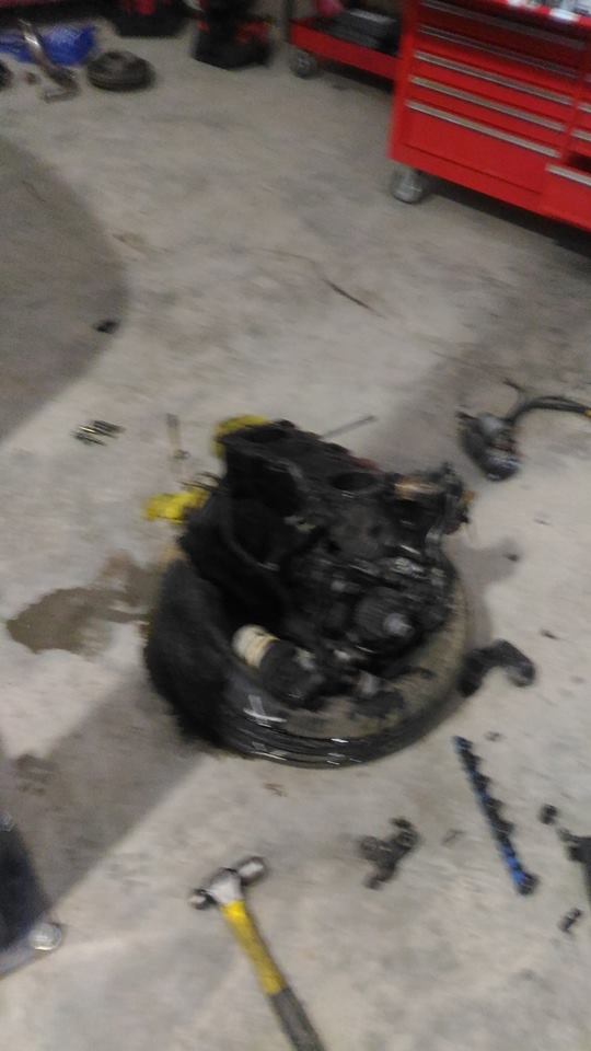

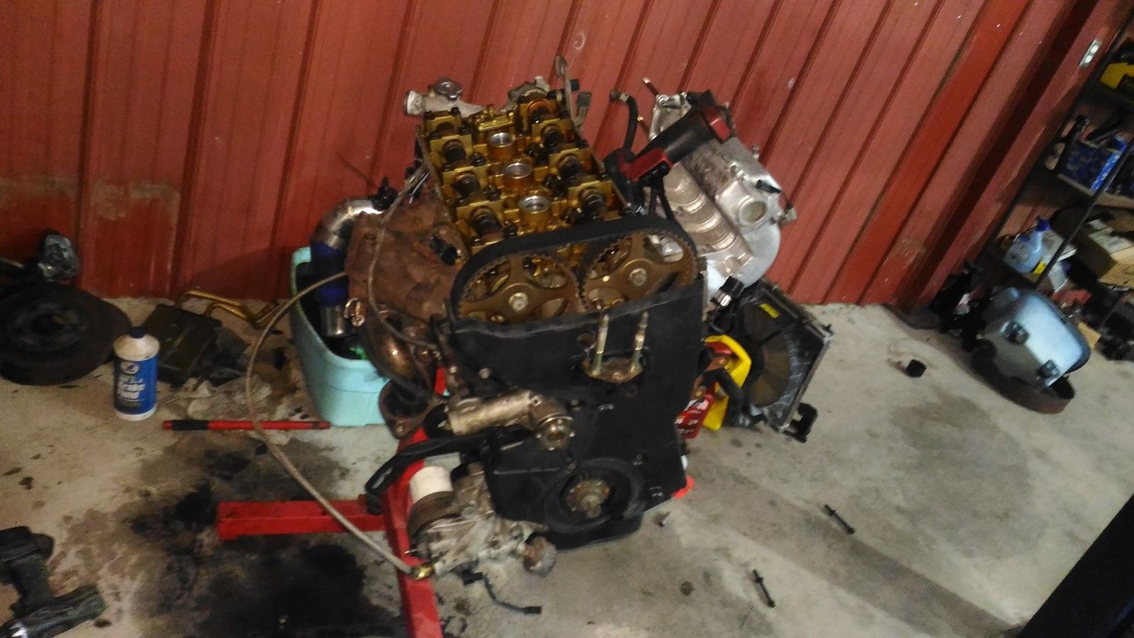

Got the bad engine stripped down. #4 is definently shot. You can move the rod up and down about about 2mm, maybe 3mm.

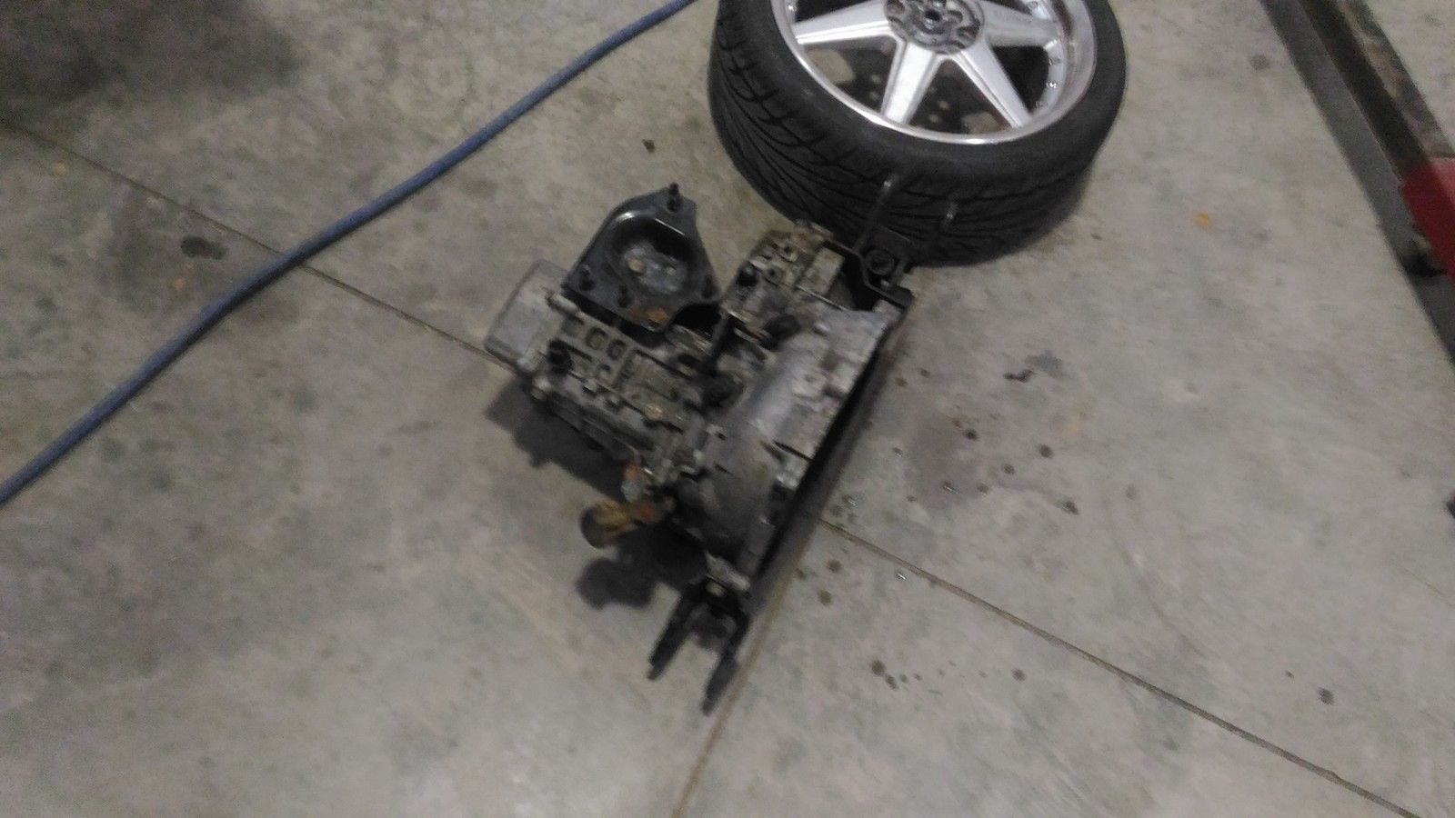

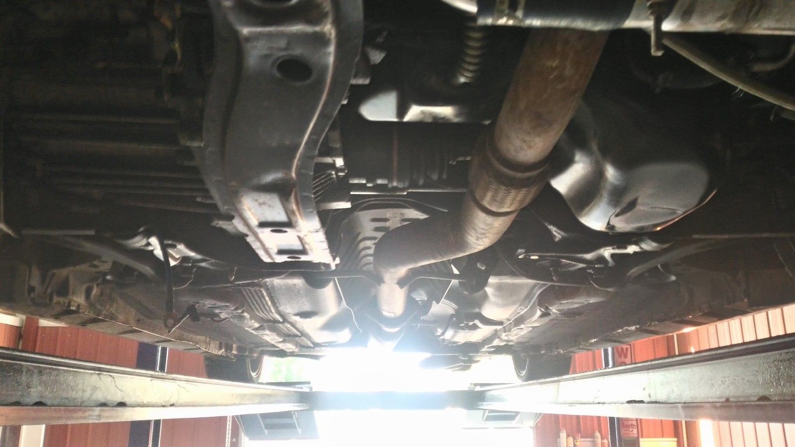

Pressure washed my trans. Looks decent. I think I may take some aluminum brightener to it tomorrow then wash it some more.

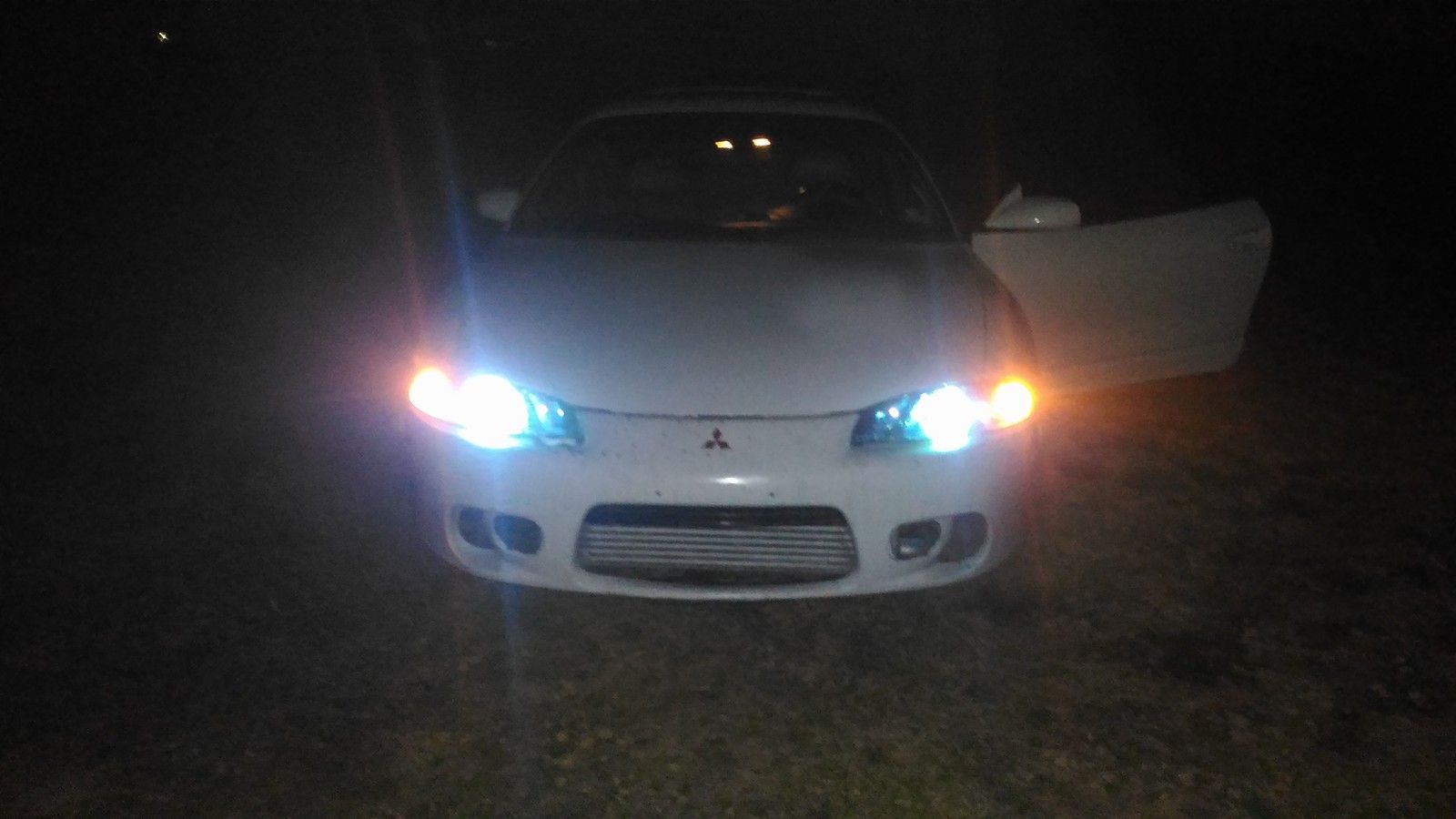

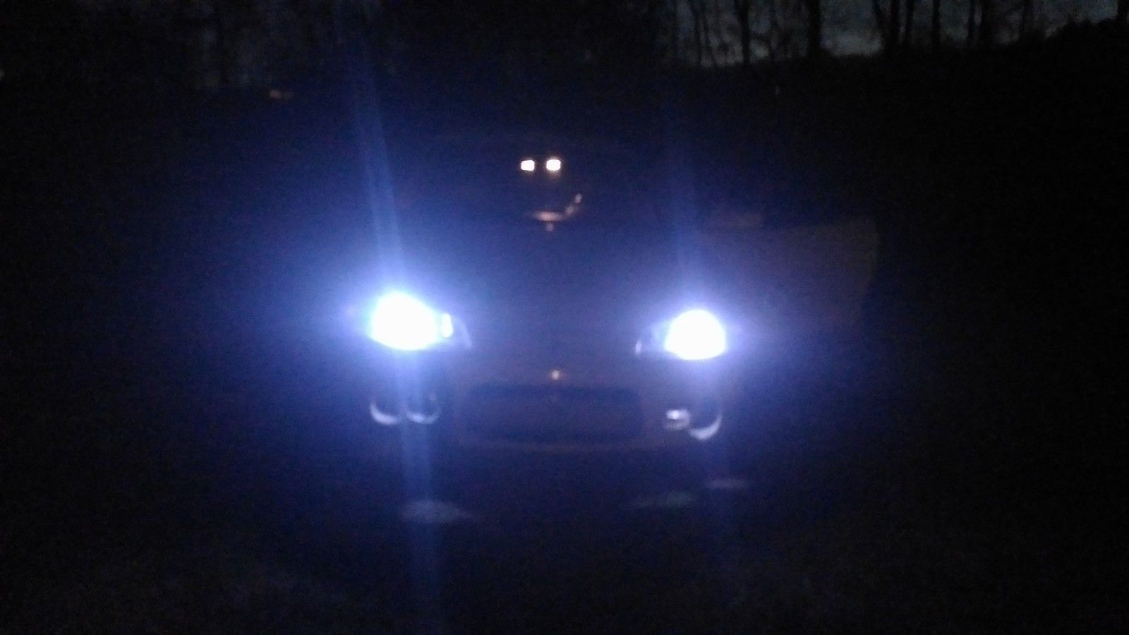

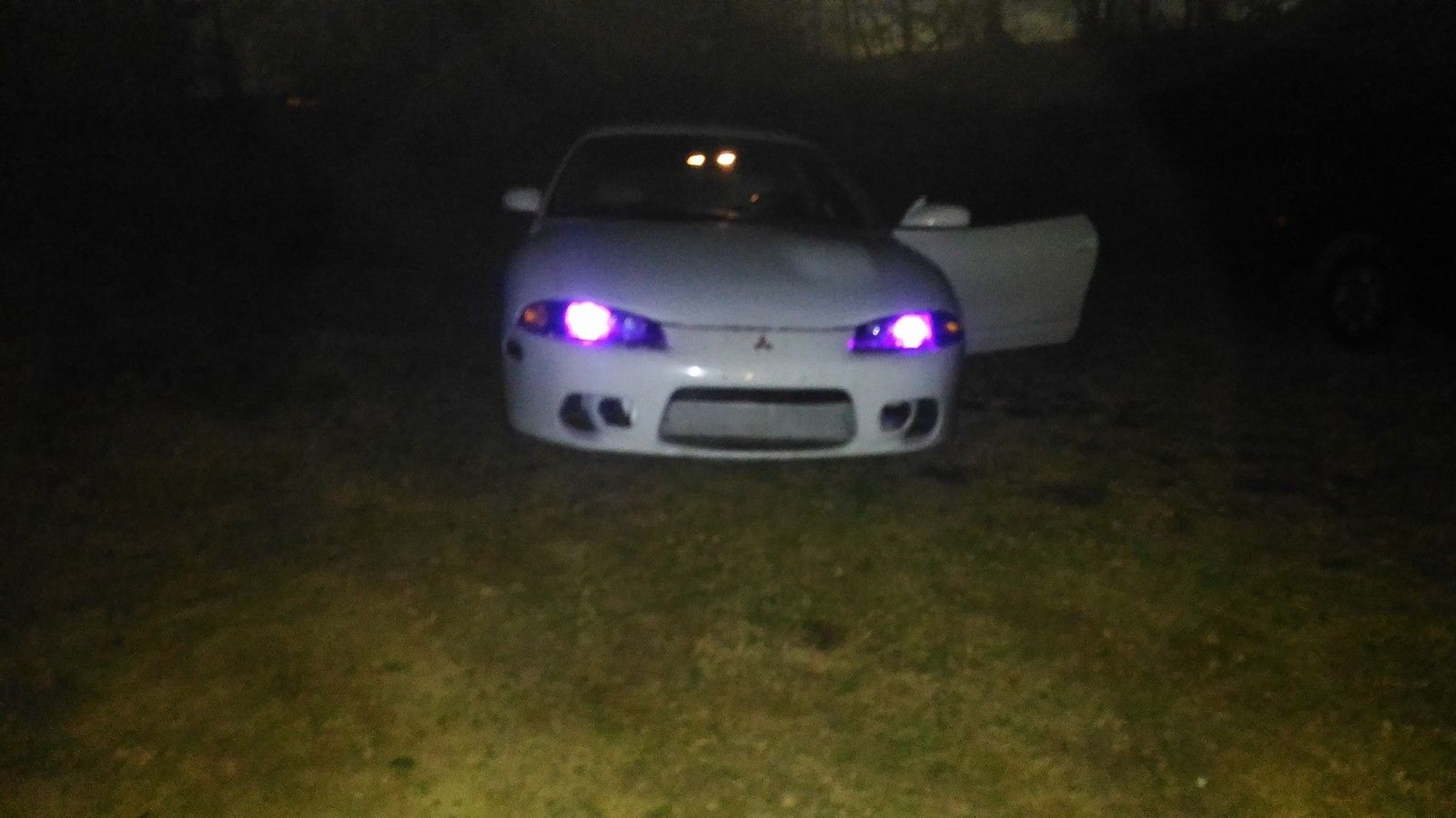

Also finished up my projector retro this week. Morimoto Mini H1s. Painted the shrouds blue, did a cutoff color mod, graphite shrouds, morimoto led halos, and ebay purple demon eyes. I think they will probably bring me a lot of business into the shop. Just got them done today and already got several comments, and a few people asking for cards when I told them we build them at my shop.
Projectors on :
Halos only
Purple Demon eyes
Bi-Xenon solenoid is tapped into the high beams inside the headlight. The HIDs are just plugged into the lows, since the 2gb headlights keep the lows on during highbeam operation. The Halos and Demon eyes are wired to +12v battery voltage at the fuse box, with an inline fuse holder. Then each are wired in series to a switch to ground inside the car. It gives me the ability to operate the demon eyes and halos independent of the headlights.
Did you get that sifter fixed? Mine broke in the same spot same weld.. I used a tap and die to put a bolt there in that center shaft and used a silicone washer and then a locking washer as the fix with it bolted together. I just uploaded the pics of it to my profile.
No I just ordered a replacement from Miller Import Parts. I still have the broke one, I plan on welding it back together at some point incase I ever need it.
