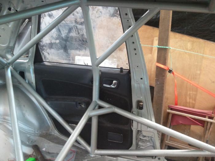

I now have an imported Sedan that has been partially prepped for Rally. There was a substantial cage but I need to add a couple of extra braces to get a log book for 2012 racing.

For 2012 I need to gusset door bars and add one diagonal on the rear brace and in the main hoop. :hmm:

Your cage design is a little odd, is it something you designed that way for a particular reason?
Mainly talking about the lack of main hoop down/cross bar and the traingulation with the floor in the center and strut towers.
G'day.
The cage was done in 2003 by a bloke in Gladstone who has built cages for quite a while.
He has a good rep.
2012 Regs say I have to add a 'Sainz Bar' that runs straight down from the top pf the 'A' pillar to the front foot of the cage.
Awaiting the opinion of the cage builder to see if he considers the changes help or hinder his design.
Cheers
Ross

Hi Ross. car lookes great. i really like what you have done here.
The extra brace is also called "Toyota-brace".
FIA regulations also say that you don´t need it to be all the way up to the top.
as long as it sits atleast 10(or 12)cm away from the steeingwheels.
My brace as example:
