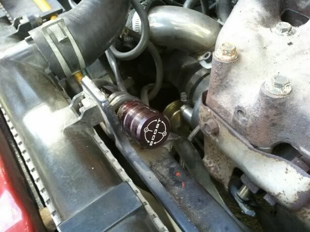

Some sort of boost control a previous owner put on I suppose says HBC I think :/

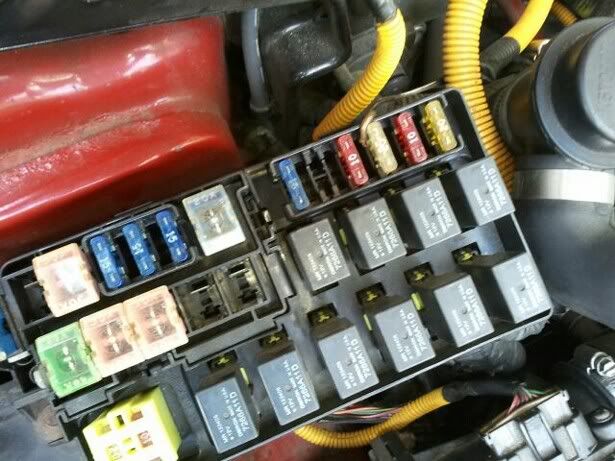

Not sure why someone bypassed a fuse and wired this right into the fuse box it says on the cover it should be for the high beams and a 10a fuse should be there but for some reason there is a 25a fuse so the previous owner did all that. Not sure if this affects anything.

the HBC is a manual boost controller made by Hallman, it's one of the best MBC you can get really.

And awesome Zcoh! I didn't know it was a really good one :) Think I will leave it on even though I don't need it yet, seeing as how I have the stock turbo on.

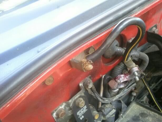

Alright so I tested my ISC also known as the IAC and all of them came back at 30 and then one connection at 29 so I figured it was fine. But my ground wire on the other hand not sure about it.
This is the ground wire (I think) that runs to the negative terminal on the battery. Is it normal to have random wires hanging out like that? This might be why it's screwing up not sure.

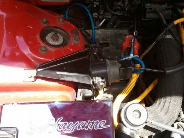

This part I have no idea so I am just looking to find out what the hell this part is that is mounted on the strut tower bar. The one that has a big bracket and holds two round things I am pretty sure this is not stock.
We tightened up the bolt to the firewall for the ground and now it runs fine most of the time except for sometimes when the headlights are turned on. I honestly have no idea what could be wrong I am having it looked at tomorrow and I am having a big 3 upgrade made for this car. My alternator belt squeals on start up sometimes not sure what the torque should be at for that. Anyone know?

Okay guys. My bad idle problem along with the horrible throttle response is on its way to getting fixed now that I figured out what is causing it. This problem is directly related to the AFR gauge and the Boost Pressure gauge. I undid the black wire from the boost pressure gauge that was connected to a black wire coming from the AFR gauge and that is when my car idled like shit and died (with or without headlights on). I just went and hooked up these two black wires to eachother again and now it only idles bad when the headlights are on. The previous owner has a wire from the boost pressure gauge tapped right into the high beam fuse in the under the hood fuse box. He also replaced the 10a fuse that should be there with a 25a fuse (probably kept getting blown). Not sure what to do! Please help!
