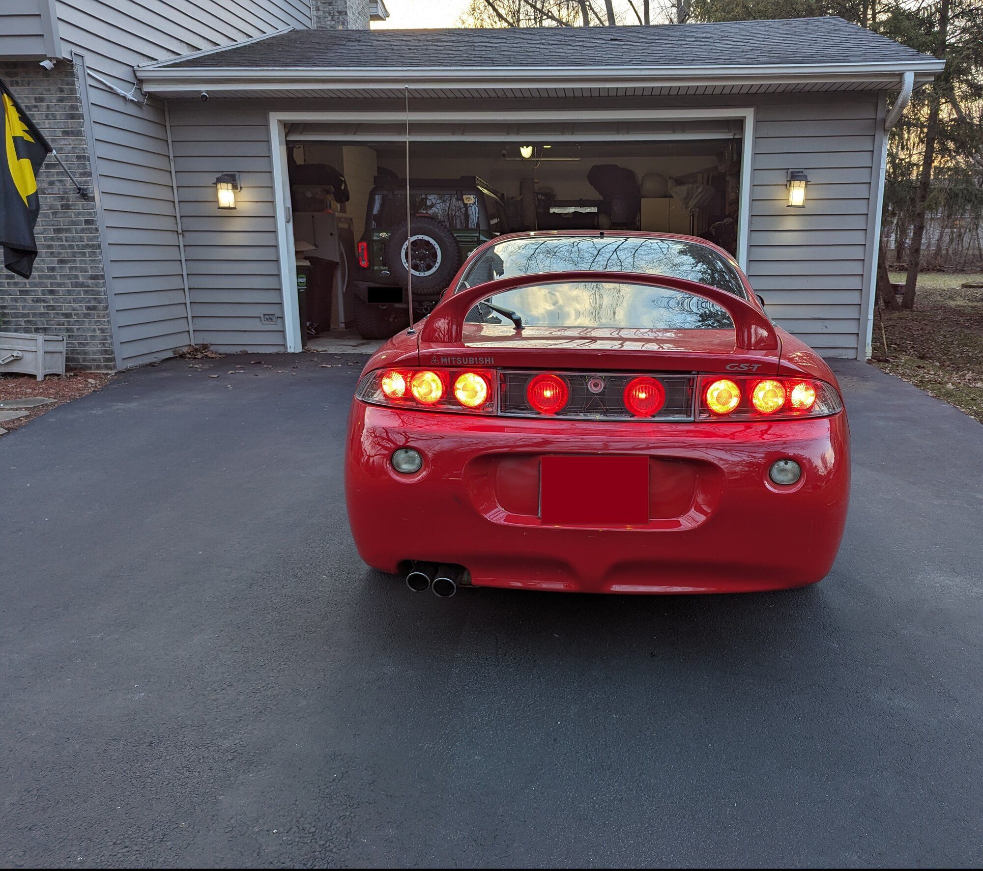

- Rear Tail Lights
- Center Tail light panel upgrade (customized)

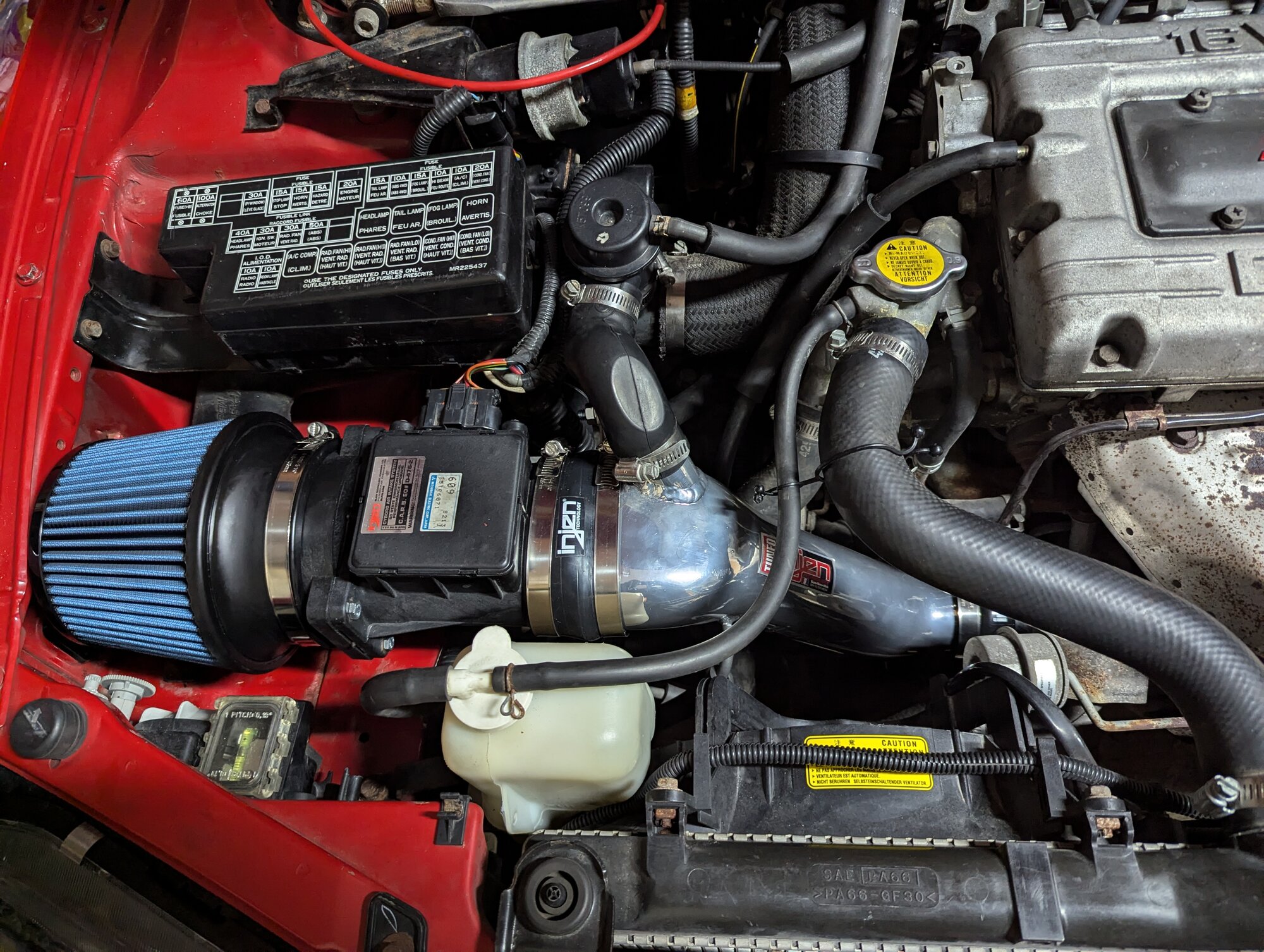

This weekend I did a long-awaited easy bolt on. I added my cold air intake. I am sure this is rather beginner this to do. but I have to start somewhere.
parts:
Injen Technology IS1890P Polished Short Ram Intake System
It looks great.

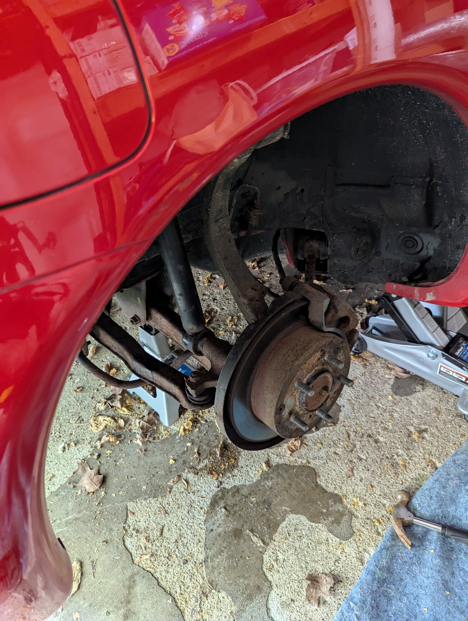

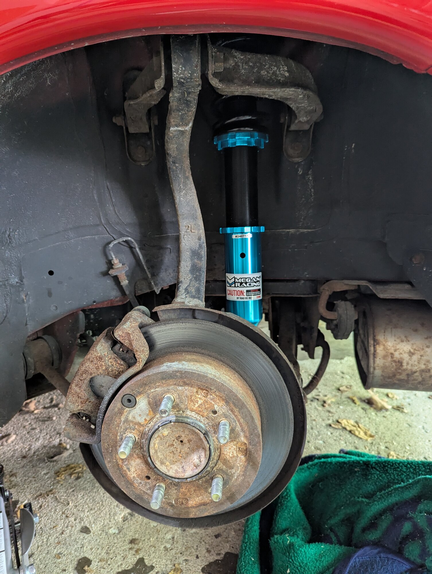

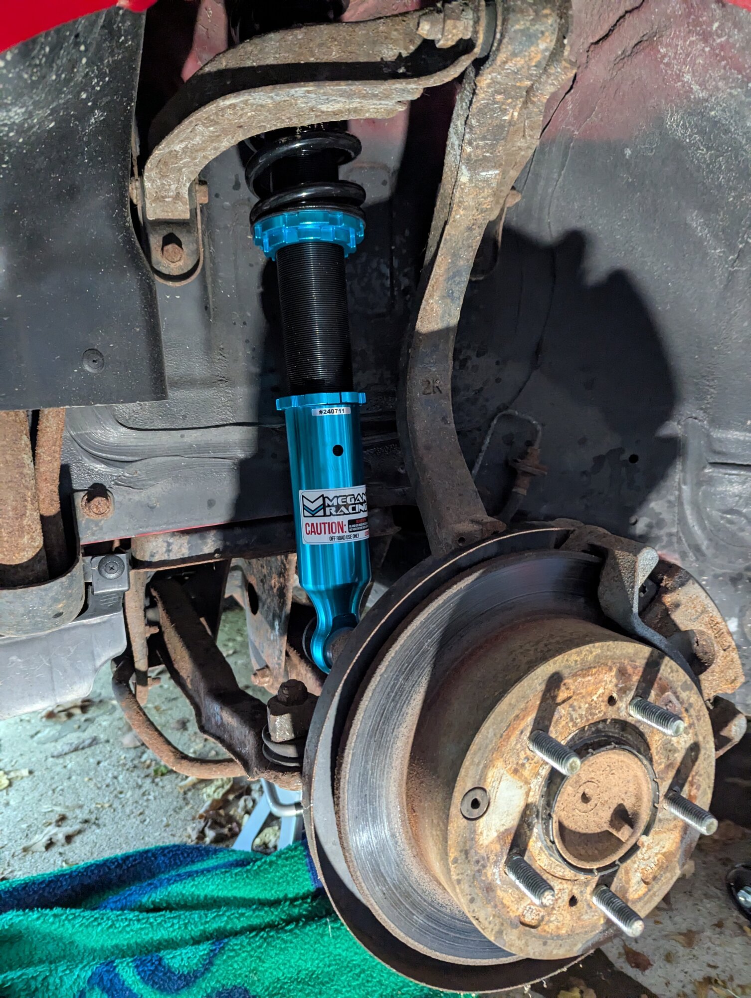

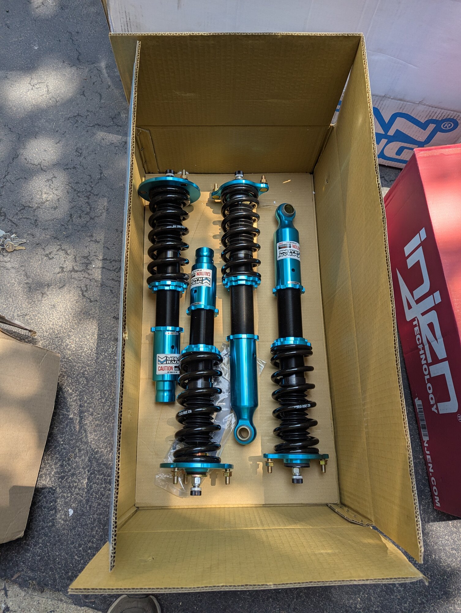

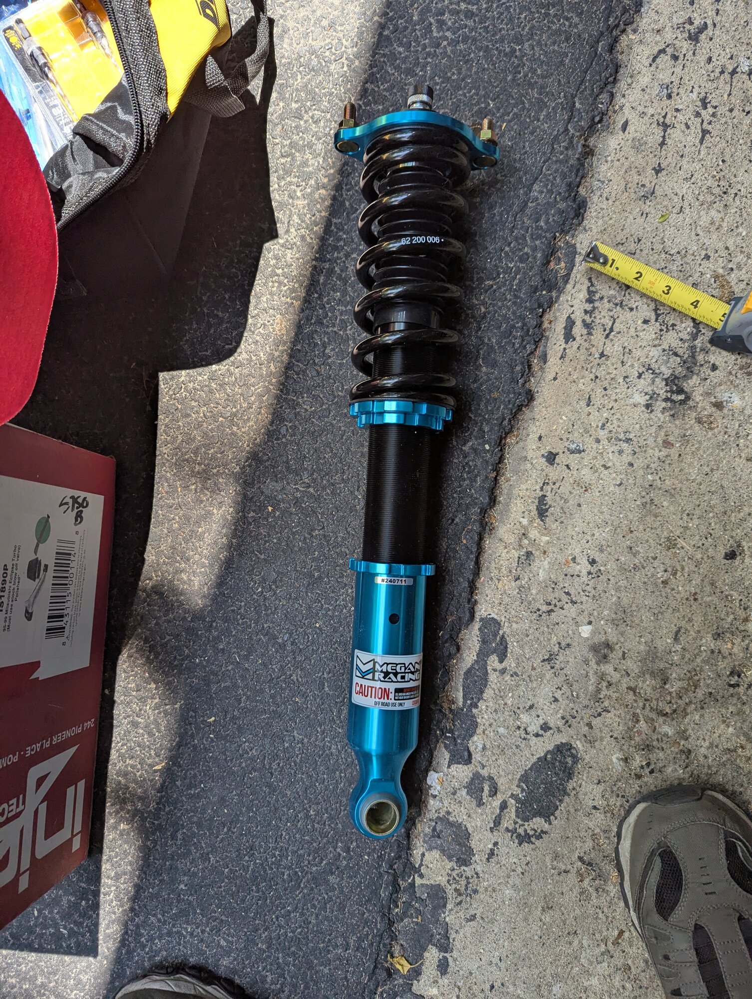

This week I am installing Megan Racing EZ II Coilovers (https://shop.redline360.com/product...ers-mitsubishi-eclipse-95-99-mr-cdk-me95-ezii).
This was a simple and straightforward job. Just a little penetrating oil and all the nuts came off easily. I will need to set the ride height, but they are installed.

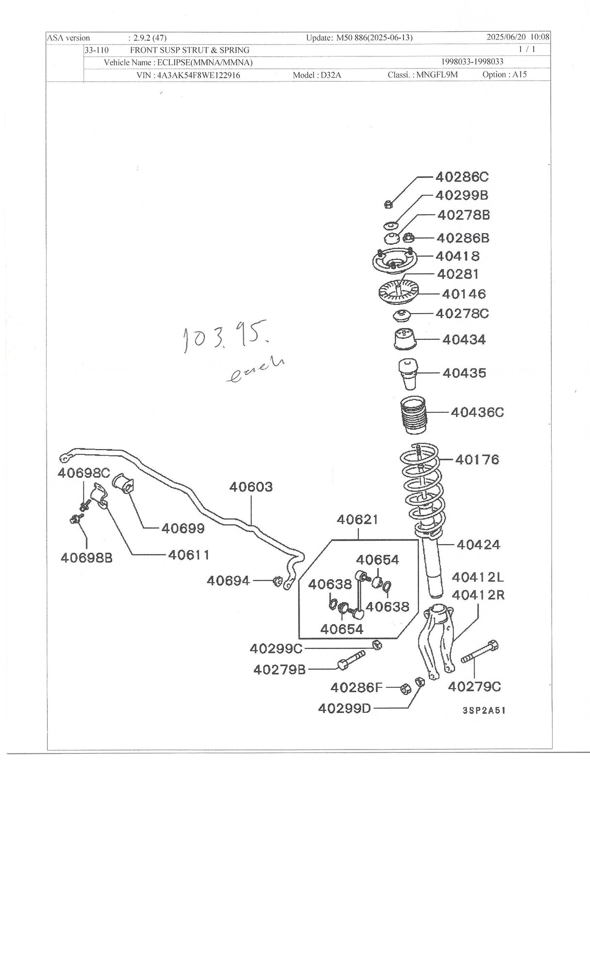

Because these went in so quickly, I moved to install the front coilovers. I moved the jacks to the front and started the process. Everything was going smoothly until I reached the small control arm that connected to the knuckle to the sway bar. OH my! I spent an hour just getting the bolt to turn. Heat, penetrating oil, and repeat. Then to realize that it was just spinning and I needed a small hext wrench in the center to hold that still. Well.... after another hour or two, I gave up.

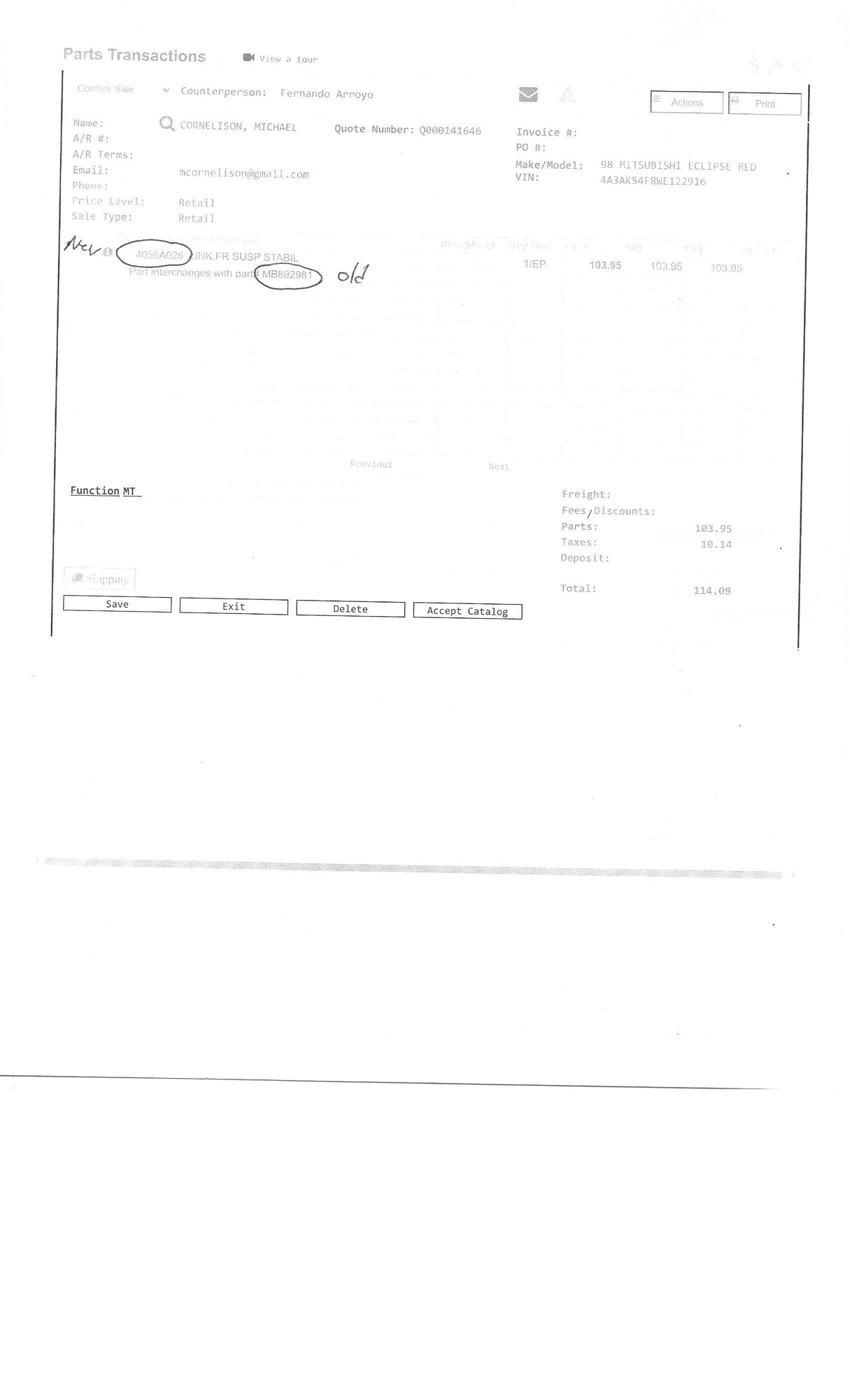

Once I can get them off, I have ordered new replacement control arms. For a small piece of metal, they are not cheap, and as of today, Mitsubishi doesn't make them anymore. The old OEM part number is MB892981 and the new part number is 4056A026. I have included a diagram if anyone is interested.
Any tricks to getting a tool in there and getting it to come off without cutting it or breaking the hex wrench?

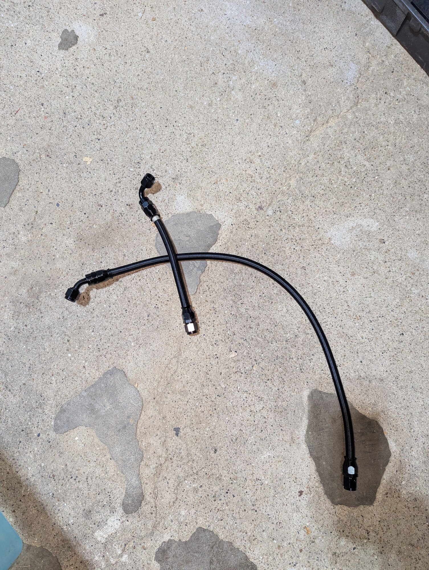

I started by watching a few tutorials on cutting and assembling PTFE/AN6 lines. After a couple of trial-and-error fittings, I got the hang of it.

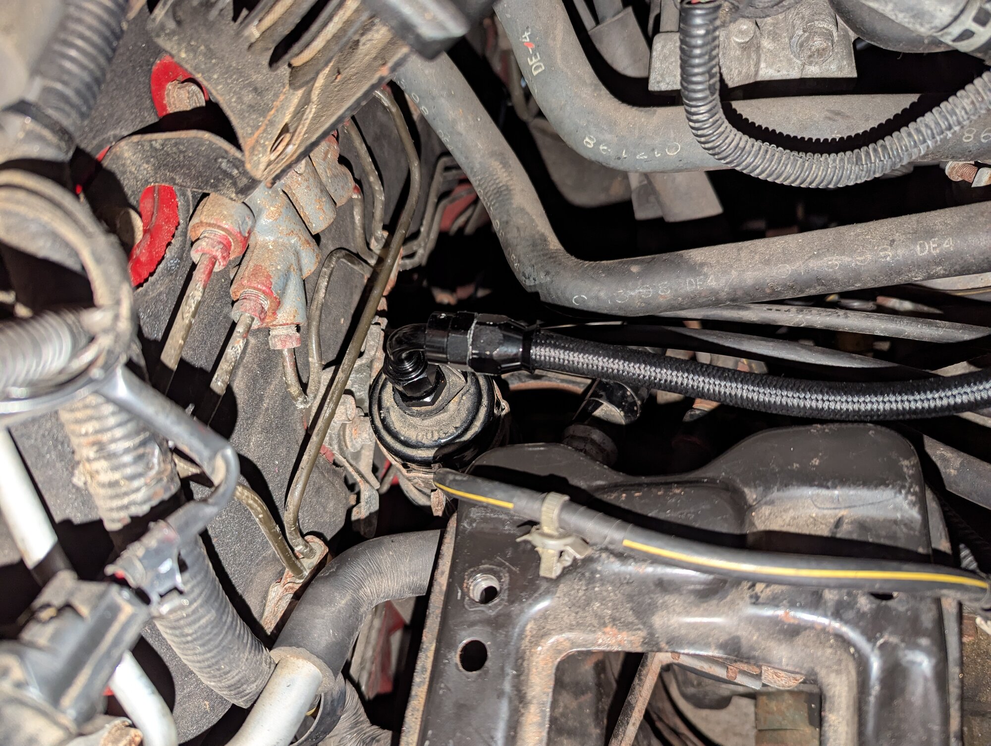

Roadblock #1:

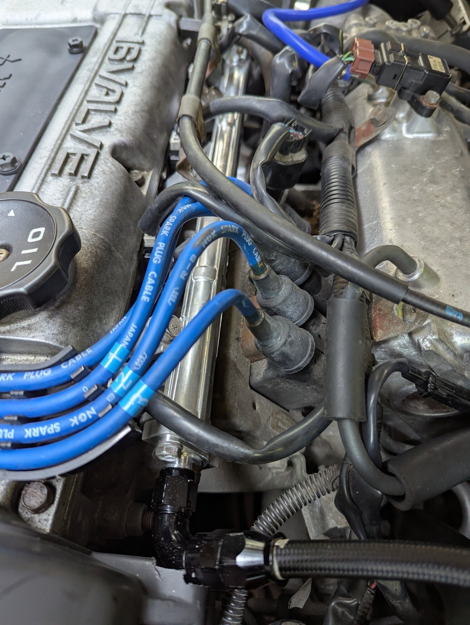

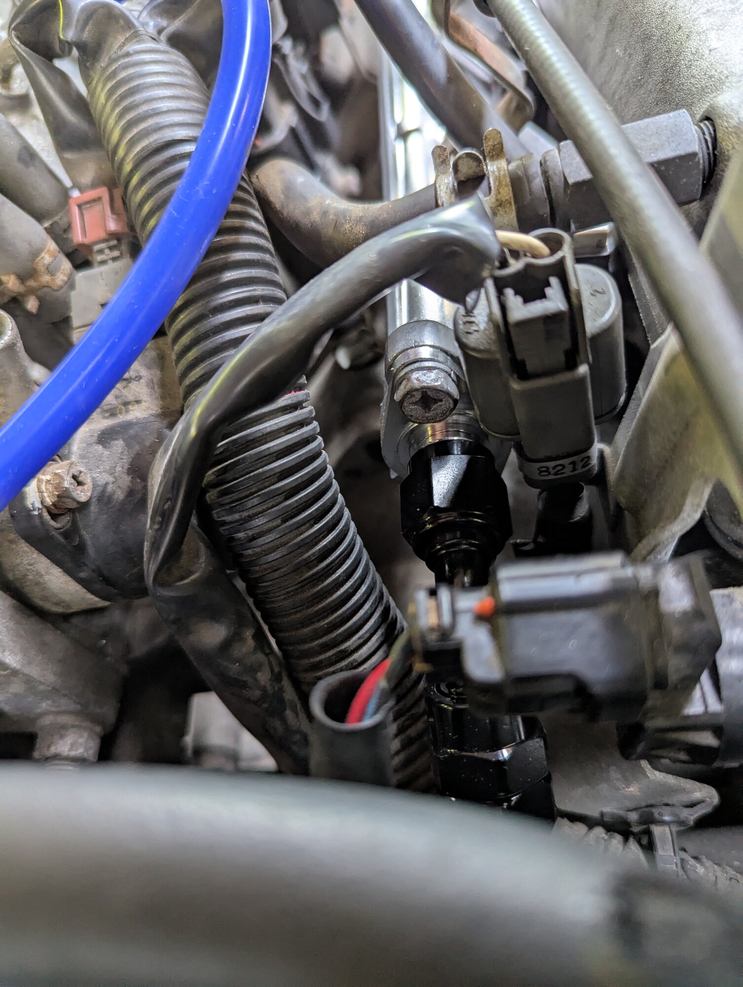

The fuel filter outlet required an AN8 to AN6 male adapter with a sender port. Took two days to get the right fitting, but once it arrived, it mated perfectly with the fuel rail adapter.

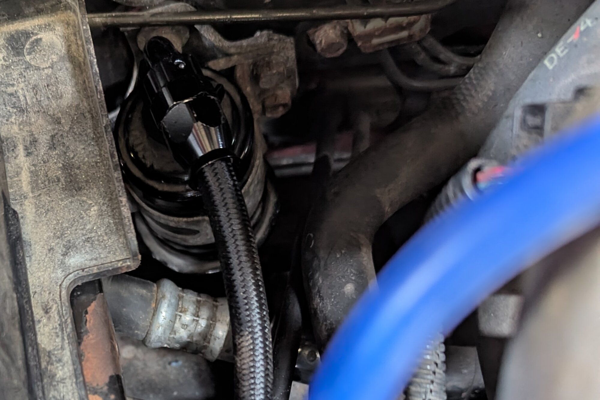

Fuel rail fittings installed.

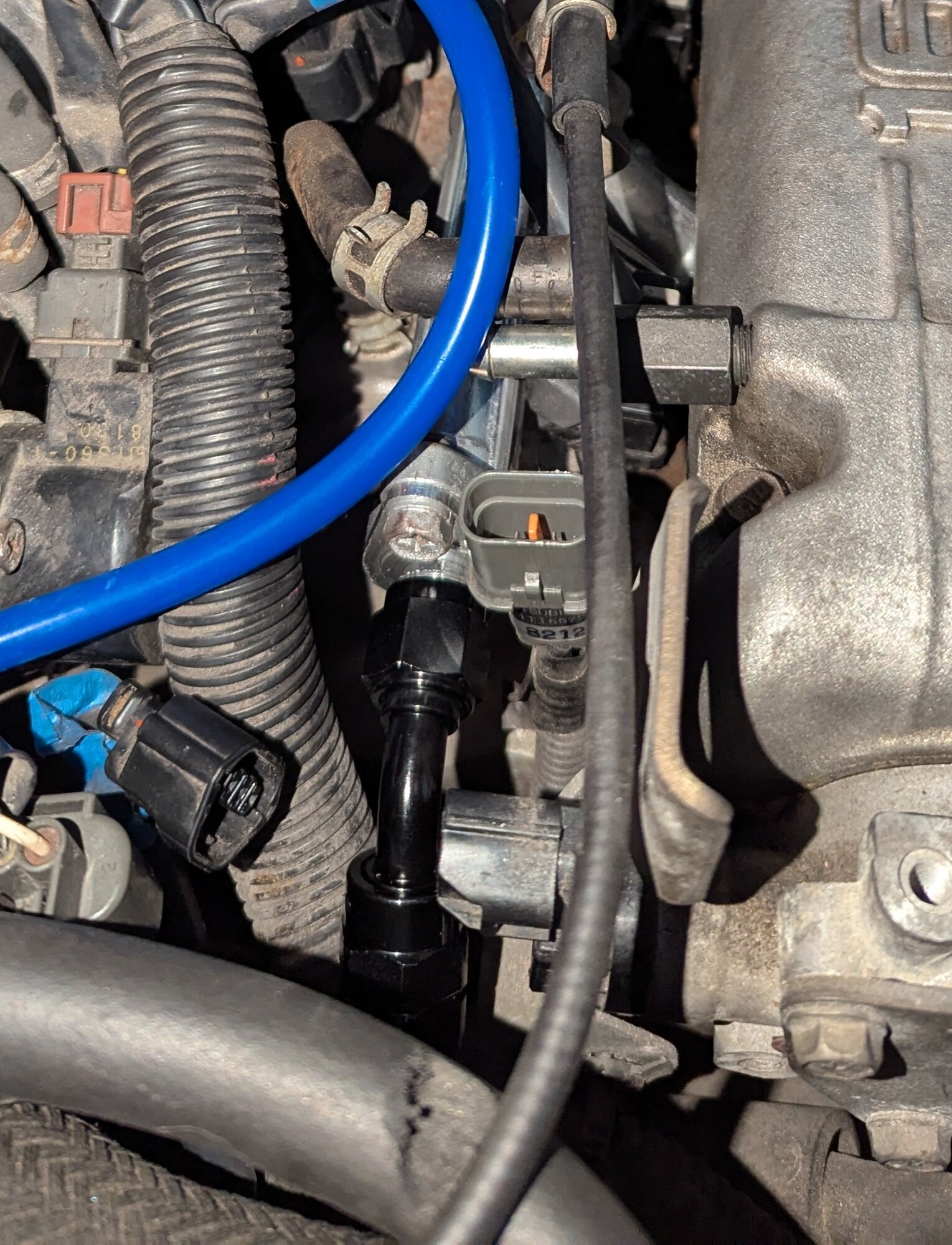

Next issue: I needed an AN6 to hardline adapter. I initially ordered a 5/16" version—too large. Reordered a 1/4" AN6-to-hardline adapter (another two-day delay). But the return line had a factory flare, which prevented the fitting from seating properly. I had to order a mini tube cutter and a compact 90° AN6 fitting to make it work—again, all PTFE-compatible.
Hardline Modification:
Using the tube cutter, I carefully removed the flare from the return hardline. This allowed the 1/4" AN6 adapter to seat and tighten correctly. Pro tip: cut the flare off first—saves a lot of hassle.
To access the return line fitting, I removed the timing belt cover—gave me the clearance I needed to route the 90° AN6 fitting cleanly.

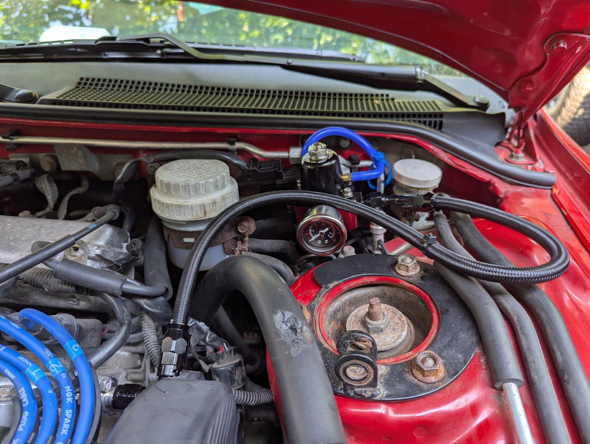

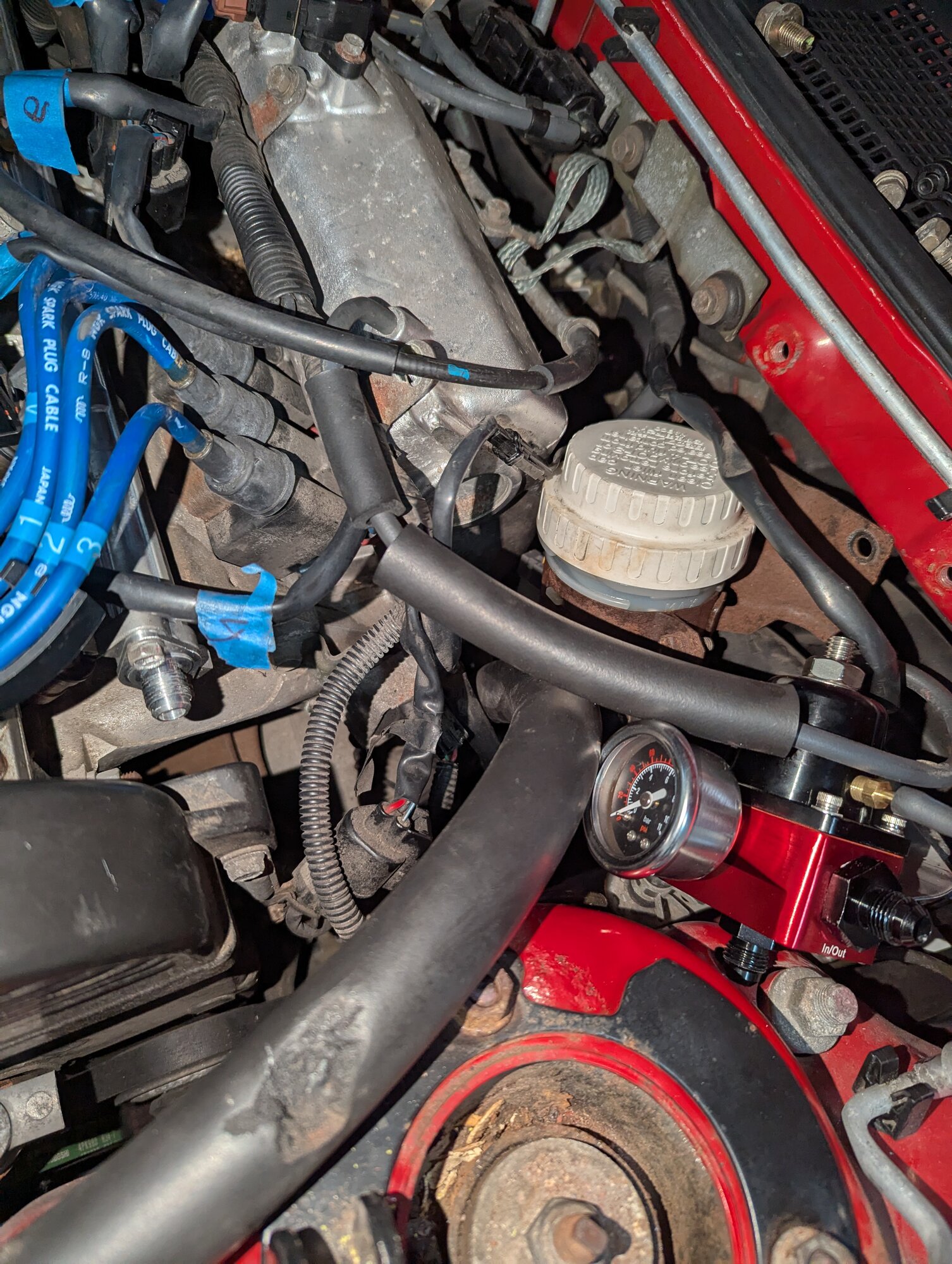

Fuel Pressure Regulator Install:
With all lines routed, I mounted the FPR—finding a suitable location on the firewall wasn’t easy, but the install kit helped. All AN6 lines were connected: feed, return, and vacuum reference.
System Test:
Turned the key to AUX—no leaks. Fired up the engine—it started, then immediately died. I suspected fuel starvation. I recorded the FPR gauge during startup and confirmed: zero backpressure.
Quick Google confirmed it—rotated the FPR adjustment screw clockwise to increase pressure. The car fired up and held idle. I dialed in the pressure to 42–45 PSI, per spec, while monitoring for leaks.
