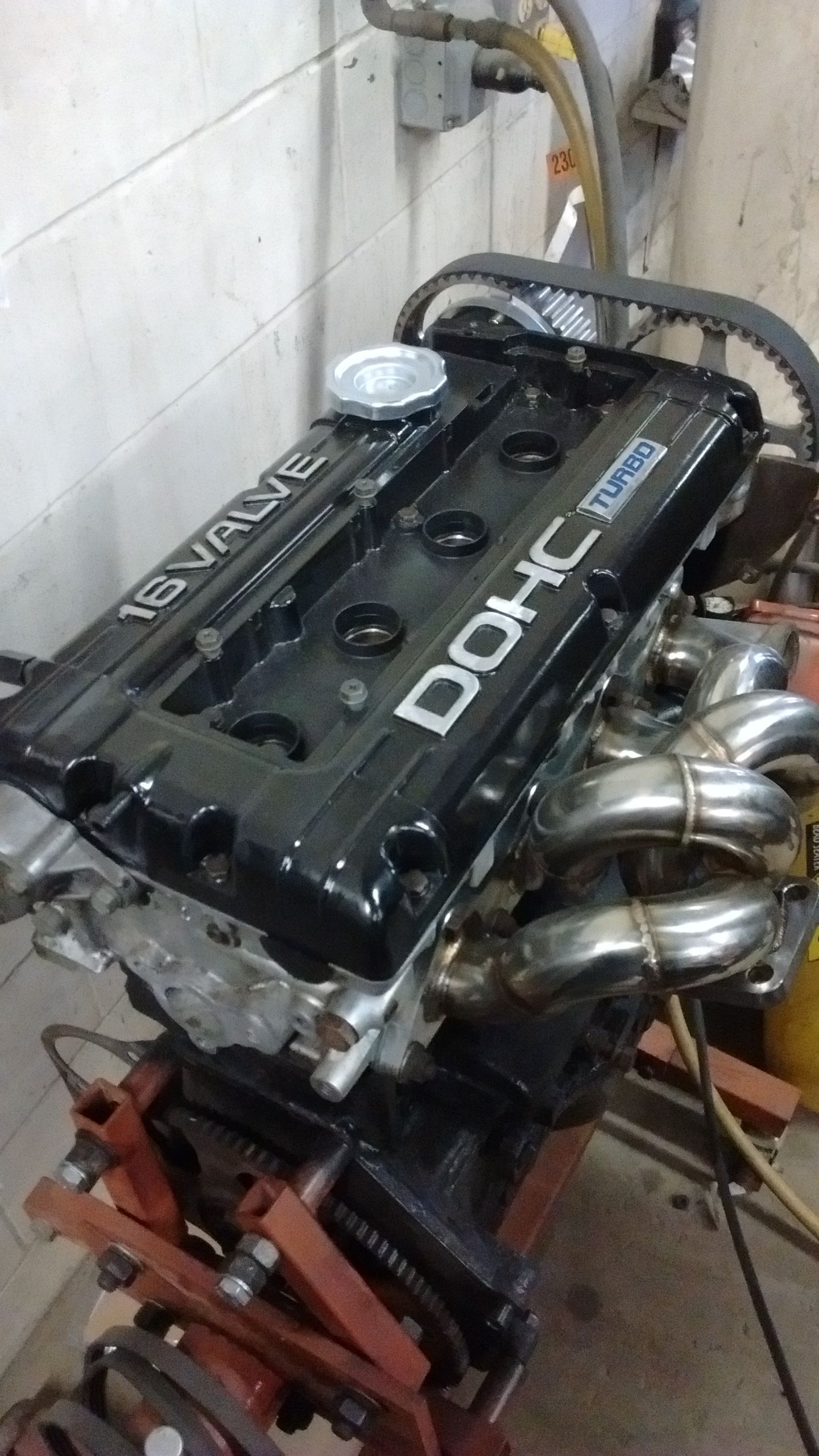

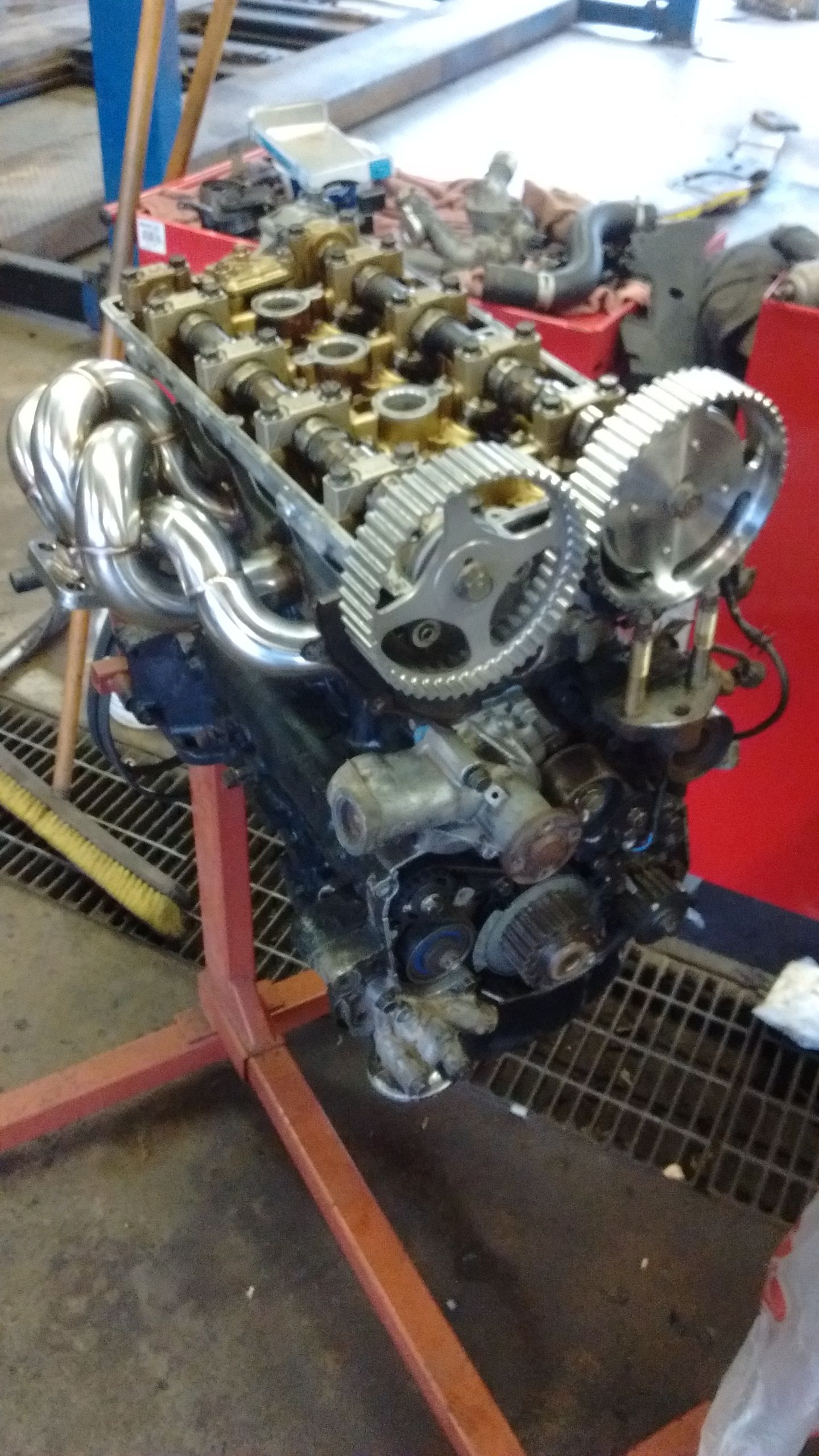

I used the factory n/t galant pistons with the 95 4g64 block. Main piston failure is caused typically from high piston temperatures. I've put a lower temp thermostat, used water w/ water wetter. Thermal intake gaskets to help prevent high temperatures before I can put forged pistons in.
