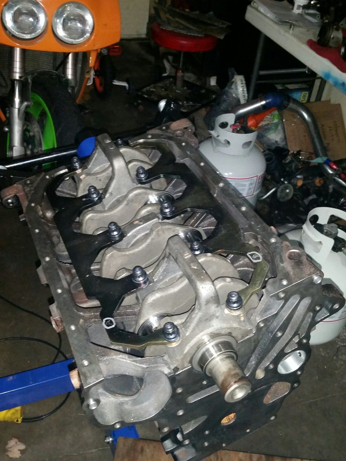

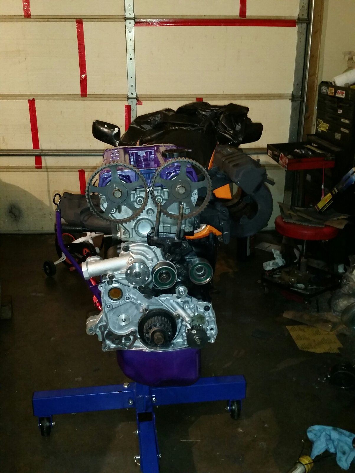

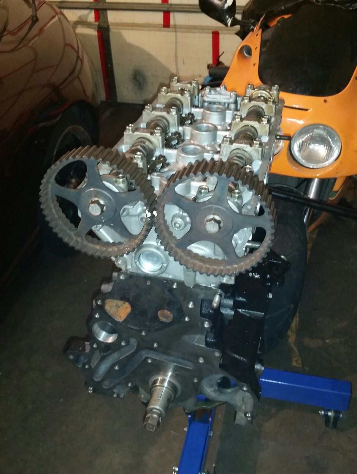

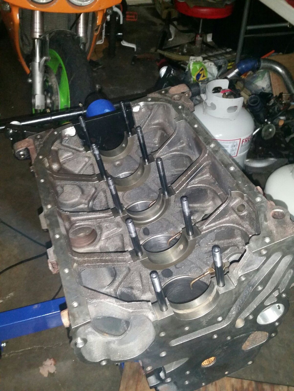

A few weeks back I got all of my parts and my engine back from the machine shop. So far it's been going as smoothly as expected. Taking a bit longer than I had hoped to get it all back together but my 4 year old insists on trying to help.
So far most of the block has been assembled. By tomorrow I am hoping to be able to drop the engine and transmission back in.

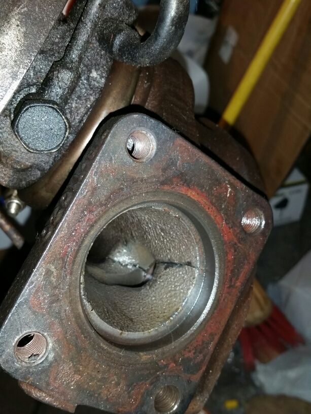

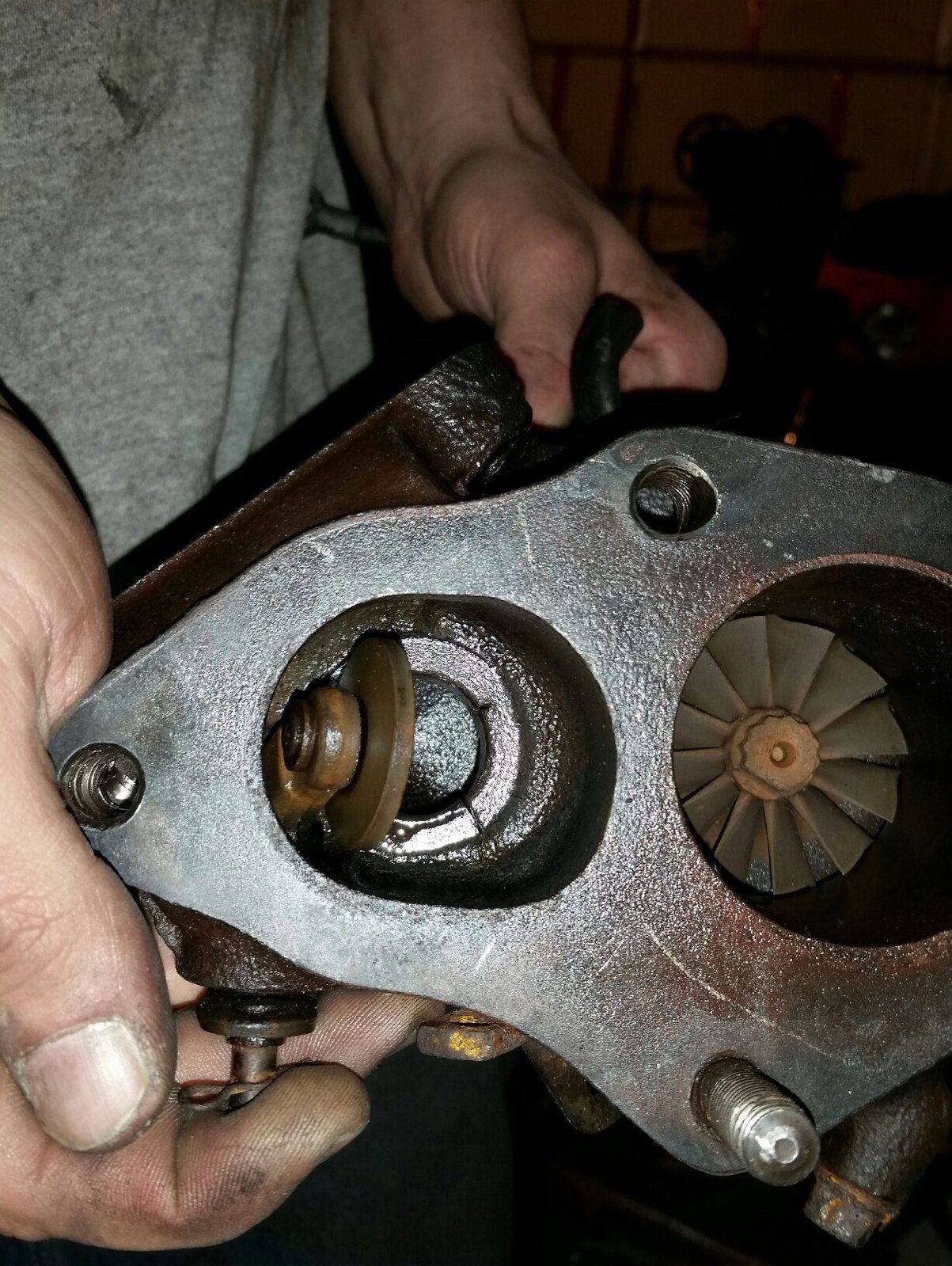

Located a 14b turbo which has some cracks in the housing and wastegate. I do know it came off a running, driving car but my husband has decided to try to epoxy the cracks in hopes of not running into issues.
The engine looks freaking amazing! Love the Kiggley Brace and ARP's. Nice build! Looking at the pictures of the 14b though, You're going to need a new hot side housing at the very least. If you epoxy it, the expansion and contraction rates of the epoxy won't match the cast iron and it won't be long before you're leaking again. I would find a used crack free housing on this forum, e-bizzle or craigslist and just replace it. You won't be able to properly tune the car (even in stock trim) and you will never see full boost from it. I'm wondering if the vehicle this came off of had an anti-lag setup. If it did, then the fuel was actually combusting inside the turbo as well as the cylinders. Not good for turbo life and if that's the case, I would be cautious about the rest of the turbo. If it's a question mark, I would just find another complete 14b or 16G. Even a stock T25 would be better than trying to epoxy that one. Up to you, but if you use this one, just keep these issues in the back of your mind if you need to trouble shoot boost leak or driveability issues. Glad to see you finally got the dream whip though. Congrats!

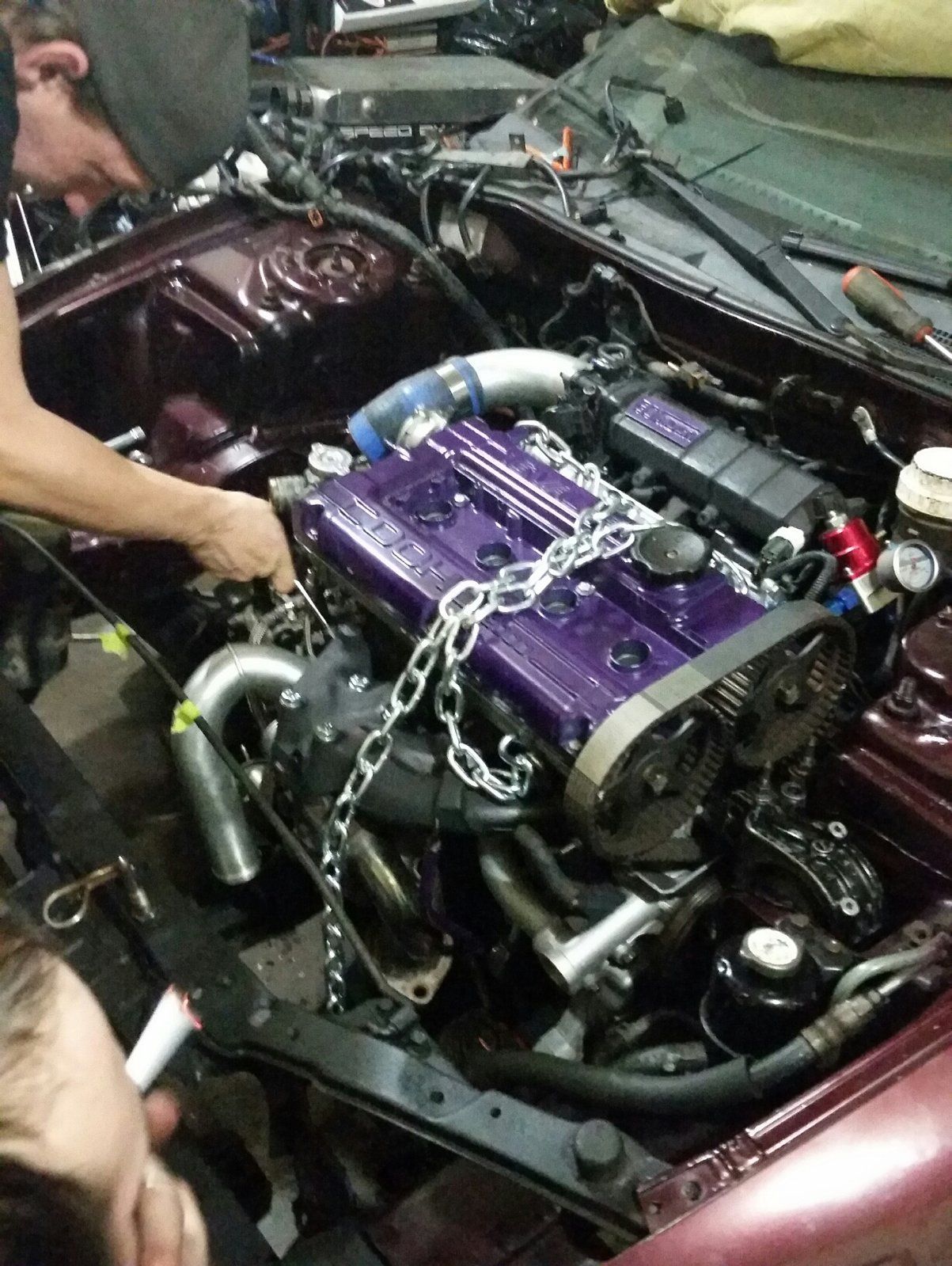

My husband finally had time to get back into the garage this weekend. All in all he spent between 10-12 hours this weekend trying to figure out my car. Yesterday it was the issue of the ecm not reading in my car which it turns out was the result of a sensor being plugged into where it didn't belong. With that fixed we then ran into the annoying issue of the clutch not bleeding after we replaced it with an SS line. Which we fixed this afternoon-that was a highly annoying cluster f#%$ of fun. After that he plugged in the remaining sensors, got the fuel pump to read, ran all the vacuum lines and installed the radiator. First few attempts at a start failed but again it was because of something that was oh so silly... apparently the 95 eprom ecm needs to have the plug wires flopped.
So once we got all of those annoyances taken care of, it fired right up. Now mind you, it's a fresh motor and doesn't run like a champ yet but it is finally alive after 6mo of sitting in my garage.
Upper radiator hose is close to bursting so that is a must to replace and we also have the issue of coolant spraying out of the thermostat housing around the gasket (3k rpm or higher) also have an issue with lifter noise which I'm not happy about (I had a shop rebuild the head) oil pressure holds steady, Temps doesn't but we also do not have fans installed just yet. And I can finally say I have had a car make boost! Hit 2psi in my garage, haha! Yeah, I know... weak sauce for all you dsm'ers but absolutely epic for my as I have never had a turbo car. My baby is nearly complete. When it's drivable and doesn't leave me stranded it will be one of my happiest days.
