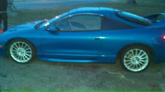

I was an owner of a 2004 eclipse GS with 169k, and disliked it. Too slow. This past weekend I traded it for a 95 eagle talon tsi awd that the guy put an eclipse gsx hatch with spoiler and tail light assembly on. He also put a 99 eclipse gsx 4g63 in it with 87k on it. He had the following modifications on it. Stock evo turbo, custom exhaust from headers back, greddy BOV, a big FMIC, it was lowered on 19's with newish racing low pro's. Had a camber kit, new struts, springs, shocks and all that jazz. And I'm sure I'm missing a few things that I'll add when I edit this. The reason I was able to get this at such a decently low price is because he had skipped timing and the car wasn't running. I was skeptical when looking at but when I took the valve cover off it looked really nice. I got it home and then I started finding the problems. The body kit was nice, but seemed pretty half ass'd; there was bolts missing everywhere which made everything lose. The battery was shot, the sunroof motor didn't work, and one of the headlights wasn't getting power, AND The first time I opened the passenger side door the handle broke.. at this point I was about to call the tow truck back and have him bring it back and drop it off in the sellers living room. But I figured they would be easy and relatively cheap fixes if I found someone parting their car.
