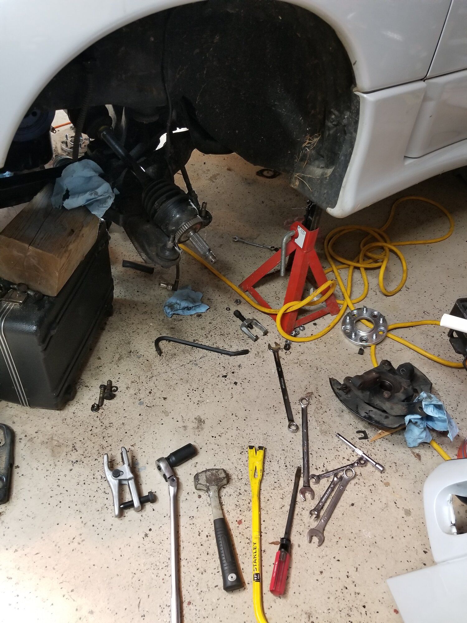

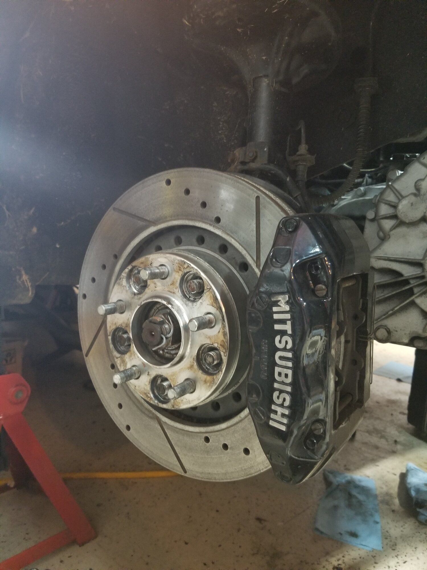

Removed OEM spindles, which will be replaced with Evo 8 spindles on hand, to fit Evo X brakes, also on hand. Pic of old brakes coming off.
The ball joints took more force than I've ever seen with a proper ball joint tool. Both spindles shot up and out 2-3 ft when they popped loose.. I was concerned that the tool might break. (those spacers will be long gone too)

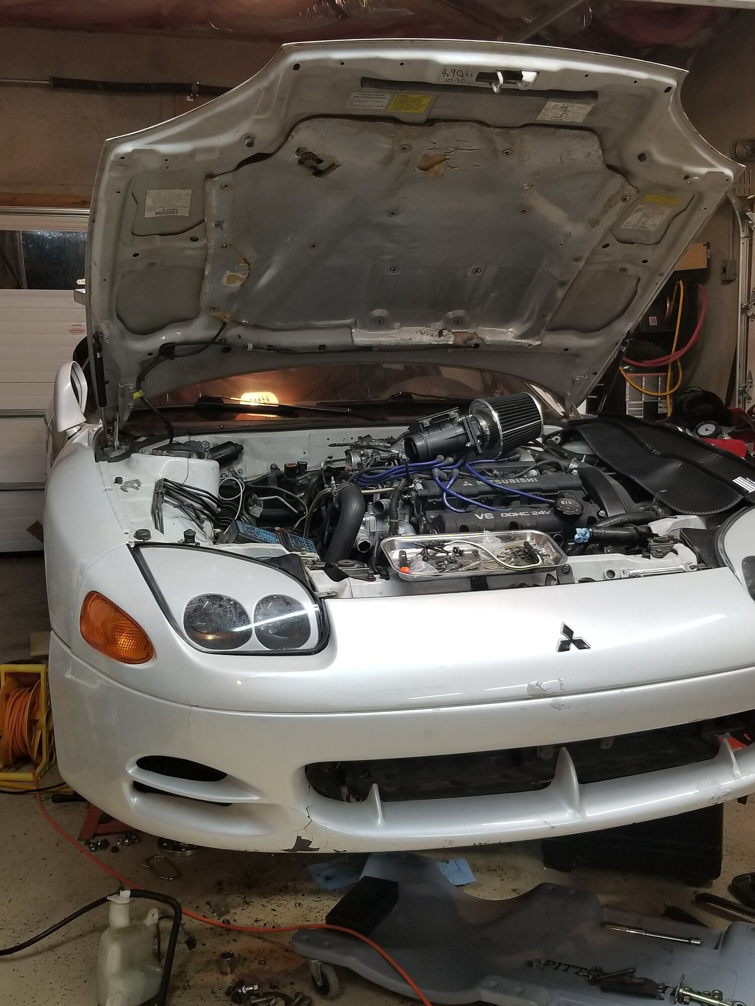

Also removed the front bumper to access other stuff for removal. Hidden parts are very dirty for 71k mi.
