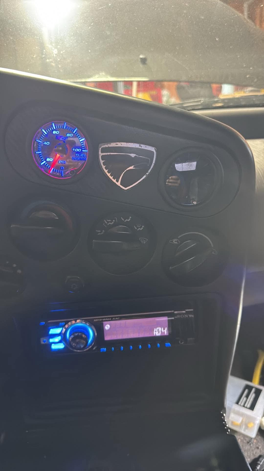

Bench tested the Glowshift sensor and gauge. Wanted to verify that the gauge itself turns the 12v power into a 5v reference.

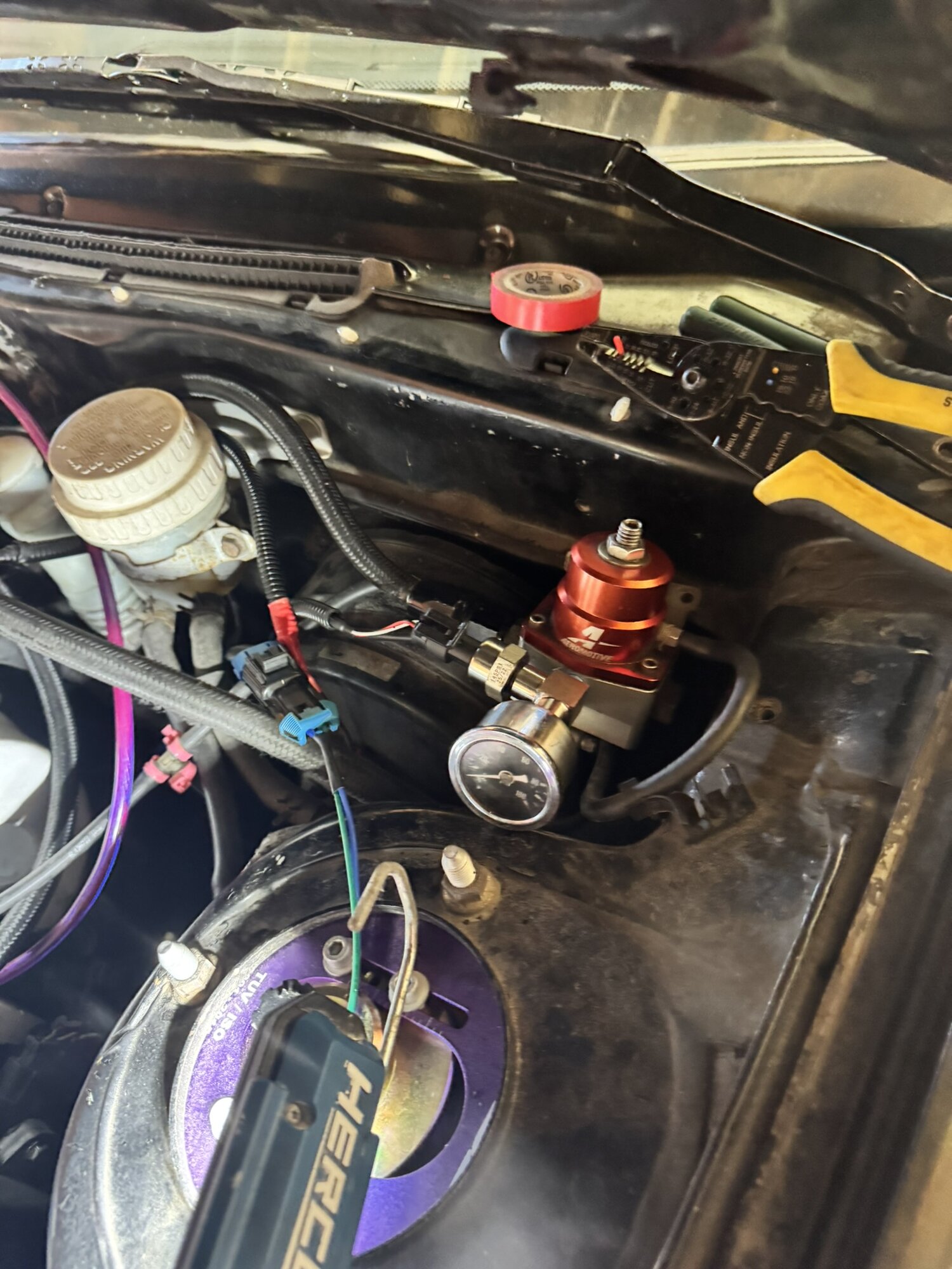

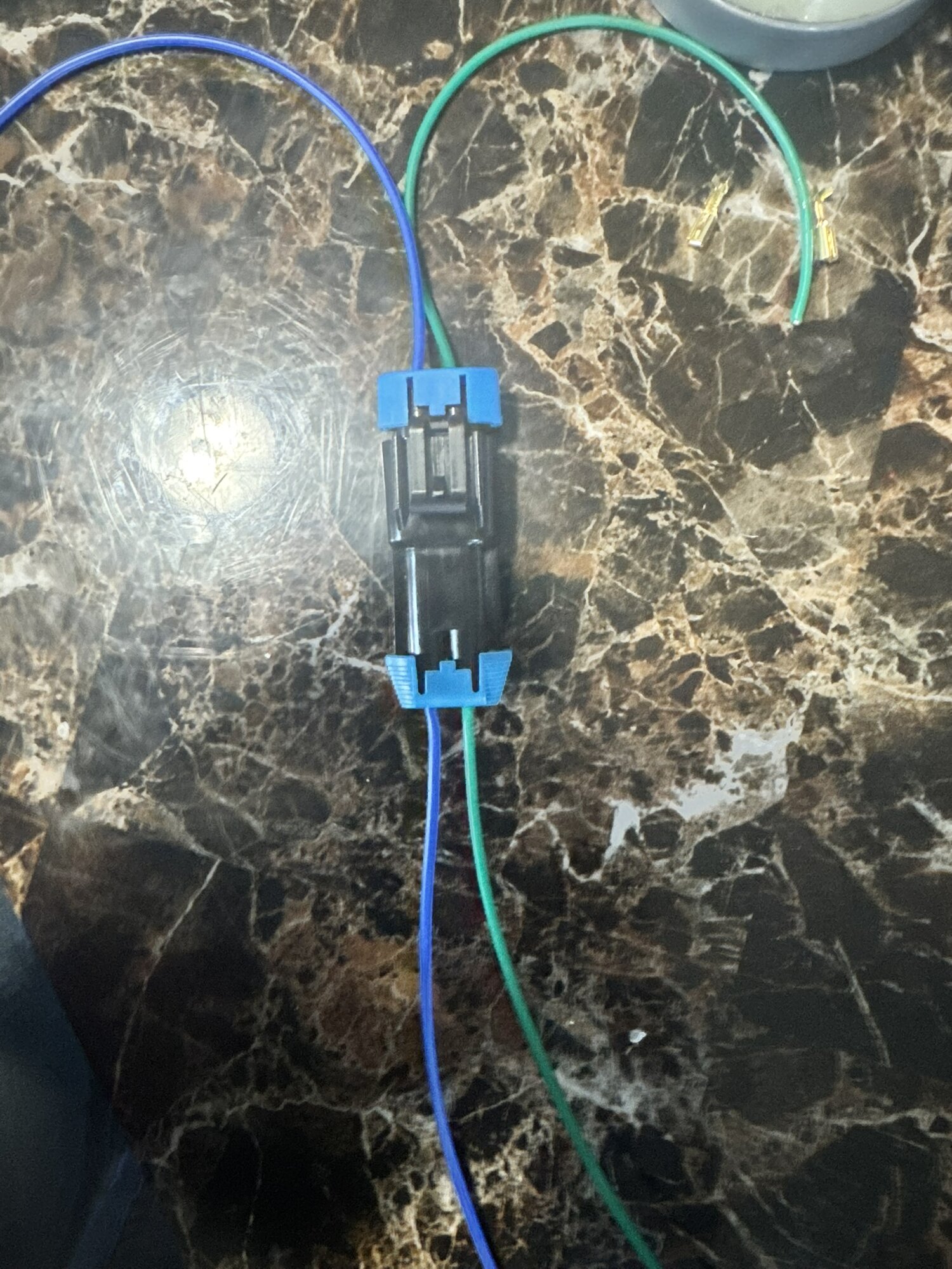

Made a new harness section to replace the EGR plug, and got my fuel pressure sensor installed. Tapped 5V from my Map sensor until I get the gauge installed. (waiting until I Get oil to do them both at the same time) I just need to set it up in DSMLink.
For you who have logged fuel pressure, do I set the voltages as follows: 0.5V=0 PSI and 4.5V=100 PSI?

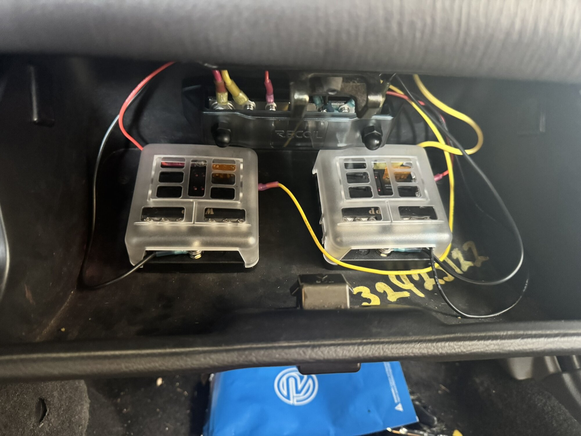

Ended up installing a buss bar and two fuse panels in the glove box. (will clean up wire paths when I install the next gauge)
Left panel is constant 12v, Right is ignition power. Installed a relay behind the glove box to power the ignition power.
No more random splices under the dash, and no more wondering where things are wired.
If anyone has done something like this, chime in. Im all ears(eyes) for tips to make this even better!
