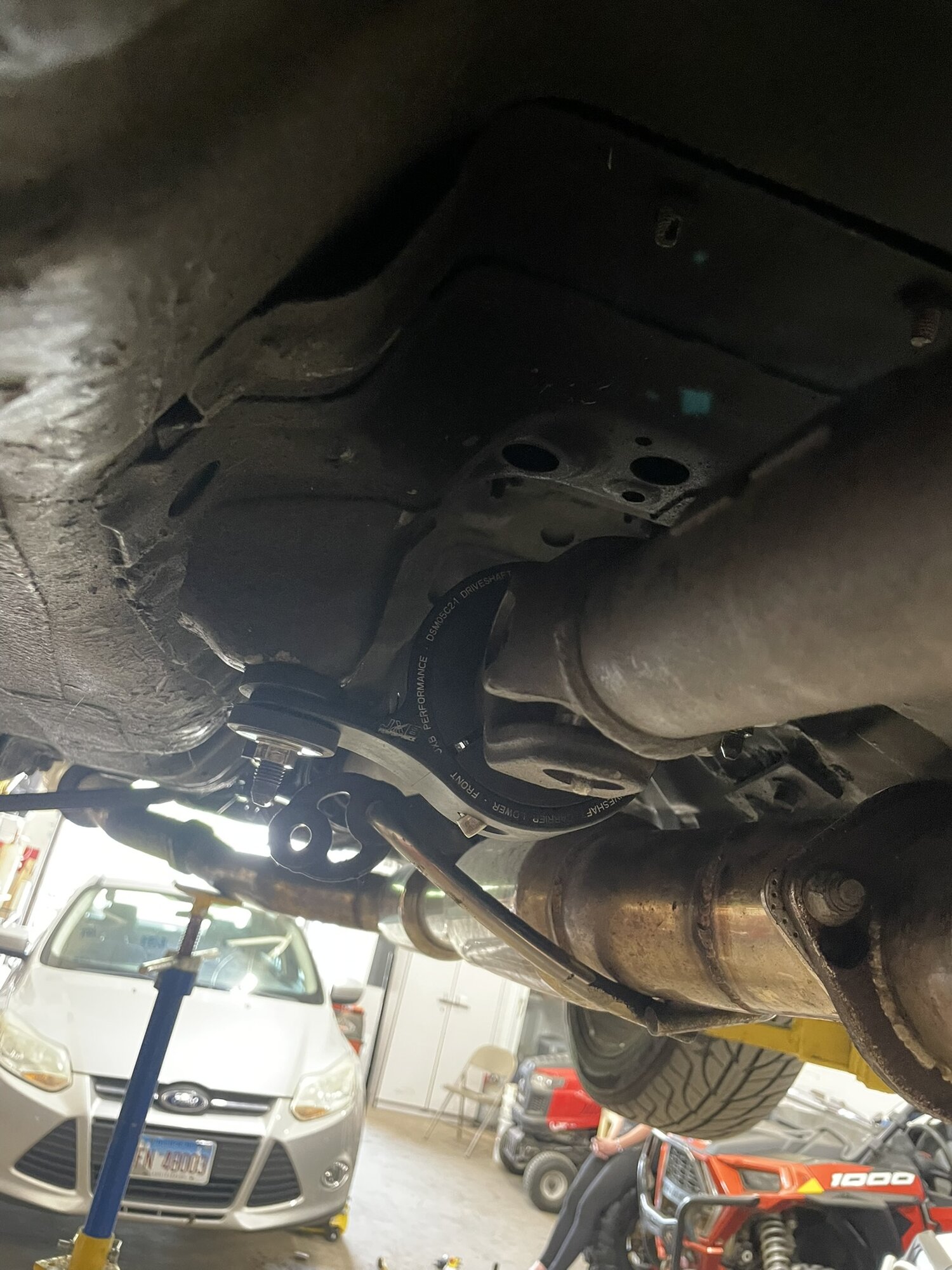

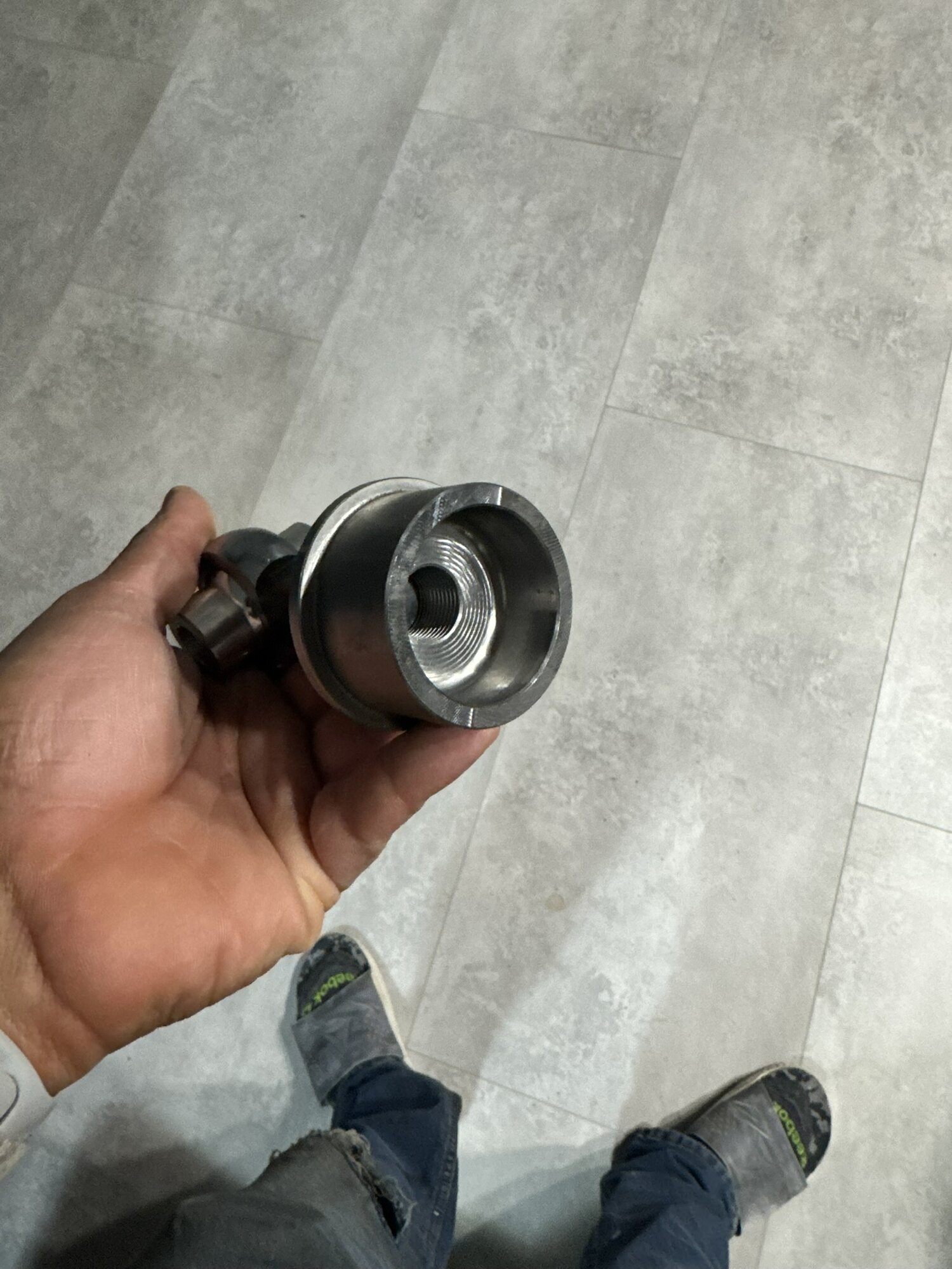

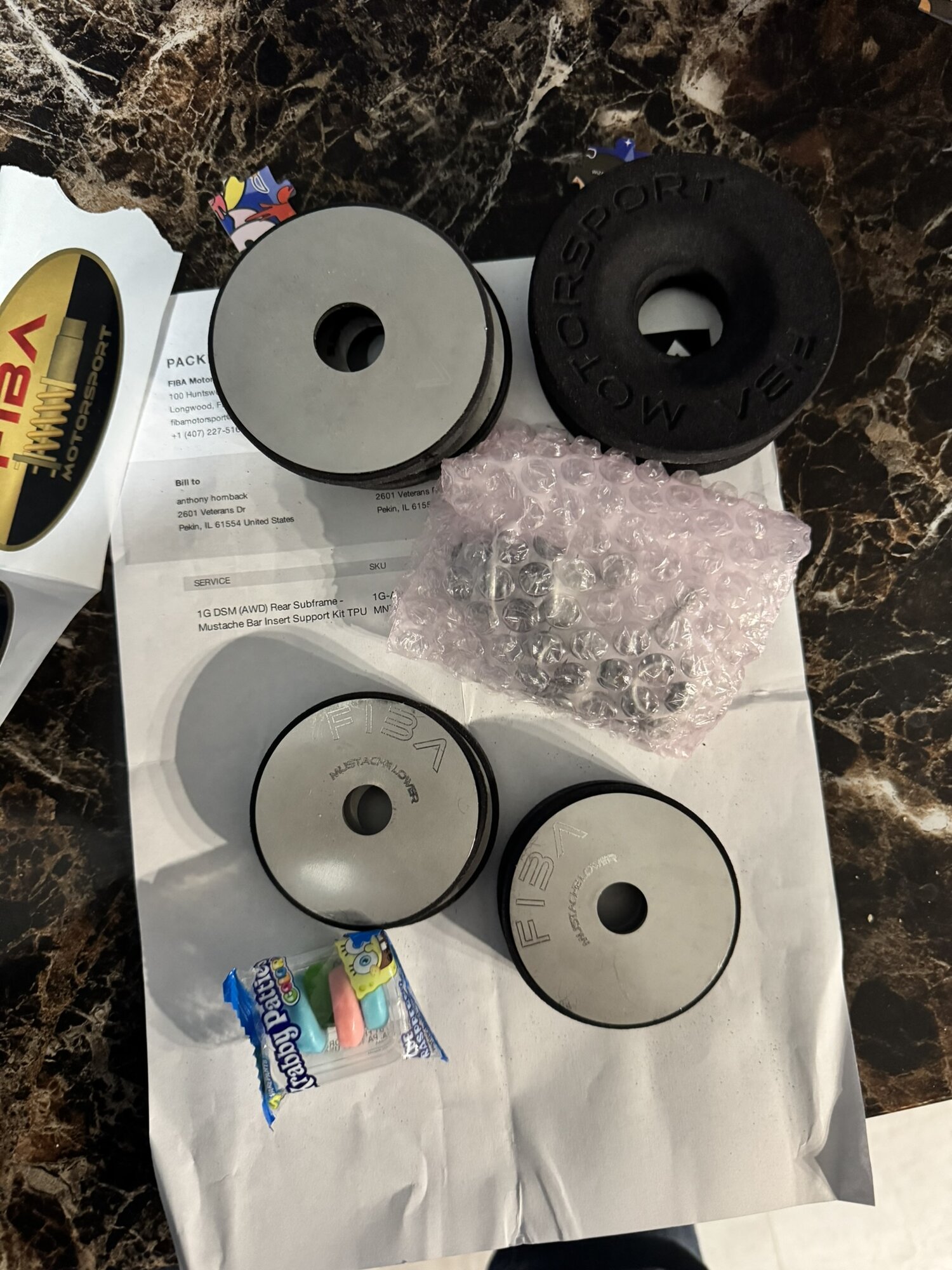

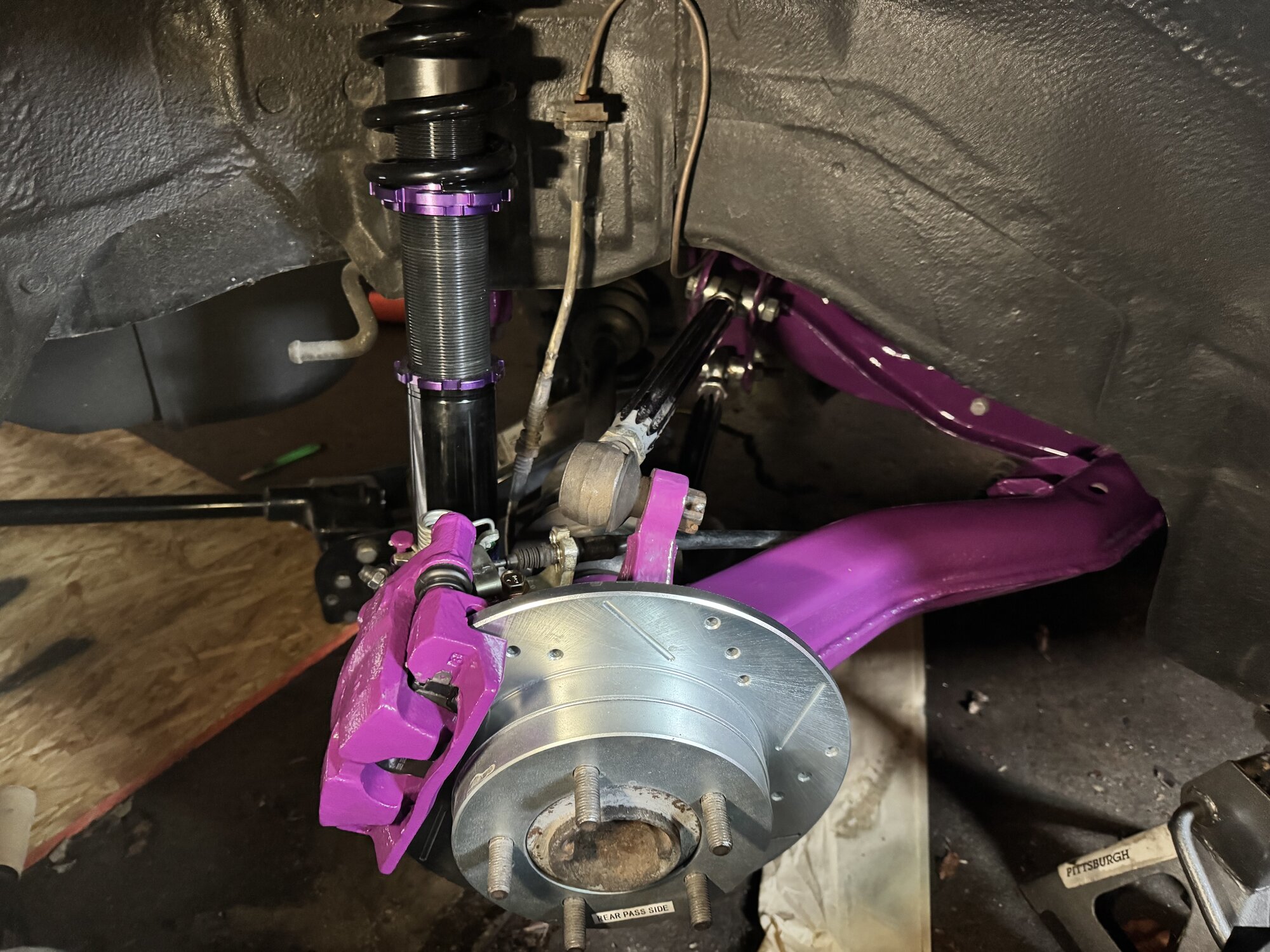

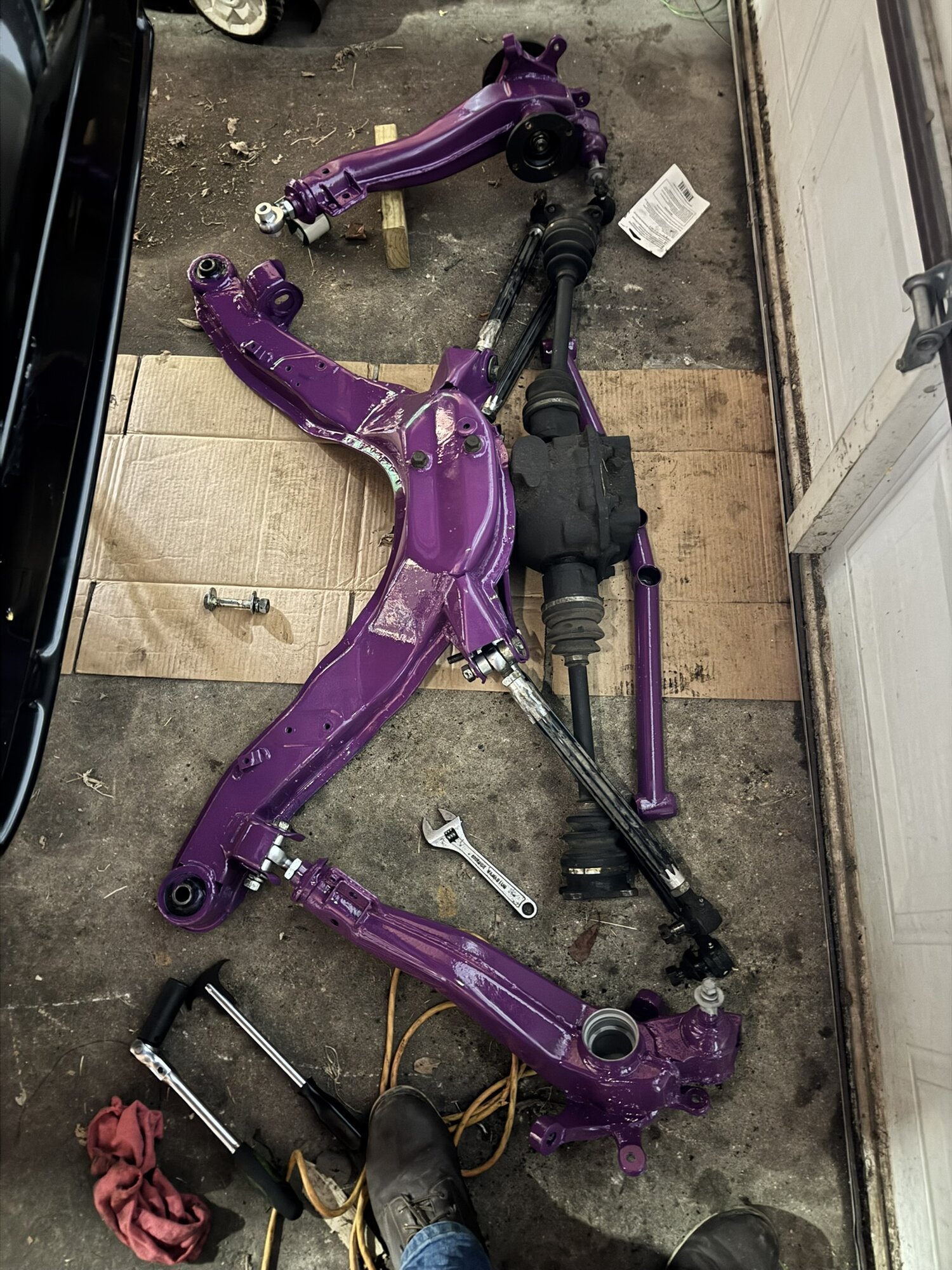

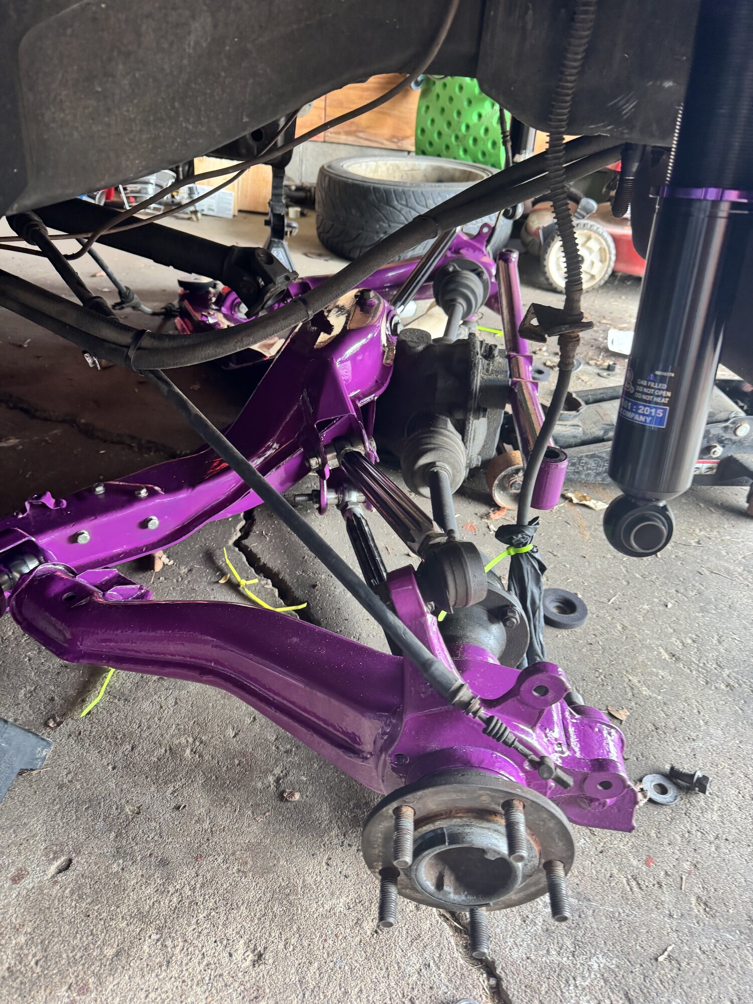

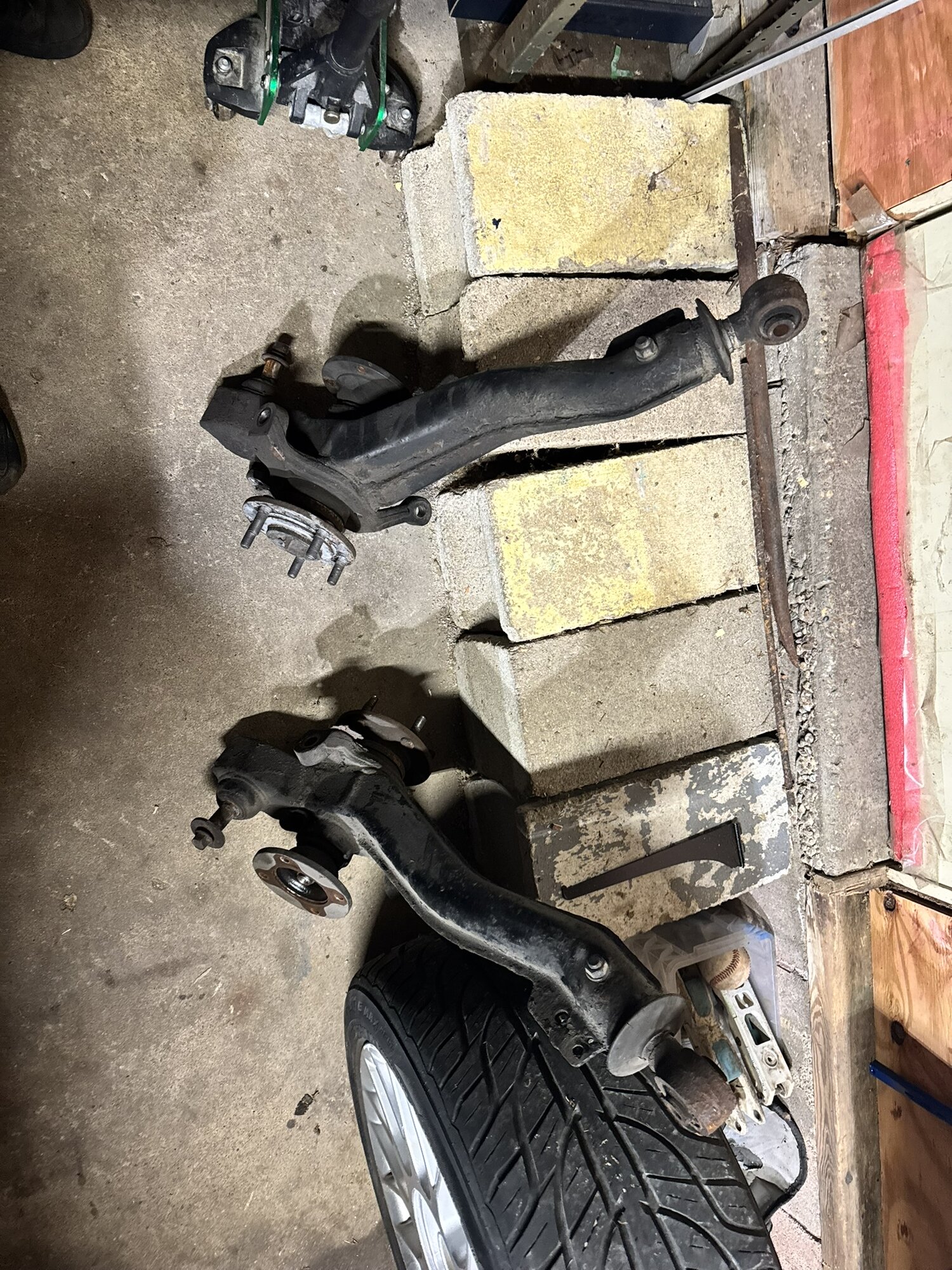

Dropped the rear subframe to install some fiba Inserts, New wheel bearings, toe eliminators, and clean up the trailing arms. I noticed that 1 of the rear diff threads is stripped where it bolts to the mustache bar.
Has anyone ever Helicoiled this or should I have it drilled and tapped the next size up? Any feedback is appreciated
On the bright side the rear sub looks super clean.
I think thats what Im going to have done as well. I dont want to have to drill out the mustache bar as well thoughI am in the exact same boat, just tore everything apart and both the bolts on the mustache bar came out with the threads and all. I am going to step up a size and cross my fingers.

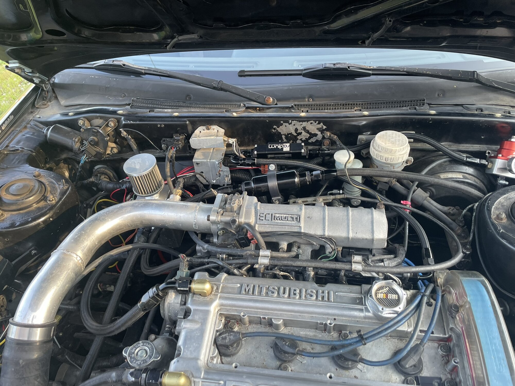

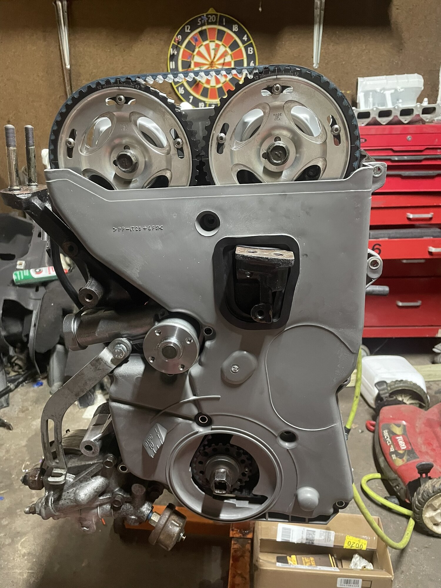

Sort of. There is no seal behind the balance shaft tensioner.Yeah all new oem seals and gaskets but didn’t change the bs plug. Isn’t there something about a bolt that leaks after bs delete?

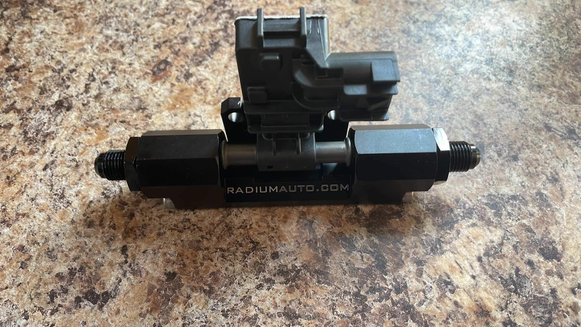

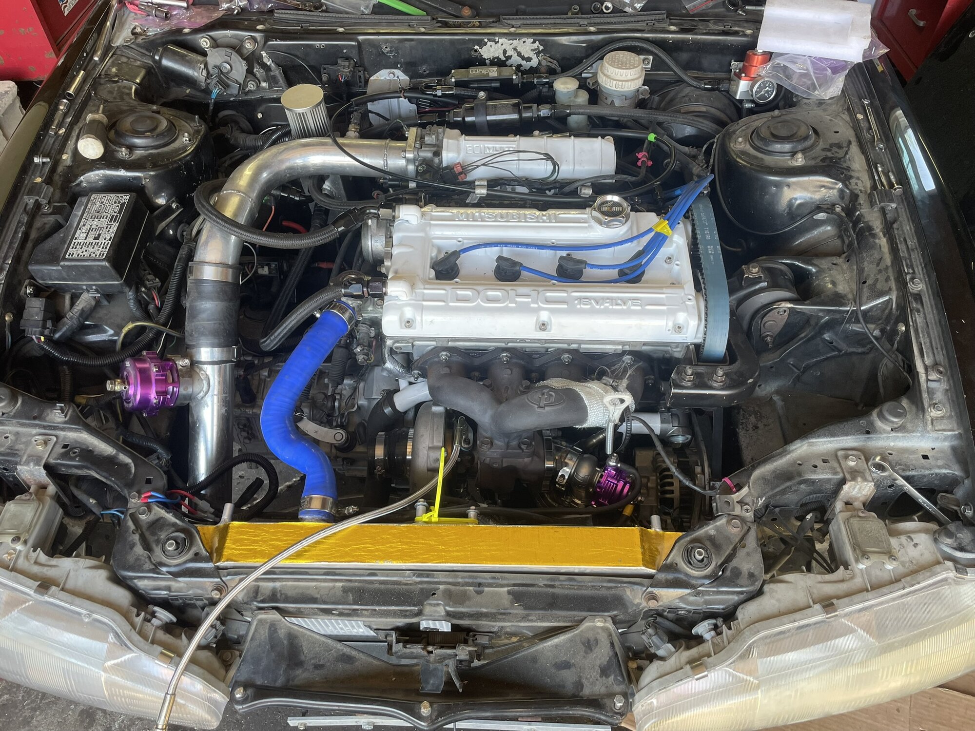

Depends on what youre most paranoid aboutSo I have AEM series x and a boost gauge. I’m ordering a glow shift oil pressure gauge soon, what other gauge would y’all recommend? I would like at least one more to fill the dual pod in the air duct.
I have been thinking of fuel pressure, and wiring it into link. would be nice to monitor during boostDepends on what youre most paranoid about... coolant temp, oil temp, fuel pressure or voltage.
