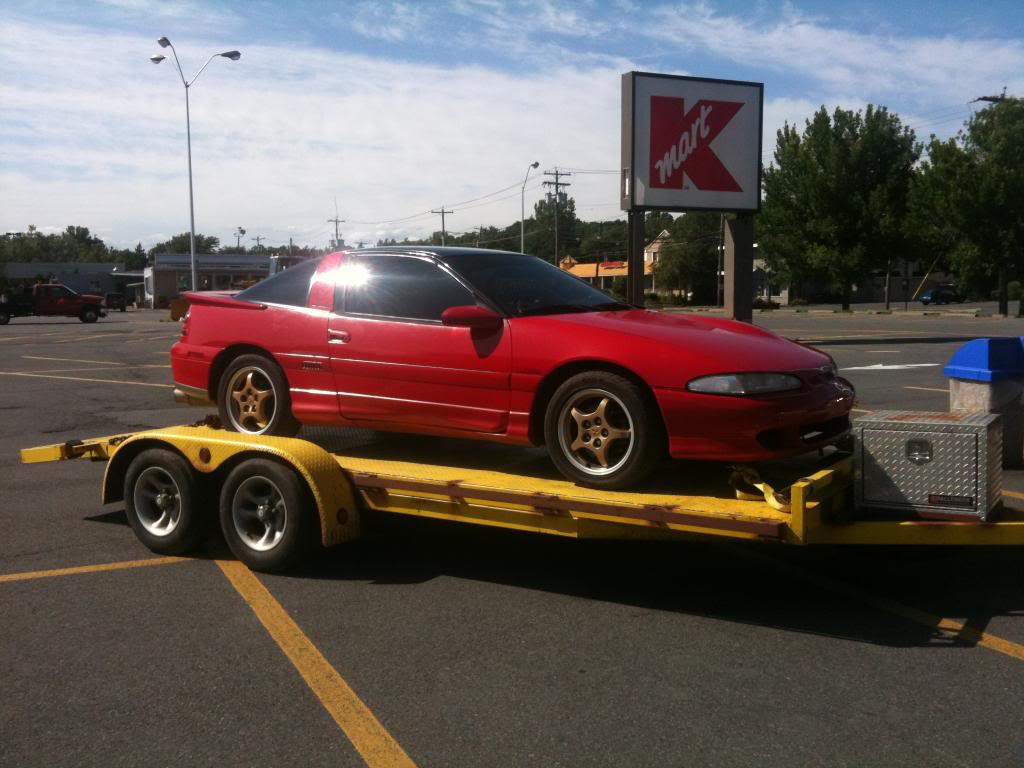

So I was tired of my '90 laser RS turbo FWD always burning the tires off it and never being able to get anyone from a dig, so 2 years ago I picked up a '92 Laser 6/4 combo in Albany,NY for $2650.
I found out after owning the car for awhile and never driving it that 1st gear in the trans is straight cut. The previous owner had the car running 11's with an hx35. He tried selling it for 3500 in that configuration but no one wanted it so he put it basically stock and someone bought it for 2k right away, 3 days later I picked it up.

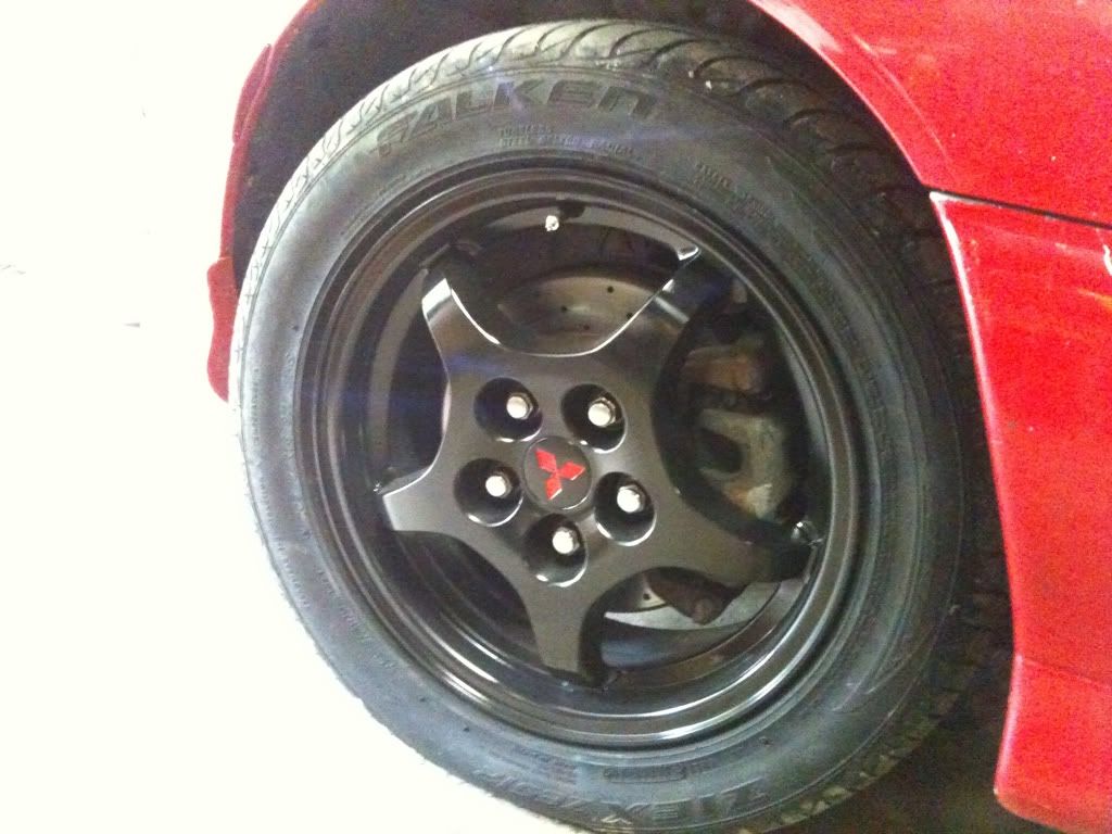

The wheels had to get changed.....
A very good investment.

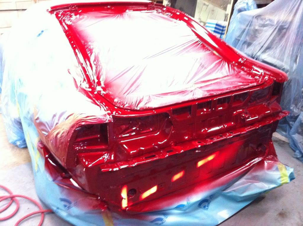

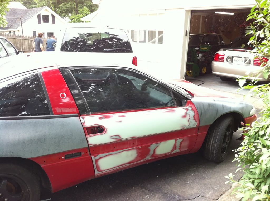

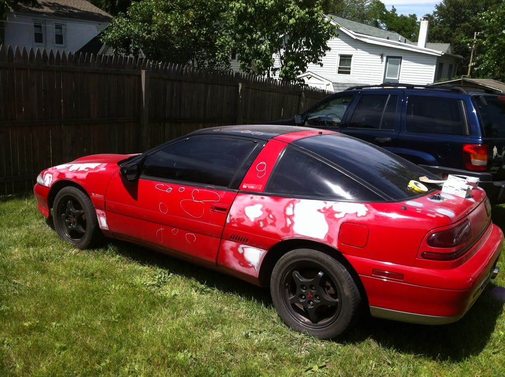

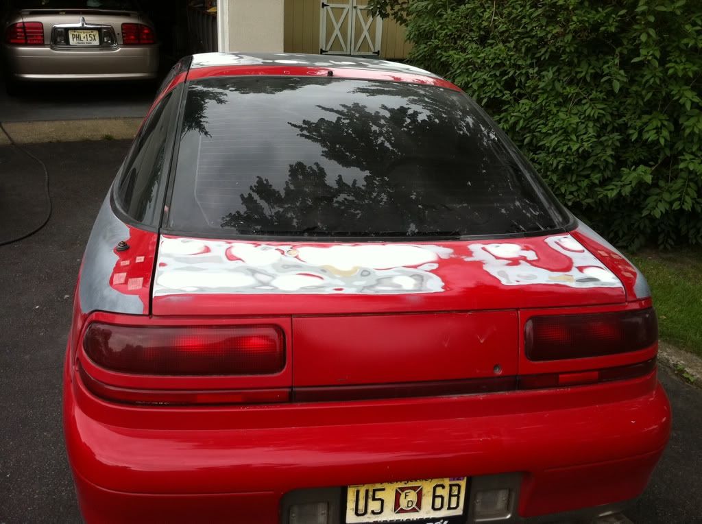

I decided I wanted to fix all the dents on the car and as I was at it why not put a hot new color.
Waffled doors, where?

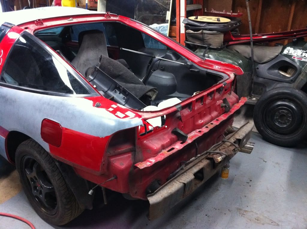

Holes had to get welded up and covered so I can re-drill for the new Talon 3 piece. I tried rocking it wingless but my girlfriend thought I stole my grandpa's car ha.
Time to start edging out the car, I dont want one of those exterior only jobs, go big or go home:hellyeah:

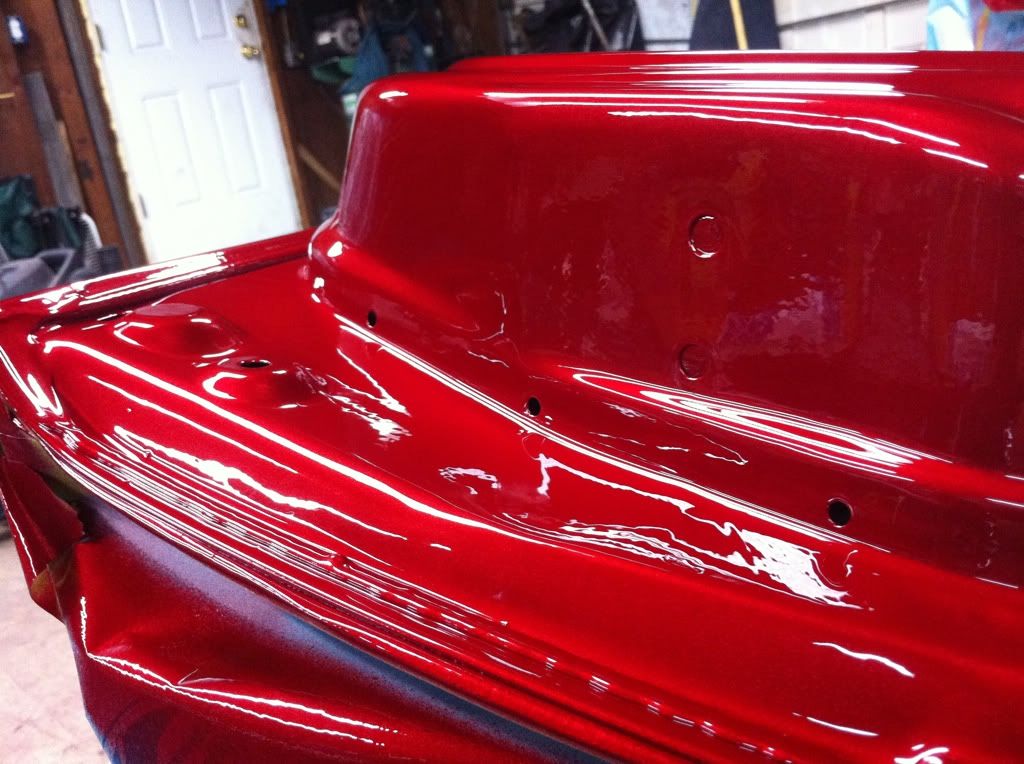

Dodge Blazing Red Crystal / ARH is the choice, perfect blend of red pearls and gold flake.

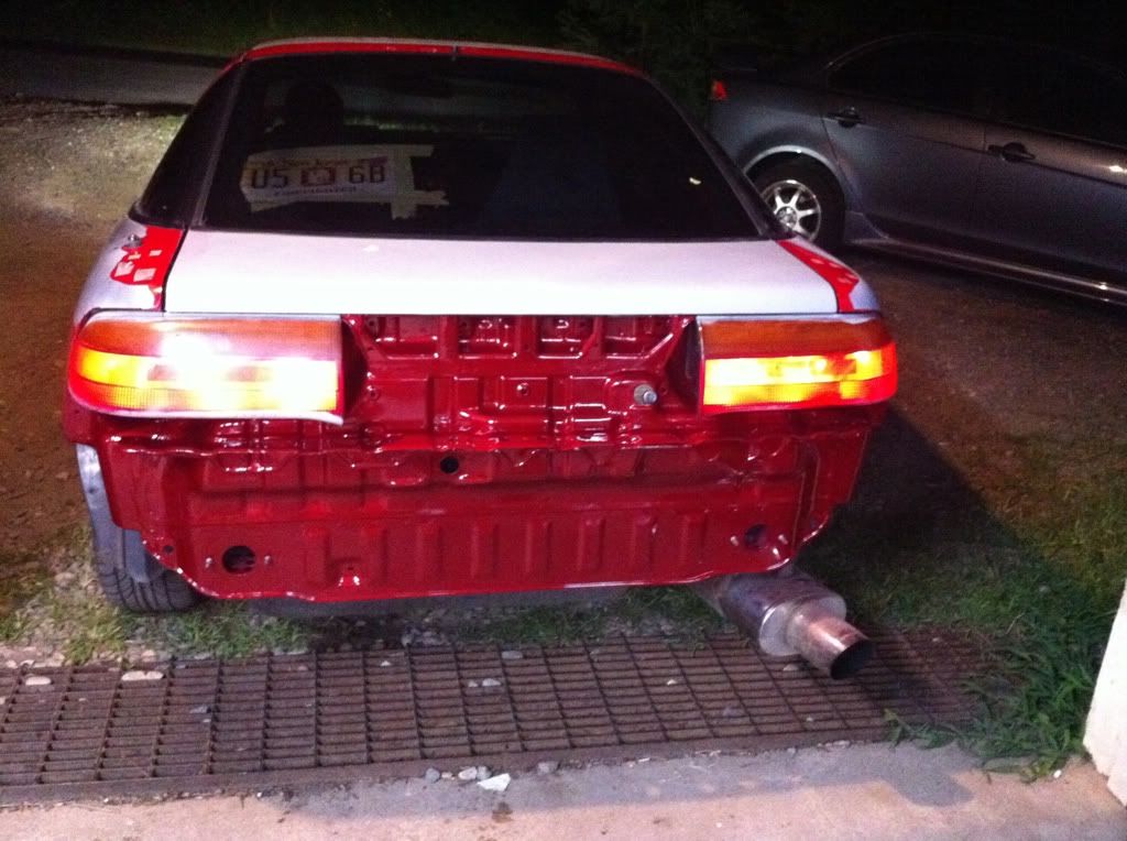

I had everything out so I could change the lights and bumper so why not?

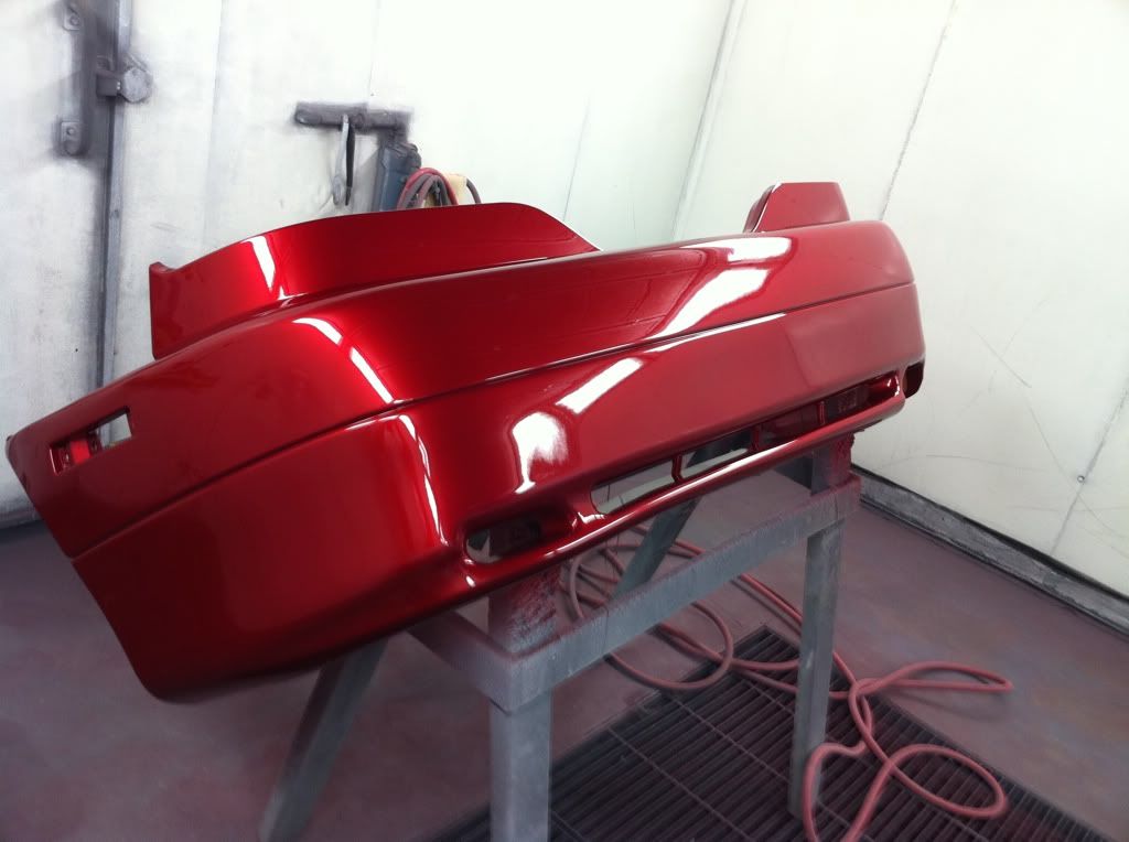

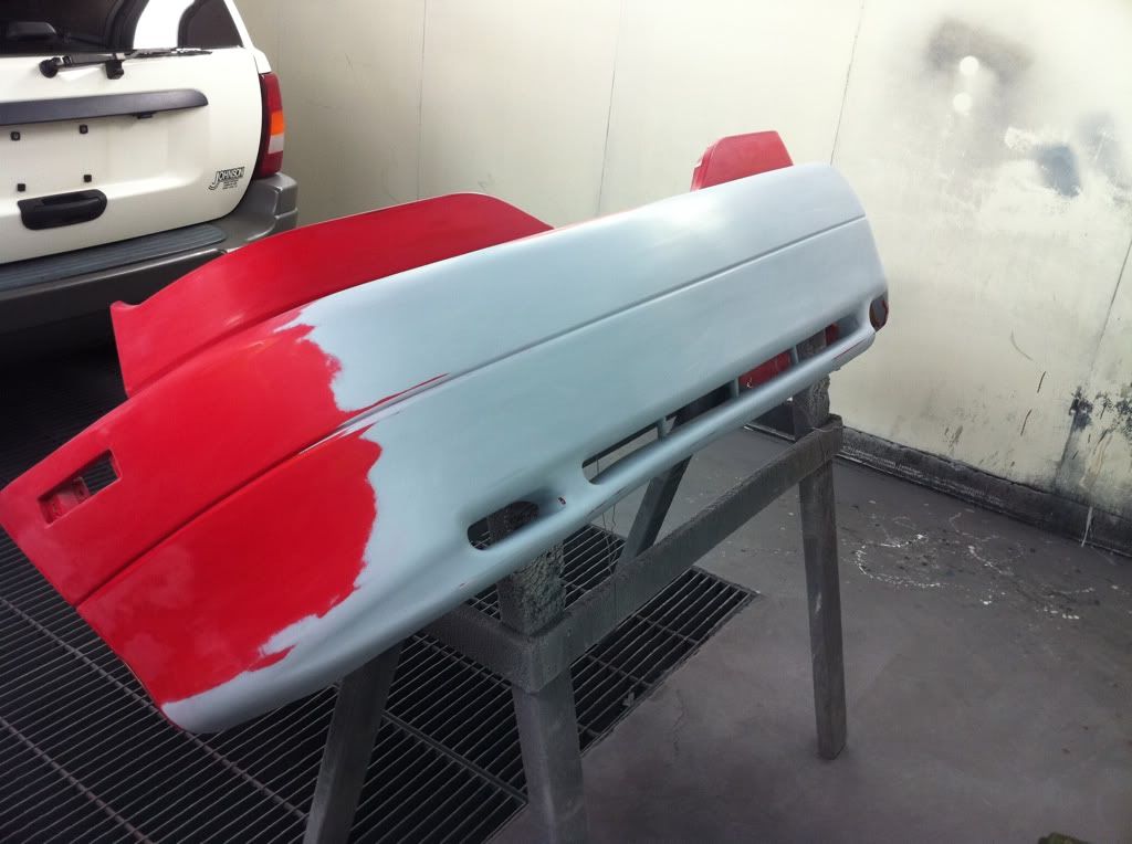

The bumpers weren't in the best of shape so they needed to get fixed as well.
and painted
In the pic it looks like the car and the bumpers are different colors...weird WTF

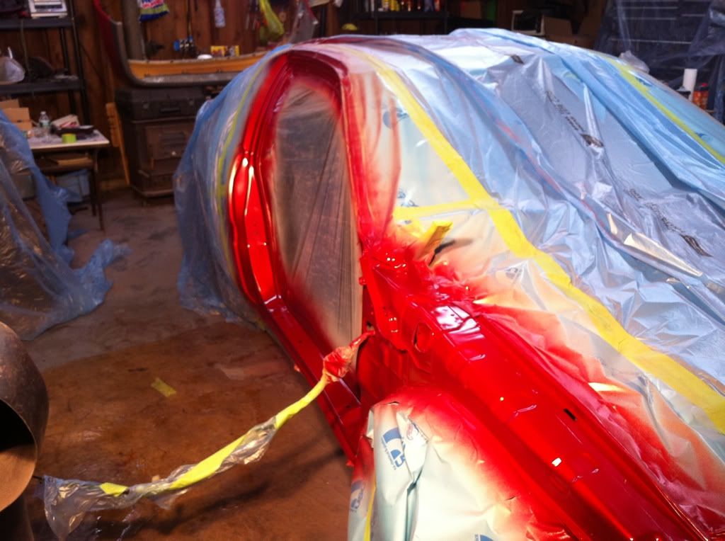

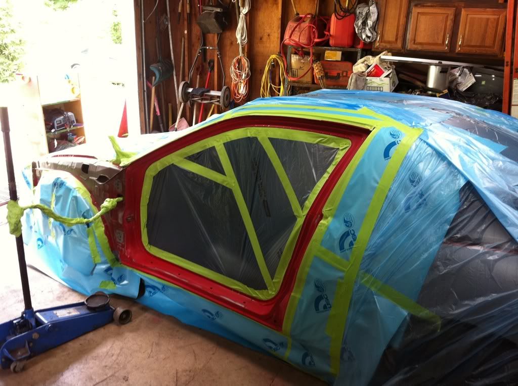

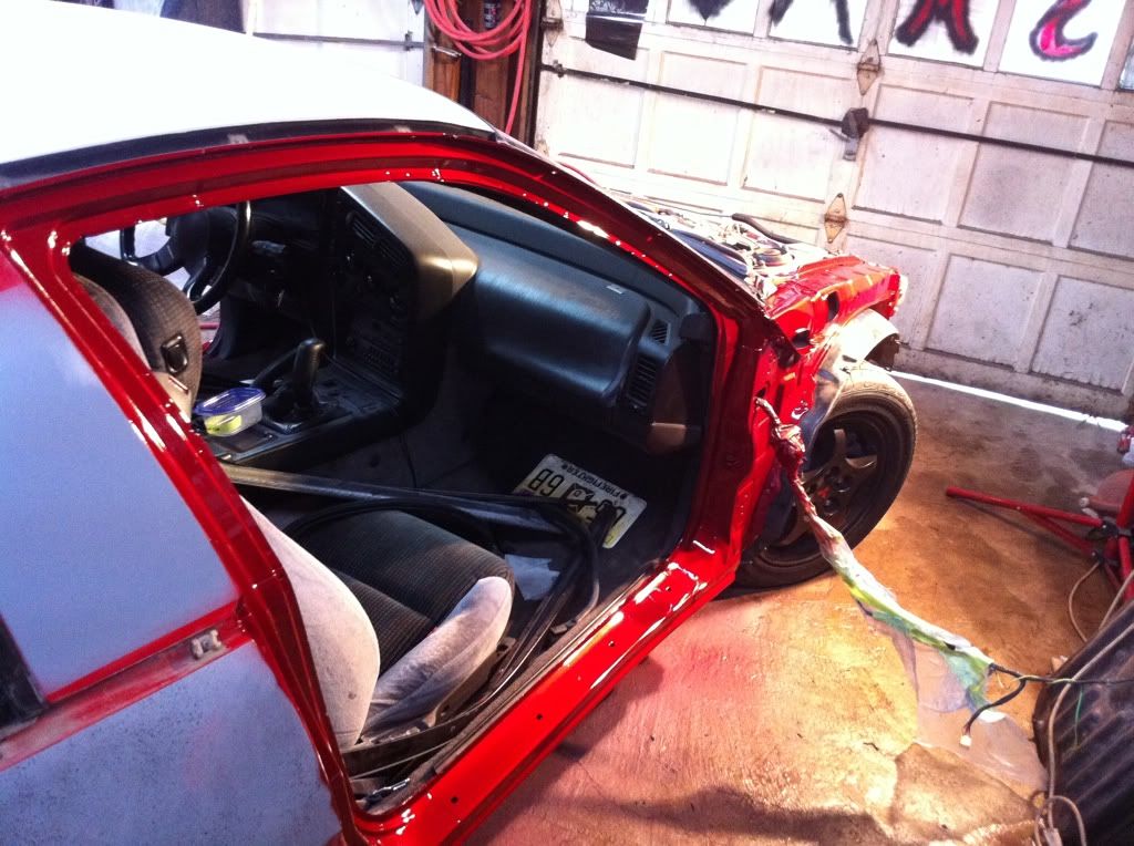

time to start on the jams
nice masking job

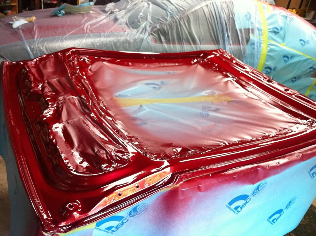

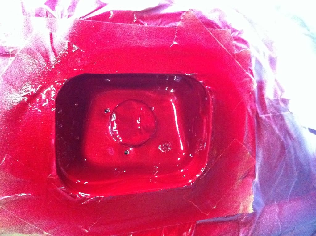

I know under the fenders are covered but why not?
What do you think?

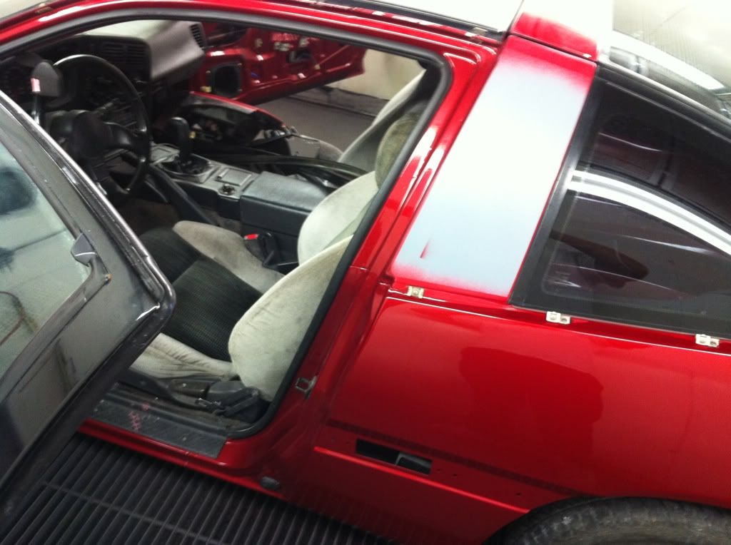

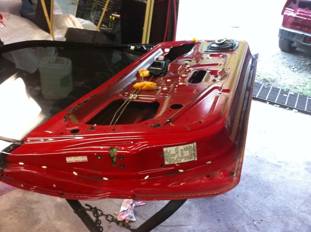

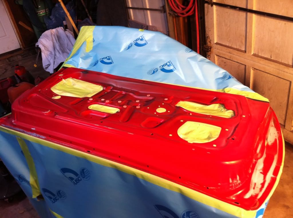

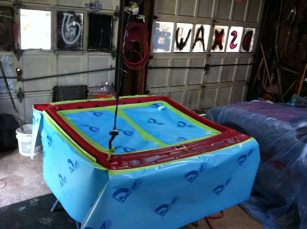

time for the doors

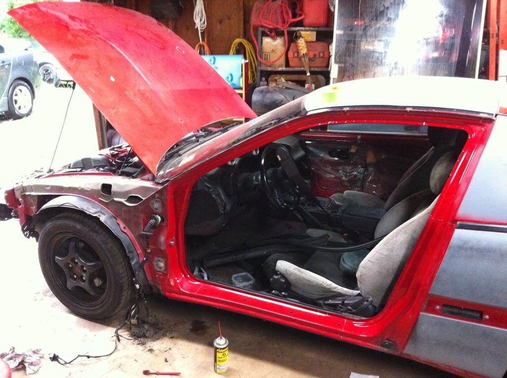

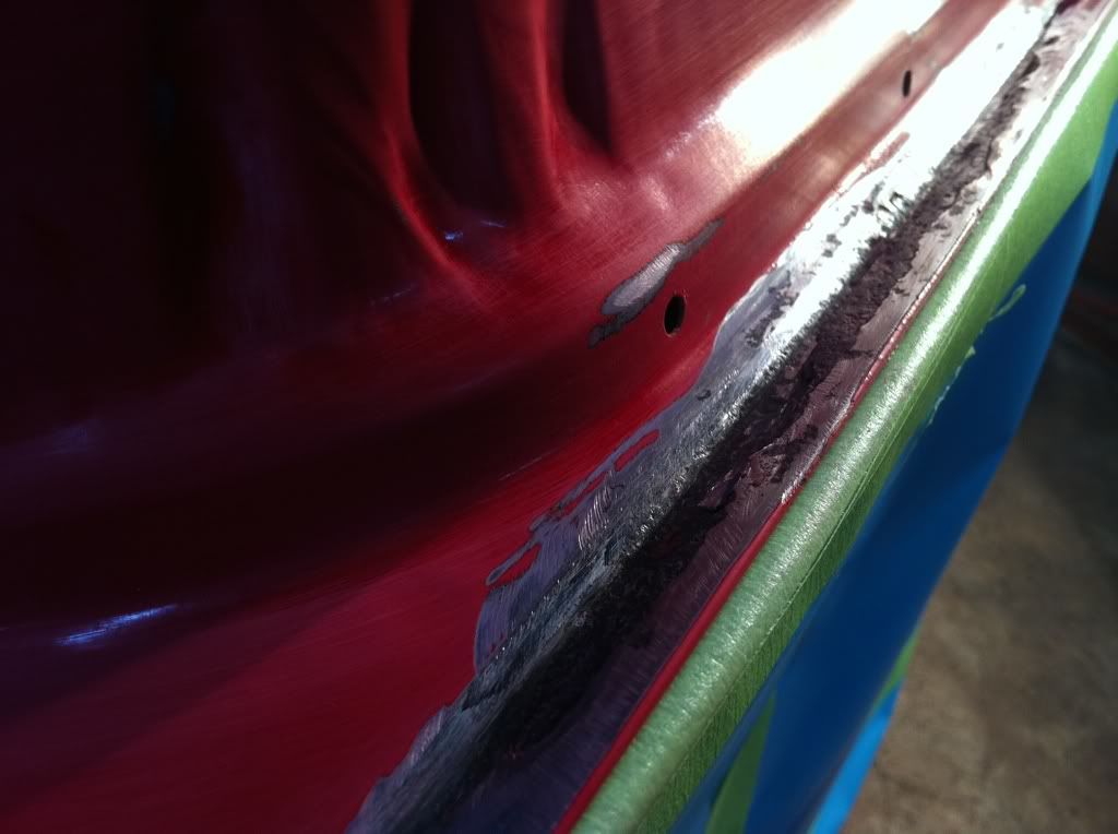

Ground most of the cancer out

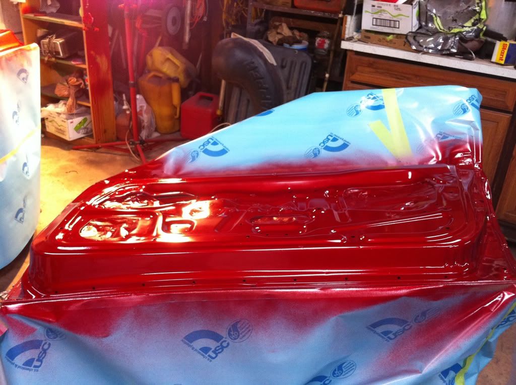

Sealer, base, then clear.

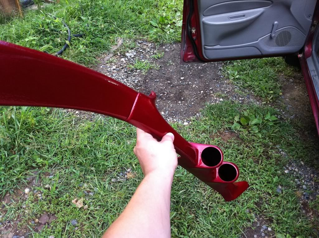

color matched a-pillars, and pods?

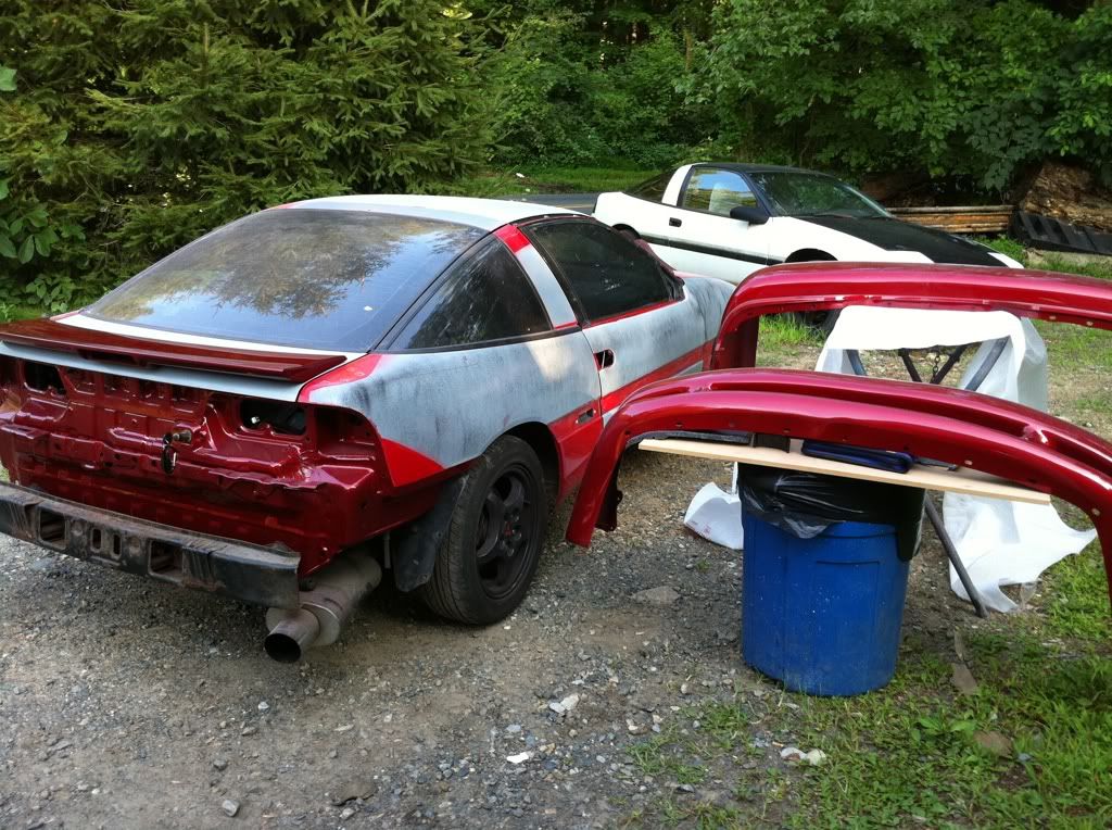

Ok so this is how far I got on my car up to last week. I will be hanging my doors and after that finally sanding down and painting the rest. I will be doing the roof and pillars black. I know probably some of you are thinking "why would you ruin such a rare car for the most popular 1g..." but the answer is because I have gone too far to turn back now. My brother continuously busts me about converting my laser to a talon but I'm sure when its done he'll be speechless.
Don't think for one second that this is going to a typical "All beauty No beast" car. I hate cars like that. I was able to put so much attention into the exterior because I currently work in a body shop and could do my car for a fraction of the price it would cost anyone to get it done.

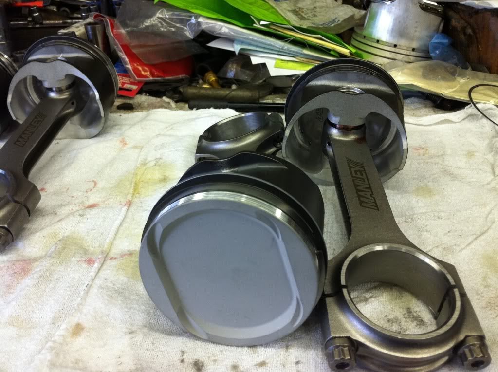

Manly H-beam Connecting Rods

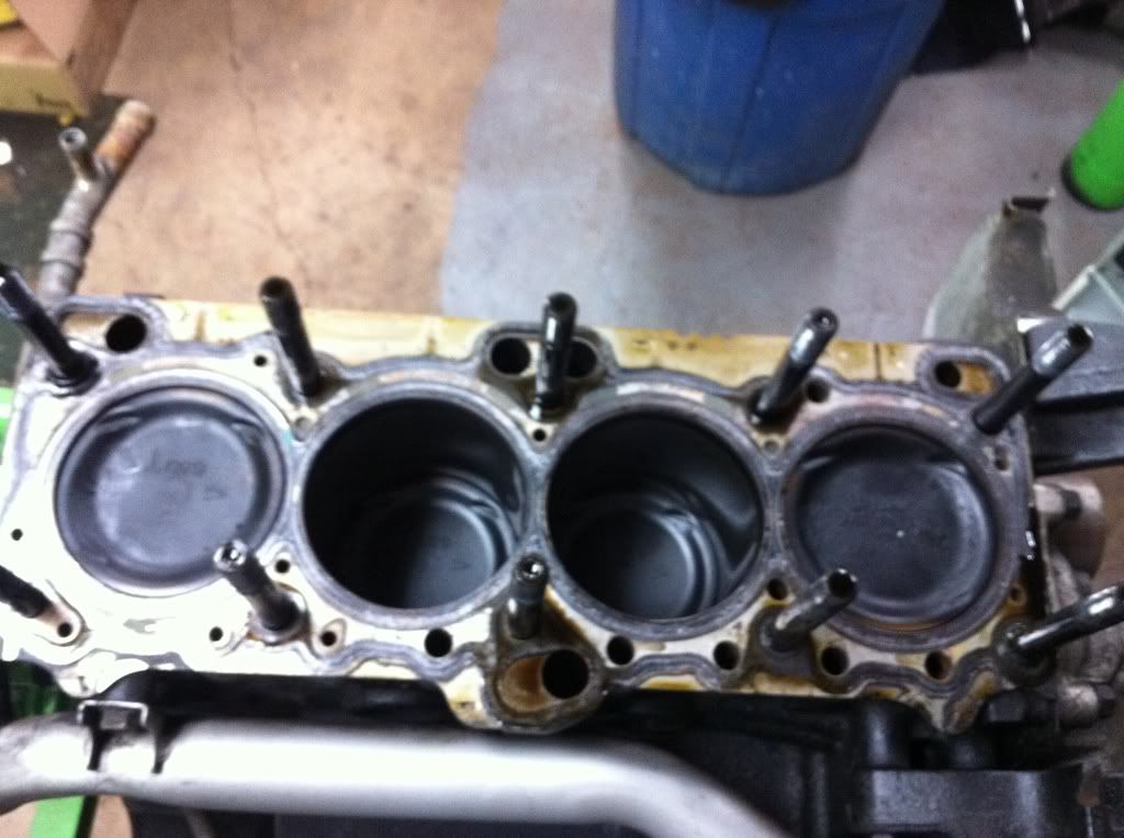

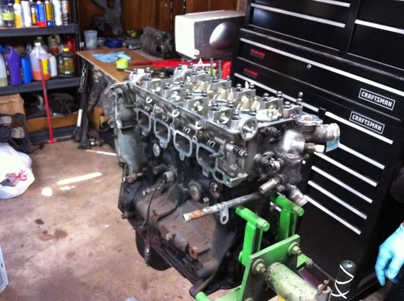

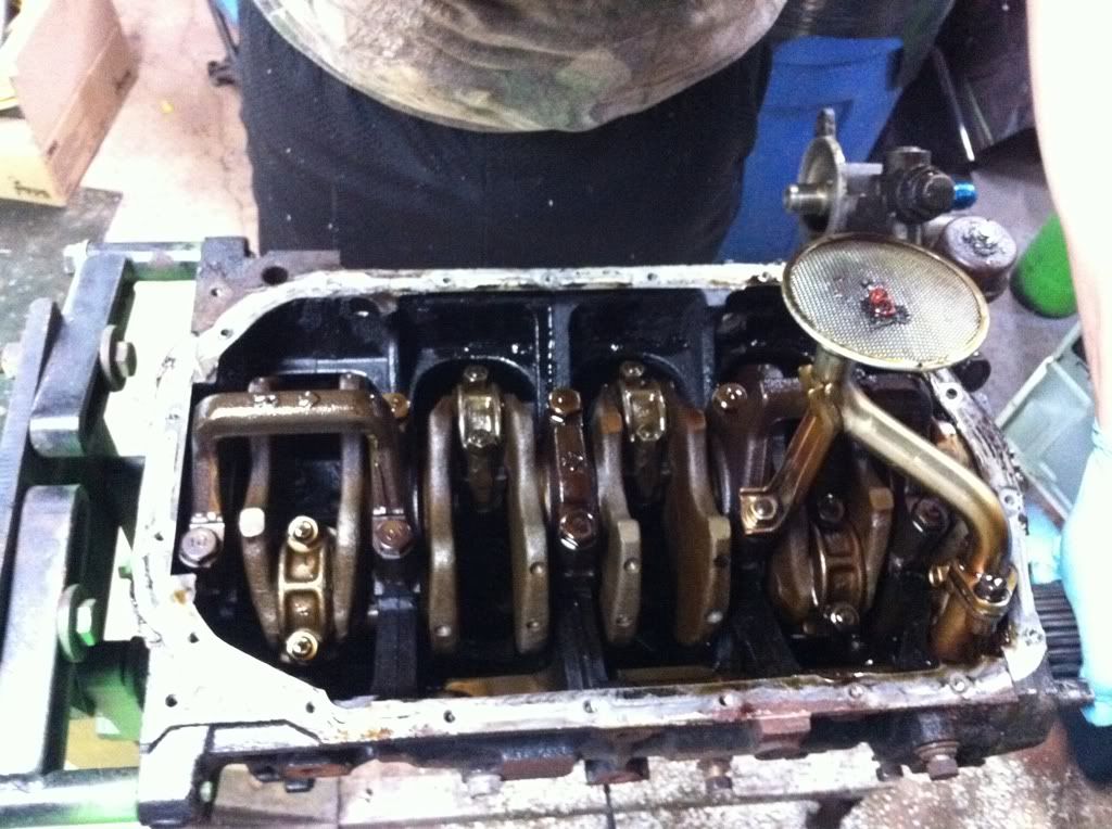

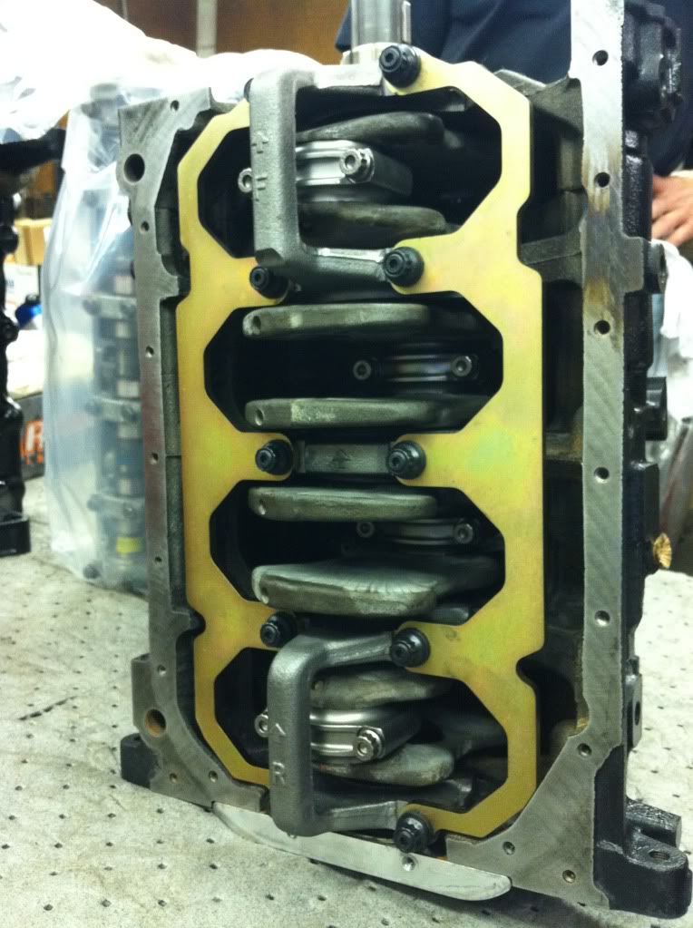

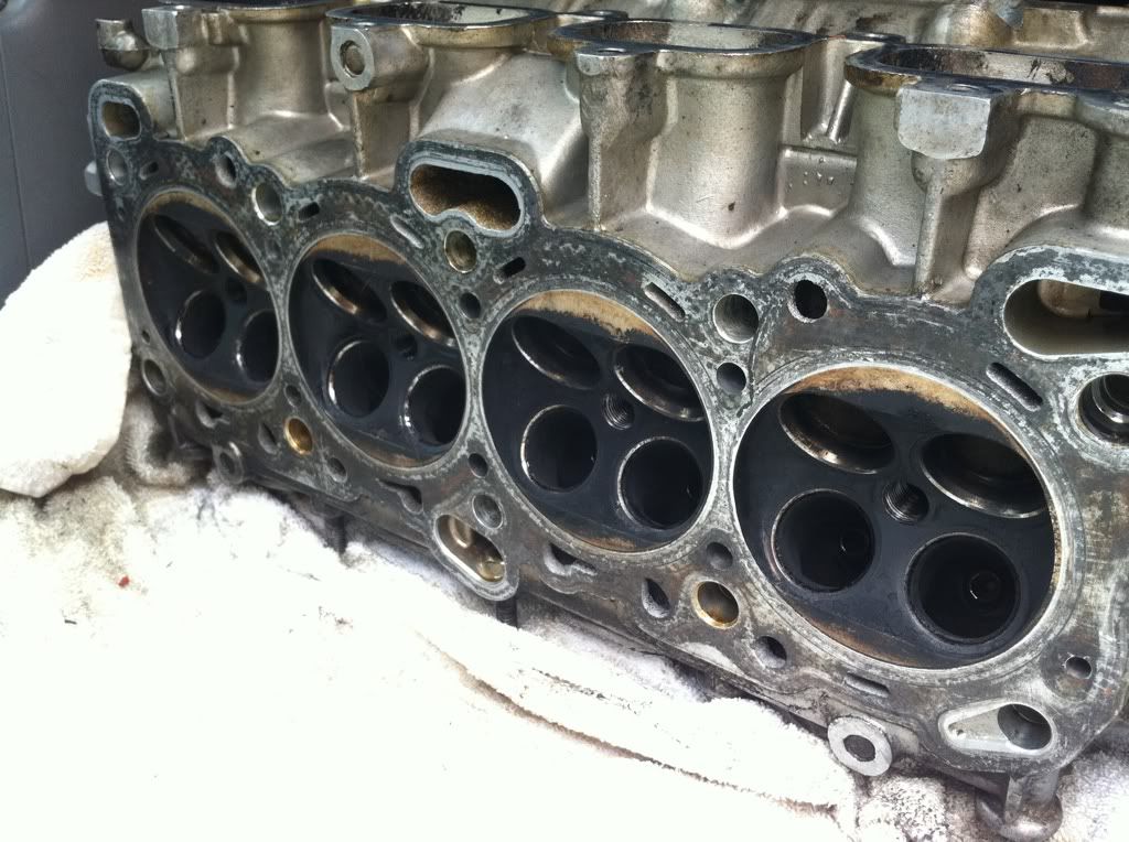

Here is the motor 3 hours before bringing it to the machine shop.
looks like some valve rub going on in 2 of the pistons
So that screen does filter out RTV and other debris that is healthy for the engine haha.

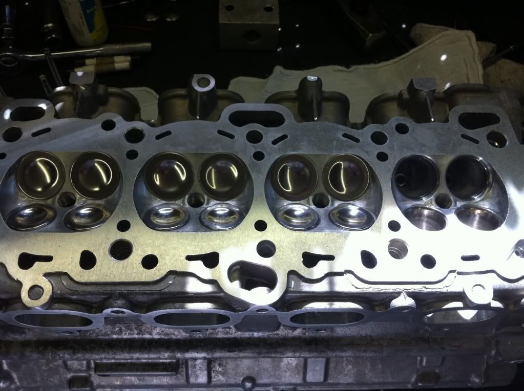

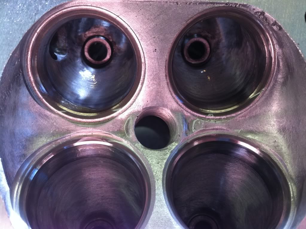

Not the dirtiest but a 3 angle valve job and some porting and polishing shouldn't hurt :thumb:

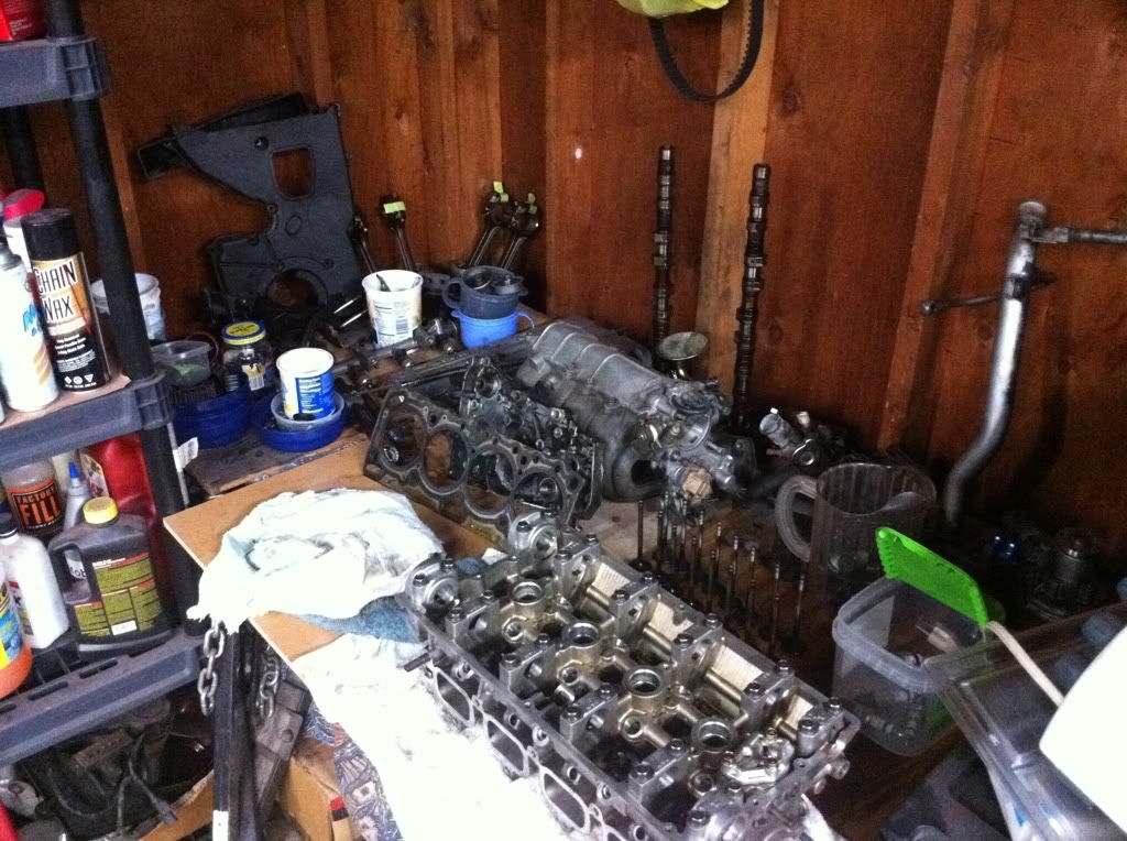

And my corner table full of parts.

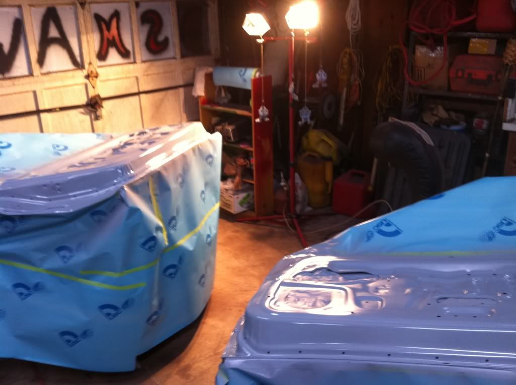

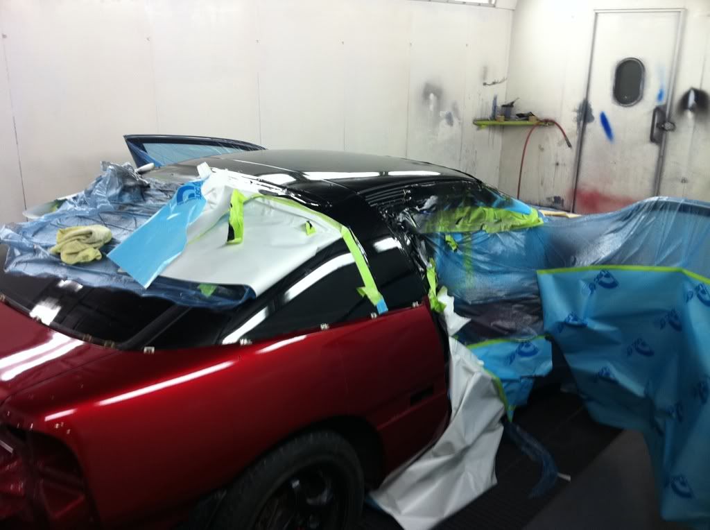

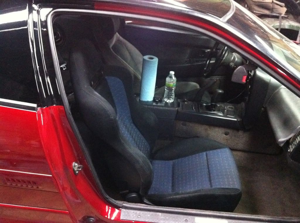

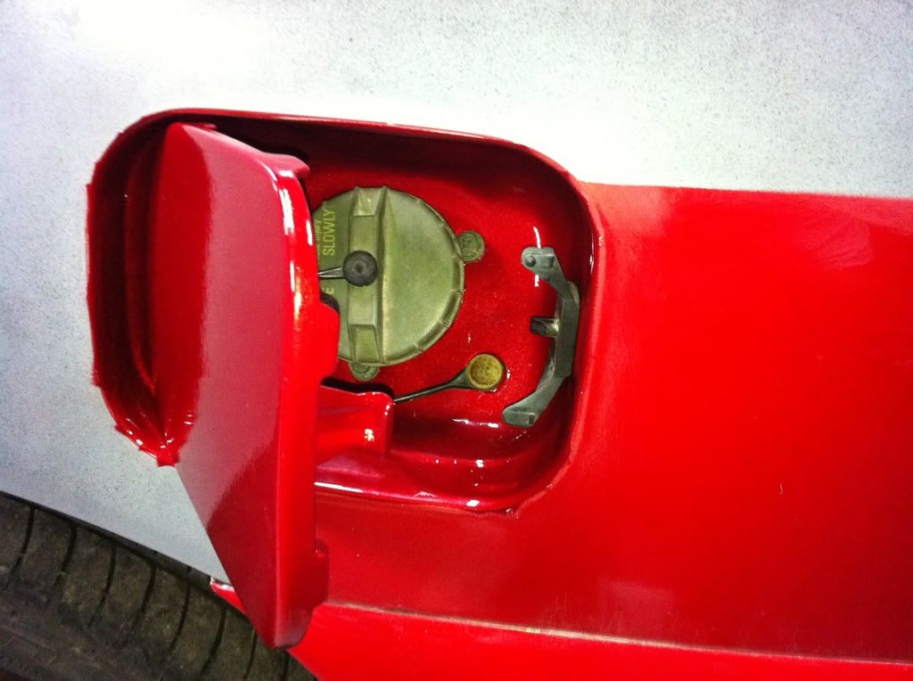

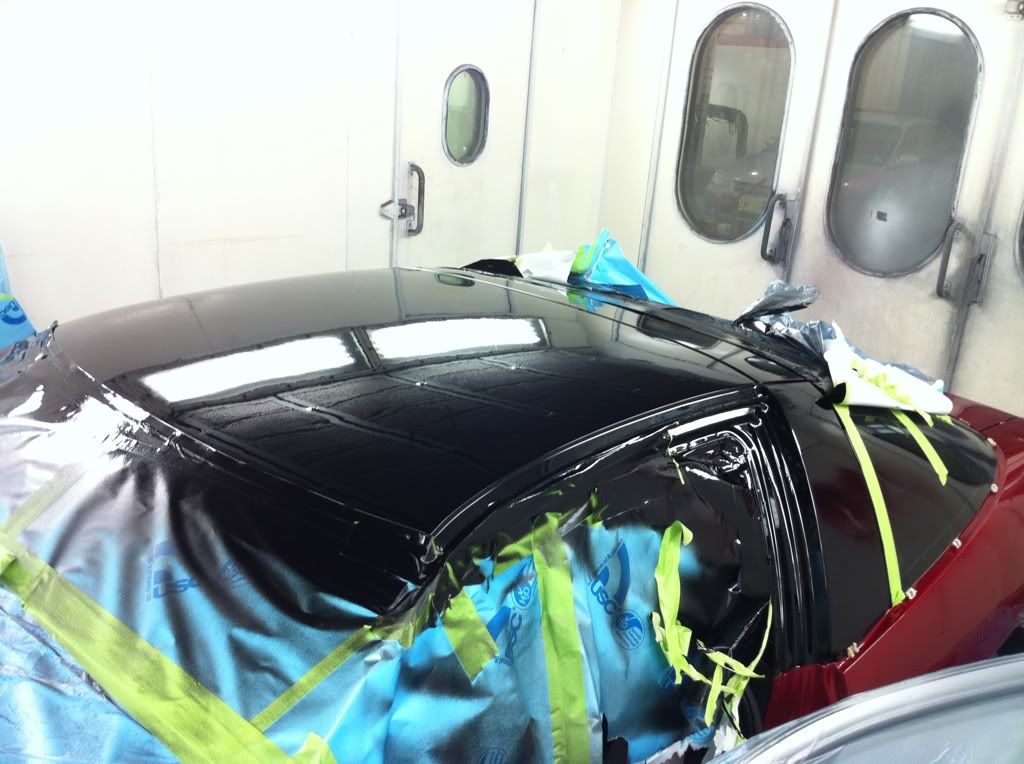

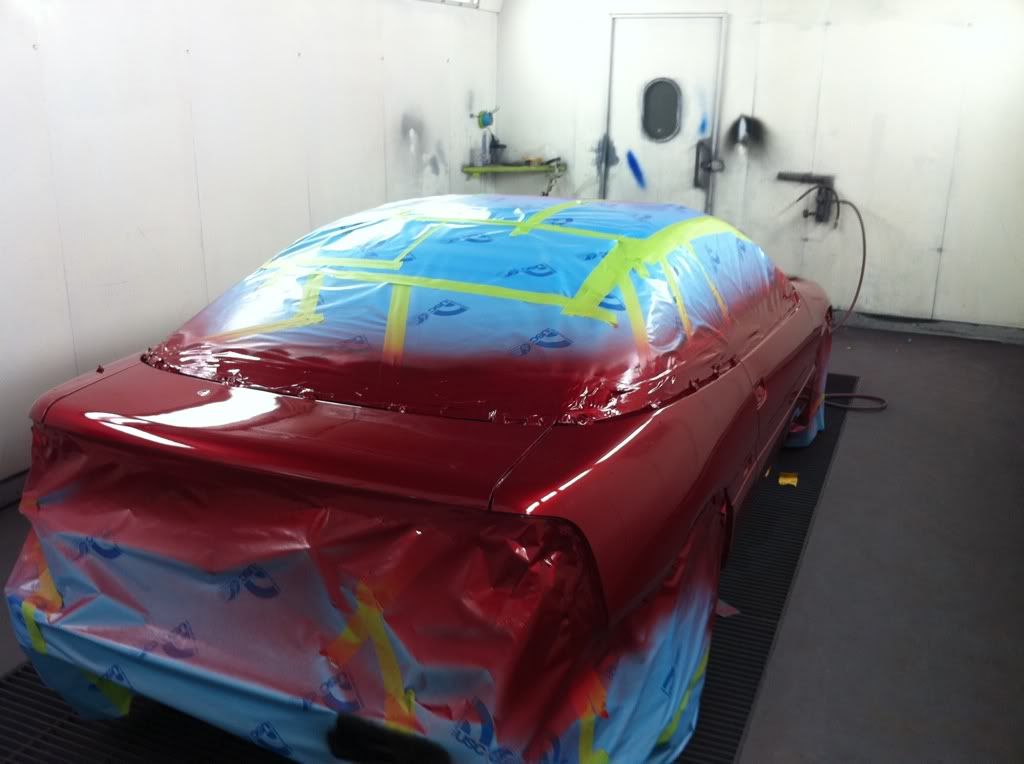

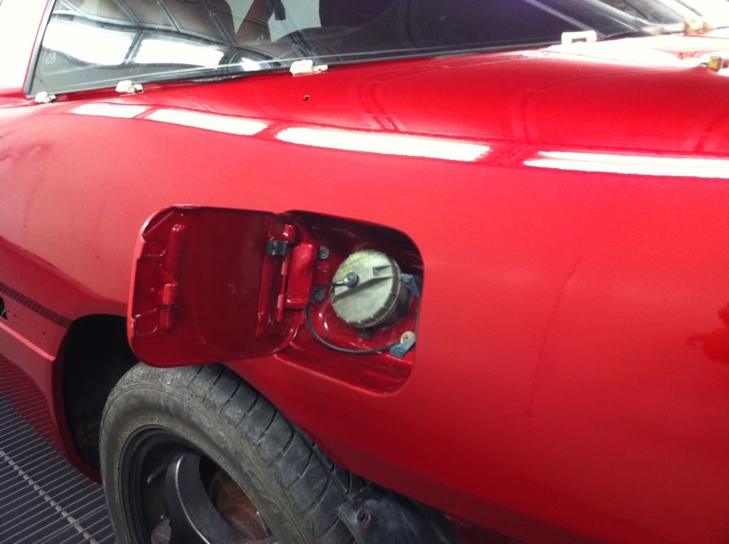

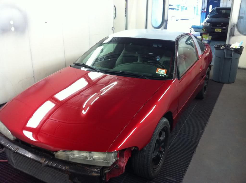

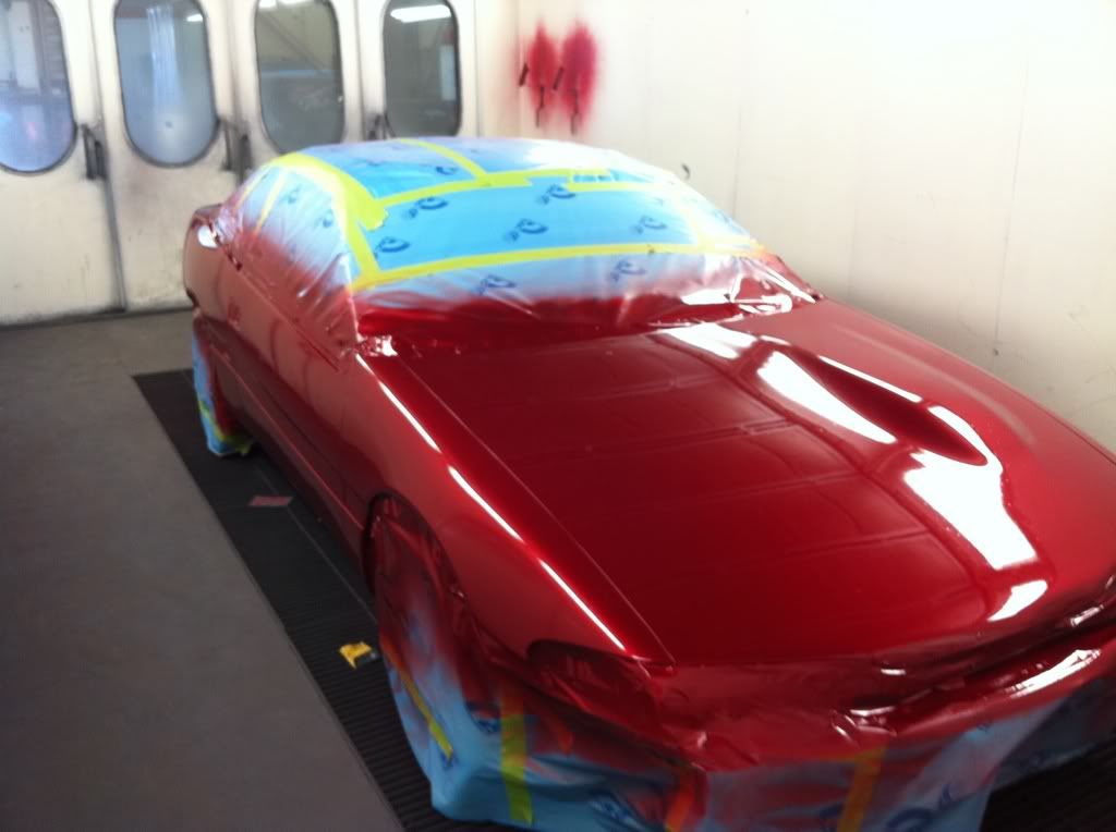

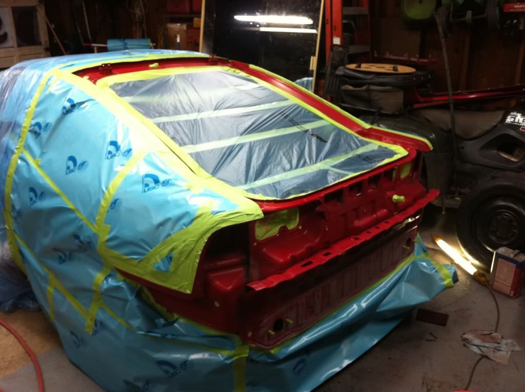

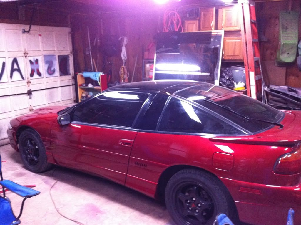

Thanks guys. The car is finally painted and it was painted inside of a booth at work but I edged out all the jambs and things like that in my garage.

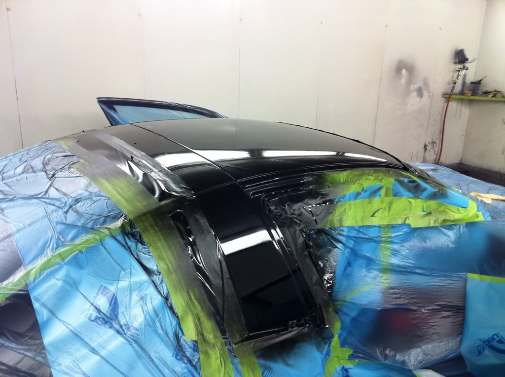

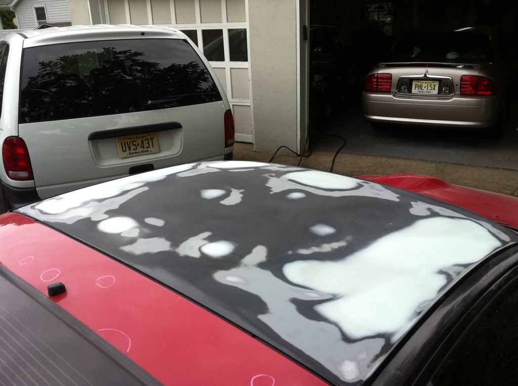

The roof was a couple days later, I didn't have the time or will to do a 2 tone paintjob in one shot.
After some headaches and sweat, finally got the trim back on.
Now that the body is finally finished and all it needs is a set of new wheels.

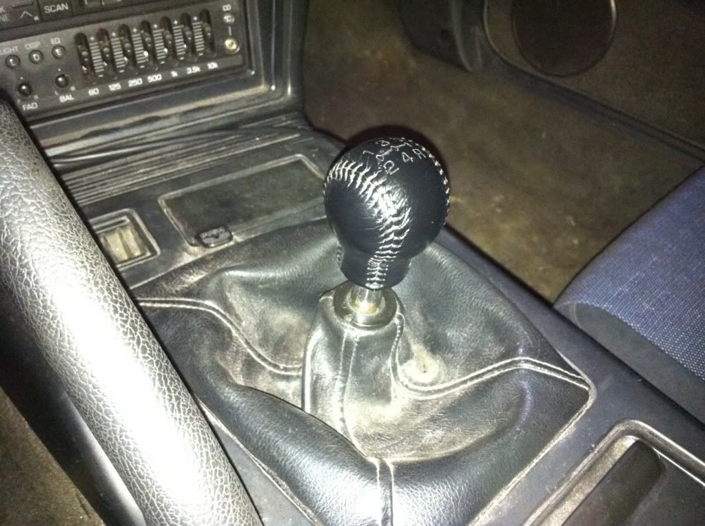

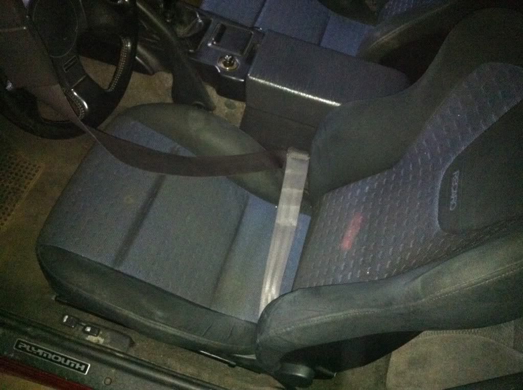

Just a Small treat.
1G lapbelt buckle bolts right up :thumb:

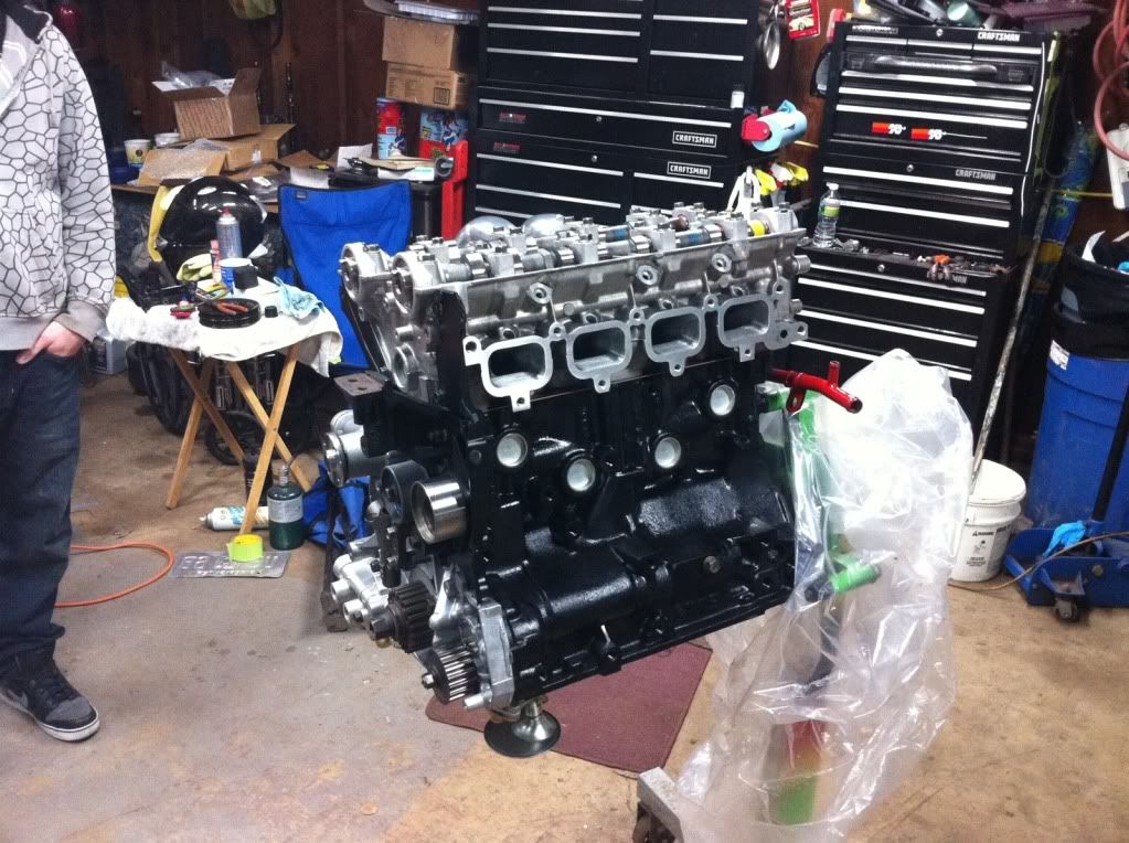

Back to the Motor.

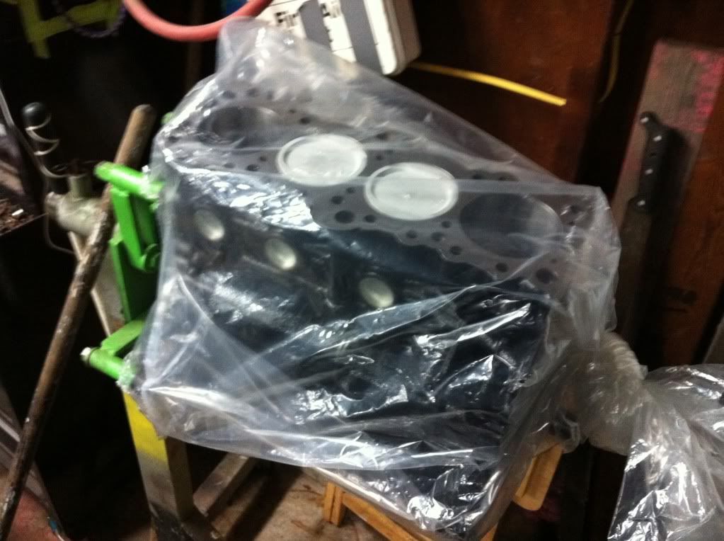

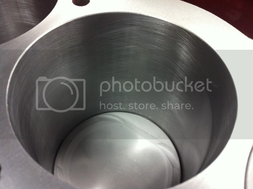

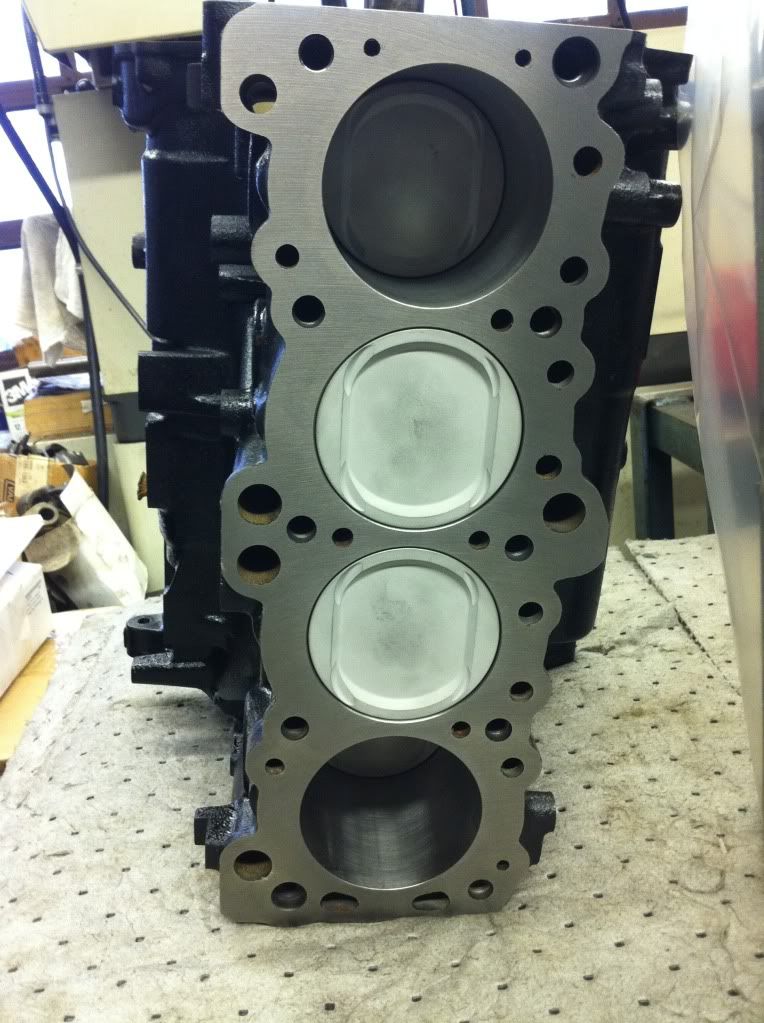

Finally got it back from the machinist with a $3700 total :cry:
But Im hoping when I put my foot into the pedal its all worth it!
ps. this is machining and labor only, no parts other than custom valve guides.
In a bag

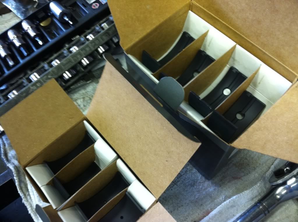

pistons and bearings coated

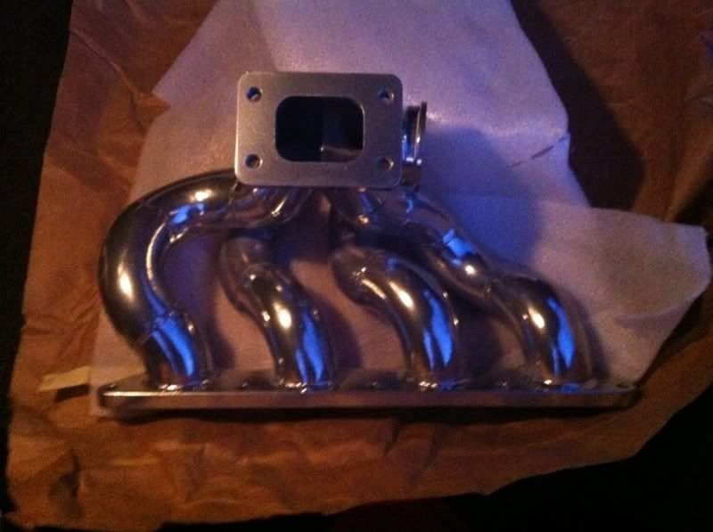

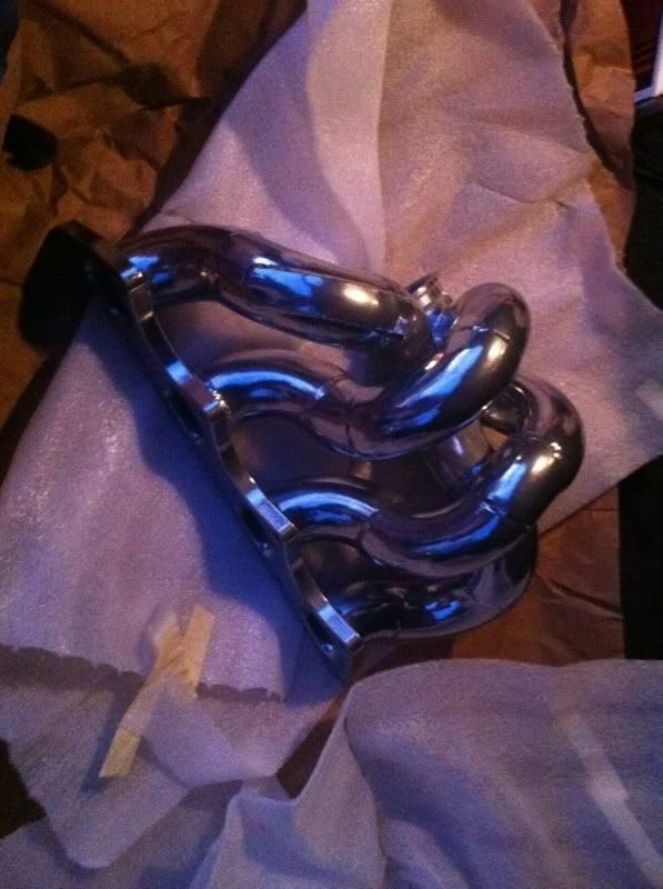

oops, cant forget the headers!

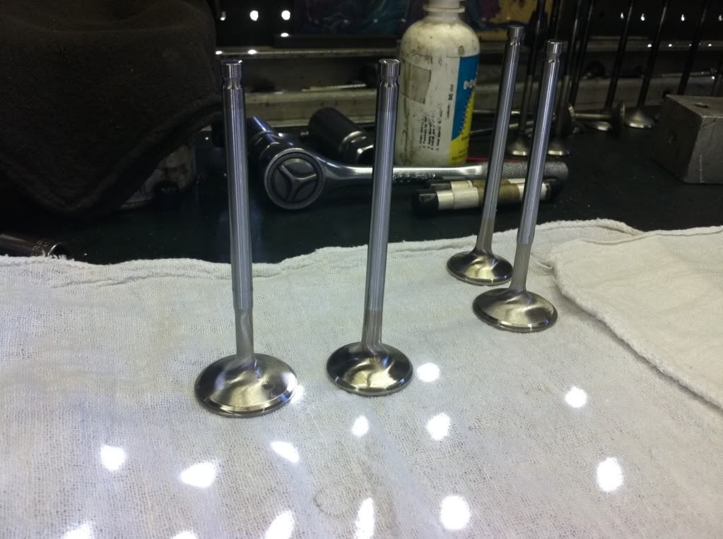

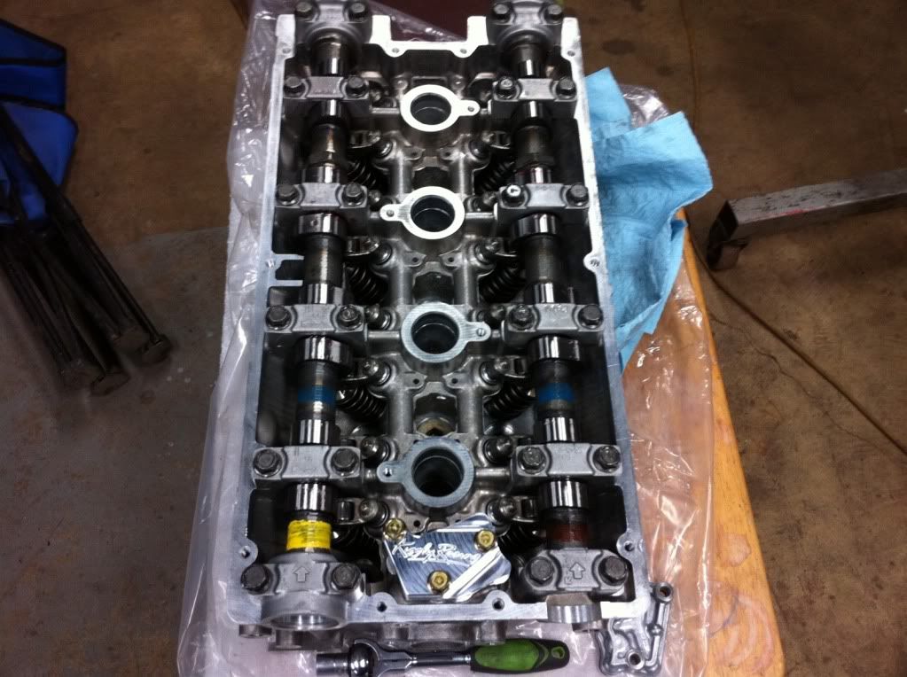

Ferrea Comps
Smoothed chamber

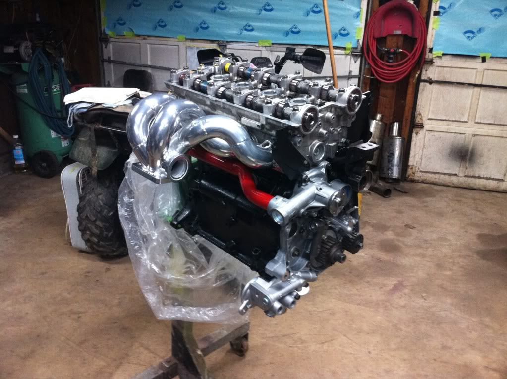

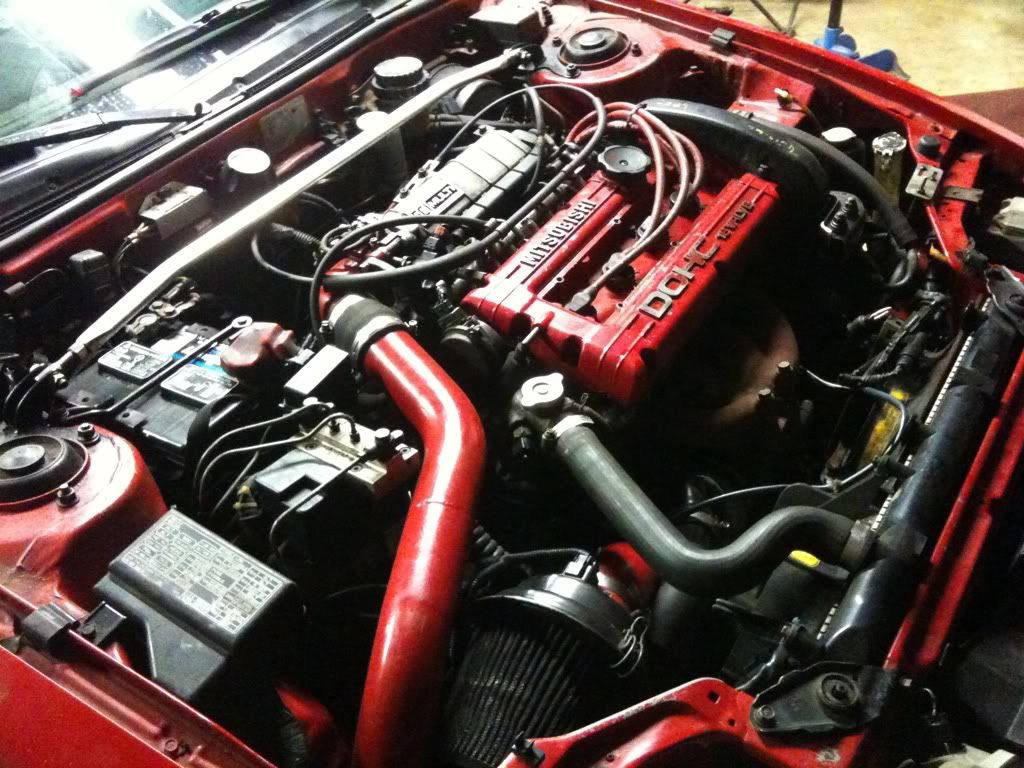

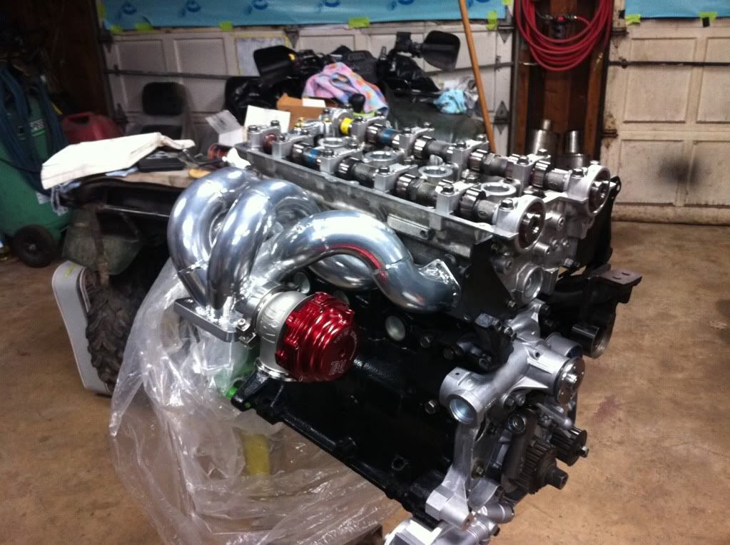

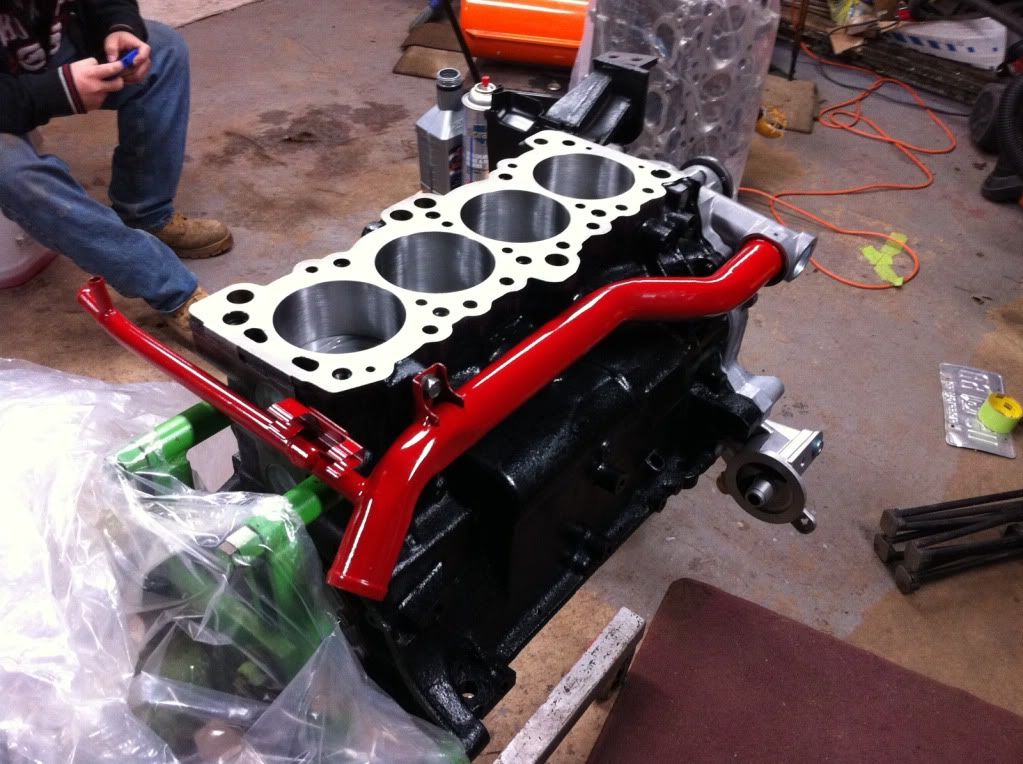

Back to some assembly, and a red coolant pipe.

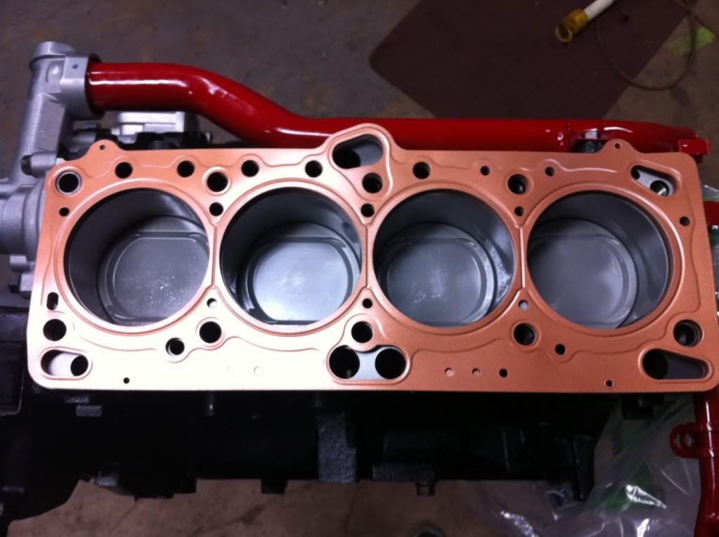

Permatorque copper sprayed with some L19s and a ridiculously chopped power steering mount, BARE BONES

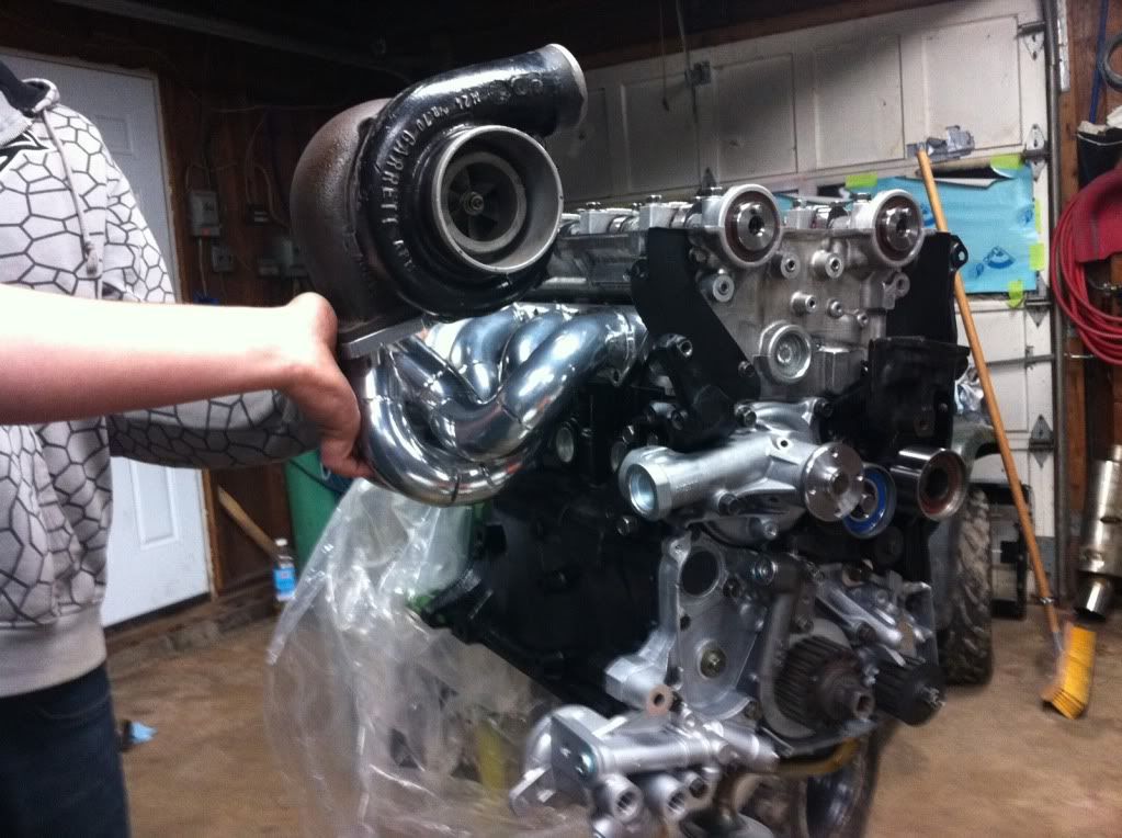

Of course when your friend and brother get beyond tired ridicules ideas start coming to mind. And no, this is not the turbo that im running on this motor, but its huge!
Will have more updates soon!!

The only thing that is left that needs paint is the engine bay. Instead of doing the bay red like the rest of the car, it will be a textured black. This is so the red accents on the motor won't be too much with the red bay.
I guess I forgot to mention what color it was. It is a Dodge color, paint code ARH and the name of the paint is Blaze Red Crystal.

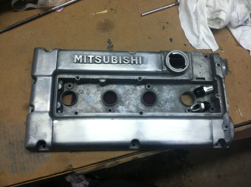

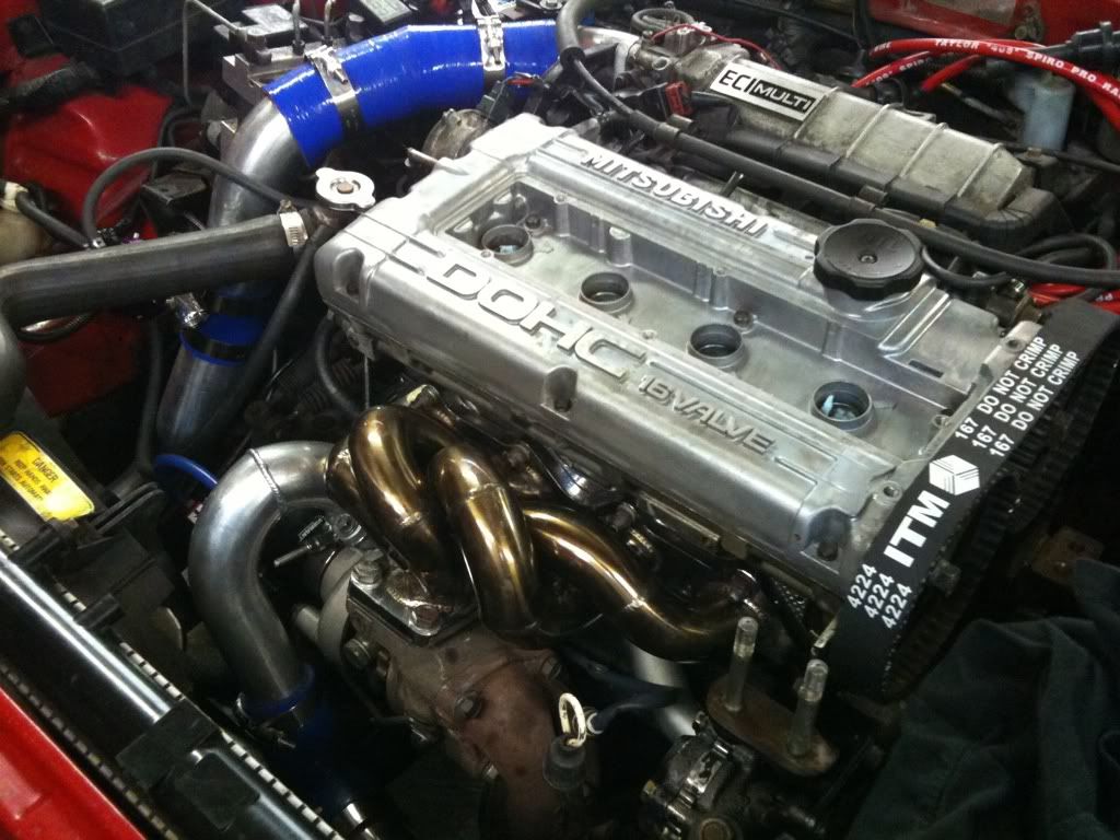

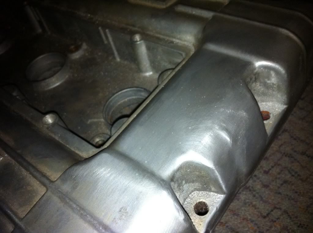

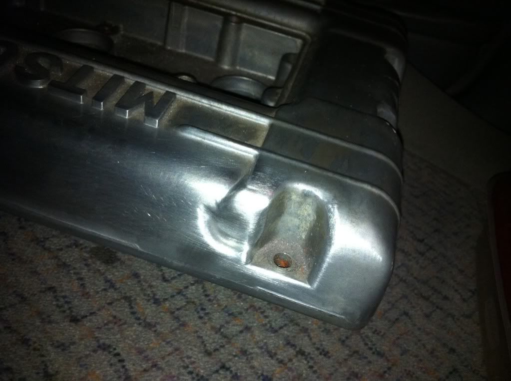

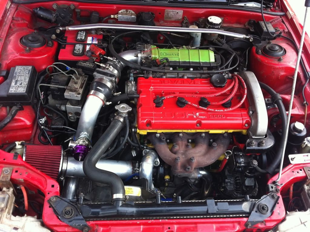

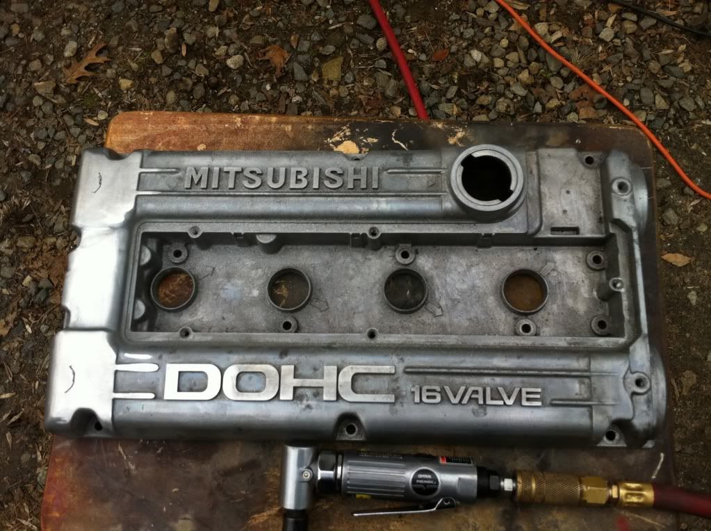

Also there has been some progress as I'm waiting for some more parts to come in before I can bolt up the timing belt and components. I was able to shave the valve cover and I'm still in the process of having my buddy weld up the AN fittings.

I'm not sure what everyone else uses but I used a 4-1/2" grinder to knock the letters down almost flat and then with a 2" angle grinder and finished it up with a file to make it flat. My brother smoothed it out with a flapper disk.
Sweet, thanks:hellyeah:

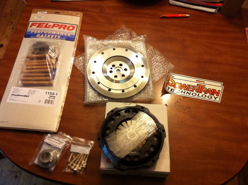

Finally got some more things in to help push this build that much closer to the end, who am I kidding its a dsm, it will never be done haha.
and 15 oem filters
