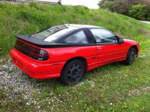

Thats all I got for now Pics soon to come! The pic I uploaded is a pic of the car before I did anything! Once again ANY advise would be awsome!

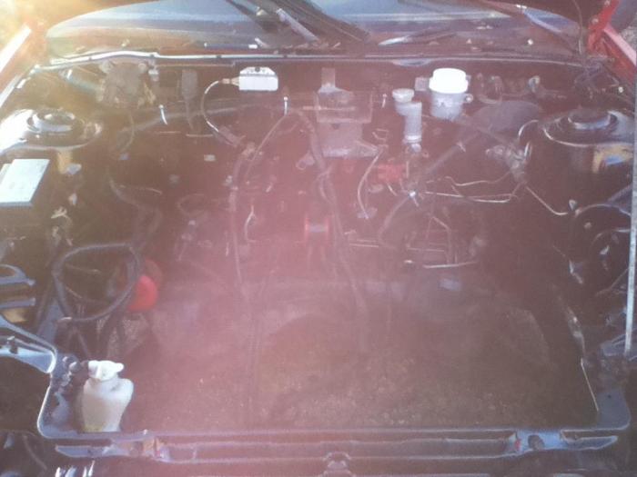

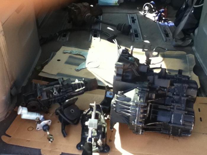

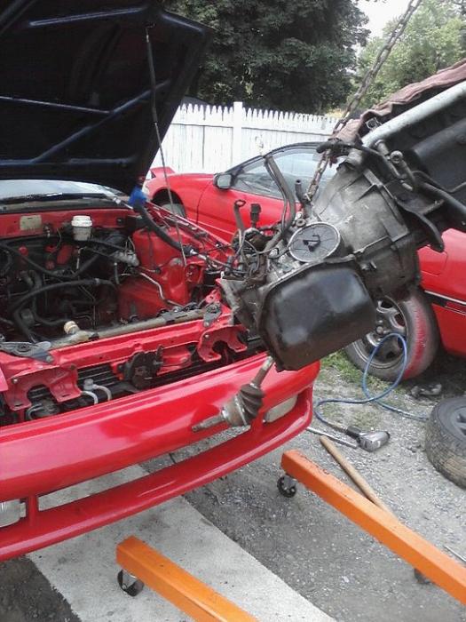

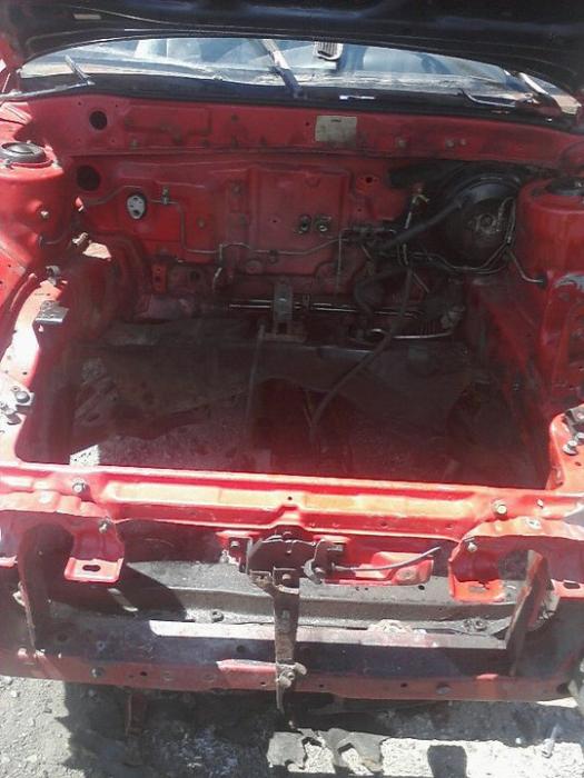

Nothing... nothing at all I'v had to piece it all back together! Motor was basically out... head was off and was auto-tragic ;) haha. So I ripped it apart stripped the engine bay, and swapped the auto stuff for manuel.
Got some work done!
