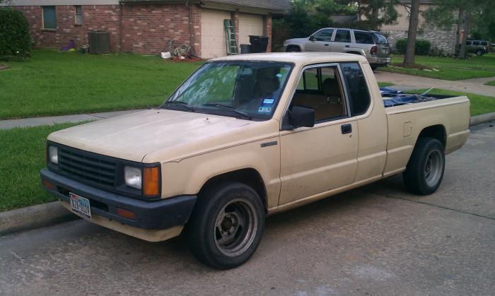

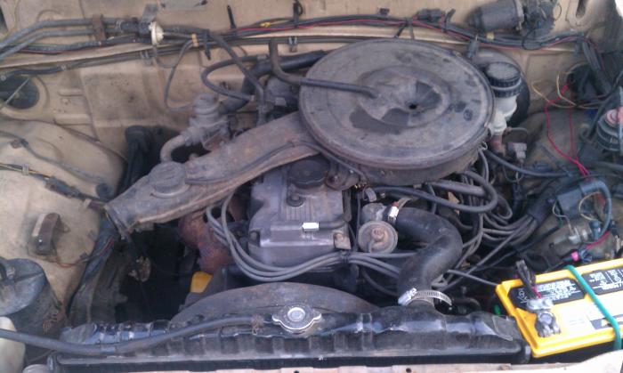

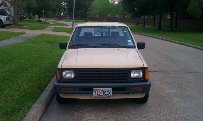

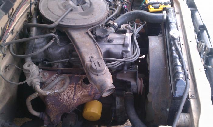

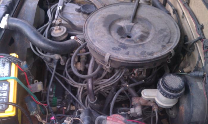

Hey guys I've been lurking for a bit while researching and figured i would join up. The truck is all stock and pretty much on its last leg, so thought it was time to start the swap. I've done tons of research on the swap but hoping i can still learn from what you guys offer from the forums.
My plans are just to get the motor swapped and running properly and then ill think about upgrades in the future. Right now its the stock 2.6L and how you see in the pics are exactly how i got it. Comments welcome.

whats your budget / power goals... hard to give you any kind of advice on what direction to head with it without knowing more details.
Sorry for the lack of information. My budget is about 3k just to get it swapped and running right. As for power goals I hope to make about 250-350hp and still be a reliable daily driver. Since this will be my first turbo vehicle ever, I want to learn the do's and don'ts.

Do you know what block is in the engine now? Serial number? could you do a DOHC swap on the block? I want to do more research on this engine.
Also there is a ton of room in that engine bay, you wouldn't have any trouble fitting a holset into that engine bay:hellyeah::thumb:

The block now is a G54B, and i do remember seeing something about being able to do a DOHC swap but since i've been crazy about the 4g63 i kind of forgot the information about it. But you can go to projectzerog.com for more information about it.
