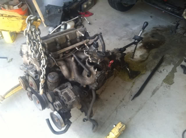

Here's how it started

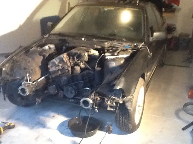

And after a few minutes we got here

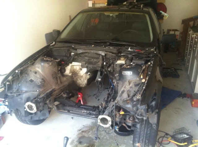

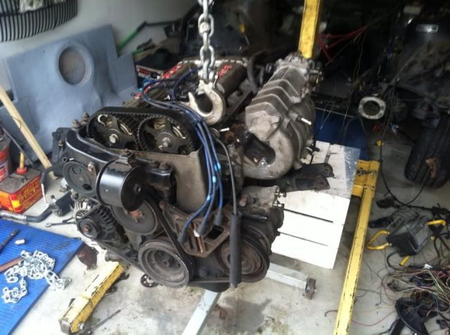

Without too much work we got the motor and trans out of the car
140 horses of German misery

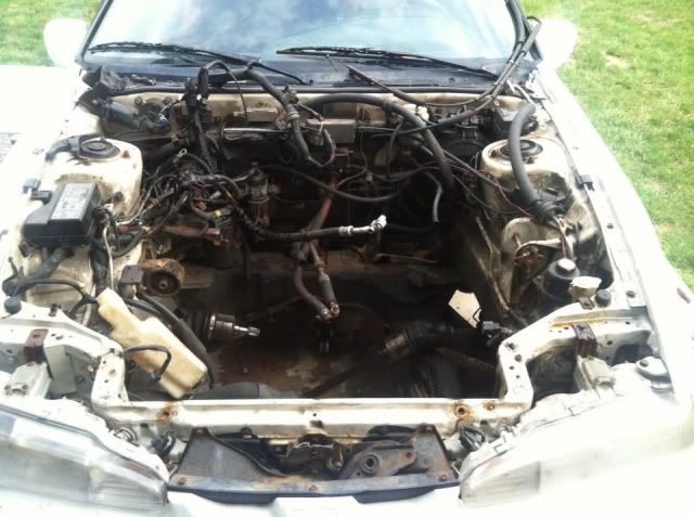

Then it was time to start on the donor car
Piece of cake

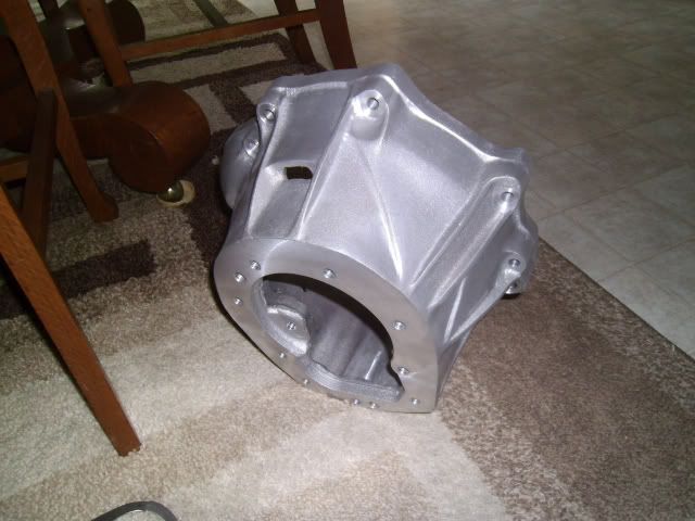

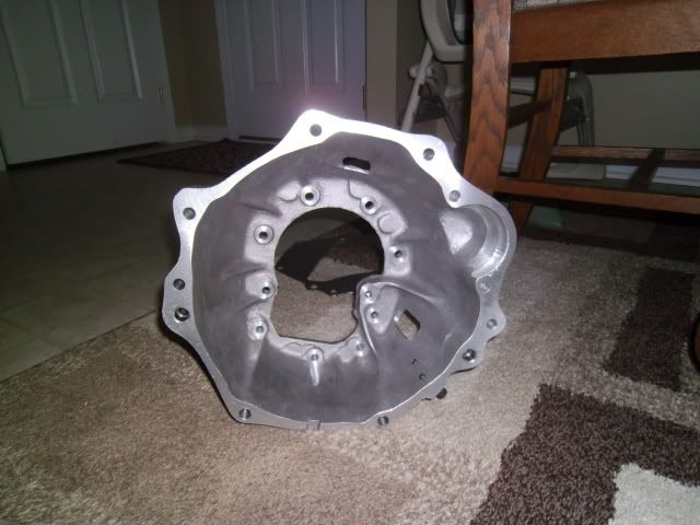

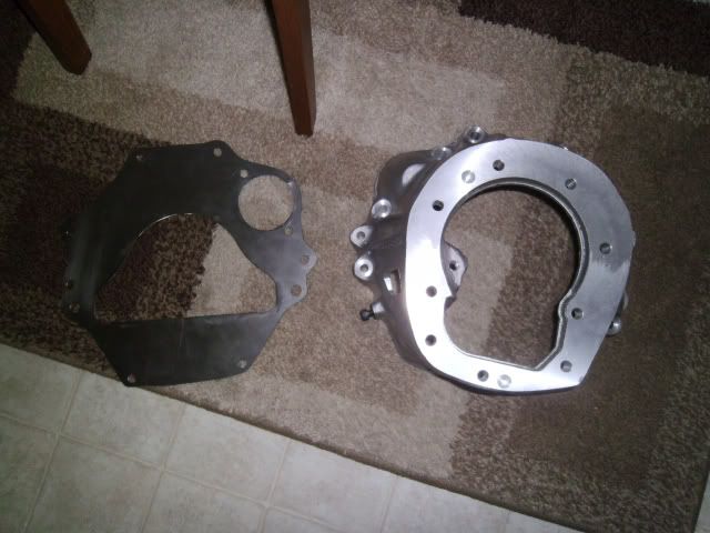

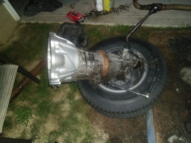

I knew I wanted to clean up the 4g and the engine bay before I threw everything together though and replace all the gaskets and maintenance parts while it was easy to do. I got the motor stripped down and busted out the degreaser and engine paint and just generally started cleaning everything up. We drove up to Toledo and picked up a custom bell housing from Bill Hincher to mate the engine up to a w58 Toyota trans.

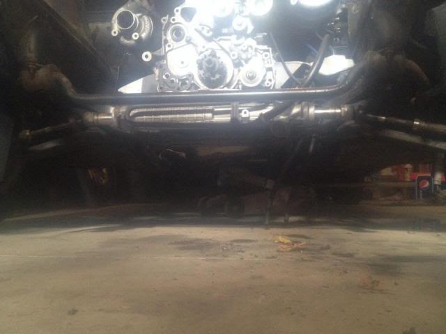

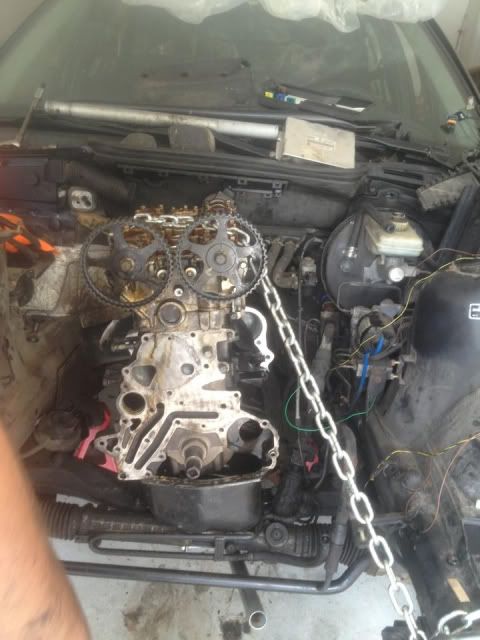

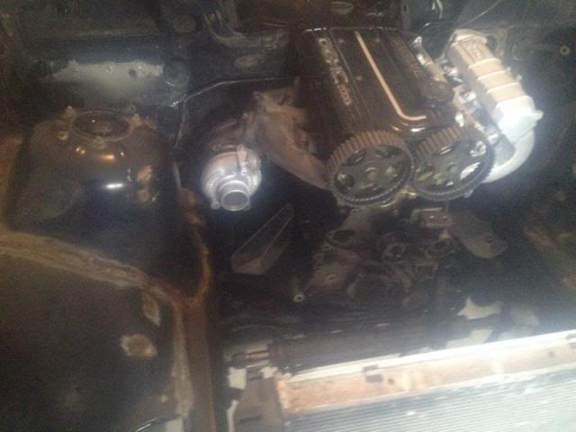

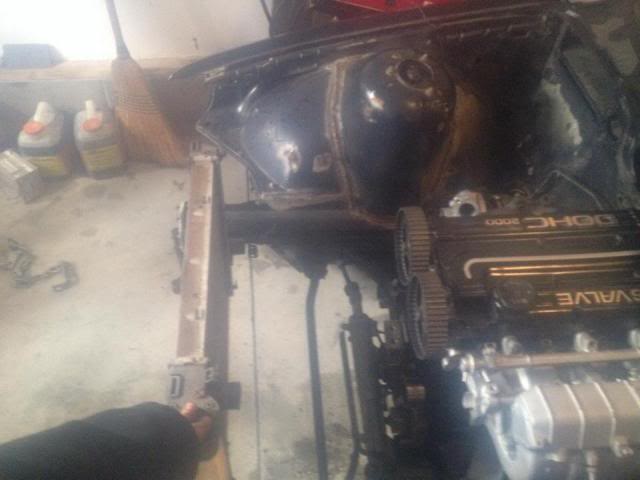

I figured since I was going through this much trouble and had to make mounts anyway, I might as well move the engine as far back and down as possible. I hoisted it into the general area it needed to be, and quickly noticed an issue.

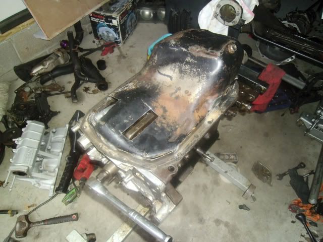

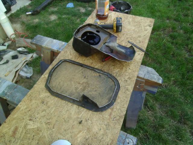

The front sump oil pan sits right about where the crossmember is. I had a couple choices here. I could either push it about 10 inches forward to clear the subframe and sway bar, which I didn't like at all, or make a rear sump oil pan.

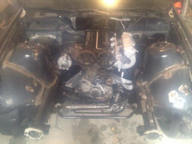

Granted, I'm only using this for mock up purposes. I'll probably have a nice thick flange machined and build a much better pan, but for it's needed purpose right now, this will work. The end result is that now the motor sits extremely far back.

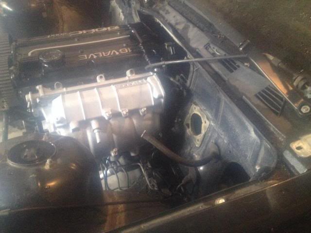

I also have a ton of turbo space
Plenty of ground clearance too
Not so much for a brake booster though. I'll solve that issue when I build my intake mani and hydroboost

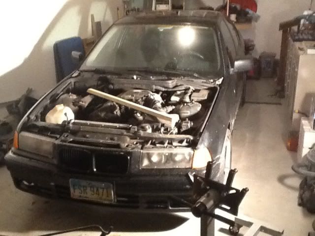

And this is how it sits right now
I have a lot more pictures but they aren't all stored in the same place. I've been taking pictures with my digital cam (which I can't find at the moment), my iPhone, and my ipad. I still have some more work ahead of me, but hopefully it will be on the road some time this summer.

I was planning on using a r154 transmission out of the early supras.
How long is the w58 trans from toyota?

I thought about going with an r154, but I would've had to wait on my bell housing a little longer. It's actually the same casting as the w series bell housing it's just drilled differently. There's a few different variations of the w trans, and off the top of my head I'm not entirely sure how long it is. The shifter location is only a few inches farther forward than stock right now, but the cas is actually sitting where one side of the blower motor used to sit LOL. I shoved this thing pretty far back. I'll probably do the same kind of flange as what jm fab does for intakes with the oil pan. About 1/2 thick steel with another 1/4-1/2 raised edge to weld to. I've looked all over and can't find a rear sump oil pan or just a flange though, so I'll have to get one made locally

There's a guy relatively local to me that makes bell housings for the 4g63 to go to Toyota w series, r154, t5, t56, gm autos. I decided to run with the w just out of pure cost and the fact that it should be able to hold for a while until I start gettin some more power put down. Once that happens I'll probably run a t56.
