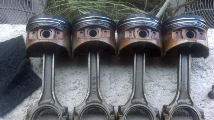

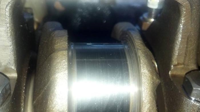

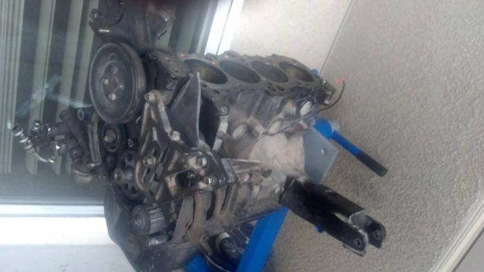

So i began the teardown immediately and to my surprise the internals were in very good shape

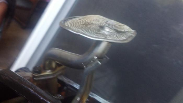

Except for the oil pick up that screamed "Please Kill Me"
But I guess these shiny crank journals will make up for the pick up being crushed

Wicked find dude. :D below 300hp I'd say these are just as good than other engines. But it really all depends on what you replace/whats wrong with it. These are 15+ years old
This one is in great shape....i believe i could have run it as is...the car i took it from would crank but wouldn't start..i know a guy putting down 3 something on stock bottom end
Stock bottom end would have no problem holding 400hp.
True story.
Good find and good luck OP.. My stock 7 bolt bottom end is holding ~450 whp in my spyder. And a buddy of mine ran his awd with a stock 6 bolt with over 500 wheel for 3 years before it spit out a rod.

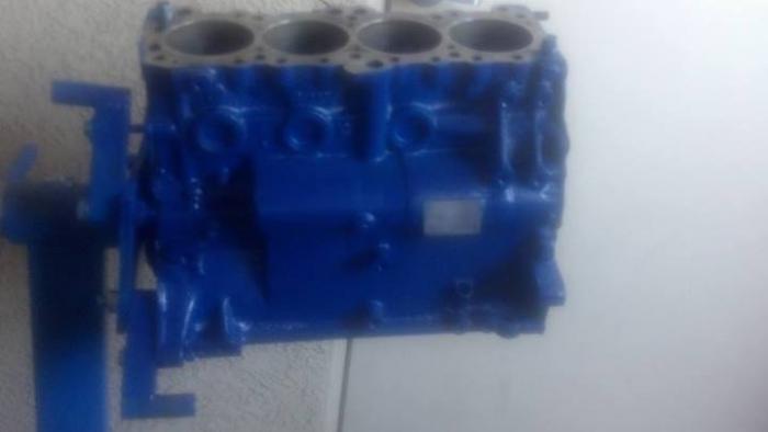

Got the 6 bolt cleaned and painted over the weekend...gonna mic the crank and cylinders make sure everything is up to spec...then the build begins....will upload pics soon as i can get to a computer....think i did ok for a guy that makes 8.50 a hr

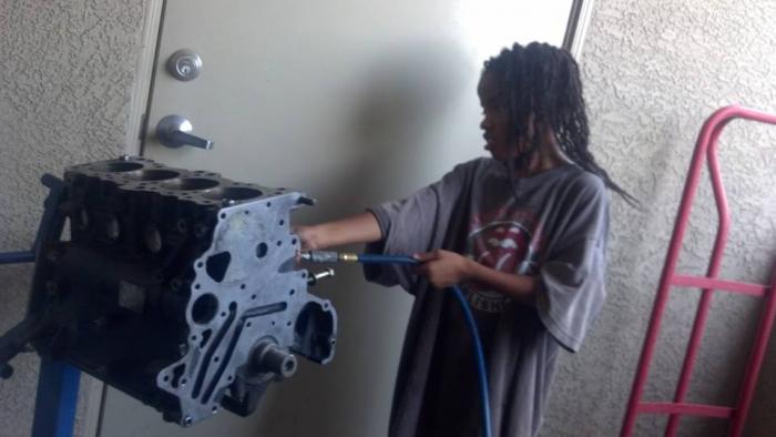

So after cleaning 23 years worth of dirt and oil i was finally able to paint.. Never hurts to have a helper dry the engine with the compressor..kid does good work
Gonna Knock out the old freeze plugs and install new ones so excuse the ugliness for now
