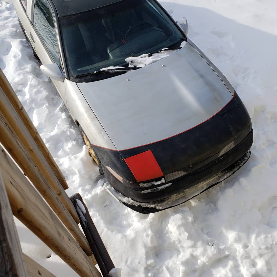

When I bought it it was in "barely driveable" condition. It could run and drive on it's own power but was far from being street legal.
At first glance you could see the previous owners had no idea what they were doing. The car was riced right out. The paint was rolled on and had an eggshell grey finish, there were green led strips in the headlights, fog lights that didnt work, and some ebay tubular exhaust headers that were cracked because apparently not everyone believes in flex pipes.
(The attached image will give a relative idea what it looked like when I bought it)

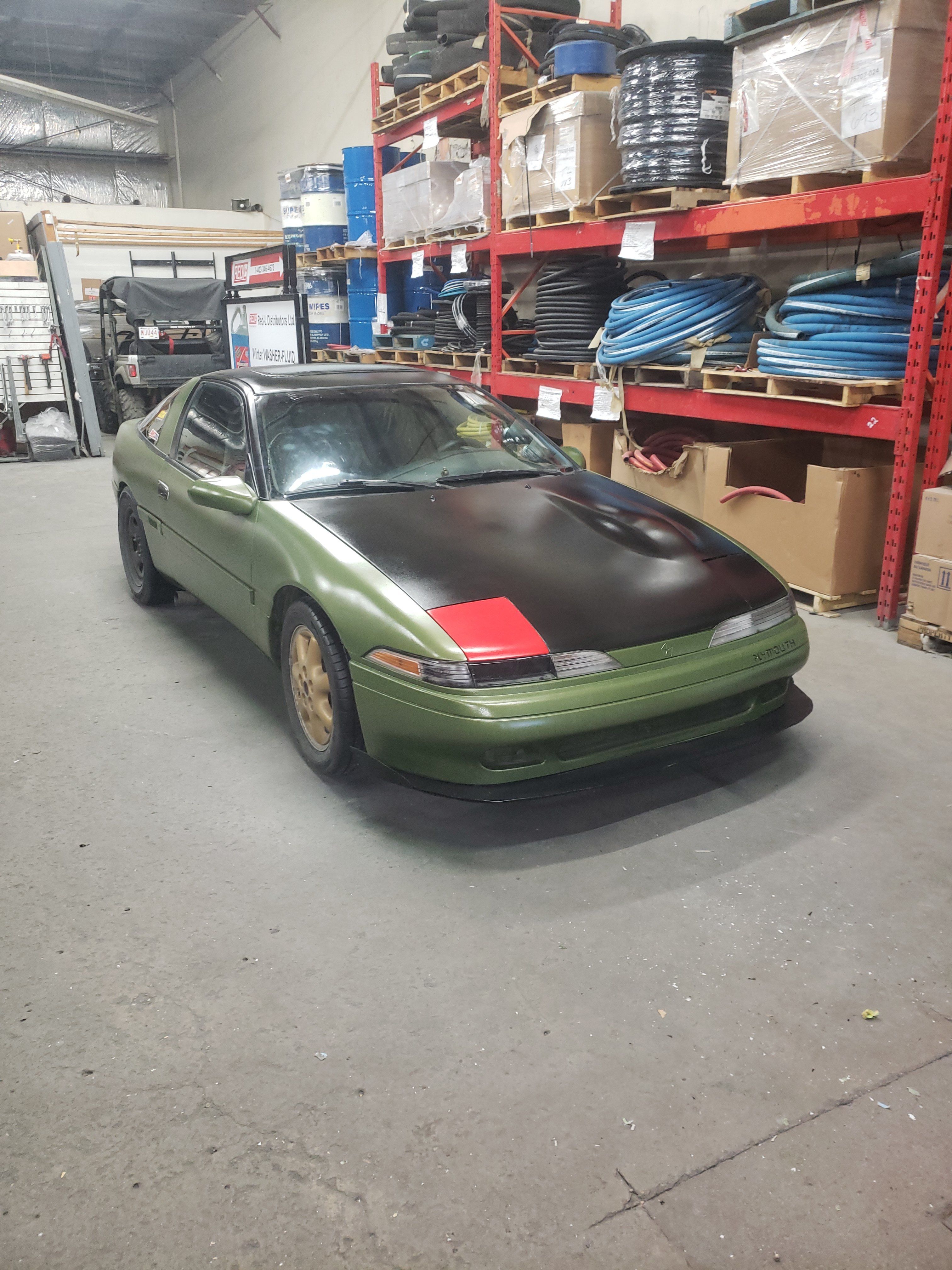

It stayed at that stage until 2019 when after receiving some extra cash I had enough money to paint it and to finally purchase a logger, aftermarket for and a maft translator/ FM maf combo.
Finally after 6 years I got to put the turbo on permanently. Tweaking the maft was tricky but after 8 hrs reading the manual and another 2 driving the same road back and forth I was able to get it in some semblance a a reasonable tune with minimal to no knock. There is 1-3 counts of knock at 600 hz airflow but I cant seem to determine the cause or tune it out.
Nowadays its running 12 psi blasting through corners and straights. Next up is a tranny swap to the f5m33 and equal length driveshaft mod.
