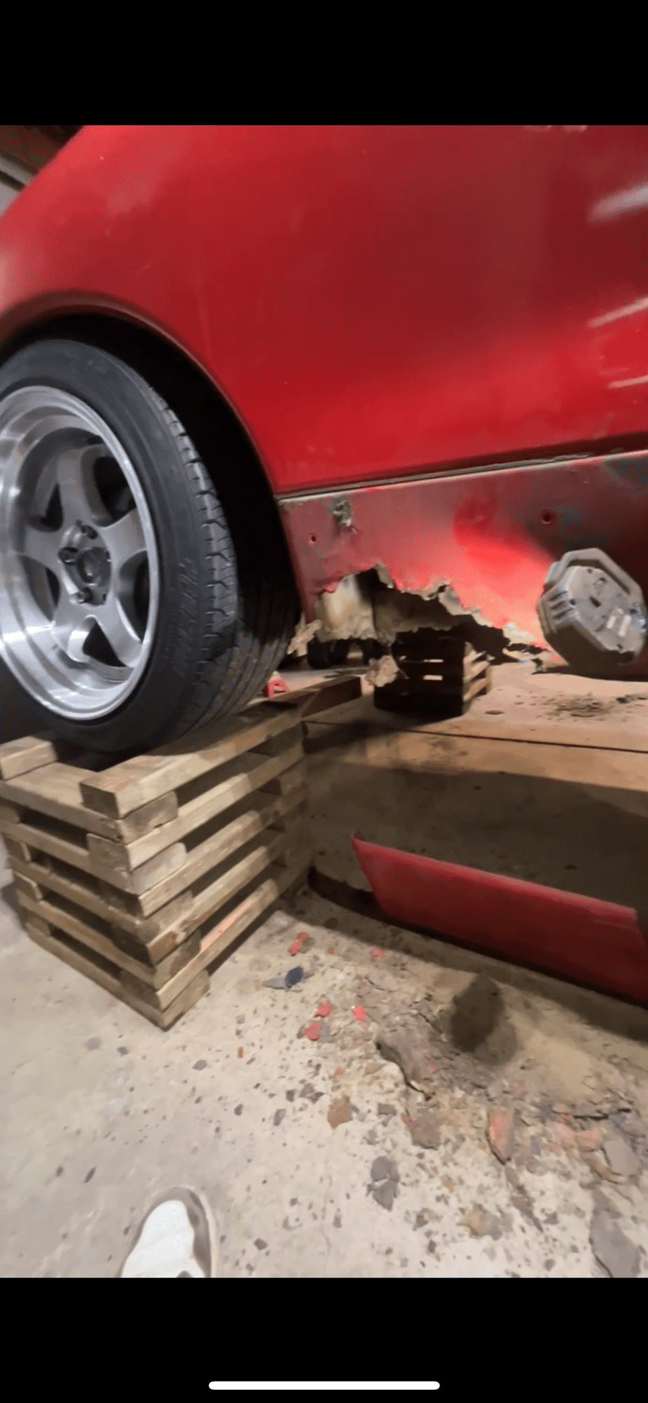

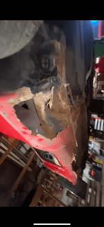

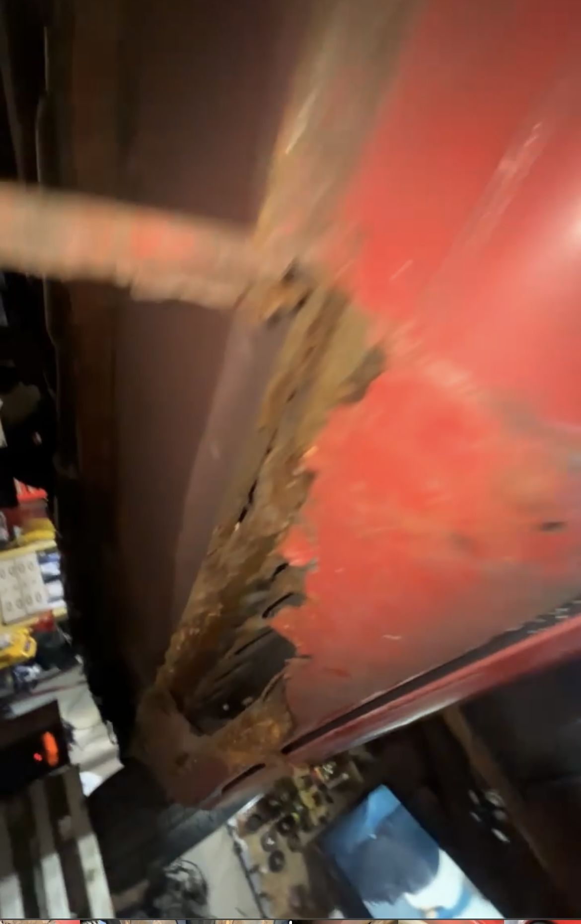

Man, that rot was insane. The Eclipse I had before the one I got now was worse than that. Check your strut towers. If you barely even see any bubbling, fix it asap. I saw a little bit of rust showing through and I thought it was surface rust, but when I started grinding away the paint... let's just say it ended up being 4x worse. Luckily I had a guy that helped me fix it before I needed to replace the whole strut tower.
Nice car, BTW. Keep it clean and simple. Keep it timeless.

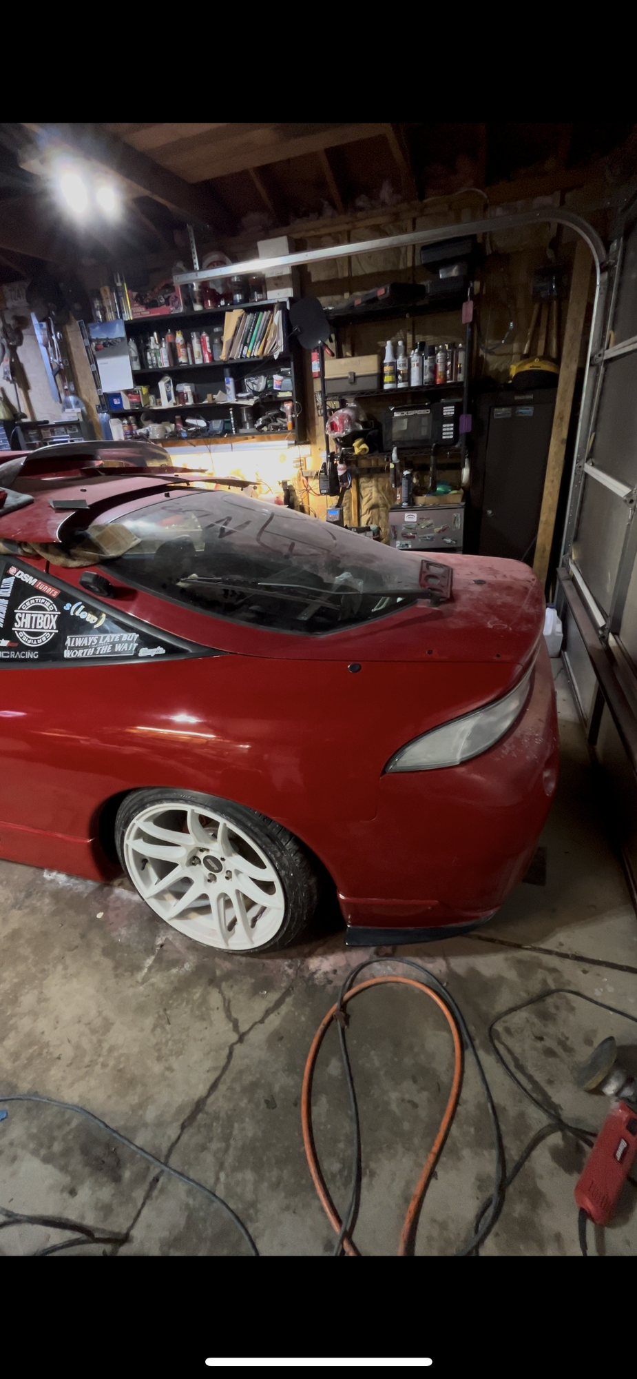

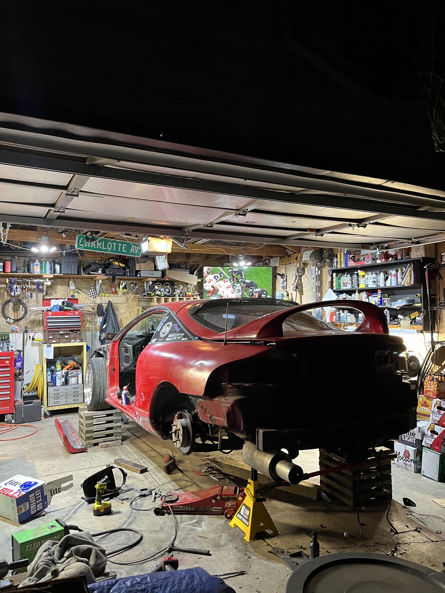

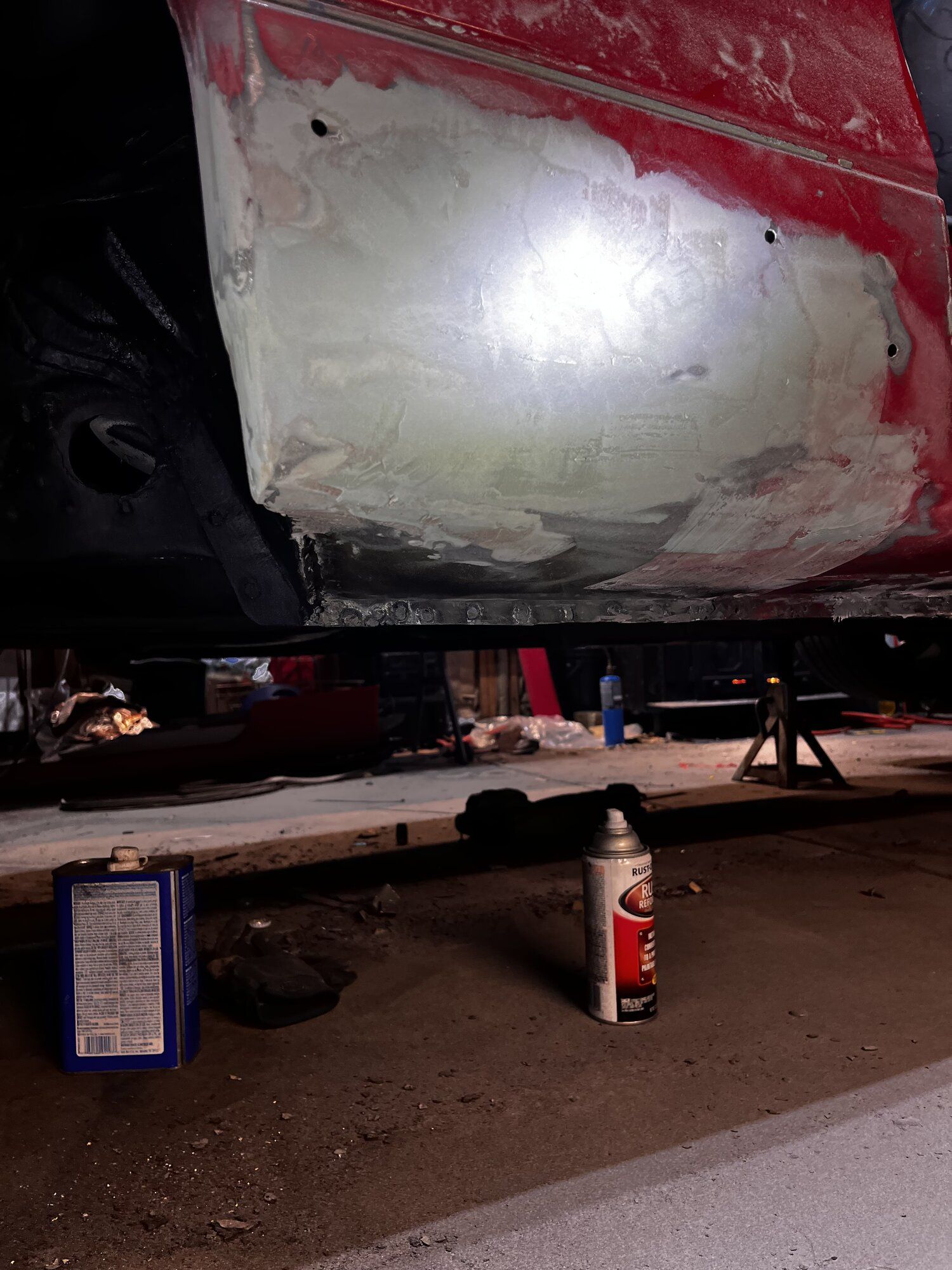

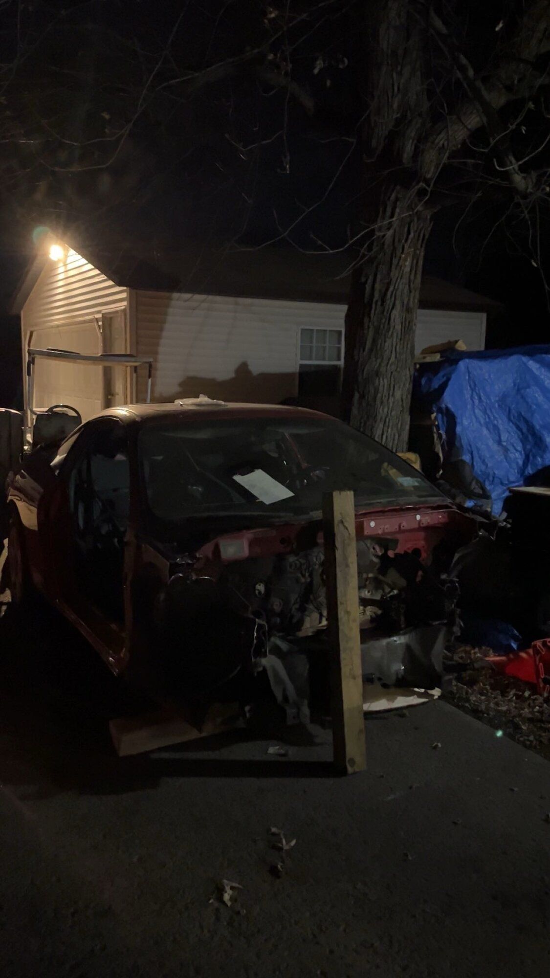

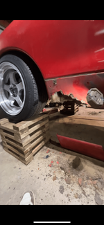

it’s got some , had some rot too cut it out and patched it back when i was 16 , would love to cut it out again and redo it and strengthen it , appreciate it brother ! goes along way

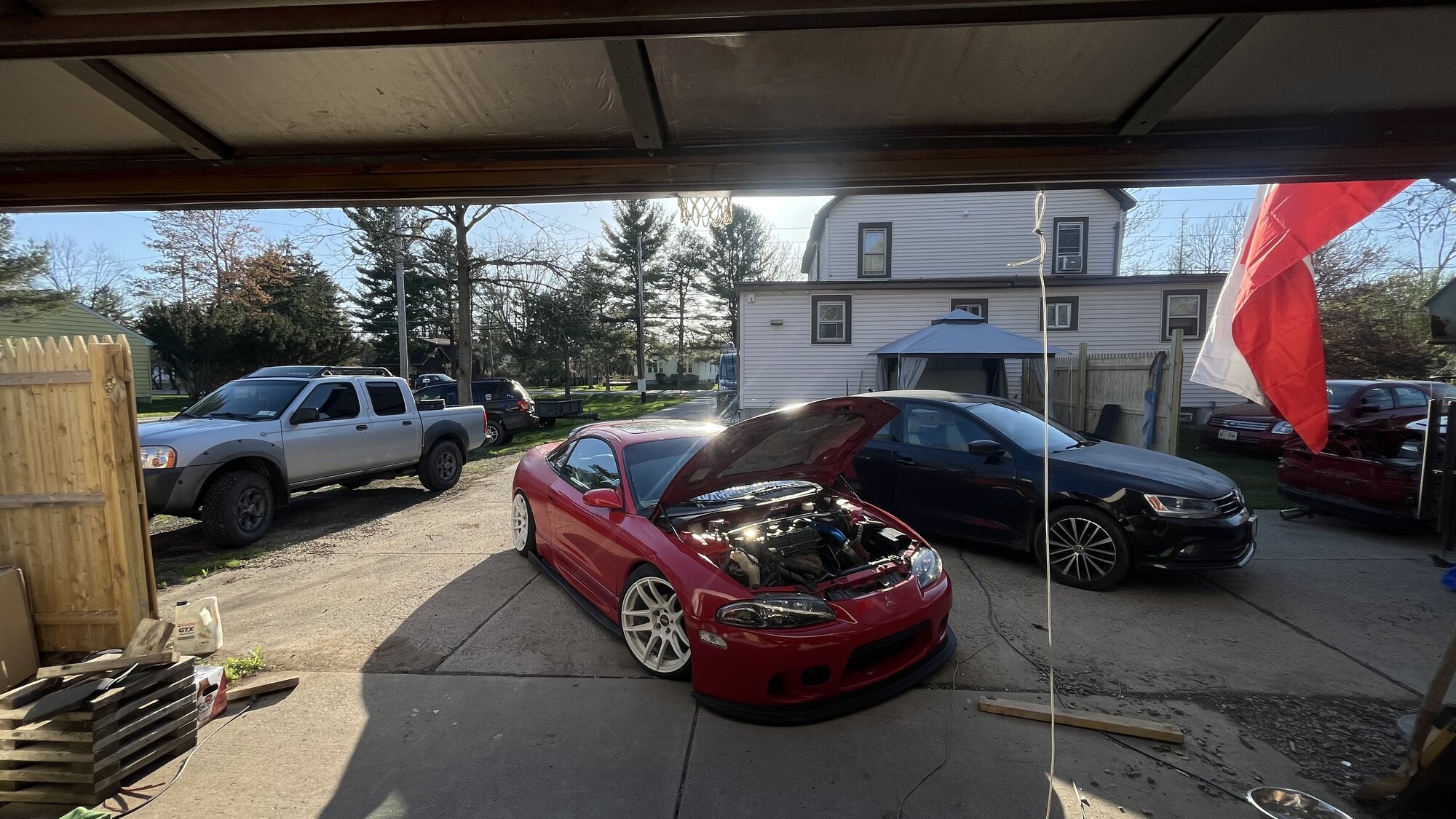

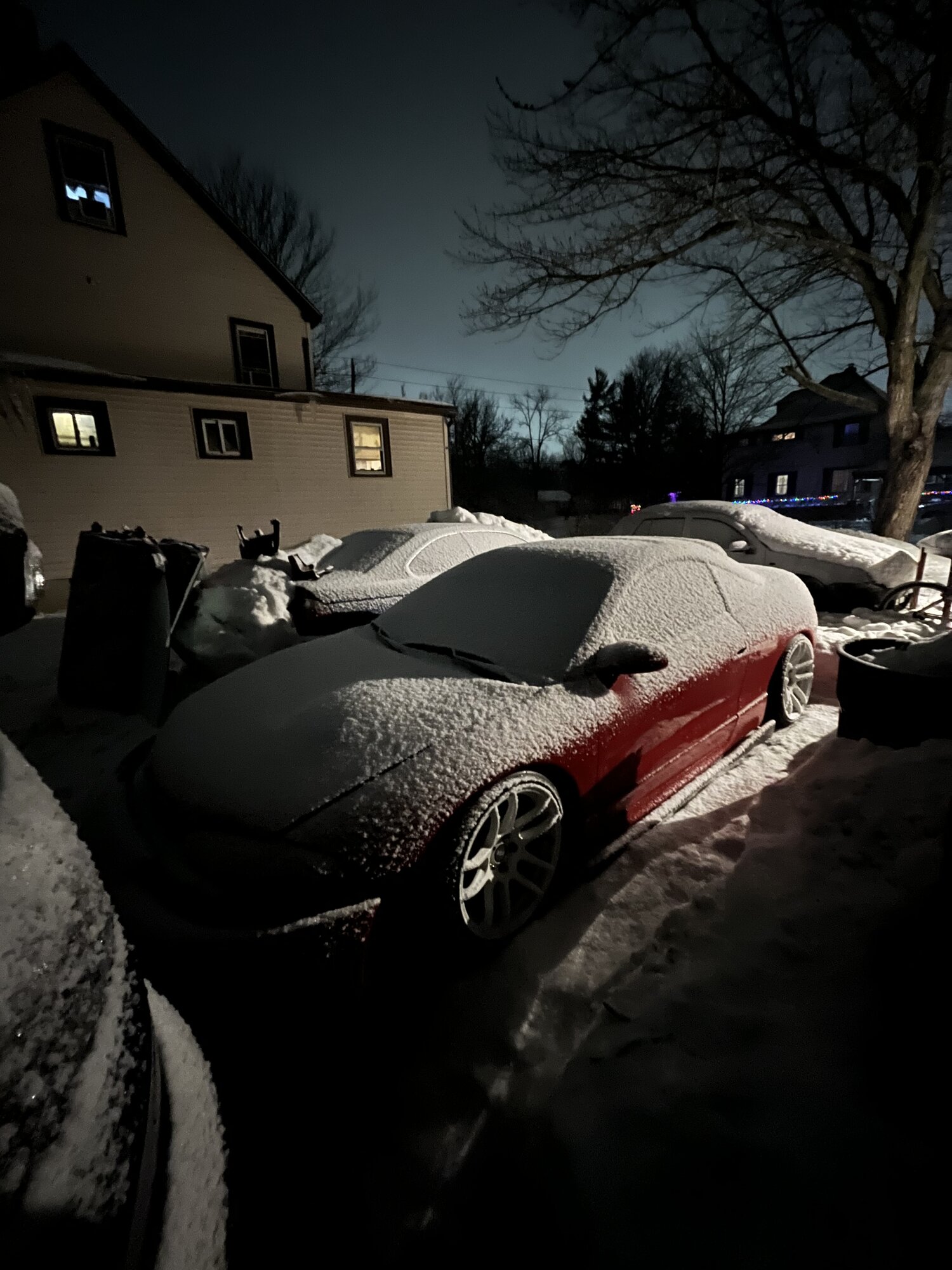

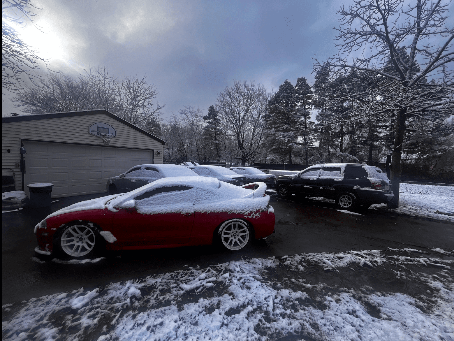

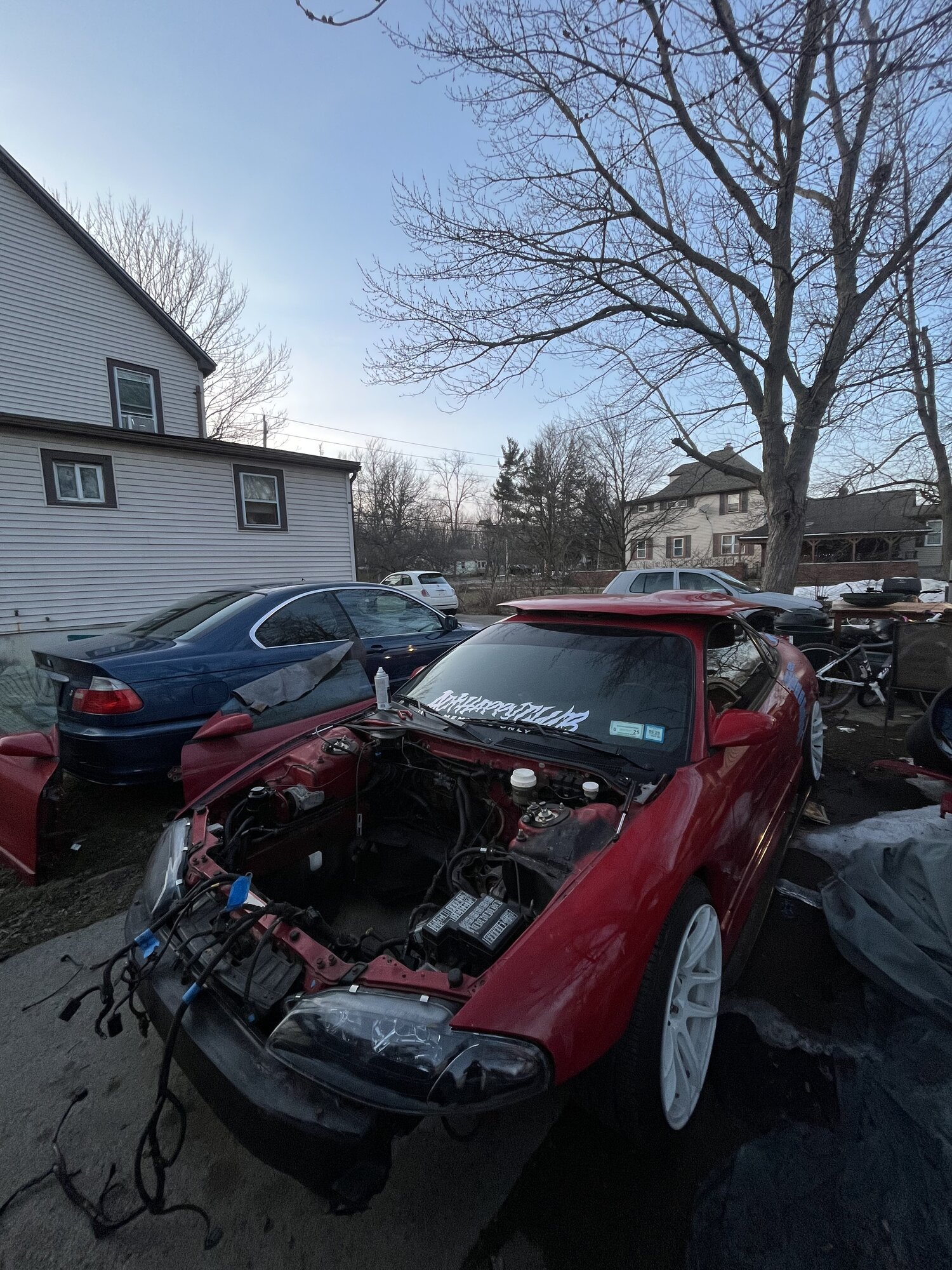

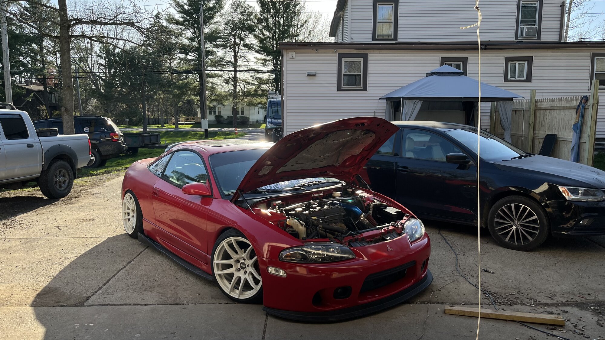

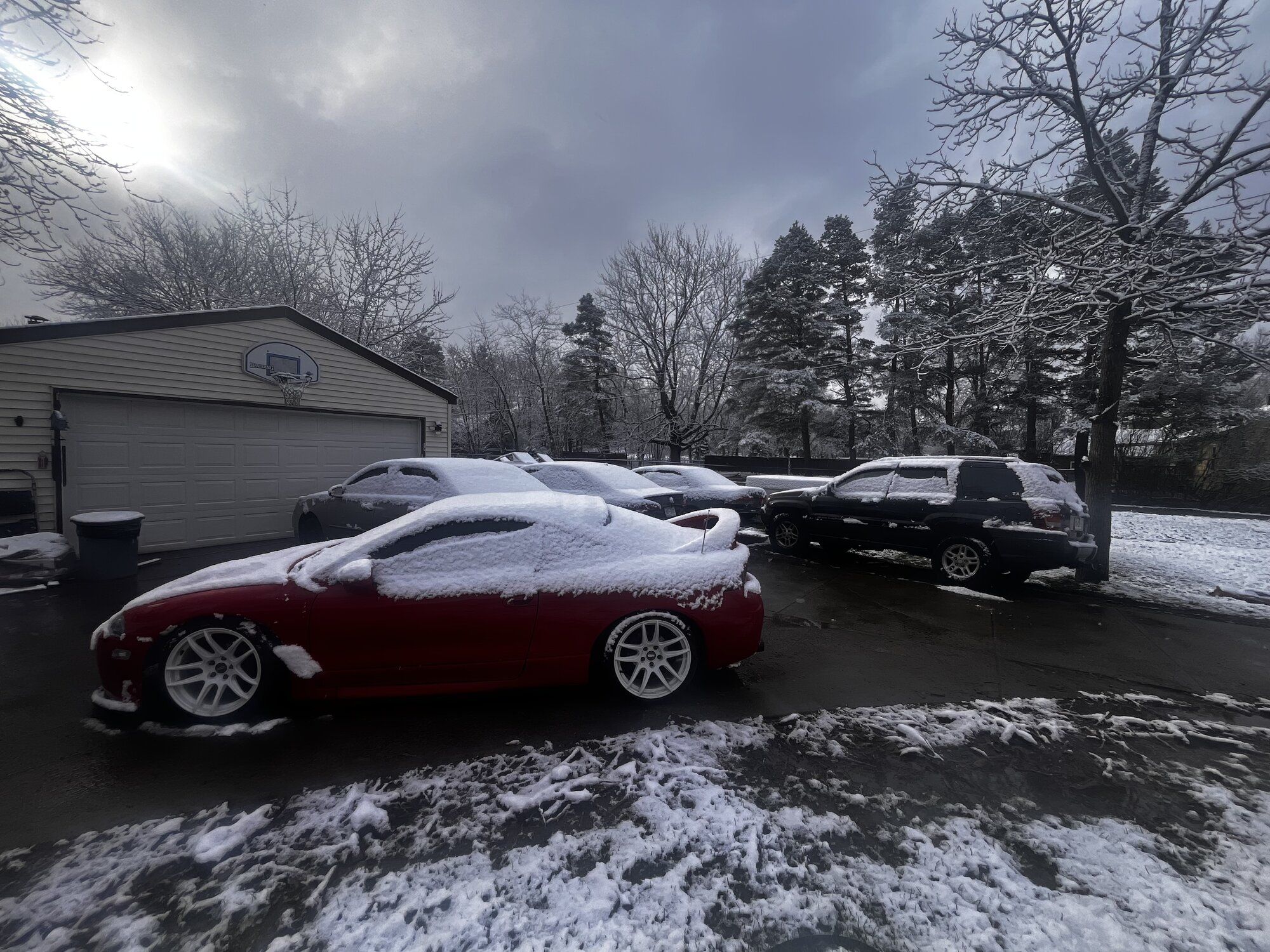

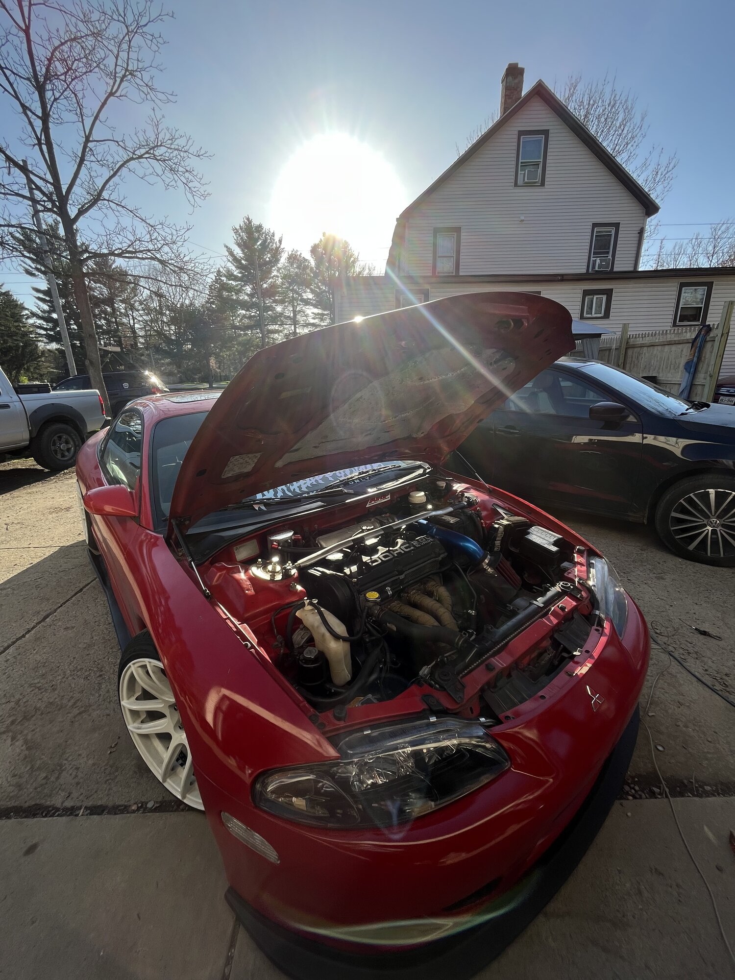

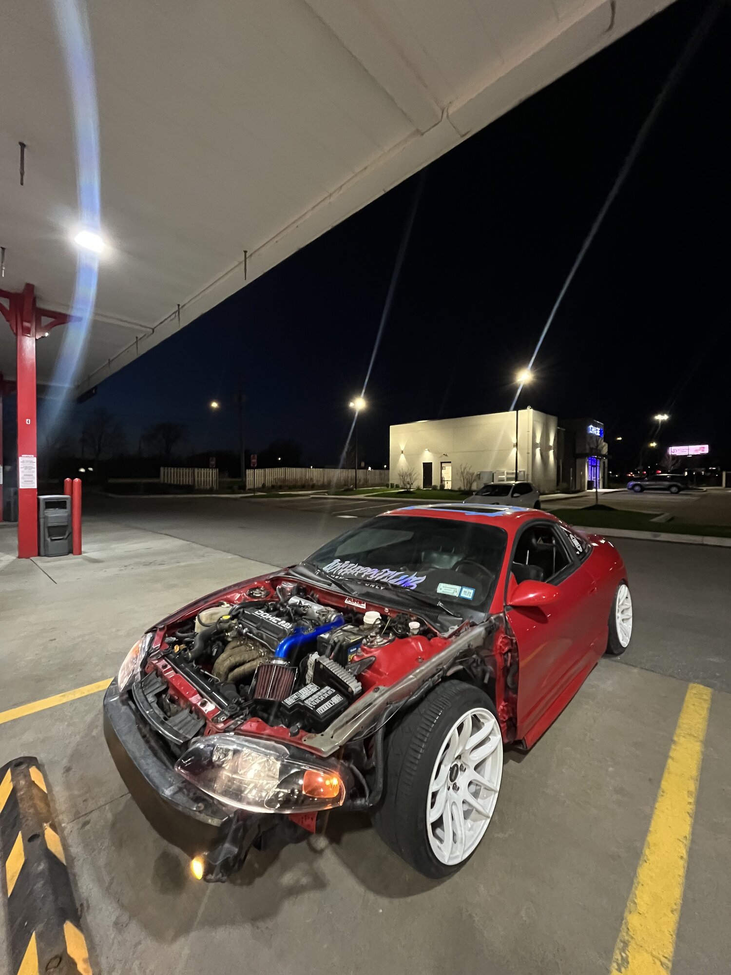

snowing here in april now LOL, red fender is on, adjustable rear toe arms are on to account for the insane toe in these cars get when lowered (got it dialed to factory spec as i was out about an inch of toe XD) and got some wheels off marketplace that were blue but i resprayed white!

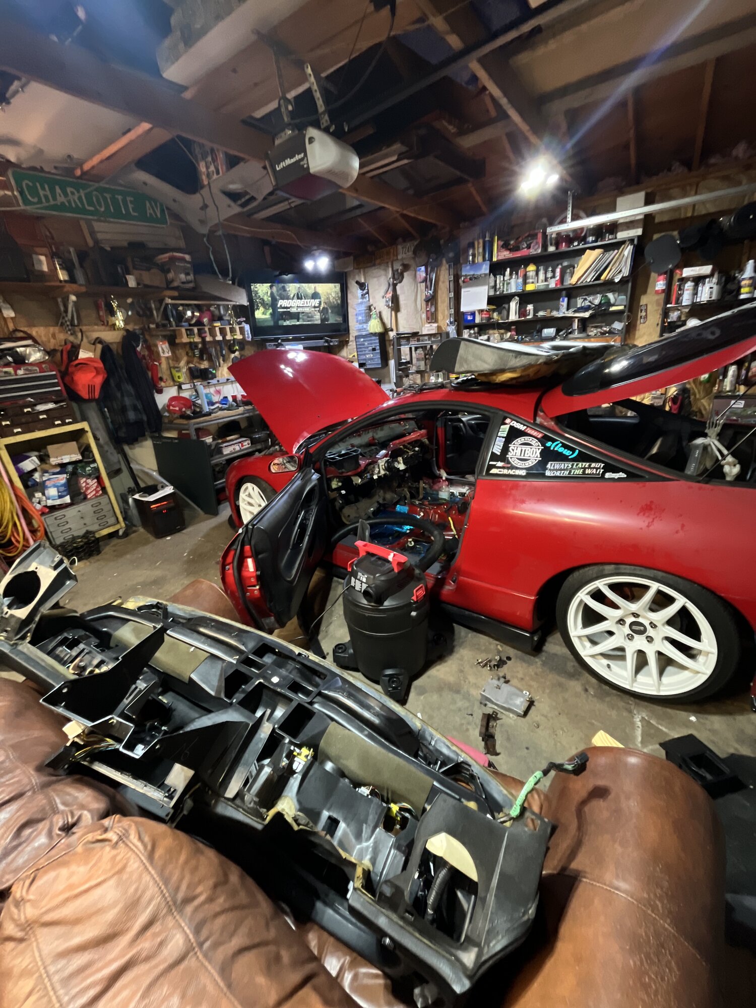

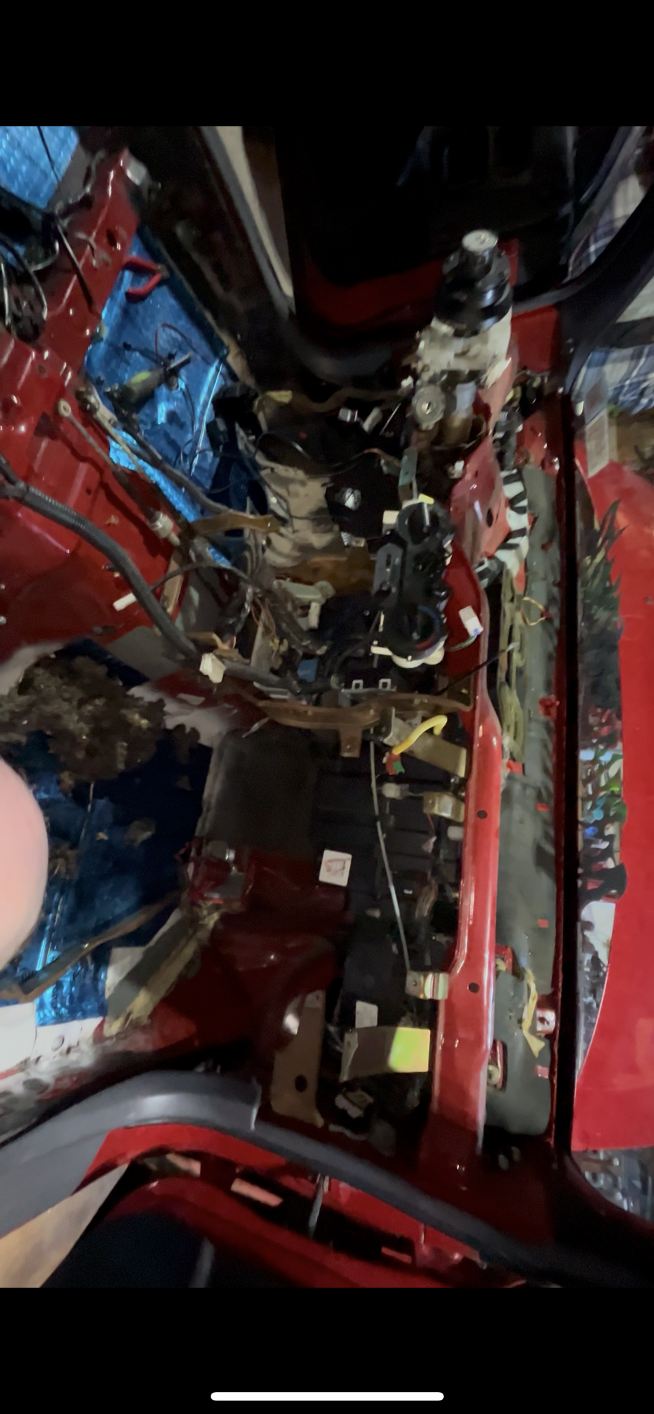

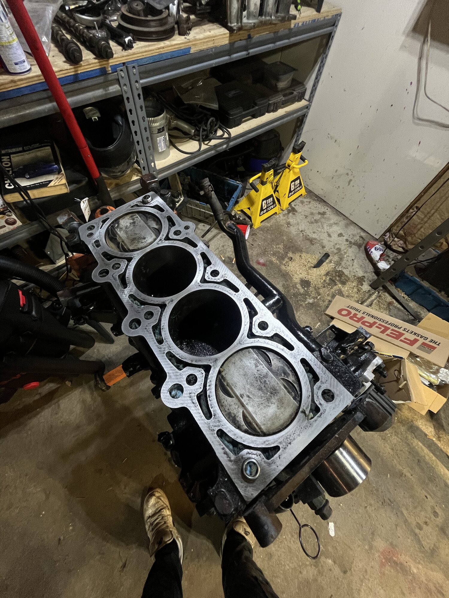

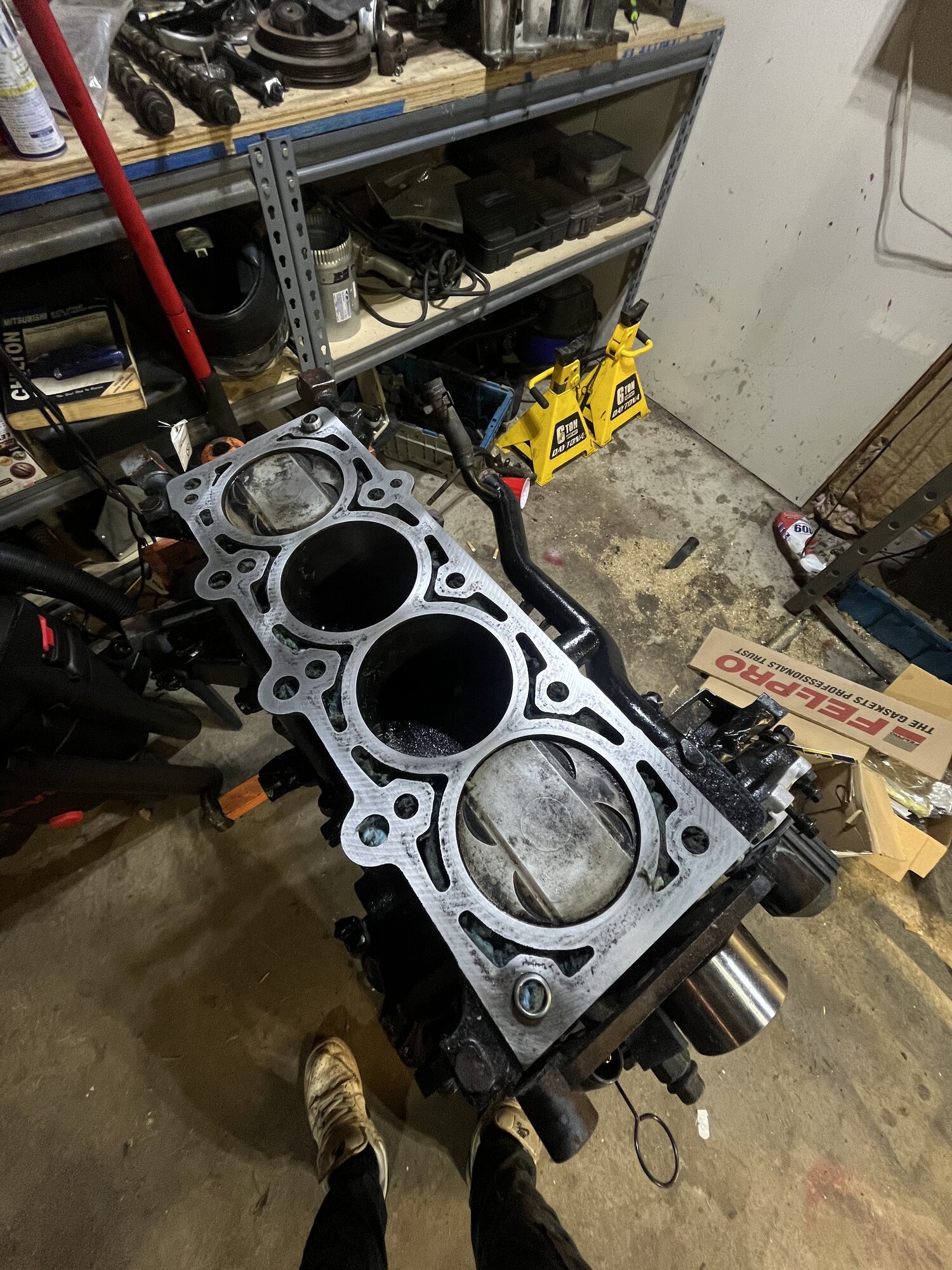

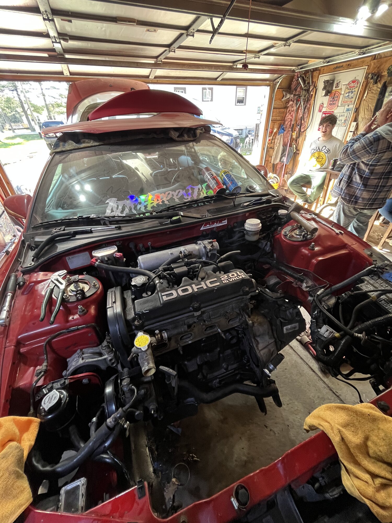

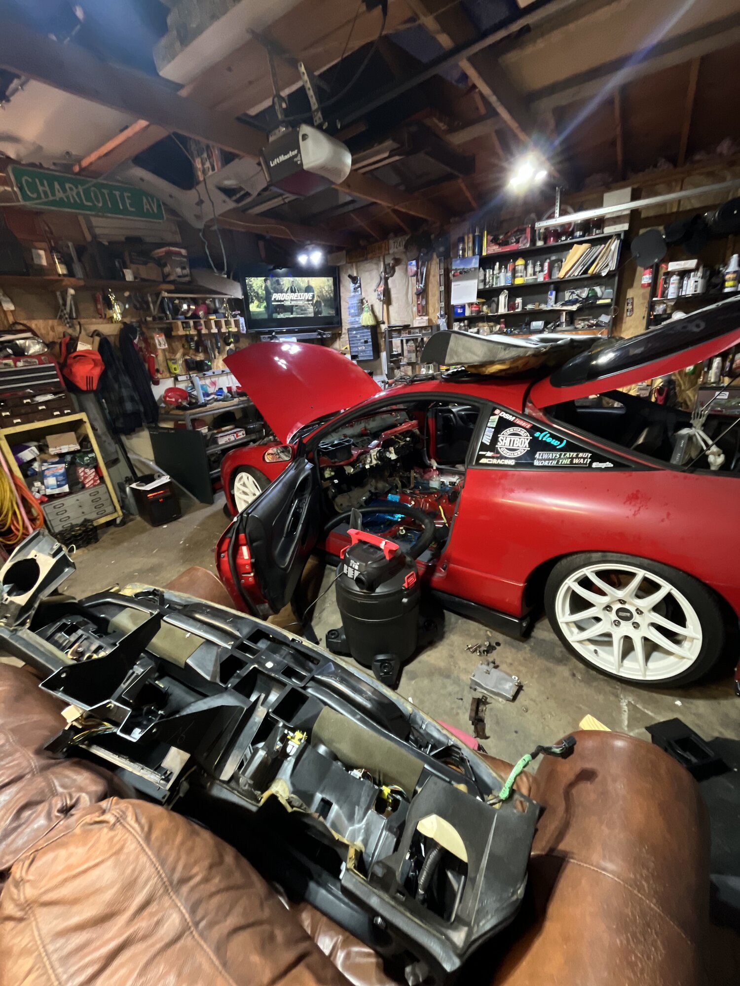

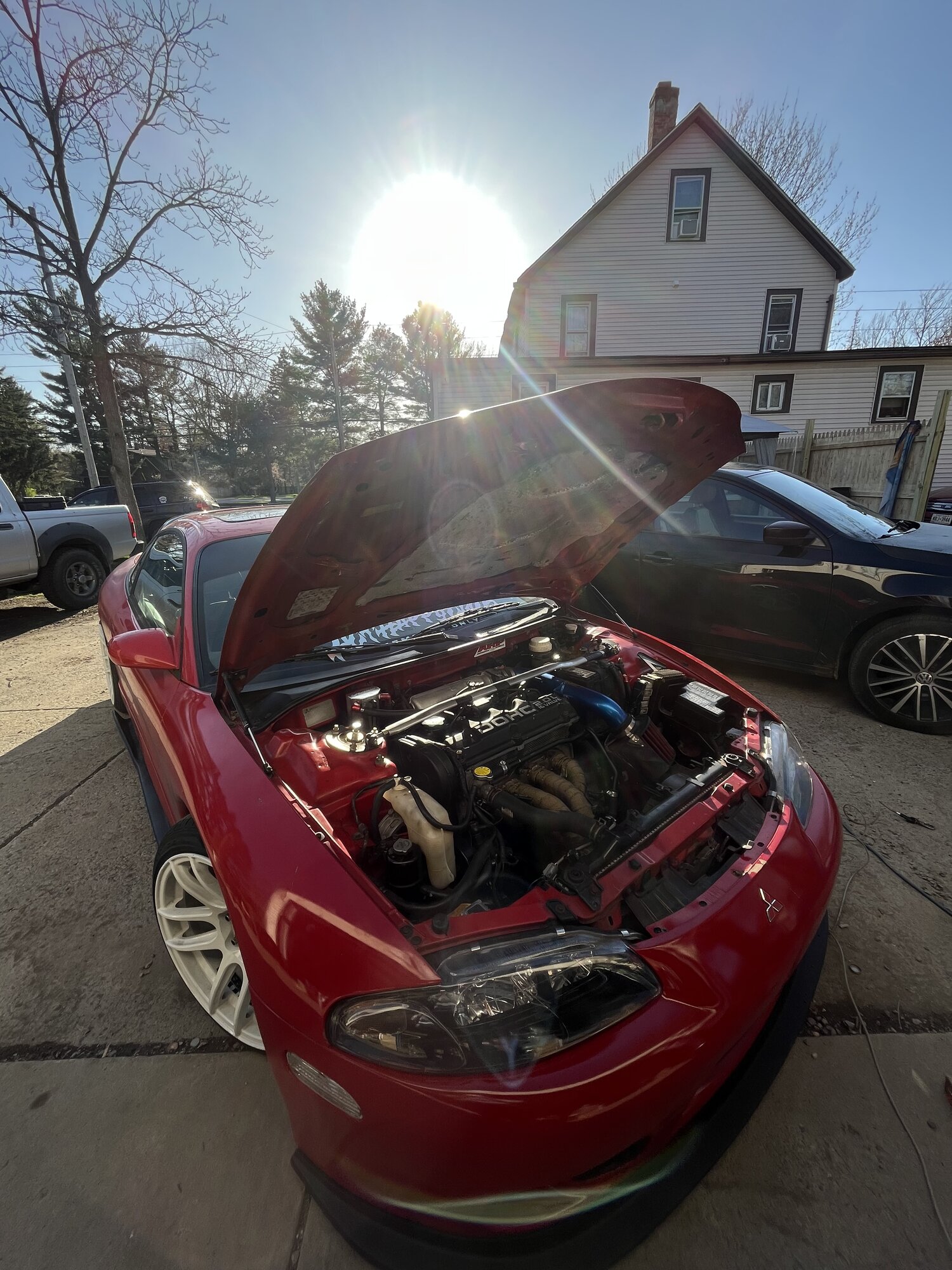

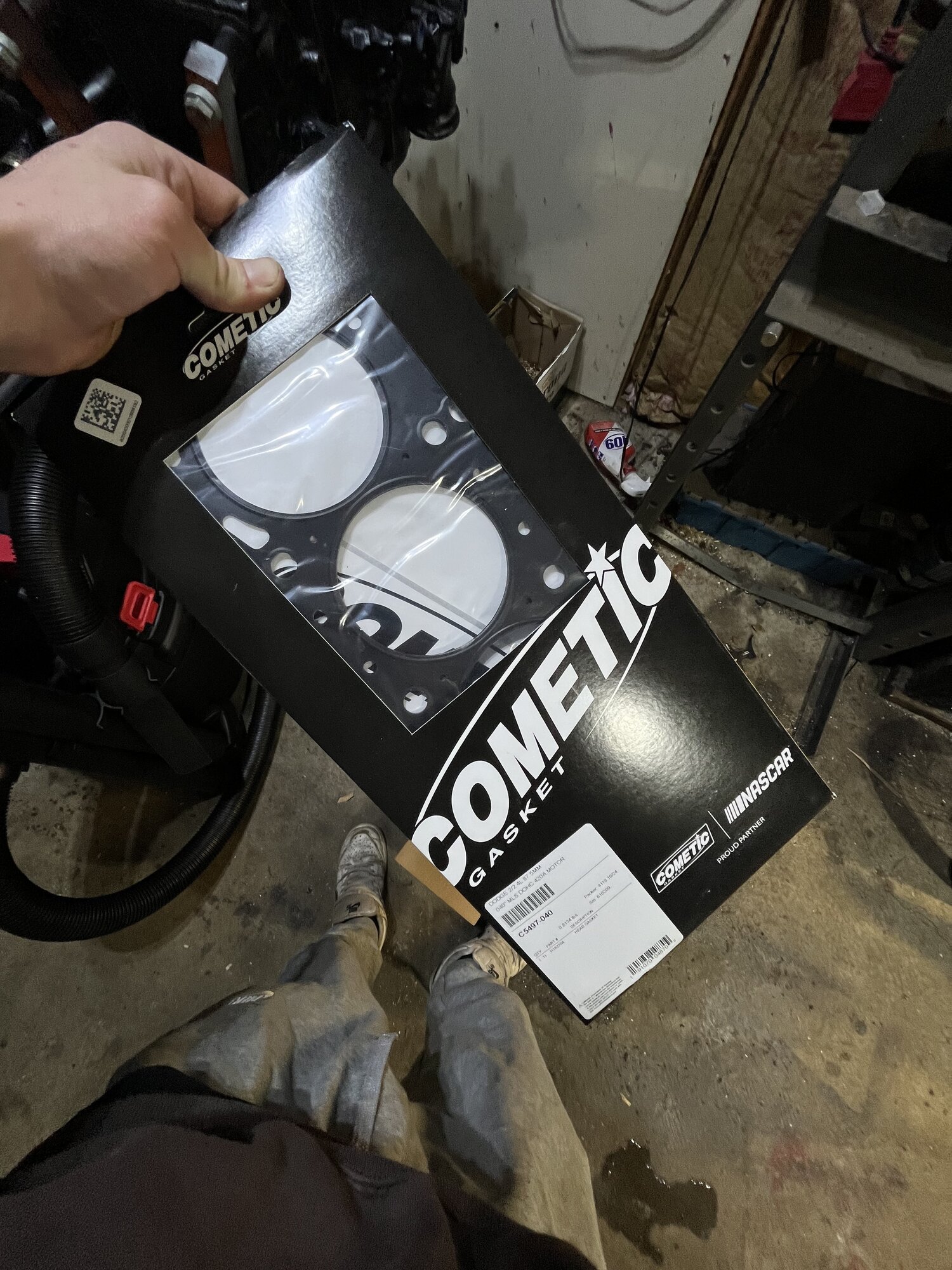

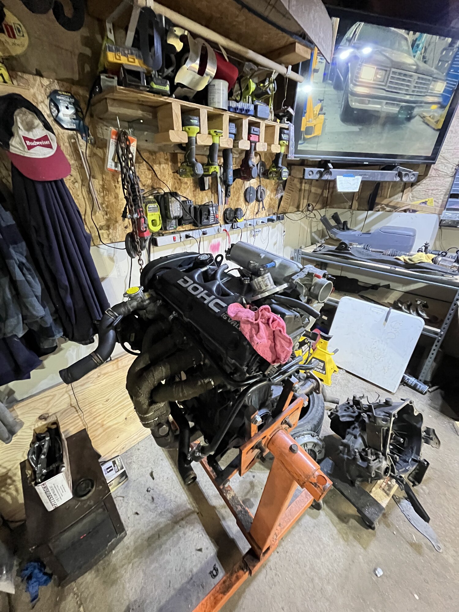

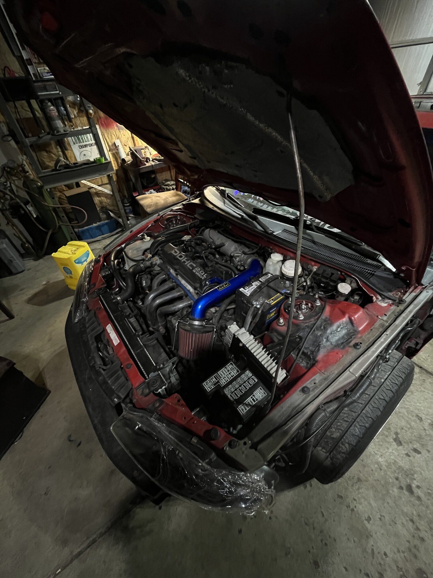

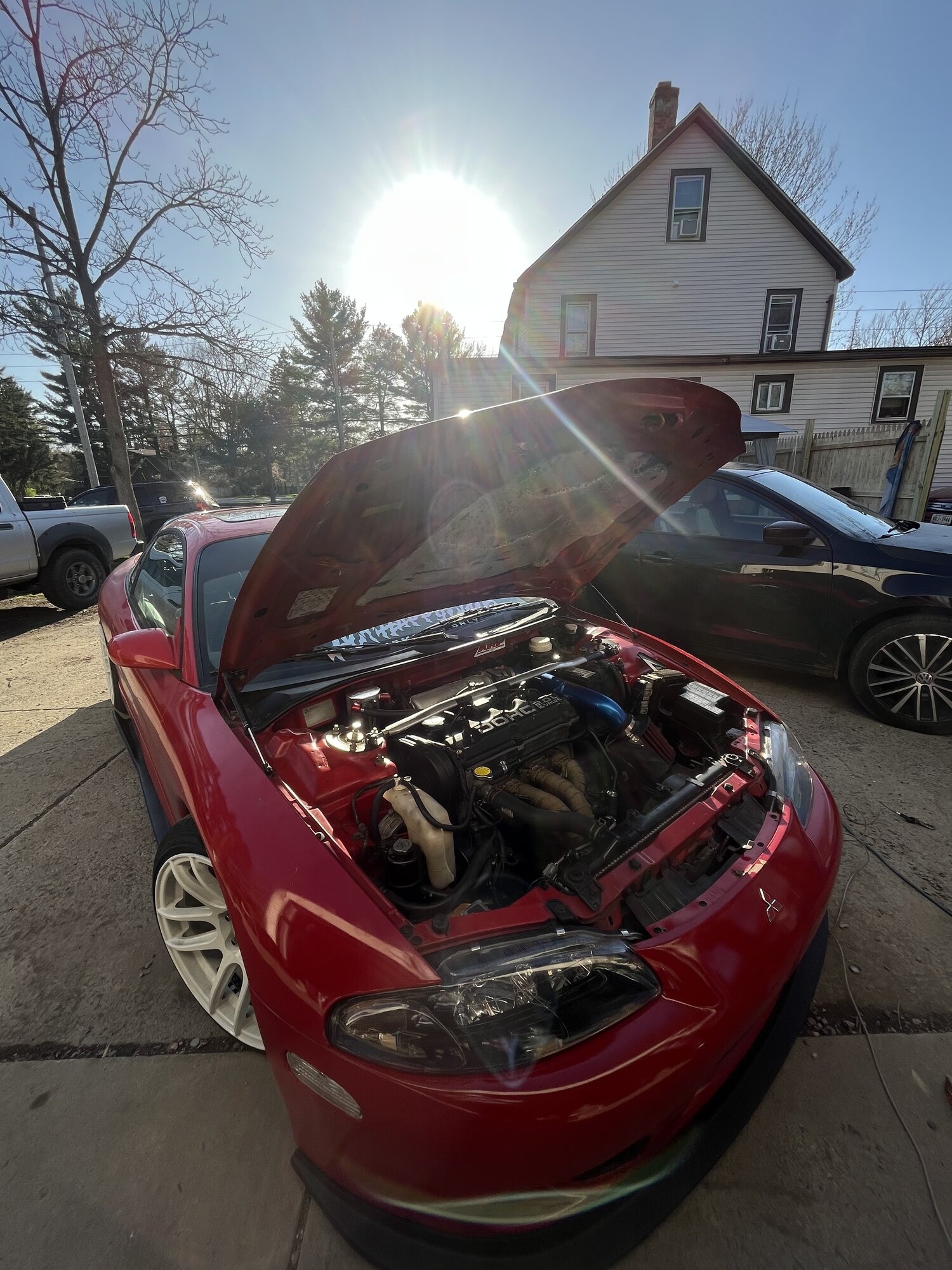

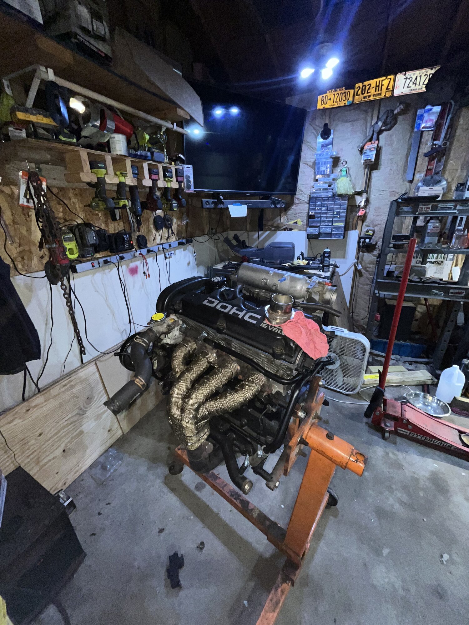

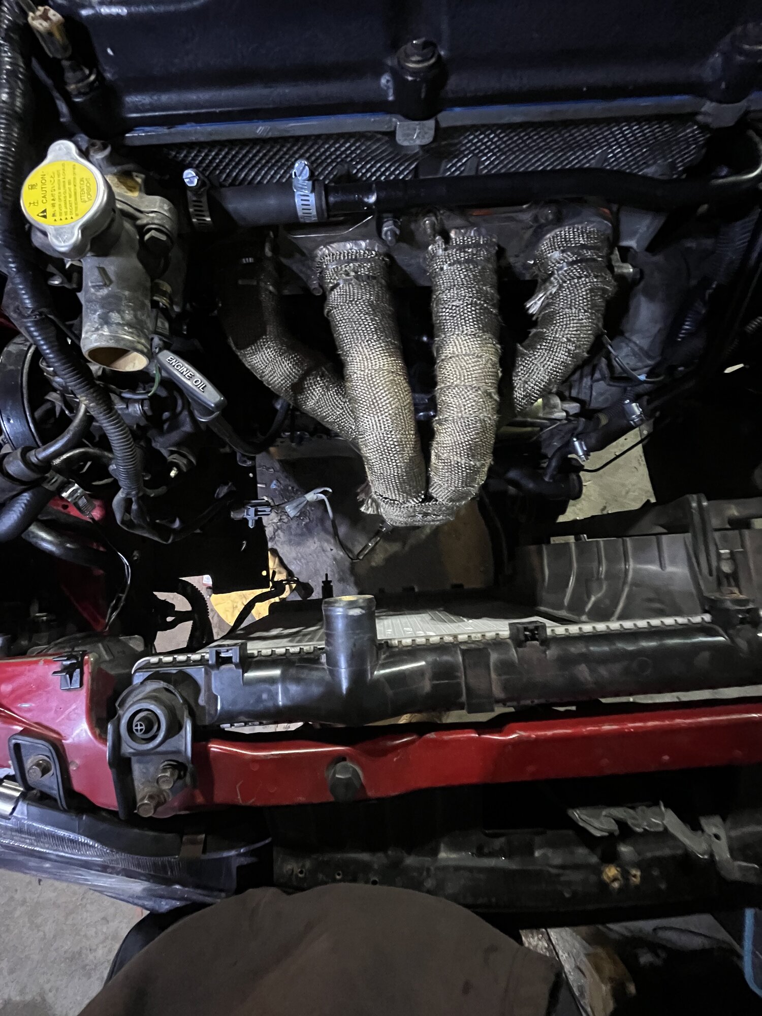

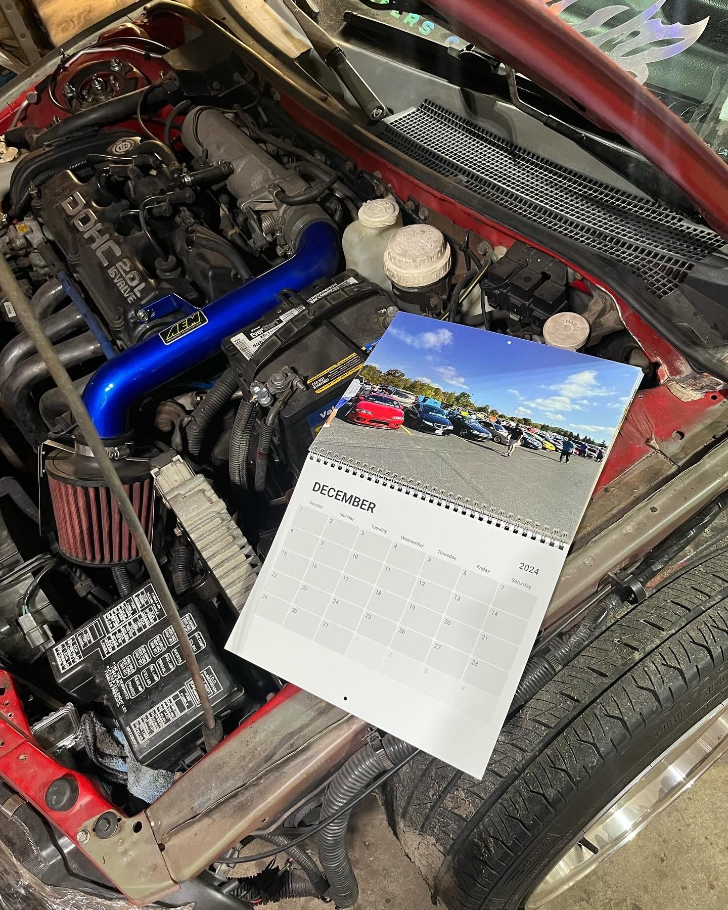

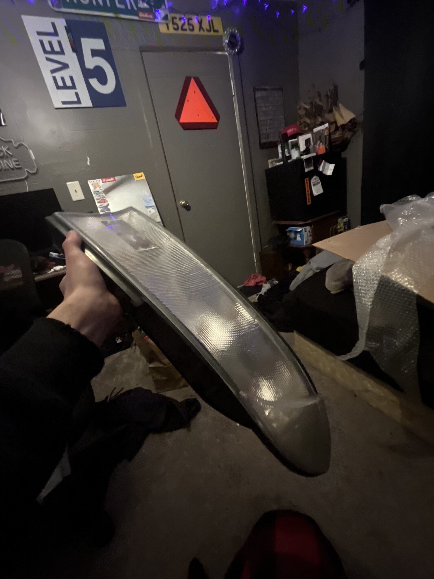

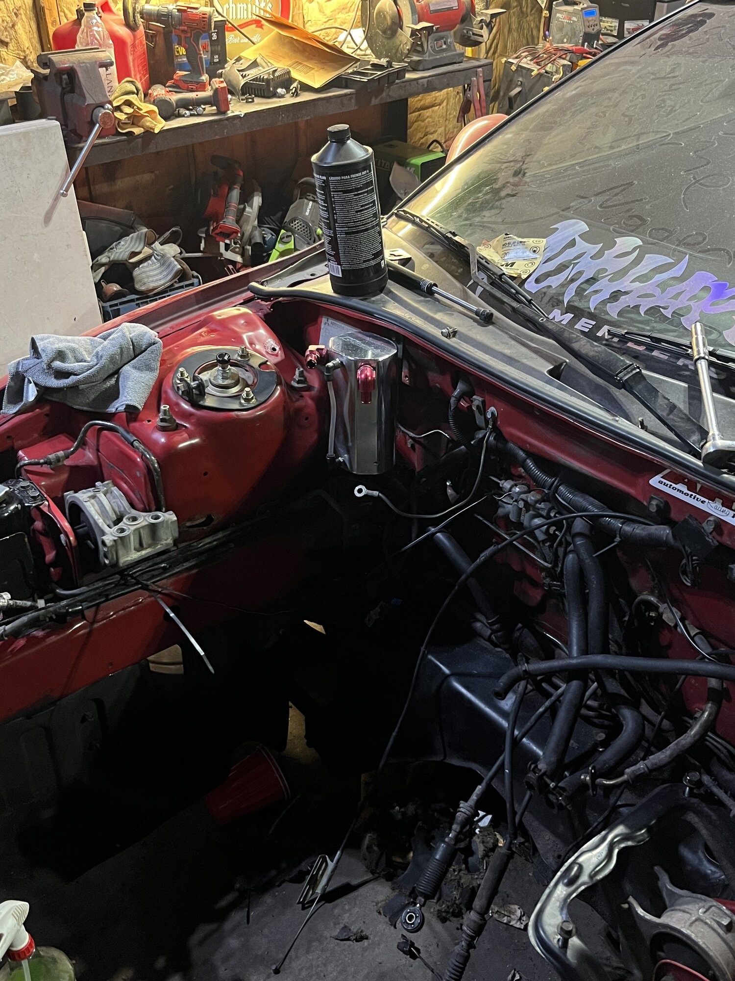

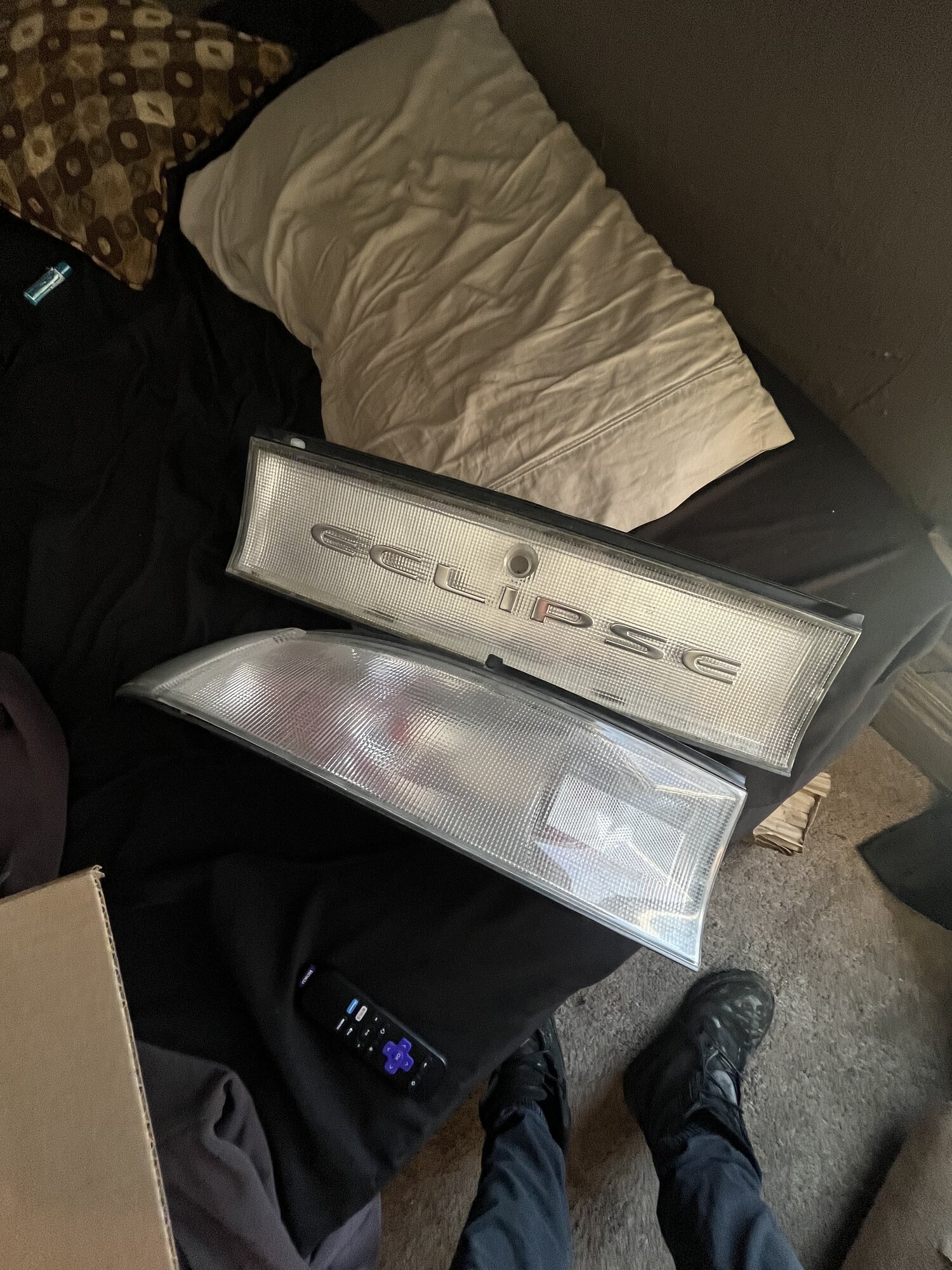

little late on the update but , rebuilt a motor over the winter , re did the interior with a new carpet , did pt lifters rockers arp studs cometic headgasket , gates timing new fuel inj new filter , had to redo the brake lines too much more coming also fixed the rear quarter paint , picked up an incomplete set of clears i’ll hopefully complete soon , greddy catch can i got for free
