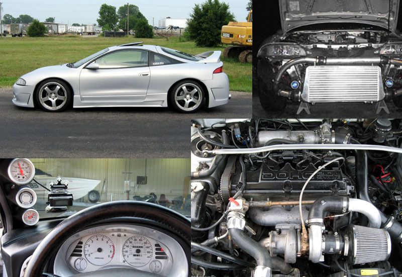

A link to the kit would be helpful for us to give you advice though. Treadstone did have a kit for the eclipse 420a for a long time. My build thread has all the parts I used.

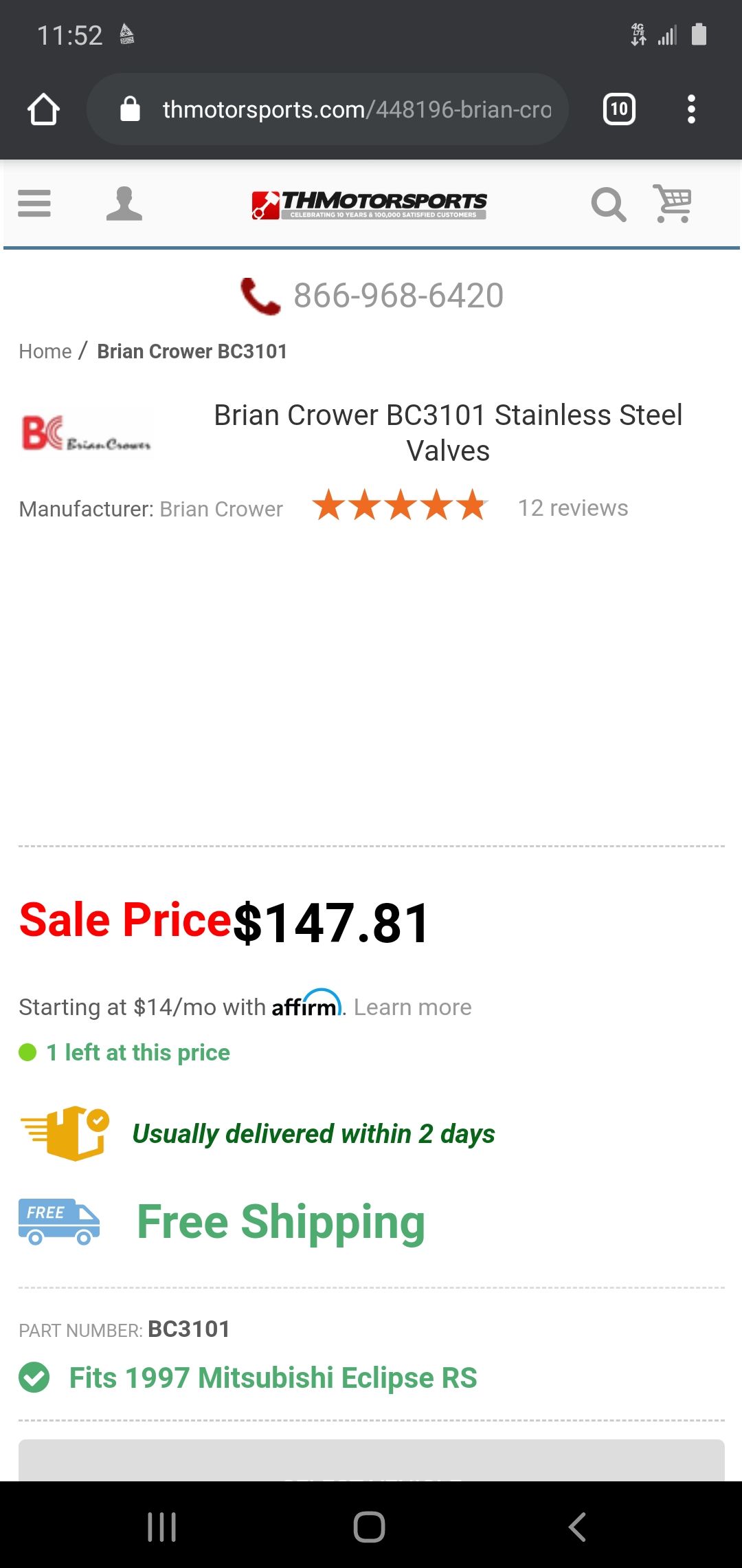

Hi , everyone i need some confirmation about some valves that i got. ok I came across a website called thmotorsport I was looking around and found some brain crower stainless steel valves. I already got the package, its from a 4g63 and it said that they will fit.
Any information would be a great help.
