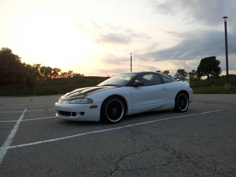

Here is the talon back when I was driving it.

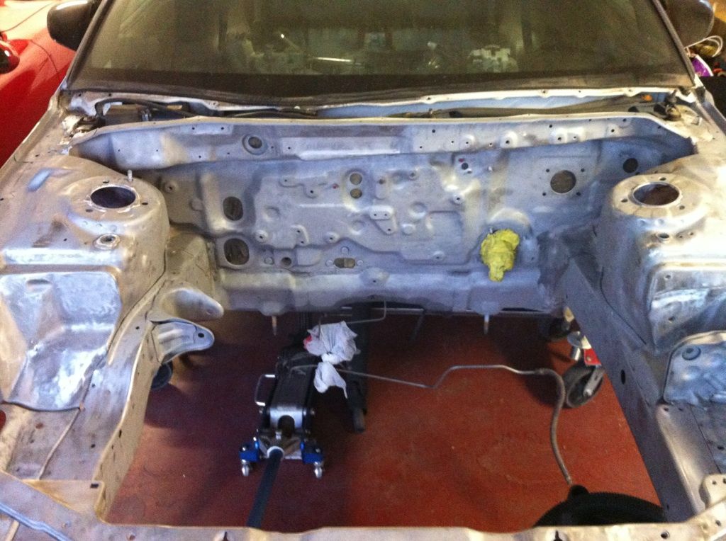

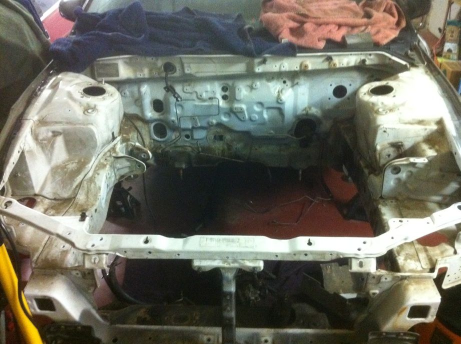

And here is a photo of the dirty engine bay.

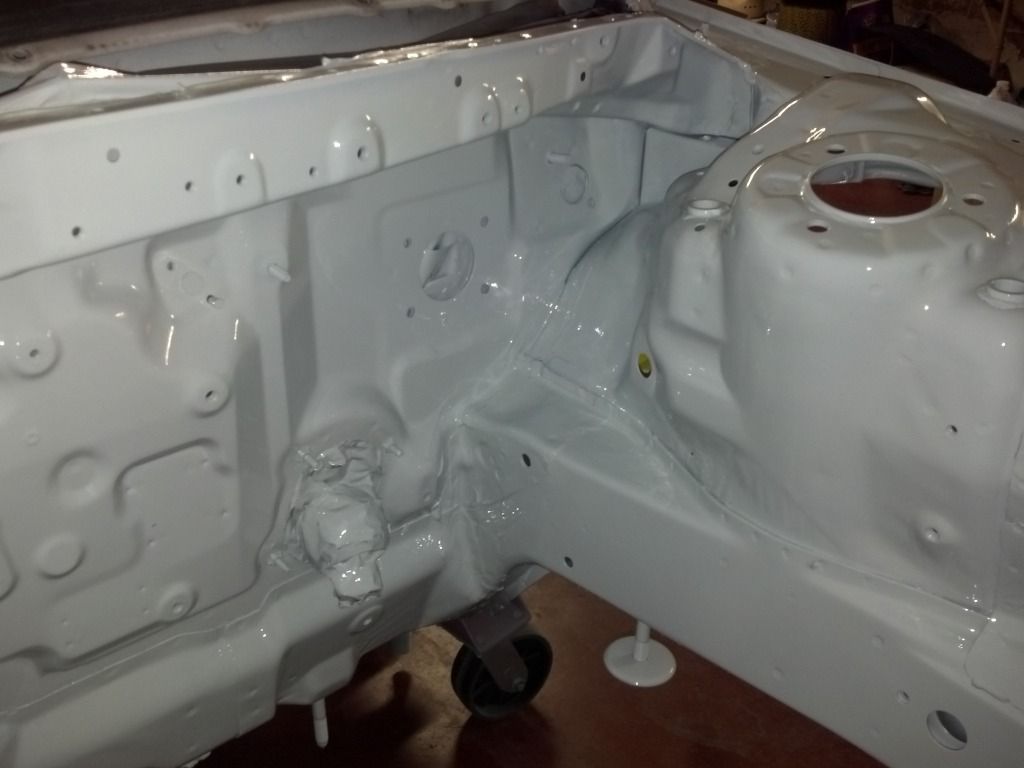

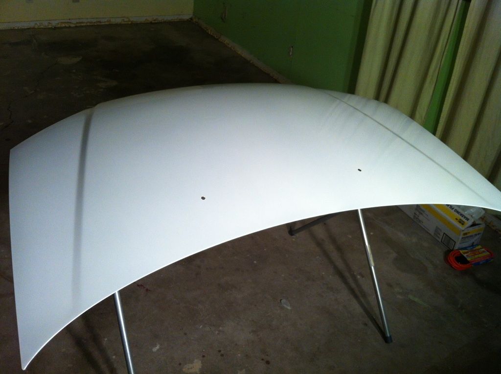

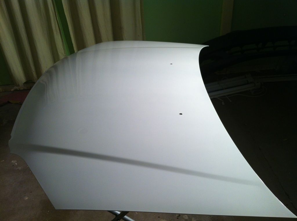

I have seen a lot of really awesome builds, and some really clean engine bays. I hope to also have nice new paint. I started practicing painting a little bit on this civic hood and other random test panels.

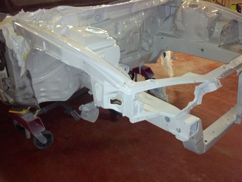

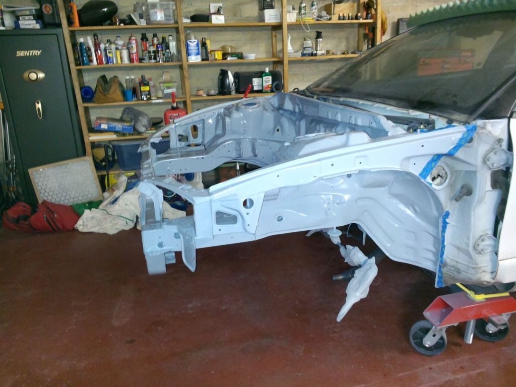

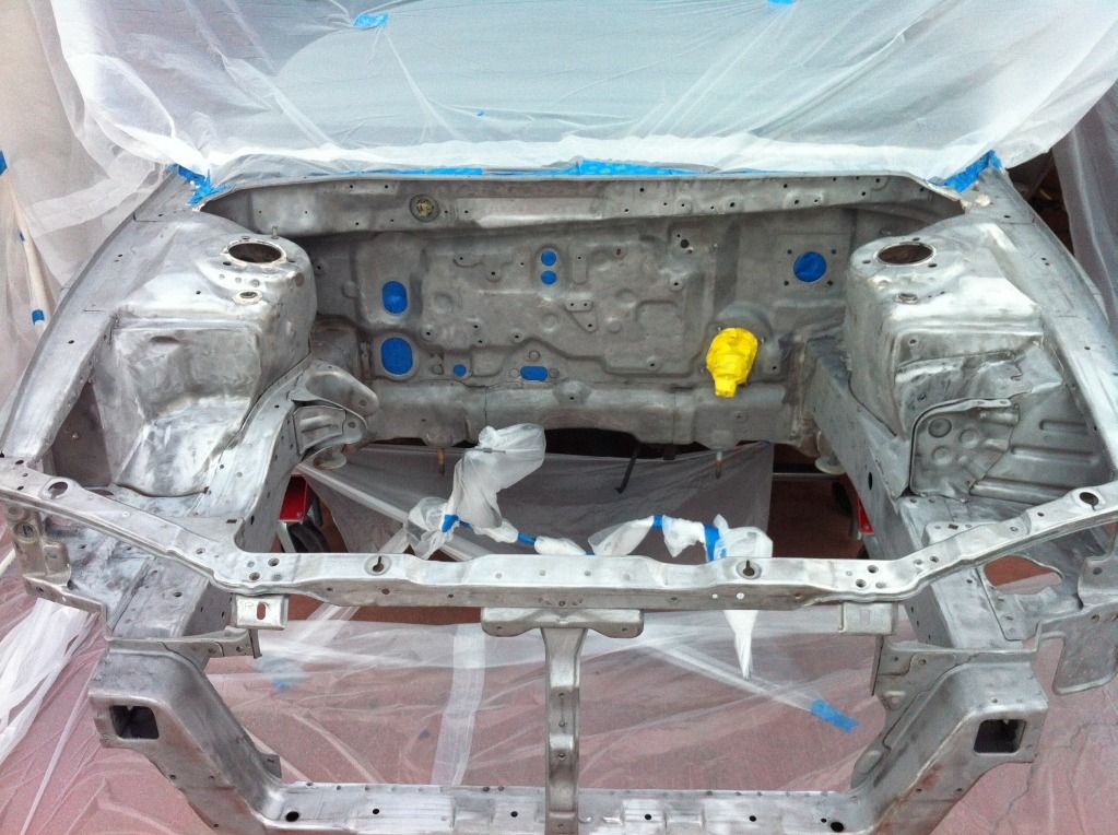

It was a really long process stripping down the engine bay and wheel well areas. I finally had to resort to sand blasting with aluminum oxide media.
It was pretty much all bare metal.

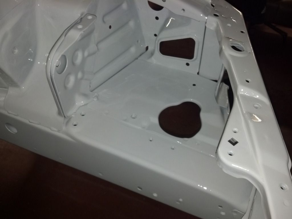

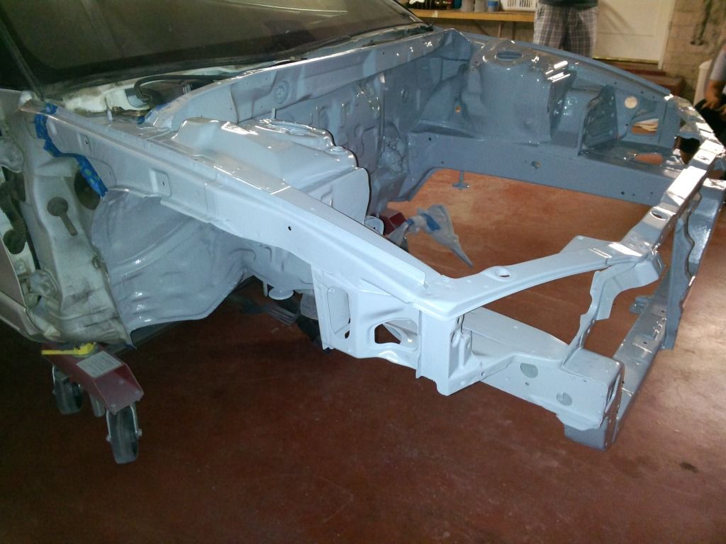

I decided to put some epoxy primer on it today, and hopefully get the paint on it next week.

White is in the plans, but I am still unsure what to do because I have all the parts to do a 2gb eclipse conversion. I may just convert it to a 2gb eclipse and make it all white. It's more of a down the road decision though. For right now, the engine bay just needs to be painted so I can start getting things together in there.
This is the base coat I will be using. Dupont Cromax Pro - code PW7 (Bright Northstar White)

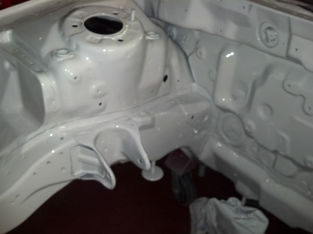

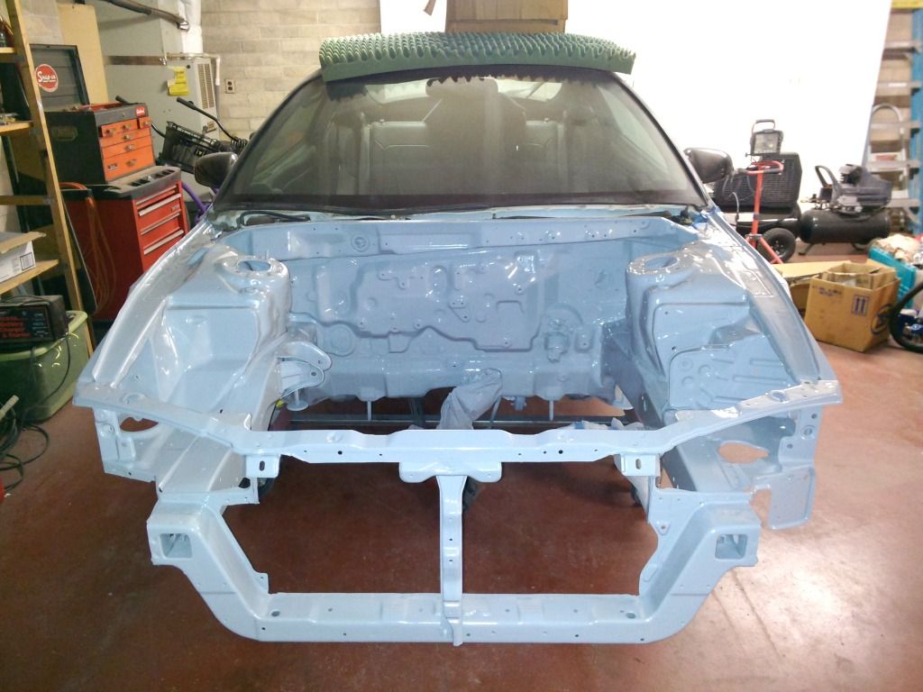

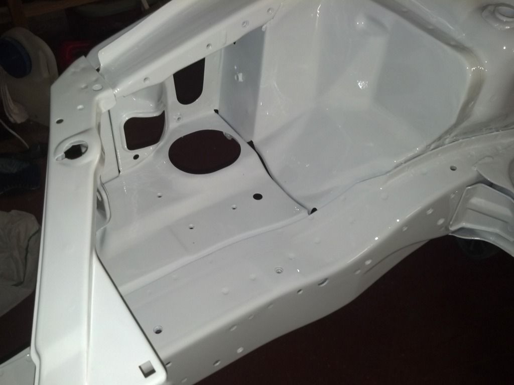

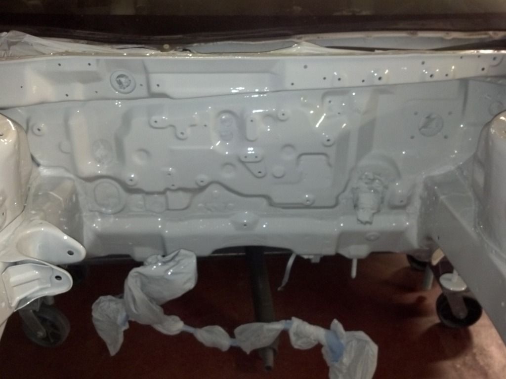

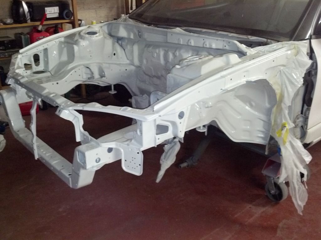

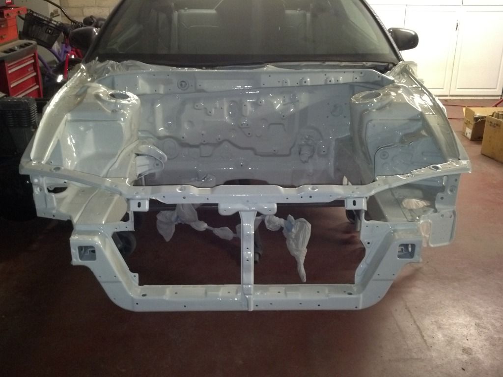

I was able to get the paint on it last night. I think it turned out really well. I really like the color as it was intended instead of my faded dirty old paint. The pictures were taken only a couple hours after the clear coat was applied so it still looks a little wet. Anyways, this will probably be the last update for a while. I have a 6 bolt being built and I'll try to update when that comes back and everything is together.

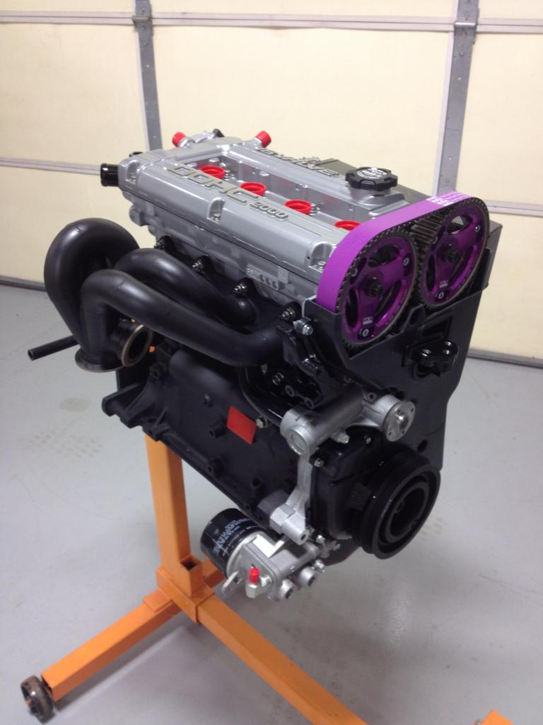

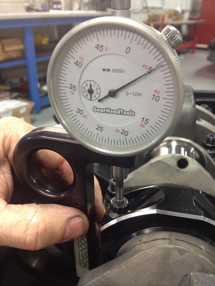

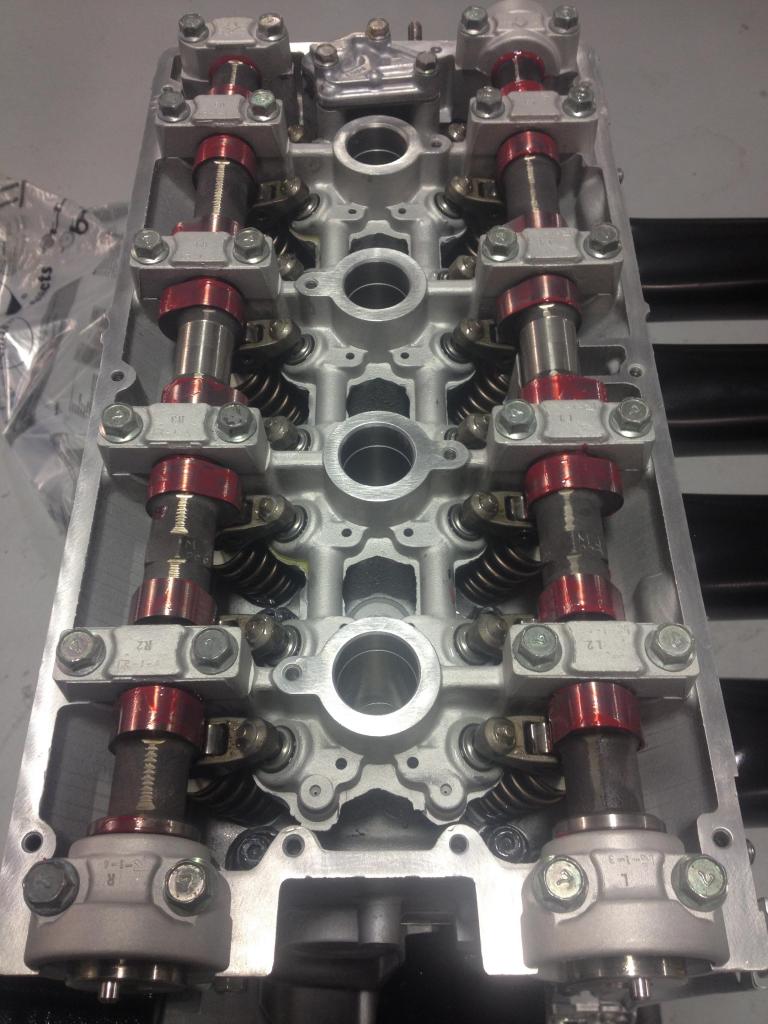

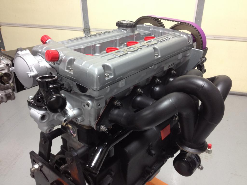

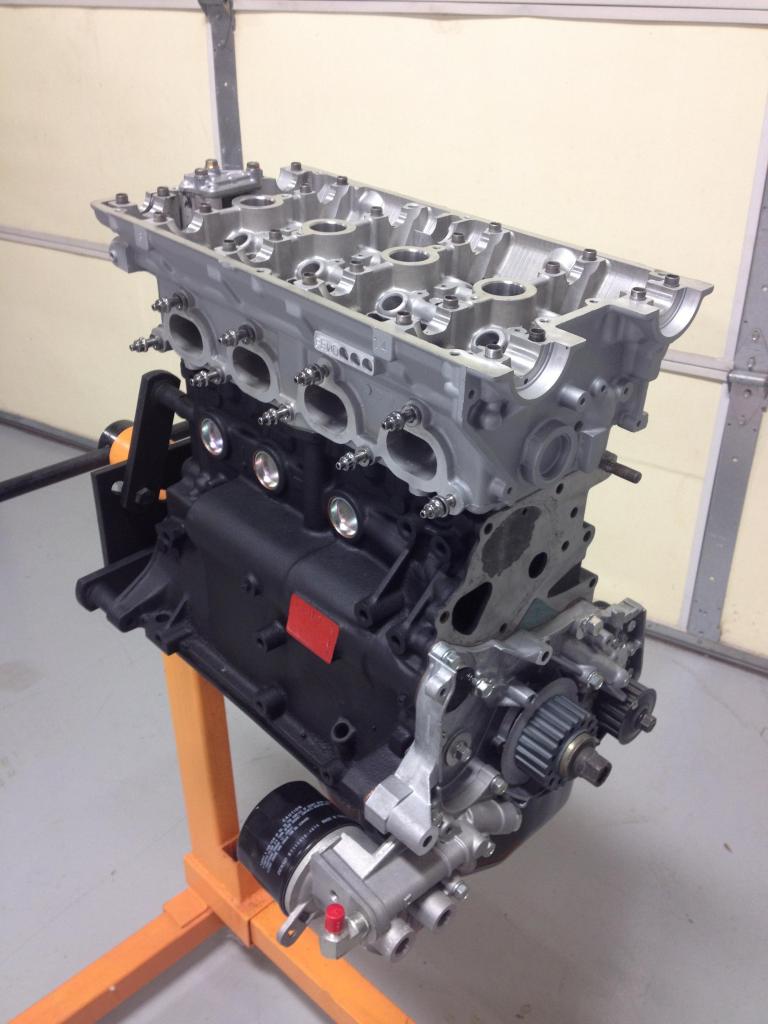

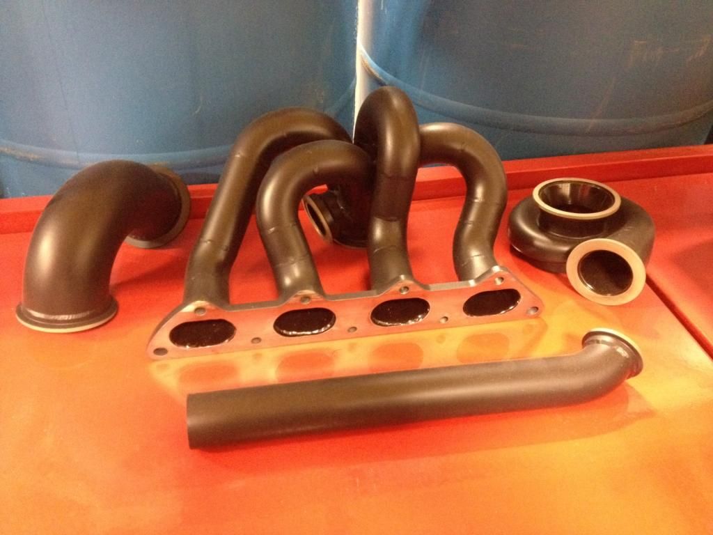

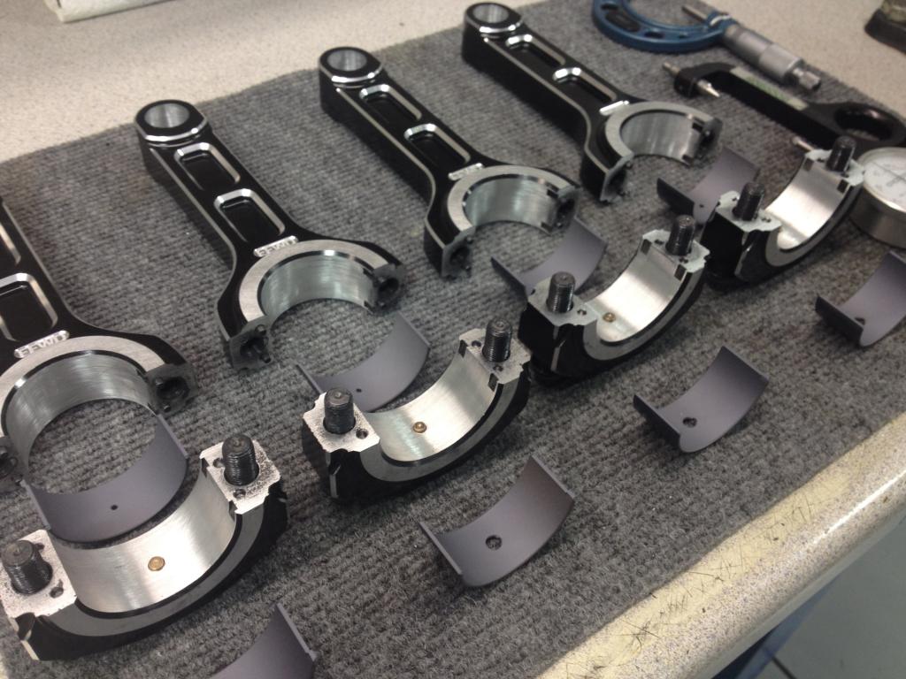

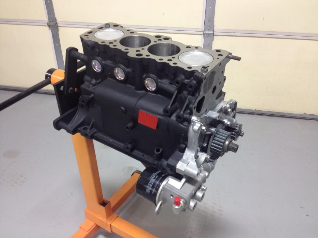

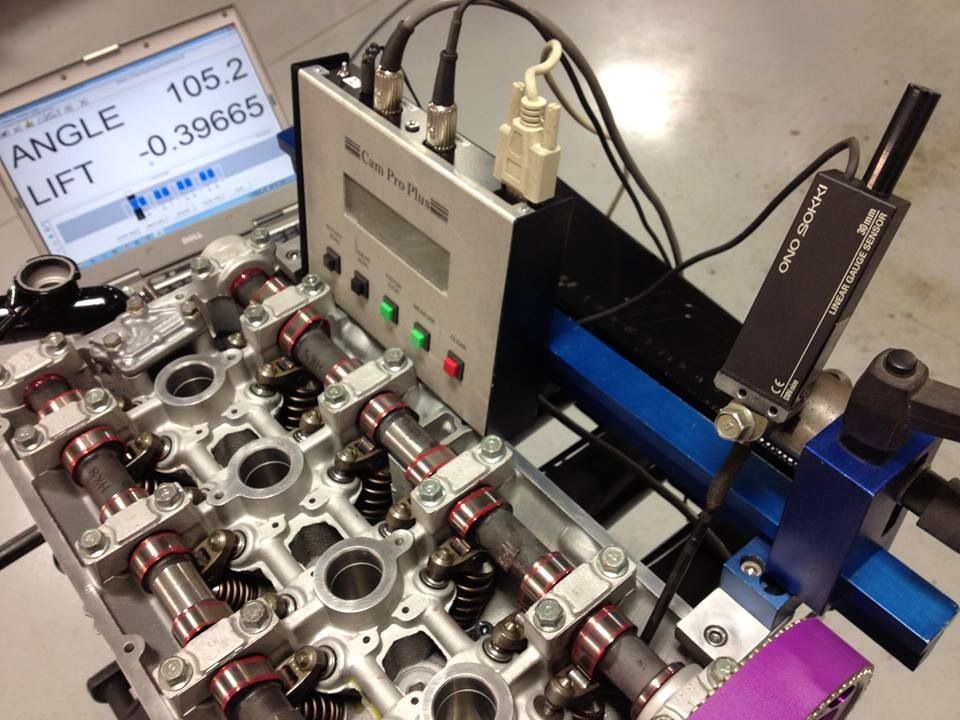

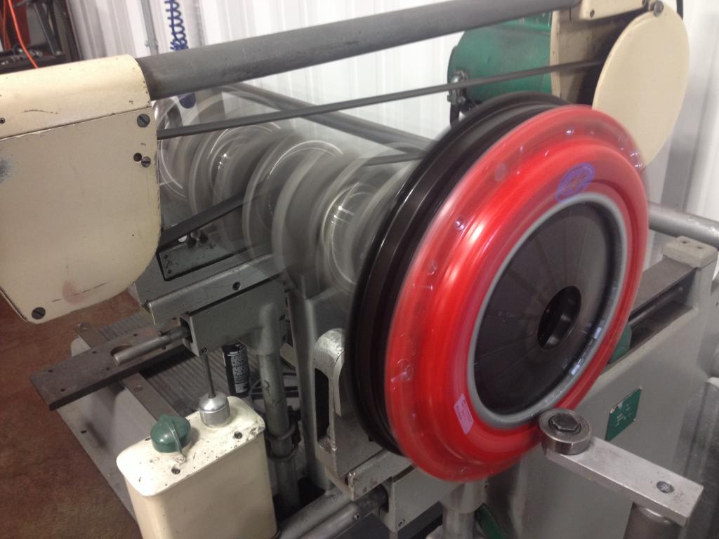

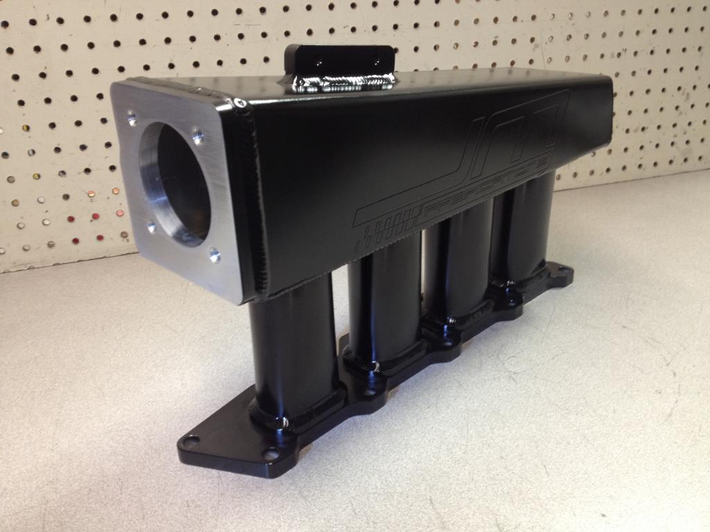

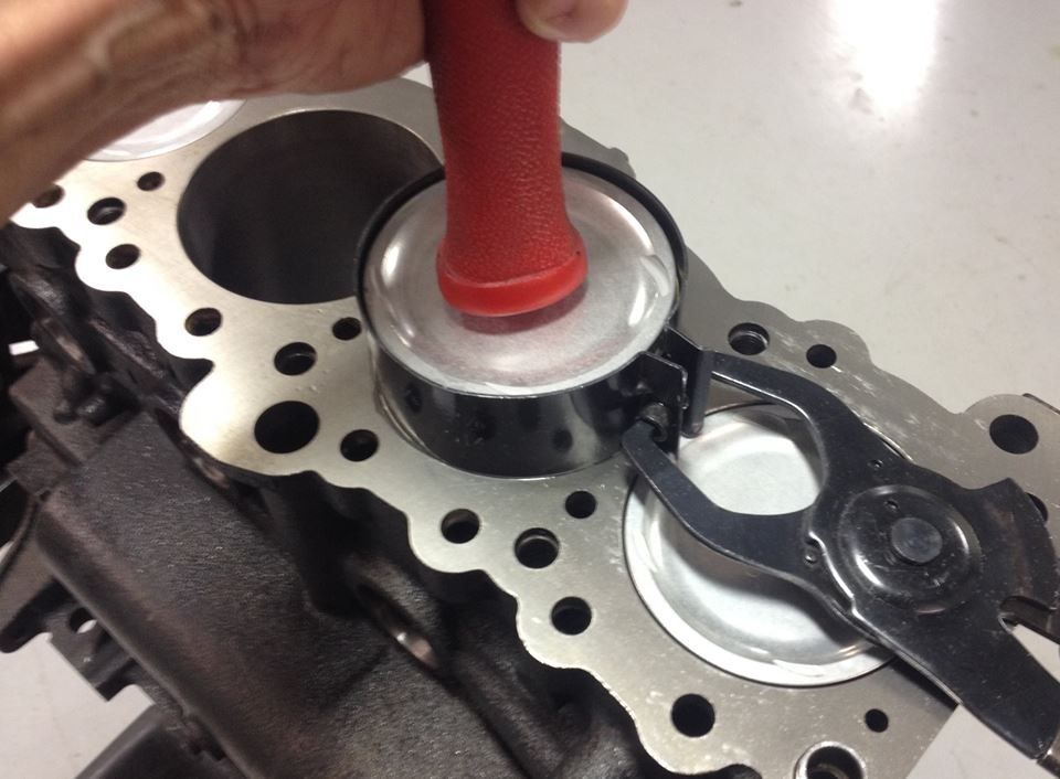

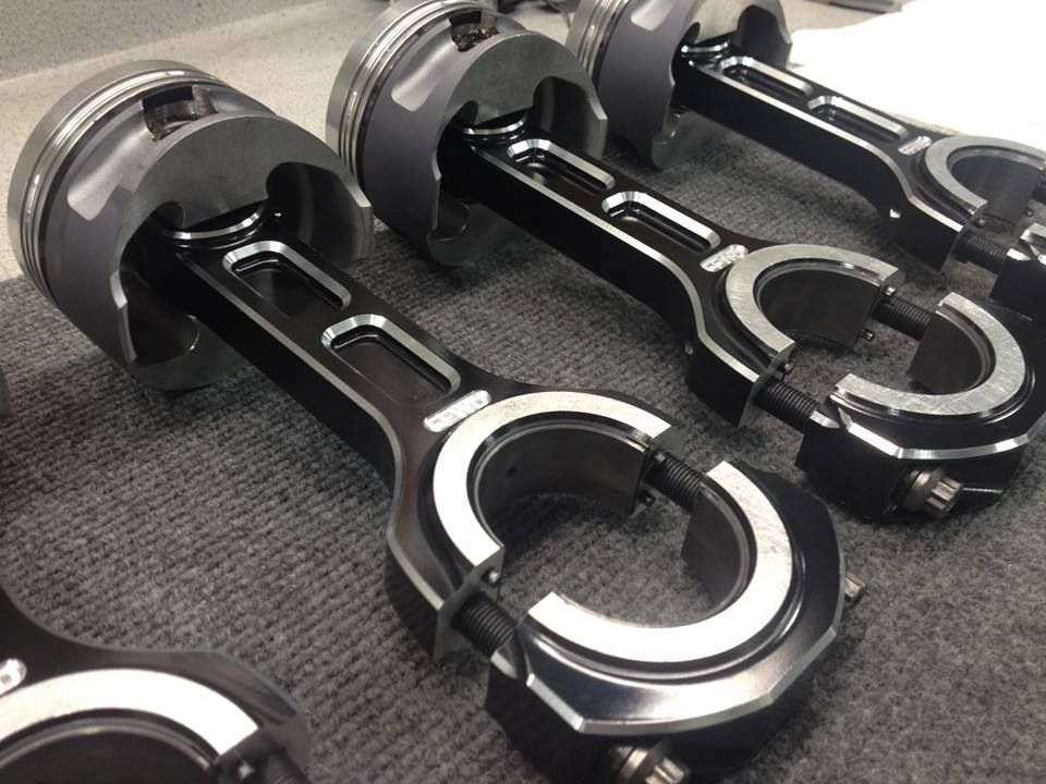

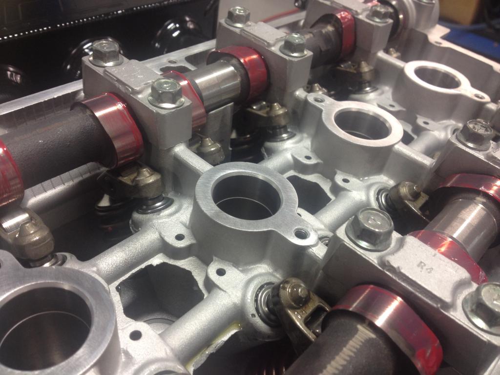

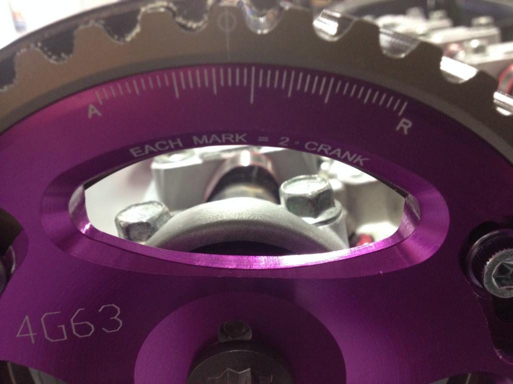

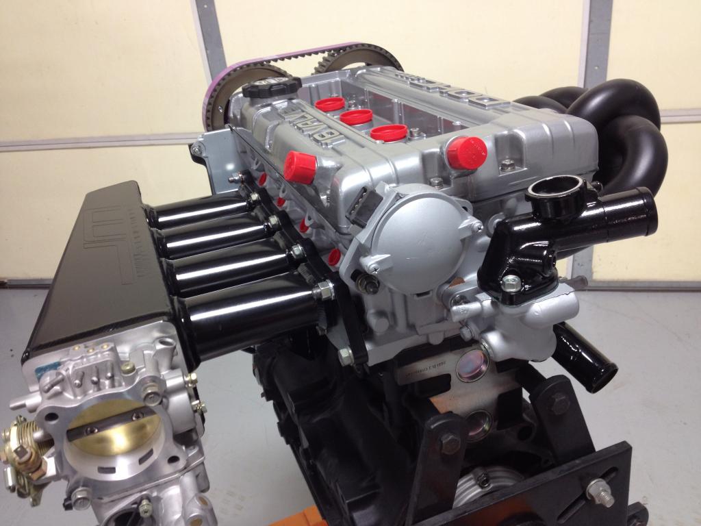

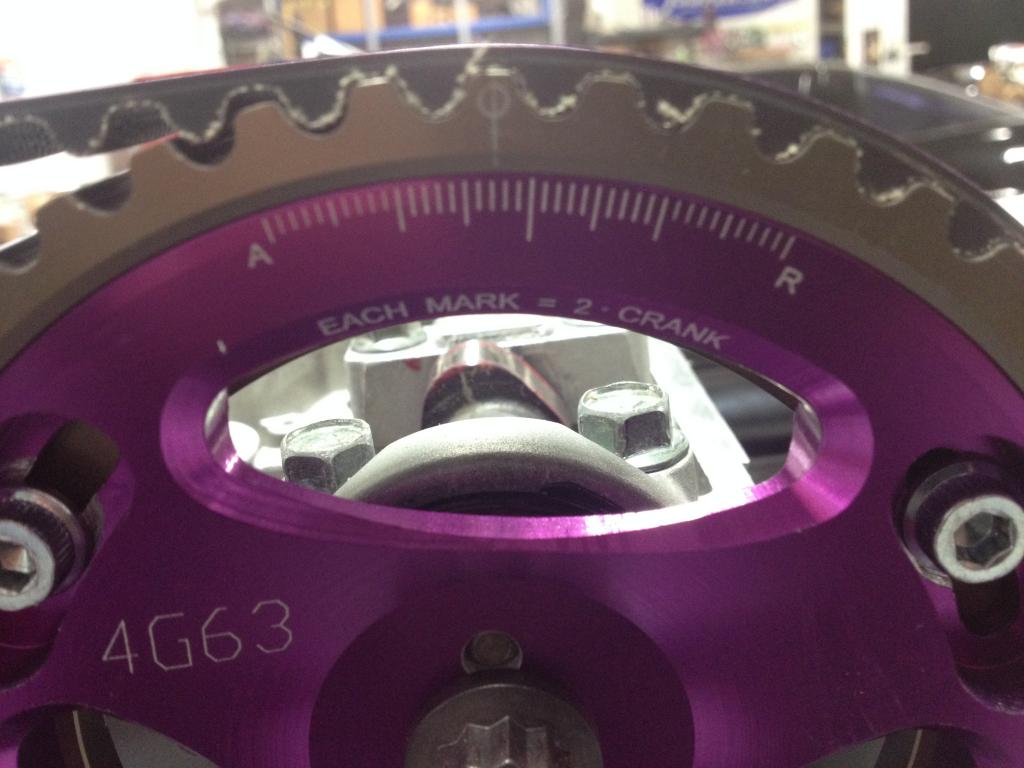

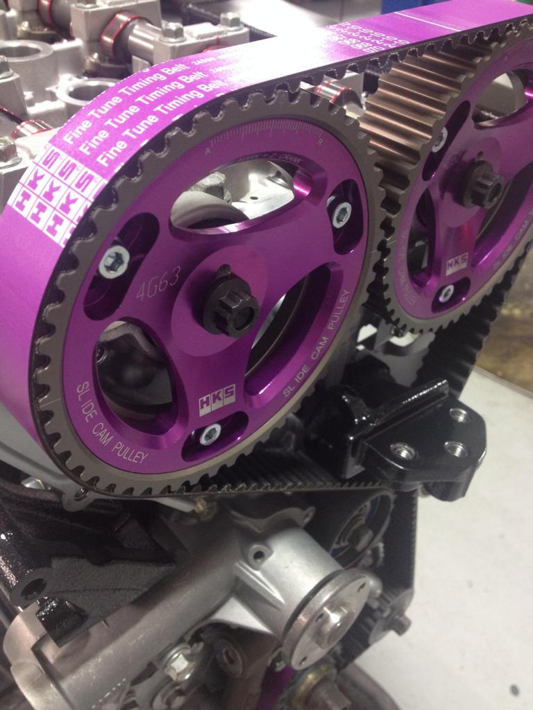

It has been forever, but I'm just slowly tinkering and getting things together. I wanted to share updates because the engine is close to being done, and I'm very impressed.
Narly! Your going all out with that engine, looks like a beaut.
dont know if your still going with eclipse conversion or not, but I wouldn't. People need to remember that its your car tho not theirs so you do it to your liking. Keep up the good work.
Build looks great but I'll be so sad if another talon is converted to an eclipse :cry: I agree the 2GB eclipse front bumper looks better but the 2ga talon body style is the most beautiful of them all IMO. Especially the pandas! But hey, it's your car and you have full reign to make it how you like
Mmmmm, vader rods. Drool....
Looks freaking bad ass man.
Seriously, you could eat sushi off that engine, so clean...
Why not go q45 tb?

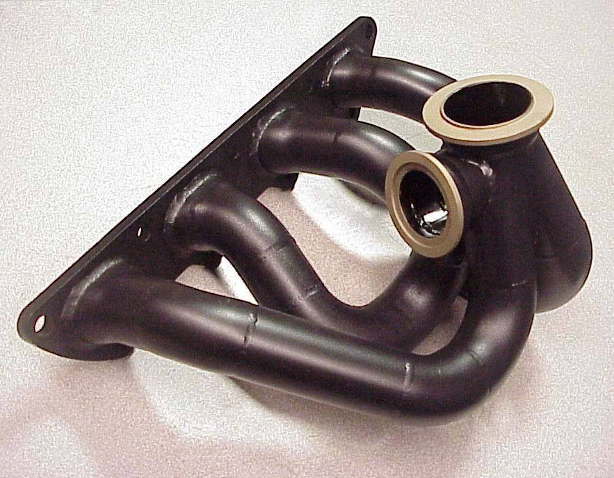

I actually thought about going with a larger throttle body, and it is a little strange since everything else is upgraded. I just didn't feel like it would hold me back from my goals. Although I suppose the header and SMIM and aluminum rods are a little overkill as well.
Looks so good. Keep up all the good work. That shop/work area you have also looks super nice.
