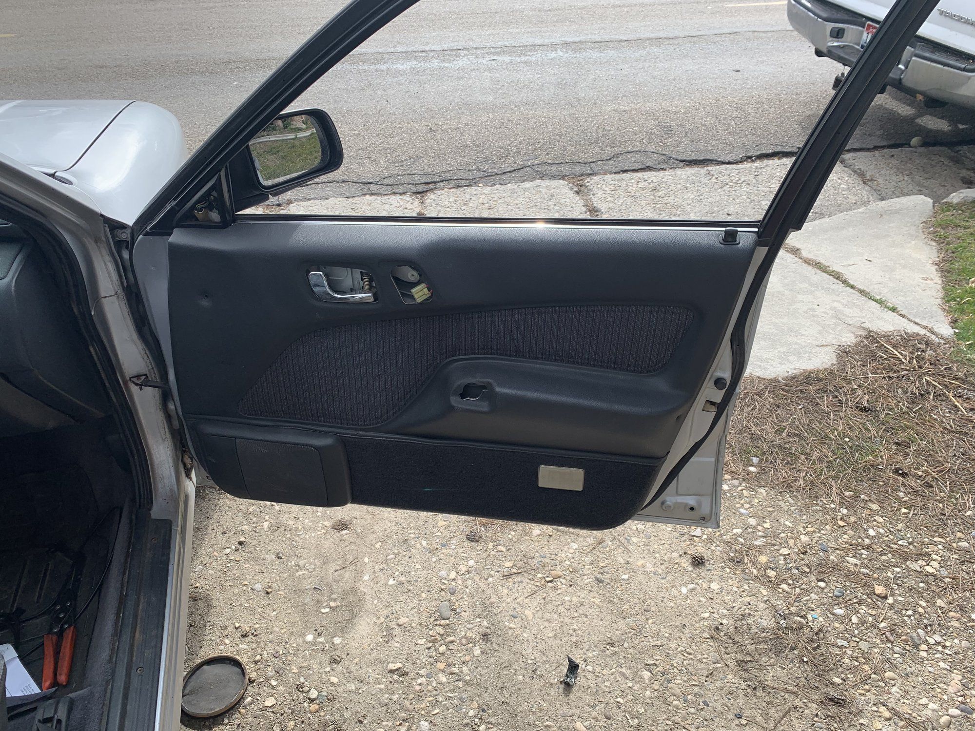

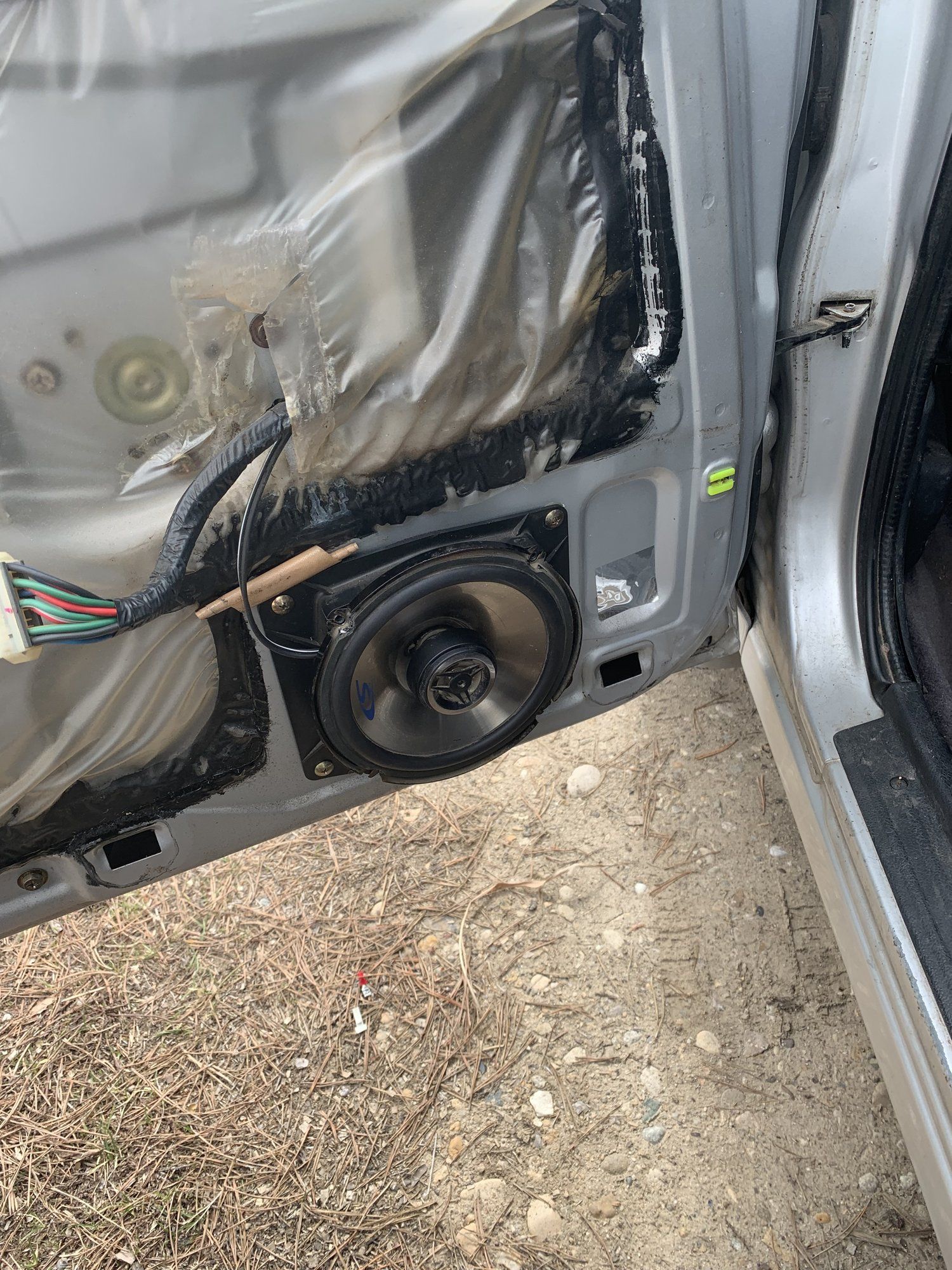

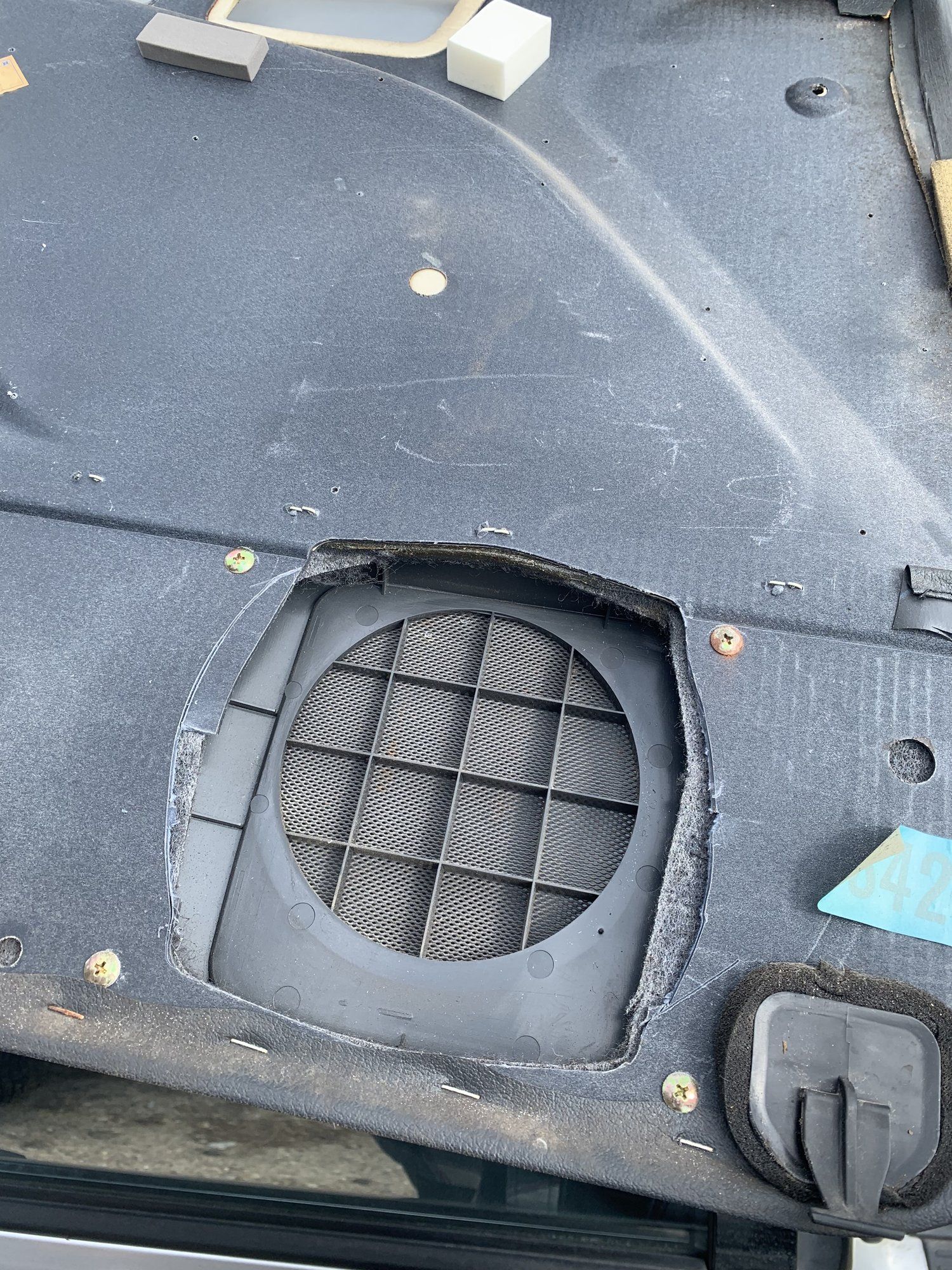

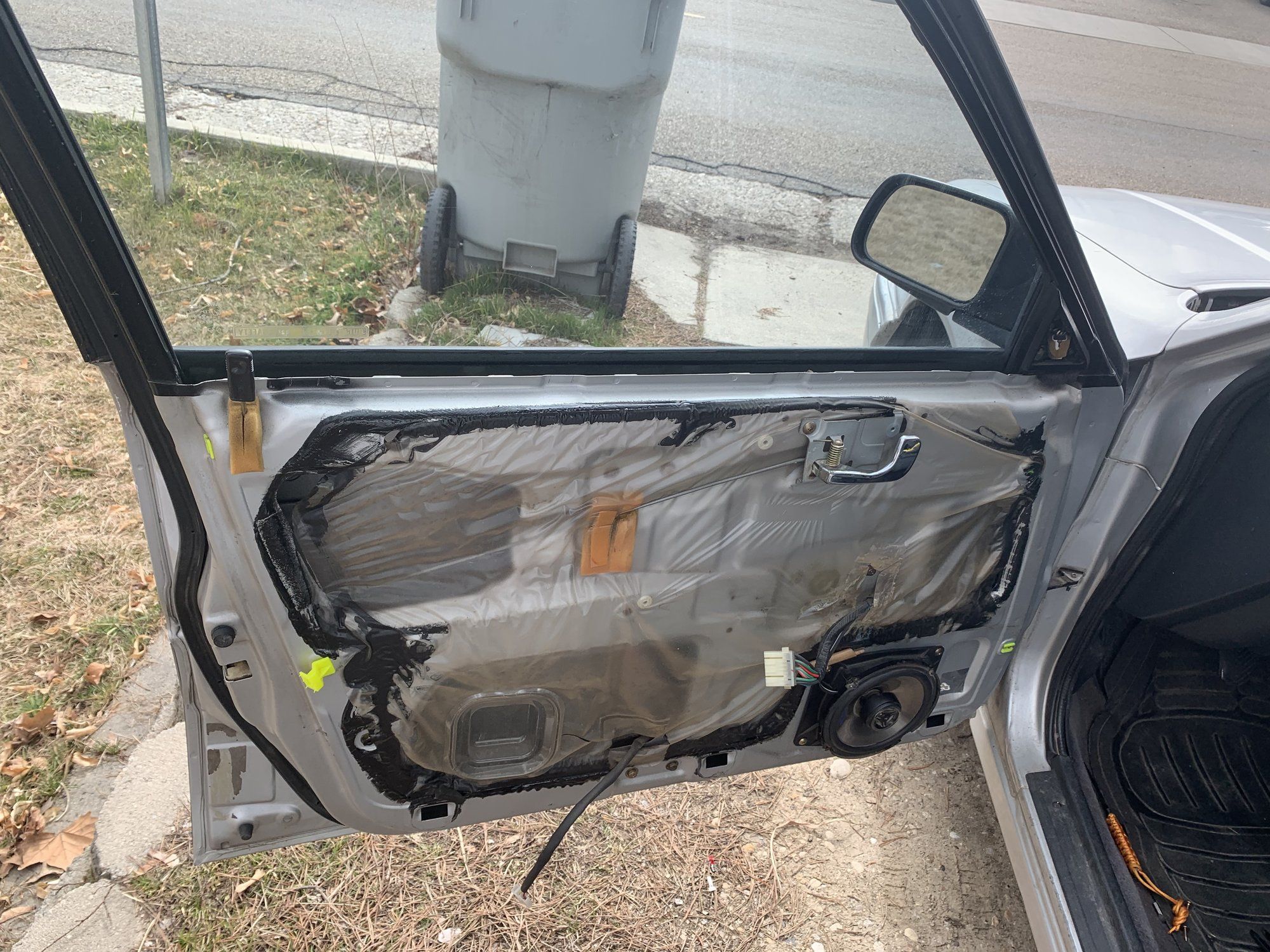

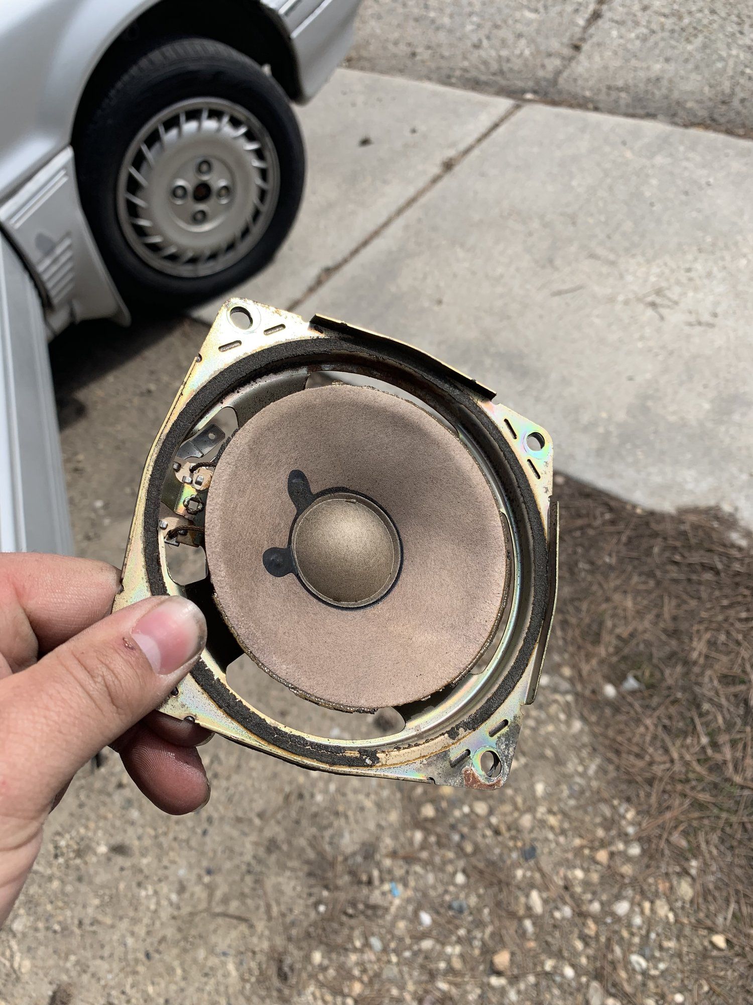

Just the first step in making this thing mine. Had to fix the speakers. As you can see from the photo. They were shot. Found some type s 6.5s at the pawn shop for 20 bucks so said what the heck. Started by pulling the drivers door panel. Pulled the old dead speaker, crimped on the connectors to fit the new speakers and installed the new one in the factory speaker housing. Fits like a glove but you have to make sure it’s facing the right way with the connectors due to the molded plastic. Forgot to take a pic of either side without a speaker in the frame. Went to install the door panel and it wouldn’t fit. Found the original size speaker was a bit smaller and didn’t protrude out of the door so far. So I had to do some trimming. Again I forgot to take a before pic but I had to trim about a half in or just over on each side of the speaker. Installed the door panel and boom front speakers are now working. Sound is much better now that the speakers aren’t blown. Haha

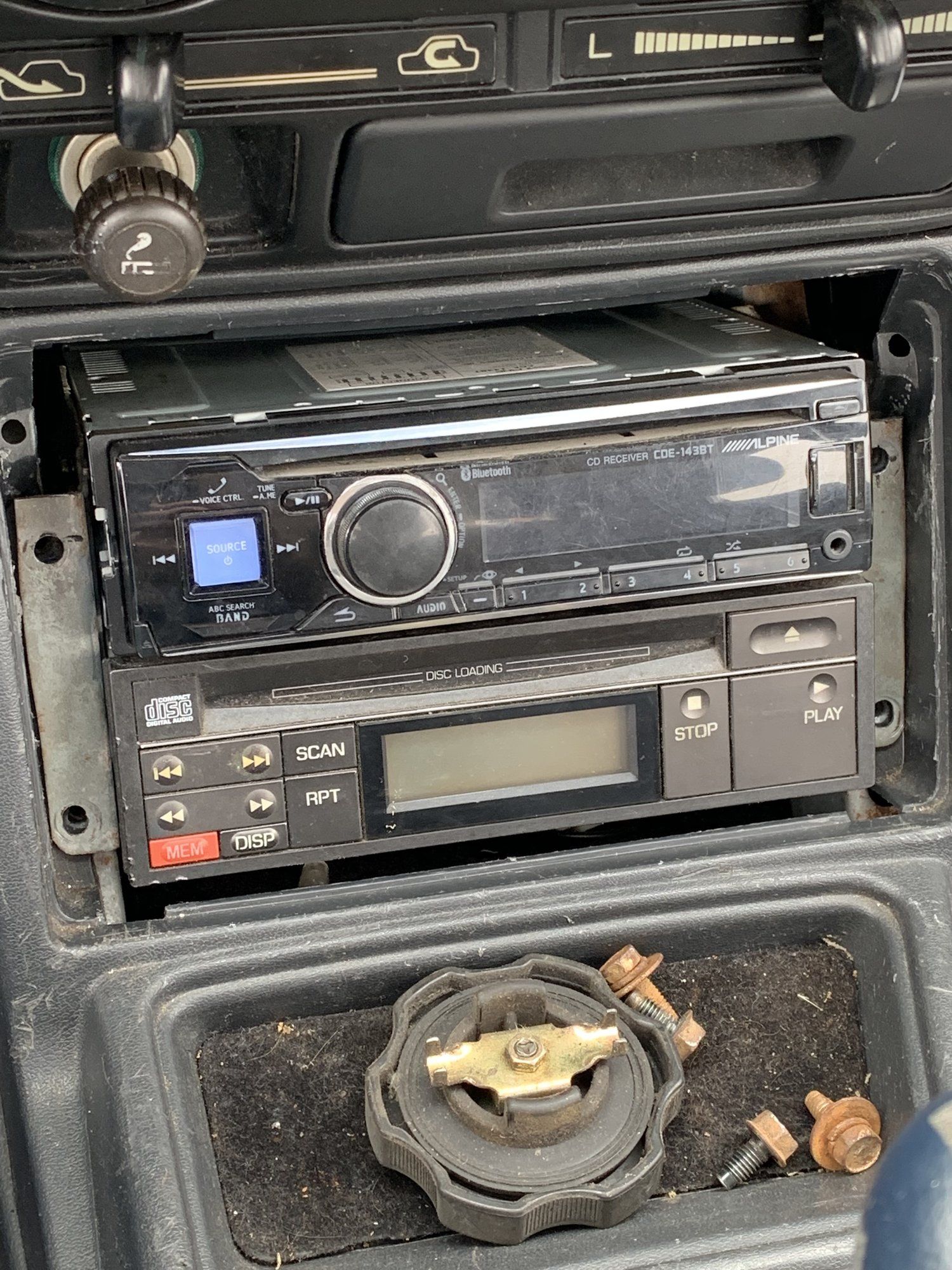

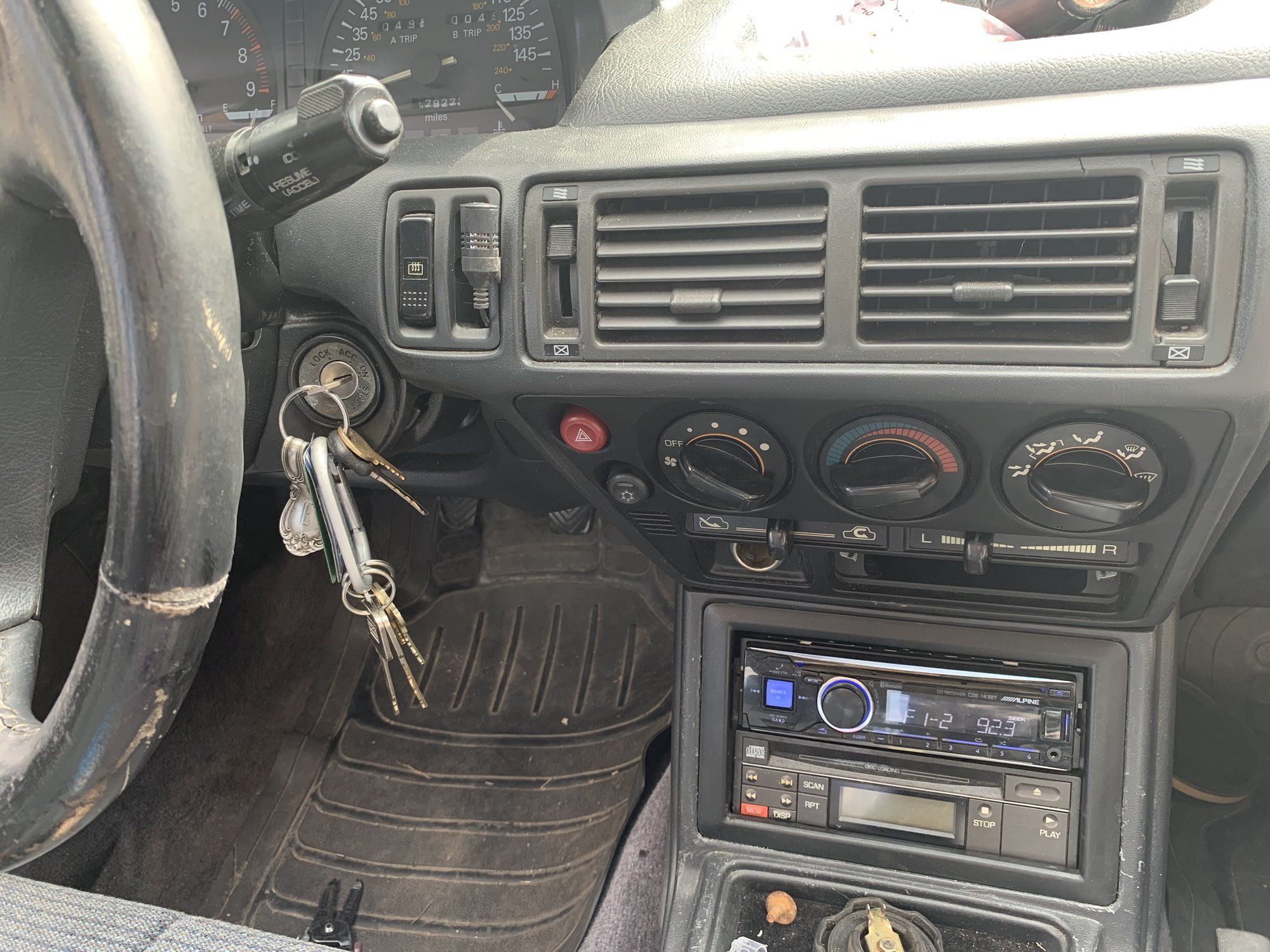

Next was the deck. Had a nice one laying around so figure it was time for an upgrade. Pulled the old deck out, it was an alpine too, and found a hack job from the po. The wires were “spliced” with electrical tape. So to the local stereo shop for the right butt connectors. Got a pack of 100 for 7 bucks so that was cool. Wired it in properly and reinstalled. May need to buy a stereo dash kit but for now it will work.

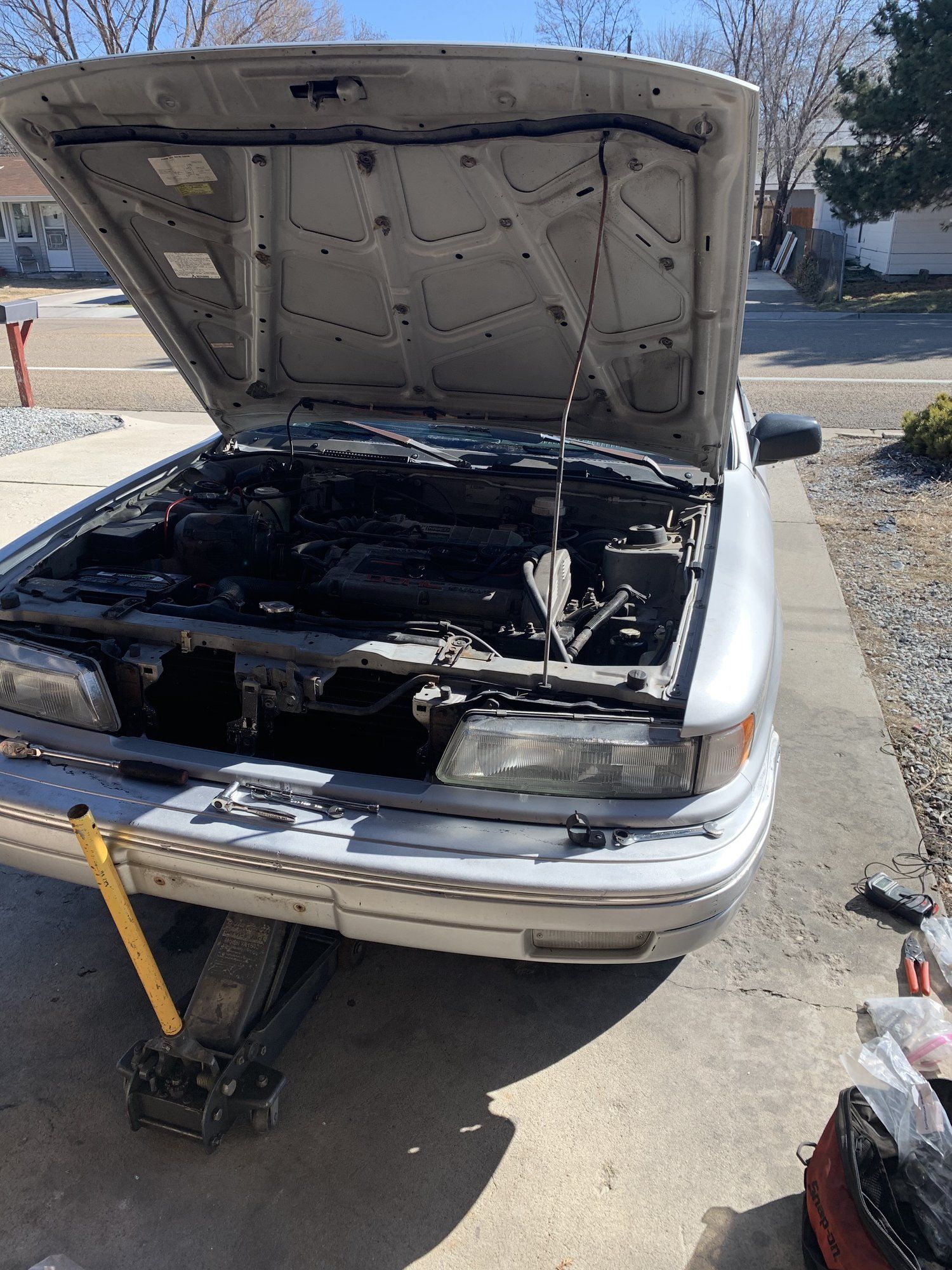

Today was the first of repairs mechanically to the gsx. Had a squeaky alt belt and was missing the ac belt. So bought the ac belt and tore into it. Belt replacement is pretty straightforward so I’ll soare ya the details. Pulled off the alt belt then install the new ac belt. Installed the alt bet again and tightened everything up. Fired it up and boom no lore belt squeal. Thank god. Do have a small chirp once and a while but I’ll mess with that later. The squeal was terrible. Next was to check all maintenance items and start a list. List to be done in near future as follows.
Plugs
Wires
Air filter
Radiator bushings
Valve cover gaskets and what I believe to be a oil pan gasket but it’s hard to tell oil all over the front end of the motor.

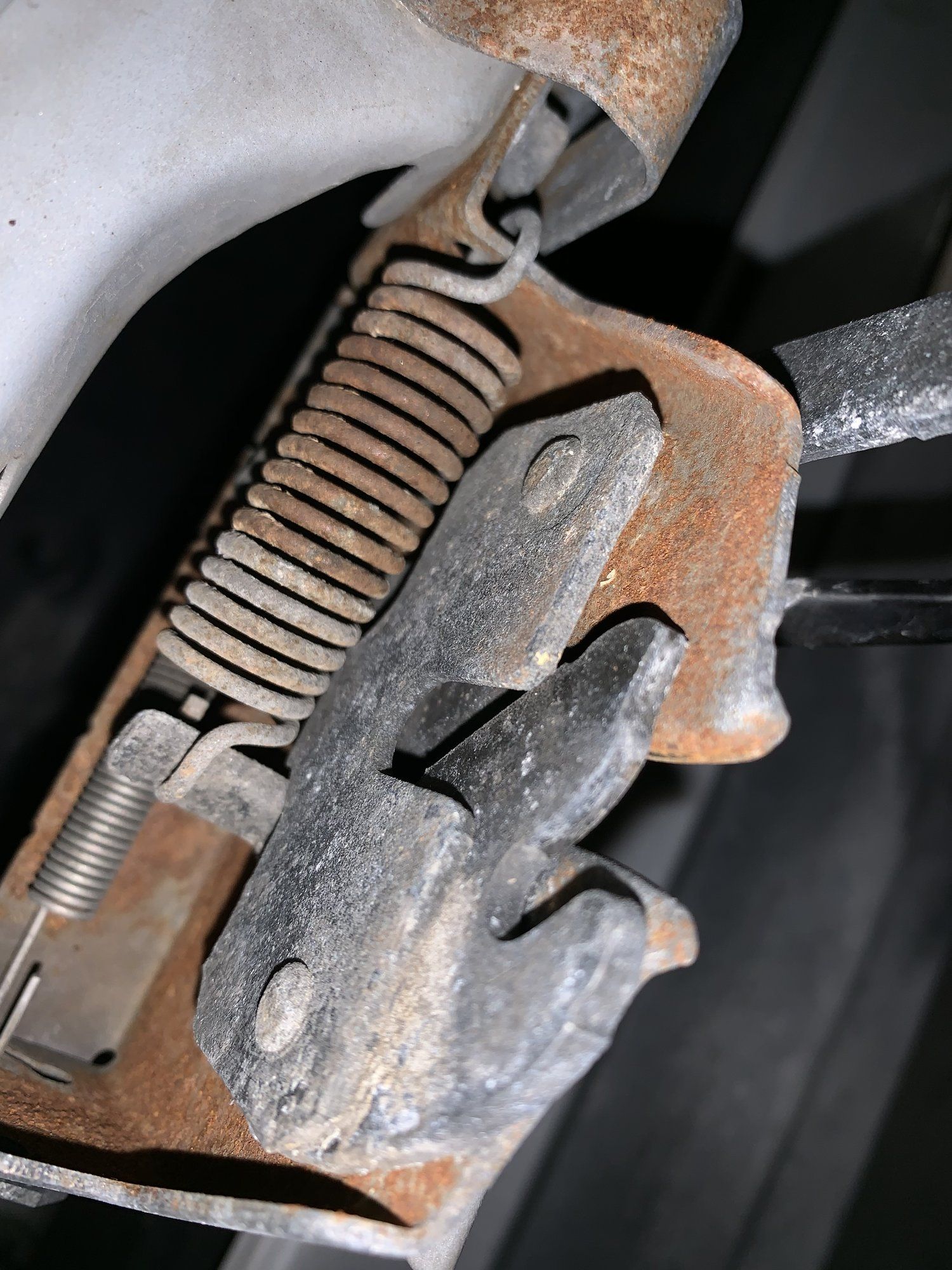

Also found the hood was getting difficult to pop so grabbed some white lithium grease and sprayed her down good on the hood latch. Works like a dream now.

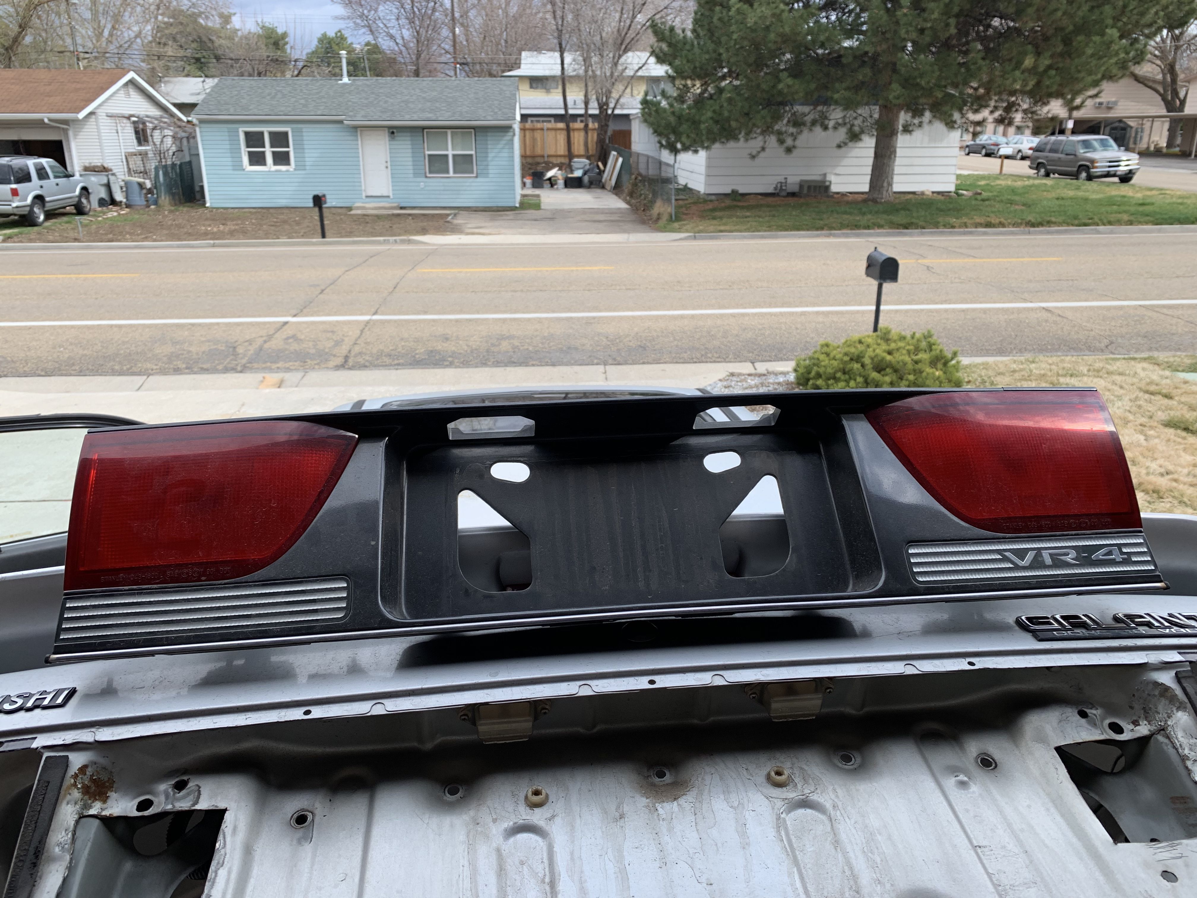

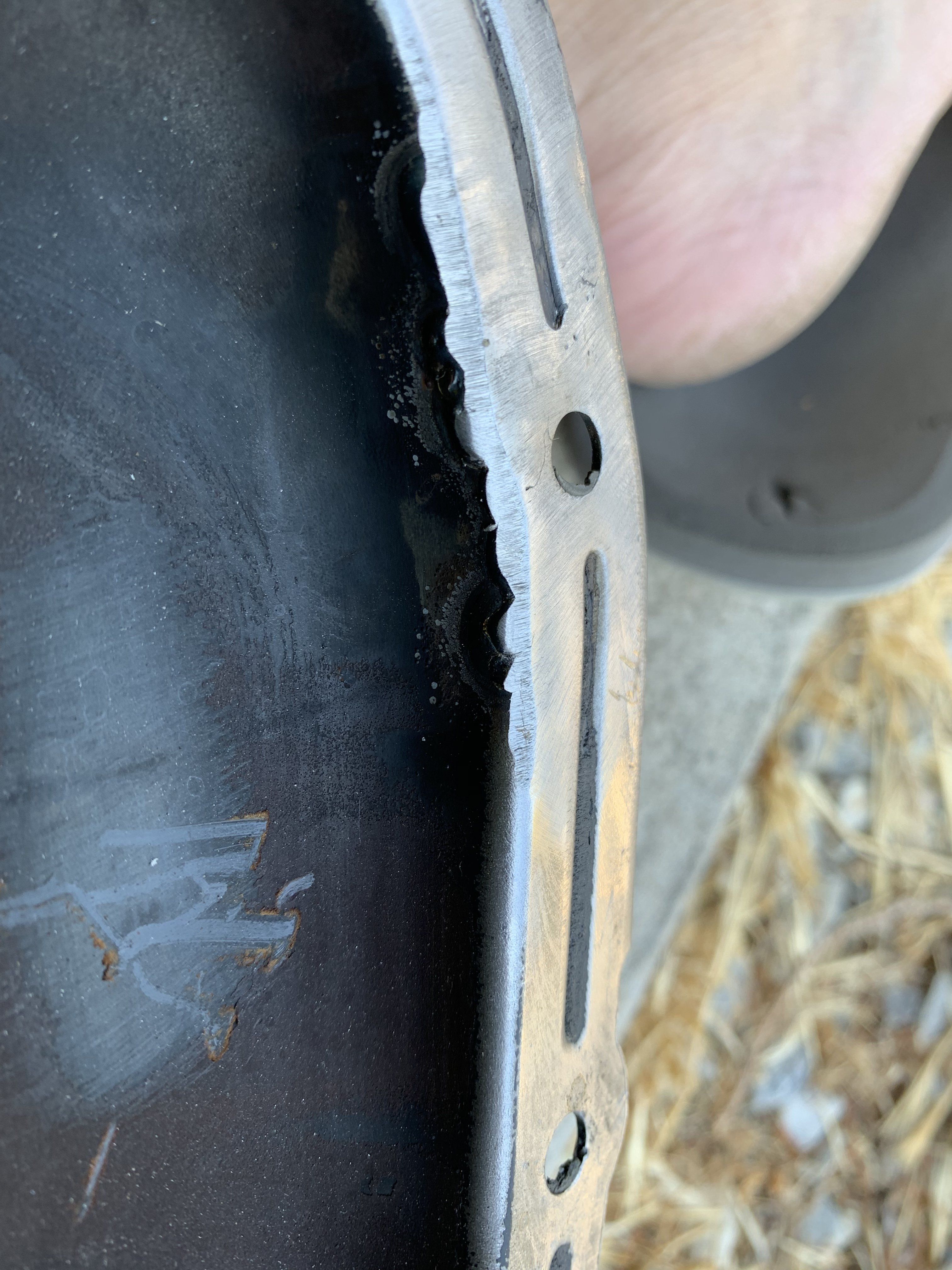

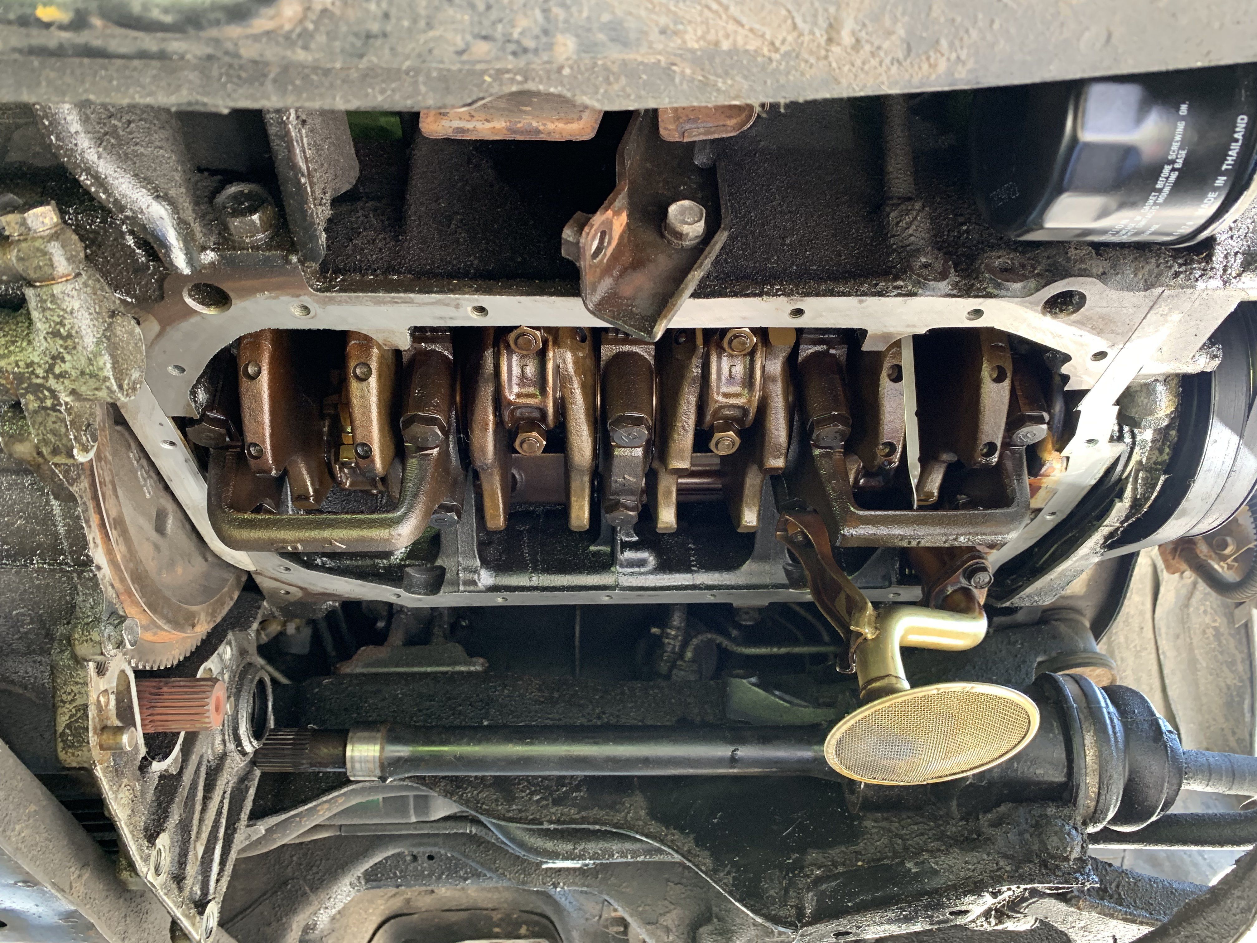

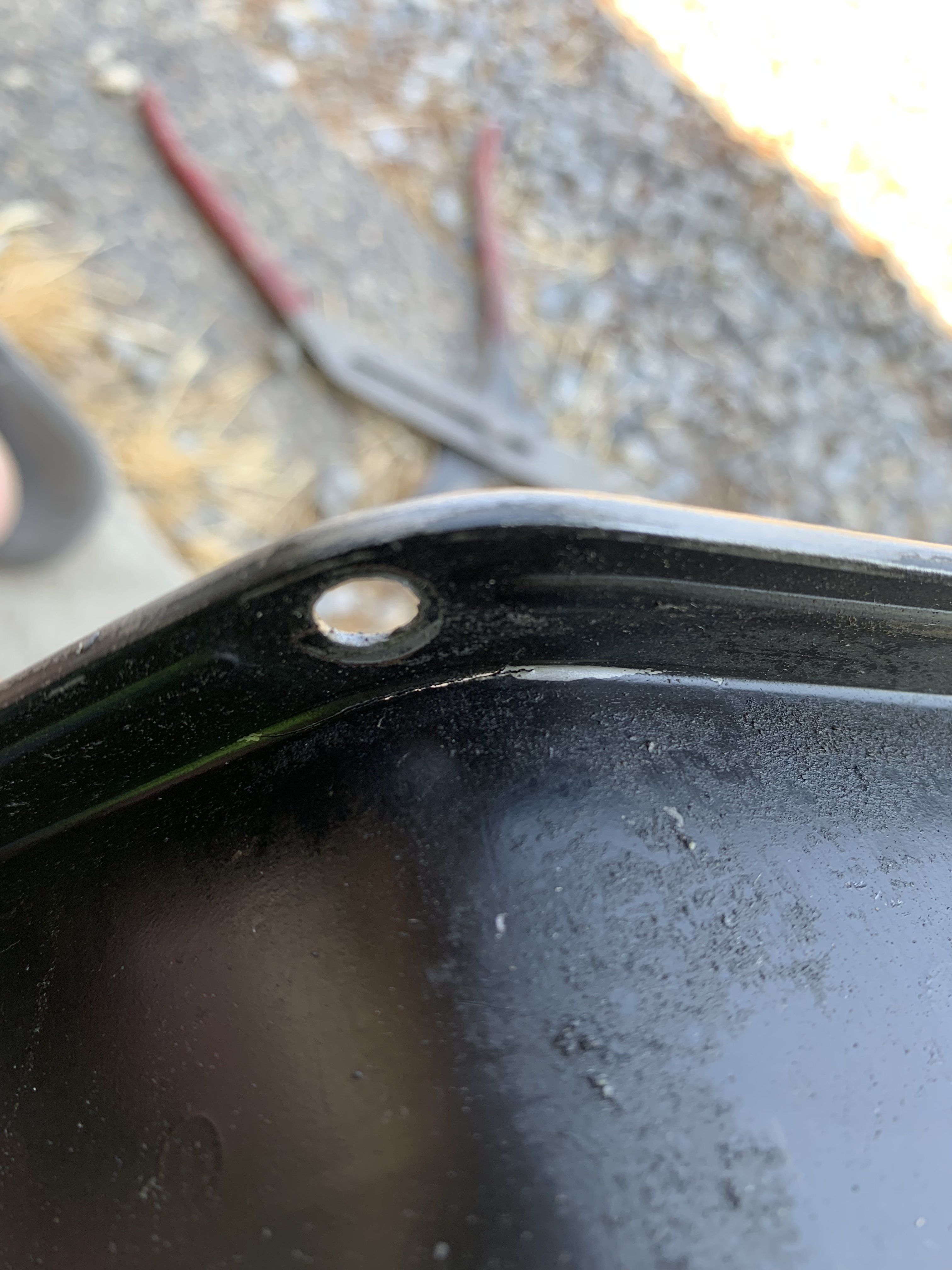

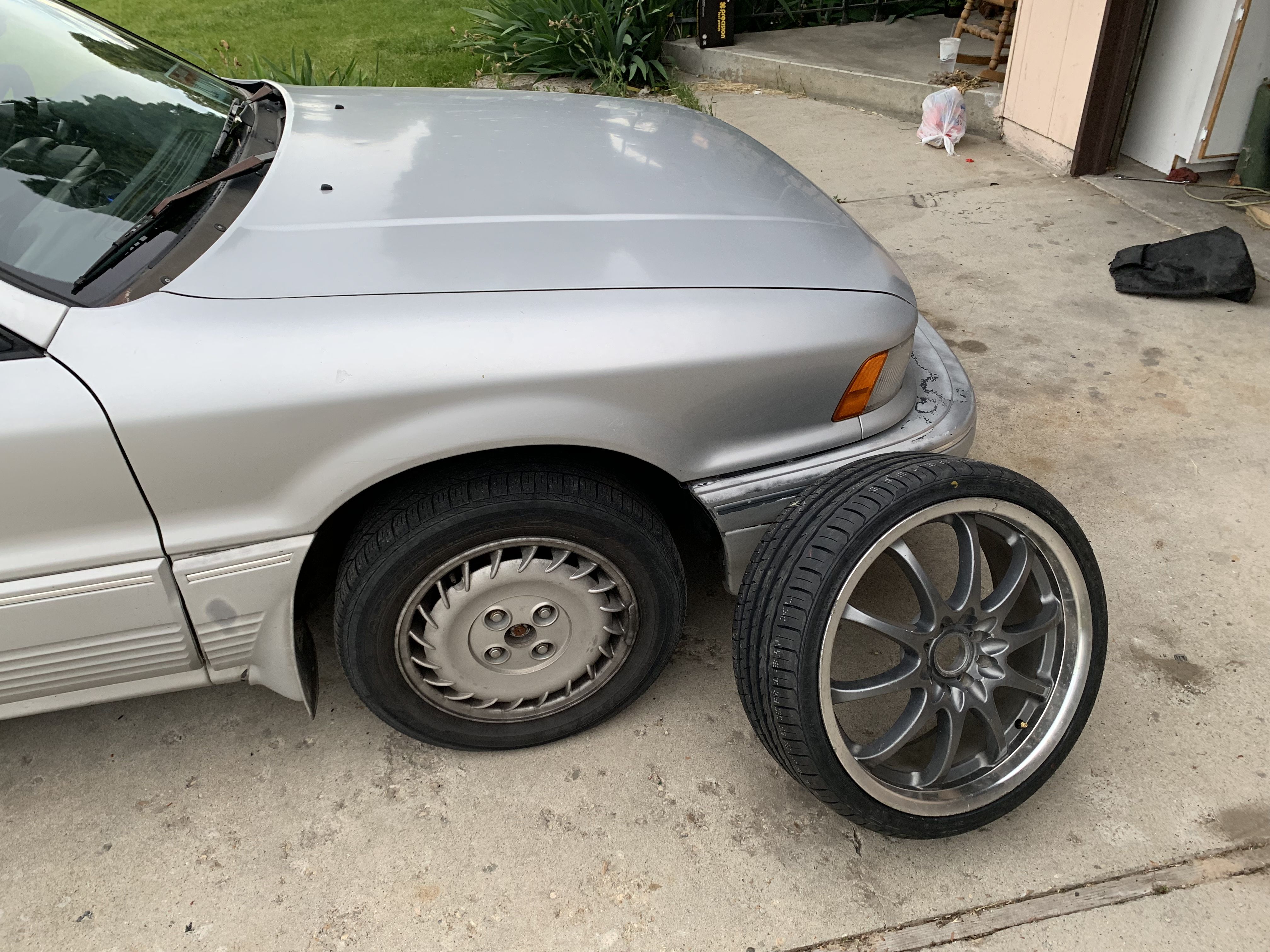

Been a while since I posted anything here, although not a whole lot has changed. Did get some new wheels and tires. Found a cheap set just to get rid of the stock look. Wired in the vr4 trunk lights. Added and antenna and started the oil leak repairs. Found out the oil pan gasket wasn’t the problem. Have several cracks in the pan. No wonder I was leaking oil. Haha. Pan is on order. Just waiting for it to show up. Changed out the valve cover gasket while I had the hood up. Took a stroll through the local junkyard and happened across a laser with a new air filter and plug wires. May just end up pulling that whole engine. Only had 80k on it!! We will see what happens so far enjoying this car a bunch. Now all I need is more power!!

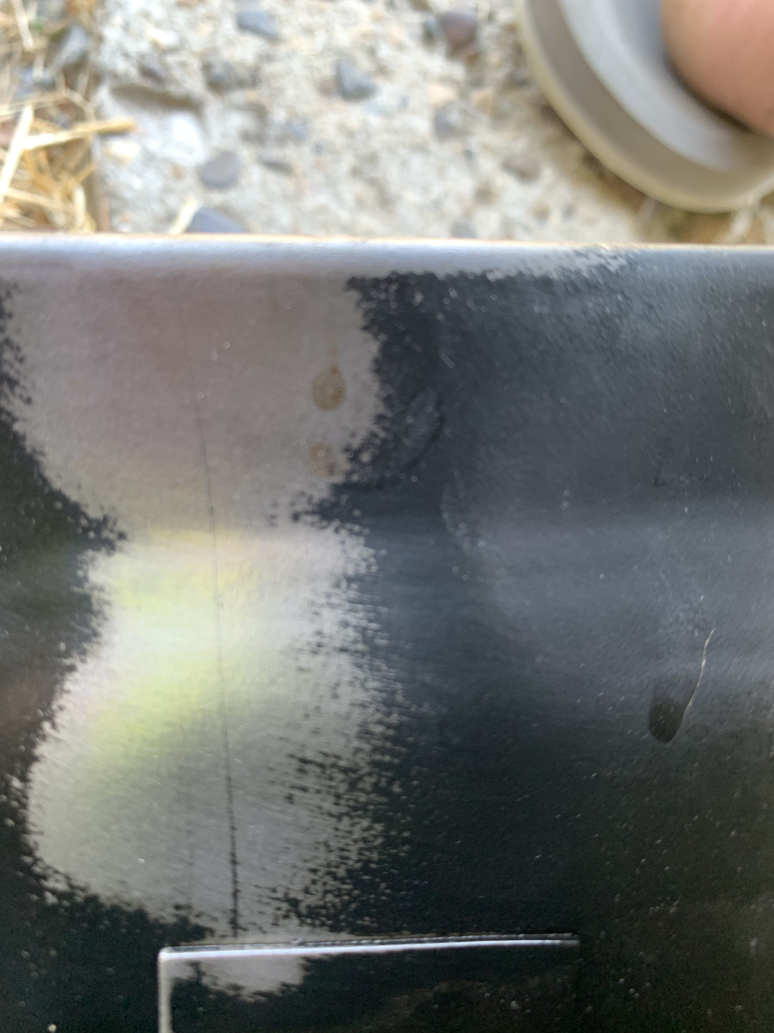

Here are some the pics I was talking about. I am not sure if you’ll be able to see it but these are the cracks in the oil pan.
This one below is the one I welded up before I found the other cracks.

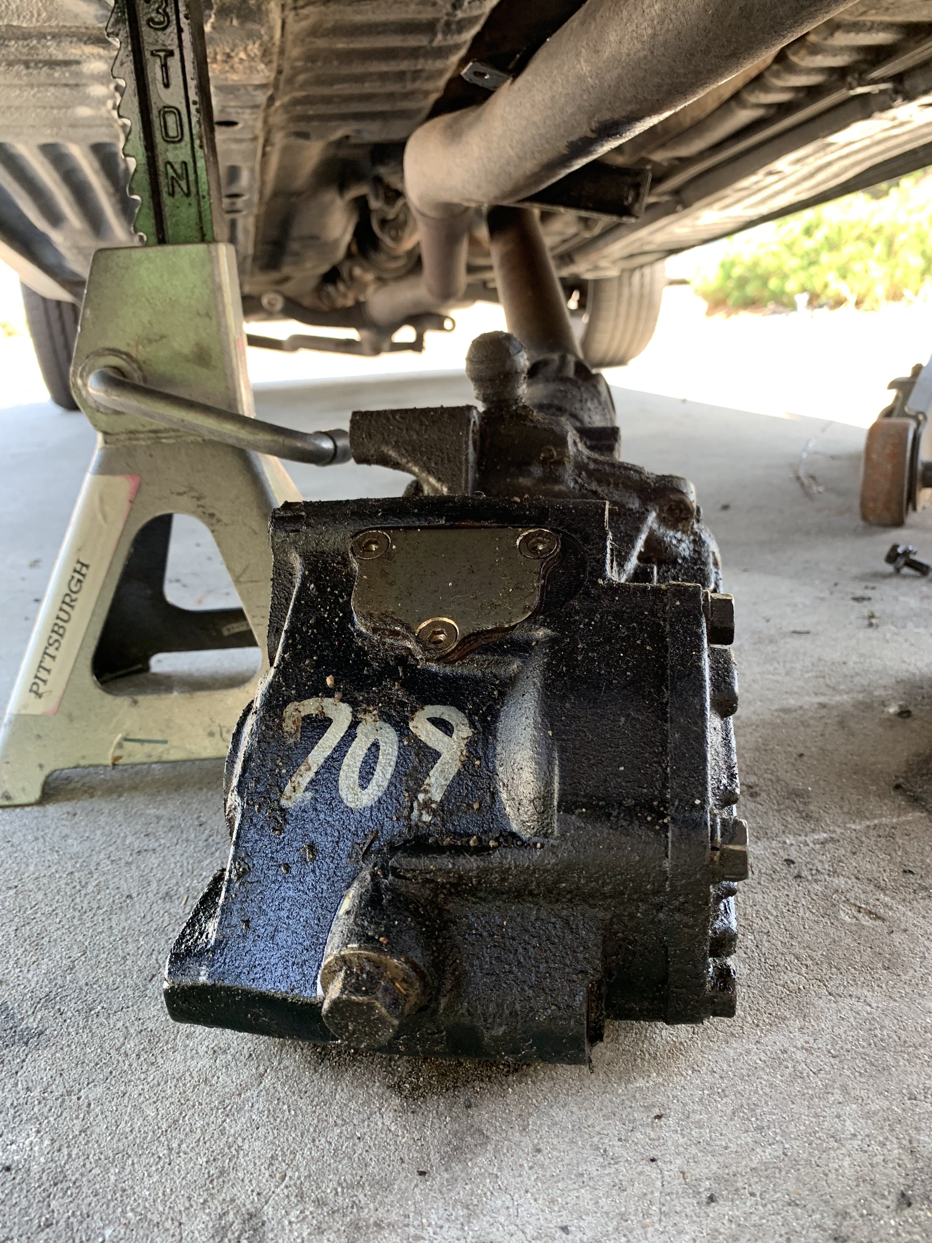

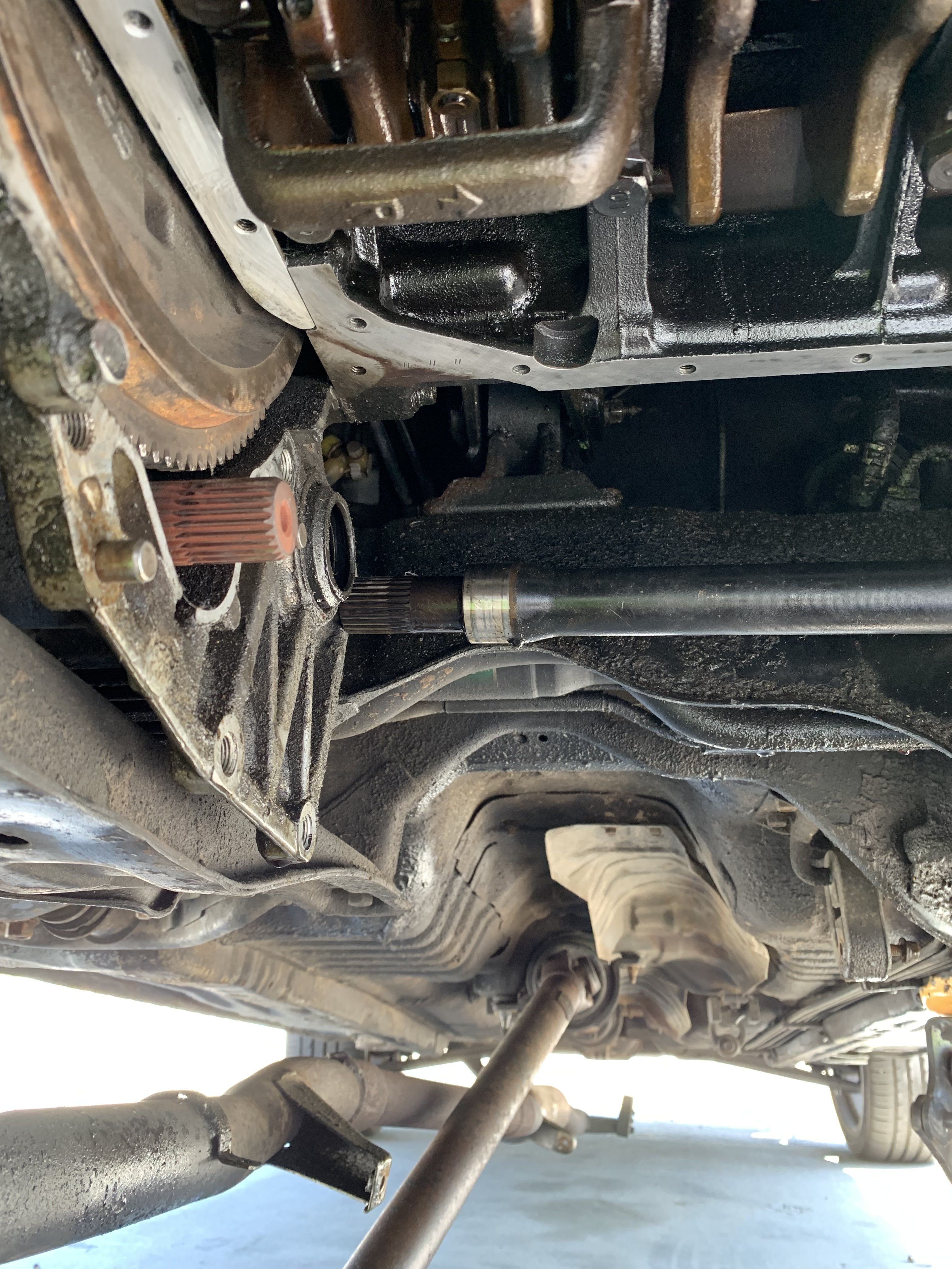

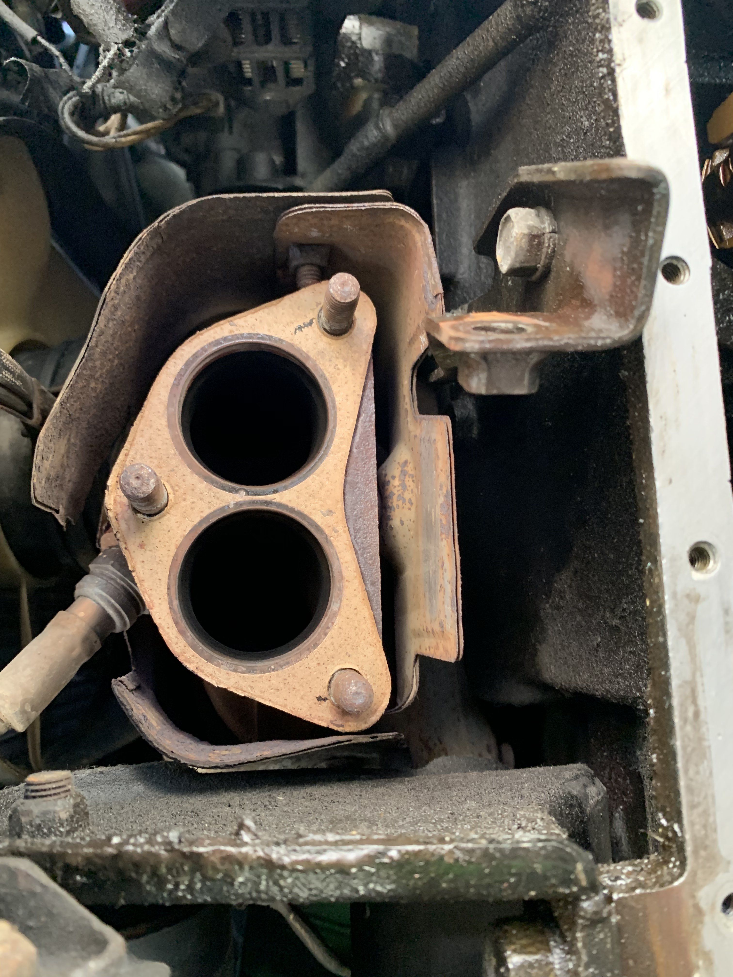

here are a few pics of the disassembled car
This is where I set the axle to get it out of the way with out pulling the entire thing (below)

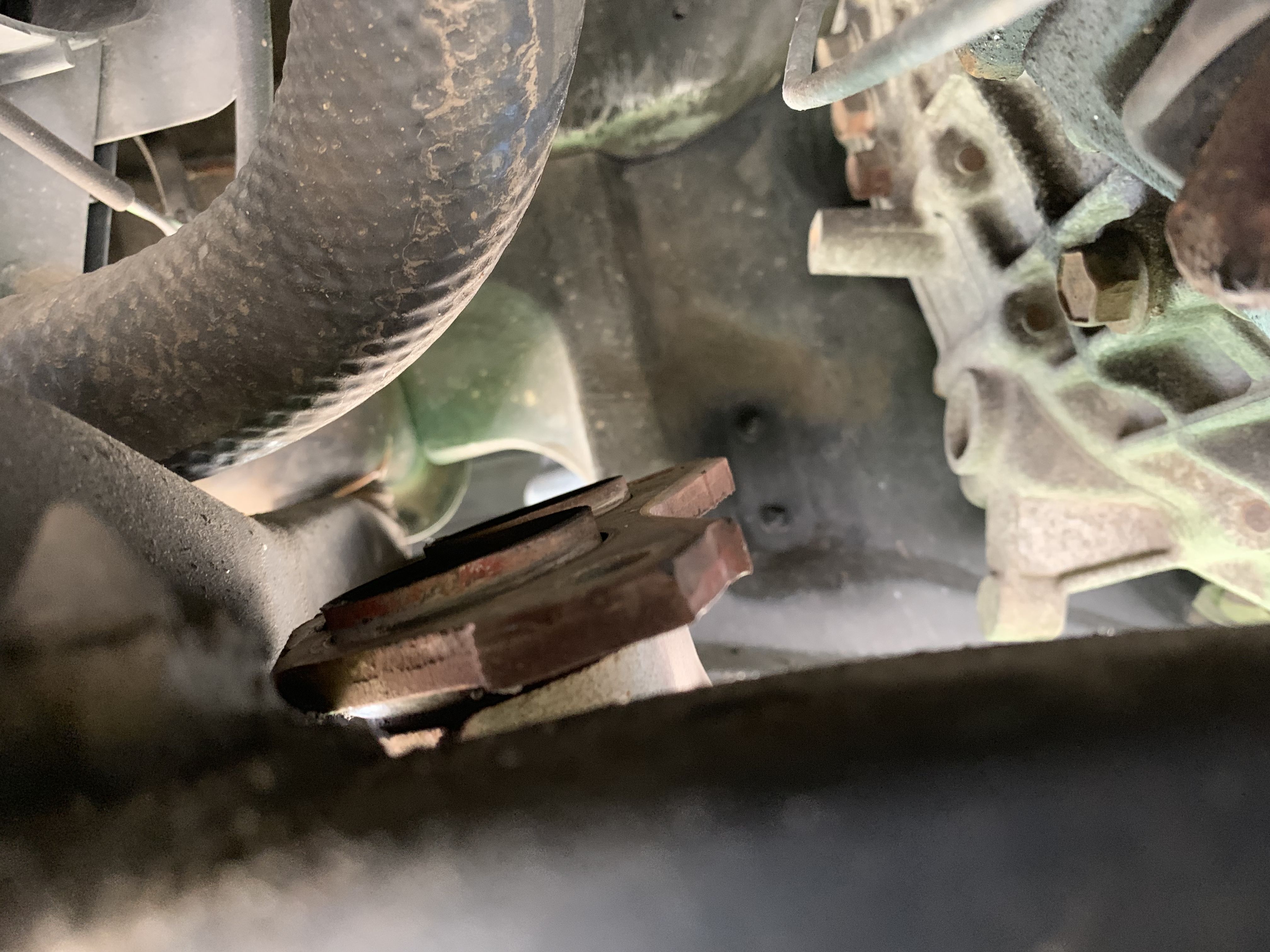

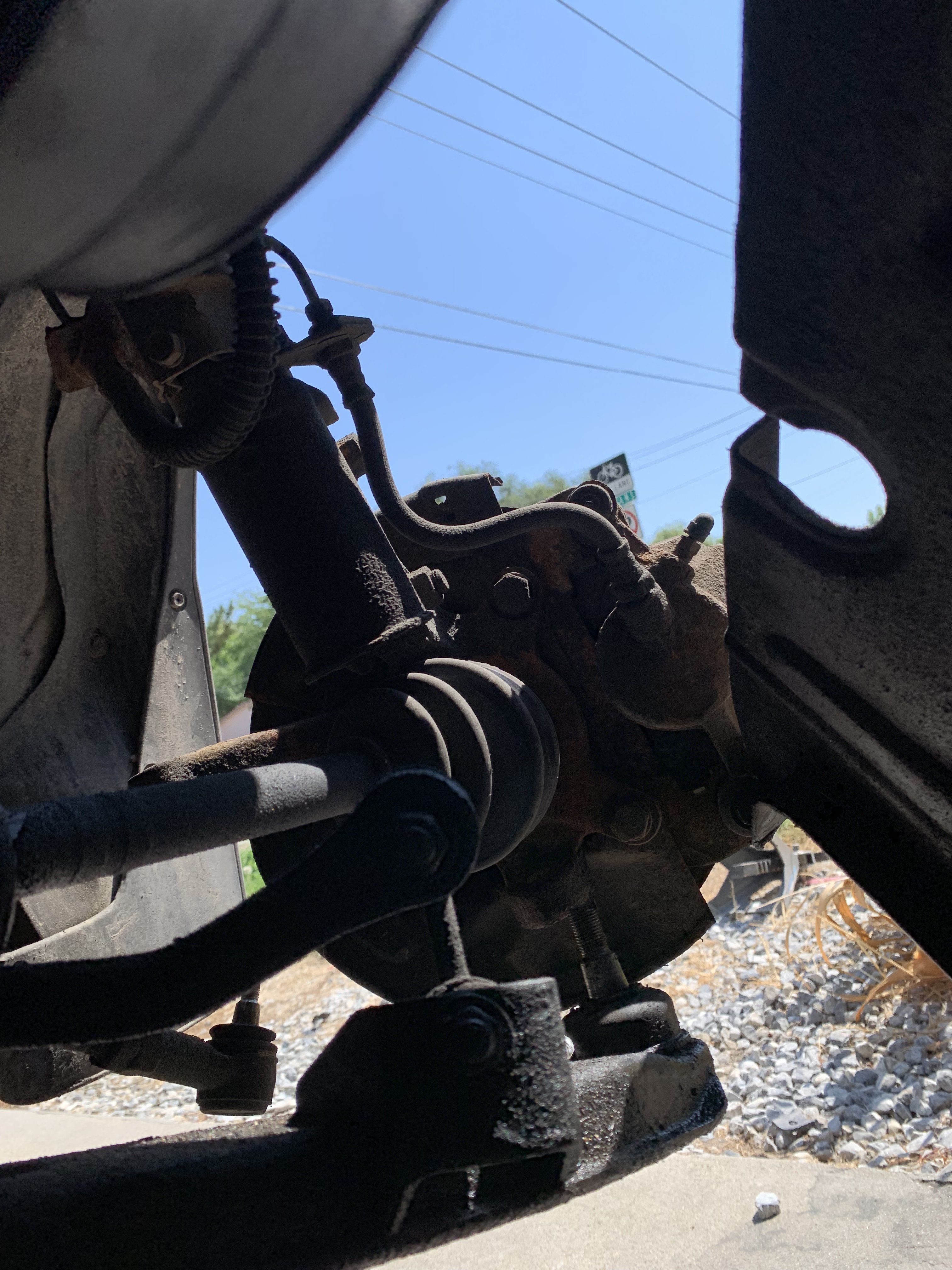

Here is the drivers side a arm assembly pulled apart to remove the axle.

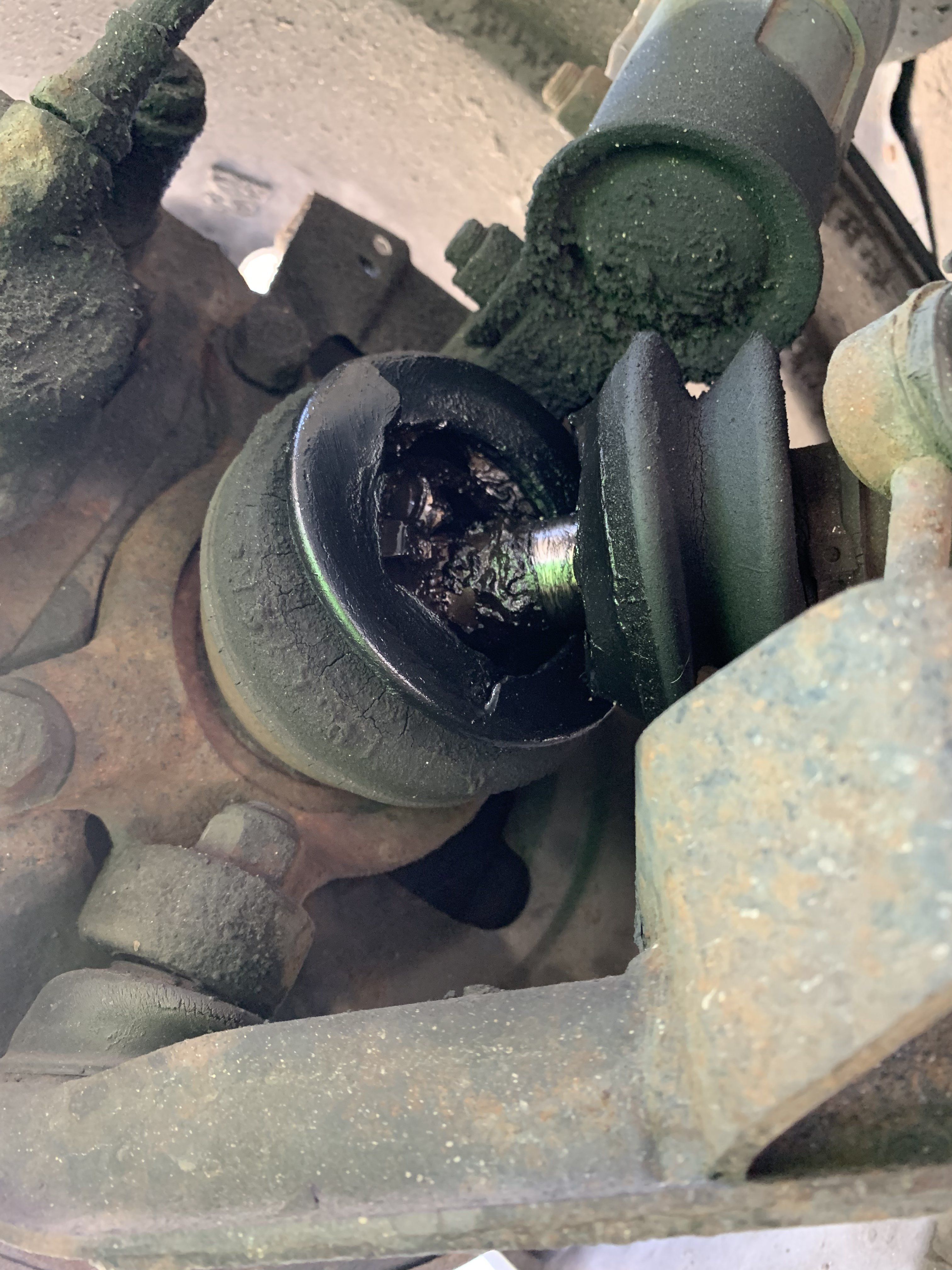

Found a torn passenger side cv boot. Looks like I know what’s next on the list...
