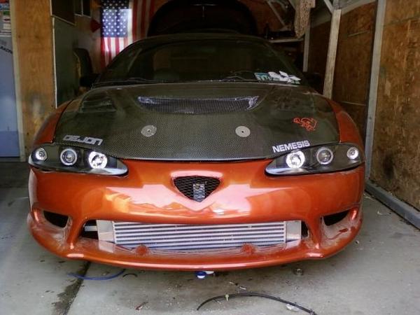

1998 Eagle Talon TSi AWD Vehicle Profile & Build Thread
NemesisTalon88's Talon TSi AWD
Year
1998
Model/Trim
Eagle Talon TSi AWD
Mods-Bolt-on
Revhard T4 manifold,precision Billet 6265,Tial 41mm wastegate,MAGNUS intake manifold, BOOMBA75mm throttle body,SS autochrome FMIC,Tial bov,Precision 1200cc injectors,Full Blown Double Pumper,Walbro Fuel pumps, E-85 fuel,all -6AN fuel lines, Hallman Boost controller,AEM wideband o2, Jm fab coil on plug. 3"turbo back exhaust,honda civic radiator,FAL slim fan,prothane motor mounts,Vis Racing G-speed carbon hood,Projector headlights,
Mods-Engine
6 bolt block/7 bolt ported/polished head ,eagle crank,eagle rods,wiseco pistons,cometic,gasket ARP studs/bolts,Comp Cams,Comp springs,Ferrea valves,balance shaft eliminator kit
Mods-EMS & Logging
AEM EMS,AEM wideband o2,Autometer phantom series,AEM twinfire CDI box
Mods-Drivetrain
Fidanza Flywheel,Spec clutch 3+,ss clutchline ,clutch cable aluminum bushings,b&m short throw shifter,driveshaft shop F&R axles
Mods-Handling
Tein Flex,F&R strut bars,F&R sway bars, OEM Enkei Evo VII wheels,Falken tires.
Parts Wishlist
JM fab top mount manifold, Jacks transmission,driveshaft shop Aluminum Driveshaft,BF goodridge drag radials,nitrous kit
