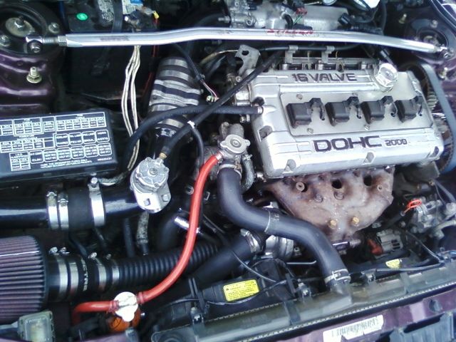

Mods-Bolt-on
Evo III 16g with shimmed wastegate,
blitz supersound atmosphere bov,
Tubular exhaust manifold,
short throw shifter,
front mount intercooler,
dejon upper blow through upper intercooler pipe,
custom lower intercooler piping,
turbo xs high performance manual boost controller,
atmospheric 02 dumptube,
custom air intake/k&n filter ,
3 inch megan racing catback system,
3 inch megan racing stainless steel downpipe,
Cat-delete,
sparktech Coil On Plug system,
Ngk-bpr8es,
SS oil feed line,
1g jpipe,
1050cc FIC injectors,
walbro 255 rewired,
AEM AFPR w/ turbo smart gauge,
Catch can,
All emissions delete,
Mods-Engine
Line honed, balanced and blueprinted.
Bored .20 over,
Ross 9:1 pistons,
Eagle rods,
Mbcad kit,
Balance shaft eliminator,
Acl bearings,
Fp2x cams,
Bc titanium springs and retainers,
3 angle job,
Titan hg,
Eagle forged 4340 chromoly crankshaft,
Fidanza adjustable cam gears
Mods-EMS & Logging
maf translator,
dsmlink v3 lite,
push button start,
Autometer boost gauge,
blitz turbo timer,
3inch gm maf,
95 ecu socketed eprom,
AEM uego wideband,
Mods-Drivetrain
AWD swapped gst, solid welded front motor mount, short throw shifter,stage 3 zoom clutch, lsd rearend, fidanza lightweight flywheel
