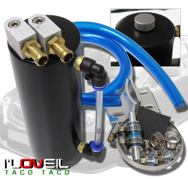

Quote:
Originally Posted by Tiki2777 View Post
What do you mean by vent? Are you talking about the filter on top of the catch can? Calan's catch cans don't use those. Why would they be necessary? I thought like others have said that you just need a good baffled catch can with a vacuum source (IE straight off the intake). However, I am only talking about the VC port to the left, not the PCV valve to the IM. The main reason to use a catch can is to not get oil in your intake, turbo, and IC.
I'm talking about one of these babies.
You'd hook the two lines from the valve cover to this baby, and where is it going to vent? In fact, how is oil even going to get there? It would be like trying to gravity-fill a sealed container....obviously the airspace has to exit or it will never fill with anything but pressure, and the crankcase can't vent whatsoever. Install this and you'll effectively go from decent crankcase ventilation to none.

Quote:
The 2 port cans are made to be installed between the valve cover and intake pipe. You would leave the pcv in place and not mess with it.

Well i got an ebay catch can given to me, actually it is the exact one that you pulled up that picture on. Just was wondering if its worth hooking it up or buying a good one, but now i know, buy the good ones haha.
I bought one like this that is vented... what if I stuff it with something to hold the oil.
____________________________
1990 TSI AWD... My first 4g63 :)
View photos of this member's car
mark post as helpful recommend reputation points    Reply With Quote

Quote:
If it's not recirculated, then there's no reason to stuff it with filter material. If anything, maybe add a simple baffle to prevent splash at the vent filter, or if you are pushing a LOT of liquid and blowby, then maybe a couple of slanted perforated screens to break up the flow going into it.
Otherwise, just leave it empty.

I have the exact one in the pic. Its not installed yet. Ive checked my intake pipe/turbine wheel several times and theres no oil. I have boosted to 27psi. I just have a good system or engine i guess. My pcv functions well so no boost is getting into the VC and the comp numbers are perfect. Ill install it sooner or later and cut it open to baffle it. I think it will work fine.
And why the hell would anyone hook both hoses from the VC to a catch can?? LMAO, thatd b funny.
Oc course one goes to vc and the other to intake pipe.

Quote:
If it's not installed yet, how is everything working so perfectly? And if everything is working that well, why would you want to install something different?
I'm confused.
