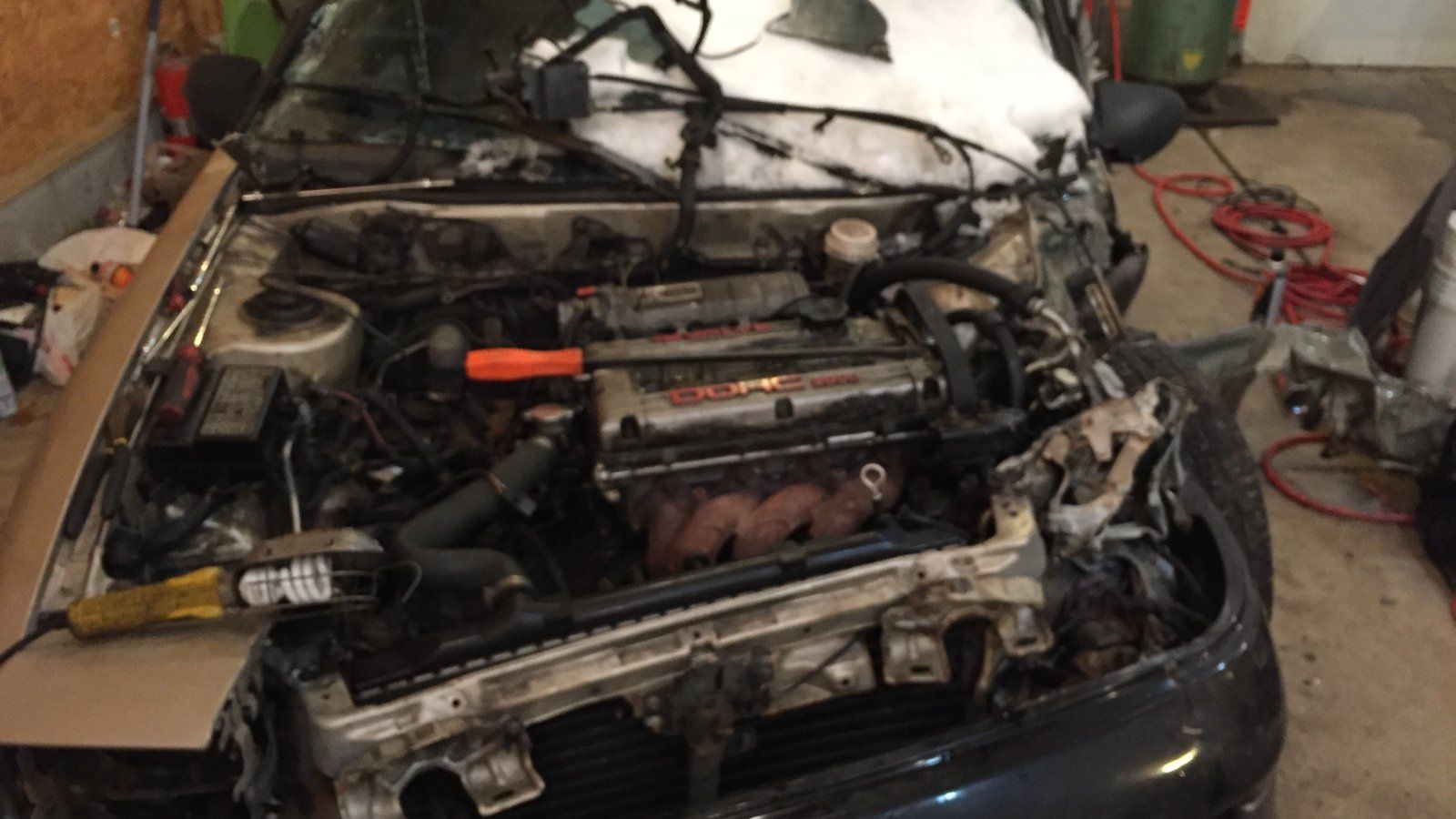

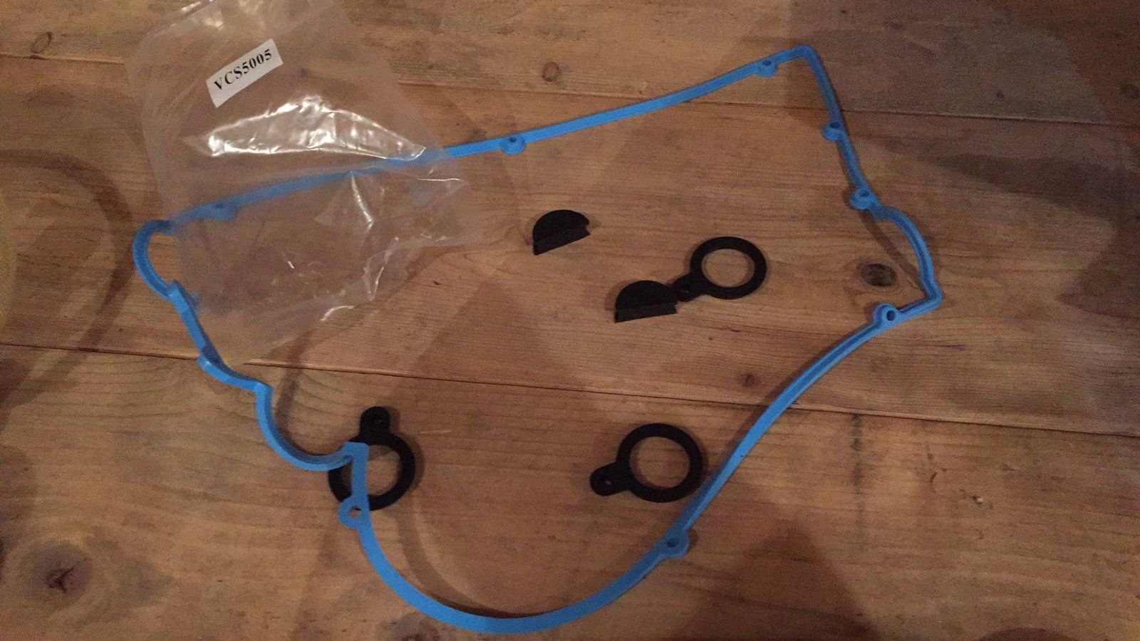

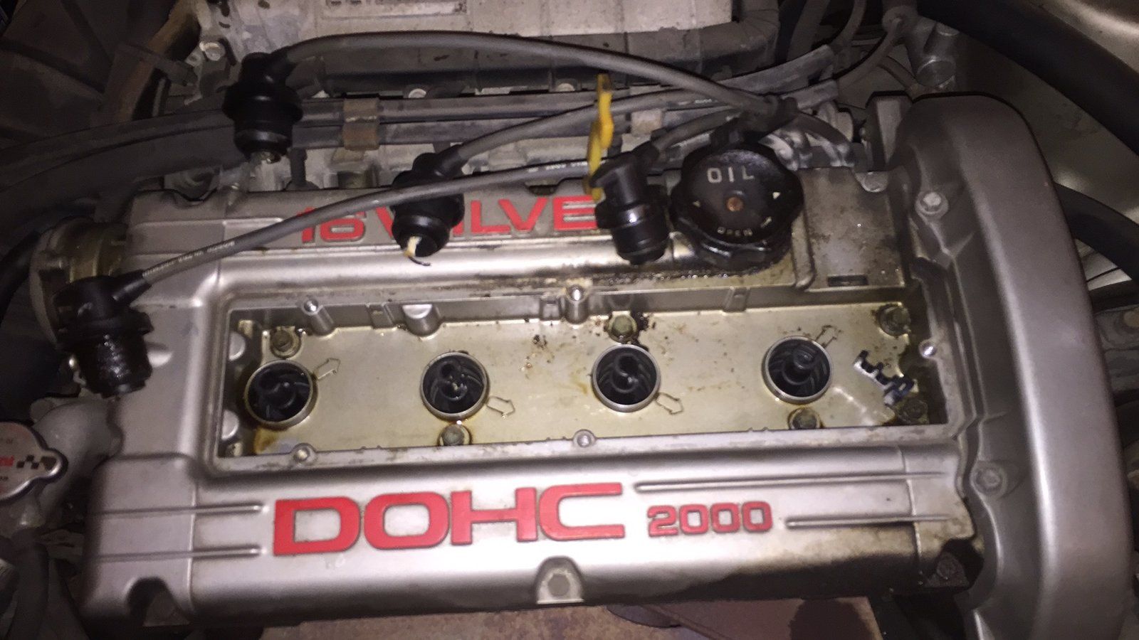

First day I thought it would be great to replace the valve cover gasket.
This reminds you, we are working with old warn out cars... Haha, spark plug wire were dry rotted.

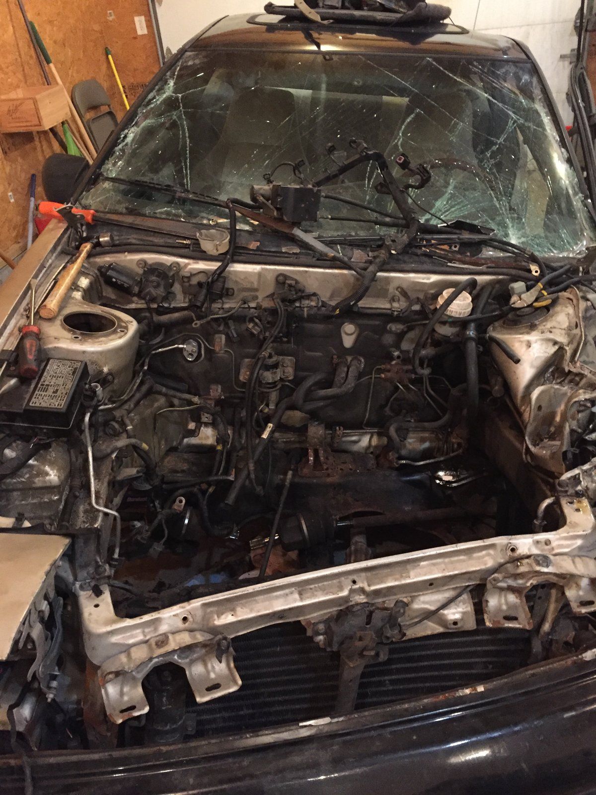

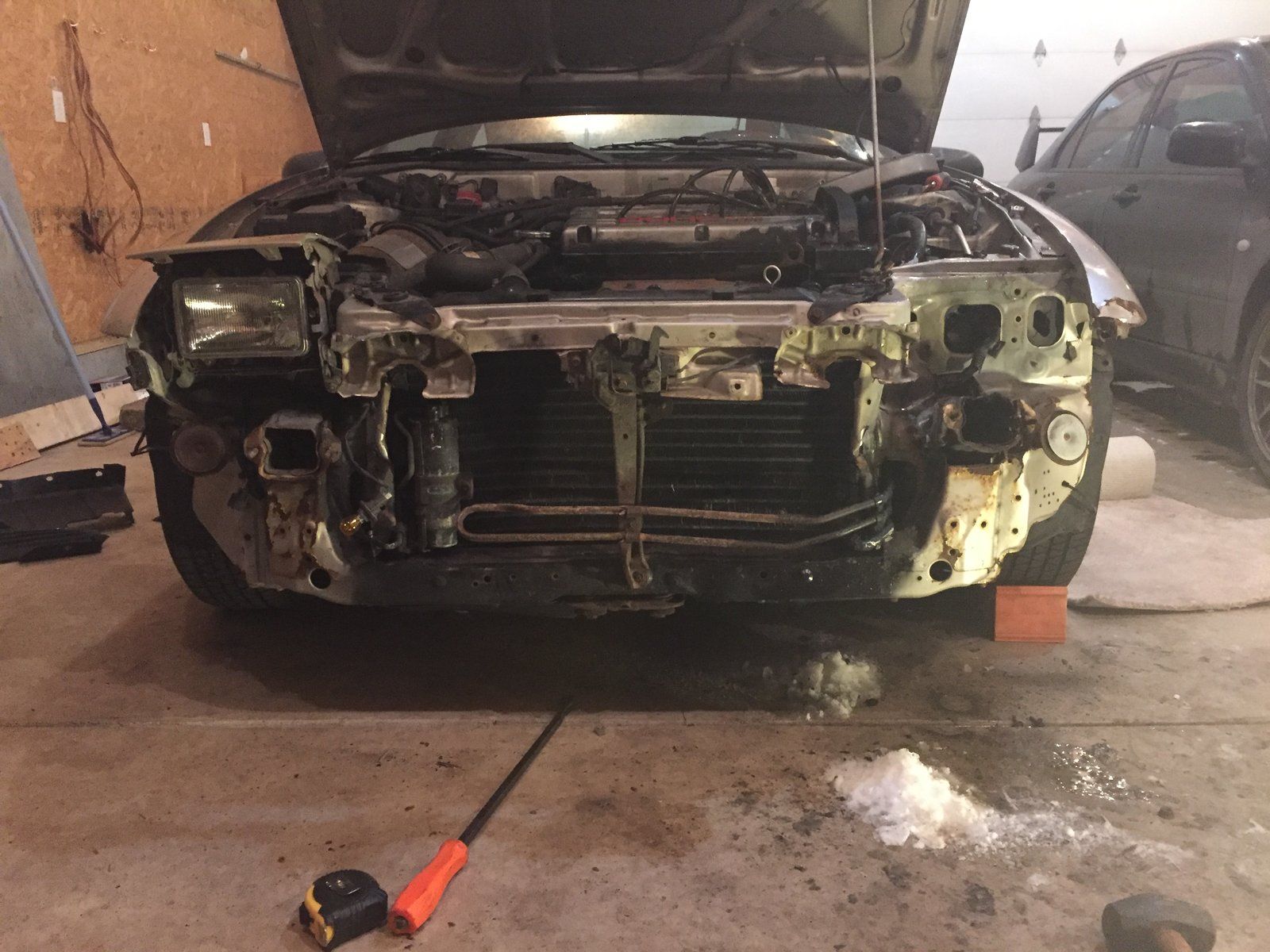

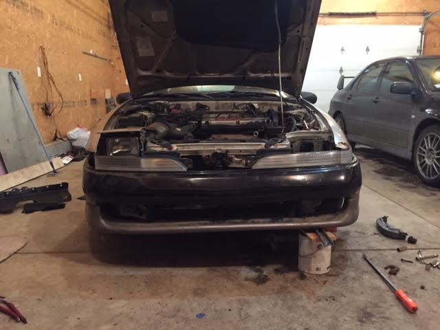

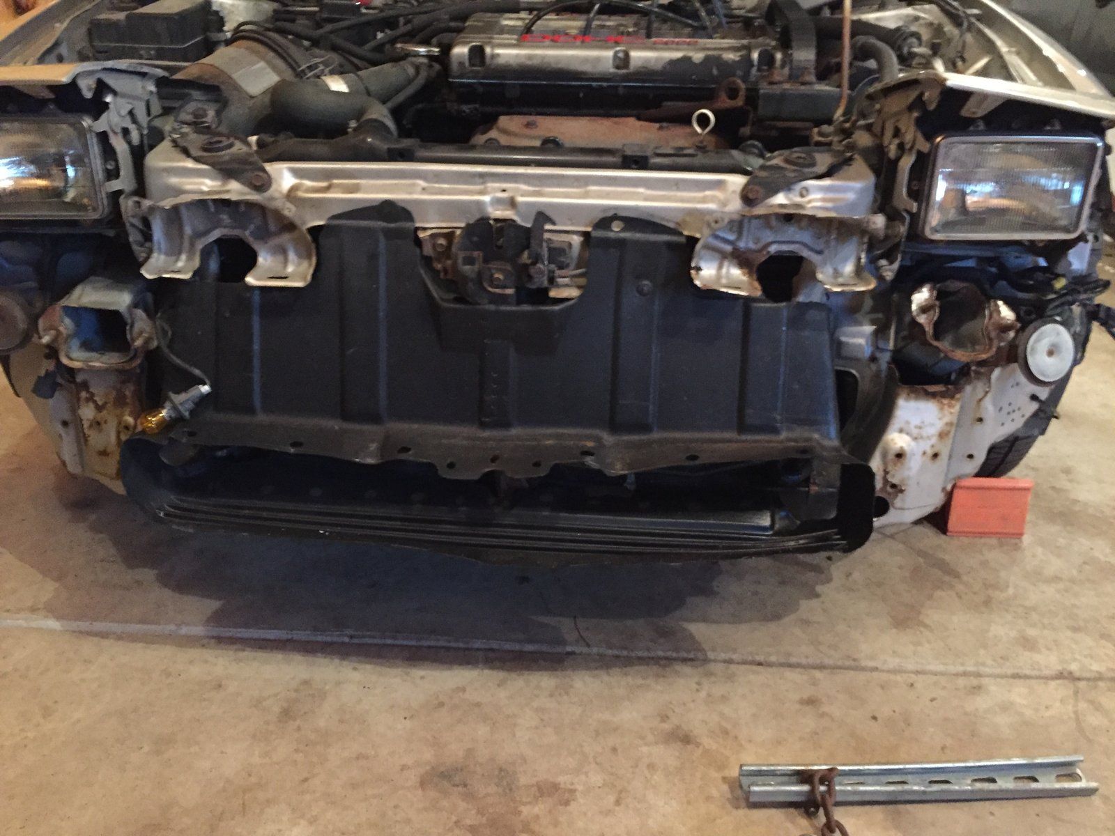

This is how the front end looked before I started. Check out the driver side bumper support frame.

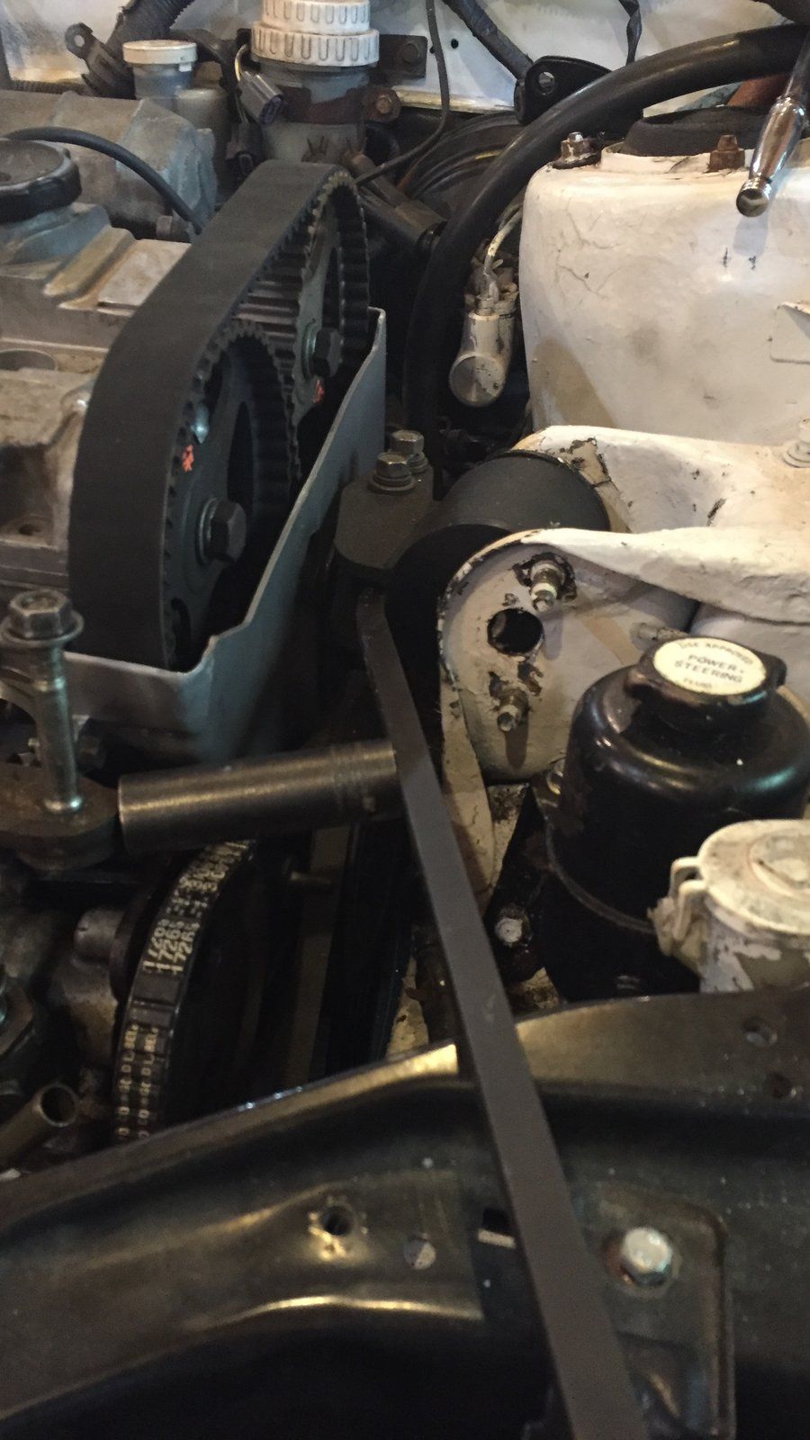

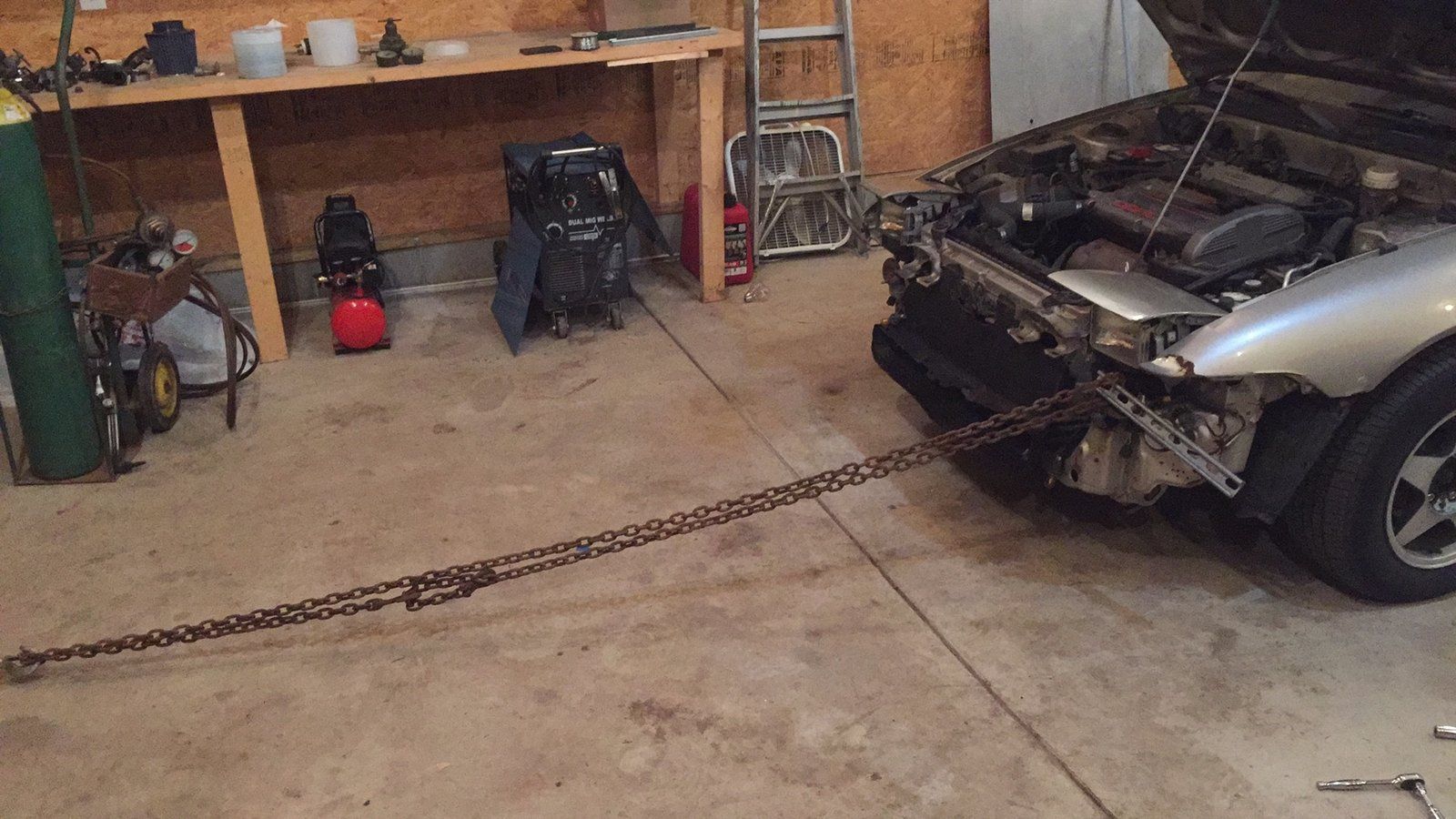

Chain meet dsm.
After that I heated up the frame and was able to pull down the support. This is what I came up with.
I did run into an issue though. The frame wouldnt budge after this. Didnt matter how much heat I gave it, it was almost stuck in place. So I gave up for the night. Before I left I decided to mock up the bumper and realized that the driver side bumper shock will have to be removed. This is due to the fact that, now there is no room for it to fit in the so called "frame". My plan is to drill the shock to release pressure, then cut the bumper shock off. Once this is done, the bumper should fit on without a problem. If this happens to fail, my mig welder should be up and running tonight too. :)

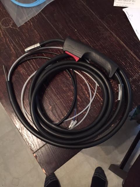

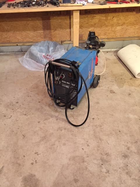

Well tonight I received my new lead for the welder. The old one was so clogged that it wouldn't feed wire.
Here she is all done up and ready to weld on a bumper!

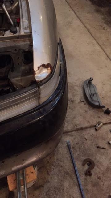

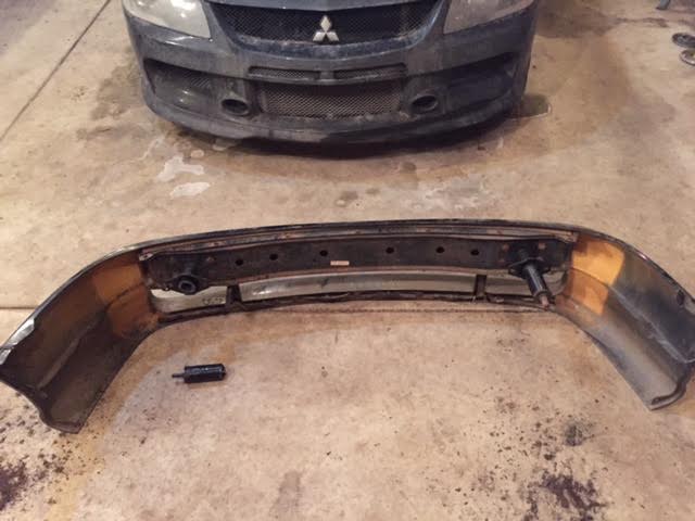

As I said I had to cut off part of a bumper shock. I first drilled through it allowing the gas to escape. Heres a pic of it cut off. Dont mind baby number 1 in the back ground :)

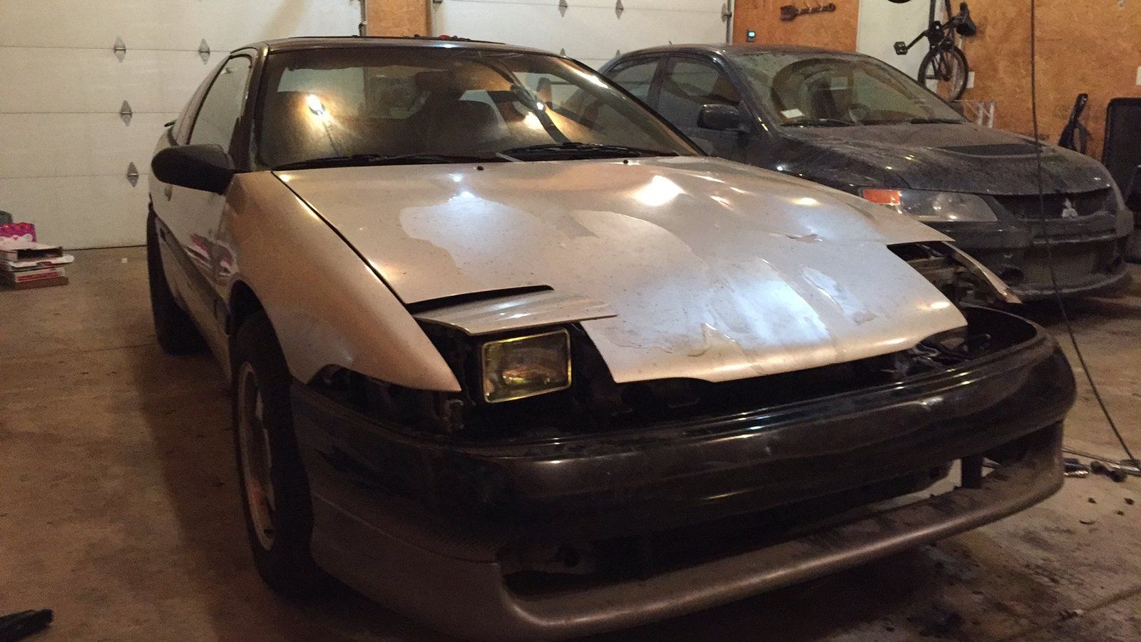

After that I wanted to see how it would fit on the car.
Not bad but the drivers side is sticking out. I guess it happens. Some screw can fix that though.
Over all not to bad. As a $600 car at least it has a bumper somewhat on. Next thing to do is to use the mig welder to mount it to what is left of the mounts. It doesn't fit all the way onto the passenger side studs but that's OK. My plan is to weld it directly to the mounts from the top, that way if it ever needs to come off I can just use a cutter. No reason why it would ever have to come off anyways. Again, this shell will only be around until I find my awd shell. Once that time hits, this car will be either put up for sale or sent to a junk yard. Haven't made up my mind yet. I hate doing that because Chuck Norris sheds a tear every time a dsm is sent to its grave.

Over the last weekend I decided it was time to fully mount the bumper, aka weld that B on. The passenger side bumper support was able to start on the studs of the crash frame. From there I was able to gently kick the bumper onto the studs. I was then able to get a few nuts started and Bam, passenger side attached. The major problem was that drivers side support. From all the hammering and bending on that support, I had a stud fall out from the vehicle side. In my opnion this helped me. I was then able to use a nut/bolt combo that would allow the bumper to bolt to the frame. However, after I had it started, the bolt would only tighten down to a gap of about 1 inch. But it was attached. From there I took the welder and went to town. Here is what ended my weekend.
Not bad over all. I placed the new light assembly on however now the hood does not want to shut. The accident bowed the hood. It also damaged the latch itself. That is next on the list of replacements.

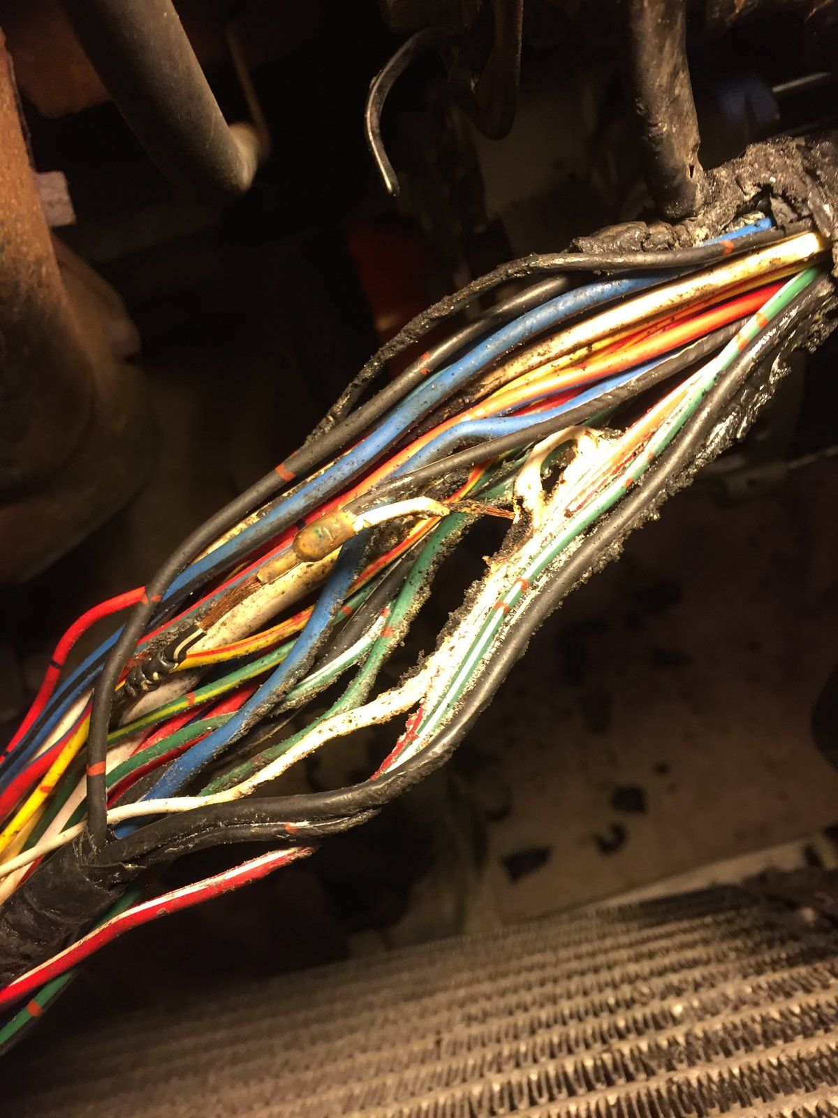

With some help from the forum, I was able to trace the alternator relay wires to this location... As you see the white wire has a larger then normal resistance. :) It only took ripping out half of the engine bay harness.
After I repaired that I threw everything back together and to my surprise, the car still did not want to charge. Knowing that there was a chance the voltage regulator was bad on a new alternator, I ordered a replacement a few days back. Luckily enough, the replacement came in yesterday allowing me to swap alternators after I found the one I had was bad. After placing the new alternator on the vehicle, I get 14.3v at the battery! The beast can now be driven. All the lights off!

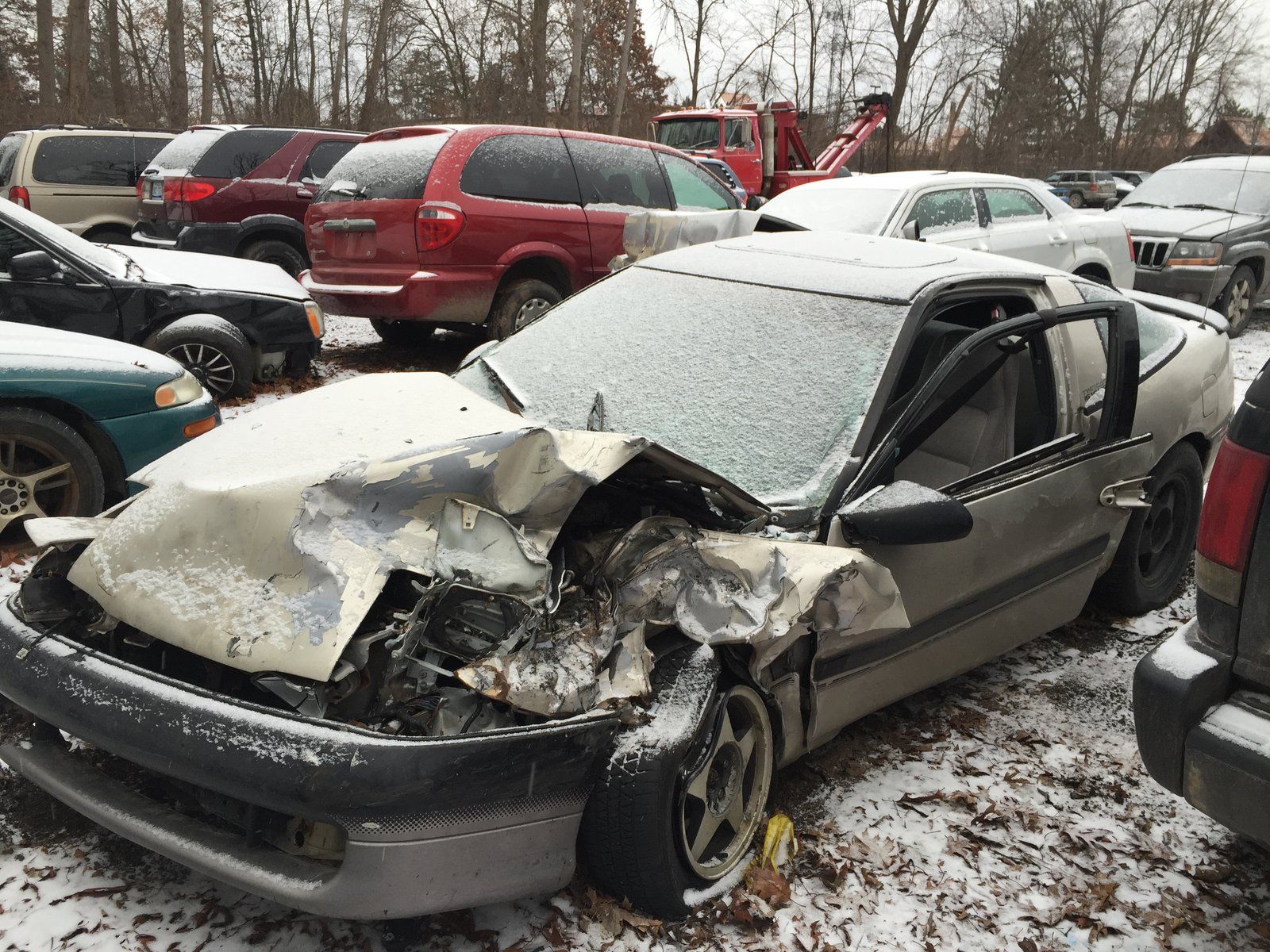

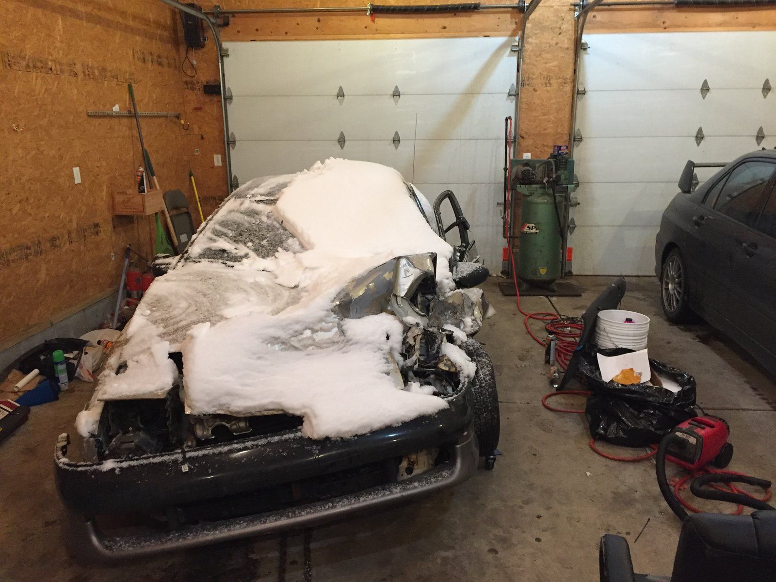

Well.. sadly to say my plans have been brought ahead. A guy coming the opposite way lost control and swerved into my lane. Just happy to walk away. Still have pain in my chest so Ive been unable to do any physical work. (even though I found out the hard way.) For now, here is how she sat after the dude hit me.
The good news! The front bumper support didnt move!
Anyways I was able to get it to my house after paying the costs of getting it out of impound... (I paid 100 more for the car then the cost of the impound cost..but I gota get that engine!)

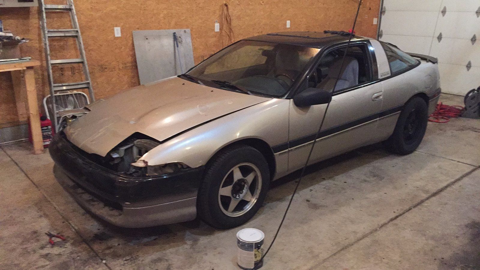

Here she is in the garage.
And this was the heart breaker. Chances are all the valves are trashed.

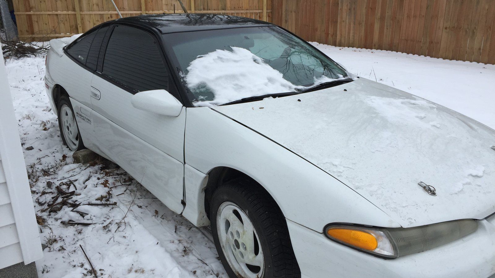

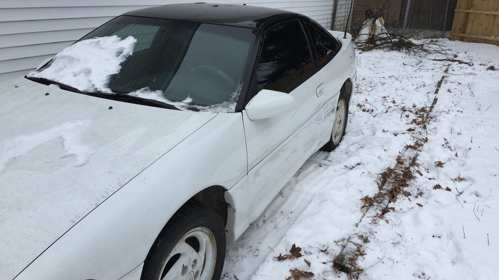

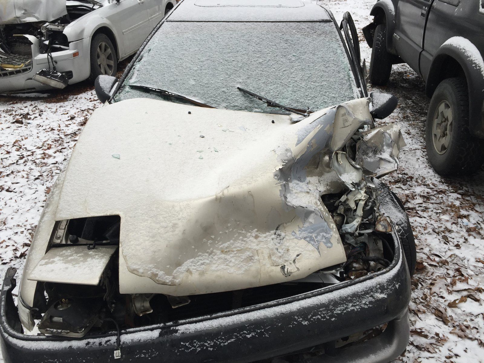

After being in the crash I figured I would pull the engine and finally buy a awd shell. Well...I did it. A week after the accident I went up to Traverse City to buy a panda. For the amount of miles the thing has, Im very surprised of the condition it was in. Sadly to say, this trip made made me aware that my chest was still hurting. After further xrays, I was told that I more then likely had fractures, etc. So I went on an ordering spree the last week. (You'll see more in the coming days.) For now, lay your eyes on the shell.

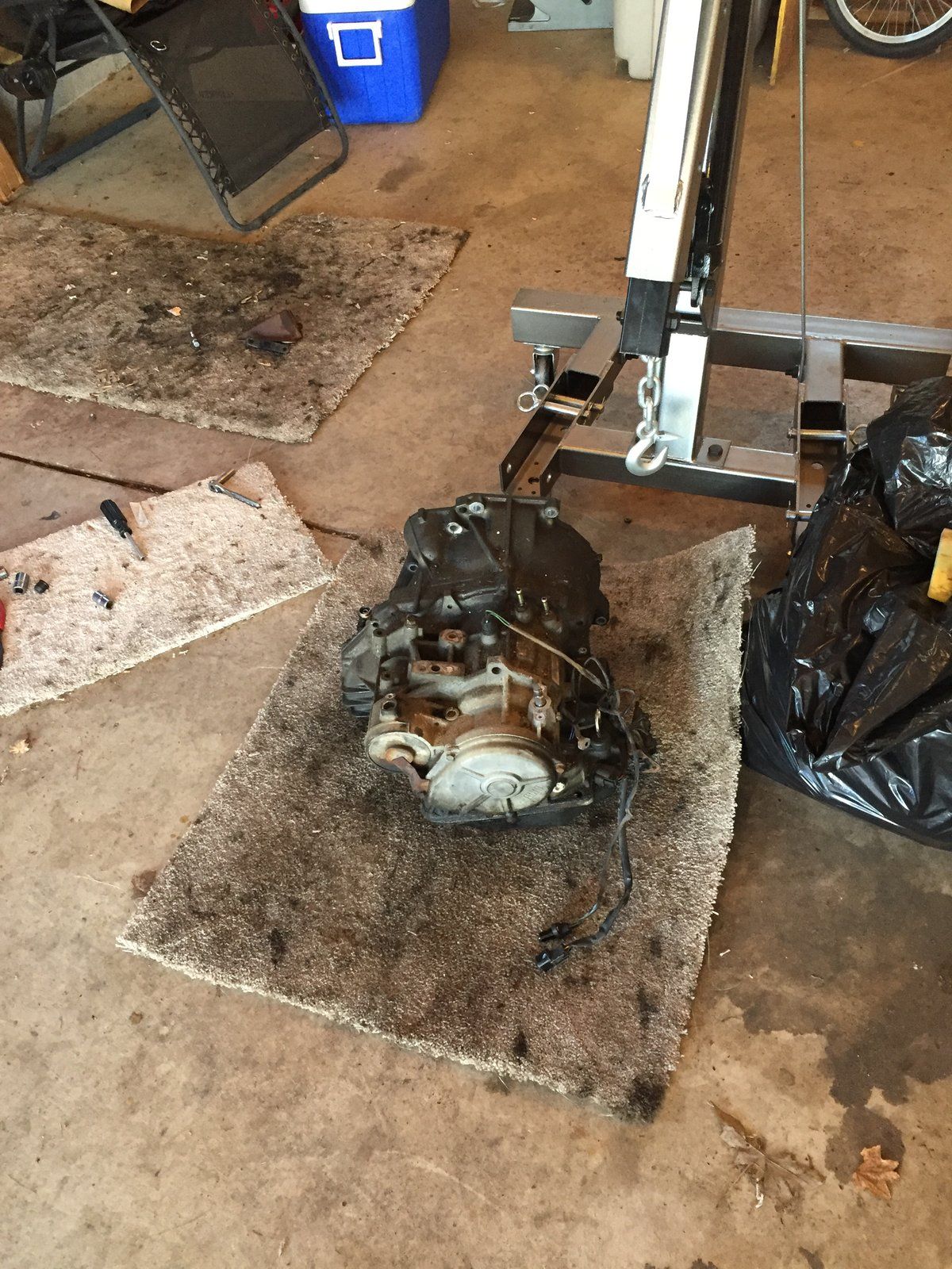

Since it was such of a nice weekend out I figured I better start doing some work. As you can see, the transmission is out! Yes I was lazy and didnt feel like disconnecting the torque converter from the driveplate. I figure Ill mess with that once its out of the vehicle.

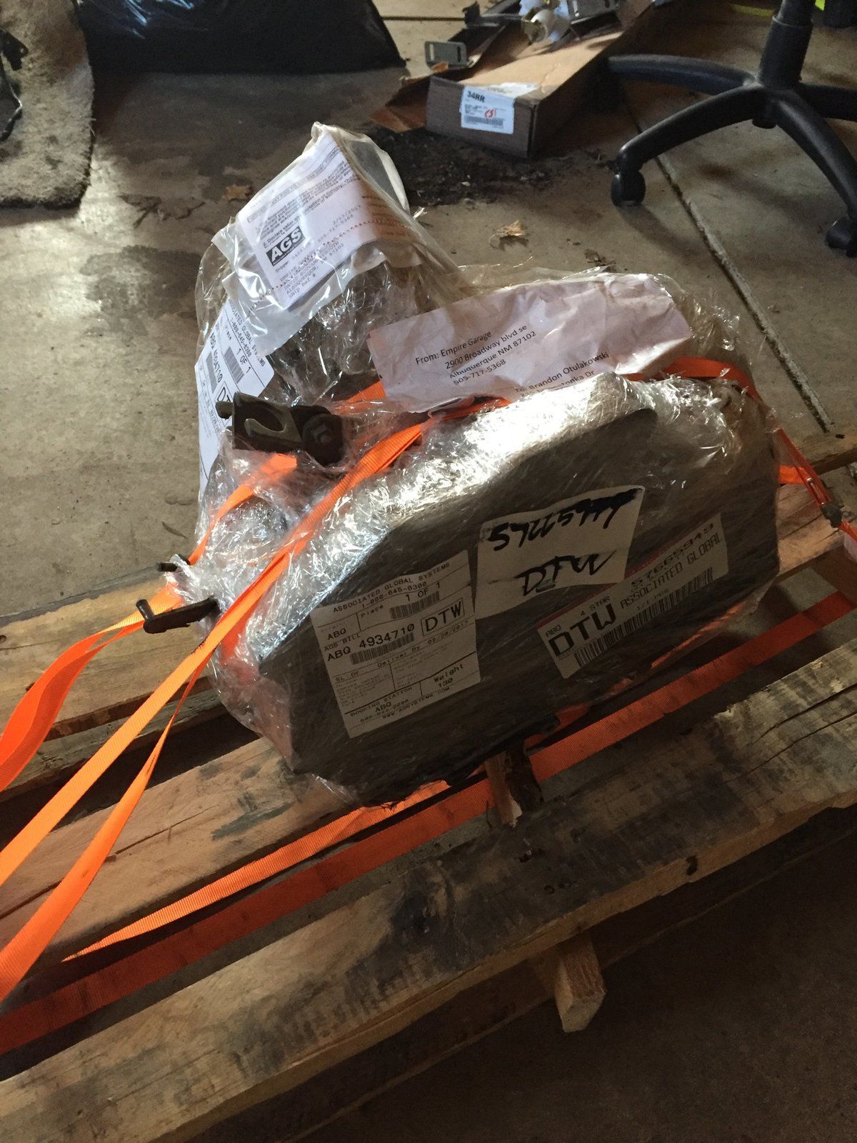

I received some more parts!
Fresh off the truck from New Mexico. Just crossing my fingers that it shifts ok. Manual Trans from a 1g.

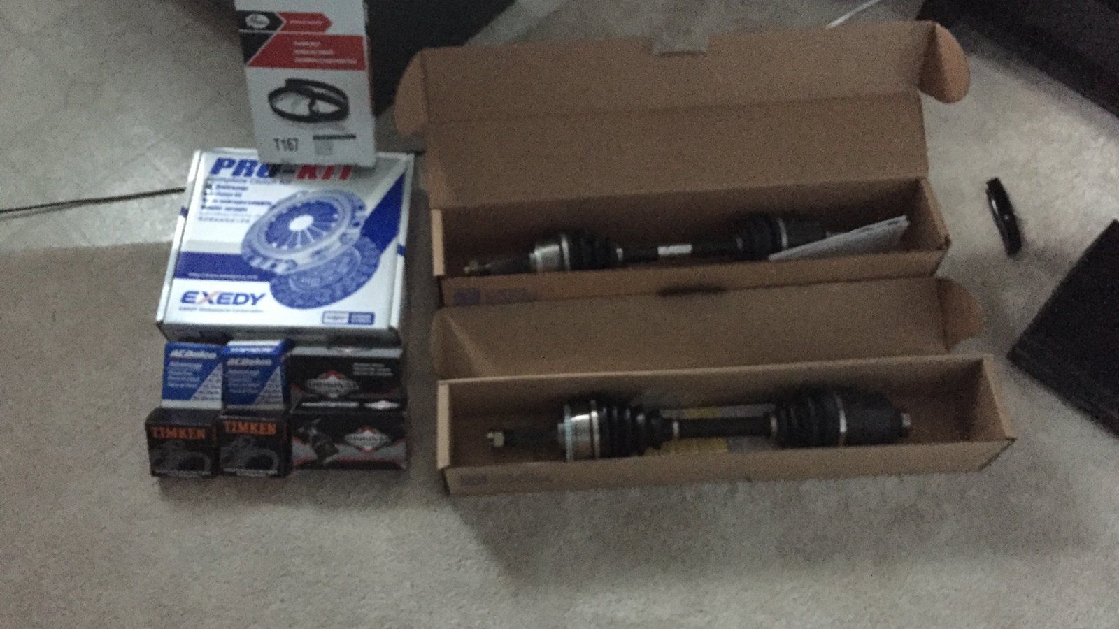

And my order from JNZ arrived!
Here you'll see the driveshaft rebuild kit, new nuts and bolts for the driveshaft, a few shifter clips and a/c delete bolt kit.

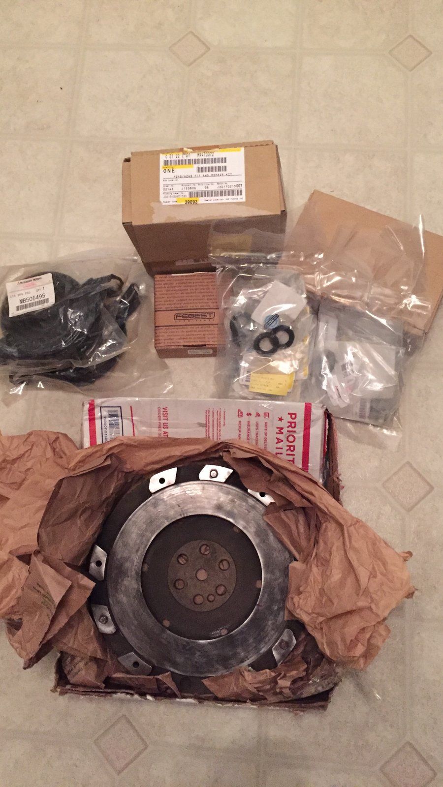

I also received the oem flywheel I bought from a fellow member on here. @black92_tsi_awd Thing looks good, no cracks or severe heating spots. My plan is to send this to the machine shop and have them give me a fresh surface. Ill wait to do this before I'm ready to drop in the engine and transmission. Limit the amount of corrosion before it gets installed.

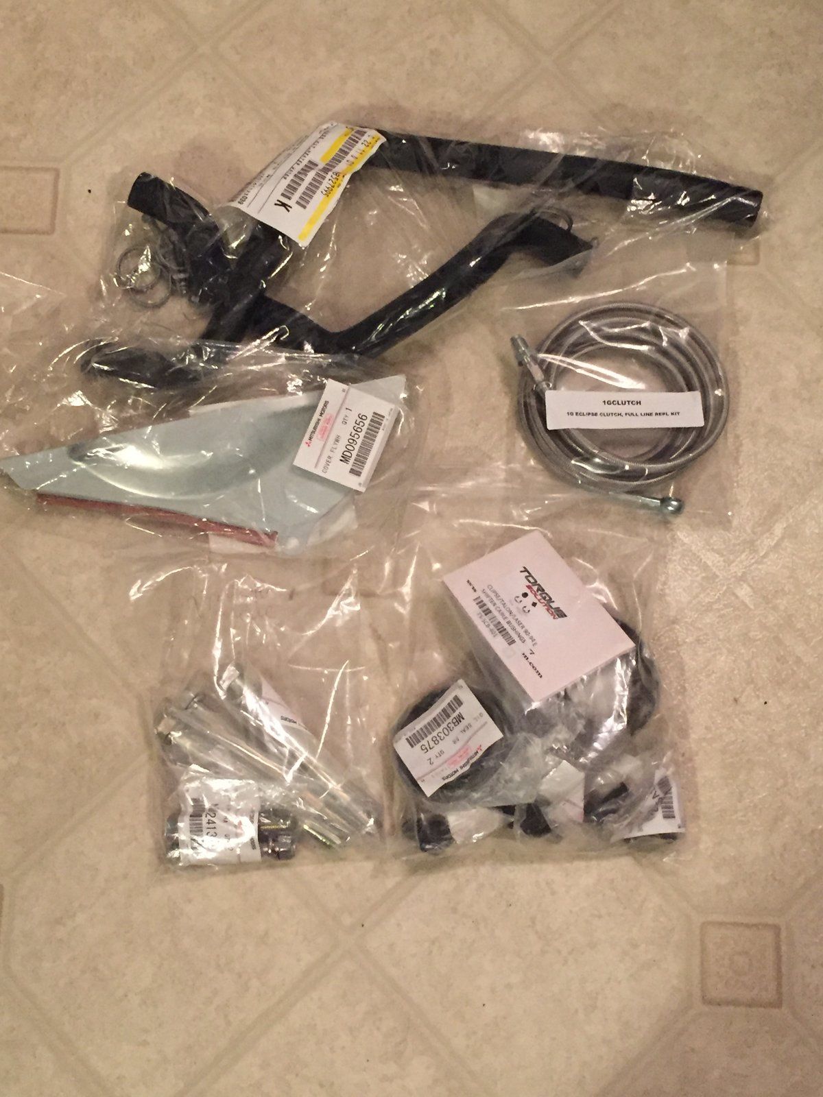

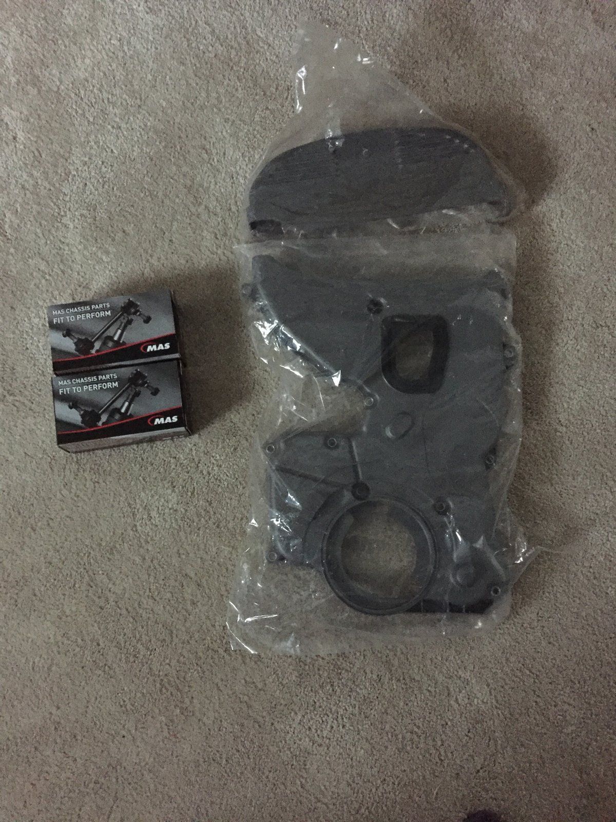

More parts have arrived!
Heater hoses, clutch line from the master to slave, trans dust shield, transfer case bolts, oem flywheel bolts, oem pressure plate bolts, TOB spring, new seals for the front wheel bearings, intermediate axle shaft with bearings and seals.

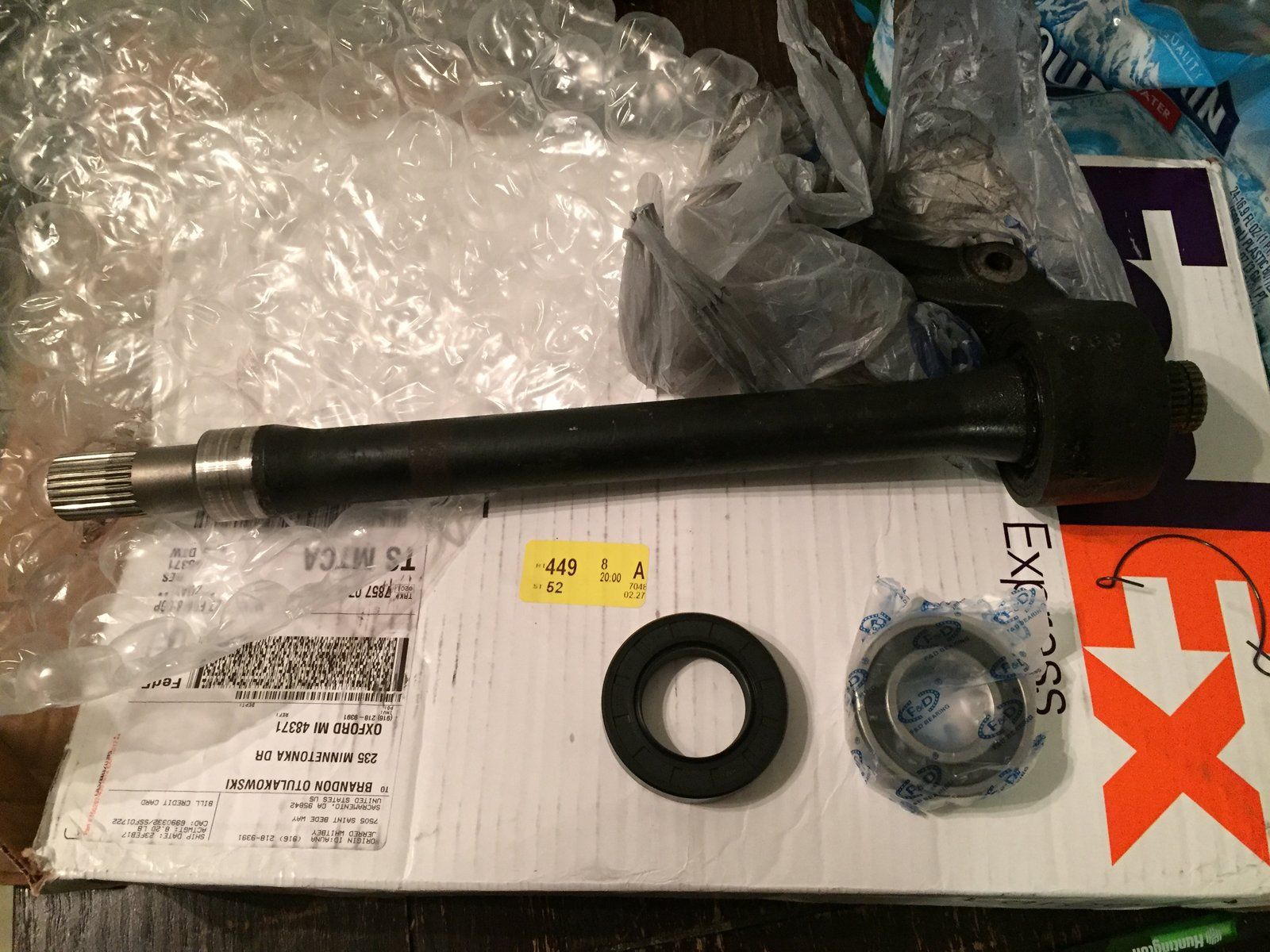

I didnt take any pictures of doing the intermediate axle because I didnt like the way it turned out. After install of the new parts, the shaft isnt as free as I would like it. I believe something is binding. The parts I used were from the "make the kit yourself" and I think Ill just order the JNZ kit that has all oem parts.

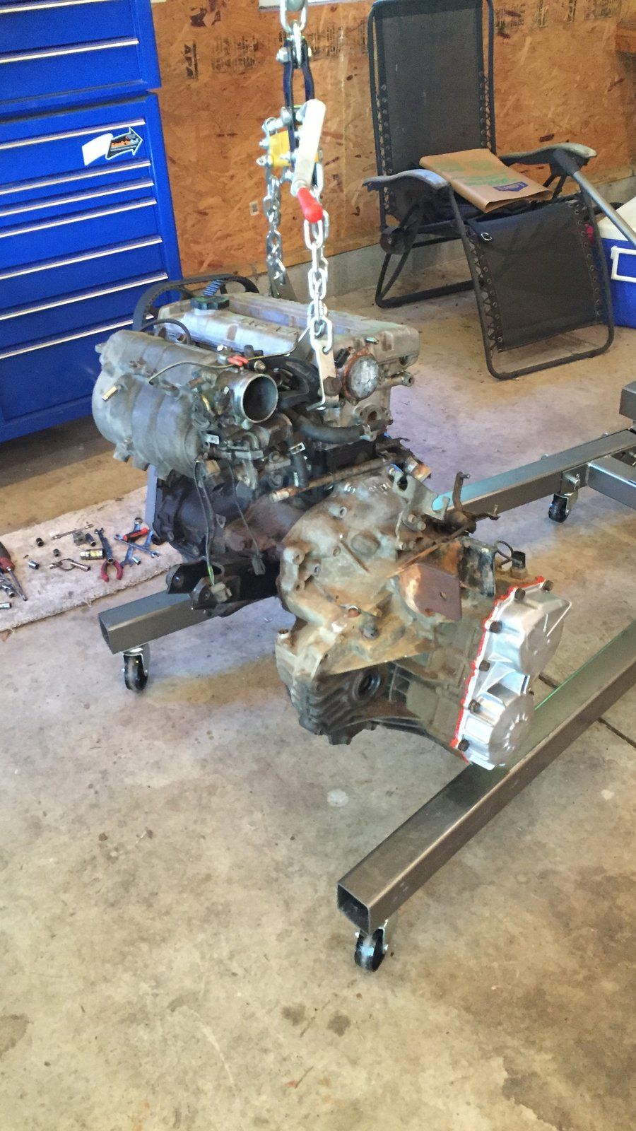

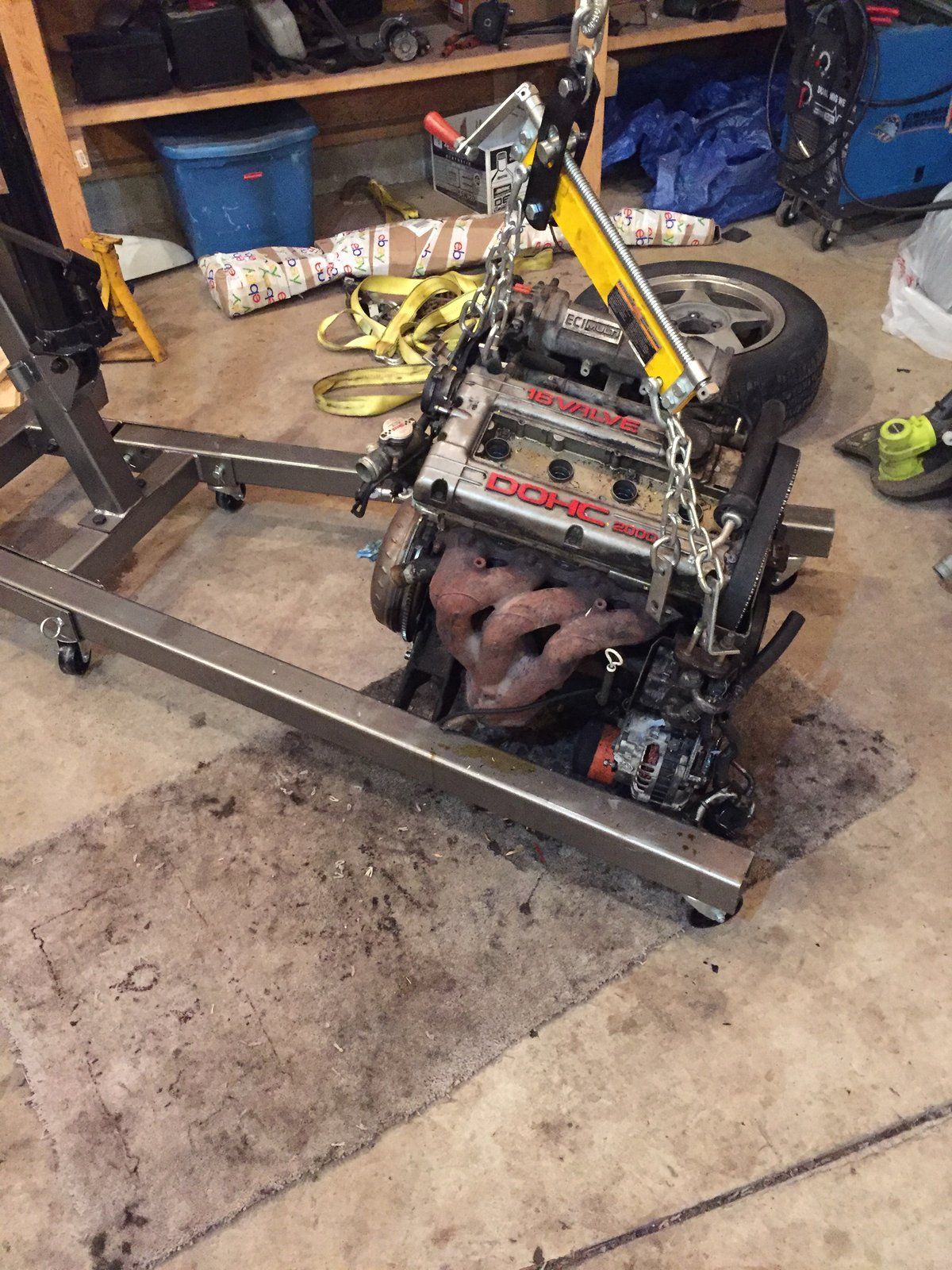

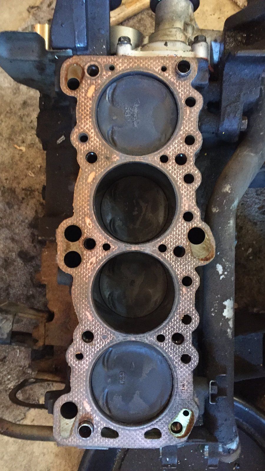

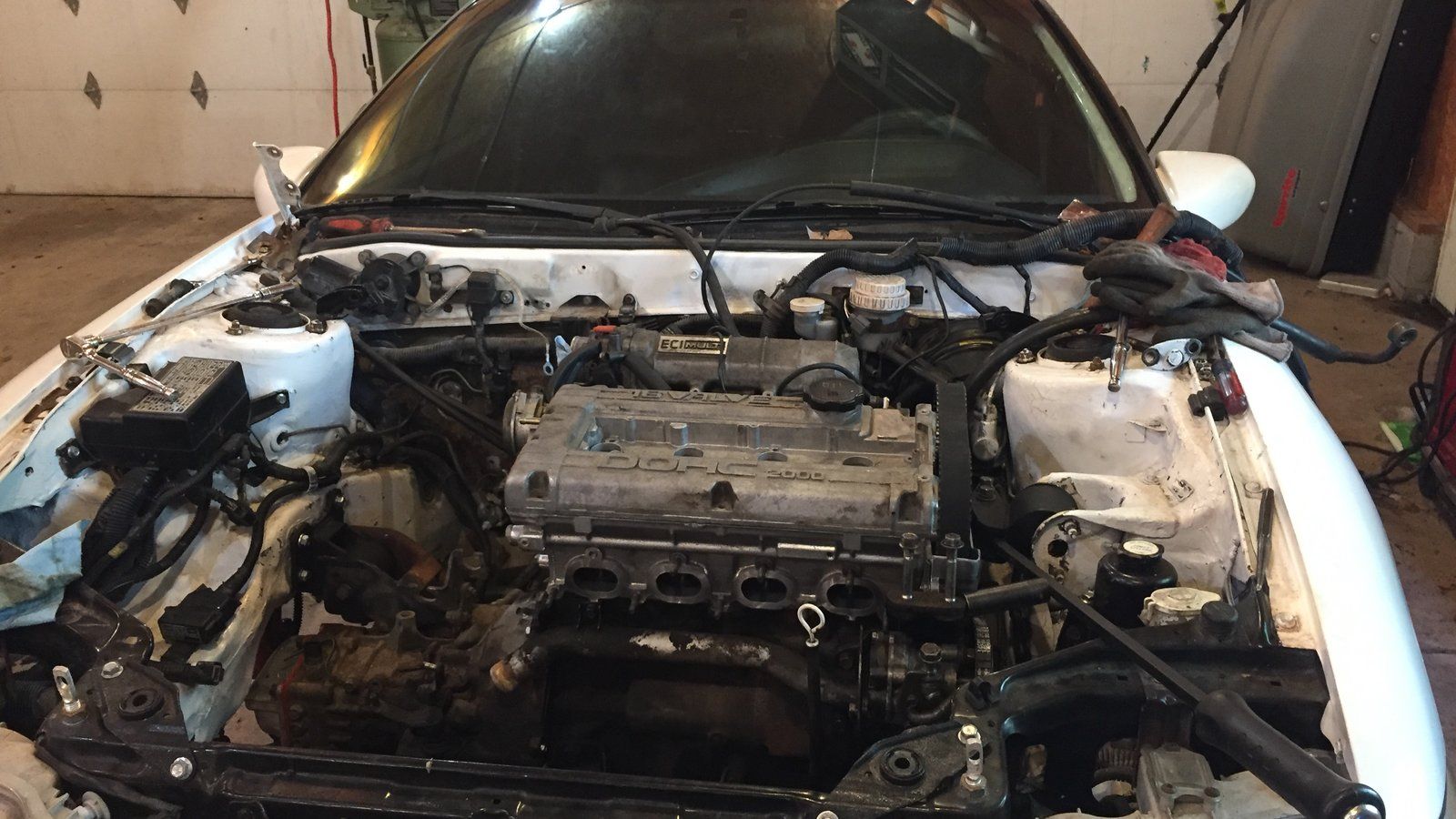

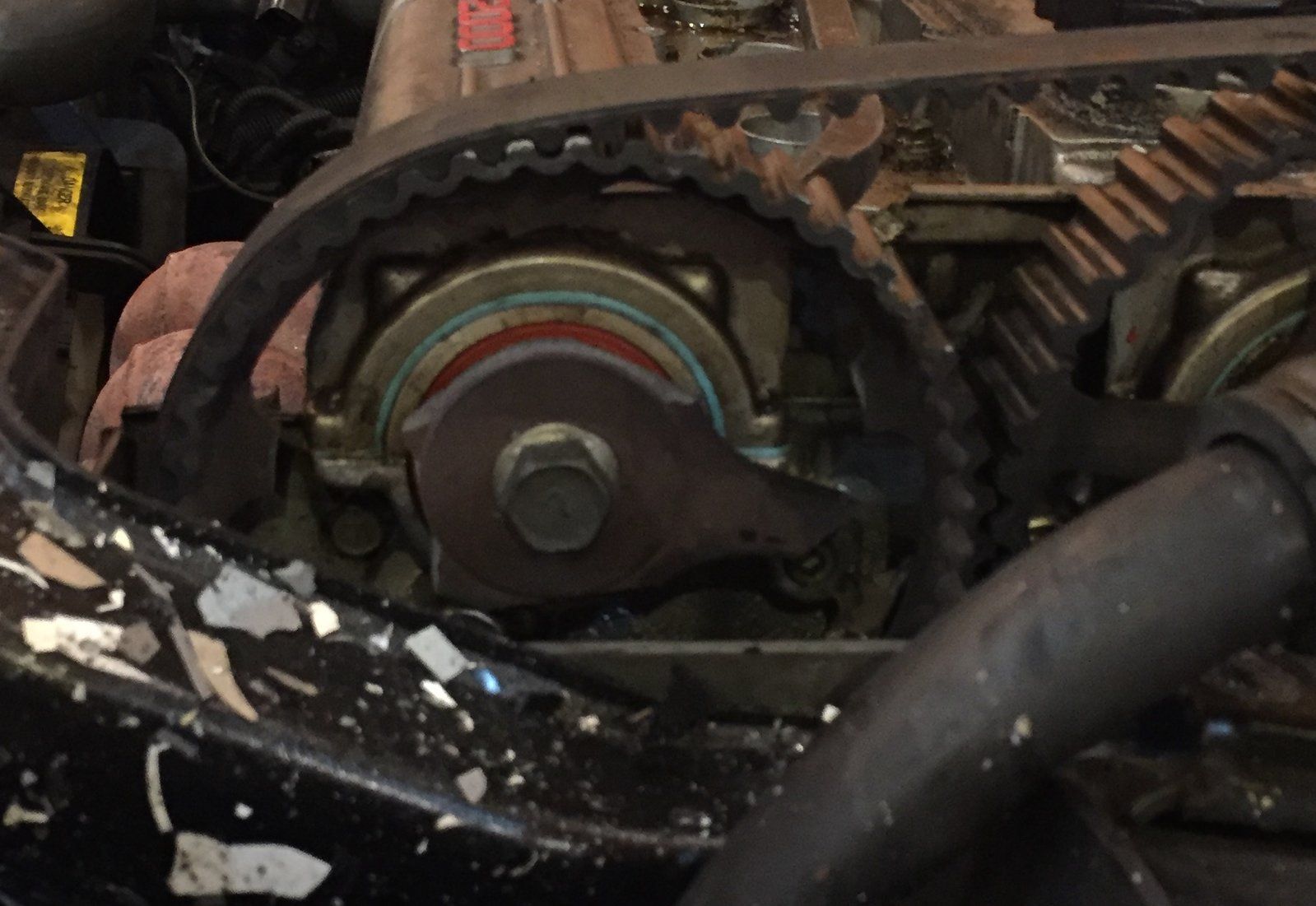

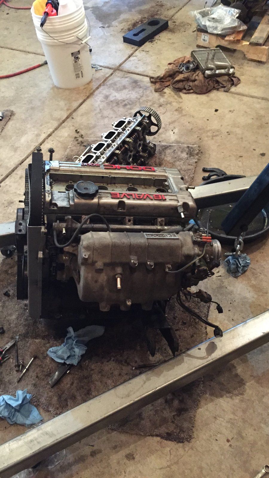

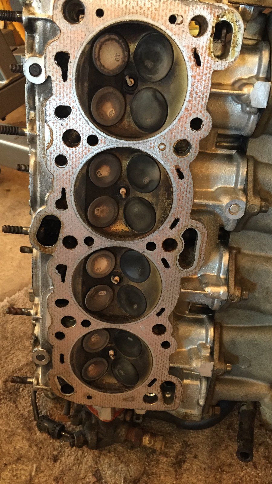

Next I moved on to the engine. Tearing most of the stuff off, this is what I ended up with.
Im a little unsure on what to do at this point. I see no visible signs of the pistons hitting the valves. Id hate to put it all back together to find out one of the valves have been tweaked. Granted it only takes a few hours to rip off the head. Still debating if I want to run it or run my buddies. Time will tell.

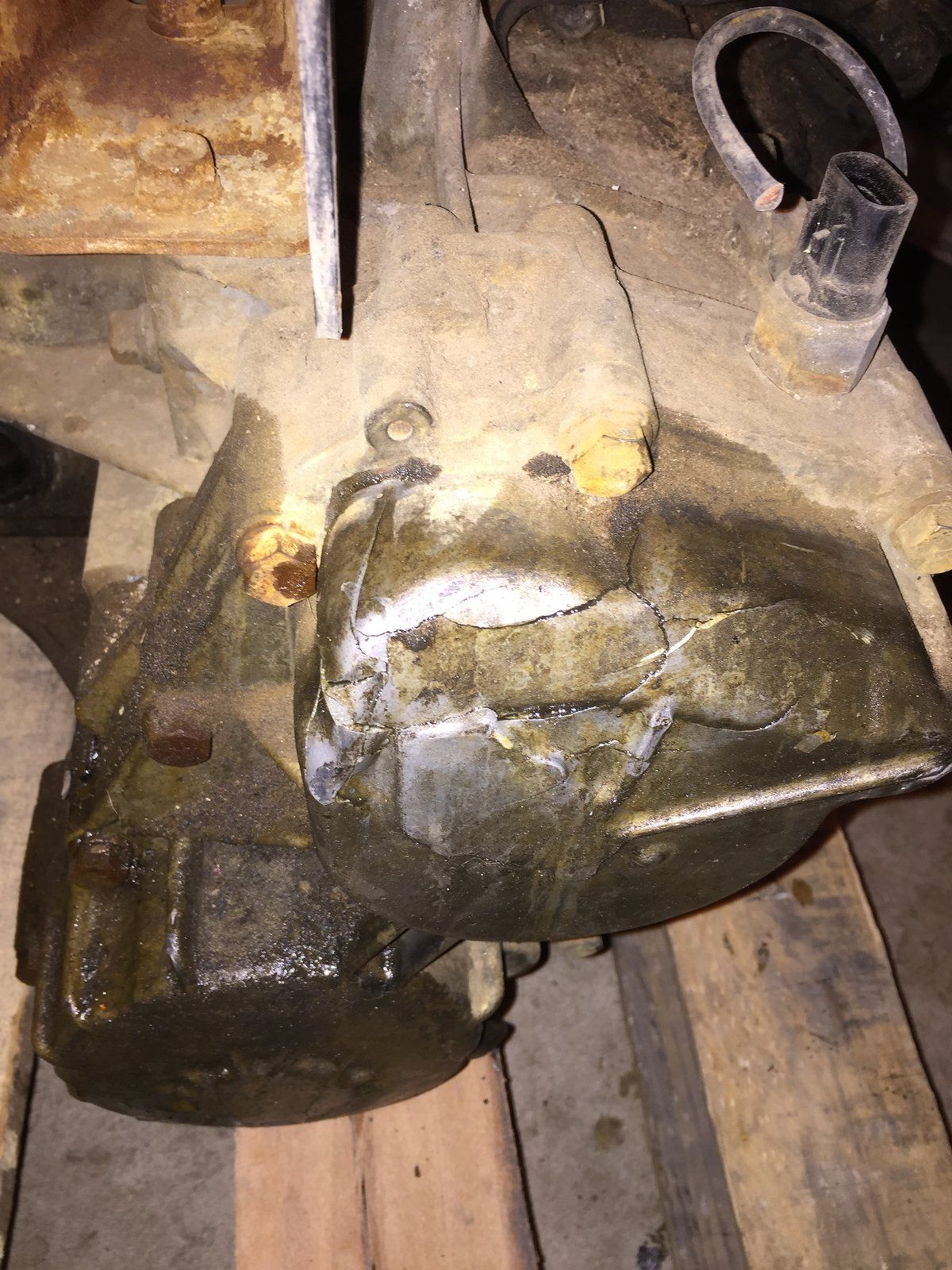

After I got off the head I wanted to finally unwrap the transmission I received. Well...this is how I found it after the unwrap. After talking with the person I bought it off of fleabay from, he is going to contact the shipping company and see if they cover it as it was not shipped from his location like this. Time will tell. Jacks has new end cases for 80 bucks. I may just bite the bullet and buy it for now. Maybe someone will eventually refun

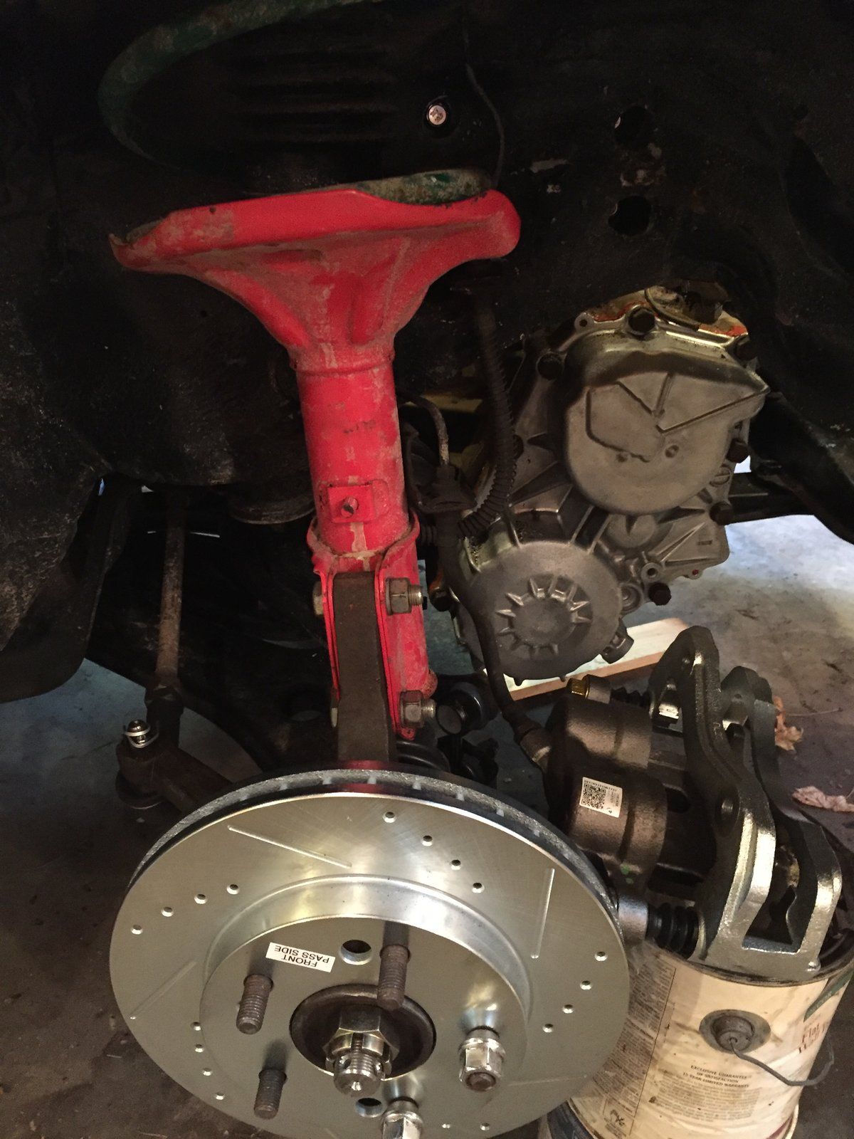

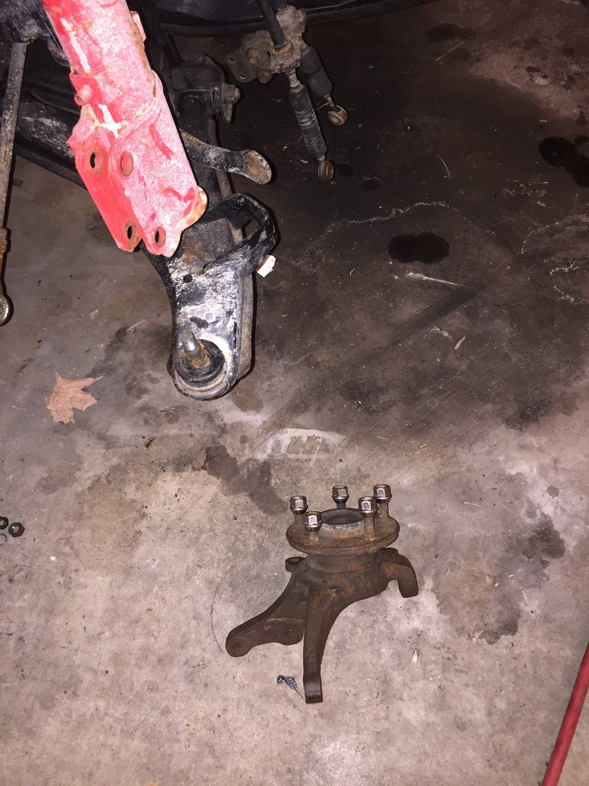

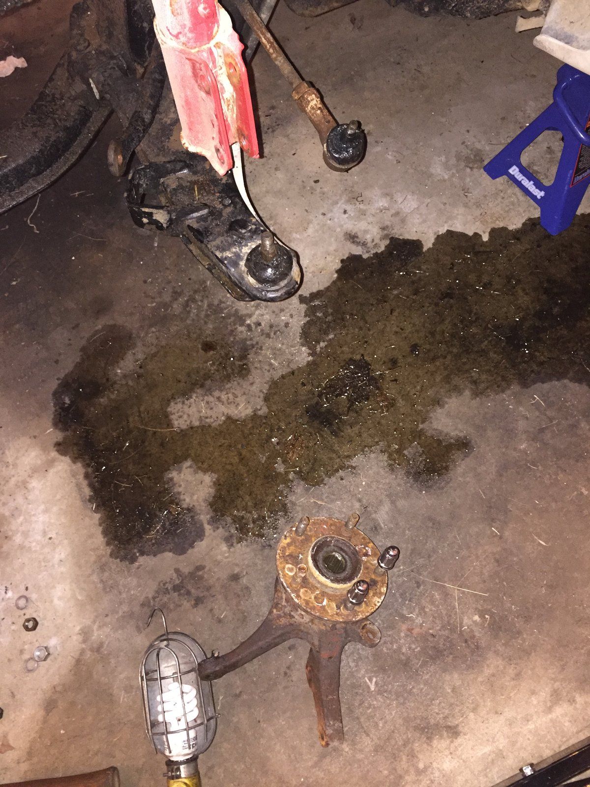

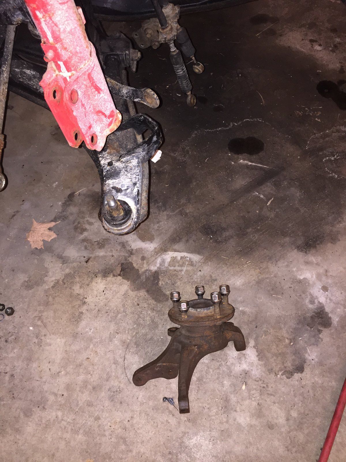

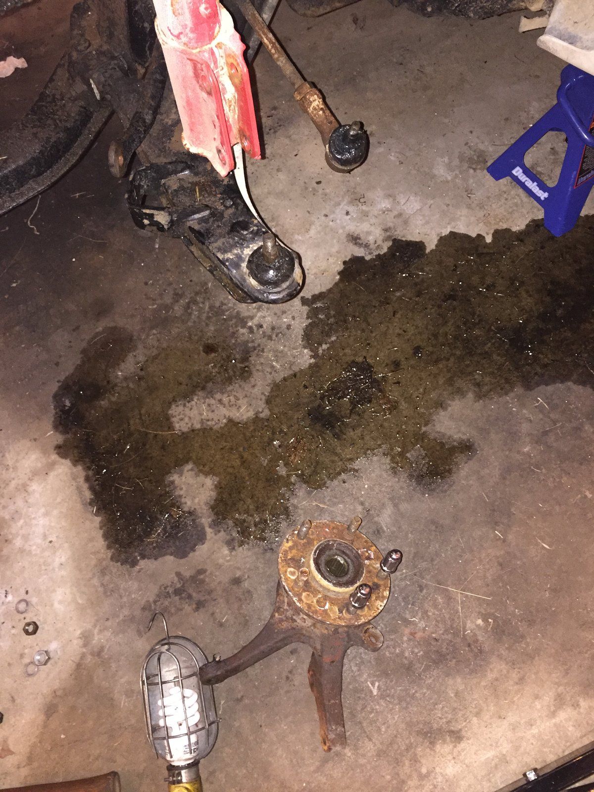

Next it was time to pull the knuckles. Job done. I tried to use my press to press the hubs out however, no luck. I may drop them off somewhere so they can press them out. Putting them in is a breeze. Dont pay att to the dirty floors :p

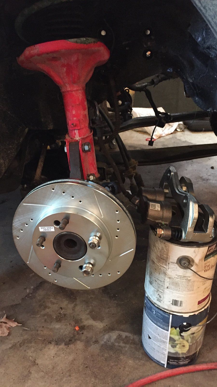

I started with bandaging up the front end. I placed new ball joint, tie rod ends, wheel bearings, rotors, calipers and pads. I had to stop here because the old bolts were too stripped. I ended up ordering more from JNZ and they fit like a glove. I just need to mount the calipers, etc.

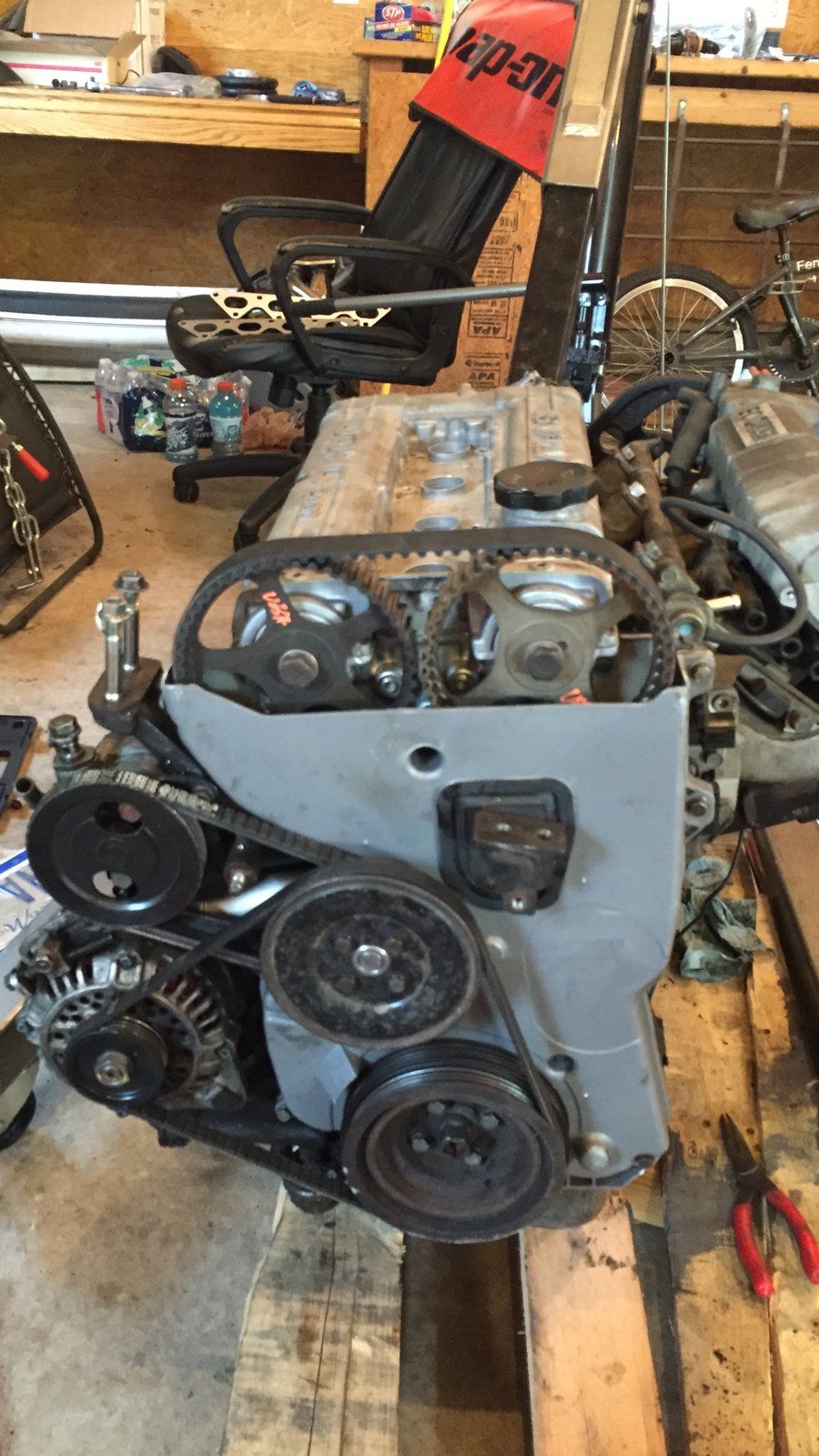

Next up was taking care of the engine. First I swapped over the manifold and CAS from the old engine.
Next I had to install the machined flywheel and an oem exedy clutch. Also placed a new TOB and retaining clip in the transmission. From what you saw earlier in the thread, the trans was damaged in shipment. The shipper was kind enough to refind me enough money to buy a new end cover from Jacks transmission. With all of that together, this was were I ended yesterday...Shes ready to drop in.

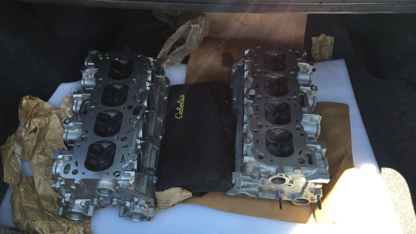

Hopefully tonight I can rip off the hood and set her in. Fingers crossed the head I got from my buddy is still good. When turning over the engine by hand it does seem a little weak, but time will tell. Worst case I have to have my old head rebuilt with evo valves.

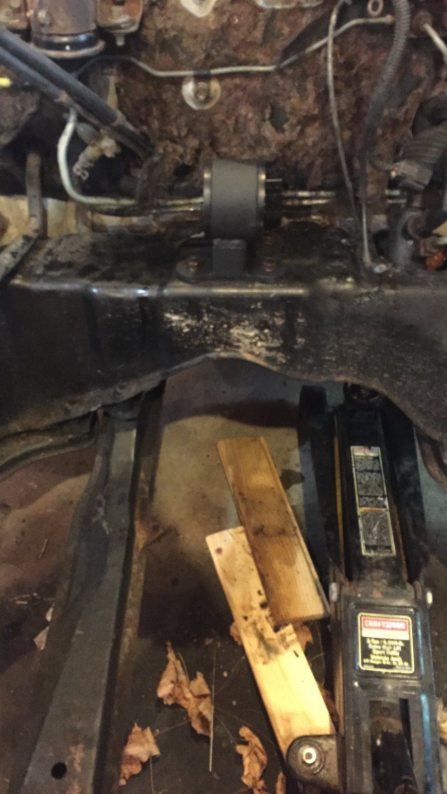

Well I decided to rewind a little. After placing the engine in the car I didnt feel comforable with the mounts I had so I pulled the engine back out. Since it was back out I said ef it, and pulled the head to ensure the valves were good. I had a local shop deck the head, install new valve stem seals and do a valve grind. (I had two heads dropped off, why not. Im sure me or one of my friends will ruin a head at some point.)
Beyond that I also ordered some Avid motor mounts. Only pic I could find but I will be using all of the mounts.

Btw, did the machine shop say if the valves were bent at all from being in the accident?

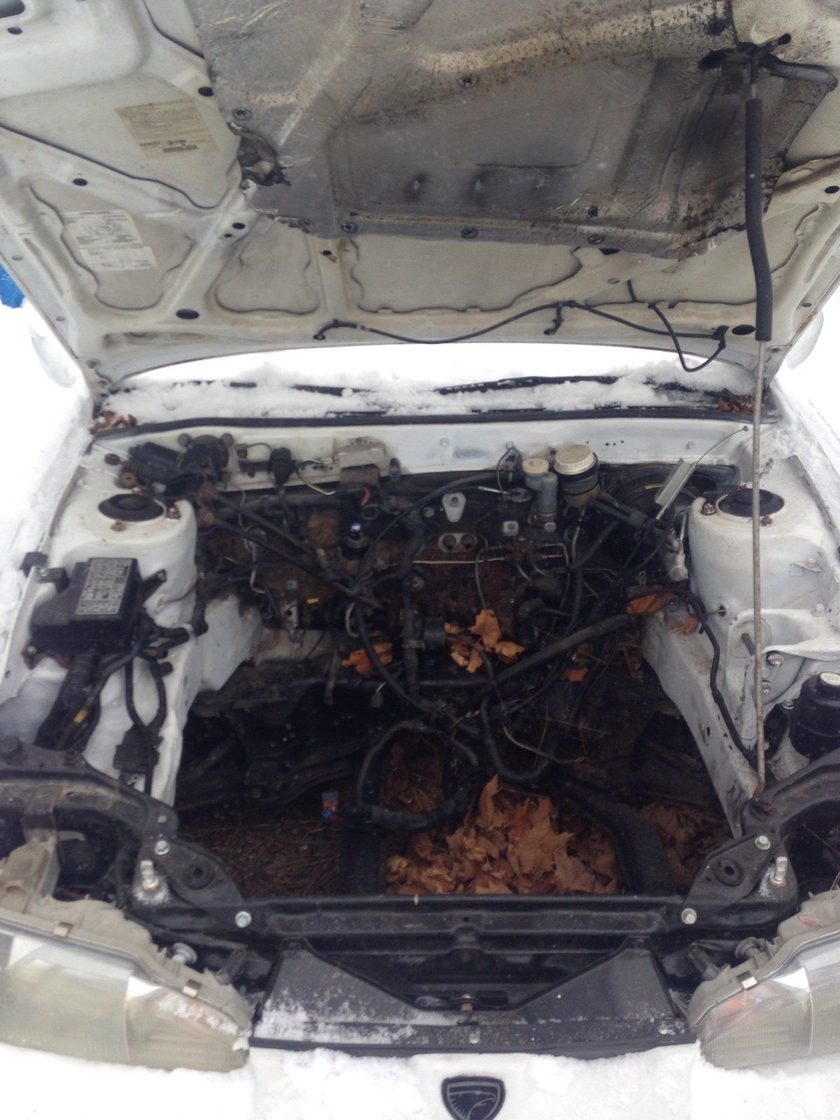

I do need to remove the firewall padding. Im afraid that if a spark ever flies the whole engine bay would go up in smoke.

And crazy thing...even though I broke the cam...the machine shop said the valves were not bent. Meaning I could have used it the way it was. I guess you can never be too sure. Now, I dont have to worry about it. :)

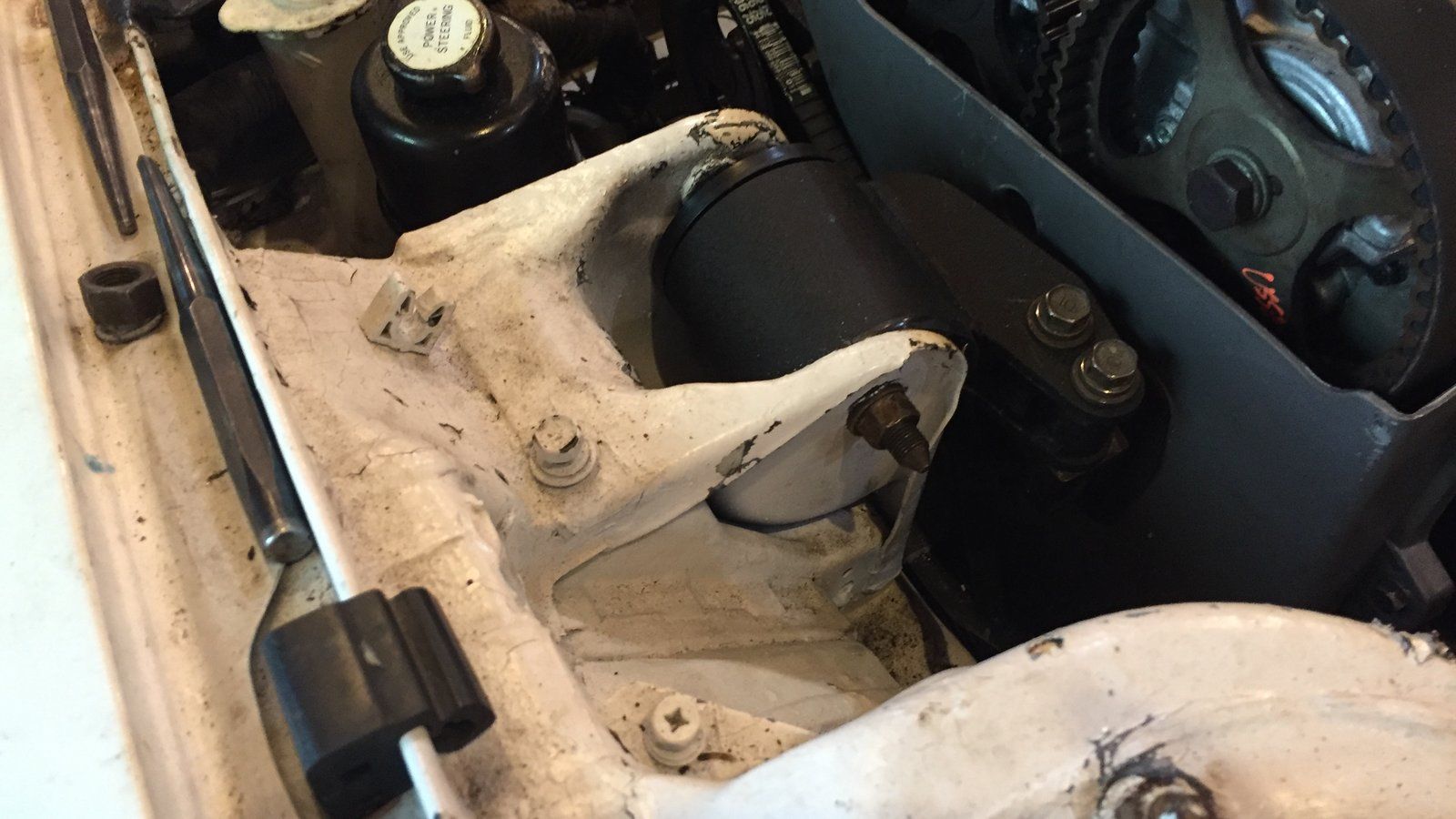

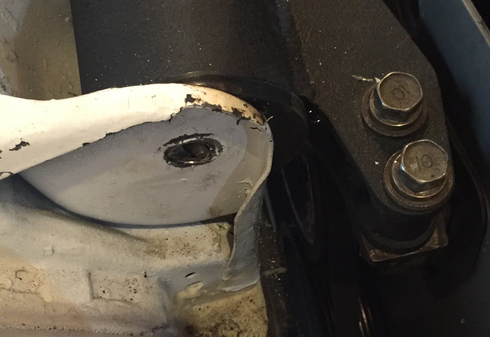

Let me just saw wow on the avid motor mounts. I found it easier to first install the rear, get the front in but loosen up the mount to block so the engine can slide. Next I installed the trans mount while leaving it as loose as possible. Finally, I already had the timing belt side motor mount installed on the engine, the hard part was making it fit in the hole.. See below.
My little trick to get it aligned.
AND ITS IN!

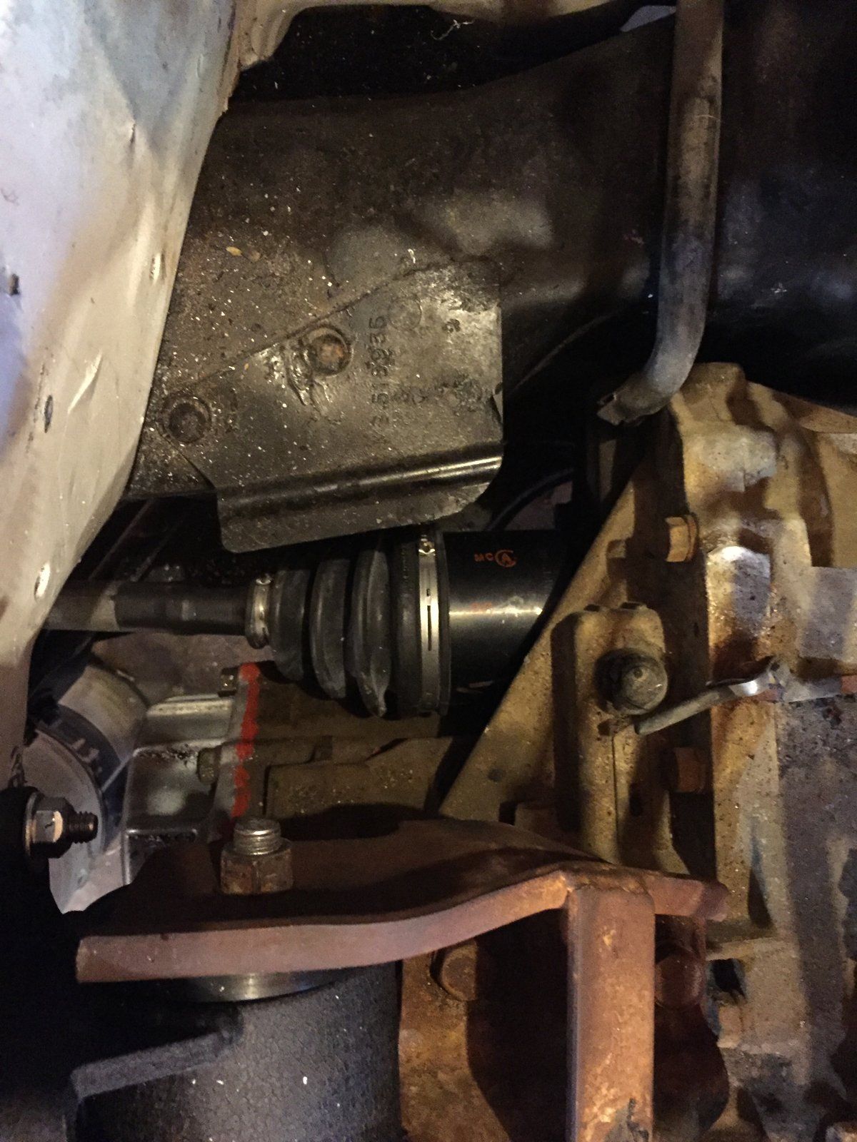

I was able to get the passenger side new axle installed however when I started to put everything back together I realized that I didnt have an axle nut washer for either side..and the break pads I bought were not for the dual calipers...LOL. So Ill be needing to source these sometime.

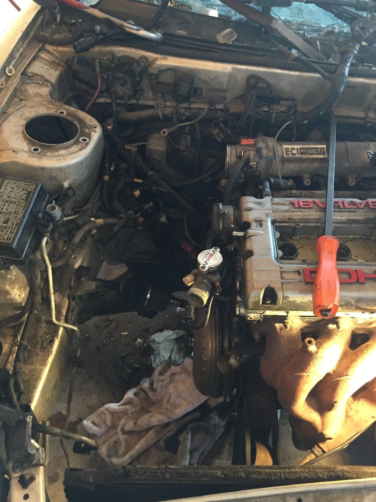

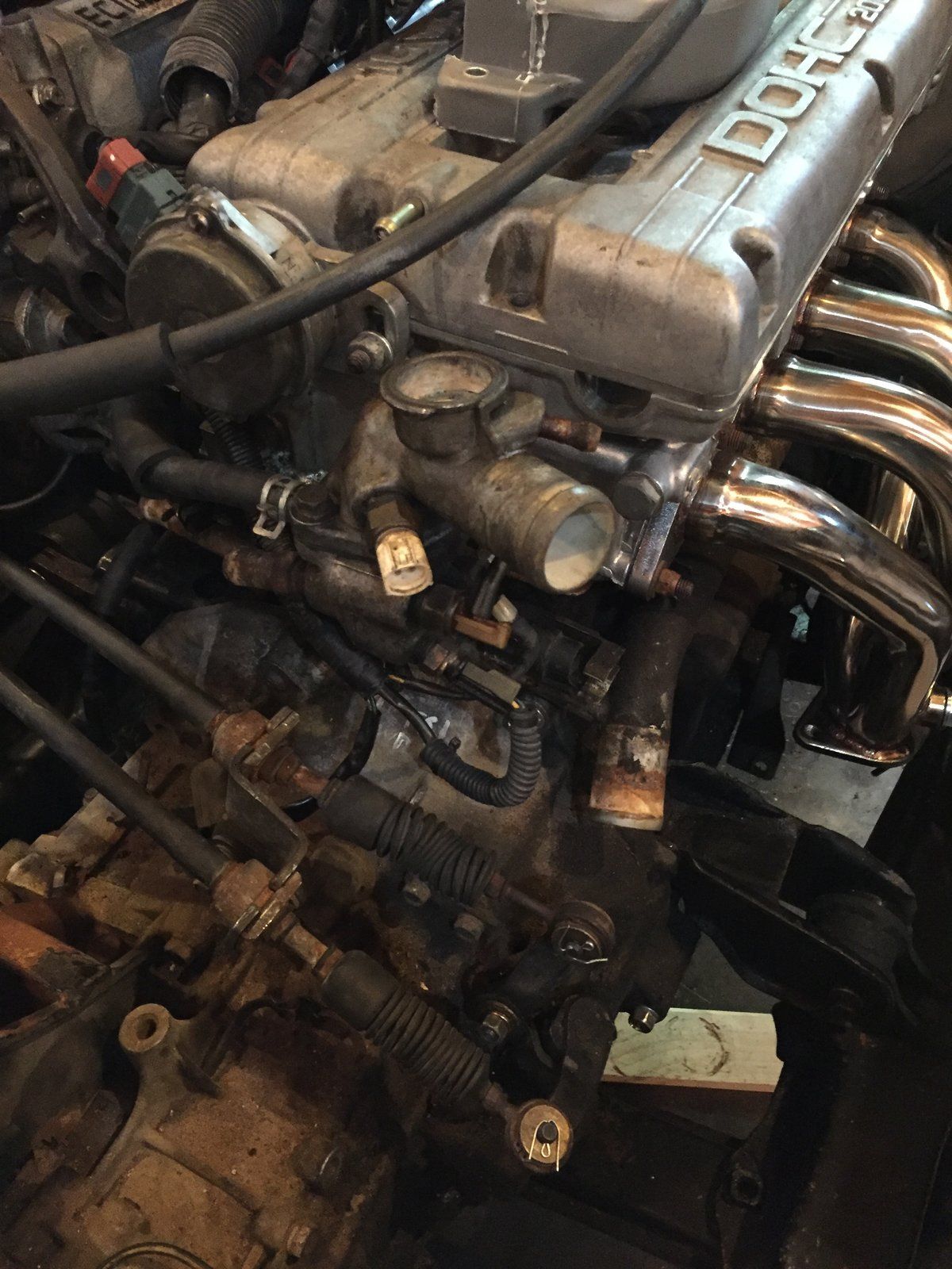

I went ahead and put on the coolant neck as well. New gasket and some rtv does the body good. One thing to note in this picture, the linkage for the top most cable is kinked a little, as you can see. After further inspection I couldnt move the shifter left or right. So I took the linkage apart and re lubed everything. Upon taking the linkage off at the transmission I found that the plastic shoe was cracked in a few place. This may have been causing the offset in angles. So my plan is to order one of these shoes from JNZ. They've been the only ones to carry them in the past. Part number MD712919.

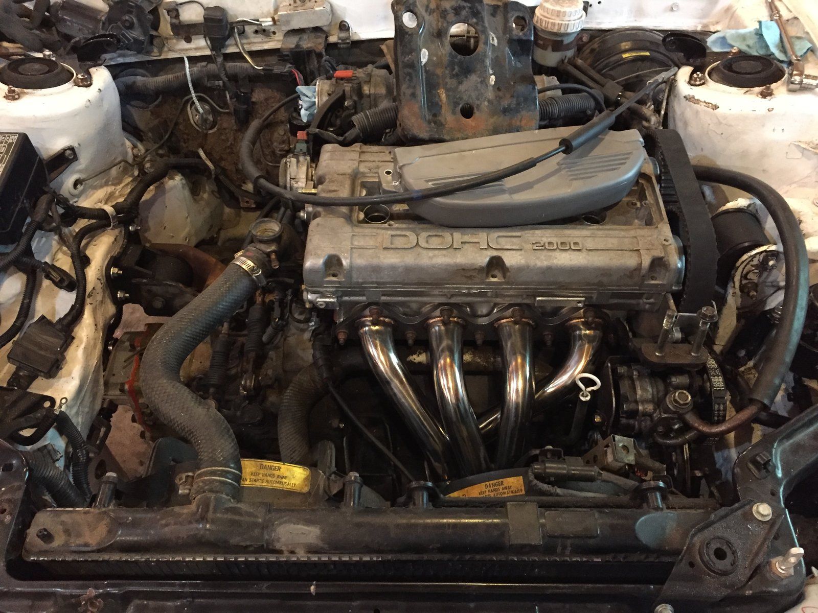

Once that was done I decided it was time to throw in the header and radiator for mock up. Everything seems to fit. I was worried about the 02 sensor but that doesnt seem to be an issue.
