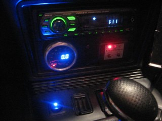

also has fuel to air ratio gauge which works
and a boost gauge that doesnt work
the dashboard lights up either green or blue

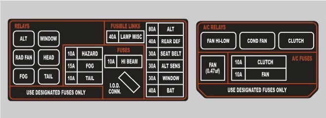

The car needs some work. You say the tranny and clutch are good ..The motor obviously runs and has a new timing belt you say, so throw in a bov which should drastically make a difference, grab a thermostatand alternator..Tranny,clutch and motor are the main things and they seem ok .. Check the wiring on the fans it could be something stupid..Run them to power with a jumper see if they come on. Whats on there of the body kit looks as though it was put on descently..If you want a turbo car you got one, I think you could deffinatly put it together with a little tlc. Also some people Ive seen put the headlights on a different switch somewhere so they can control how much they open..Run a jumper to those motors too on the lights ...The boost gauge obviously isn't going to work...Start off with the main stuff first get it running right then worry about cosmetics (gauges and a front bumper)...Also if you have air bags there must be a pump for them somewhere...You can also piece together an interior and bumper pretty cheap...Honestly doesn't seem that bad...Good project car..Good Luck
P.s. Check every possible fuse first..
