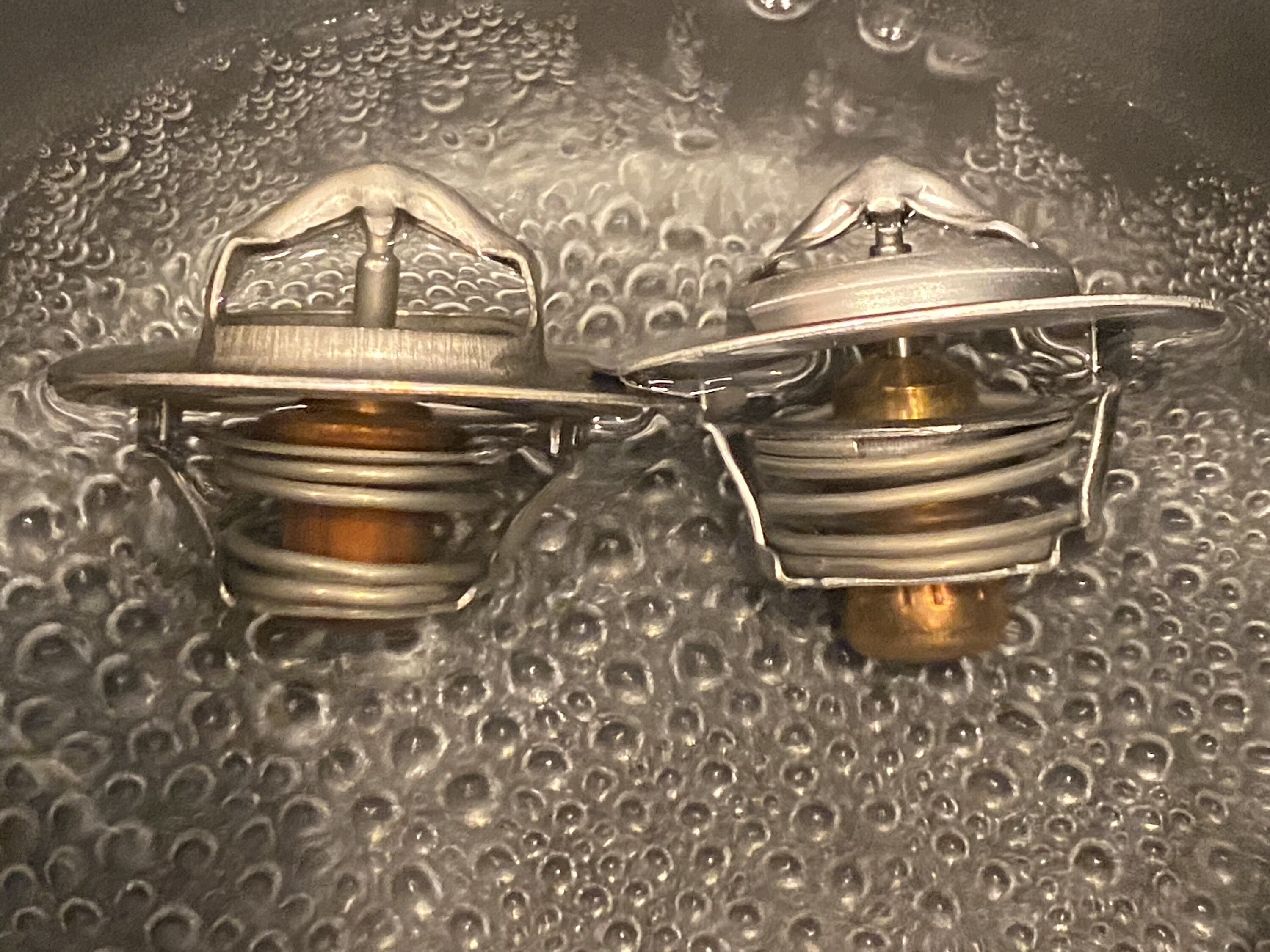

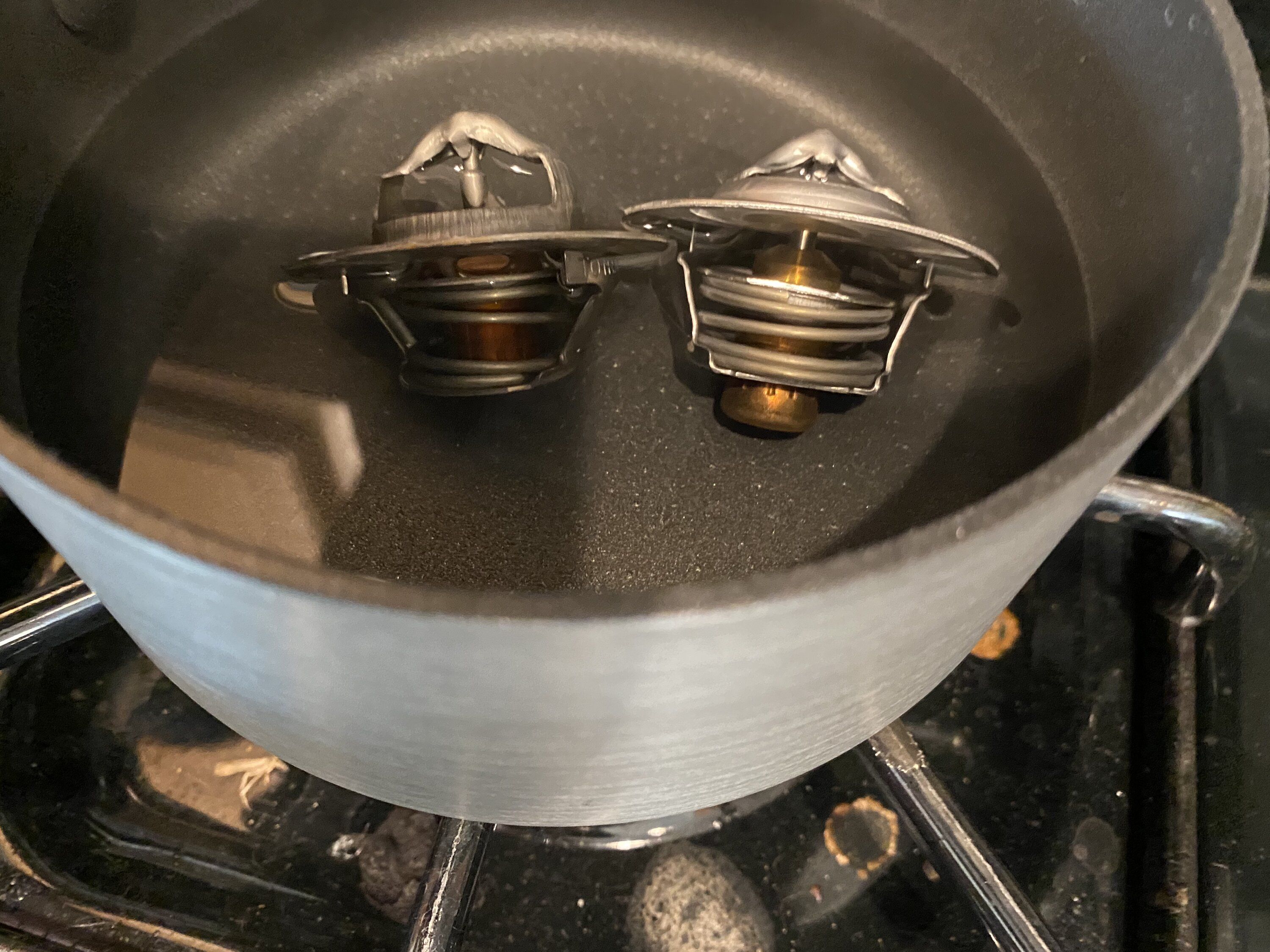

This year the jeep has been giving me problems. Voltage regulators are built into the ecu on these models and early this year, it started to fail. Luckily they sell and external voltage regulator which I replaced a few months ago. Now it started overheating sitting in traffic. It would start to bubble out of the reservoir. It has an upgraded fan clutch so everything pointed to the thermostat. New gates tstat on the right. If this doesn’t fix the issue, I’m not sure what will. About twice the opening.
