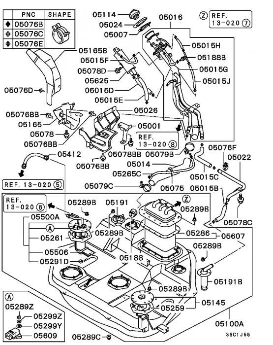

This is from the Mitsubishi ASA database (same one dealers use).
Download database here: http://www.dsmtuners.com/threads/dsm-caps-program.470931/#post-153340217.
Or use online version here: http://www.partsbase.org/mitsubishi/us/
Attached is the diagram of the hoses on the in tank canister.
PNC is Part Number Code - it is not the part number. Example: PNC is like the generic code for a fuel pump where the part number is the actual number for the fuel pump used on a unique year, model, engine, options, latest revision etc. (and is often stamped on the part and is what you order it from Mitsubishi by). Part numbers usually start with MB, MR, etc.
The 4 hoses are:
PNC 5617D, PN MR323718
PNC 5963T, PN MR299442
PNC 5963S, PN MR266607
PNC 5015B, PN MR342240
Ya worm gear clamps are ok as long as the gear teeth don't dig into the hose.
The 4 hoses are:
