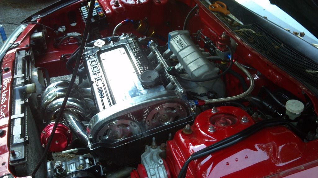

very nice, that motor is looking sweet! Also its great that you were able to save the car, nice work.
Got alot more stuff back on the car today, not much left. Should have it up and going in a few weeks. Just need to get a few more minor things.
It looks even better in person. I replaced all nuts and bolts with stainless. I'm gonna be rerapping all the old wore loom also
I'm ready to hear this thing run

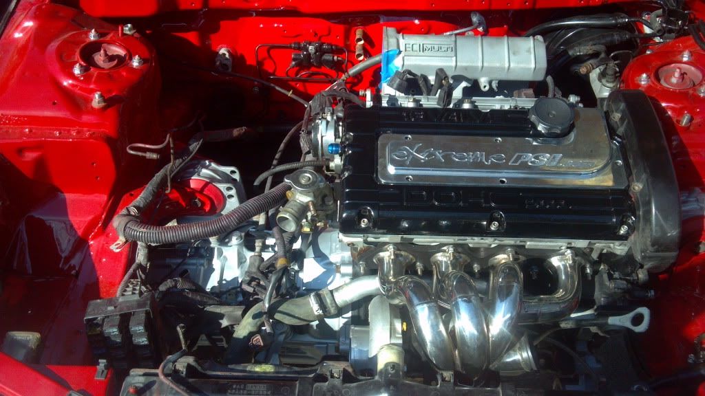

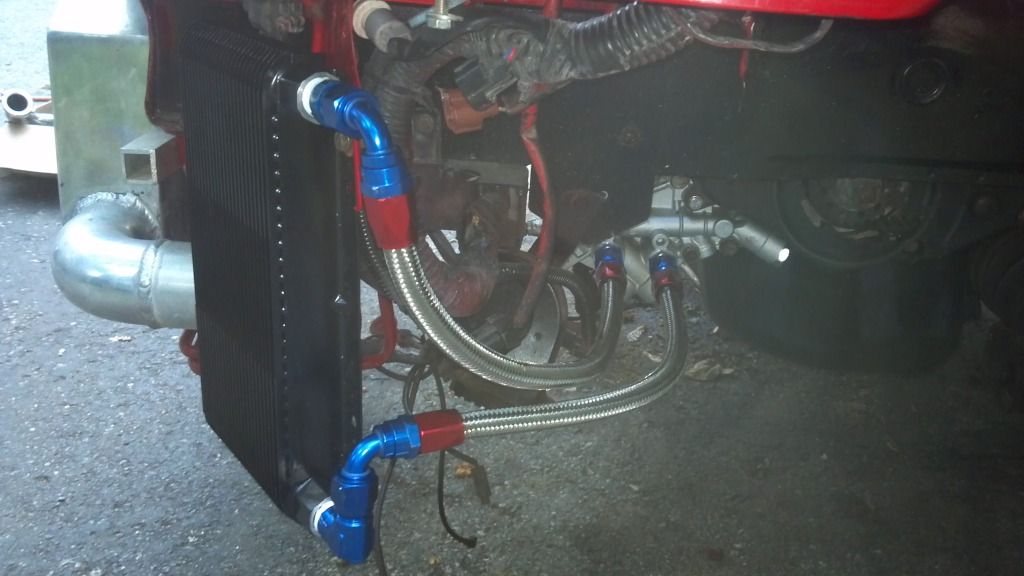

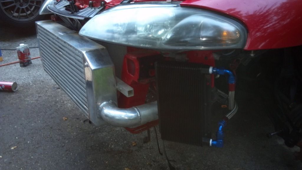

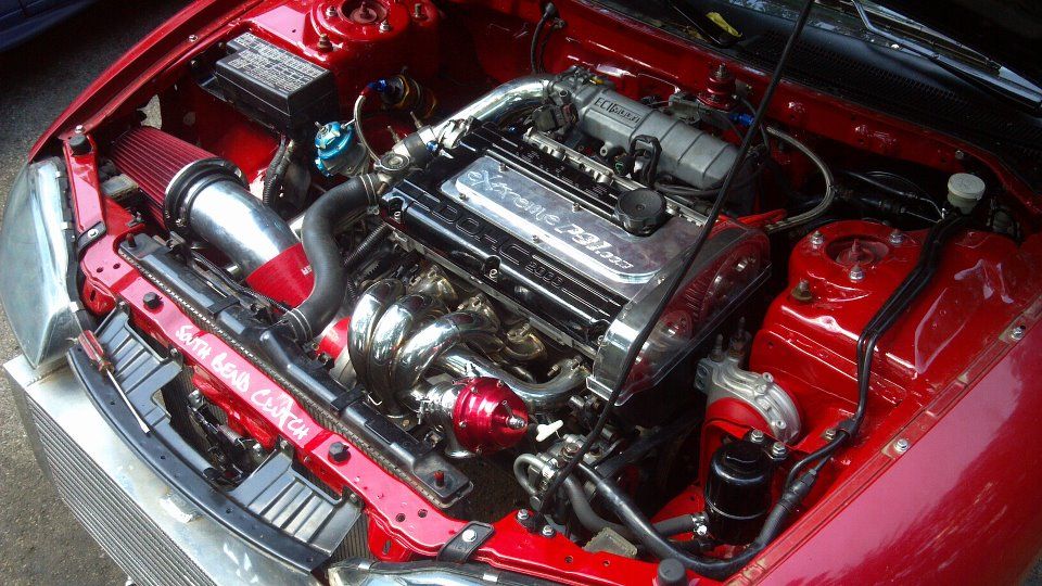

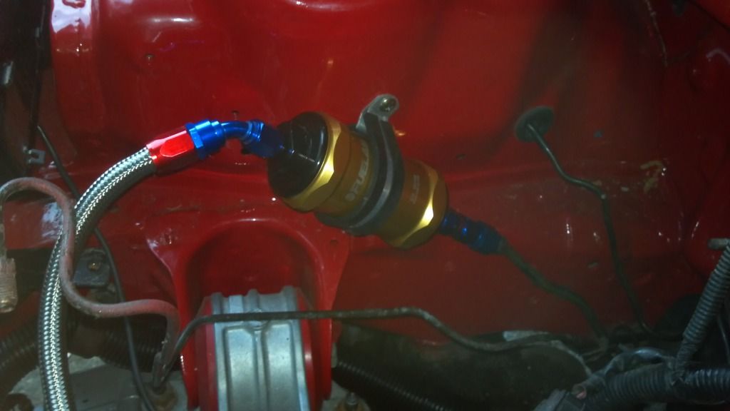

Finally was a too sneak in a produtive day on the car, we got quit a bit done, fuel filter mounted, afpr put on, started rewraping all the wires with new wire loom and getting wiring hooked all back up. New timing gear over installed. Got the b&m oil cooler and all mount up the the evo3 ofh, and a few other random things

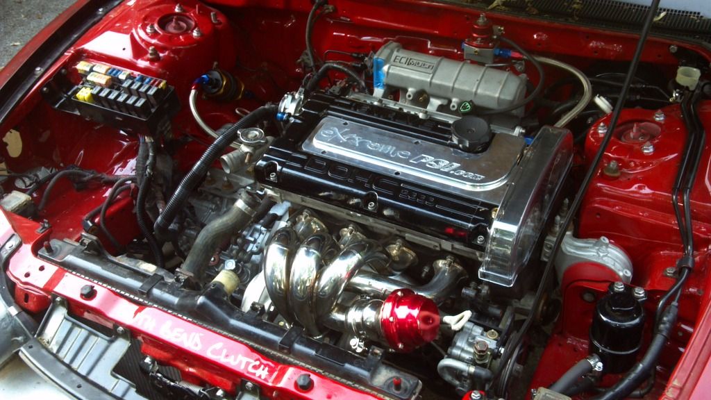

Well shes pretty much done, and ready for the first start. I need my -10 an fittings for my oil line, and get my downpipe fabbed up at a local shop. Here are a few pics that I snapped after getting done working on it today.
After

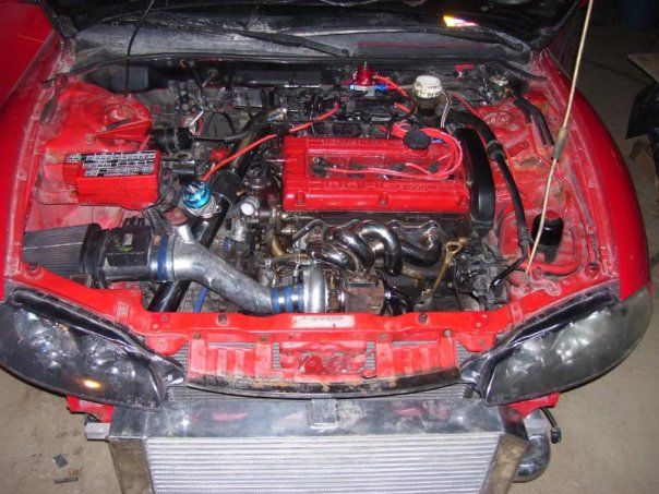

Before the swap with and shitty engine bay and rusty strut towers.
