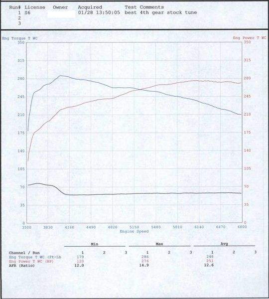

5.2L variable geometry intake V10. 276WHP giving a 4.8 second trip from 0-60. A good car for the wife.

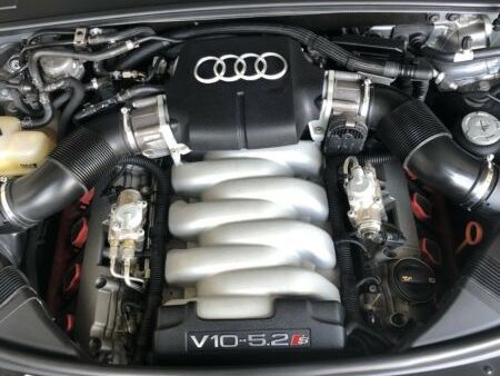

While I was replacing the spark coils and plugs bank 1 had oil on one of the coil's tips. I took off the valve covers (that was a huge job, ask if you want tips) and saw that 2 of the plug gaskets were damaged. Replaced the valve cover gaskets. We took it to Audi where they did a media blasting of the air flow path. She has never been running better!
