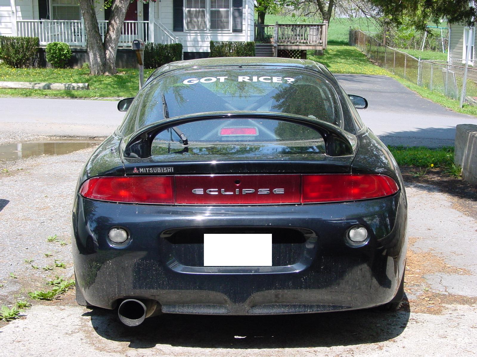

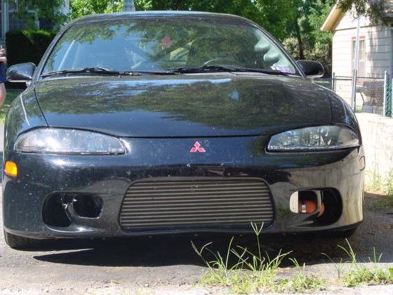

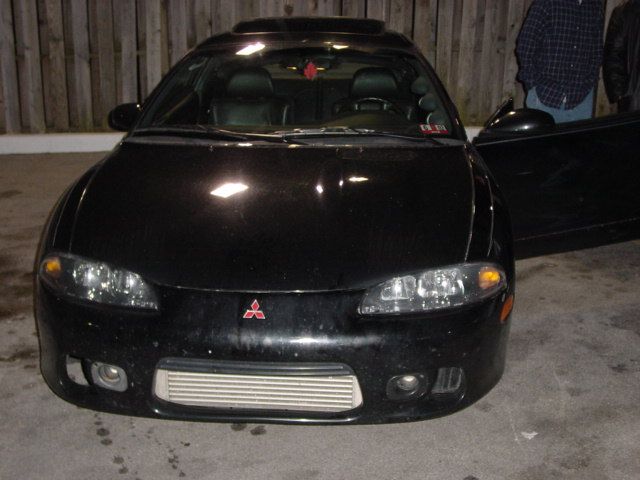

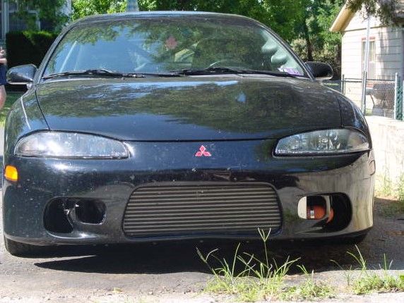

In the process of getting my '99 GSX back on the road. Its been a long time (2005 perhaps) since it has run. Started a rebuild and 6 bolt swap back then, never finished it. Finally got the time and funds to get someone on it. Got it to turn over, going today to get a battery in it and load the injector settings in dsmlink and see how that goes. Hoping to have it road ready soon but still working on a list of items that need fixed / replaced.
