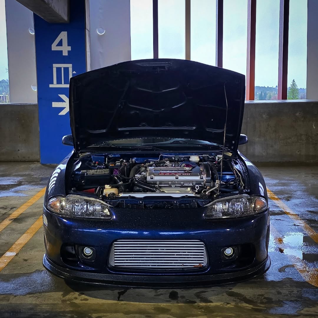

Chassis:
Carbon fiber hood, and intercooler mocked up.
I sanded what i can with the VIS hood. Carbon weave is breaking and epoxy is cooked. I'm buying a Ravoony PET Carbon Wrap and crossing my fingers. CF isn't for looks but there goes my reclear idea LOL
Intercooler bracket made from a home depot zinc steel bar. Easy pz.

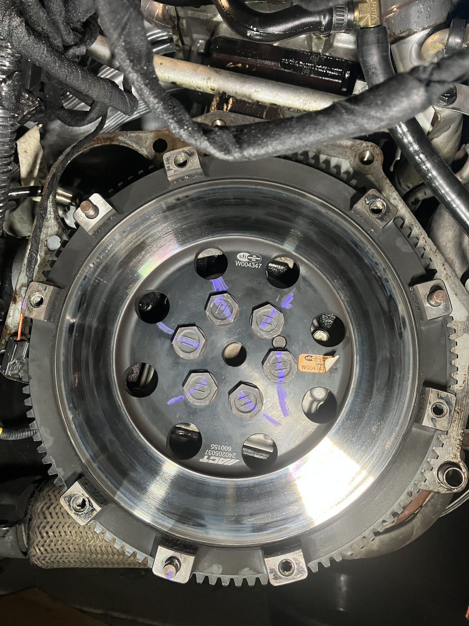

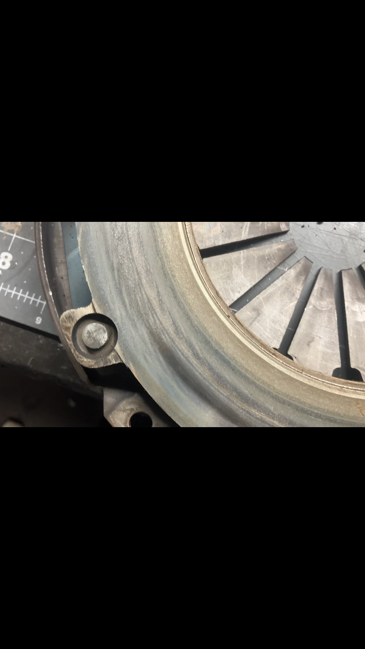

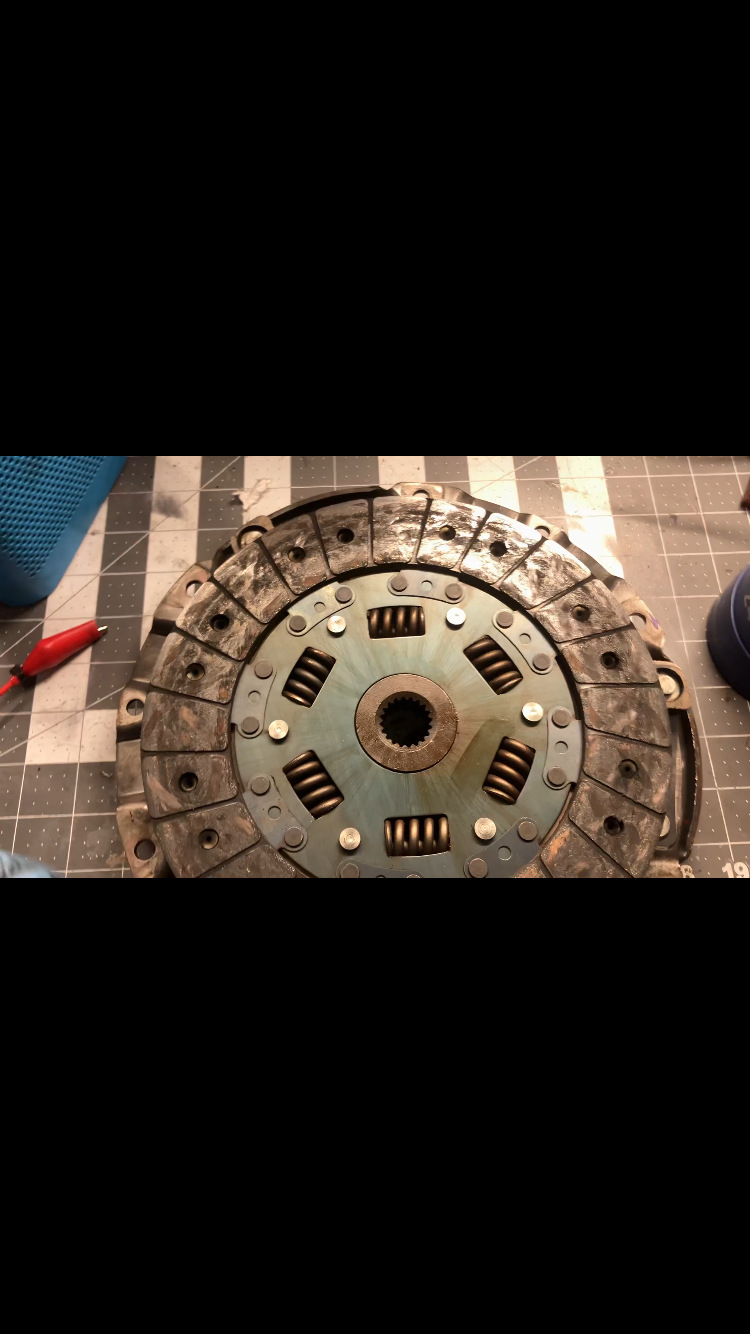

Alright we went under the car and looked at this inspection plate. Doesnt look to be spilling out, but the problem could be my axle shaft seals, or the center input shaft in the transmission.

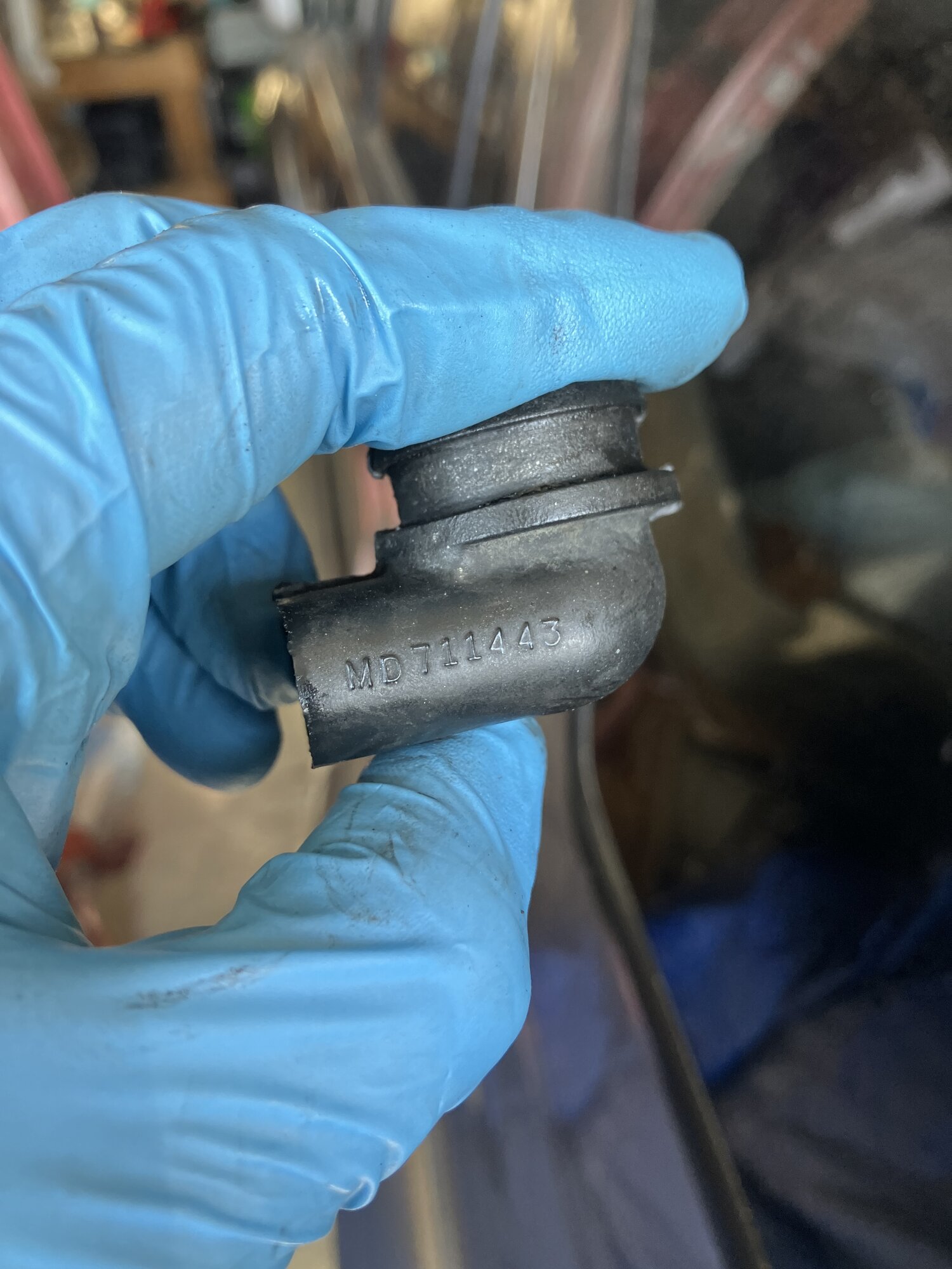

I also looked at the top of the trans. I am missing one of the breather boots i believe its called. Which is a possibilty. from my top valve cover leaks into one of the holes LOL
Will be tearing my transmission here shortly for an input shaft seal replacement. I found this out by the leaks transmission.

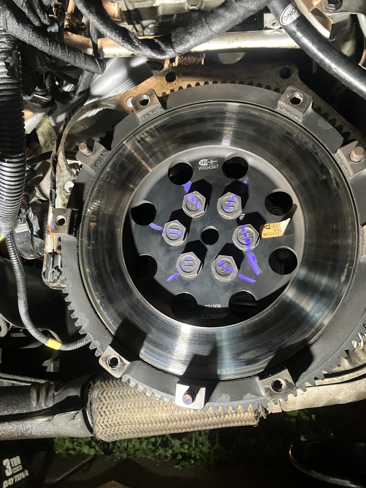

Thinking it was a rear main. Mine still appears spotless. Upon inspection of the clutch disc. There appears to be a leak where the input shaft area sits. So of course my ACT flywheel is cooked too. Sooo here we are. If anyone has any tips or tricks to it lmk
I know I need the input seal. But I’ll grab all necessarily seals on the way.

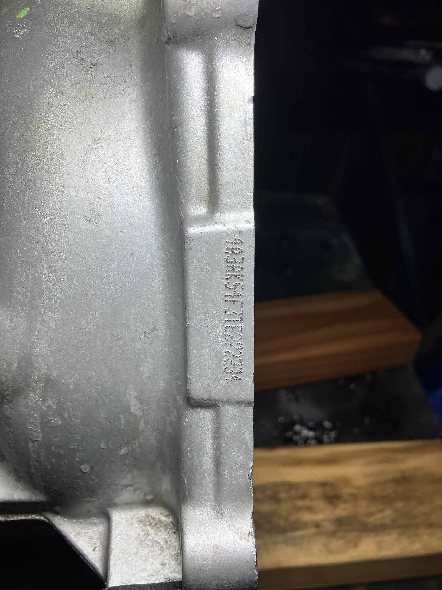

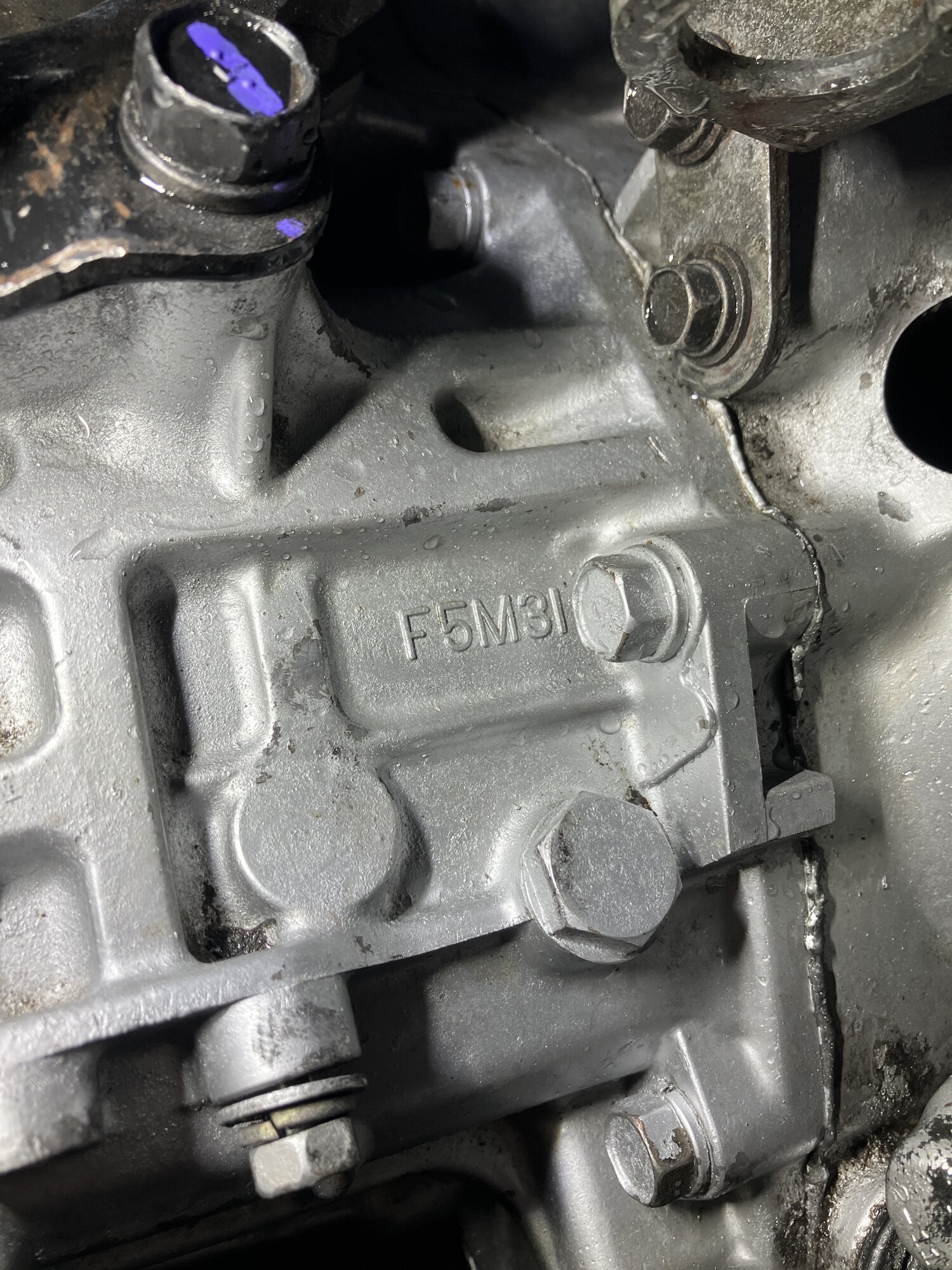

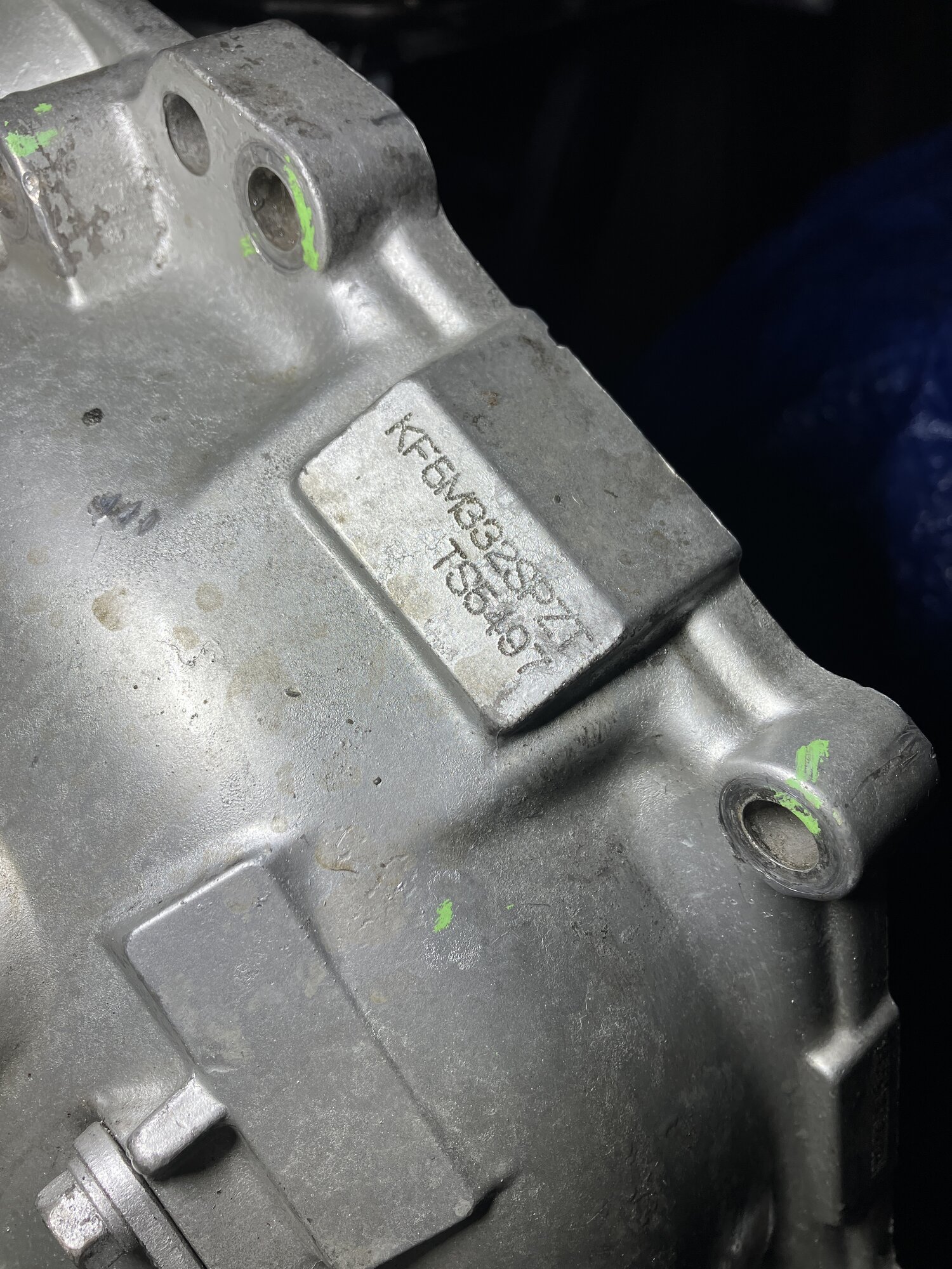

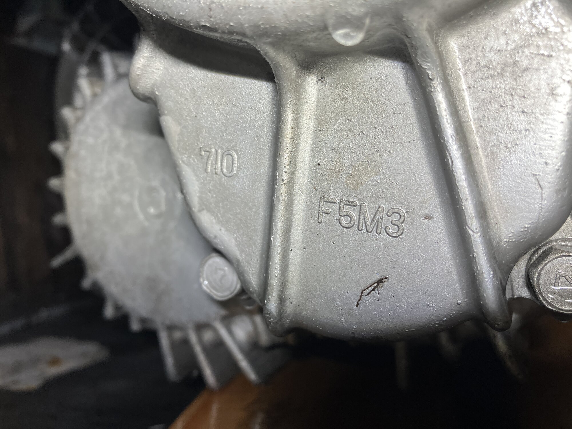

Here are some markings on the transmission. Not sure why there is a f5m31 on the center Housing
