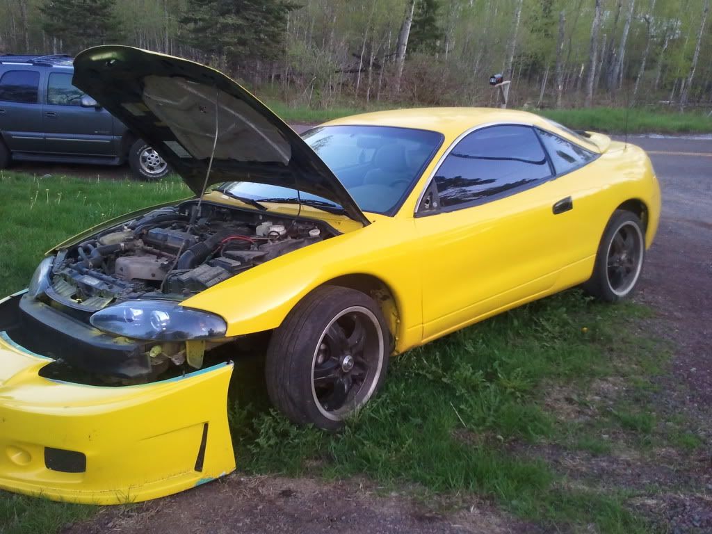

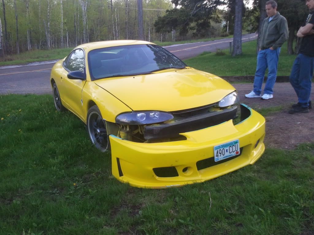

A LITTLE HISTORY OF IT, I BOUGHT THE CAR ON THE SIDE OF THE ROAD FOR 400$ HERE IS A PIC OF IT WHERE I FOUND IT
AS YOU CAN SEE, OR ATLEAST IN MY OPINION THE AFTER MARKET FRONT CLIP HAS TO GO! SOLD IT A FEW DAYS LATER FOR 120$

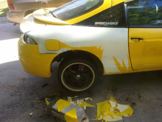

THE PAINT JOB IS ABSOLUTLY HORRID BTW OVERSPRAY EVERYWHERE AN DEFFINANTLY DONE OUTSIDE, BUT NO RUST.
I WILL BE RETURNING THE CAR TO ITS ORIGINAL COLOR OF BLACK

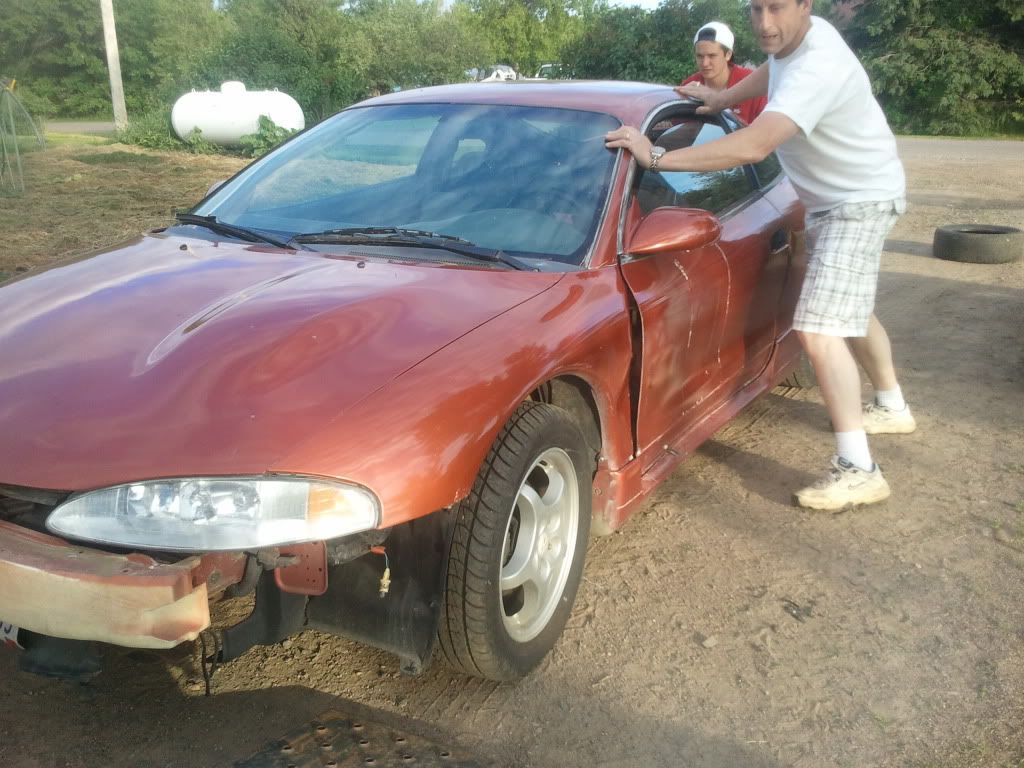

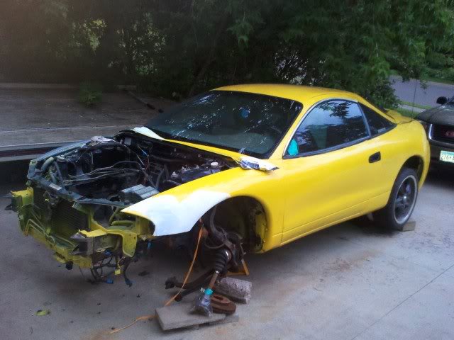

NEEDED MORE PARTS SO I PICKED UP THIS DONOR CAR WITH RUSTED OUT UNDERSIDE FOR 700$
IT KNOCKED, BUT CAME WITH BRAND NEW TIRES ON THE STOCK 16'S, EXGAUST, HARD PIPED INTAKE, GOOD INTERIOR, AND OEM FRONT BUMPER (BUMPER IS OFF IN THE PIC CAUSE IT WAS GETTIN PUSHED ON THE DOLLY
THEY ALSO DECDIDED TO PORE 15 THE STRUT TOWERS

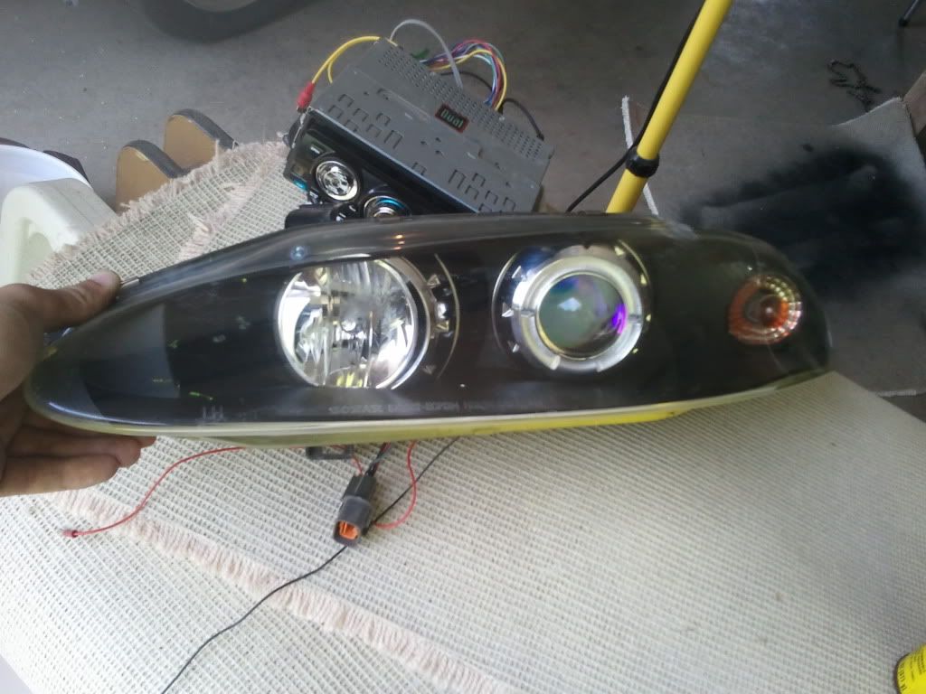

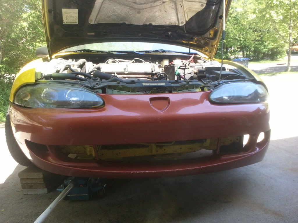

NEXT I GOT MY 10K HALO PROJECTOR HEADLIGHTS AN DUMMIED THEM IN WITH THE NEW OEM FRONT BUMPER ON, NOTHING WAS BOLTED IN, THATS WHY IT LOOKS WARPED

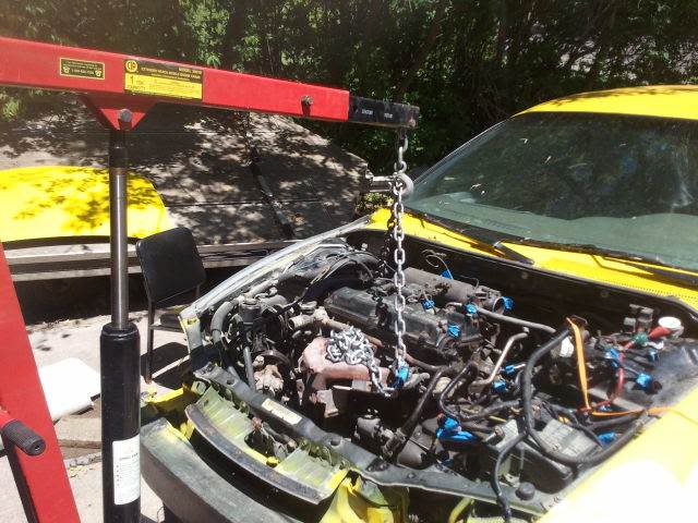

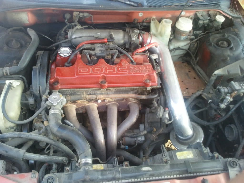

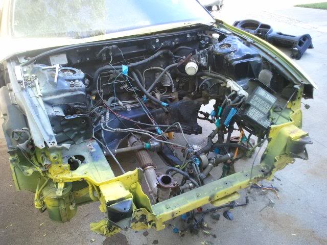

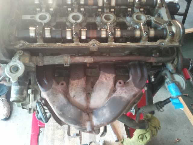

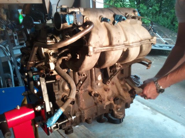

THE NEXT STEP WAS TOO PULL THE ENGINE FROM THE YELOW CAR (LABELING EVERYTHING IS A REALLY GOOD IDEA)

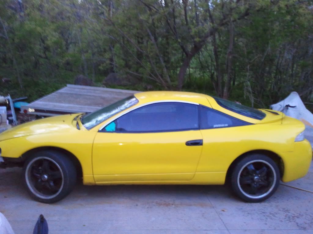

NEXT A DISASSEMBLY OF BOTH CARS(TALON ESI AND ECLIPSE RS) BEGAN, BOTH ENGINES WERE PULLED, THE ECLIPSES IS LEFT TOGETHER BUT THE TALONS TOTALLY DISASEMBLED FOR REBUILD

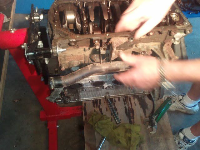

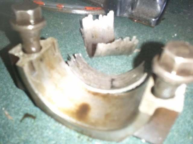

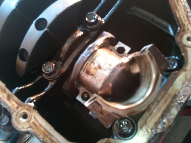

THEN I GOT TOO THE BAD BEARING

PROOF OF PAINT BEING SUPER SHITTY!! PEELS OFF!! LIKE VINYL
FEEL FREE TO LET ME KNOW WHAT IS WRONG WITH THAT PAINT IF YOU KNOW!!

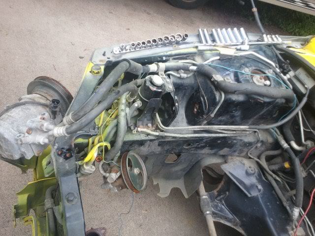

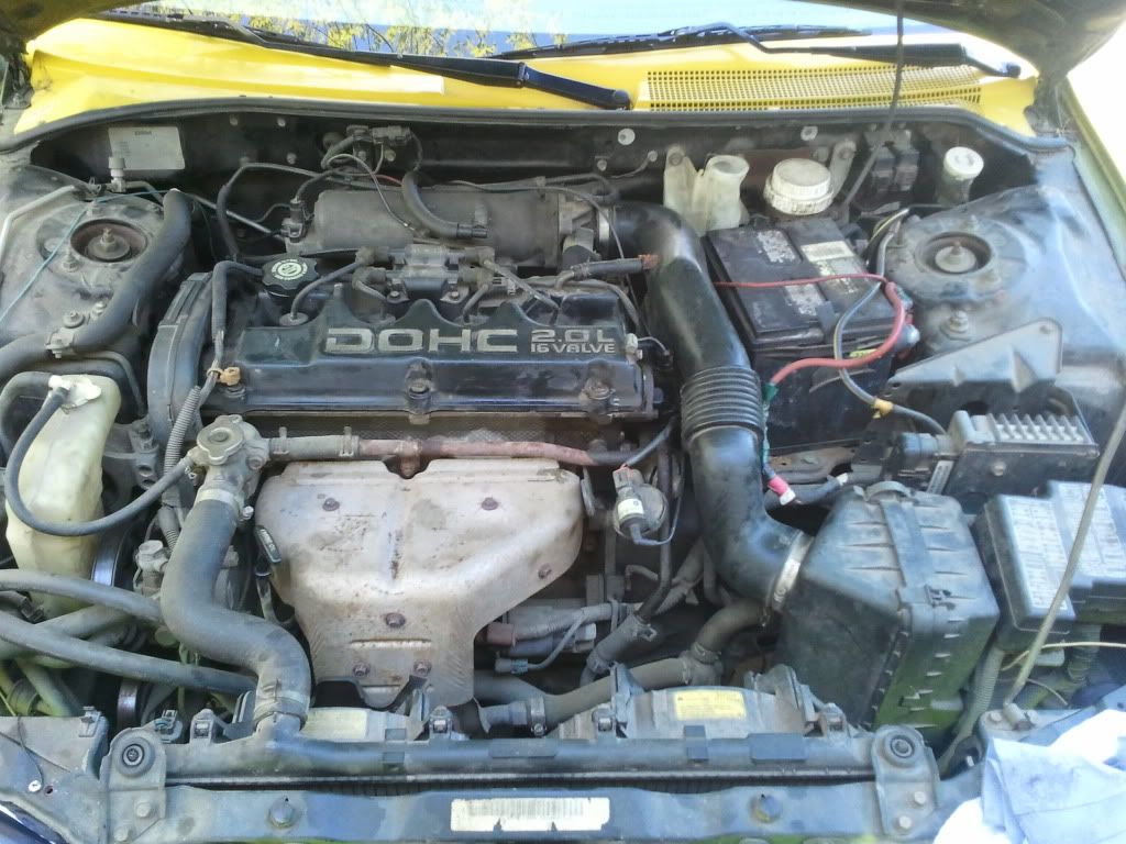

A/C REMOVAL
GUTTED BAY

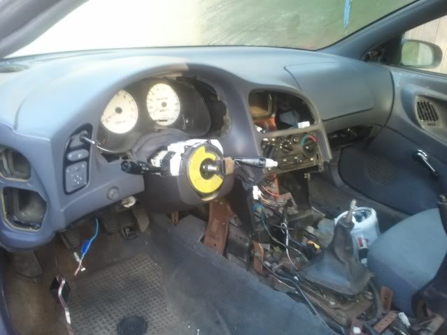

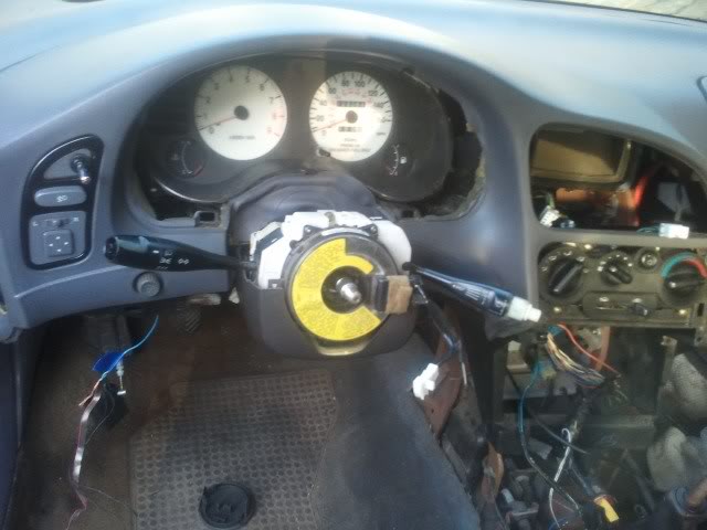

UP NEXT WAS BACK TO THE ECLIPSE SINCE THE DASH IN IT WAS PERFECT AN THE TALONS WAS CRACKED, TIME FOR REMOVAL!

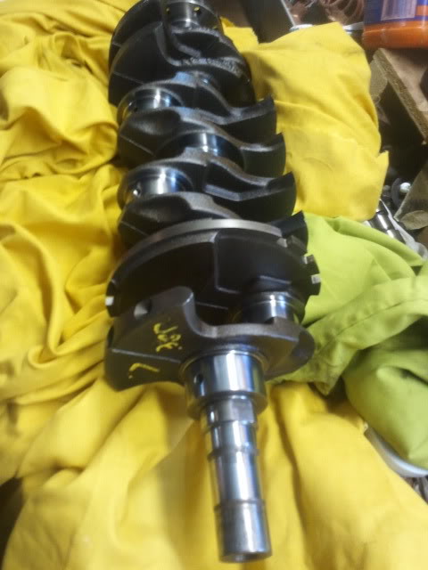

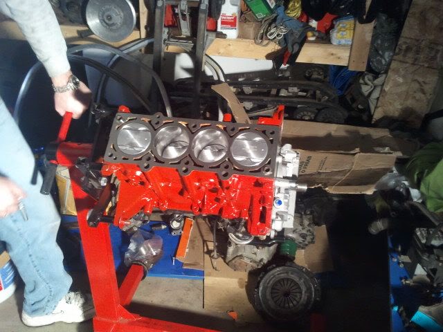

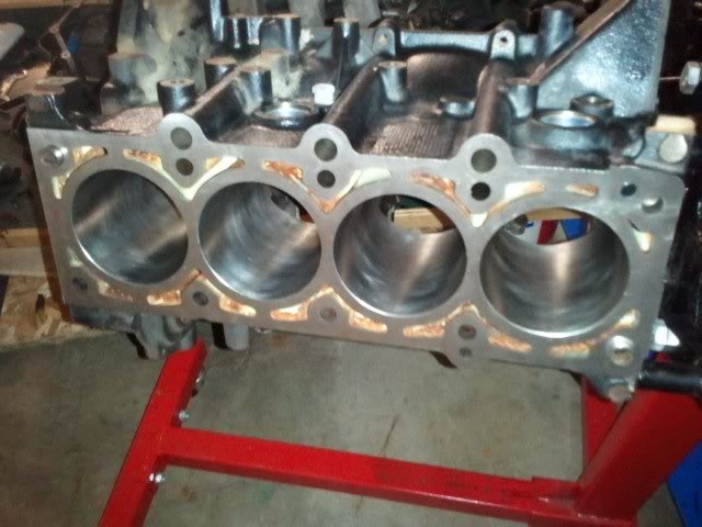

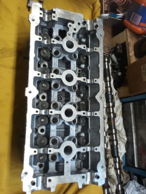

I HAD PREVIOUSLY BROUGHT THE ENTIRE DISASSEMBLED ENGINE TO THE MACHINE SHOP TO BE HONED BORED .30 OVER AN CLEANED, ALSO REBUILT HEAD
SPEED PRO PISTONS
EAGLE RODS 1G
NEW CRANK!!
AN REBUILT HEAD!!

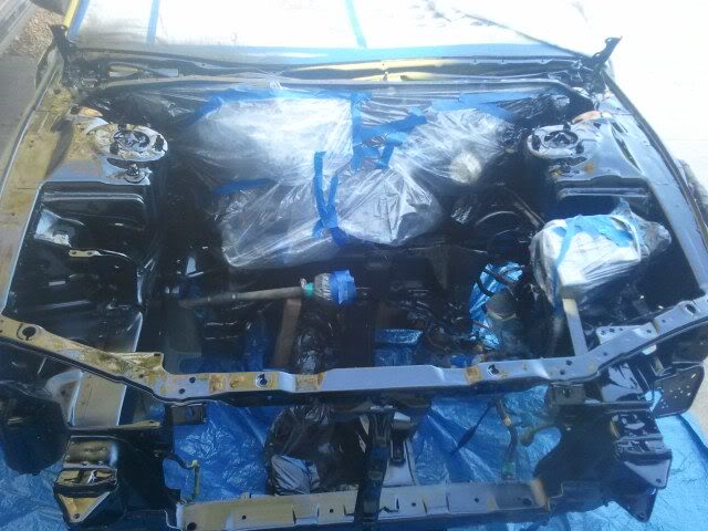

NEXT IT WAS TIME FOR SOME FAB WORK, THE RADIATOR CROSS MEMBER WAS DAMAGED FROM PREVIOUS OVER CRASH(JUST BENT UP, ALSO THE HOODLATCH WAS WELDED TO IT) SO IT WAS TIME TO REPLACE IT, DRILLED OUT THE TAC WELDS ON BOTH AN THEN PUT THE ECLIPSE CROSS MEMBER TO THE TALON AN WELDED IT ON
BEFORE
BETWEEN
AFTER

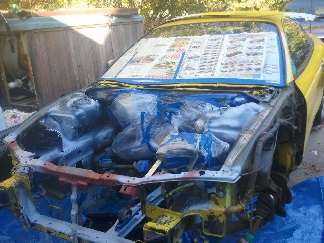

ALSO TAPED UP AN PRIMED ABOUT TO REPAINT THE BAY
PAINTED!
FIRST TIME WITH A PAINT GUN, TURNED OUT GREAT!!
SUPER HIGH GLOSS, PICS WERE TAKEN THE DAY AFTER WHEN DRY

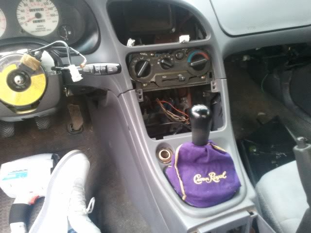

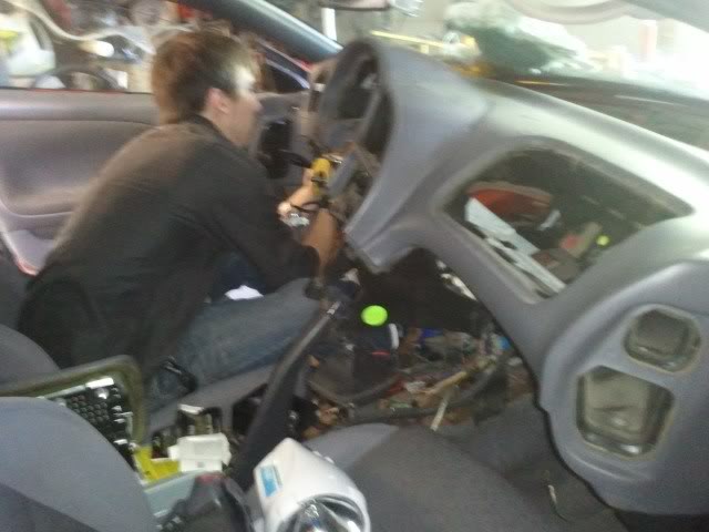

NEXT IT WAS TIME TO REMOVE THE TALON DASH
NEW DASH IS IN AND MY CROWN ROYAL SHIFT BOOT!

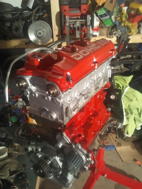

BACK TO ENGINE, PAINTED BLOCK, PARTIALLY ASSEMBLED. NEW WATER AND OIL PUMP
FULLY OR ATLEAST ALMOST FULLY ASSEMBLE ENGINE ALMOST COMPLETE AN ALL PAINTED!!

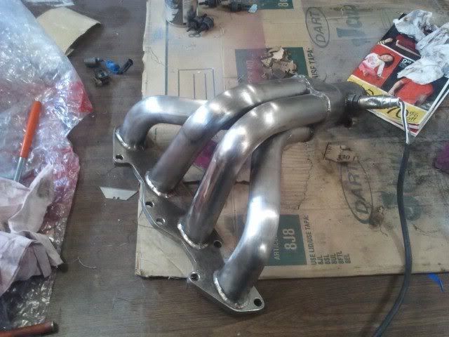

HEADER IS STAINLESS STEEL, SANDED DOWN AN READY FOR A BUFF.

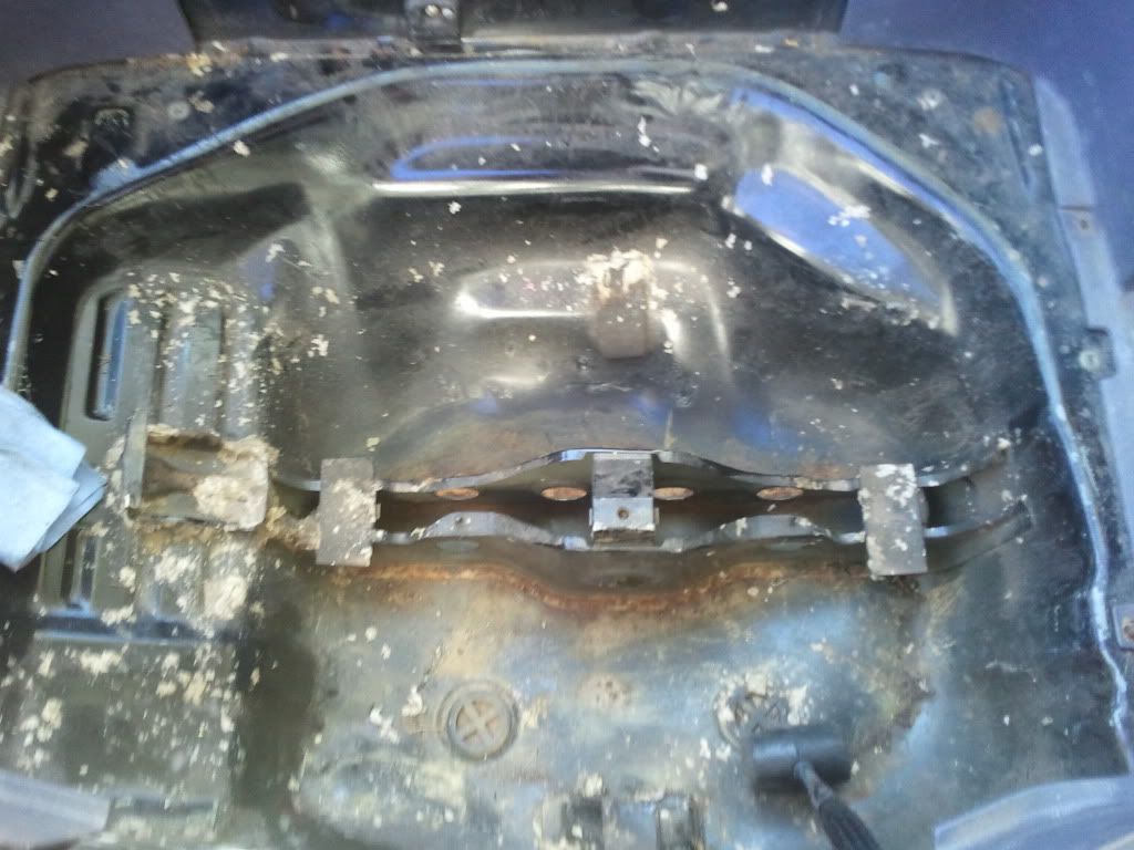

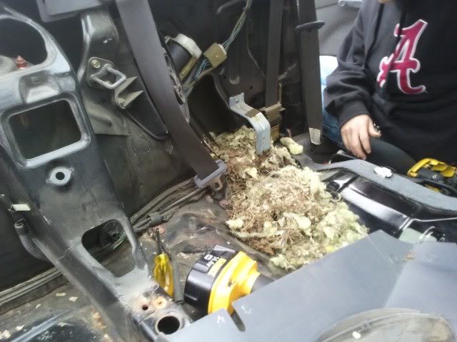

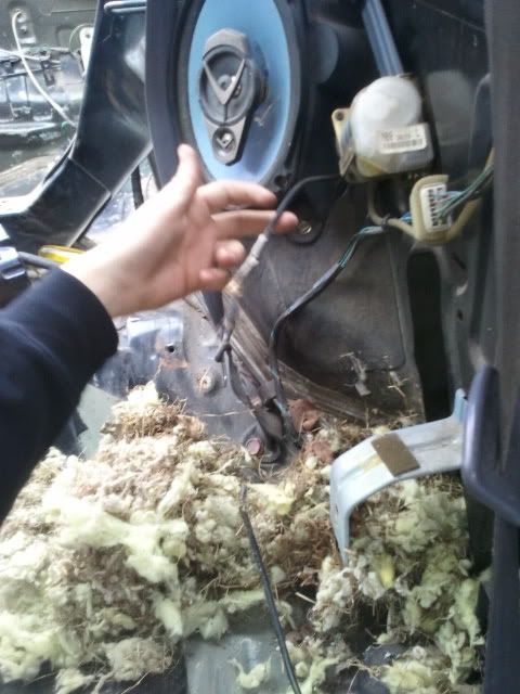

BACK TO THE INTERIOR, WAS FINISHING UP TAKING OUT ALL THE PLASTICS IN THE BACK SEAT AREA DRIVERS SIDE WITH I DISCOVERED A GIANT ANIMAL DEN BEHIND THE PLASTICS!!!
EVEN CHEWED THROUGH THE SPEAKER WIRE, I WAS WONDERING WHY MY BRAND NEW SPEAKERS WERENT WORKING ON THAT SIDE...

The paint is peeling because the surface was con taminated dirt grime clear coat still underneath even the oil on your hands can make the paint not stick and become like a sticker.
