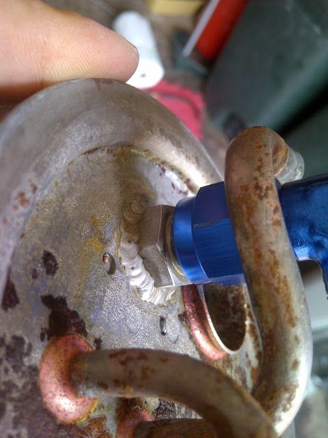

On another note, I locally found a complete Nylon Fuel Line setup with a sending unit that had a AN fitting already welded on. Got lucky for once in my life :)

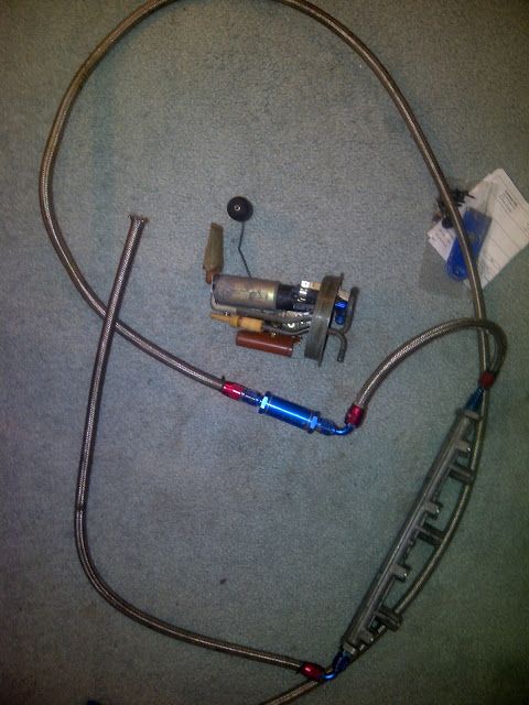

Got really lucky today A guy locally was selling a complete sending unit to fuel rail kit for ONLY 100$! I got the sending unit in amazing condition with a -6AN fitting bolted on, SS braided line for sending unit to Fuel rail including all the AN fittings I need, Earls 10 Micron in-line fuel filter, and a 1G fuel rail. Talk about luck.
Here are some pics of the setup. I am not to sure if I like where the AN fitting is on the fuel sending unit. It is bolted on and their is JB weld on top to block out any fumes which im sure is fine but, the AN fitting looks to close to the oem lines. Also the 90* elbow should be facing the other way and should go over the oem lines.

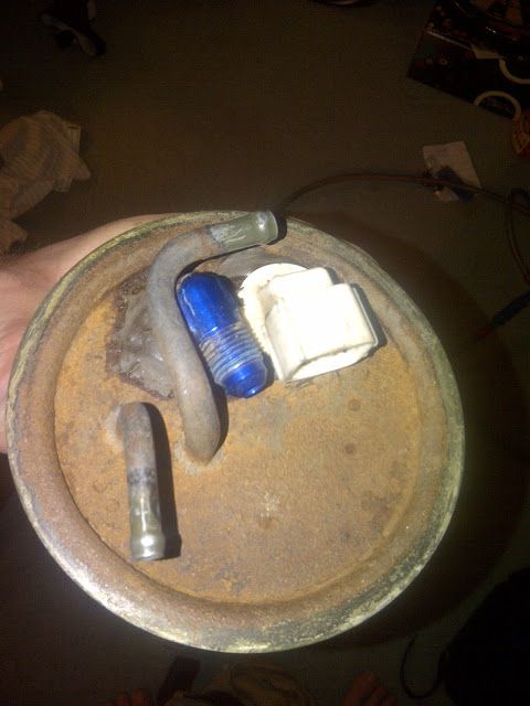

I took this Friday off to make it a 4 day weekend and I will be installing the new fuel system. Only thing that sucks is that the Fuel sending unit I bought last week wont work for various reasons so I will just be modifying the existing unit in the car. I will try to take a bunch of photos before and after the install.

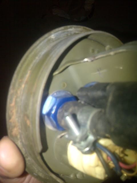

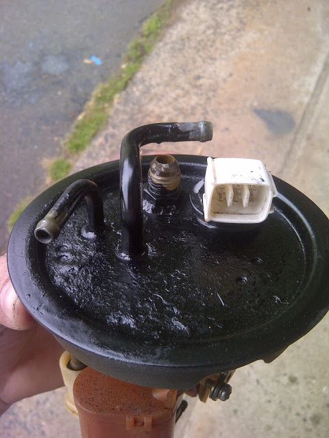

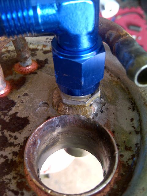

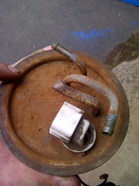

Over the weekend I worked on the new fuel setup. So far I cleaned up all the rust on the sending unit and TIG welded on a SS -6 AN fitting on the top. I also got the -6AN Fuel lines from the fuel rail to the sending unit all hooked up.
Only issue I ran into was that the old pump was completely different than the new 255hp Walbro and the pigtail connectors where different. I just ordered a brand new pigtail connector from Extreme PSI along with the Walbro Install kit since the one I bought never came with it :ohdamn:. It should be arriving tomorrow hopefully.

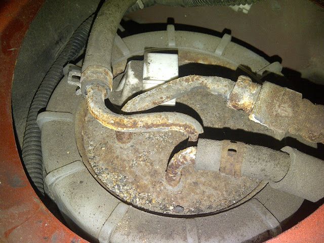

Here are some pics of the process. I forgot to take pics underneath the car where I mounted the Lines but I will try to snap some pics tonight.

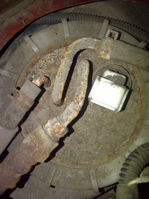

Here is what it looked like before touching anything.

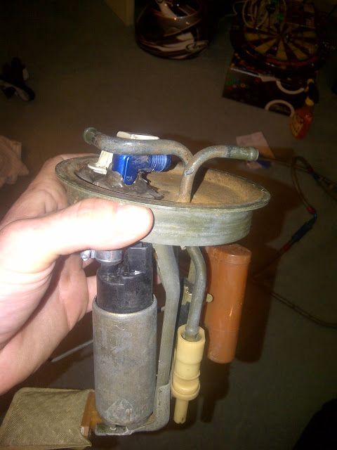

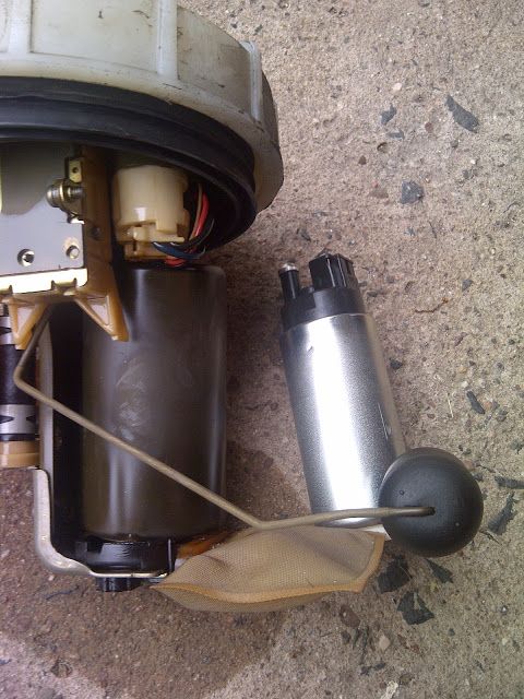

Old pump on the left, new pump on the right. previous owner said that the fuel pump on the left is a 10 year old Walbro 255hp but I couldnt find the model number.
rust cleaned up and Fitting welded on
Painted

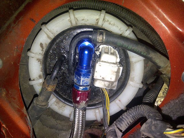

All done except I had to pull everything apart again :/. All those scratched on the fitting are because I bought the line used. Don't judge me LOL

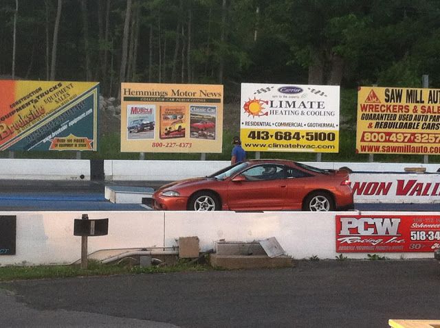

I got out to Lebanon Valley Dragway yesterday to see what times I could pull off. My best time was 12.8 @105mph and a 1.753 60ft and this was on hankook all season street tires. I think I could definitely go into the mid 12's on street tires once I activate NLTS. I was losing a massive amount of time shifting, more than any other car I have ever driven.

And a quick pic of the car :)
