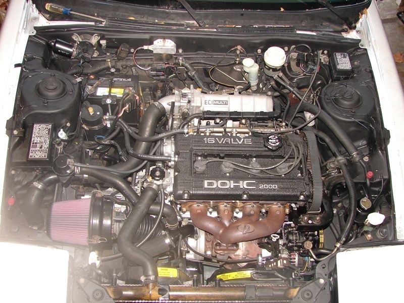

I Bought a 90 gst off of craigslist for cheap. Timing belt snapped on previous owner, so I rebuilt it.
Cleaned the hell out of the engine bay and painted it flat black
6 bolt block bored 20 over
Stock rebuilt head, 3g lifters.
1g rods
20 over 2g NPR pistons
Cometic head gasket, and ARP head studs
New T belt, tensioner and Pulleys
ACl rod and main bearings
14b turbo
FP manifold
90 eprom socketed ecu.
stock exhaust, no cat
K&N filter.
Custom Mini throttle cable.
Lawn tractor battery, and custom battery holder.
Custom catch can set up.
Fox body mustang sway bar end link bushings in my radiator support brackets.
Runs like a champ and I am very Happy.:D

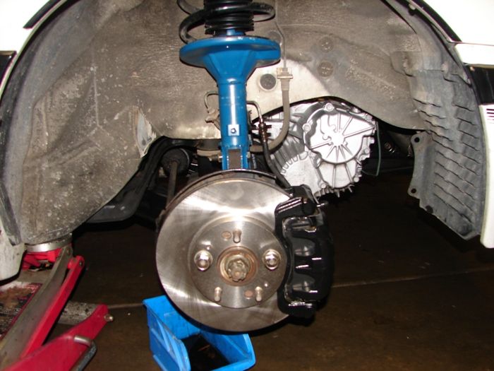

Since my car is 21 years old and most of the front suspension is shot, I decided to start replacing some parts.
New front lower control arms, and bushings.
New sway bar end links.
New front struts and bump stops.
New front wheel bearings and seals.

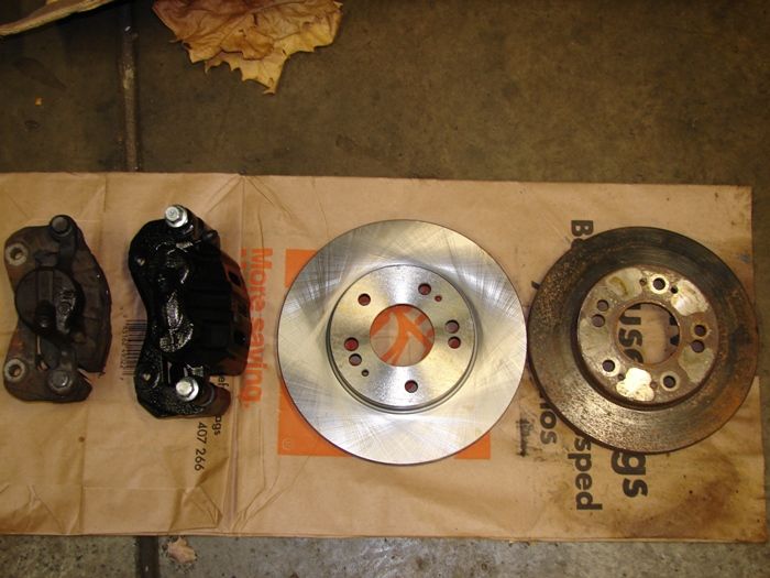

{Edit} Ordered me some rebuilt 93 GSX 2 piston brake rotors, calipers and pads
Also have V3 lite in the mail
All oem replacement parts. Should have some pics up soon but waiting on the parts, had to order it all nothing in stock at the parts stores.
Its been a while since I last updated. I finally got a lot of my parts in, and on the car. Couple pics of my new suspension and my new GSX brakes.

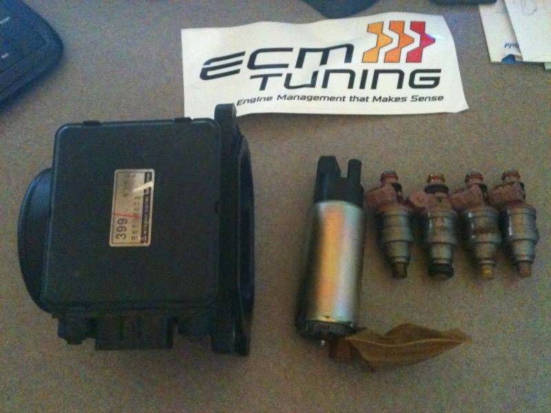

Got some new goodies going in soon.
ECMlink V3 lite
Innovative wide band
EVO 9 Fuel pump
EVO 550 injectors
EVO MAF
After that my next plans are to get a SS downpipe and build up a 3 inch dump exhaust with a dynomax bullet muffler.:thumb:

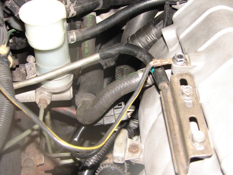

Been kind of slow going for me. I finally got Ecmlink V3 lite up and running in my car and had to fix a couple issues. 02 was bad, idle switch is bad and had some bad connectors on my Coolant temp sensor.

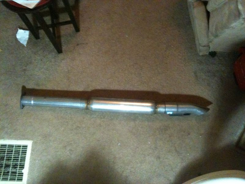

Dynomax bullet 3 inch
3 inch exhaust pipe and flange

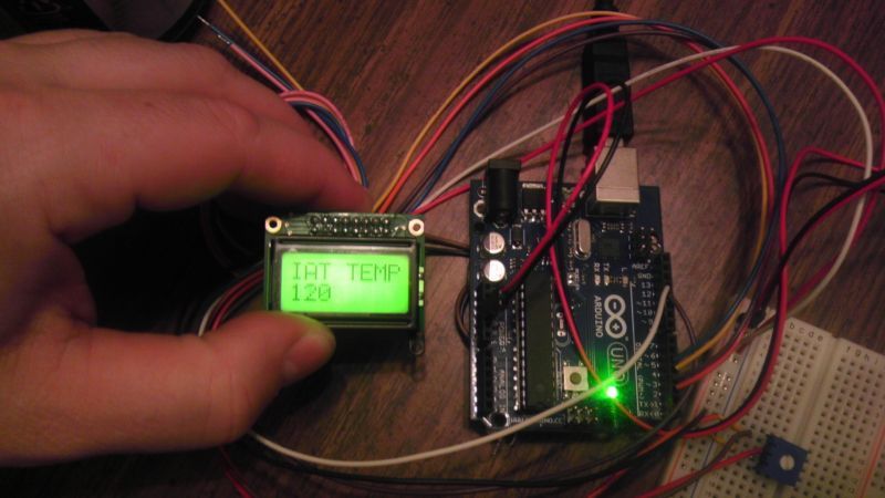

Also been working on a custom IAT

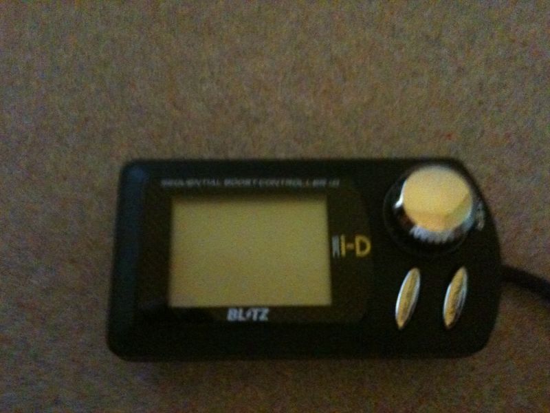

Blitz Boost Controller and Guage.

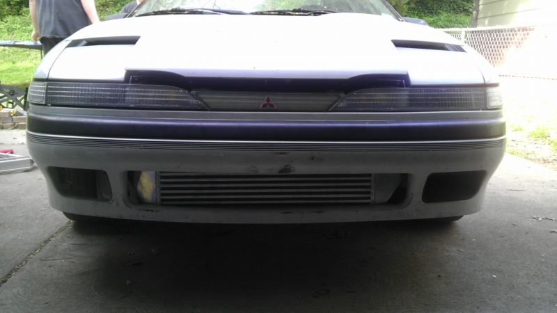

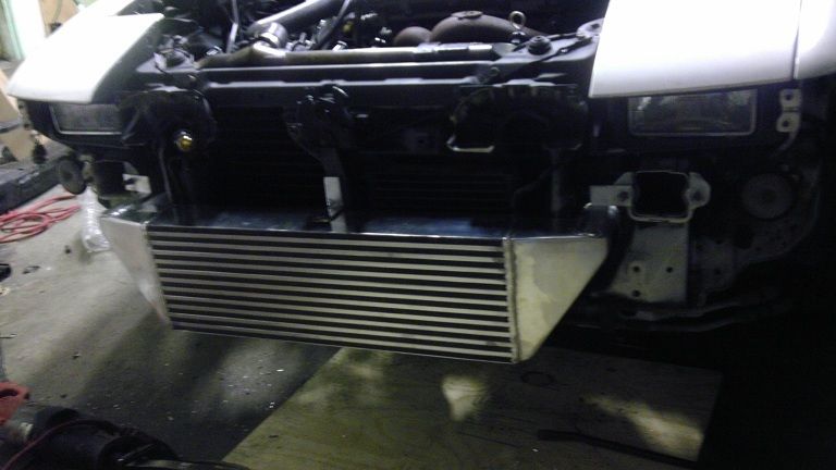

Finally got my VR-speed inter-cooler in and on, after a small back order. While taking the front bumper off I broke 4 bolts.:ohdamn: The kit is really nice for the price. The only bad part was the A/C lines had to be bent alot, and I had to take my power steering cooler off.

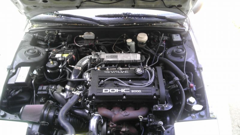

Got my VR front mount fully installed and the stock 1g bov flange welded on.
Disconnected my A/c due to inter-cooler fitment.
Removed A/c fan due to inter-cooler fitment.
Installed a PR 3 inch downpipe.
Aluminum E-bay j pipe.

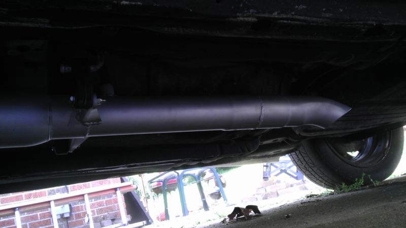

Welded up a custom 3 inch dump exhaust with bullet muffler.

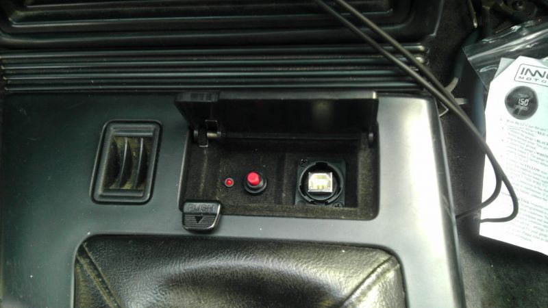

Custom Ecmlink V3 center console plug installed in pop up bin.

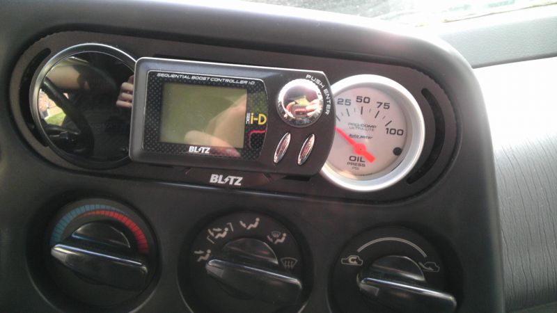

Blitz id boost controller , oil pressure and LC-1 guage installed in center vent.

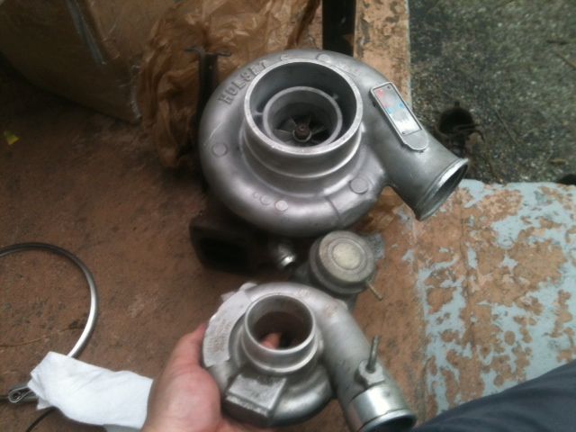

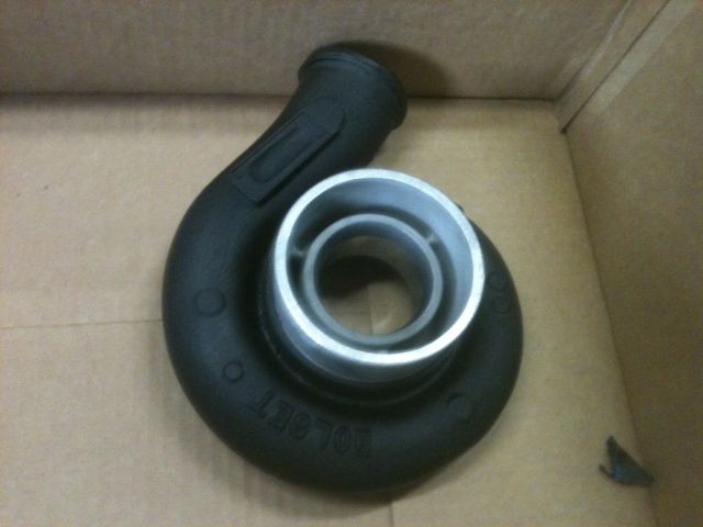

I picked up a big Holset H1C Saturday, has 54mmX83mm wheel. Havnt decided if I want to go t3 manifold or bep housing, with PR external wasetgate o2 housing.Here it is compared to a TD04 subaru turbo.
Ive been searching locally for a back glass at a junk yard to no avail. So Im gonna bite the bullet and have a glass company come out and R&R the hatch glass.:notgood: I just want to drive this thing. In the mean time I have been working on rebuilding my holset H1C. I also polished the compressor inlet and gave it a coat of wrinkle black.
