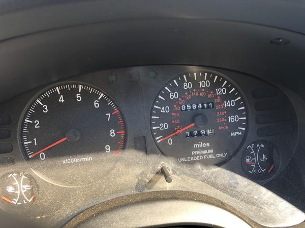

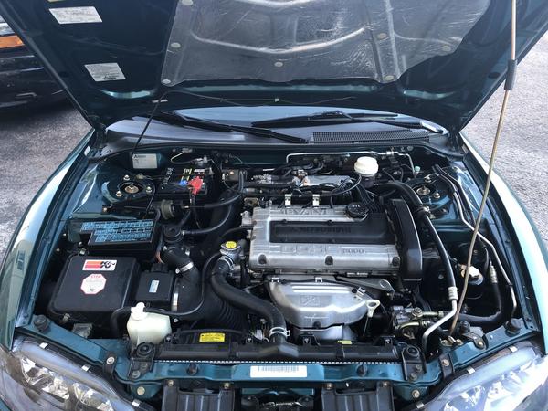

These are some of the pictures he sent me to show the shape. We agreed on the price after about forty pictures and a few videos and I flew out there to pick it up. He met me at the airport and it was exactly as described which made me very happy. I checked a few things and hit the road for a 14 hour non stop trip across the NM and Texas desert back to Houston. Car drove like a dream not one single problem on the way over. Gas mileage in these still sucks even stock at just a hair over 25mpg at 77mph.:
Seriously though have you ever seen an engine bay like that in the last ten years? Holy cow that thing is so much stocky goodness!

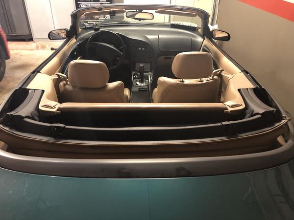

The car was almost in to good shape to even touch. I wanted to leave it as a time capsule. I probably should have. Buuuuuuuuuuuut that just isn't going to happen.

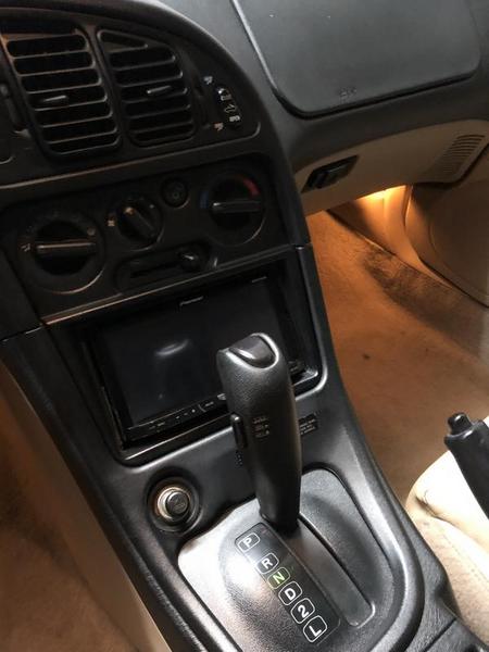

First order of business was to get rid of the 1999 aftermarket stereo they had put in there. It had an Aux Port and thank god for that on the drive back. I just put my Pioneer 4500BT double din in there and for now will retain the factor amp and I believe infinity system.

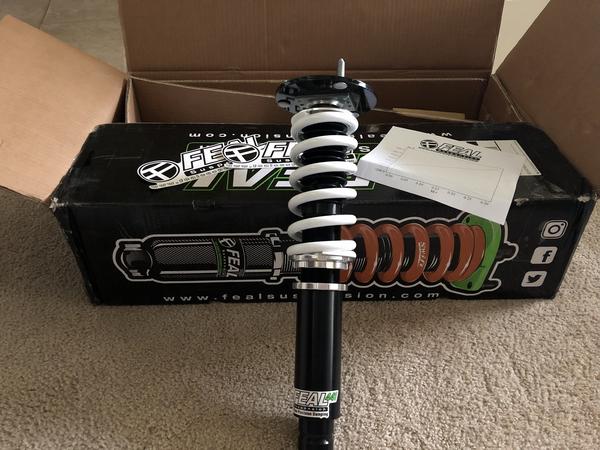

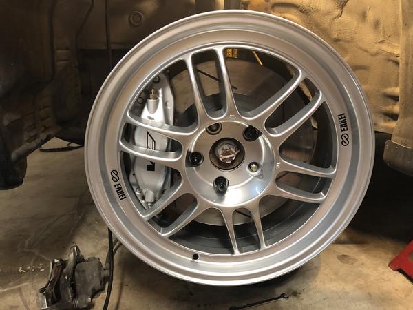

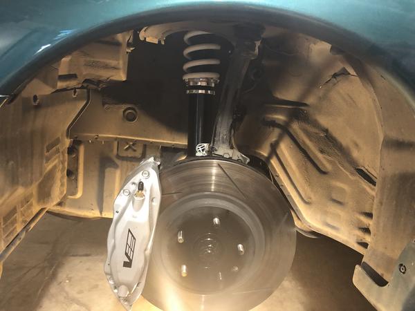

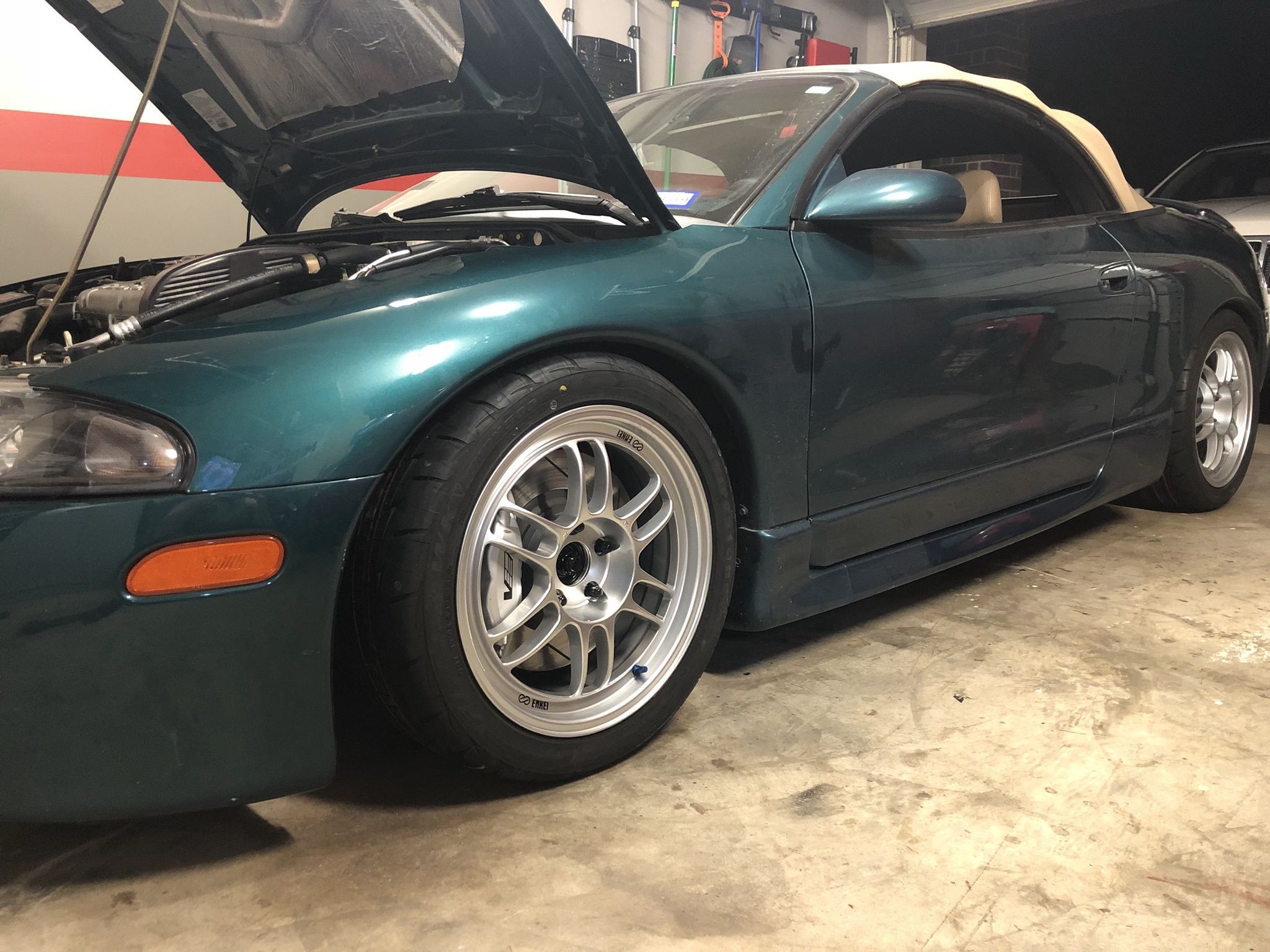

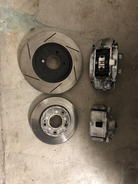

Second thing this time around was suspension and brakes BEFORE power. I wasn't going to cheap out either. I knew exactly what I wanted and went ahead and ordered it. FIC 441s 10k/6k with CTSV brakes. These brakes are huge on this car. Stop on a dime now!. I will be ordering rear evo calipers and putting on a 3g brake booster in the near future to compliment these fronts. I will probably have the rear evos PC'd silver to match these fronts. Also went ahead and put on some RPF1's that I got for a screaming deal.
These brakes did need a little grinding to clear the wheels. They don't leave much room at all.

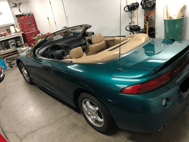

Money shot. I need to wash it but it has rained every single day in Houston since I brought her home. Hopefully a quick wash tomorrow. The P/O waxed it for me the day before I landed and did a decent enough job (taped off) but the car will need paint correction at some point to knock some swirls out.

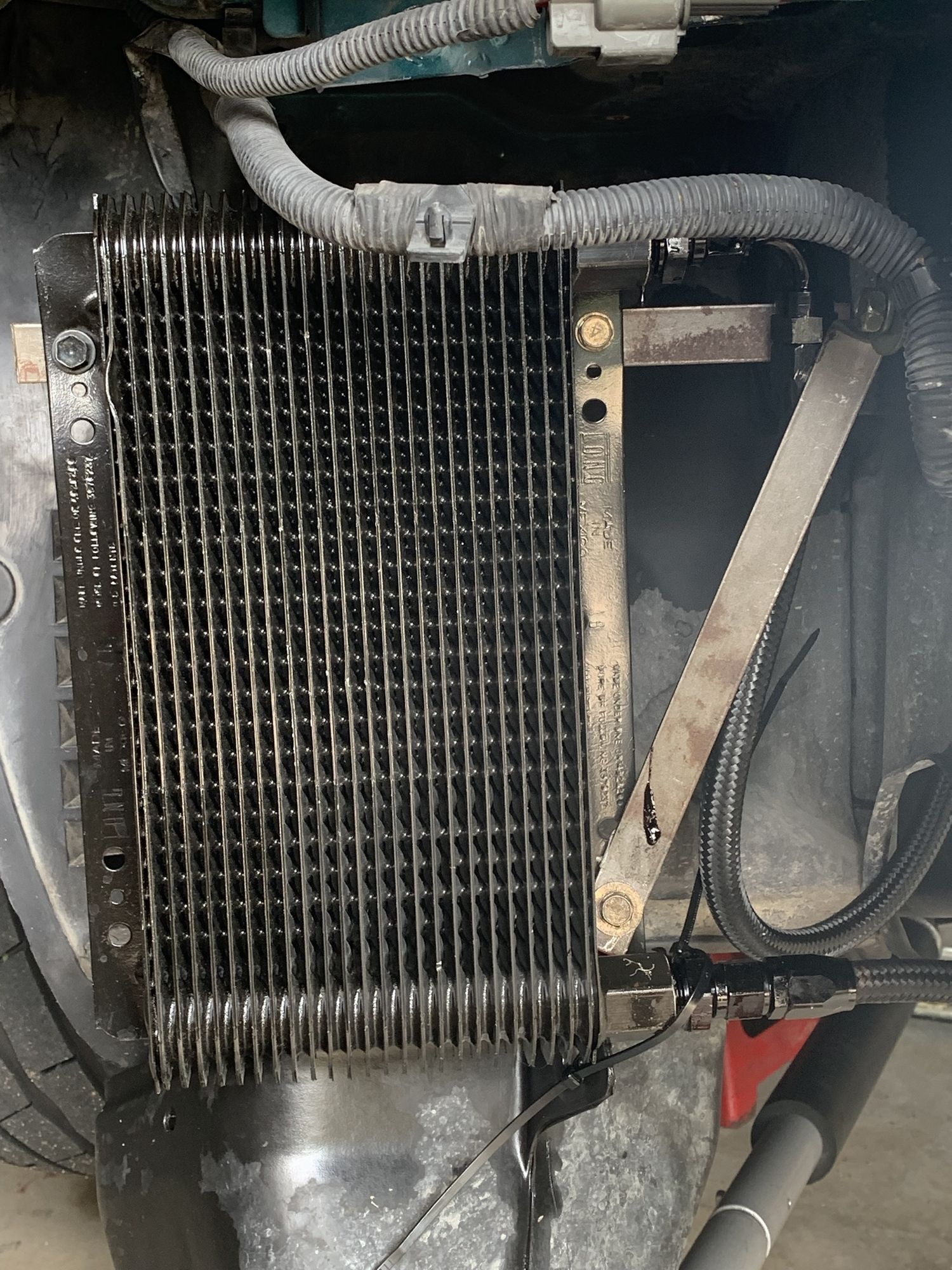

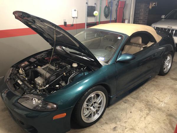

I decided to address cooling next for general longevity. Swapped in oil and trans coolers and mounted them up on either side of the stock fog lights. Added an ETS intercooler as well. Fabbed up some simple mounting brackets. Not really proud of them, but as of four years later they are still holding up excellent and you can't really see them anyway.
Made some new ducting out of thin aluminum to seal the intercooler to the radiator. I'm still running stock fans with an "upgraded" N/A fan for higher CFM on the A/C side.

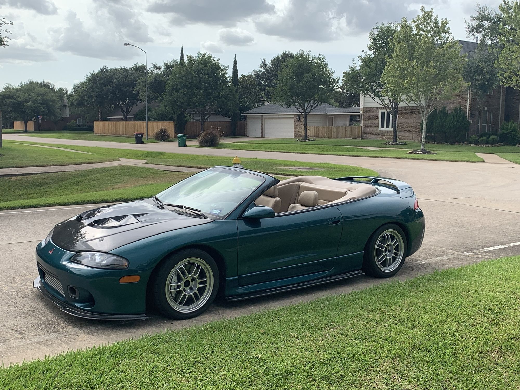

Decided i wanted some ground effects from Carbonetics. Got a front bumper splitter, side skirt extensions, and v2 hood with the waffle weave CF. Good products and happy with the quality of them. I eventually decided these just weren't for me and sold them off. But this is how it sat for awhile.

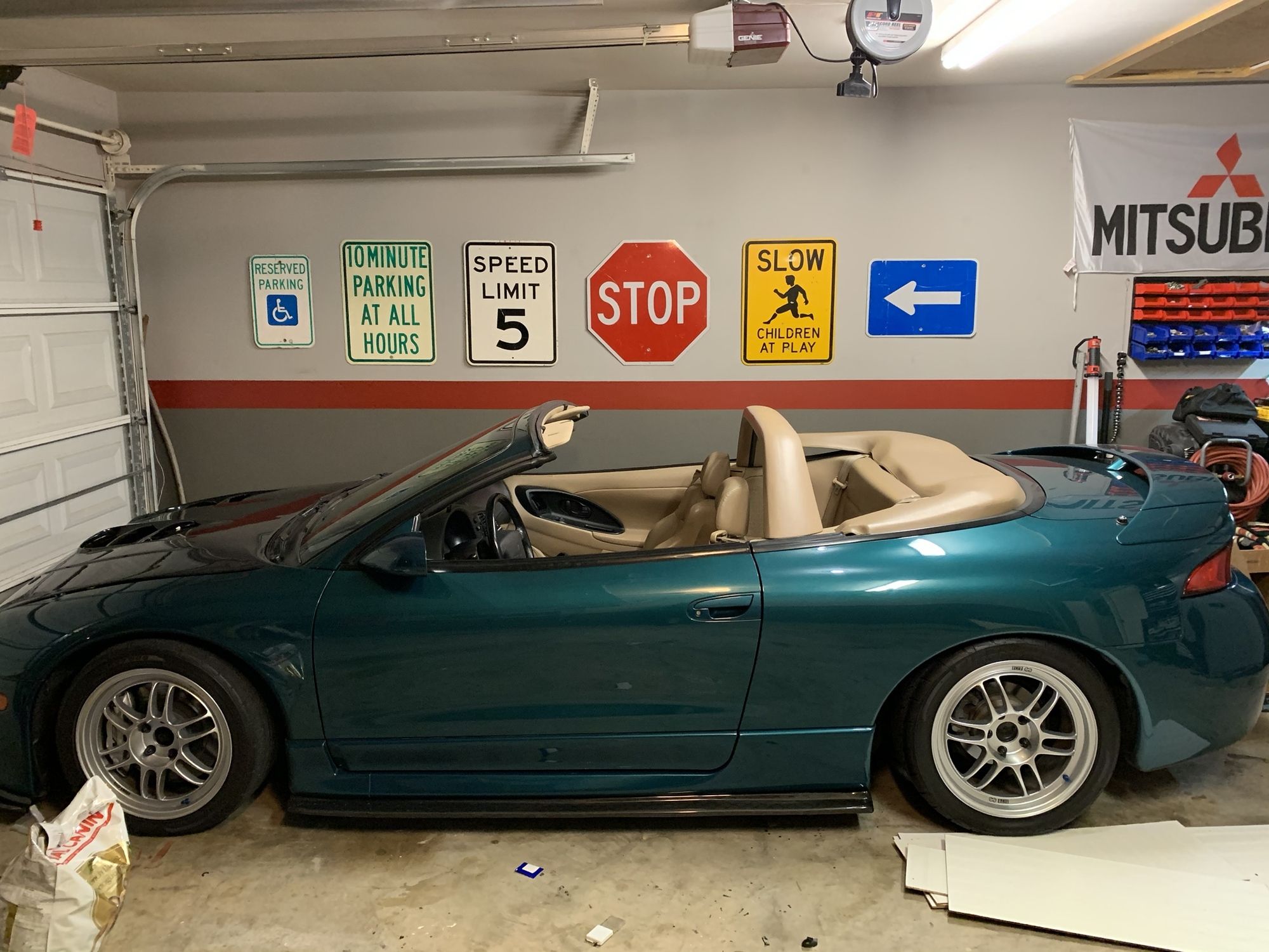

Added rear MachV sway bar, but due to it being a GST, I wanted a stiffer front far than stock, but didn't want to run the MachV as I feel its too stiff. I settled for a ST front bar. Really happy with that setup. Also added Bobby's (@ec17pse) billet bushing brackets. I added his front reinforcement bar too, which i only had for a few months before a boulder in the highway ruined it. But it saved my car so it did its job and i appreciate that.
Decided the Apexi N1 exhaust was too drony for a convertible. Made a call to my buddy at TwoStepPerformance.com and told him I wanted an Apexi WS2 and I wanted it brand new. He struggled to source one but finally found the last one. From what we were told, Apexi will no longer be making any exhaust for the 2g GST any we believe this is the last one sold. Twostepperformance has really stepped up for me during this pandemic and sourced some hard to find stuff.
Last day with the carbon fiber accessories. I enjoyed them, but its was time to move on. I was going away from my initial goals for the car and I knew it. I lost a lot of the pictures of it, but the tan cloth top was also replaced around this time. I did it myself and felt it was fairly easy. I think it took me about four hours total.

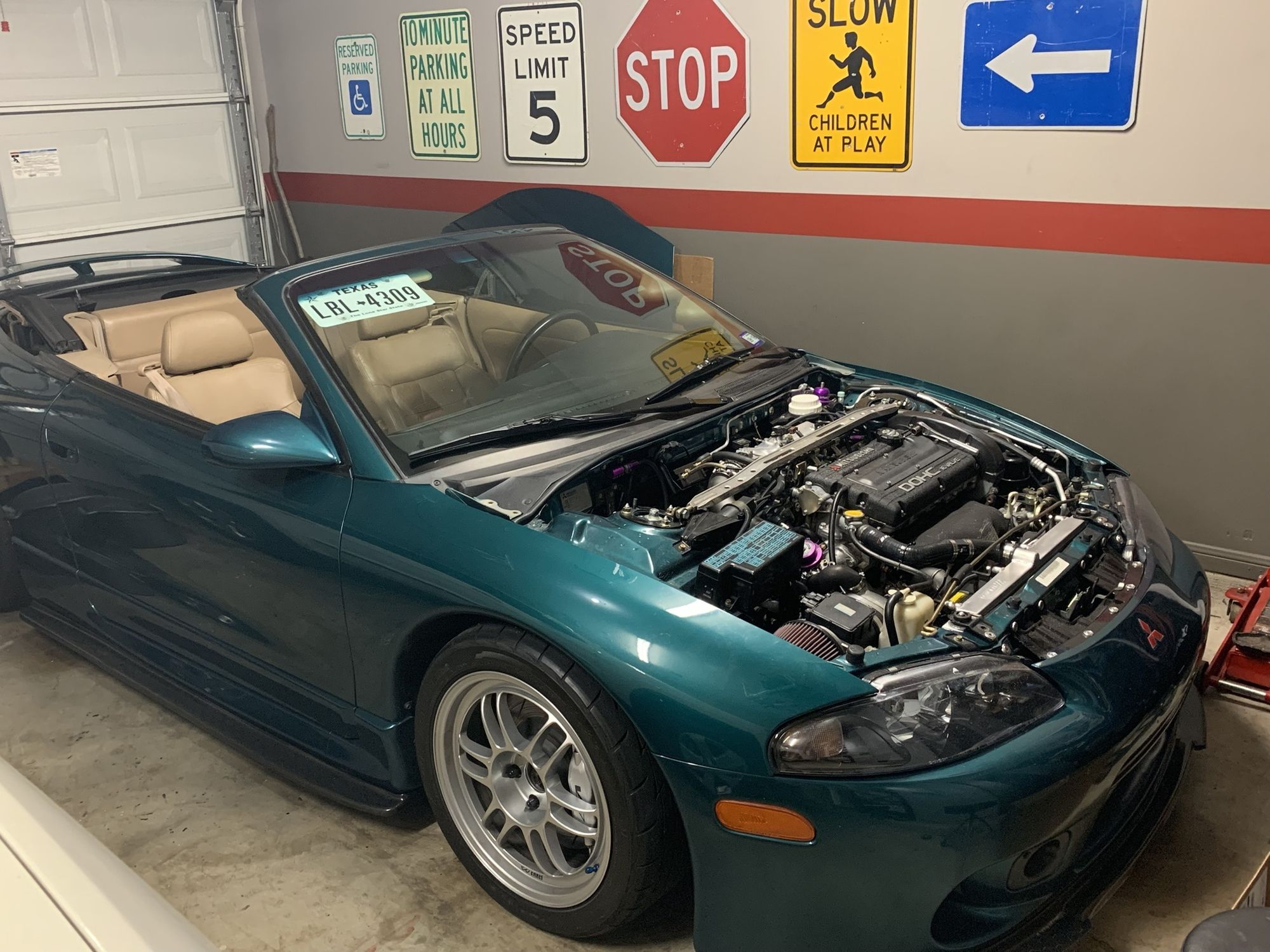

Hated how my FPR sat so I redid all of that.

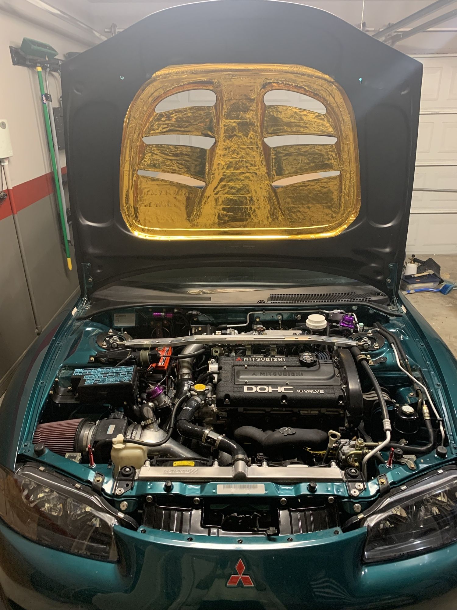

Engine bay getting how I wanted it. Got the valve cover done up in purple. Its a shade off and I'll have to get it redone over winter at some point.

Now that Buschar is back under proper management I trusted work would get done as I wanted it. I wanted stainless IC piping and stainless intake pipe. I also wanted the car dyno tuned. Knock it all off. Some of you may have seen Mike post about the car when it was up on the hoist. I can't be more excited about how good the underside of this car is. I have toyed with the idea of having it dry ice blasted, but as it stands this is how the car is with no cleaning at 22 years of age.
New piping done and installed. Switched up to a Tial BOV. External. Also went with SD tune.

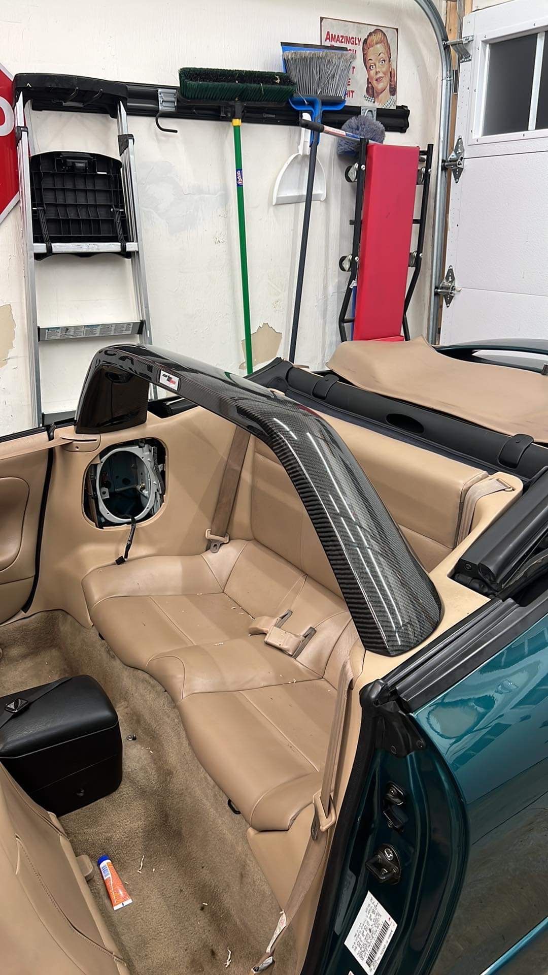

Took the lightbar off. Sent it to Sergio to hopefully have it molded for CF. I hope he comes through I really wanted to take the risk of sending it off for the greater community as they are almost impossible to find for Spyder guys. I hope I don't regret this.
