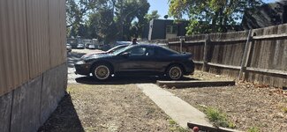

I just recently bought a 1995 Mitsubishi Eclipse RS 420A with a 5 speed manual but it started to not start after being driven gently. I've checked all vacuum lines and replaced them, I replaced the MAF sensor spark plugs and the coil and I can't figure this out.
