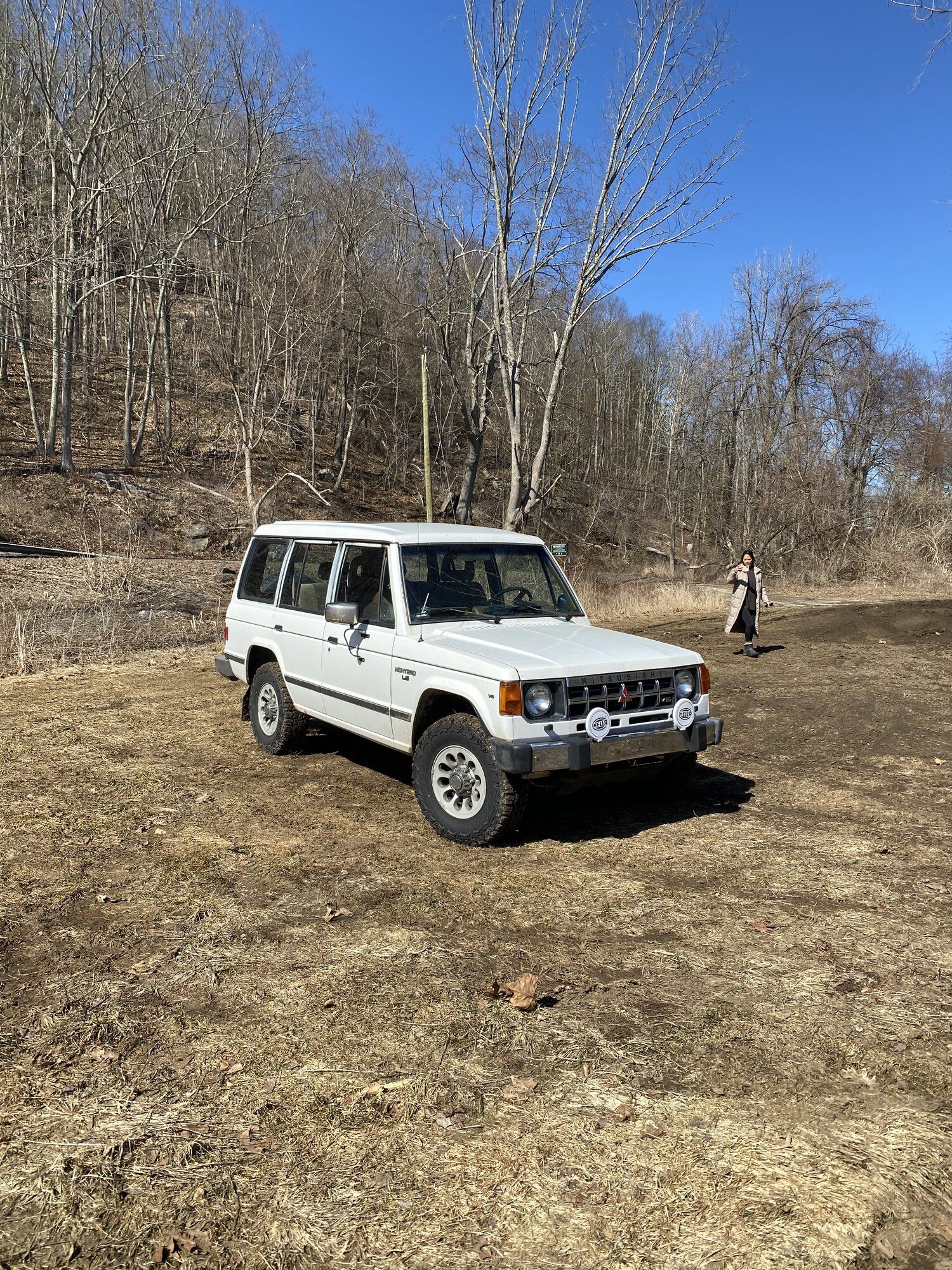

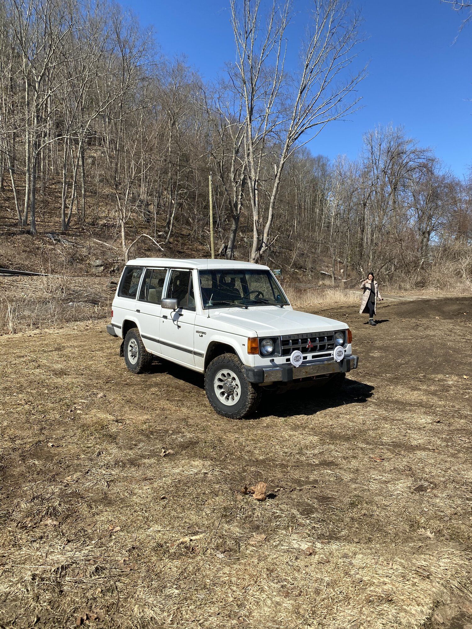

1990 MITSUBISHI MONTERO
I could use your advice.
I have a ‘90 Montero 4x4 that blew a head gasket in early January (a month after buying it), diagnosed by shop due to overheating, stalling, and coolant pouring out the bottom of the engine bay when running.
