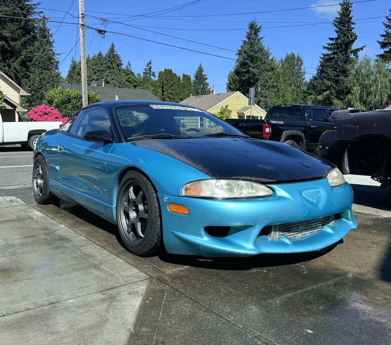

Jade Pearl 1997 Eagle Talon TSi AWD, two of 24 produced. Tastefully modified and built to be driven. The focus is on performance, reliability, and enjoying the car on the street. Long list of mods—still with a stock trans/xfer case; this could get ugly.
1997 Eagle Talon TSi AWD | Jade Pearl #2 | Street Build
Ownership Status
Currently Own
Year
1997
Model/Trim
Eagle Talon TSi AWD
Turbo Type
16g
Drivetrain
AWD
Transmission Type
Manual
Build Type
  1. Street
Mods-Bolt-on
V1 68HTA Ported by @pwee05 (Greg Byers)
FPRace Exhaust Manifold
Hotside ceramic coated by Detective Coating
JMFab Recirculated 02Housing
Apexi Full Downpipe and Catback
Forced Performance 4 inch "Mongoloid" intake
Punishment Racing "budget" FMIC kit
Deatschwerks 340 lph Fuel pump w/ STM Rewire
FIC Bluemax 1250 injectors
Mods-Engine
Comp Cam "272" Intake and Exhaust
Stock Valvetrain
4g64 2.4l engine block
Wiseco 9:1 Hypereutectic Pistons
Eagle H-beam rods
Stock 2.4 crank
Best Western Swapped by the best "Pit Crew" ever
Mods-EMS & Logging
EcmLink V3 w/ Speed Density
Zeitronix Zt-2 with LCD display
STACK instruments 30 PSI Boost gauge
Mods-Drivetrain
BW swapped "Mystery clutch disk"
Fidanza 3.2 pressure plate
ACT Streetlite Flywheel
Stock Trans and Xfer-case
Swapped rear LSD unit
Mods-Handling
Magnus Motorsports Tubular rear subframe w/ RM DSM swaybar, Whiteline HD endlinks
BlackGST front aluminum subframe bushings w/ RM DSM swaybar
Poly bushing everywhere else up front
Compworks Fender Braces
BCRacing BR+ Type coilovers
SSR Type C 17x8.5 wheels
Evo Brembo swap front and rear
Adams Rotors Drilled/slotted Evo discs
Evo Steering wheel
Parts Wishlist
Port and polished head
TMZ built Trans & Xfercase
DSS driveshaft
Background
Northwest-owned 1997 Eagle Talon TSi AWD in Jade Pearl, two of 24 produced. Acquired from a friend and longtime DSM enthusiast who entrusted me to carry the torch. Its previous build thread is documented here on DSMtuners, and I plan to continue its legacy as a thoughtfully modified and well-documented street build. The focus will be on continued maintenance, refinement, and reliability while preserving the character that made the car special. After sitting for many years, the task of bringing it back to life has now begun. Documented through @drivenbyboss and BOSS Innovations.
