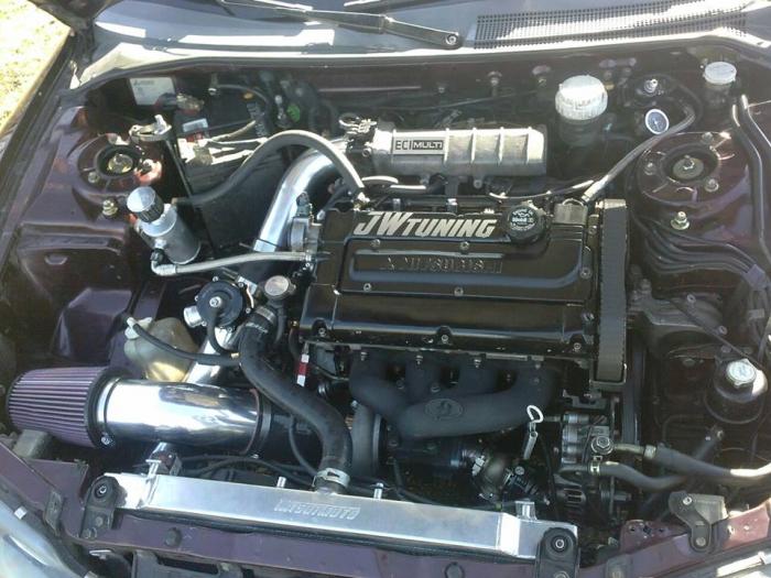

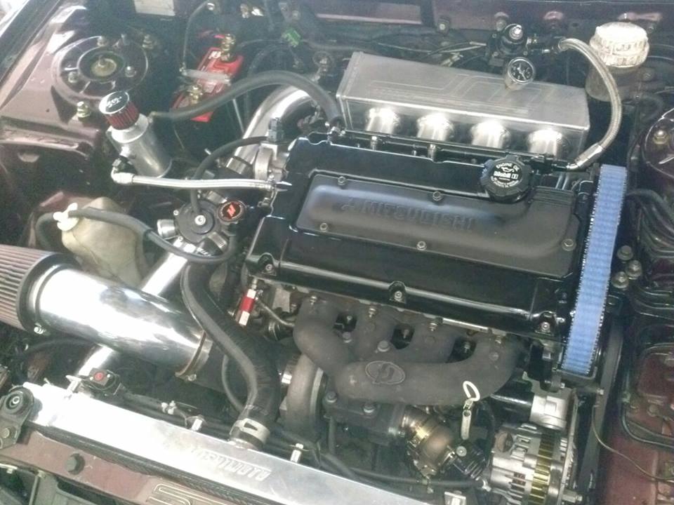

Just a couple recent pictures I took while out on the first drive with new setup.

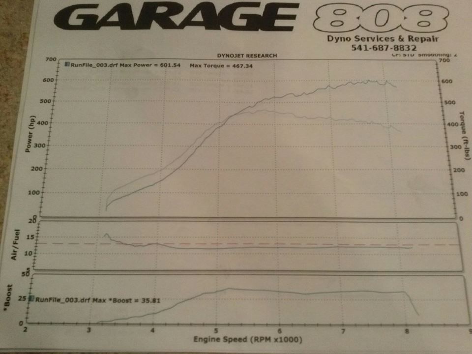

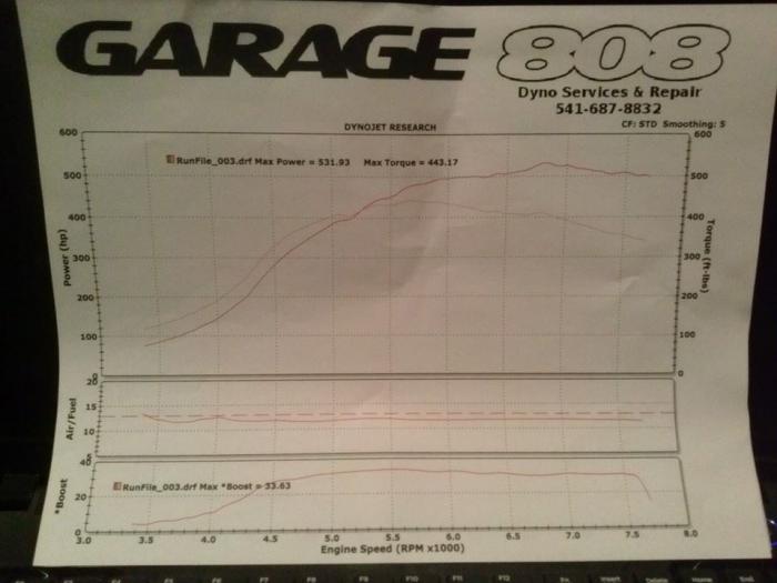

Dyno results are in!! Made 587/410 on a DYNOcom Dyno ( they tend to read a little higher than Dyno Jets ). Im gonna put it on a Dyno Jet soon to get some more accurate numbers. Tuned it at 35psi on E85 for this dyno session. Time for new Head studs also.. the standard ARPs are not happy at 35 psi, head is lifting and pushing coolant so the boost is gonna come down a bit for my next Dyno session until I can get some L19 studs in.. [ame=http://www.youtube.com/watch?v=gc2QpQHSXc8]FP Black DSM @ 35 psi E85 587/410 tq - YouTube[/ame]
That makes me worried, I plan to have 30lb of boost with those studs. Seeing quite a bit of issues lately.
How much flow are you seeing? I wasnt having issues with standard arps at 66lb/min 36psi
according to link only about 58 lbs/min .. Fuel is about 240 lbs/hr on E85 . the head has been off a couple times in the past 30K miles, so the studs may be a bit stretched( last torqued to 100 ft/lbs) and probably time for a new head gasket and timing belt anyways.. I could maybe try re torqing them down, but in my opinion It would be better to just get some L19s to avoid future problems.

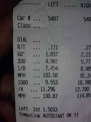

Well I Finally got the car to the track. Only got two good passes in, best was 11.29 @ 130.09, other was 11.31 @ 131.09. Only on all season street tires so I was having a little problem getting out of the hole fast. Best 60' I could cut was 1.82. So next step is getting some drag radial tires. Also have a JMF sheet metal intake manifold on the way so that should pick up some more top end.

Nothing to be ashamed of there. That is a great mph. Plenty of e.t. left to gain. Good luck! :thumb:
