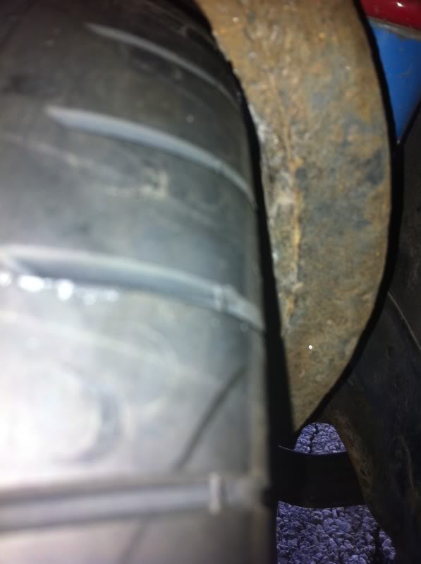

245/45/17 doesn't seem to fit very well...
So, added 3mm spacers and solved that problem

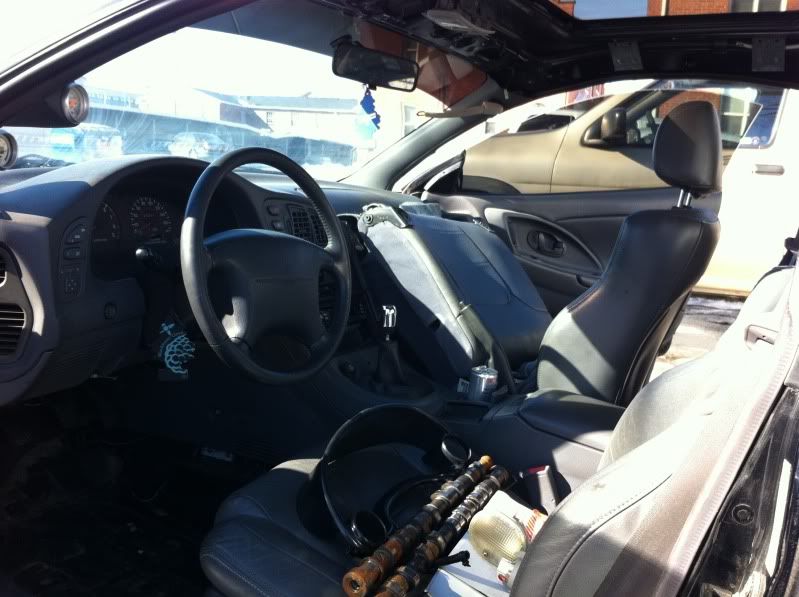

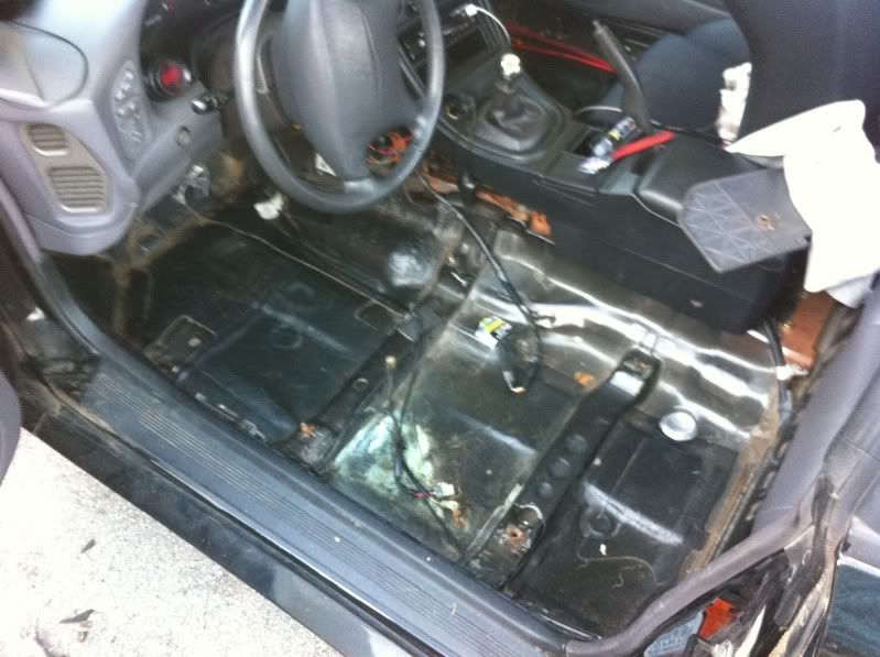

Just to give you an idea of the interior when I bought it...
I worked on getting interior back in the car by searching craiglist and found someone parting out a 2g talon so I went and got most of the interior parts I needed. The HID wiring was terrible as I said before so I cleaned that up. The front bumper was hanging on with very little tape so I just went ahead and took it off.
Now I made a few goals to be done on the car when I first started posting the build...let's see which ones I actually completed.

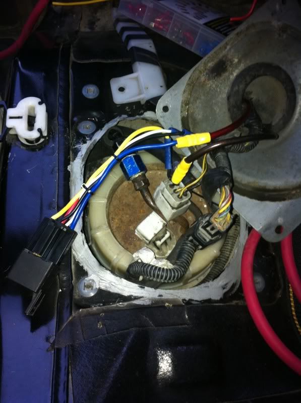

Fix gas leak (Can't fill above half a tank or it leaks) – Had to fix this, gas leaks are annoying and dangerous

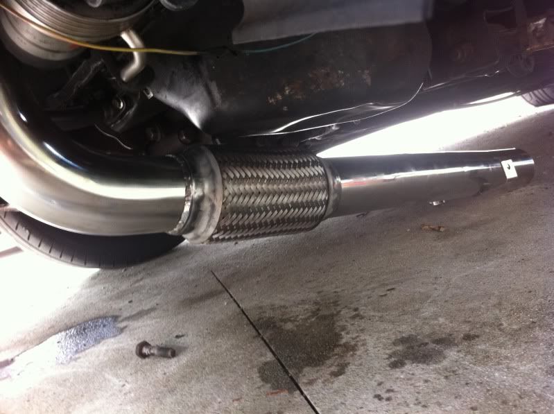

Get new downpipe – Finally done, the old one was crap
Do a custom catback like on my gst (I loovveedd the sound) – Actually did within a couple weeks. Basically take out the muffler and put two tips on to make it look like stock.

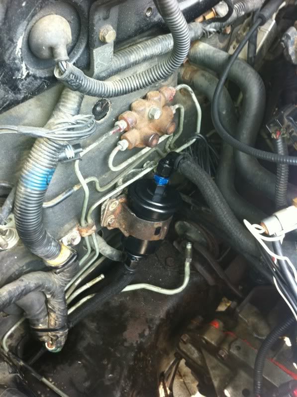

February 16, 2011 – FMIC and fuel replacements
Since the previous owner said that the E85 was bad in it, one of the first things I did was drain out the old E85 and replace all of the fuel lines. The car would barely run and I couldn't even think of going WOT without going lean, so I was hoping this would fix it.
Drained the e85, replaced all fuel lines with -6AN lines and replaced the fuel filter.
Put new e85 in and it runs much better, although something is still off. It goes waayyy too lean anywhere close to WOT, so either the fuel pump is dying, the fpr is messed up, or the leak directly in front of the wideband sensor is causing it to read lean...highly unlikely but I was hoping that this was the cause
There is also a leak somewhere that I need to find, I think it is the seal around the fuel sending unit but not sure.

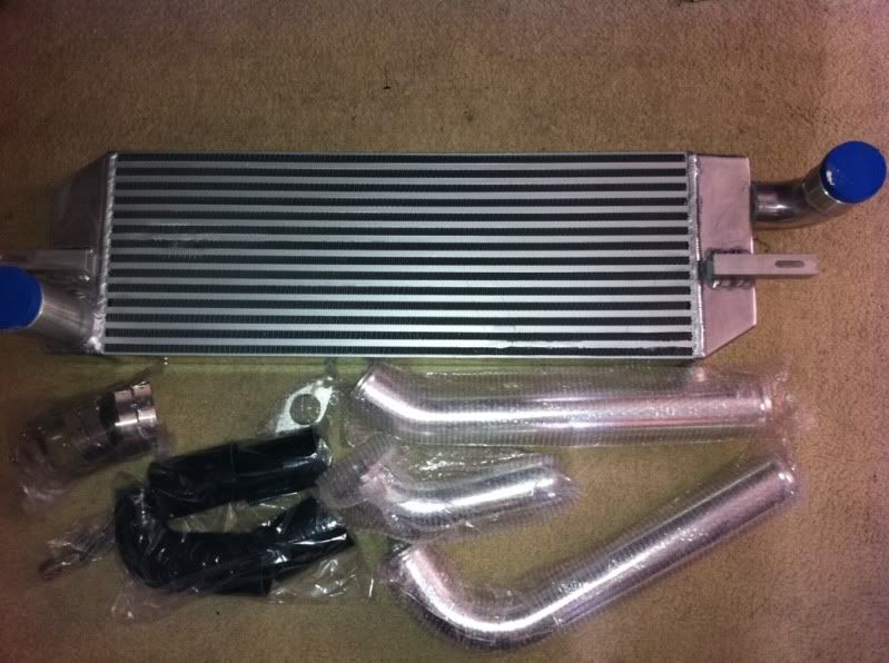

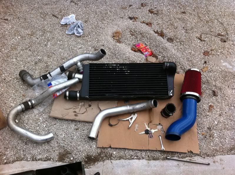

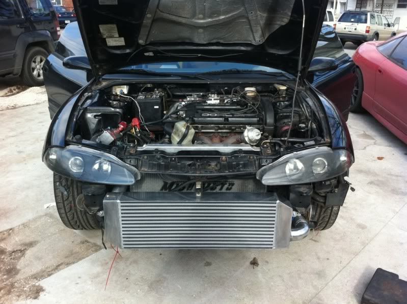

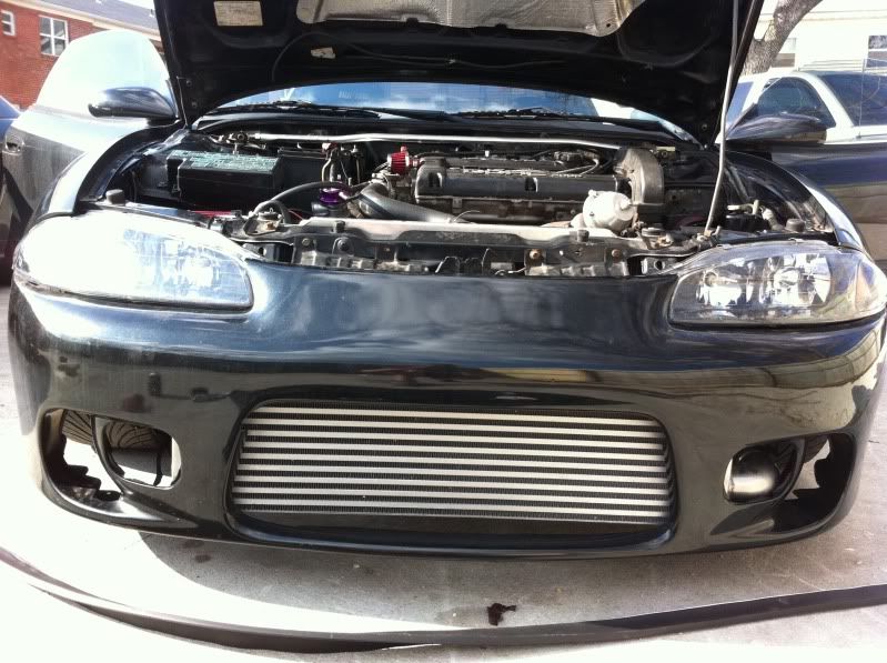

Today I took off all of the old fmic setup (Greddy with the ghey piping)
And am replacing it with this (VRSF)
Got the iat sensor bung welded into the throttle body elbow
And thats as far as I got today. Only a few more things to do and I can bolt the new fmic on. Plans for tomorrow are to swap suspension, get an alignment and finish putting on the fmic.

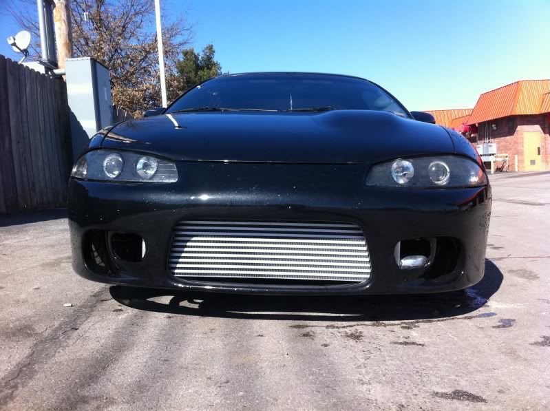

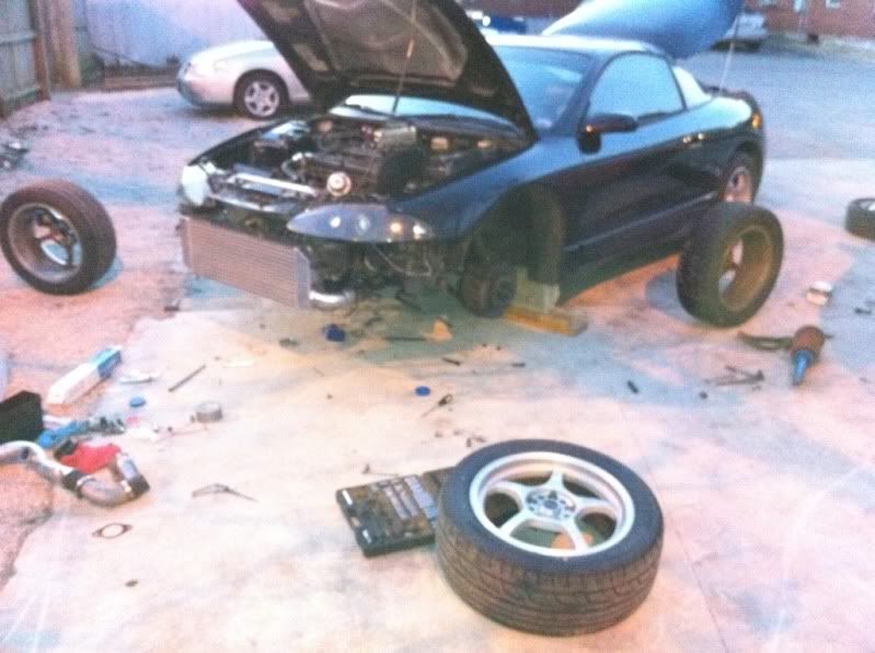

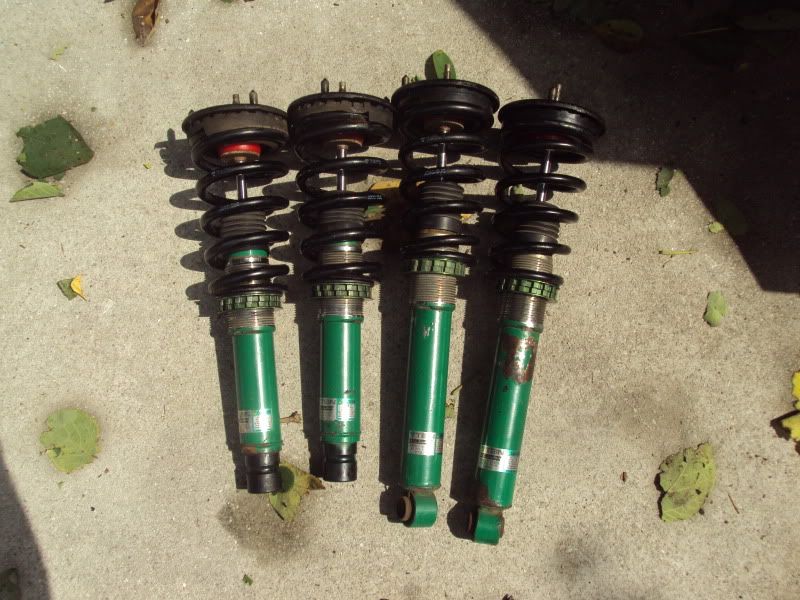

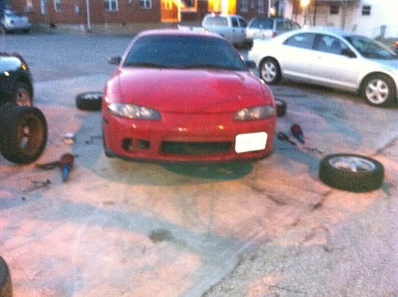

February 17, 2011 – Coilovers on and newly found rebuilt head
Swapped out my coilovers from the gst
I use my parking lot very well...and the cement blocks and pieces of wood
Also finished up the fmic as well, had to do some trimming to the front of the car though
This is the test fit before the bumper goes on and before I fixed a few fitment issues

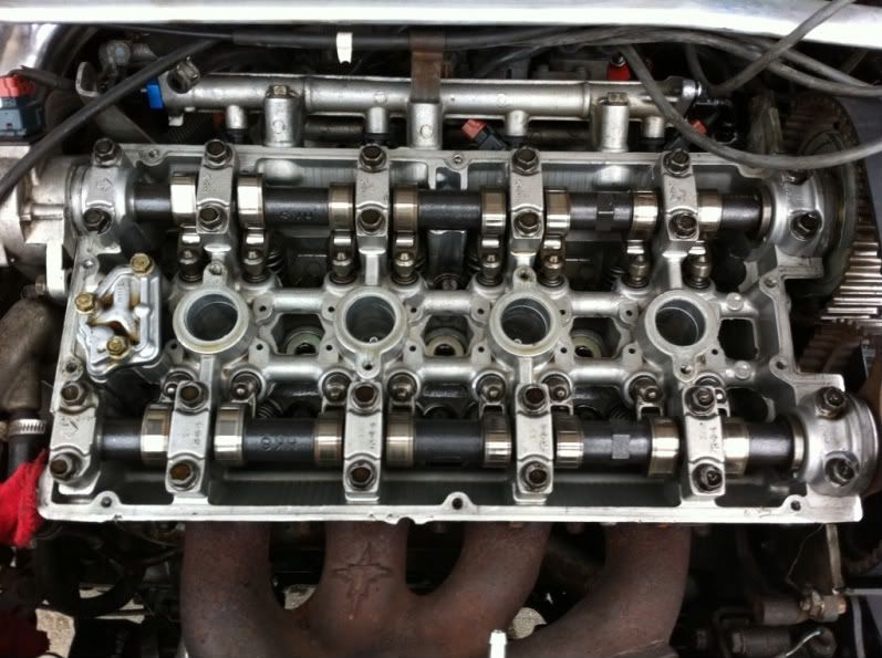

I changed the valve cover gasket thinking that may have been where the oil leak I spoke of earlier was coming from..but it wasn't...I did find a nice surprise though
Apparently the head was rebuilt by the previous owner of the previous owner, or in other words it is fairly new and clean as hell! I wondered why there was no lifter tick. But even though I was happy about that I still have a damn leak from somewhere. I will probably drop the oil pan and replace the gasket to see if that could be the problem (I just changed the oil with synthetic...what a waste).

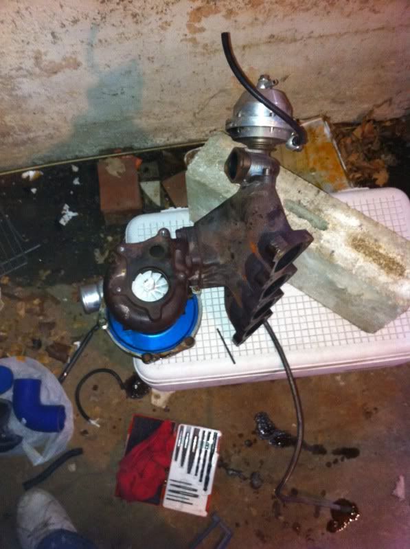

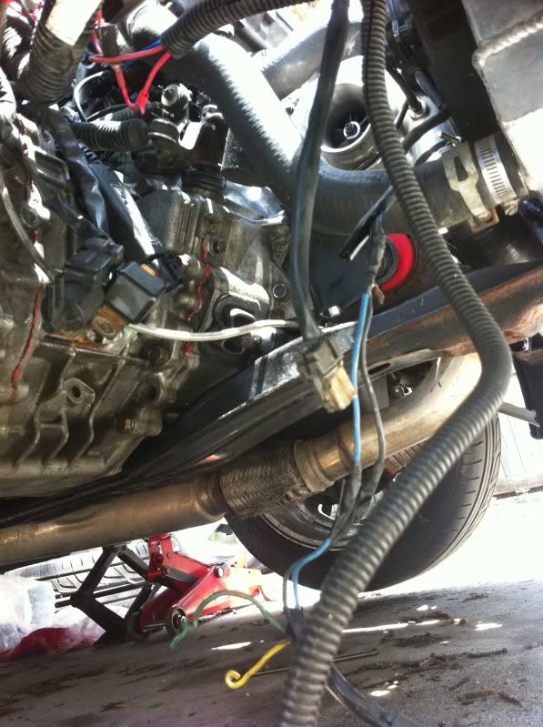

March 2, 2011 – Broken Exhaust Housing Bolts
Put my car on stands to drop the oil pan and try and find/fix the oil leak and figured while I was at it I would fix the broken bolt in the turbo exhaust housing...
It didn't work out too well as you can tell...THREE more bolts broke off in the housing, making that FOUR bolts that are broken off in there. FML, I planned to drill them out myself and use an extractor to get them out but the extractor broke off too. I ended up taking it to a small shop in a very small town and he got them all out for 30 bucks :D

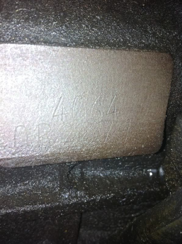

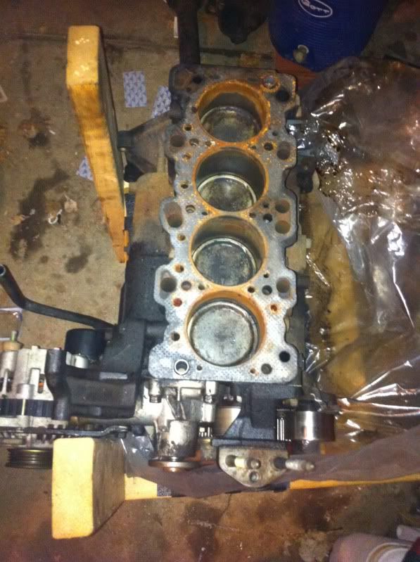

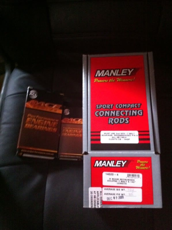

March 20, 2011 - 2.4 Block, Rods, and Bearings
Finally got the 4g64 2.4 block from the previous owner. Got the block, manley long rods, acl main bearings, and rod bearings for $450. Hell of a deal if you ask me. If I get some money back from school I will begin on putting it together asap. (It still hasn't been put together...) I think I am going to go with a 9:5:1 compression ratio since it will be on e85. Anyways, here are some pics

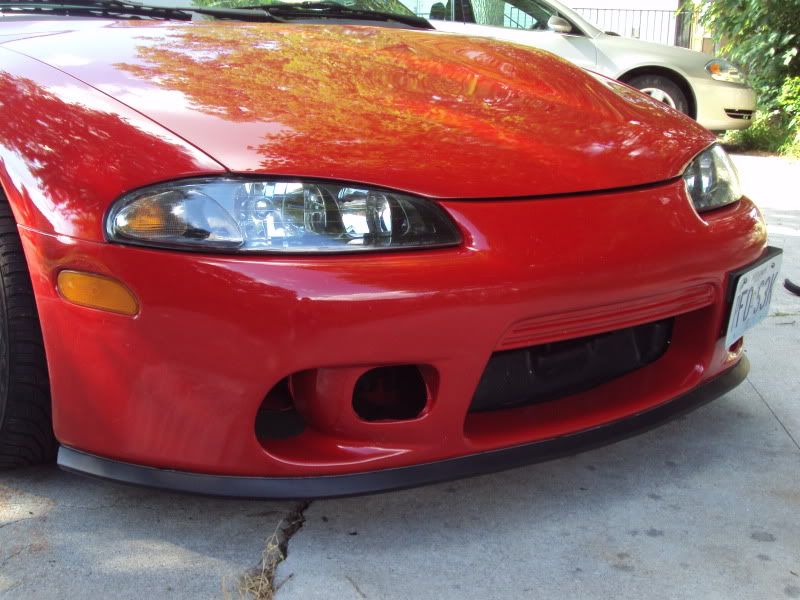

May 6, 2011 - HD Lip and Exterior Photoshoot
Not too big of an update, but here is how the car looked after almost 3 months of owning it. You will notice that I put my other wheels on and replaced the headlights with oem 2gb ones.
I also made the HD lip for it and made a how to seen here. But linking to it is boring, so I will post it here as well

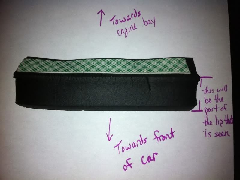

Ok so I have seen a lot of questions about how to do the "Home Depot" (or HD) lip as it is called. I have seen the material at both Home Depot AND Lowes, so it is pretty common. I believe I have bought my materials from Lowes every time however, but it doesn't really matter. I have done it numerous times so I figured I would share how to do it so people can stop asking what products to use and where to find it. So here goes.
To begin, you are obviously going to need materials. I prefer to attach my lips using 3M double sided tape, while others prefer to use screws. 3M tape works very well, but be warned that it can take off some paint if you ever have to replace the lip. (It will remain unseen however, as the tape should be out of sight.) Next you will need 9' of garage door sealer. It is 2 1/4" wide and is a soft, yet durable foam type material.
Now that you have your materials, unwrap the packaging (obviously) and lay the sealer around your front bumper to get an estimate on how much you are going to need. I usually have about 1'-1.5' left over when I do mine.
Now that you have a guesstimated length, you are going to want to put the tape onto the lip, leaving the part that will stick to the bumper with the cover still on. Here is a section I had left over that shows basically how it should be. (Excuse the purple marker, it is all I could find.)
As you can see, you want the tape about 1/8" to 1/16" from the bend. Make sure you get it on the right side too or you will have to do it all over again.
Ok so here comes the more difficult part, sticking it onto the bumper. Make sure you clean it first where the tape will be because if you don't, it will not stick on properly and fall off. What I do is start from one side and start pulling off the cover on the tape so the adhesive is showing. I then start by putting the lip on the bumper so that it is right at the bend of the bumper. It is hard to explain this so I will provide pictures of where I put it. Keep pulling off the cover on the tape and working your way around the bumper, trying to keep the same line as you go around. Once you reach the other end of the bumper you should have some extra. Just grab a razor blade (makes for a clean cut) and trim off any excess. There are a few different ways you can cut off the ends, you can cut it off flat with the fender or you can angle it so it blends with the bumper. Both look fine, it is just personal preference.
Here is what the final product should look like.
You can see what I mean by right at the bend on the bumper, much like any lip should be placed.
On this one you can see what I mean by cutting it so it blends with the bumper, it is more angled towards the bumper.
Here is a picture from down low so you can see how far up on the bumper it should be placed.
Annd, the latest one I completed for my GSX.
Total cost is probably around 15-20 bucks when you include the tape. Keep in mind that you want to be careful when pulling in and out of driveways because it can be ripped fairly easily if not careful. It is durable to a certain extent but steep inclines will rip it off. If the lip separates from the tape, I like to get a dab of super glue and glue the lip back onto the tape. Do not put super glue on the bumper however as that will for sure take off paint. I have had to do this numerous times as my car is a good 3" from the ground, so any incline is bad news for me. Best thing is if it rips it off, just go buy some more and redo it.

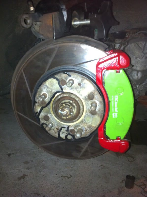

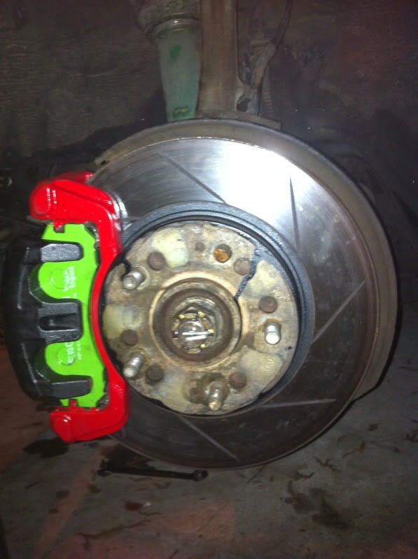

May 7, 2011 – Painted calipers, wiring cleanup, fuel pump rewire
Since classes are officially over, except for finals...I probably should have studied instead, but, I worked on my car. Got a lot of things I have wanted to get done finished.
Started working on it because it seemed like first gear was gone all of a sudden. Just didn't want to go in most of the time which I thought was weird because it showed no signs of wear or anything. I figured the clutch just needed to be adjusted. Well before I adjusted the clutch I wanted to make sure the slave cylinder wasn't leaking and come to find out it was pretty bad. So I bought a new one from Autozone and put it on. Bleeding the clutch seemed like it took forever. I really need to get a speedbleeder for next time as I got tired of getting out from under the car every minute. So when it was finally to my liking I adjusted the clutch, which needed it pretty bad. Haven't driven it yet because I wanted to take care of a few other things but I am anxious to see if I fixed the first gear problem.
I figured while it was up in the air I would change my front brake pads which were pretty much toast. The rotors and calipers were pretty rusty so I cleaned them up as well. Just accented it in red for now as I have to custom order the color I want. Put in EBC Green Stuff pads which I have heard good reviews about so I am looking forward to testing those out as well.

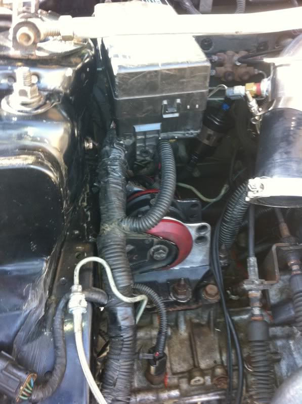

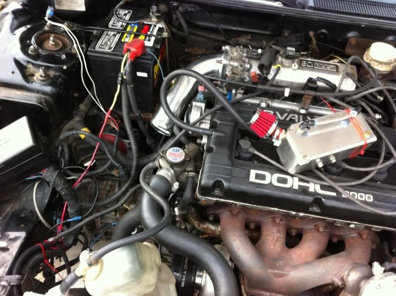

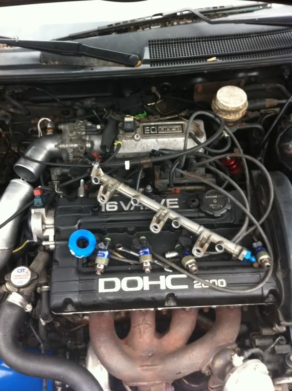

I decided that I was tired of my afpr just hanging on the side of my engine so I am going to relocate it...I got distracted by other things before I could finish this so it will be finished tomorrow. I had wanted to look at my return line to see if it could be rerouted to give me some extra slack, but while I was checking this out I noticed my feed line was hanging kind of low to the ground. So I pulled the slack out and realized I might be able to put my fuel filter back in its stock location. (I had to relocate it under the battery because the feed line wasn't long enough.)
Back in the stock location..sorta. Had to angle it for the hose to clear.

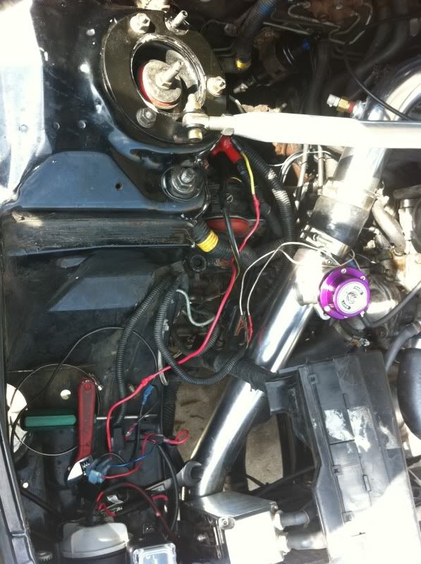

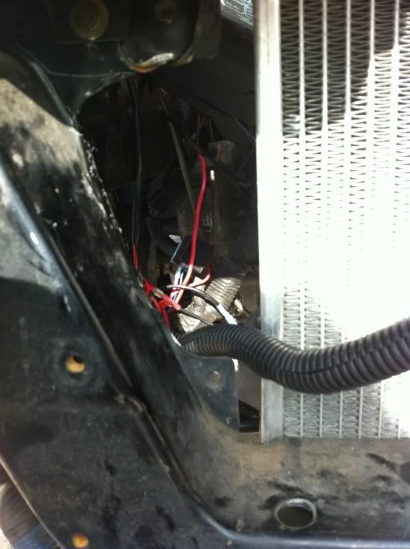

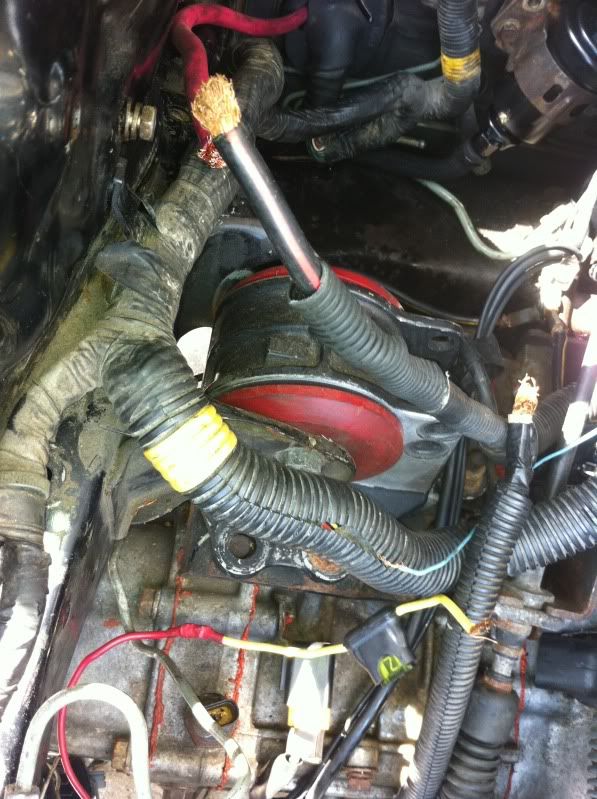

The wiring for my HIDs has been pretty bad since I bought the car so I decided to finally clean up the mess.
This is the mess I set out to clean up.
I noticed I had an excess of wire for my fan when I was cleaning up the headlight wires so I set out to fix that as well.

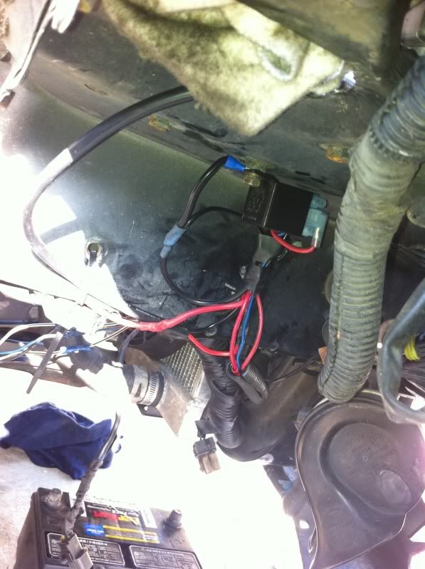

Almost finished doing that and realized I wanted to finally relocate my battery since I was doing wiring anyways. Sooo, went and bought 2ga wire and went to town relocating the fuse box to where the battery was.
And all done, need to get some better pictures tomorrow when I finish up some other things.

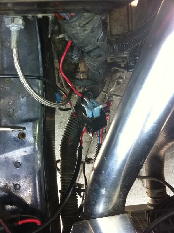

Moved the HID relay under the passenger side fender.
Ran the battery wire back to the trunk and figured I would stop along the way and finally do the fuel pump rewire to give the pump better voltage. To give you an idea of how much the voltage drops with stock wiring, I can hear the pump slow down and speed up when I have my blinker on. So this should help.
And that is it for today. Tomorrow I will be painting the rear calipers and putting my gramlights back on for a while. Painting my intake as well..blue-->>gunmetal gray. I will need to finish wiring up the battery and moving the afpr and then it should be good as new! Hopefully I don't lower it back down and drive off only to realize first is still messed up. I would then proceed to kill myself. (First was still messed up...I am still alive.)

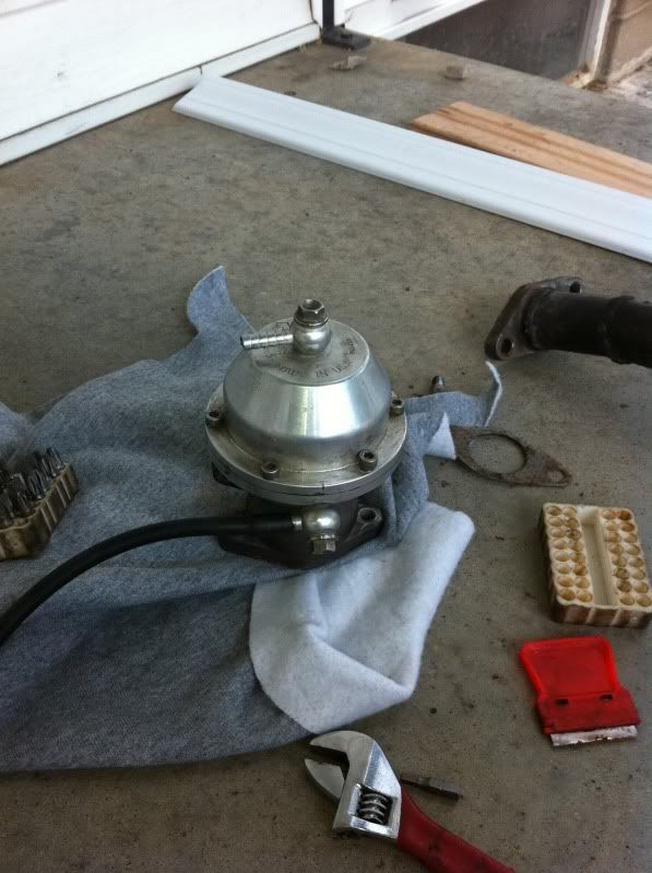

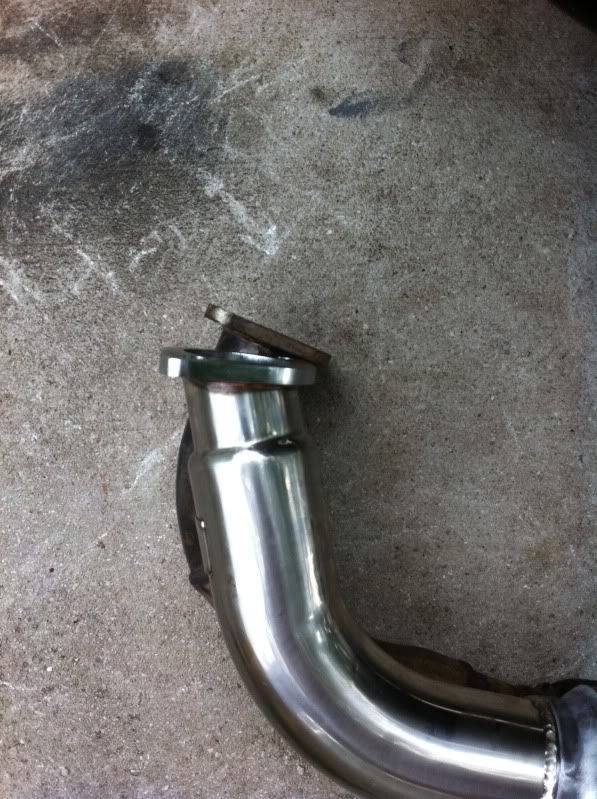

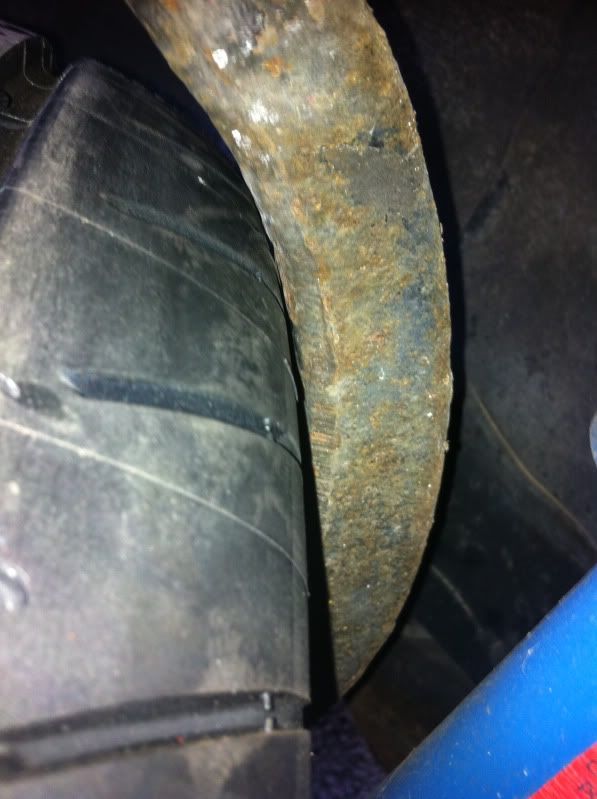

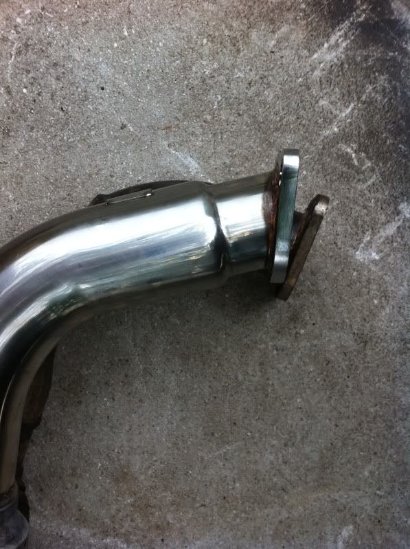

May 27, 2011-New downpipe needs modified
Seafoamed the car today and changed the oil and spark plugs afterwards. While I was at it I wanted to see if I need to modify my new downpipe, and sadly I do. I think it may bend to where it needs to be by heating it up in a vise then bending it to more of a 90 degree angle but I am not sure.
Here it is on top of the old downpipe...the old one doesn't fit exactly right but it gives me an idea of how the new one needs to bend to fit
No way for it to fit without modifying it...

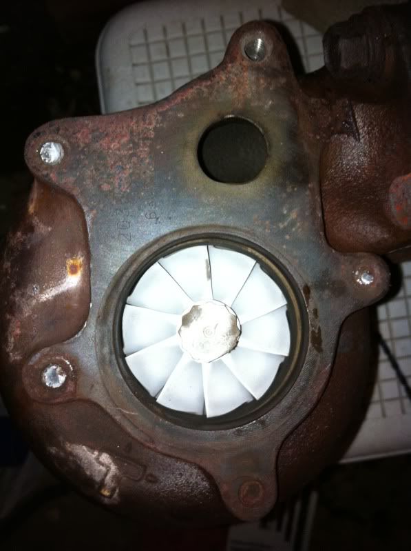

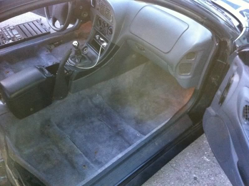

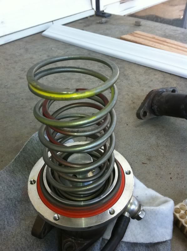

June 25, 2011 - Carpet in, wastegate checked
It seems that I took a break from working on the car or something, or that I just didn't document anything because I can't find any posts or pictures from this month span. Oh well, things start happening now

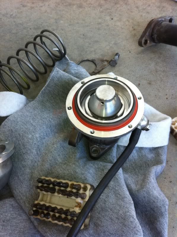

Finally checked out my wastegate and no leaks to be found. Diaphragm was in good shape and the valve sealed up. Went ahead and put two springs in it in case the small one was worn out. That was a freaking pain but with the help of my roommate I got it done. Even if it doesn't fix my spool issue I can run more boost with the current mbc now

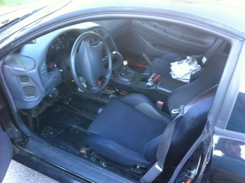

Also put the carpet that came with the car in. I planned to just dye it black and keep it for a while but decided it wasn't worth wasting the 20 bucks worth of dye. So, I just put it in the car as is for now. Looks much better and much less road noise.
How it started out
Seats out
Carpet in
