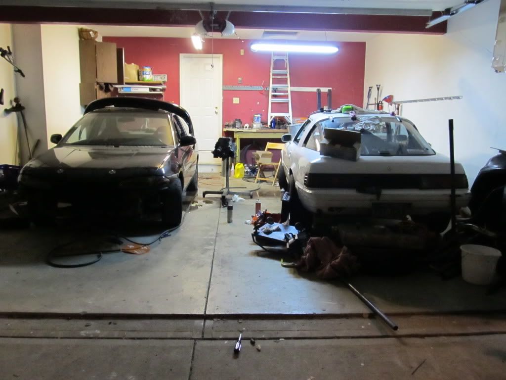

After being asked 497120342134 times to build another, I was happy to save a clean local chassis that was one foot in the grave.
[/IMG]
I am going to toss it together with parts I have laying around collecting dust. I should have all of no money into the thing after its all said an done-I am confident I have enough junk laying around to put it together.
Next to its TDB brother-an 85 RX-7 picked up a few weeks earlier. That will be the long term-winter deal. ;)

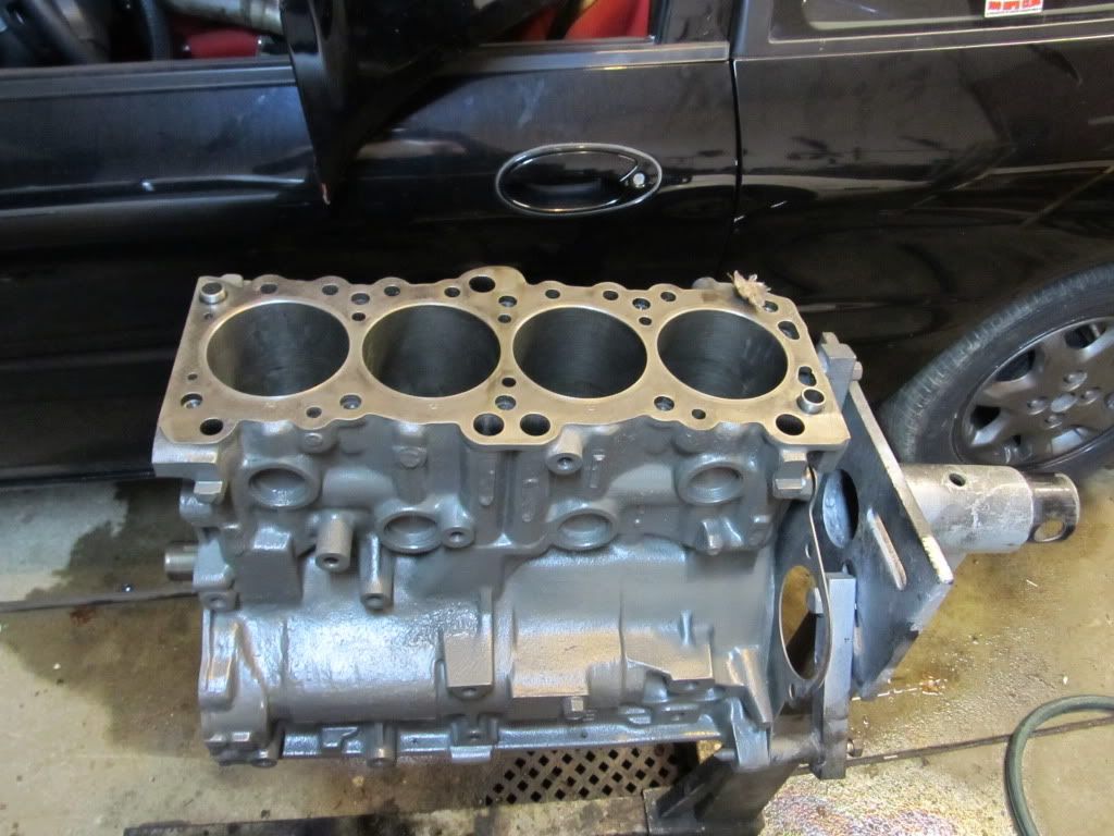

This wont be the Busa slayer the old Colt was (for now) but should provide fun for the rest of the season. Making the shootout is a maybe- but with no time between the work, a weekend trip to "The AC" coming up, and not having a motor together, it may not be likely. We will see! Stay tuned to see what parts I dig up for her.

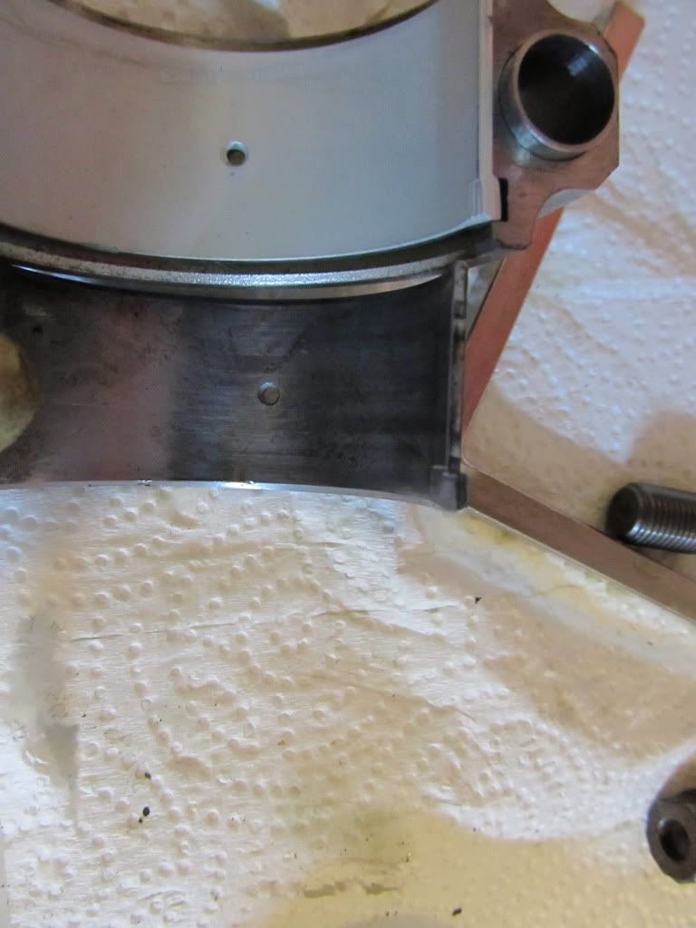

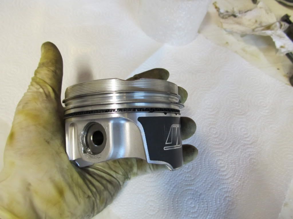

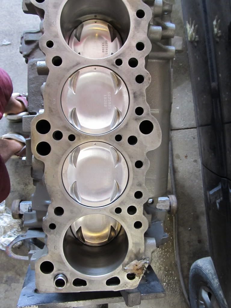

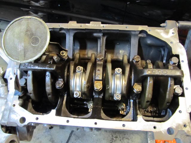

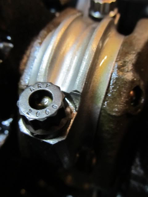

Found enough spare parts to toss a motor together! She"should" hold. :) Crank looked good. rods and Pistons looked good. Did not have my Mic. or Calipers at the house, so it had to pass the EYEBALL test. ;) Poured some Beer on it just in case....
Now, I am a little sketched out about the bearings-never used this brand before, and I am not sure I would use them again. The seem to have a smaller tab to prevent the bearing from spinning that was what in there (presuming Federal-Mogul as thats what I usually use) but its all I had on shelf-and I am pressed for time!

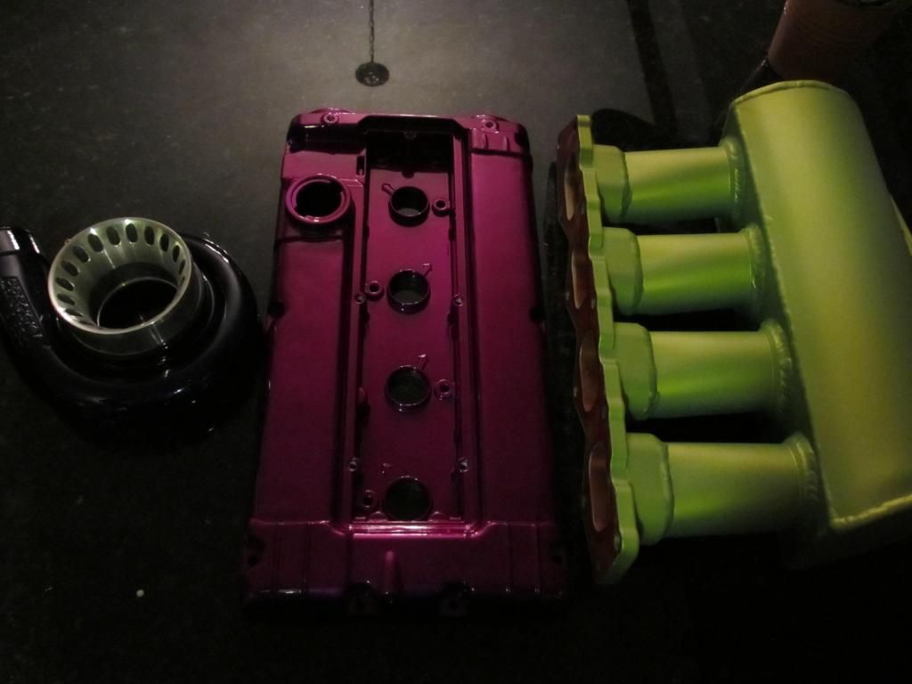

Again big thanks to Detective coating for the great work and the very fast turn around. Everything was packaged very well. No one should have a hesitation sending him anything just because he is not local! Best work I have seen in a while.
I will admit the green in pictures was scary-but in person it is SICK. Iridescent almost with a "white pearl" effect. I love it!
