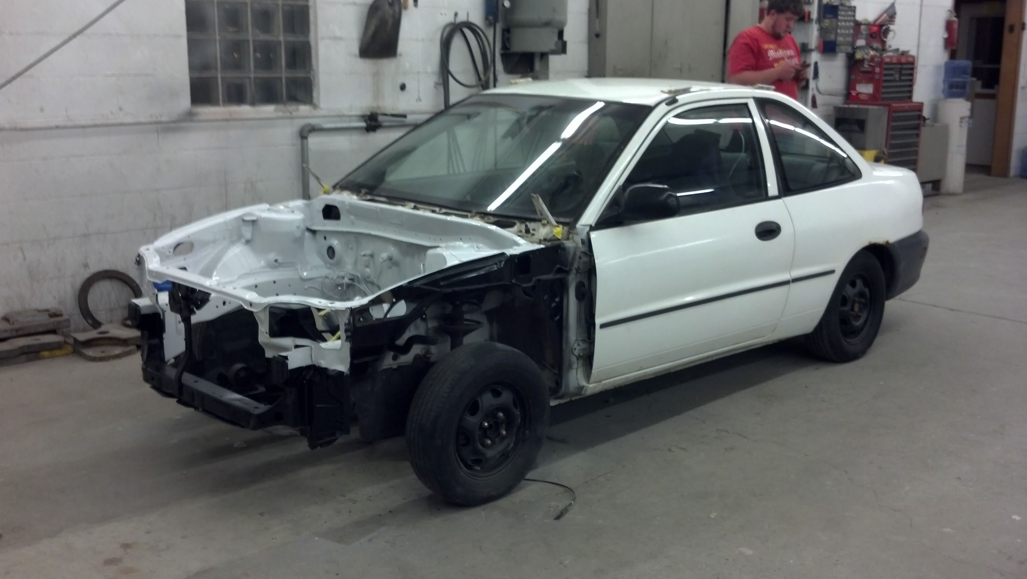

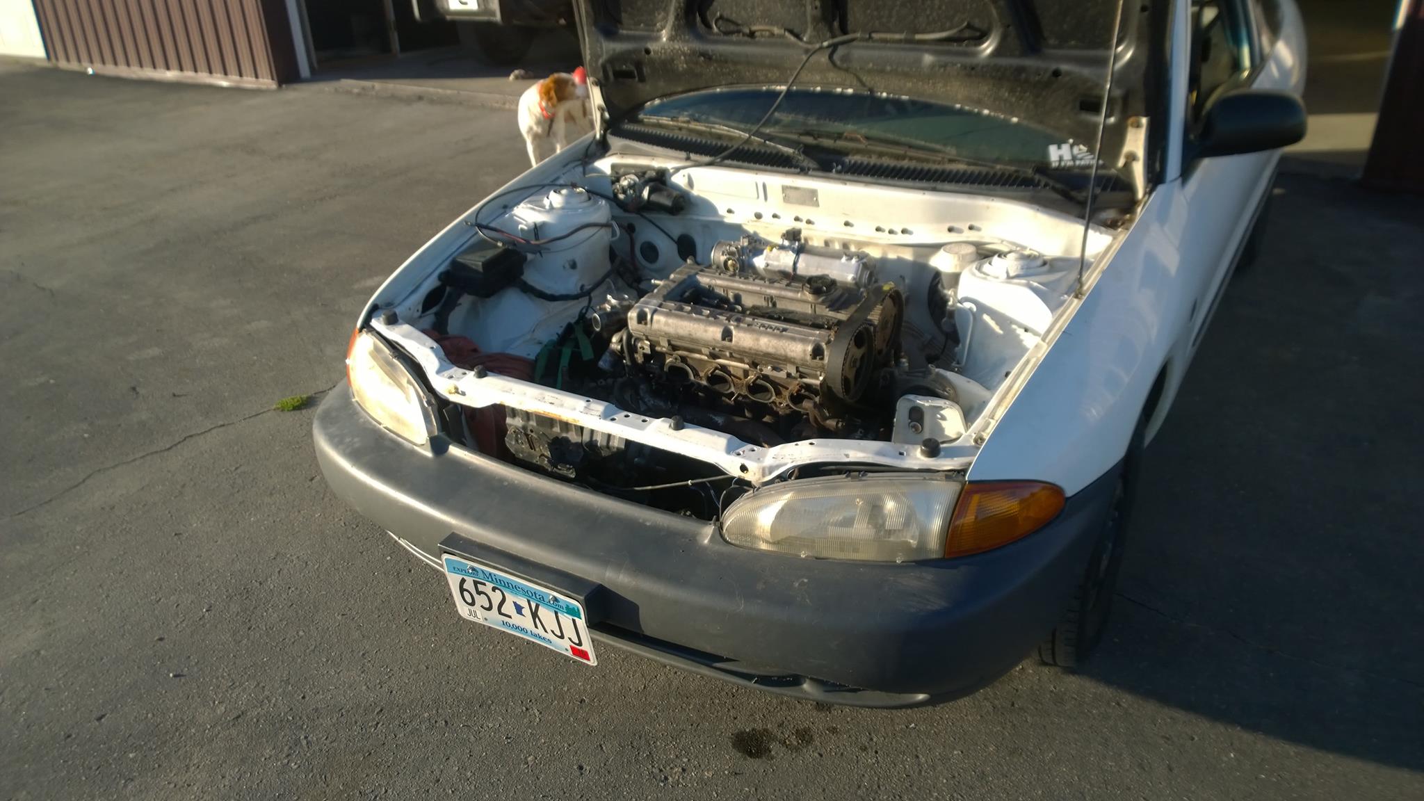

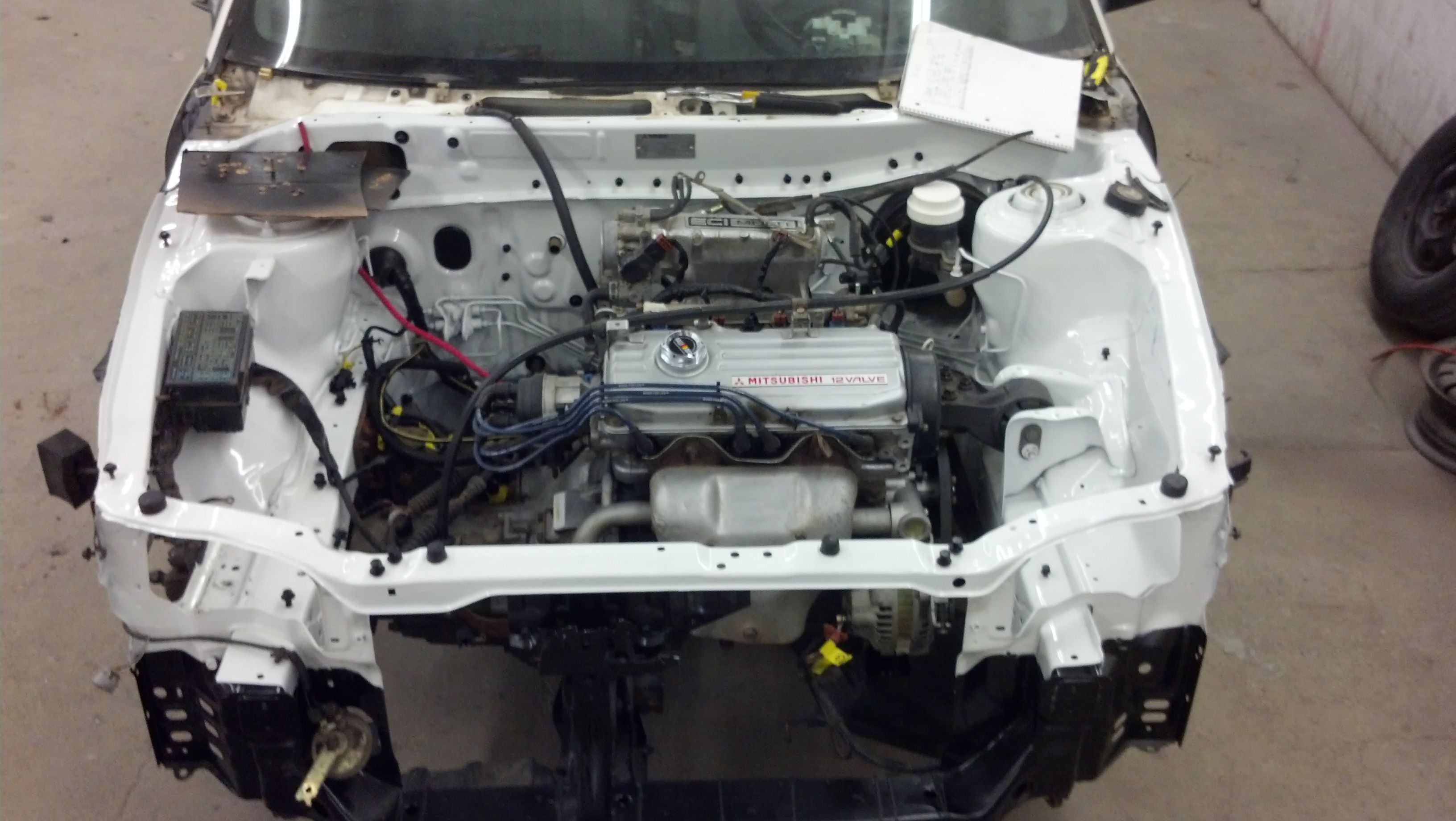

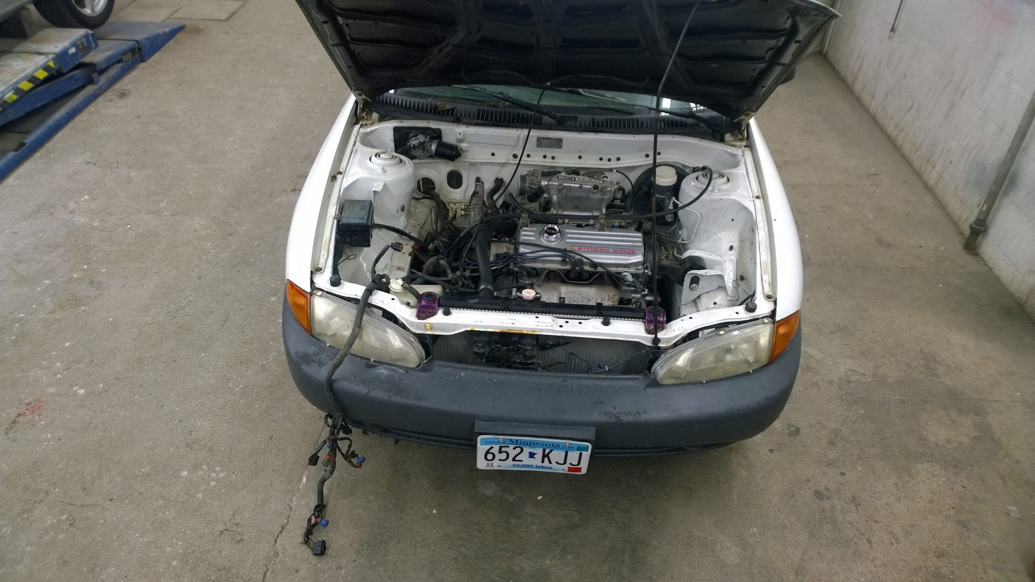

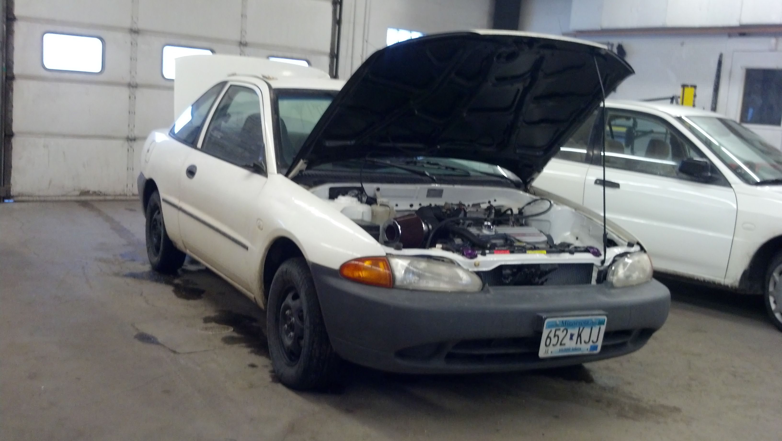

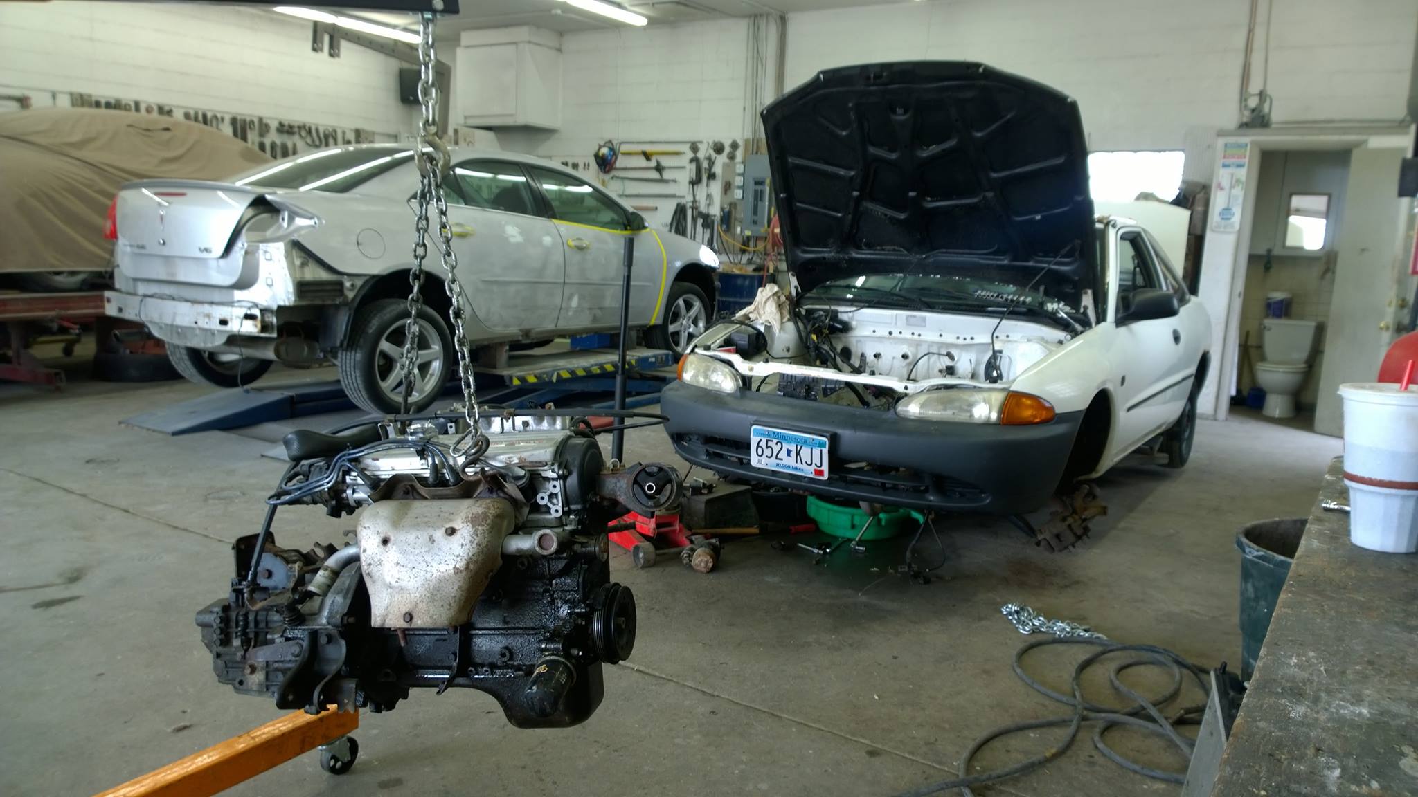

My '94 1.5L Colt base moving to 4G63 swapped, FailWheelDrive, spin happy machine.
Looking good. Keep it up and get it done. I need to get a bumper and new headlights for mine and new hydraulics for the clutch. Its almost ready to start on the 14b though. Sc61 will go on when I get the suspension and brakes finished.

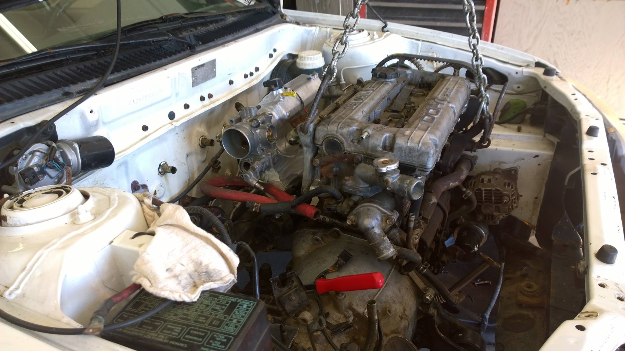

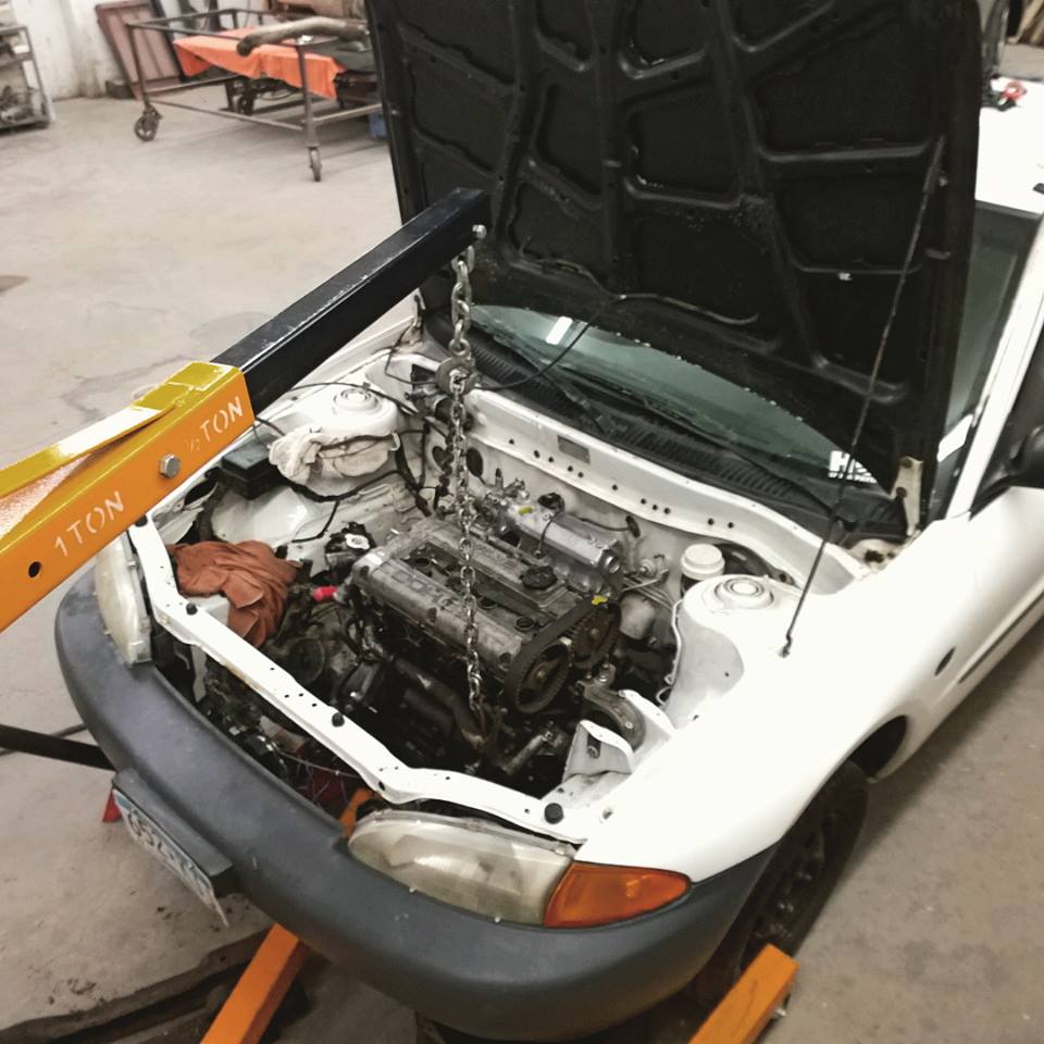

Thank you sir! I just received a 1g F/W4A33 upper transmission bracket today. Now (hopefully), I will be able to mount the transmission correctly and make the front and rear mount! The ratchet strap isn't exactly going to cut it. LOL

I think I am going to be making the change to AWD with this anyway. I have the stuff to do it. Or enough to get it going and the rest I can buy whenever I am able too. We'll see. The main issue I have now is needing to move the engine over an inch or so to the passenger side. With the transmission bracket off of a 1g automatic and 1.5L frame mount flipped upside down it just sits too far over. The alternator pulley messed the paint up on the frame rail. No way that'll work. Makes a guy just want to go manual! LOL
