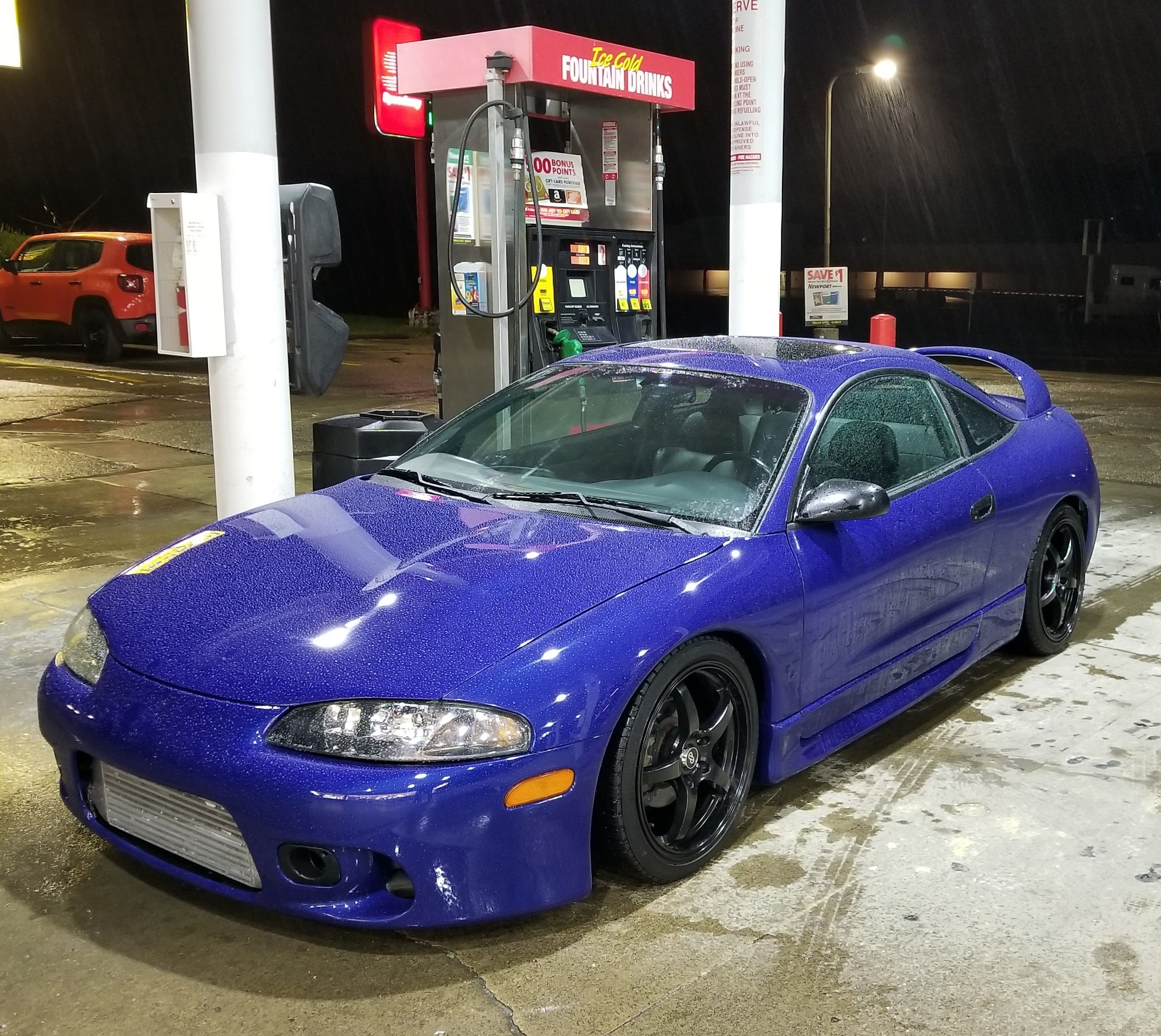

Just wanted to post an update since I haven't in a few years. I still have the car and it's still going strong. I just made the trip from California to Ohio and it ran perfectly, making the 2250 mile trip in just 38 hours. This car has now driven across the country twice so yes, DSM's can be reliable and practical! Before the trip I did a bit of maintenance, with the worst being the heater core. They don't make the right one for the 2Gb anymore so I had to get one for the 2Ga and bend the pipes and trim some plastic to make it work. I also completely redid the AC system in the car replacing the compressor, evaporator, expansion valve, drier, condenser, and the AC lines. Heat and AC work beautifully now. I don't think I ever mentioned this but about a year ago I upgraded my radiator to the Mishimoto X-line 3 core radiator and silicone coolant lines. I also added a SPAL AC pusher fan in front of the condenser since the factory AC fan no longer fits with the bigger radiator. Car runs pretty well with only minor quirks that still need sorted out. But hey that's just the reality of owning a 25 year old car
