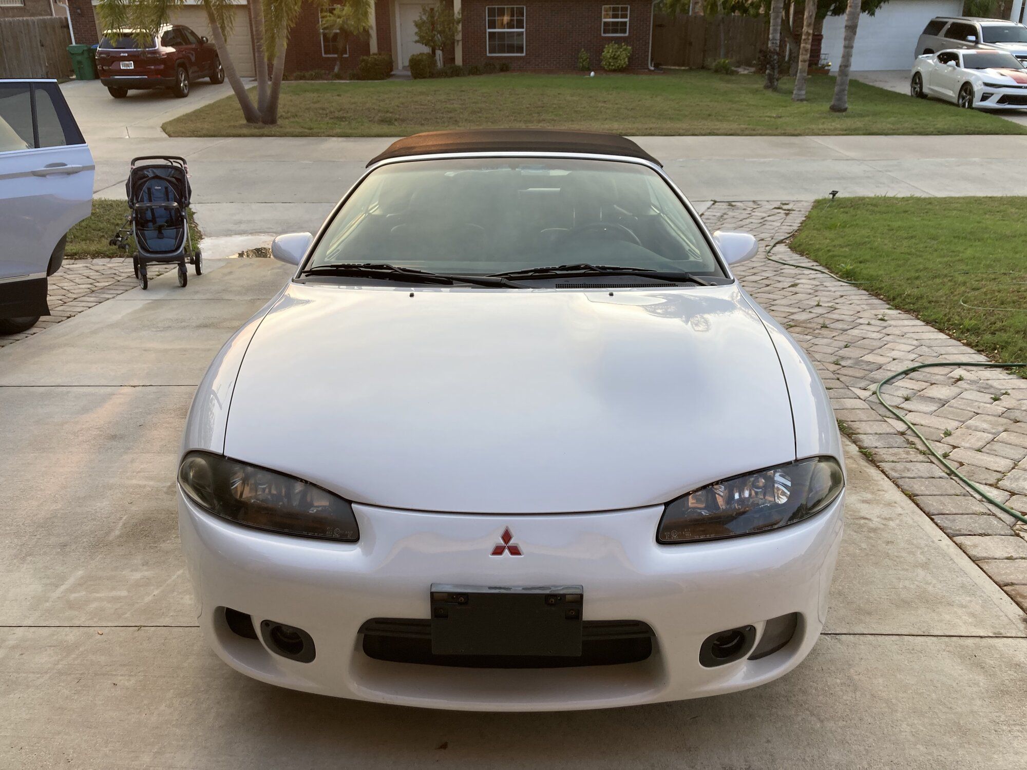

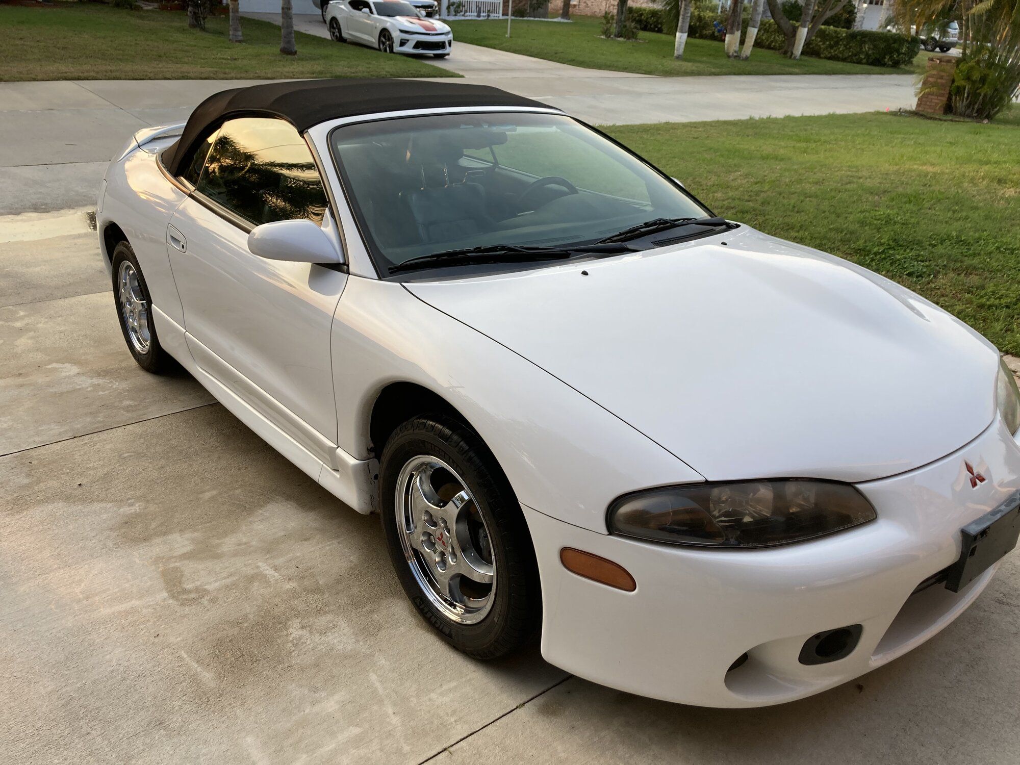

My new 2g GST Spyder
New to me ‘98 auto GST Spyder. Completely stock, 69k miles

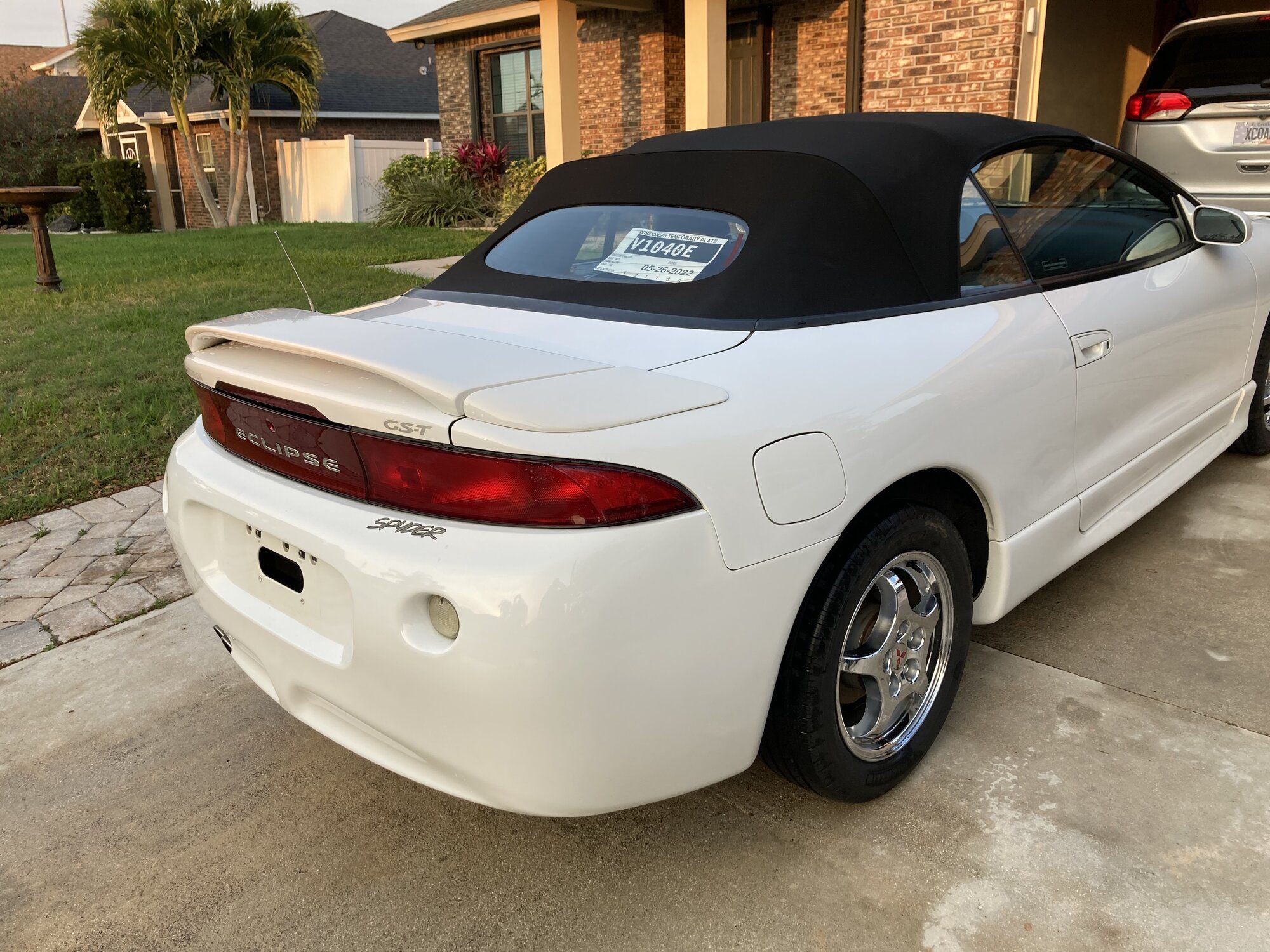

Paint is in great condition! How many miles? Strange the trunk stickers are light silver bc white cars got the dark silver ones. Unless it was different for Spyders for some stranger reason.

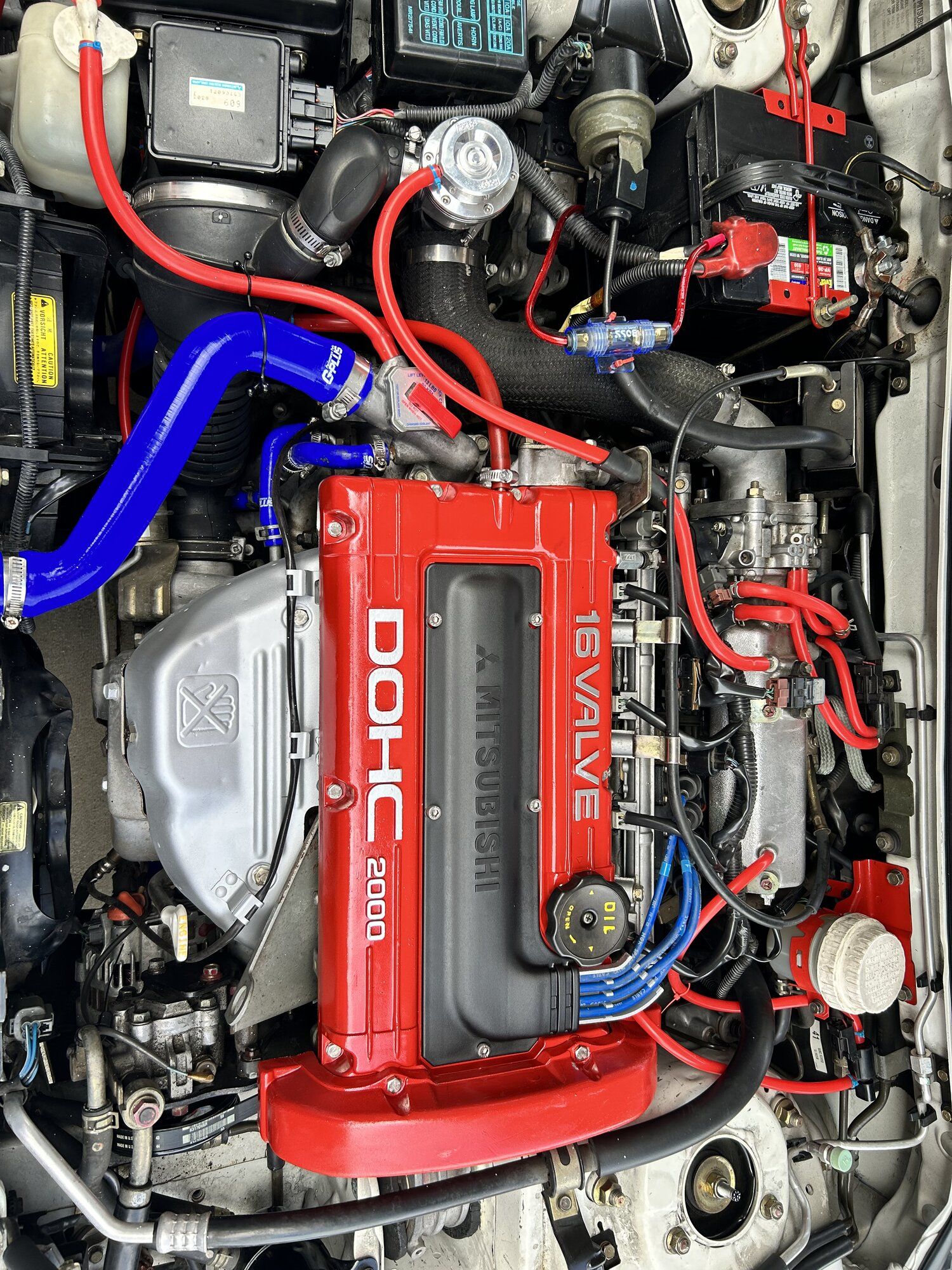

There is still a low idle issue. I've replaced the idle air motor, and read all of the threads on this all-to-common problem. It only happens after putting the car in drive. After that, she won't idle above 5-600 or so. Sometimes as low as 400. I will be replacing all vacuum hoses with red silicone hoses in the near future to see if it's a mild leak, but I think it's likely an AC or power steering pump bearing issue. Or the ECU. She runs pretty smooth at idle, even at those RPMs, and no OBD codes.

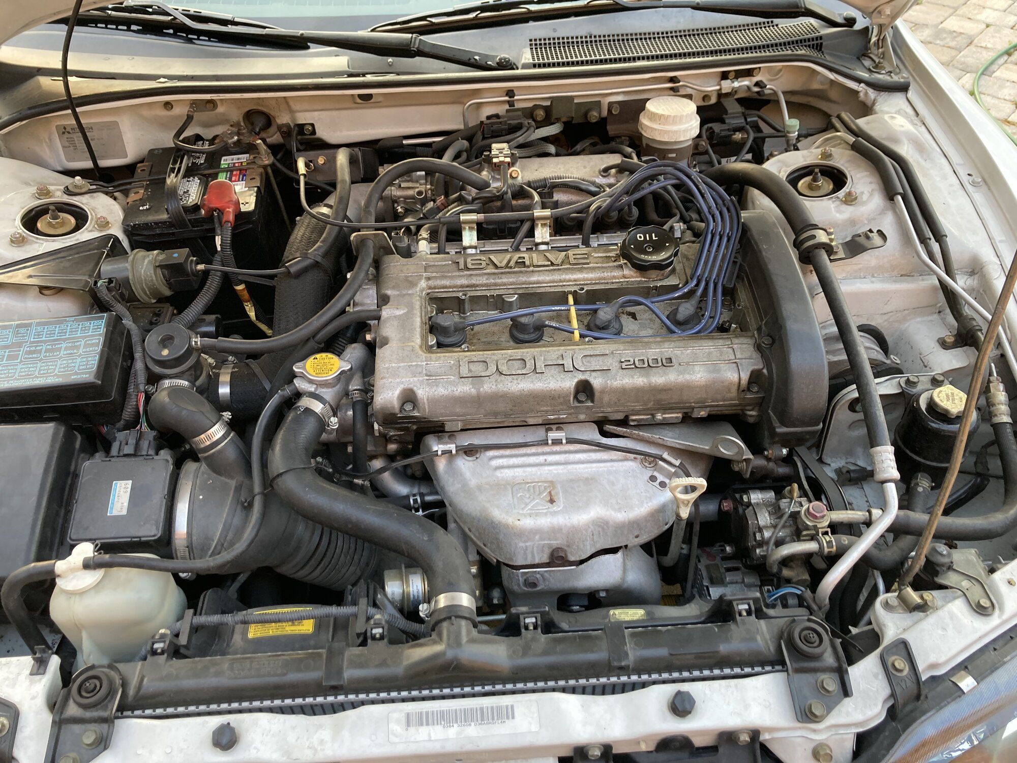

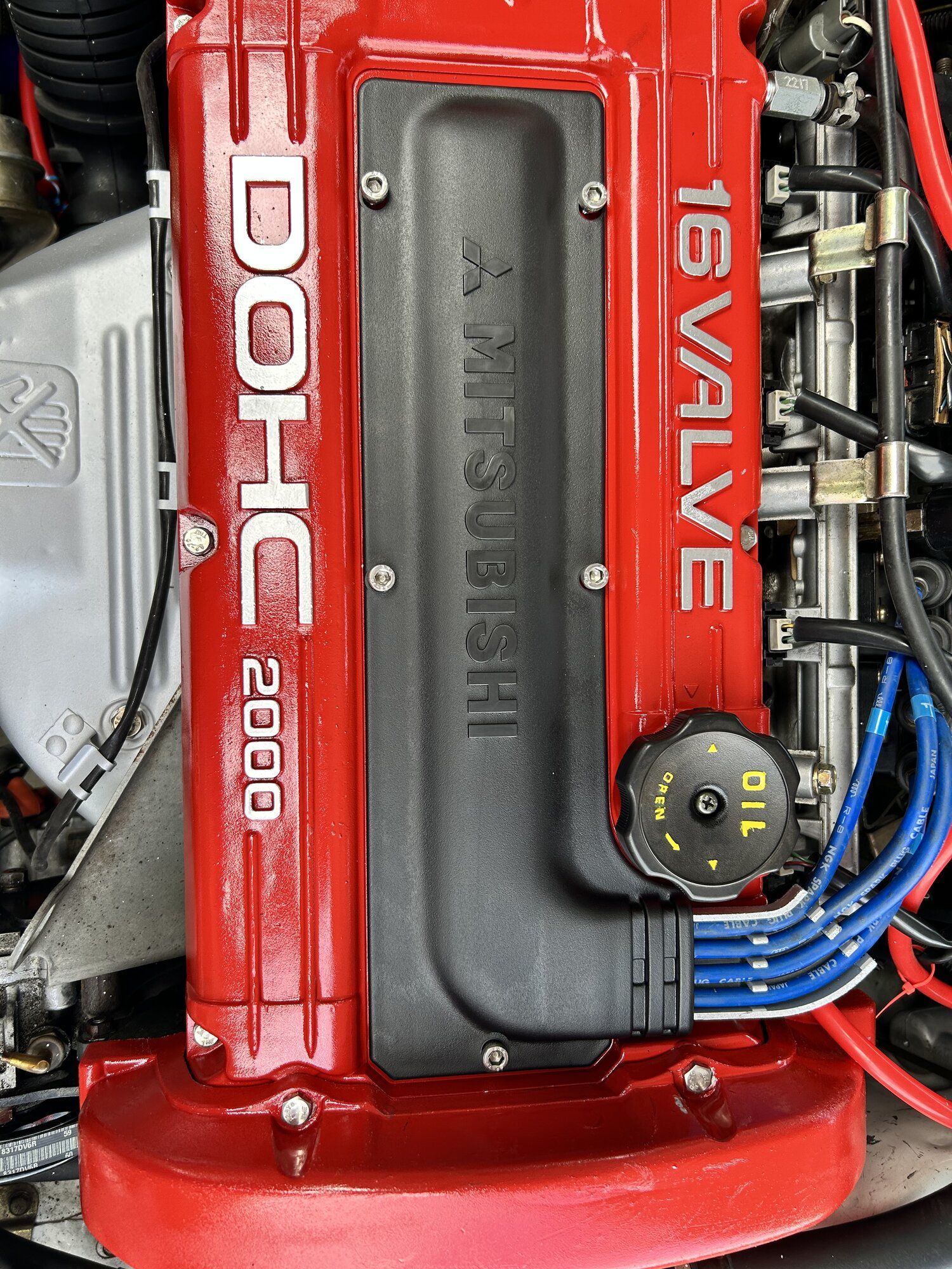

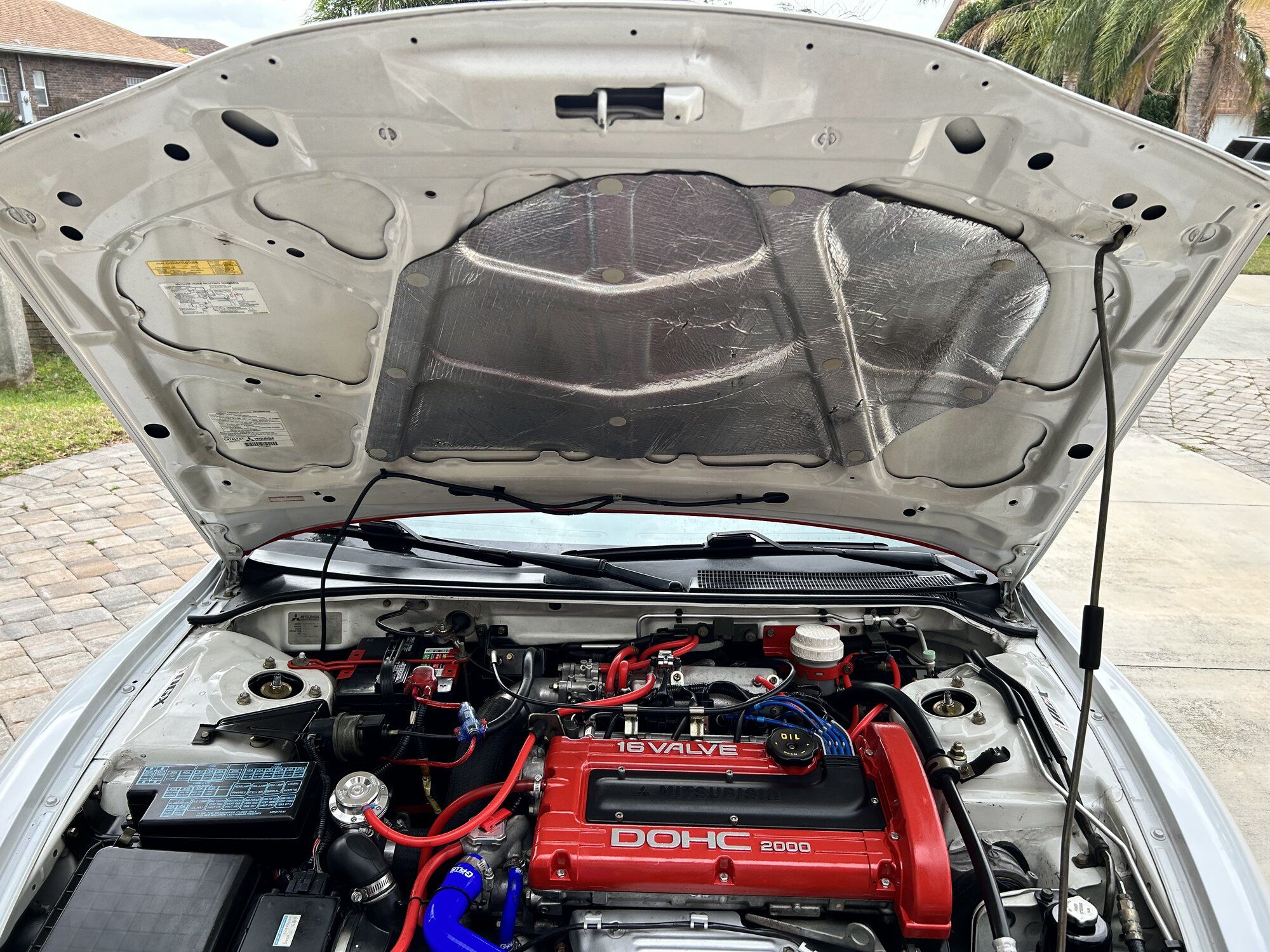

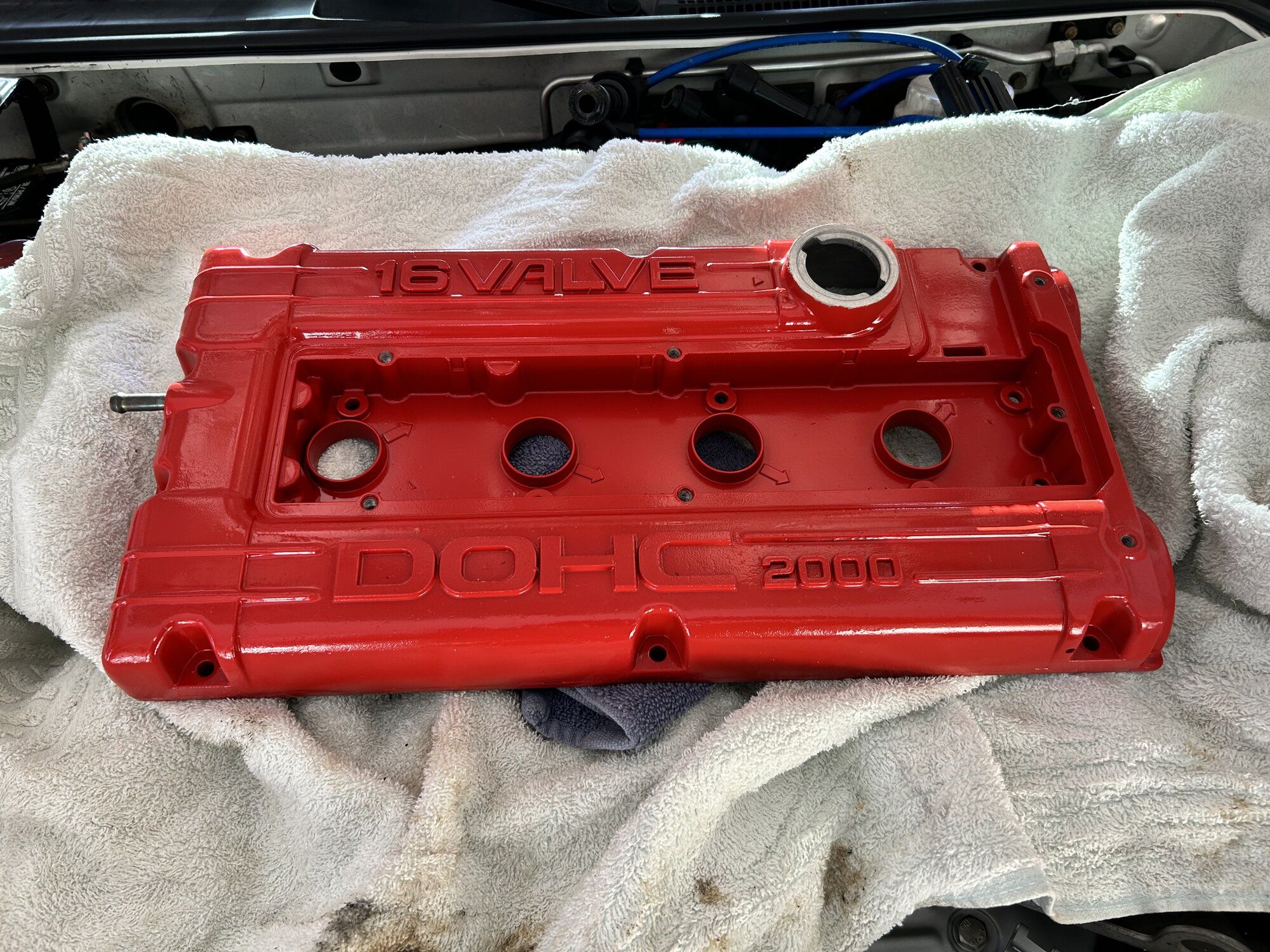

I am starting the process of cleaning up the engine bay now. Going with a red/blue theme as I like those colors. I'll be looking for a valve cover-cover (engine cover?) but I'll also be removing the valve cover to clean / replace gasket / paint.

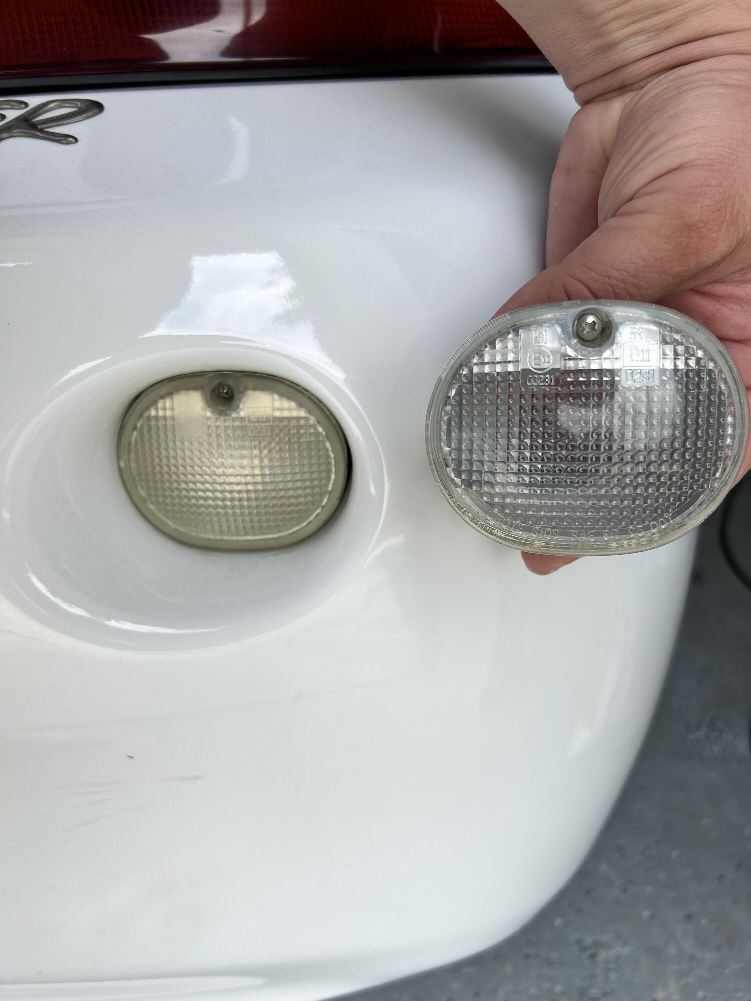

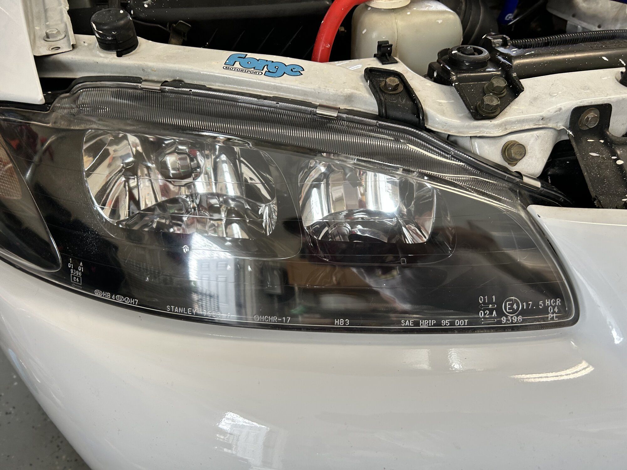

Clear headlights and backup lights!

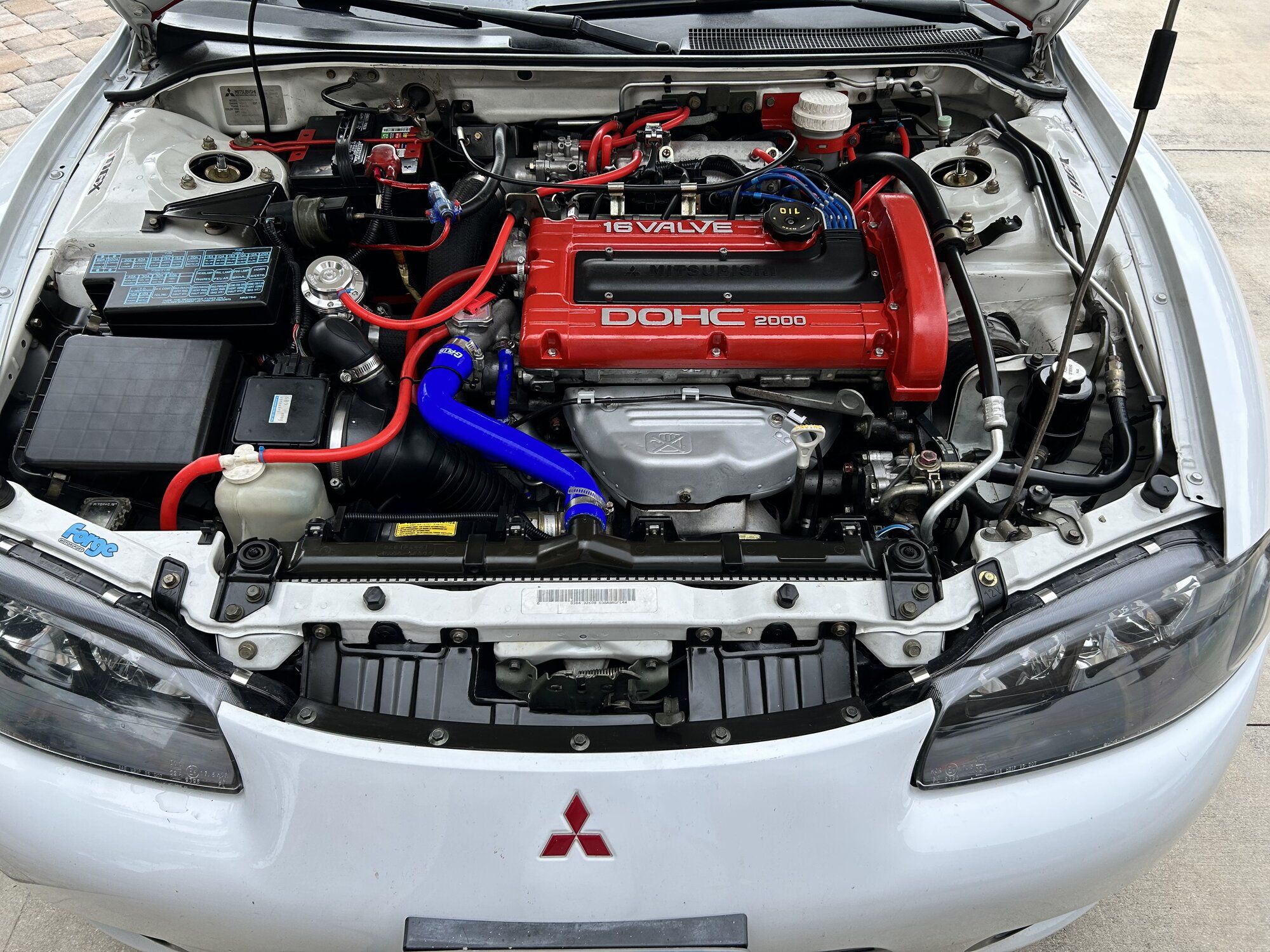

New FELPRO valve cover gasket, stainless steel bolts, and soda blasted valve cover and upper exhaust heat shield.
Rattle can paint all around. The brake fluid reservoir bracket was rusty so a good wire wheel and rust fixing paint to stop that.
Engine bay detailed and trim restorer applied.
